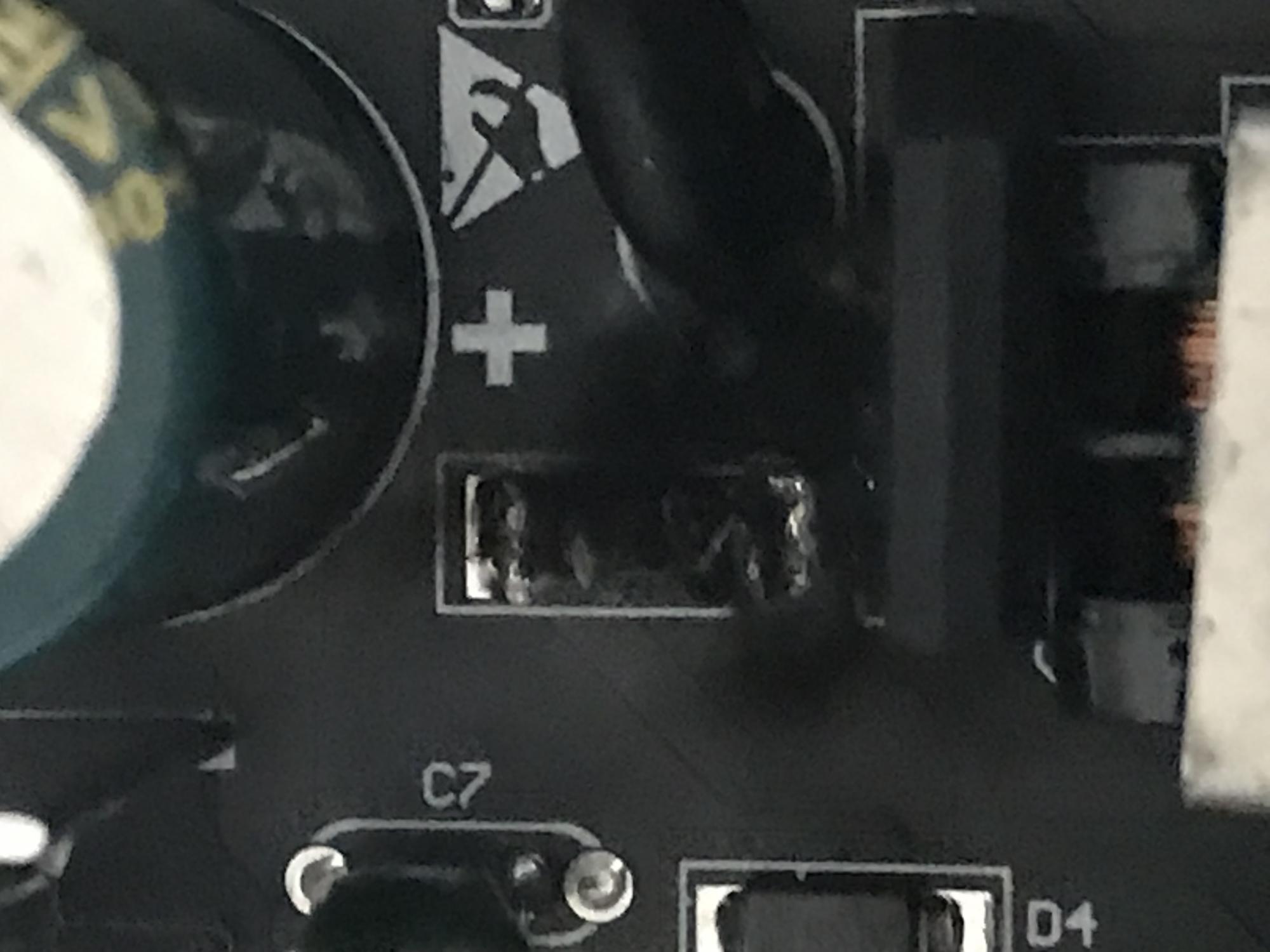

                              When I turned on my KSGER today there was a loud bang. Turns out R1 is completely burned. Other components look OK. Any ideas what could cause this? Don't want to replace and have it happen again.
                              • redwire
                                • Dec 2010
                                • 3912
                                #55
                                Re: KSGER STM32 T12 soldering stations
                                That is the sense resistor for the SMPS 0.30Ω
                                It means your power mosfet failed shorted. Check R6 as well, but the IC could be blown as well.
                                Schematic here: https://www.eevblog.com/forum/review...36/#msg2467236
                                For the time and money to repair it, I would just order a new PSU. The price of mosfet, IC, fuse, and maybe a cap or two, troubleshooting time...
                                Why it blew up - it could be a failing electrolytic capacitor, shorted wand or just cheap stuff off the junk.
