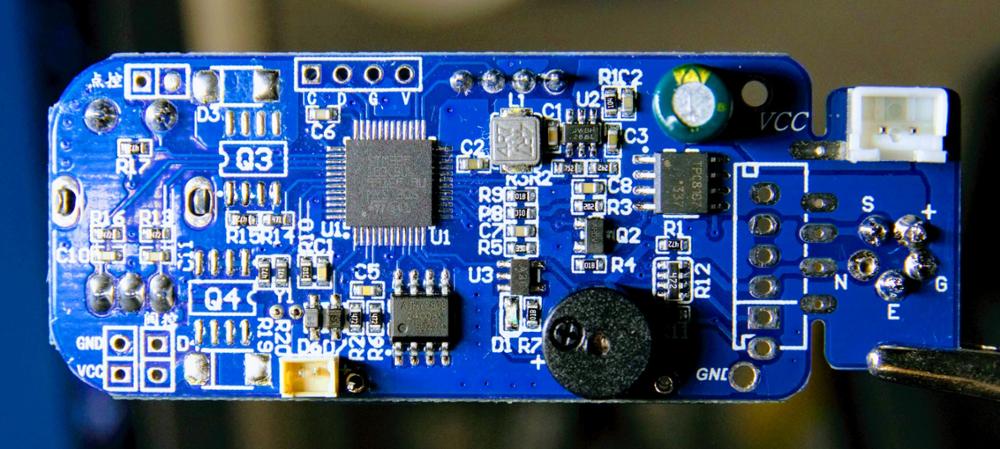

    Picked up a soldering station with H/W Ver 2.1S and S/W 2.10 from KSGER store on Ali. Build quality is very good, price was high.
    The handle has a NTC thermistor inside that doesn't seem to do anything.
    What do your station do?
    Bottom right corner of OLED shows a temperature 40°C all the time. Even with a handle plugged in or not, or shorting the "N" pin to GND.
    Menu 04. Cold End Adj. -> NTC-> 40°C {dial in}
    The temperature I dial-in is always displayed.

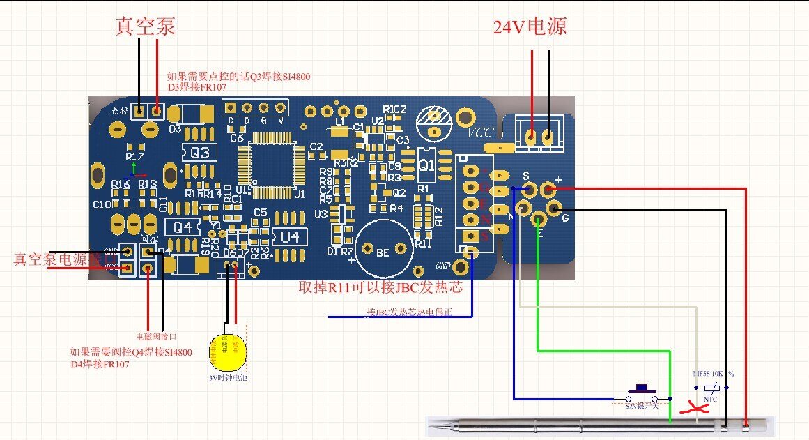

    I drew a full schematic of the controller board and 24VDC power supply.
    The NTC input is just a pullup resistor going to the MCU input. So the hardware seems fine, it must be crappy firmware?
    RTC battery was DOA and a new one also died quickly. Took out the stupid resistor R10 from this video: https://www.youtube.com/watch?v=B-xWhPcr6jk

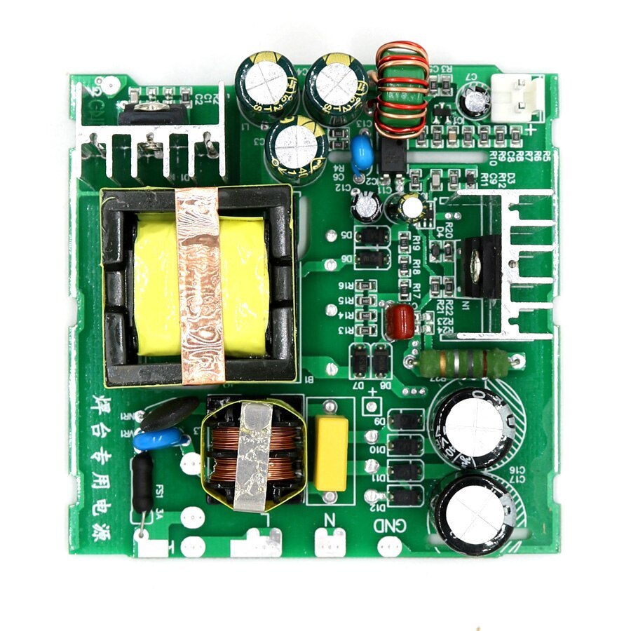

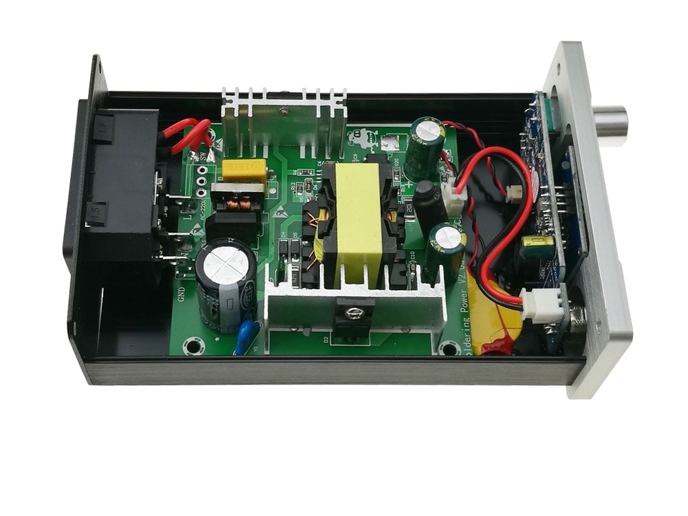

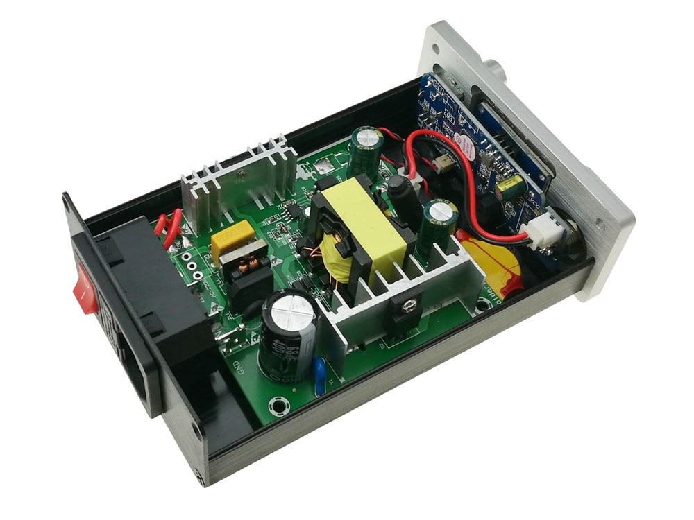

      Here's the schematic I drew of the KSGER soldering station 24V PSU for service and repair.
      Soldering Power V2.04 and pig with bull horns icon on the silkscreen.
      KSGER 96W 24V 5A Electric Power Supply Unit For STM32 STC OLED T12 Digital DIY Soldering Station Controller.
      It has some clearance mistakes running +HV trace underneath heatsink and a thin PE ground trace, no connection to the chassis
      The TL431 is set to over 25VDC output and it has no bias resistor. The snubber cap is pretty cheap. Could not find datasheets on the CR8642S PWM controller.
      Earlier version PSU's like V2.01, V2.02, V2.03 are the same but no pads for a mystery DPAK part or different DC connector.

        are the heatsinks insulated? the semi's are.
        it's a good design - caps well away from the sinks - unlike japanese shit i used to fix.

          Semi's are isolated TO-220 parts (fullpack), but the heatsink mounting pin pads have very little clearance to the fills. So the path is PCB trace->heatsink->mounting pads-> nearby pours.
          I'll put Kapton tape over the two traces if I can fit that in.

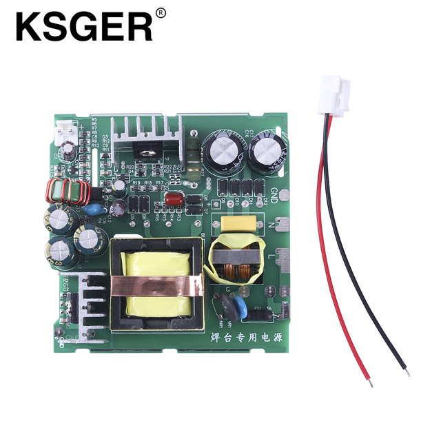

          The older version 24VDC PSU (left) is apparently not very good. Primary capacitors are low value 2x22uF, 1A diodes instead of 8A bridge, no 3A fuse but a 1R resistor in heatshrink. The Schottky rectifier runs 112C at steady 3A. Quicko sells them too.
          But it has to put out 3A for short periods.

              It's a good power supply. Just the two issues with 100V snubber cap and heatsink on the HV pcb trace, and it takes a few seconds to power up which is strange. KSGER sells it with their better soldering stations.
              Actually you don't need 3A for very long, just bursts.
              There are a few other T12 soldering station PSU's out there- this one pictured below is what I consider not very good. KSGER, Quicko, Banggood sell them too. At $12.50 it is $1.50 USD cheaper than the previous one.
              It has 1A rectifier diodes, small heatsinks, very small primary caps 22uF 450V each, super thin PE GND trace. Runs hot, high stress on parts and not for heavy duty use.

                Which of one of photos is a good quality one let see if the one I have is a good one or I should use the medical grade switching power supply that I just bought and change the low voltage power cord on

                  Left is the lower quality one, right is the better quality one.
                  Before I was mentioning the right better quality one that had a few weaknesses.

                    can you remove a few mm of the heatsink where it crosses the track??

                      A person could grind off the fin on the heatsink for more clearance. I used Kapton tape and lifted the heatsink up a bit, it does have sharp edges which would cut solder mask.
                      It really does take several seconds to light up the red LED on the 24V rail. Not as long if you switch it off and then on.
                      I can't find datasheets for the CR8642S PWM IC. It has 1.5MEG HV DC feed and 22uF 50V cap, so I'll bet it's taking its time charging that to start up. Or a 120VAC version needs a lower resistor value. It's kinda weird. Voltlog is 240VAC so maybe that is covering it.
                      edit: Changed out the 22uF 50V 105C Chong-X capacitor. It tested fine. No difference in 3 second start-up time. Power-off it quickly goes from 16V to 9V and takes many minutes to discharge to zero. When it still has charge, next start-up is quicker, maybe 1.5 seconds.

                        I have the version the one on the right side of the photo

                          That's the better one, it's still pretty good for stuff out of china, with the usual couple of weak points.
                          I think most important is adding a PE ground wire from the IEC outlet to the chassis.

                              Anyone know the T12 handle components? They ship two NTC thermistors and two different motion switches, a ball shake switch and a mercury switch.
                              The black blob NTC I have only seen on a controller board and the glass MF58 part I used. The 0.1uF cap sometimes across the NTC, other times across the heater, the handle wiring is always different.
                              Got a replacement T12 controller board V2.1S and the cold-junction temperature is now working. Display shows !24°C if the handle is unplugged, where the old one was just stuck at what was entered at the cal menu.

                                  The GX12 has 1.6mm pins and the desoldering tools I have couldn't clear the holes. No tips fit over the pins close spacing. I thought hot air would melt everything around it like the JST power connector and capacitor, buzzer?
                                  The temperature I am talking about is always displayed on the bottom right, even if the handle is unplugged and ERROR is up.
                                  When the handle is unplugged it goes to the default value from menu 4.
                                  I suspect the firmware 2.10 got a sneak update or they programmed the STM32 wrong, as the hardware works fine on the defective controller.
