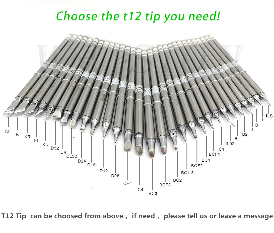

        And I believe I found it ?
        Wattevah...
        • diif
          • Feb 2014
          • 6978
          • England
          Re: Soldering station thoughts and guidelines
          Either T12-JS02 or T12-J02 Dannyx.
            • 31316
            JL02, i was going to get one until banggood ran out of stock.
            maybe i should check again.
              • 31316
              http://www.hakko.com/english/tip_sel...eries_t12.html
              full list!

                I'm keeping an eye out for a T12 iron on AliExpress ATM, and found this overview and description of available T12 tips there.
