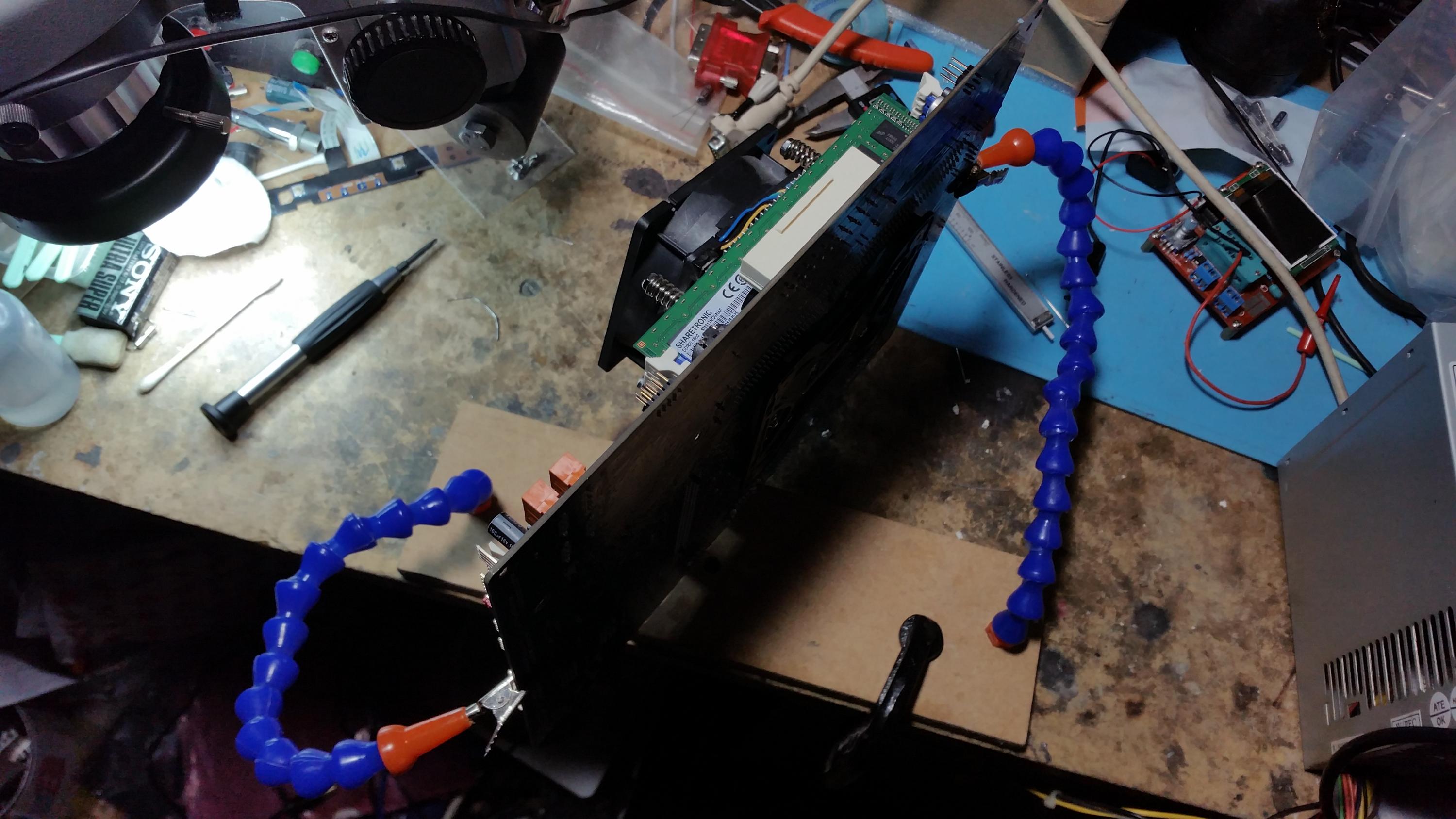

                      So I'm using a solder sucker from the top side of the board while I heat up the hole on the other side. It's actually working well. My problem is keeping the board steady between my legs while keeping the iron tip in the hole and then aiming the sucker properly. Holy crap I need 2 more arms!
                              Build yourself a large pair of "helping hands" ?

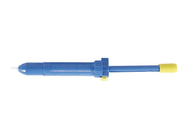

                                    My solder sucker of choice is the Vellman. Strong and cheap, like me.lol
                                    • tvtimmy
                                      • Mar 2015
                                      • 1160
                                      • usa
                                      Re: Solder differences and desoldering tools/technique
                                      The Vellman
