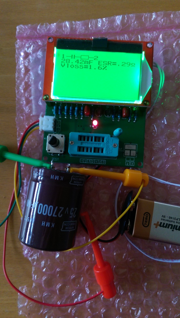

                                    #37
                                    Re: Thoughts on this ESR meter
                                    Originally posted by eccerr0r View Post
                                    My Sencore LC meter has a limit of around 0.25F ...
                                    Does the Atmel avrtester work OK with even higher capacitors, perhaps supercapacitors?
                                    This is the biggest cap I have at hand, tests fine even after being in use in industrial equipment since 2002!
                                    I just realized it's actually this very cap from the OP in this thread:
                                    https://www.badcaps.net/forum/showthread.php?t=7413
                                      #38
                                      Hey I've got a couple of those lying in a drawer at work somewhere

                                        that anti-static bag can probably effect the readings!
                                        that's why i fitted mine to a bit of acrylic with spacers.
                                          #40
                                          Well, a box has been on my to-do list since forever, but you know, lazyness and all that got in between :P
