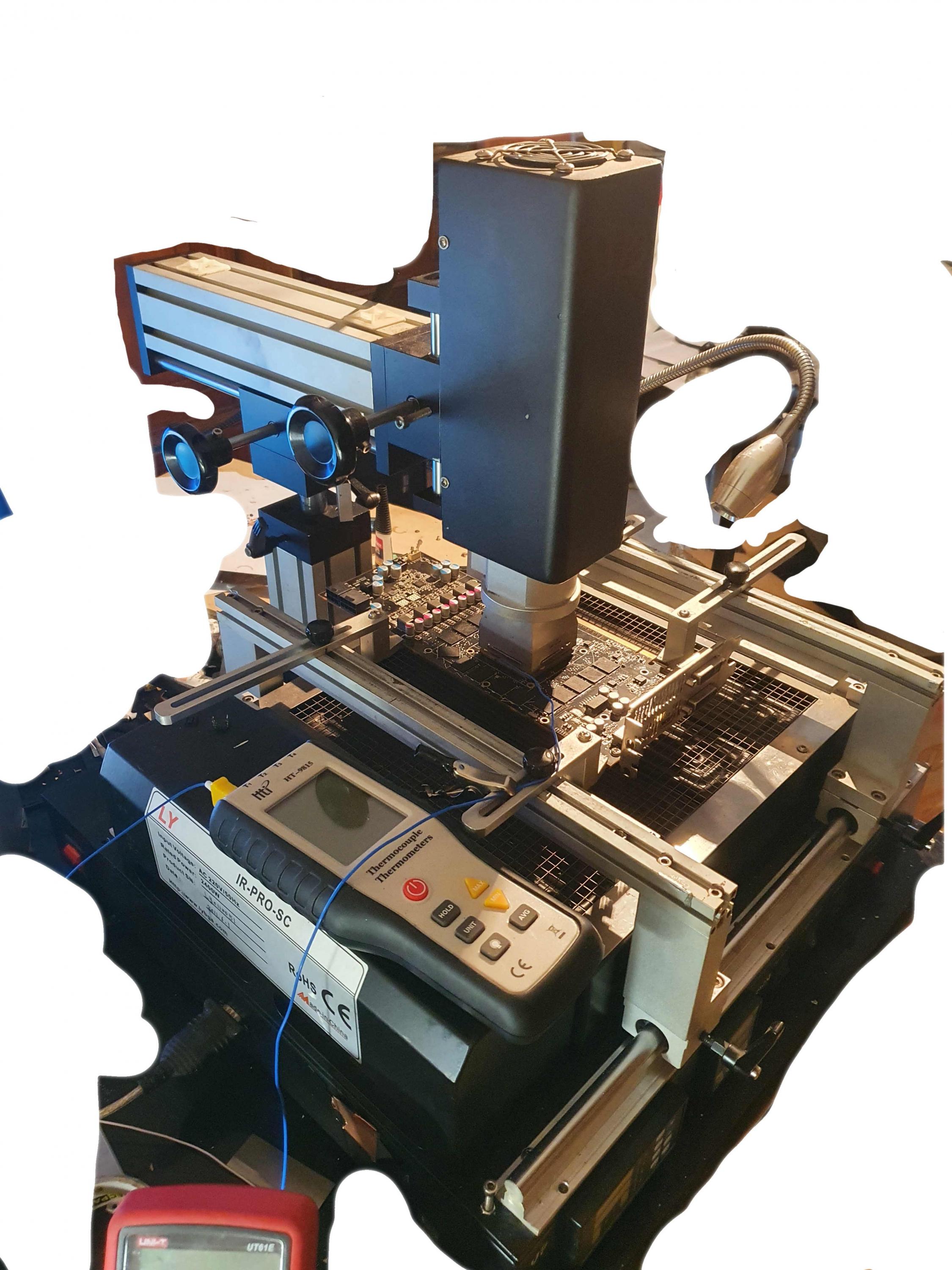

              I am trying to connect to ALTEC PC410 which is mounted on ACHI-IR-PRO-SC
              Anyone with suggestions? Also how to run line tests and read altec via other means. Their test software is all Chinese and hard to decode

                Re: New Software Achi LY by PSOFT
                Check the connection parameters inside the altec pc410, enter the same ones that the psof software requires.
                I have changed the top heater (from IR to air) with good result
                  Im trying the same mod. Did you wire up the top heater fan to be on all the time?
                  Also my input 2 on pc410 was closed, I have attached the air heaters thermocouple there. But I'm not sure if it gets detected or acknowledged. I saw here that I should use the bottom thermocouple in parallel to rex instead if I want to drive them from PC410, is that the way it is planned? It is very hard to make sense of its documentation.
                  Are you using the thermocouple within the air heater?
                    As you know, various types of heat transmission have been used over the years (air flow, air flow with inert gas, ceramic IR, quartz IR, focused IR, etc.) in order to improve the quality of the welding of BGA components (leed free and high density bga). Why do we want to modify it if we have a non-professional but still good quality welding machine?
                    Probably because we are not satisfied with the quality of the weld and we think that the fault lies in the type of technology used for the transmission of heat. This is partly true with some components (rectangular shaped mobile processors, large components, etc) but often the fault comes from the soldering profile, the flux used and the use of low quality thermocouples often placed incorrectly.
                    In my opinion the best technology ever is a focused IR but the cost is very high, over $ 30,000. Personally Iìm modifying the IR-pro to solder the rectangular CPUs and after various tests I can tell you that:
                    1 - Psof is partially used with the air top heater as the bottom heater (in the absence of an additional air nozzle) must have a static profile that is independent of any changes in the temperature of the top layer (see the profile I posted)
                    2 - The fan of the top heater is always on and has a constant speed
                    3 - The thermocouple of the top heater measures the temperature of the air flow which is not the same as the top layer and this is different from the temperature under the component. (in this case, tests must be made to establish a correspondence between the air temperature and that of the top layer, the problem is that in some cases the relationship is not linear).
                    4 - You can use a thermocouple close to the component for safety but the temperature is affected by the air flow coming out of the nozzle.
                    So in conclusion, in a situation where the machine is working as expected and the thermocouples are of good quality (omega thermocouples bought in the UK and not in China where many are fake) the component is placed correctly, getting a good profile is the most difficult of the welding process.

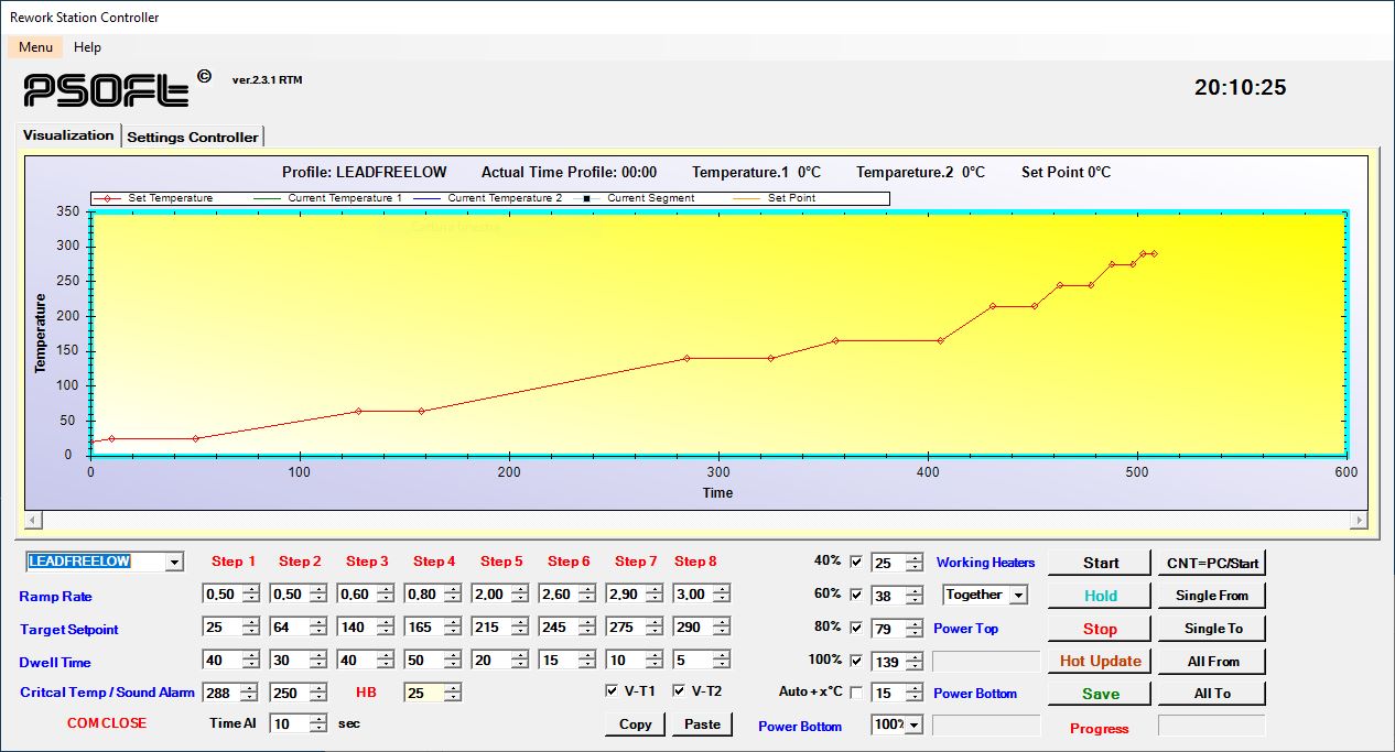

                      The Psof software was created to obtain that the real temperatures are as close as possible to the solder profile when using a machine with both top heaters with ceramic IR technology. In other cases it is not so necessary
                      This is a profile I use to solder medium bga as hm170, etc with an IR-pro modified.
                        Thank you for sharing your profile and insight on this. My reason for needing modification on this ACHI SC Pro is because I cannot reach a melting point on bigger iMac graphic cards. 400w top heater is a joke, especially when the environment temperature is below 25*C

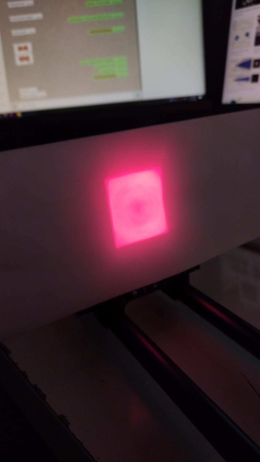

                              Ah... of course... "famous"... but I think that the only difference between the "famous" and this URL="https://i.ytimg.com/vi/OvdSOBwlZYg/maxresdefault.jpg"]https://i.ytimg.com/vi/OvdSOBwlZYg/maxresdefault.jpg[/URL]
                              is only... the price. The famous are only a high priced popcorn machine and second are a cheap Chinese barbeque but none are a real BGA Rework Station ! In rest, I'm sorry but both are same garbage. Both use in worst ever mode a 150W infrared reflector bulb.
                              The "famous" as you see in this image https://www.pdr-rework.com/sites/pdr...anced-pic2.jpg use a truly "focused" IR (when I say "focused" I say "gaussian beam"), gaussian beam https://upload.wikimedia.org/wikiped...ser_Pulsed.png , as you see from images, the maximum intensity are in the middle of the target (BGA chip) and minimum intensity are on the border, that "gaussian beam" or... "focused beam" result in soldering balls in middle of BGA and on border of BGA remain unsoldered balls or... if you want to solder the balls from border... well... result on excesiv / damaging energy in the middle of BGA. Most of the chip manufacturers recommend for middle to borders (corners) maximum 7 Celsius degrees non uniformity !
                              And for the... "famous"... I don't want to speak about how are the Fluke infrared sensors used (transformed to K-type compatible output) or... about infrared emissivity of an object (BGA) that is highly dependent with the color, material, texture and so on (here you have some materials emissivity values https://www.thermoworks.com/emissivity-table), and this... infrared emissivity can result in even 90% or more errors in temperature reading (90% at 200 celsius degrees are pretty much for my taste).
                              Last but not least... Please we do not can even speak about the energy (infrared) control for top and bottom heaters, did you see what curve / graphic can control ? I'm sorry but I don't see that manner to control a rework / reflow process in only one datasheet.
                              The "famous" remain for persons that not buy this popcorn machine... a dream (due to misunderstanding / undocumented and so on) and for that guys that buy it... only a source of problems that generate the famous words "BGA Rework process success rate"
                              By the way... did you see a round BGA chip ?! In 35 years of electronic service I don't see a round BGA chip, I see square / rectangle but round... NO.
                              In the attached image you have an example for a near to perfect, variable dimensions (from 10mm to 65mm) square shape IR NIR (Near InfraRed) spot (was an old experiment / test from... 2017 if I remember correctly).
                              Thank you very much for your clarification but... NO... the "famous dream" are not a BGA Rework Station !
                              Best regards, Dan
