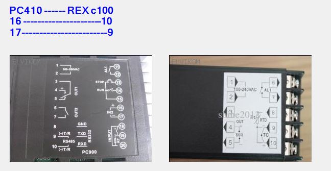

            Originally posted by jasko_jacker View Post
            Usually in many bga rework machine (chinese brand) the top heater is
            drived by altec p410 and bottom heater by rex-c100 (on the internet many altec or rex are clones) but
            while the upper heater is operated by the altec that follows the set profiles, the temperature of the lower heater gradually changes from min to max, regardless of the temperature on the motherboard.
            Instead, this software drive the bottom heater to generate a temperature on the bottom layer of motherboard proportionally to a temperature on top layer.
            The circuits of the controllers are separated, each one has a digital relay and an input for the thermocouple, but only the altec has a rs232 port and therefore a software can only drive the top heater.
            With an easy modification you can solve this problem and use the psoft program. To avoid errors in temperature it is important that the two temocouples are positioned on the same point, or very close; one on top and the other on the bottom layer
            Hi! I want to know which modifications are needed. I have an achi ir pro sc v3
                  See the pic, on pin 9 and 10 ( not remove the thermocouple cables), connect these outputs to pins 16-17 of the altec
                  from rex disconect negative on ssr out (pin 5) and connect to pin 7 (out 2) on altec, connect pin 6 from altec (out 2) to negative pin on ssr

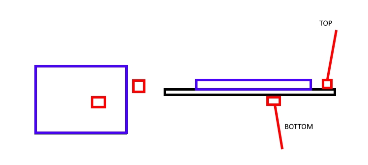

                                        Originally posted by RavoLx View Post
                                        i have change the data bit to 7 and it work, just a quick question it normal that the Com Open keep flashing
                                        Yes it's correct,
                                        to avoid motherboard damage, place bottom thermocouple and top thermocouple not at opposite side respect bga chip.
                                        Set Rex at 190-195 C° if you see that the bottom temp is to hight
                                        change (auto+x = 5) and check rex settings.
                                        Test thermocople with ice (fused ice) to check 0° C and with a sn/pb alloy to check 180° C
