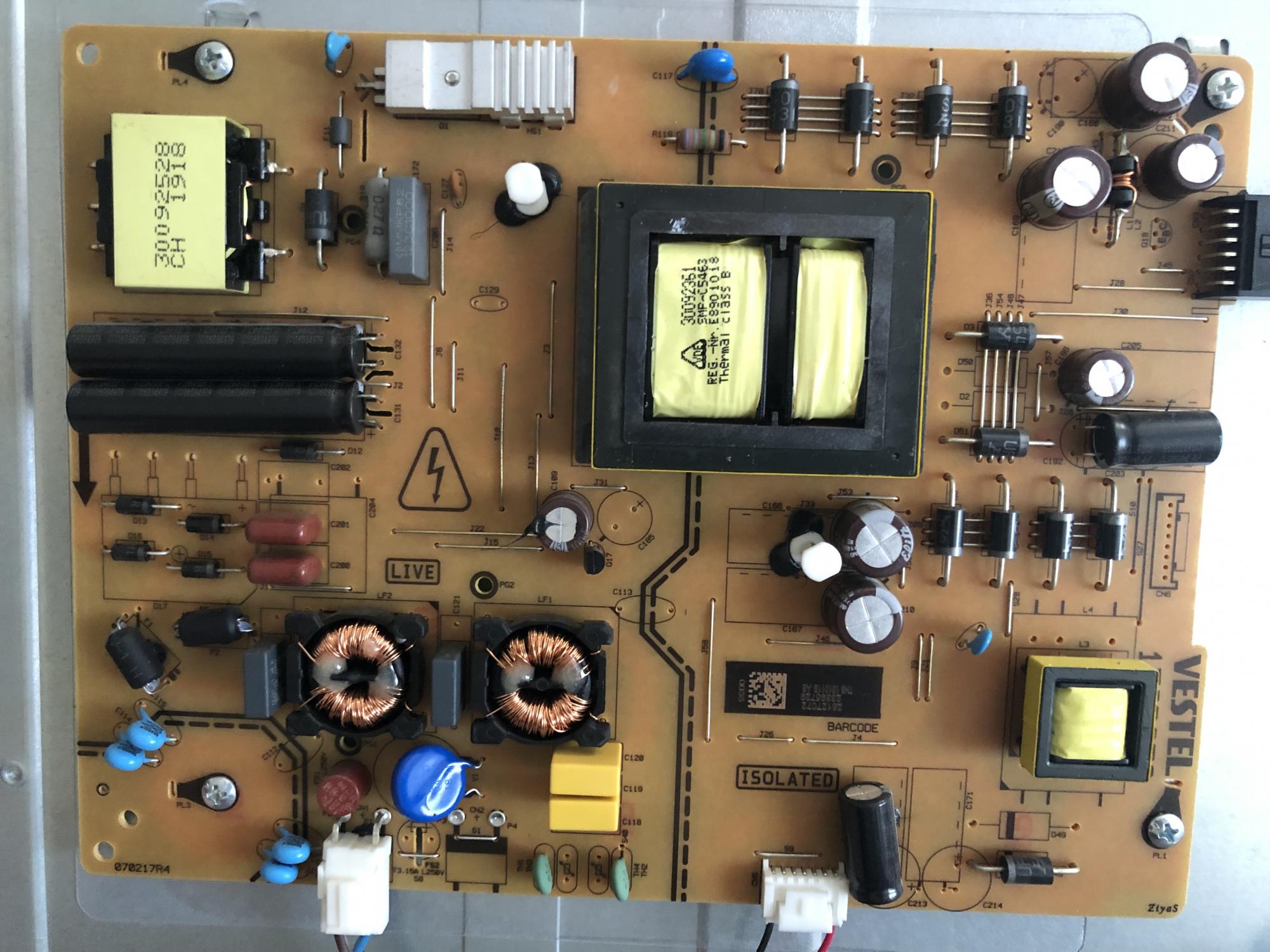

    All voltages seem to be present (LED 80v, 25v , 12v and 3.3v locally regulated on the main board. Tried disconnecting the T-Con, no change, tried disconnecting the LED strips from PSU - no change.

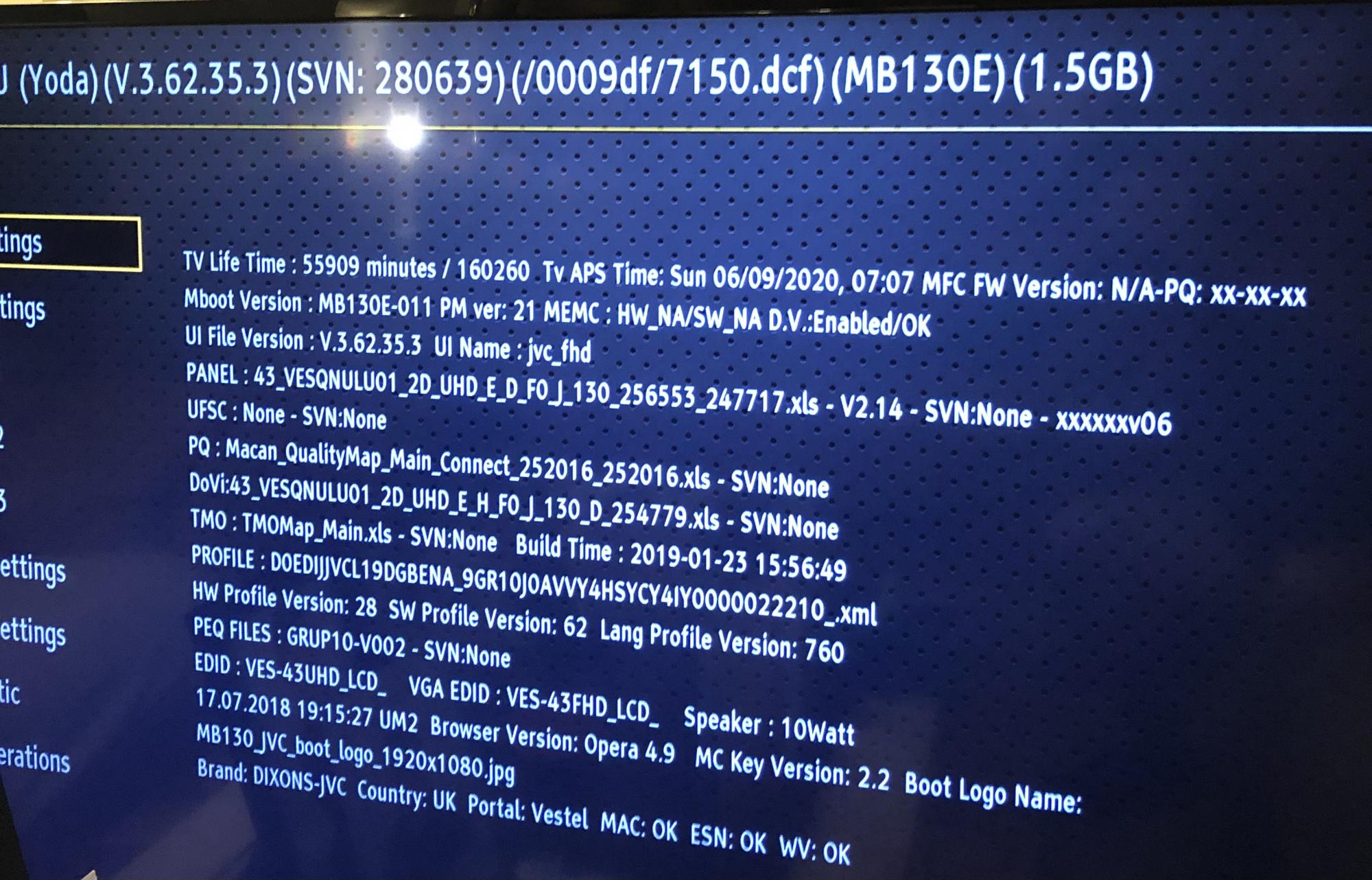

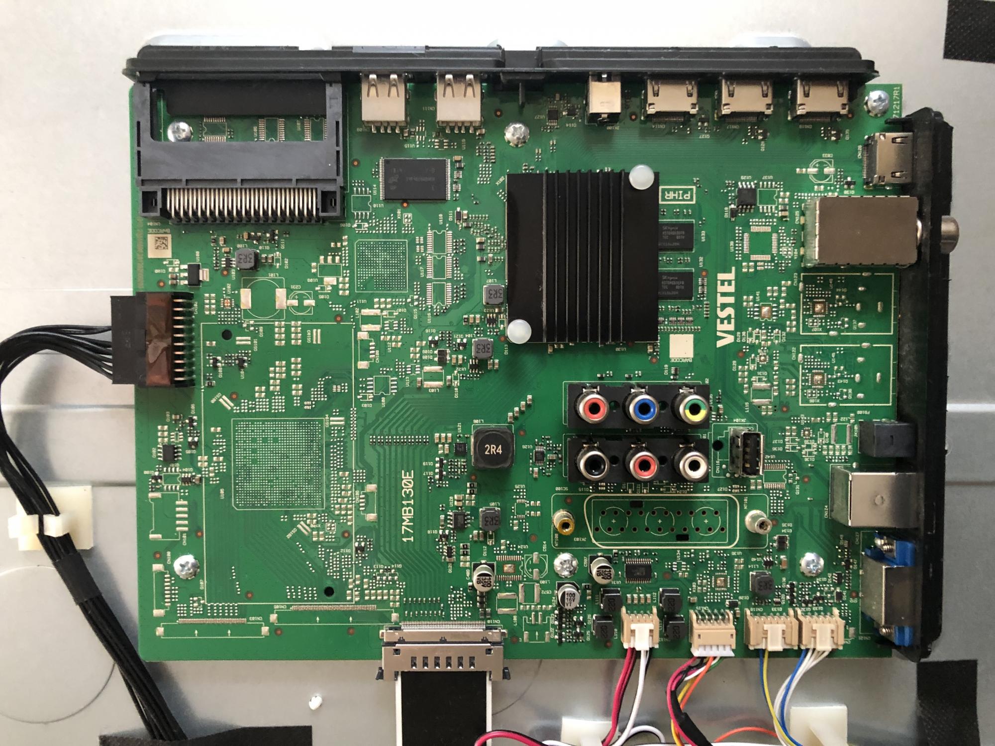

    So, I acquired a main board 17MB130E from a JVC LT-43C888 which is also a 4K panel but a different type of course.
    I wanted to see if the panel was working and backlights were OK
    To my surprise , the TV boots and is functioning as expected with a digital signal, but doesn't find any terrestrial HD channels.
    Netflix will load to the Home Screen but upon playing a program it gives error tvq-pb-101(8.1), which is something to do with data on the streaming device. I had signed out of the previous account without trying it and am using my own account.
    ITV X doesn't work but YouTube does.
    Looking in the service menu, it shows that the mainboard thinks it is addressing a 43” panel aa you would expect.
    So the conclusion is that the original main board probably does have corrupt software.
    The question is can anyone on here help me find the right version for this TV?

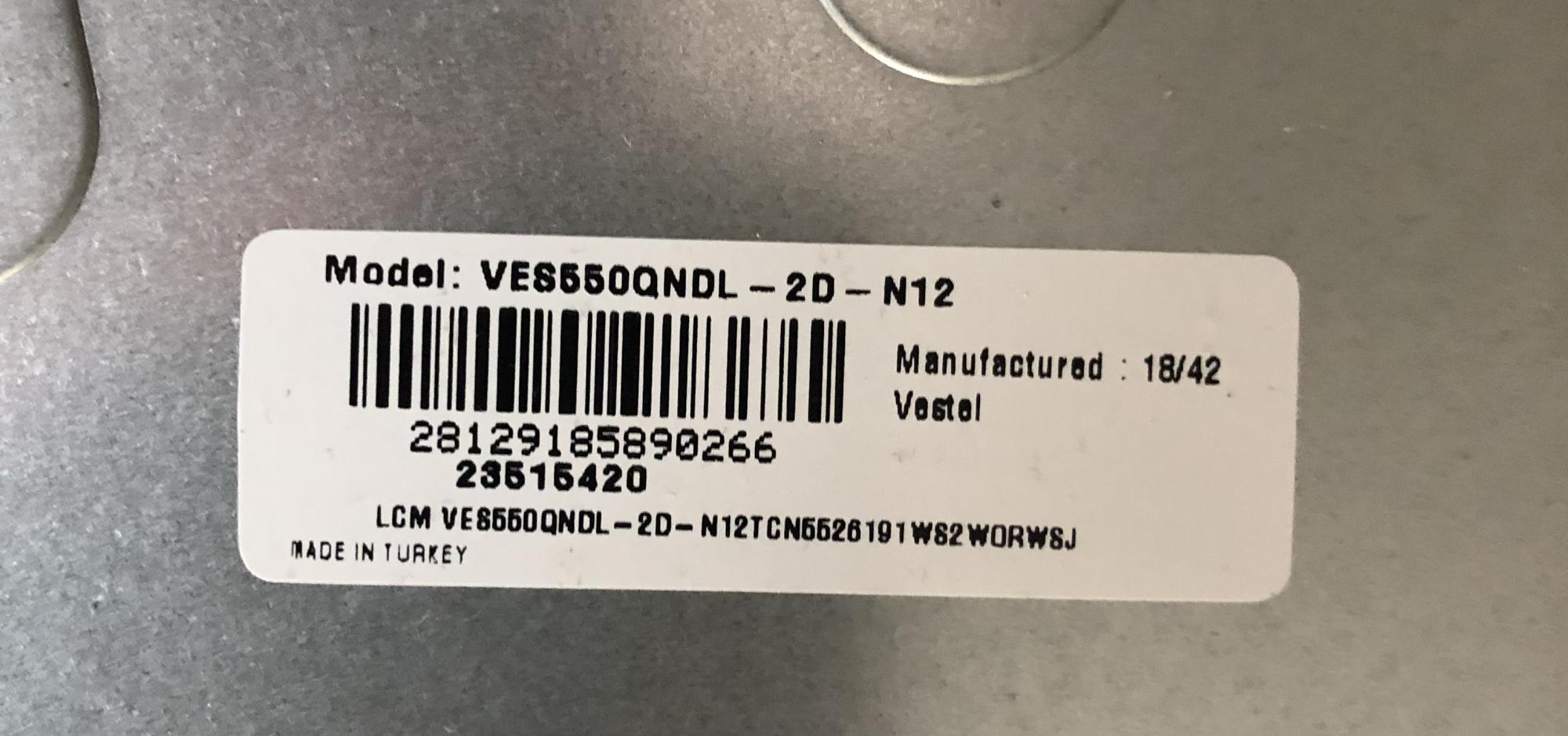

            Rear sticker attached
