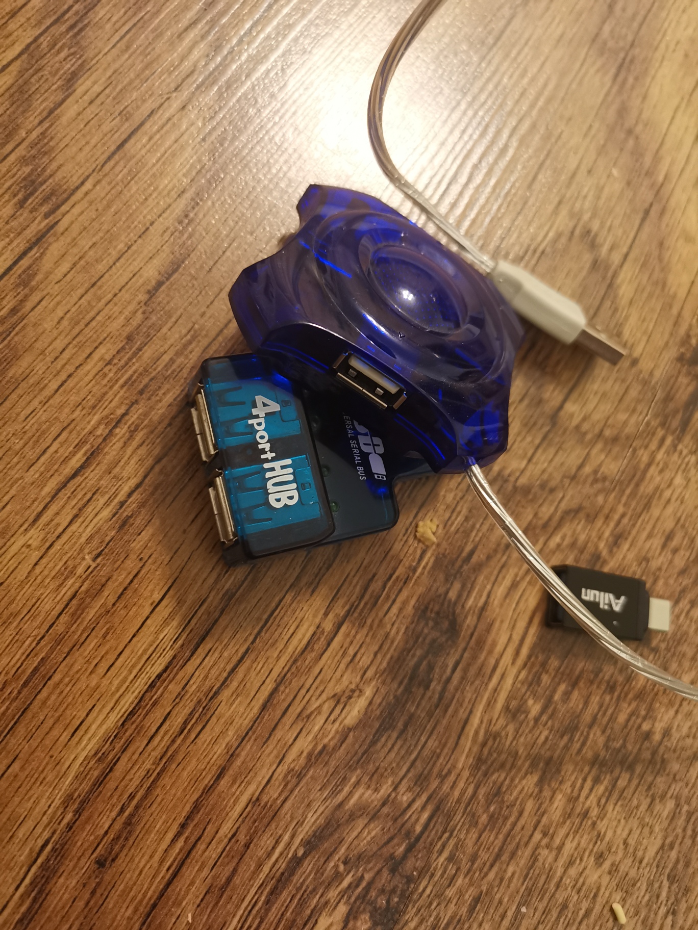

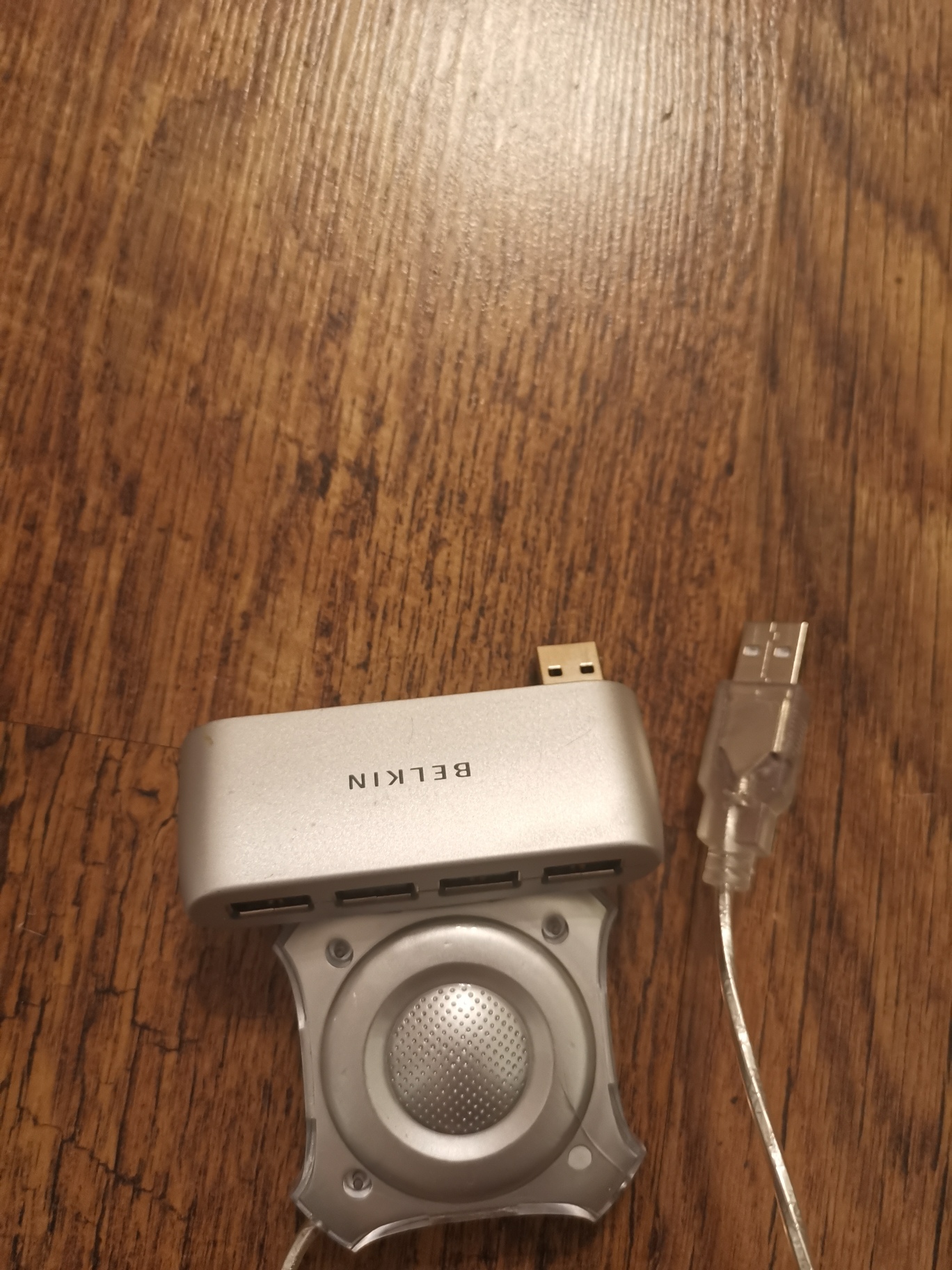

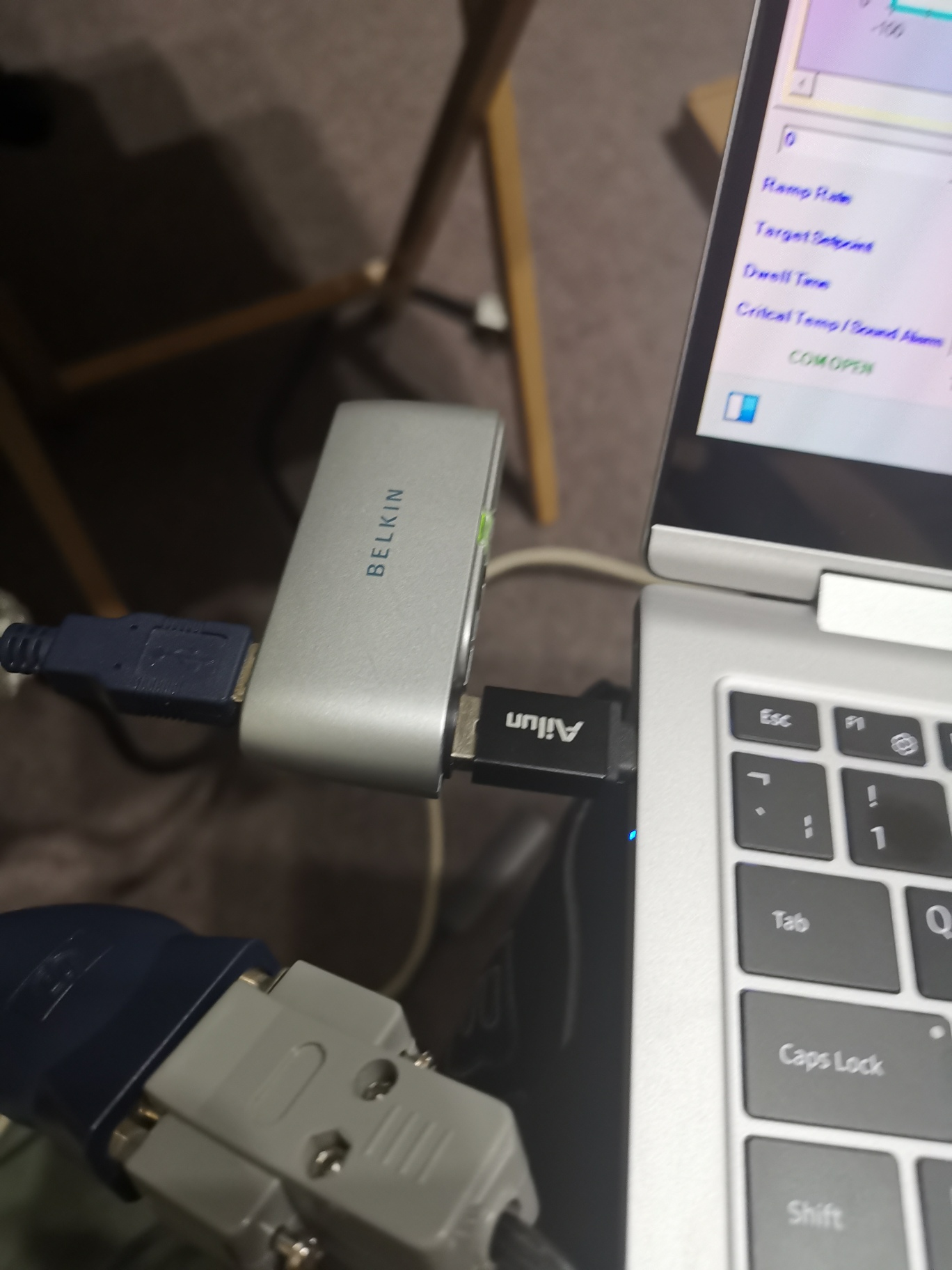

          [QUOTE=ck84;984629]Hello
          I've been trying to get this software running for days, unfortunately without success
          have already tried 2 different rs232-usb adapters (chipset CH340 and pl 2303) unfortunately still without success
          I myself use windows 10 64bit on usb 2.0 and 3.0 tried all the settings also changed the computer afterwards, unfortunately, it was restarted without success.
          I would be very happy to receive help / information
          For those who have been having difficulties to get their Achi ir pro sc to connect with a laptop or pc via the psoft software. It may work for you too but you can only try to know if it will work. Please note I am not a pro and there is no logical process in this. I have seen others reported here no connect after I came her myself for solution. After trying for days to connect this to my laptops via the laptops usb 2 or usb 3 ports on two laptops, it refused to connect. I tried all sorts of drivers and change settings to no avail. When it failed to connect, I bought several usb to rs232 serial converters and they all failed although they were all recognised as com port.* I bought the Digitus USB 2.0 to serial convertor FTDI chipset, Ugreen usb* to rs232 serial cable with PL2303 chipset, Dtech 3 pin to usb to TTL serial and finally usb to rs232 XTVTXb pl2303HX to TTL. None of them worked when plugged in directly in the laptops usb ports of my Samsung galaxy book2 pro 360 win 11 and in my good old reliable Sony sve1713z1eb win 10. However, connecting to my very old pc in win 7 directly in rs232 port, it connected and worked but glitchy in win 7 and did not work on another PC with win xp. Even in the pc with win 7 it did not connect via the pc usb port via the cable usb to rs232 serial adapter.
          *After giving up on the the 2 laptops, and after days have passed I was reaching for something on a shelf an old usbV1 hub fell in front of me and I picked it up and I said let me try to connect that to my laptop and to the achi pro* sc V1 and to my astonishment it worked on both latops.** I was very happy and started to ponder why is it working via the usb hubs but not directly via the latops usb ports and in my view very strange. I thought may be it is to do with drivers of the PC410 or win drivers. I cannot explain and I do not know the answer. I eventually found out that it does work also via usbv2 hub too.
          The way I connect via the laptops, I ensure port settings in device manager matches the port settings in psoft menu then first tab, configure com port. I connect cables to Achi pro first and then connect cable to laptop using an ordinary usb to rs232* serail converter to the sub v1 hub, start laptop wait for it to boot to windows, I then switch on achi pro and then open psoft and voila it works. When it connects the com port in psoft flashes green and on pc410 com flashes red. It can be temperamental too and If it does not work repeat the process switch off Achi and close psoft and start again and try in another port.
          I would also check inside the Achi which wire is ground, rx and tx to Din rs232 port (mine) or usb port may be in Achi v2, v3 and v4. Mine was different to the schematics which I found on a utoob video. There is no logic in this, I am merely sharing my experience.

            Here are the pics.

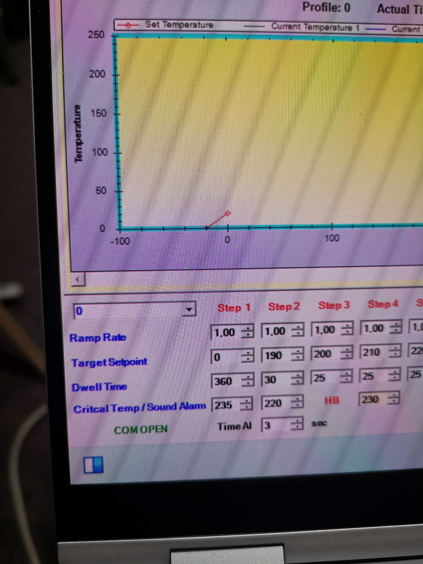

                  Information on forums seems to indicate the IR6500 is not cut out to do Ps3 because the bottom heater is not powerful enough. Most of them seem to recommend minimum 2000W heater at the bottom and the upper minimum 400W. I have a jovy-7500 it really struggled with old backwards Compatible PS3. On the other hand others reported success with it on forums. This is why I bought the Achi ir pro sc, which is in my view better than the Jovy-7500 in terms of doing big boards.
                  What I am about to describe re BGA rework machine is well documented and known cliché. The problem with BGA rework stations, seem always dependant on the environments and many variables involved. You have to know, adapt and take measures to tackle the variables.
                  If I may with this analogy. I have a bread toaster, which I toast 2 slices of bread every morning, on the same settings set at number 3 but I do not get the same result daily as there is always a little to significant variation. Some days browner than others, on other days too brown or burnt in corners. The environment and ambient temperature at the time of toasting play a big part in the result. The variables are, the moisture in the bread and atmosphere of the room, the thickness of the slice, type of bread, the way the bread was stored, the age of the bread, fresh or getting near to stale. Your handling of the slices may introduce fat and moisture from your hands. The quality of the toasters, technology, design and wattage are indicative too. All these put together will have an effect and can affect the results.
                  In BGA rework the effect and affect would be the same too. You would have to know your machine and consider all variables to get results on a consistent basis. It is accumulated experience in using the old Achi ir pro time which with time I have improved my technique. I have had good results and failures too. Practice and practice is the key word.
                  From the beginning I have followed and made adjustment from the examples given in the the Achi IR pro Sc manual re leaded and unleaded solder used on board and manual is on line to download. Please search for it on google. The 2cm recommended for the upper heater will depend on how quick the chip gets hot and the temperature. Sometimes you have to raise to prevent pop corning or chip damage. The rate per second the temperature is rising, ramp rate and the dwelling time is very important too. There is a lot of information on this out there and I am not an expert.
                  I found quite a decent Ps3 profile for my machine on psx place forum by a member goes by the name of Shawn Shakir and helped by Victor Muir . Please note I have had to adjust it to the environment and setup I am working in when using his profile. Others Profiles are helpful but you need to tinker with them for your needs.
                  The profile is public and use at your own risk.
                  Bottom heater:
                  Set at 280c and keep it at that until top temp reaches 160c, then lower to 270c at 180c, 260c at 190c, 250c at 200c, 240c at 210c, usually just leave it there.
                  Top heater:
                  R1: step
                  L1 0 d1 360 r2 1.00
                  L2 190 d2 30 r3 1.00
                  L3 200 d3 25 r4 1.00
                  L4 210 d4 25 r5 1.00
                  L5 220 d5 25 r6 1.00
                  L6 230 d6 25 r7 end
                  hb 230.

                          Finaly made it to work OK ...
                          The R1 - ramp 1 should not be 0.00 then the error appears ...
                          Put it to 0.5, then should all be OK

                              Yes but the "original" software don't turn the controler on if the value is 0.00 ...
                              It recognizes it like STEP to alow the bottom heater to preheat the MBO ...
