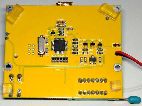

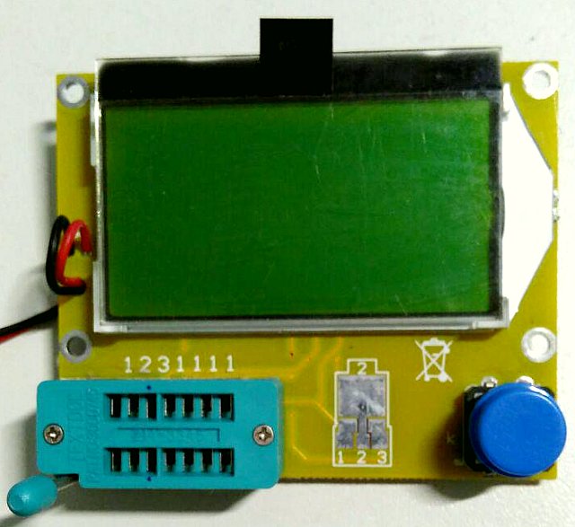

                                          i'm not sure why 3 people downloaded the T4 code without posting answers to my questions afterwards - that code is not tuned or complete!
                                          I'm very keen to upgrade to your T4 code and provide answer. Can it work on my "LCR-T4 Graphical Multi-Function Tester"?
                                          It display "MTester" only, no version number, no branding, no words, letters or numbers to ID it... like a nameless clone of a clone.
                                          I also ordered a 40cents rotary encoder:
                                          http://www.aliexpress.com/item/1pcs-...655246773.html
