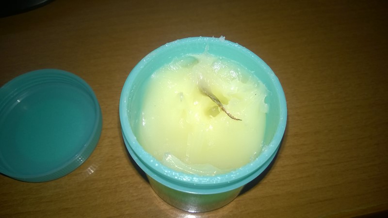

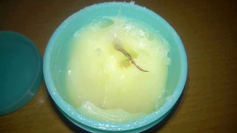

              Originally posted by Dimitrios
              Last year I bought one KINGBO but instead of being the nice soft whitish cream, I 've received a hard yellow compound which at the end gets the job done but doesn't like its texture. Maybe its been on the shelf for too long and then they sent it to me? who knows..
              Yes flux and solder paste should be stored in a less humid area
                  http://imageshack.com/a/img42/9909/qhx2.jpg
                  Yep, that's just old/stale Kingbo flux there.
                  I can confirm that because mine was white and soft too when I got it 2 years ago. It's been sitting on a bookshelf in my room, though, where the temperature in the room often drift as high as 86F (30C) in the summer (and no less than 70F or 21C in the winter). And now it looks even worse than yours. But surprisingly, it still works great. Just tends to "smoke" a little more when burned/heated. No nasty residue left afterwards, though.
                  So Kingbo really is decent stuff.

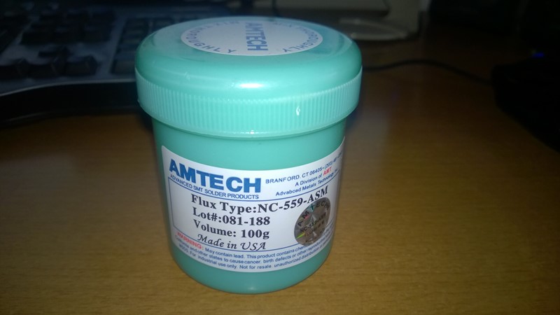

                              it is very hard to buy a genuine branded flux from internet. there is also big difference in price. someone will sell a fake at expensive price, so only good sellers will save you from fake.
                              personally i got a amtech 559 from china (seller goldpart) and it is for sure fake. ok for 10€ what would i expect, but the bad thing is that it make lots of smoke, and become black and glued like, very hard to clean.
                              now i use a mouser flux and is very ok. also i have a original amtech and is ok too, and a fake amtech rma that do it's job fine.
                              for example
                              http://www.ebay.it/itm/1pcs-100g-KIN...item3380ef35f9
                              or
                              http://www.ebay.it/itm/100g-KINGBO-R...item2a1ee018c6
                              both say it's original; so a good kinbo is 7€ ship included?
                              from goldpart i got this:
                              http://www.ebay.it/itm/100g-AMTECH-N...item2c66cd5fdf
                              and here it is some picture i made.
                              PS: i see a video of a dude using kingbo and it was quite similar to white (transparency)
