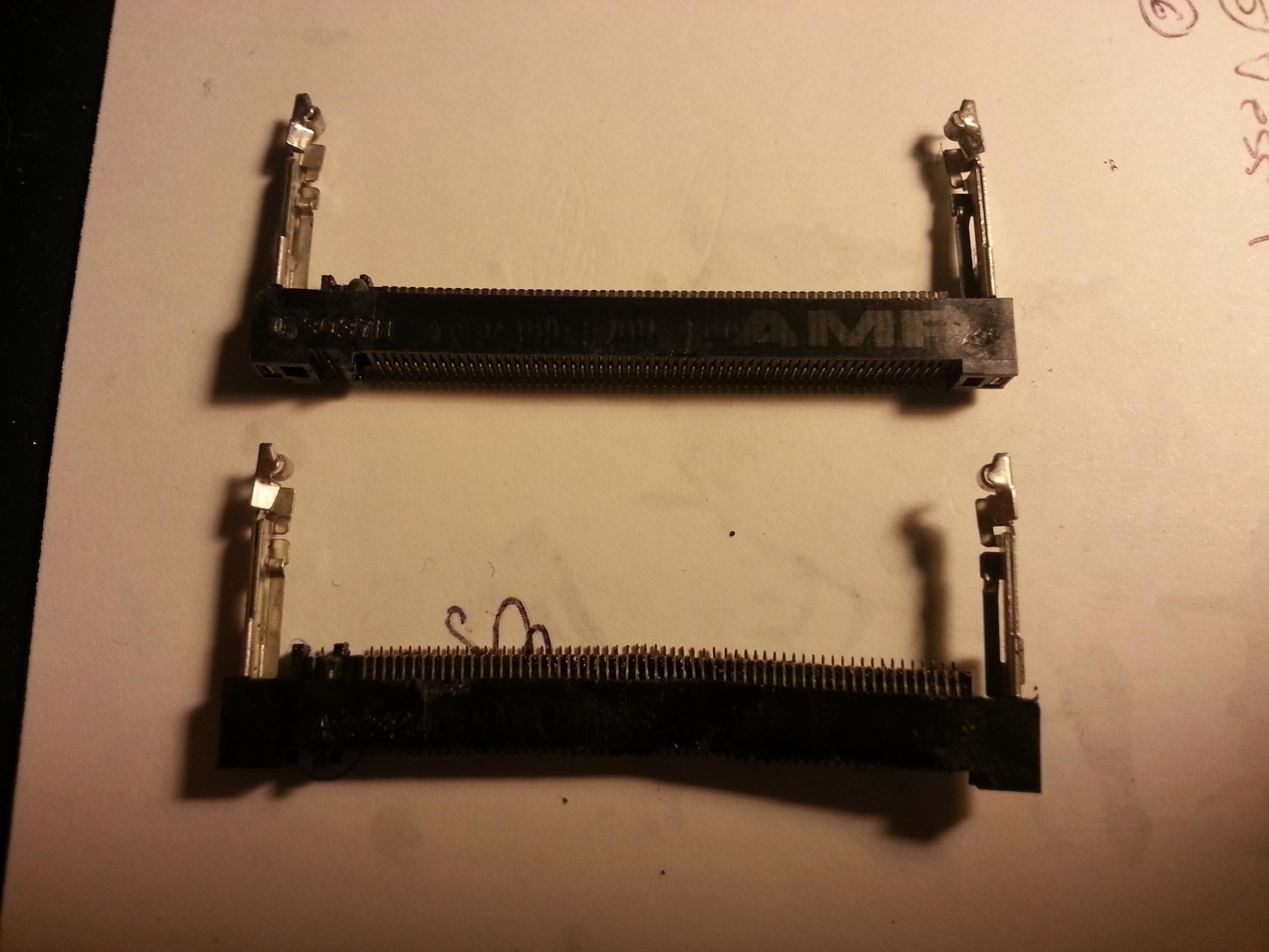

              Here's what I'm using it for today:
              Ill let you guess which was first and second attempt.
              And here is where it is going:
              Speaking of cost cutting, this was a pretty expensive board when i bought it 4-5 years ago. How much could a minipci connector cost, 50 cents?

                A big connector like that in medium quantity could easily eat up $10 to $15 of the BOM.
                I recall talking to an automotive systems engineer who told me one of the largest costs in a car, after the frame, is the wiring bundles and connector assemblies - automotive rated connectors are not cheap and a lot of R&D money is spent on reducing the wiring size/length and number of connectors.

                  Wow, I figured it was saving around 2$ max including assembly.
                  10-15 is more reasonable to lose the part.
                  Auto connectors are the bane of my existence. Who knew they paid so much for them.
