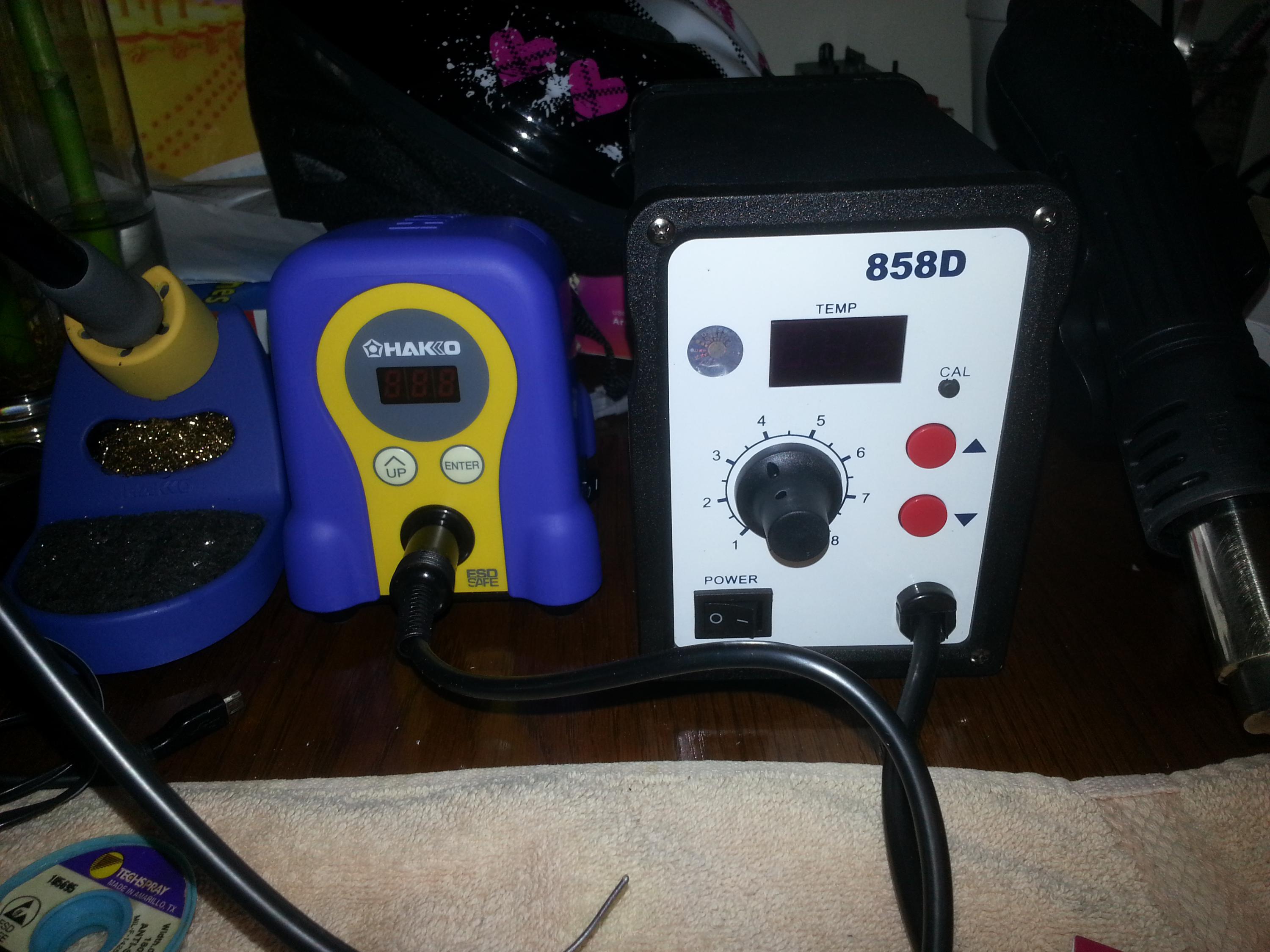

    Surprisingly, the case is metal. It towers over my hakko 888d, shaming the hakko's plastic shell. Controls are easy, up and down for temp and a dial for air speed. The handpiece looks heavy, but it doesnt feel that way. The handle is well balanced and the sound is not loud. The air warms up quickly, usually by the time it takes me to get into position. The first time you use it, it will smoke lightly, probably burning off oil from the construction of the unit. Point it away from the work until it stops. Auto shutoff of the heat when placed in the holder is a nice feature, one i didnt expect at this price point. Fan still runs until the unit cools off.

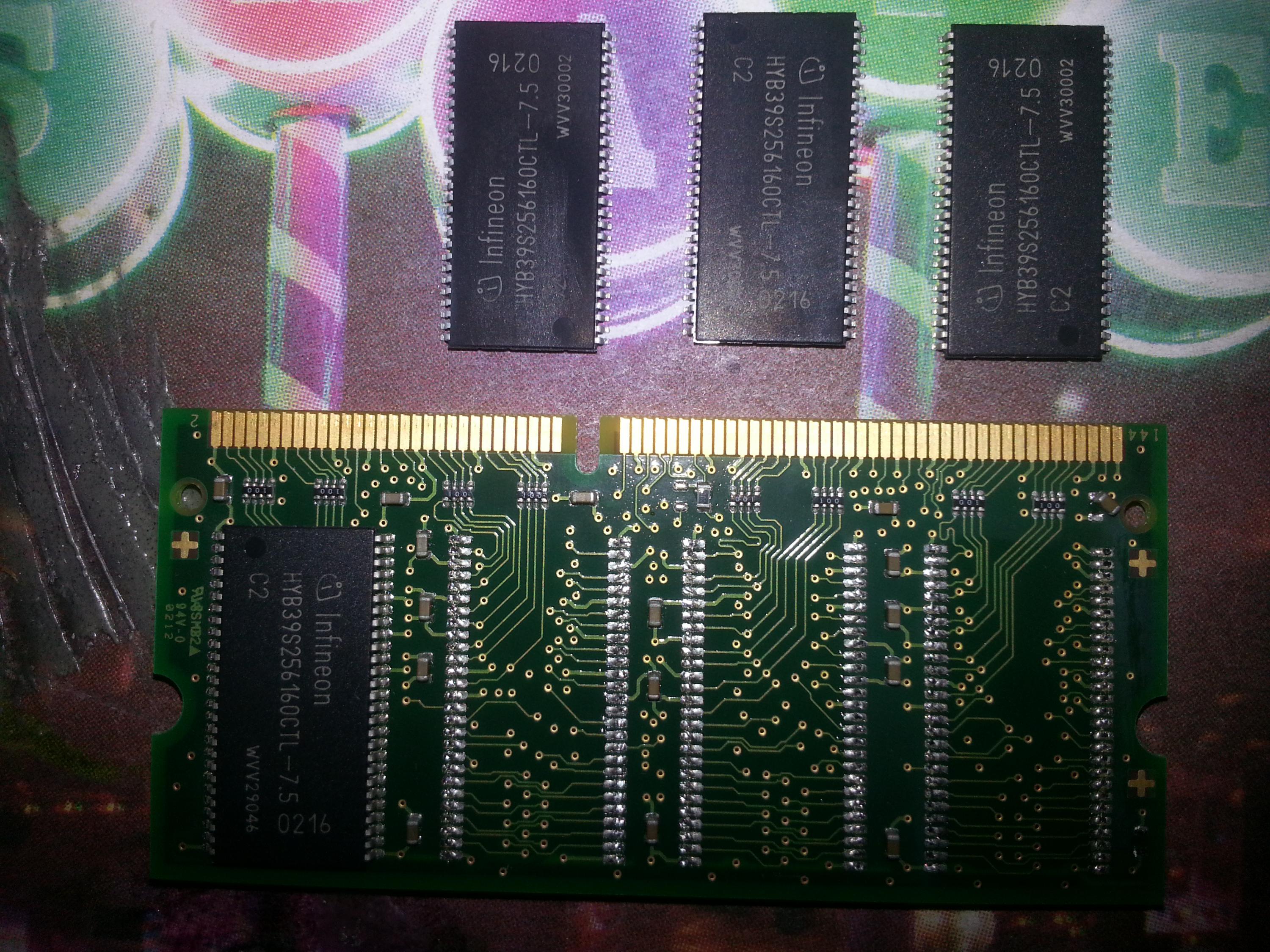

    Using it is amazingly simple. I pulled some pc133 ram chips off a laptop dimm (destined for a linksys router upgrade). It was nearly effortless. I was amazed because I remember the mess a had made in the past with a cheap iron and some chip-quik.

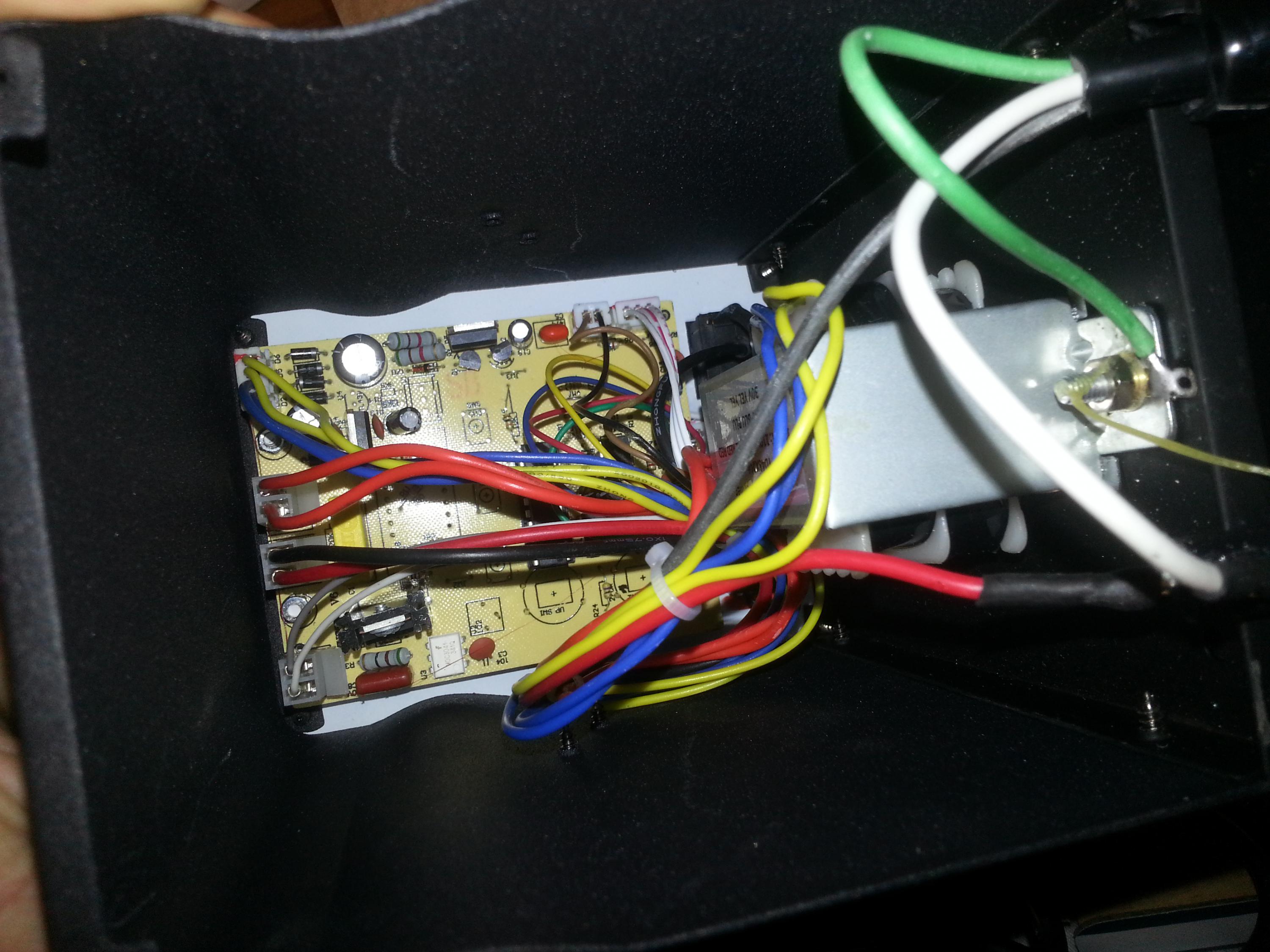

    As far as durability goes, it looks like a simple unit. The trasformer seems small, but there's lots of room in the box to upgrade if required. The only thing that looks like it may be a problem to repair is the handle, and I think replacements are available for those.

    Picture inside from back.
    858d next to hakko 888.
    3 chips desoldered. I may have scorched the first one I tried. Its remarkable how they came off so clean.

        Btw, one thing that surprised me was that the fuse was on the neutral line. Arent fuses supposed to go on the hot leg?
          Since when AC plugs have polarity restrictions?
            Re: prefered solder paste and 858D review
            The fuse should not be on the Neutral side.
                You do not know about AC plug, why don't you do some research before posting stupid answer since you are professional.
                The US per UL does not require fuse on both Hot and Neutral (Neut is tied to ground in the panel. Double insulated units can have no polar two-pin plug without ground prong. The Euro requires to have have DPST power switch (our products are sold Euro with TUV/ETL testing) and fuse since Schuko plug without ground pin can be plug in in either direction. UK plug has fuse in the plug itself.

                                        Yeah, there really isn't much in the handpiece (aka the hot air wand). Just a single fan, metal tube to hold the heater, and the nichrome wire heater itself. That said, there is also a small board in the wand - but dare not look at the soldering and wires - they are horribly undersized! I'm not sure if all of these hot air wands with the fan built-in are like that, but I've opened two of these so far and they both had wires that were way too tiny for the rated output wattage of the station. IIRC, they were 22 AWG 300V rated for the mains and 24 or 26 AWG for the fan.
                                        The older units like the Kada 852D+ which have an air pump in the station itself are much better built IMO. They used 20 AWG wiring IIRC - still too thin IMO, but definitely better 22 AWG.
                                        It actually costs almost nothing to implement. There's just a simple magnetic switch in the hot air wand and a magnet in the holder. When you put it in the holder, the switch closes and tells the station to put the hot air wand in sleep after it cools off.
                                        You won't really need it, though. The transformer is only used for powering the controls. Usually 9 to 10V, 0.3A if even that. This voltage is then usually brought down to 5V with a 7805 for the MCU. The handle is powered from the mains and controlled through a triac.
