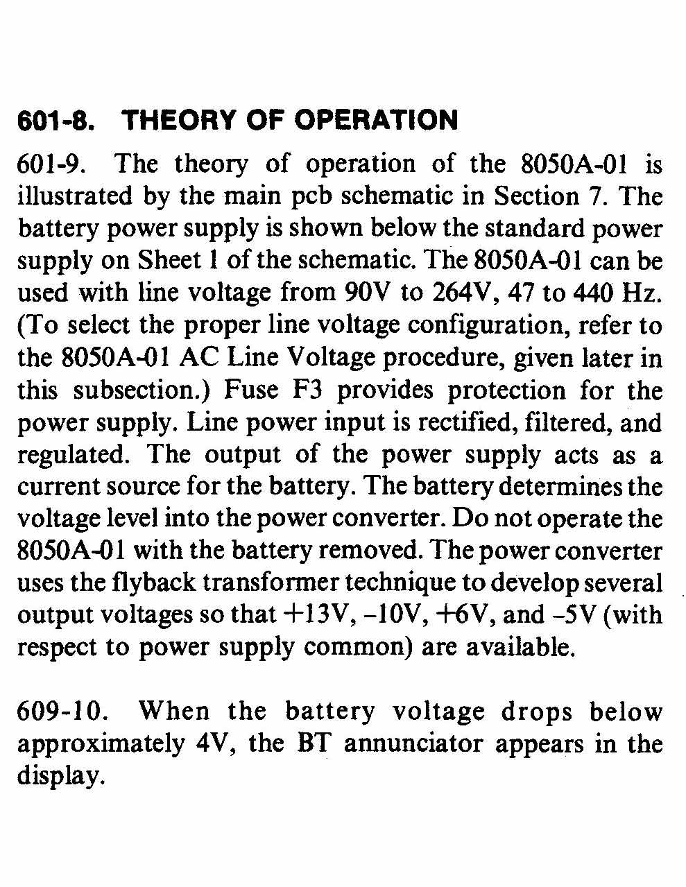

          I have some updates to share.
          I got some fresh 2500mA NiCD for my cordless power drill, and the old ones found a good home in my 8012A (NiCD qty 2), and the 8050A (NiCD qty 4).
          What I do see as a problem is that fact that R26 (9.1 Ohm) stays very hot all the time at 74C = cooking up.
          The R25 (12 Ohm) run a bit cooler at 43C, room temperature 22C .
          The constant current PSU causes a constant flow of 300mA 24/24.
          In the old days FLUKE could be happy with this design, but today I am not with it.
          Other than the constant flow of 300mA the NiCD are all the time warm too.
          The only option that I can think of is to add a second power switch so to turn off Mains completely.

              If the constant current source is which is set at 1.25Vref/9.1 oHms = 137mA, that means the 9.1 Ohms resistor will dissipate 137mA x 1.25V = 0.17 Watts. What it means is that the LM317 is not working, instead of regulating the current, that is why you are getting 300mA flowing through the resistor instead. The LM317 has 1.25V ref voltage built in. Right now the resistor is trying to dissipate about 0.8 Watts of power (300mA is flowing through 9.1 Ohms, some may still flowing through the LM317).
              the whole purpose of the constant current source is to limit the current flow to the set point as determined by the resistor, the current will force though the load up to the point where the Vload cannot be higher than the LM317 Vdiff.
              So if the Vin is 15V and the Current is set at 100mA, if you short out the load, the max current will still be 100mA, the resistor (12.5 Ohms) will dissipate 0.125W (1.25V x 0.1A), the LM317 will dissipate 1.375W ((15V-1.25) x .1)
              By the way, when power switch is activates, the resistors are put in parallel to provide BOTH the charging current and the operating current for running the meter. See post 24.
              And of course the R25 (12 Ohms) will be cooler since less current is flowing through due to higher resistance than the 9.1 Ohm resistor, those two resistor are in parallel when power switch is activated.

                    Unbelievable ... the LM which the meter was have on it, found to have one lead broken.
                    But now those resistors does not get hot any more and the charging current is at 100mA and 140mA with the switch off, but the LM317 runs hot 45C
                    The old one was LM317MP (attachment) and the New one LM317P+.

                                  I did play my last card on this game and soldered the old back.
                                  Volts 2.65V / 3.9V / 10.13 temp 51C it runs far cooler than with the other one.
                                  I am going to measure charging mA and be back.
                                  98 / 136mA
                                  It looks that today 9 June, this meter restored back 100% after all this research, thanks budm !! .

                                    Base on you voltage reading, the Vin-Vout = 9.1 - 3.8 = 5.3V (Notes: right now your batteries voltage do not reach the full charge yet since you are only seeing 3.8V), so the power dissipation is about 5.3 x 0.14 = 0.74 Watt which is not too bad, it should get cooler as the batteries are at full charge, but when the power switch is on, then it will draw more current and heat up more.
                                    It looks like the metal tab dissipates better heat than the plastic tab. I think you will be OK with the old one, it did not get damaged, just a broken pin.
                                    At 50~60c. I do not believe the Jct of the LM will be @150c.

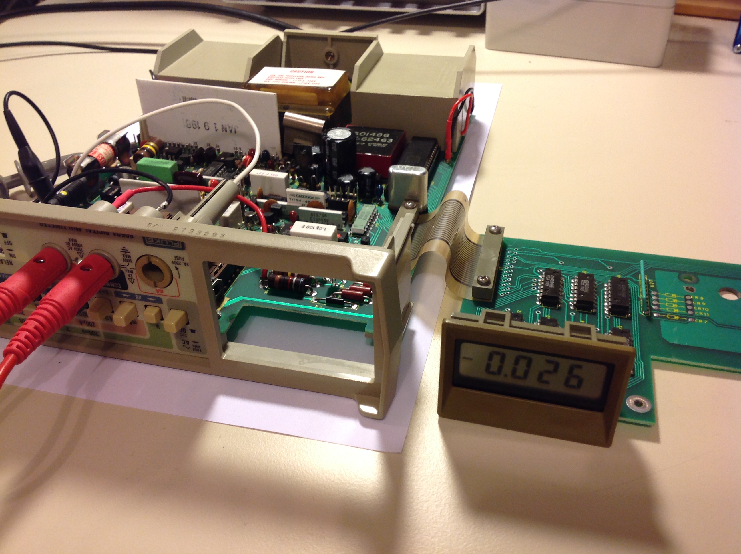

                                          Hello all,
                                          I found this thread (and site) because a search led me here. The problem here is not exactly what I have but kinda close. Maybe someone can help lead me to a solution. Thanks!
                                          I also have a Fluke 8050A-01 and it works fine except that the 20V and higher ranges have a negative voltage offset. I got this off eBay and expected to have to put new batteries in. I swapped out the dead Panasonic NiCDs (already a replacement) and used NiMH units. (I know that constant trickle charging can kill NiMH so I simply won't do that.) I let the batteries charge and was pleasantly surprised by a working meter with a nice contrasty display. But...
                                          The 200mV and 2V ranges are fine (and so then the ohm and current ranges). But the 20V range sits at about -30mV (30 counts) with shorted input. And it can vary, sometimes as low as -10mV and sometimes much higher, even -100mV! The 200V range tracks with a 3 count offset and so on. Again, the 200mV and 2V ranges are fine and give correct values for test voltages, +, -, AC. So, I assume the A/D is OK.
                                          I've probed all around and cannot figure out where the voltage is coming from. The voltage is zero right up to the A/D (R8).
                                          A bit more info in case it helps. The +13V rail is rather low at about 9.8V. Other voltages are in line. I have replaced all of the power supply caps (Frolyt ERF series) but the voltages and symptoms are unchanged.
                                          If anyone has any ideas, I would really appreciate it. Thanks to all in advance.
