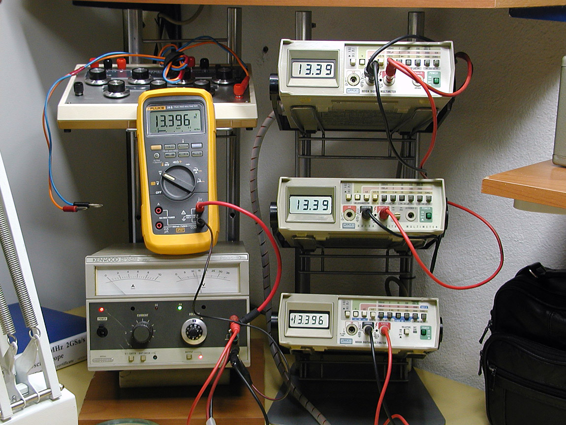

    Recently I did a repair on my FLUKE 8050A bench top DMM.
    I have all the available documentation and I did an complete calibration & adjustments.
    Funny enough there is no info about zeroing out the display at DCV.
    I get 2-3 additional counts at the last digit depending the range.
    I can use REL if I need the most of it accuracy, but I was hopping for a repair tip, as it looks that this adjustment is totally undocumented.

    If you short the input and it reads zero within about 1 count, I wouldn't worry about it. I also would not use the Rel function to attempt to null a residual reading, because there is no guarantee that any small offset is constant once a low-impedance voltage source has been applied to the inputs.
    There is no zeroing adjustment that I know of in an 8050A. The A/D converter includes an auto-zeroing phase that stores any non-zero error offsets in the system on tantalum capacitors C8 and C33, and subtracts them from the reading during the de-integration phase. You can check those caps to be thorough.

      Thanks for the tip modemhead.
      Crossing the leads it does has an effect and I recorded the details.
      200mV = -00.01
      2V = + .0000
      20V = - 0.001
      200V = + 00.00
      1000V = + 000.0
      Now it looks that the differences are not significant to be called as damage,
      but the 20V range definably differentiates it behavior in contrast with the other ranges.

        I have several 8050As, and that looks perfectly normal to me. The one I use on a regular basis stays powered up 24/7, usually on the 20V range, and it bobbles constantly between 0.000 and 0.001, even with the input shorted. I have found it to be very trustworthy in terms of accuracy.

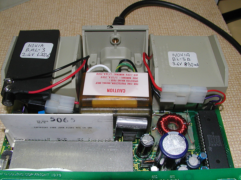

            From your pictures, it appears that you do have the battery-powered version (option 01), except that the batteries have been removed. The small toroidal transformer, and also R26, do not exist in the AC-only model.
            It is not good to run this meter without the batteries. The power supply consists of an LM317 configured as a constant-current source. The design depends on the batteries being there to regulate the voltage to near, or just above, the nominal 4.8V. Without the batteries, the voltage will rise much higher, and may cause problems.
              Re: FLUKE 8050A searching adjusting tip to set DC at 0000
              You did send me a travel to the moon with out ticket.
              The meter came with out batteries and clips, just the plastic covers of the batteries was attached.
              The 8012A was not power up with low batteries, and assumed that the 8050A it can power up because is not a true (option 01).
              Nor the Fluke schematic was helping, in my understanding the schematic was indicating that if there is an active mini inverter instead of the transformer, it would act to charge the batteries.
              Any way, thanks for pushing my curiosity so to retest and find the truth,
              regarding batteries I had to improvise with what ever I have available,
              but it did worked.

                It is a very simple charging scheme. With the power switch off, the LM317 provides about 140mA of charging current via R26. This is a reasonable trickle-charge rate for basic 1300mAH NiCd cells, and should bring up a flat pack overnight.
                With the power switch on, the current is increased by another 100mA via R25, to power the meter and continue charging the battery at a slightly reduced rate. If I recall correctly, the meter uses about 150mA.
                The charging LED is always illuminated when the power switch is off. It's basically just an indicator of mains power, it is not related to the charge state of the battery pack at all.
                If you plan to get some new cells to put in your meter, resist the urge to use NiMH. I'm not a battery expert, but I understand that they do not tolerate the constant trickle-charge as well as NiCd.

                      Just for reference, here is how the original pair of 2.4V packs (4.8V total) are connected.
