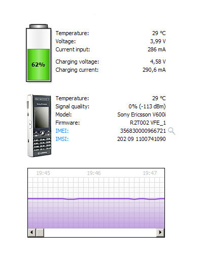

    Thanks for the multiple warnings, now pay the proper attention to the post #16.
    And as last info I will add that this battery setup does not even get warm, and actually the batteries stays frozen all the time, something that does not happen when my mobile phone charges it 3.7V battery with 300mA or more.
    That makes a 900mA battery to be ready in a hour time.
    Back to class for a Math lesson: 300mA for a single cell VS 240mA for two Cells.
    All the bets goes that my phone will explode first !! LOL

          If you look at the charging circuit, it is real simple constant current source charging. The U26 (LM317?) voltage regulator is setup as constant current source, not PULSE CHARGING. The charging current is 1.25V/9.1 Ohms = 137mA (Power switch is off, but the power supply is still running to charge the batteries when the meter is OFF) output voltage will be the Vdc on the input of U26- Vdrop across the U26. When power switch is activated, the 12 Ohms resistor is in parallel with the 9.1 Ohm to increase the constant current.
          The simple DC-DC converter is made to work on 4.8V, when you use 7.2V, the output from the converter will be higher than design, better verify.
          Per post 10 "While the meter uses 130 - 140mA at normal operation, at charging is capable for 200 - 240mA ( measured by Fluke 28II). " that is not the charging current you are testing since the power switch is not in the OFF position, the total current is split into the batteries and the circuits' current draw. The constant current of 1.25V/5.1 Ohms (Notes: 9.1 Ohm in parallel with 12 Ohms = 5.1 Ohms) = 240mA when the power switch is on.
          So after 20 Hours, you better remove the charge, since in 20 Hours the total current charge will be 2.74A (137mA x 20) that the batteries received.
