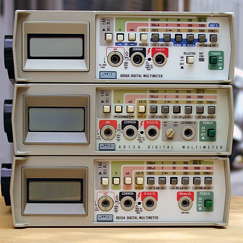

    Well a Fluke 8050A it can be a good candidate if you do not need more than 20,000 counts.
    Edit: I will add a picture of my meters, its model has its own strong points.

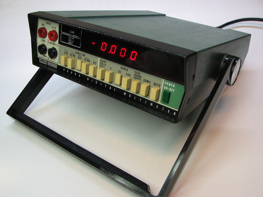

          I recently acquired a Fluke 8600A and I like it very much. It's a 20,000 count 4-1/2 digit meter like the 8050A, but it has an LED display (a proper bench multimeter should glow in the dark.) It also has auto as well as manual ranging. The 200mV and 2V ranges are spec'd at greater than 1Gohm impedance, I actually measured 10Gohm on mine. I find this very useful.
          These models are old, but volts and ohms and amps are still the same as they used to be.
            Cool, I'll keep that one in mind as well. I saw your 8050 LED conversion, that looks awesome.

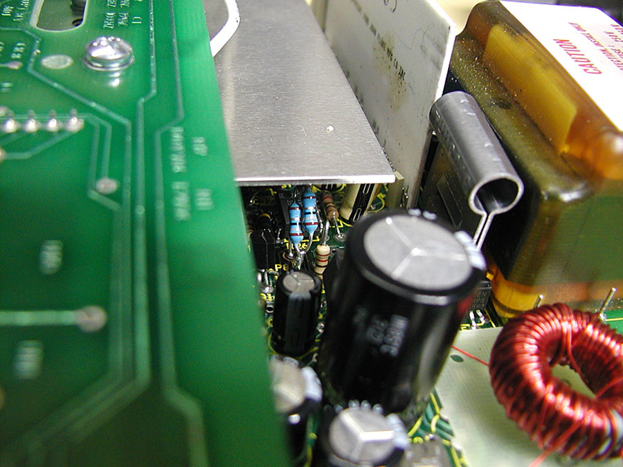

                            Primarily I was up to for an 8050A with battery option, and I did buy one with all the outside markings to indicate that is was what I was looking.
                            By opening up the meter, the PCB was had an modification by Fluke, which was converting the PCB with battery option in to a non battery powered one.
                            The seller told me that Fluke did some of those ( afterward modifications) so to please some large customers.
                            I did get an discount after my finding from the eBay seller, but the point is that I did not get an meter capable to operate on battery ....
                            The PCB with the inductor at the right replaced the charging circuit,
                            Which usually looks as one black box.
