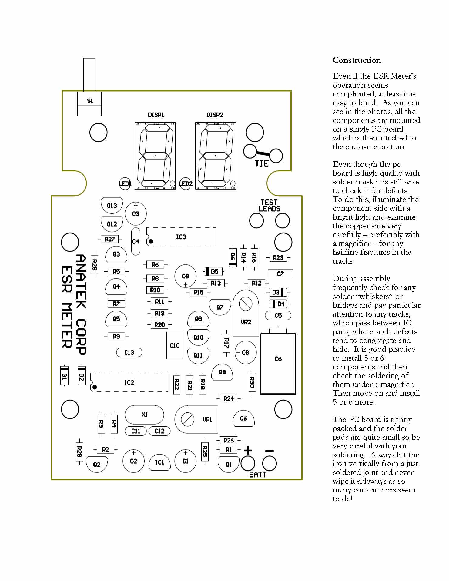

                    Re: anatek blue esr not working correctly
                    Can you post another photo now that you think you have it assembled correctly.
                    I don't wish to sound rude, but what exactly have anatek done wrong? You are ranting & raving about them, but from what we have seen so far, you have made errors in the assembly. Despite saying that you have checked & rechecked the layout, you didn't even realise that the 2 pots had different values, despite this being shown in the BOM!
                    Have you corrected the mistake in the 220k & 220R resistors which I can clearly see in your photo? You say that there is a problem with a 220k resistor, but are you reading it correctly. Did you check the colour codes of the resistors?
                    It is very rare for a new resistor to have an incorrect value unless it has been stressed by heat. Why did you demand that Anatek send you a complete set of new resistors? Have you replaced them all?
                    Finaly, you still haven't clarified this 70k resistor. It's not shown on the BOM. Where is this 70k resistor supposed to go?
                    I think you are being very harsh with your comments about Anatek. The chances are that it's your assembly errors causing the problems, & not a problem with the kit.

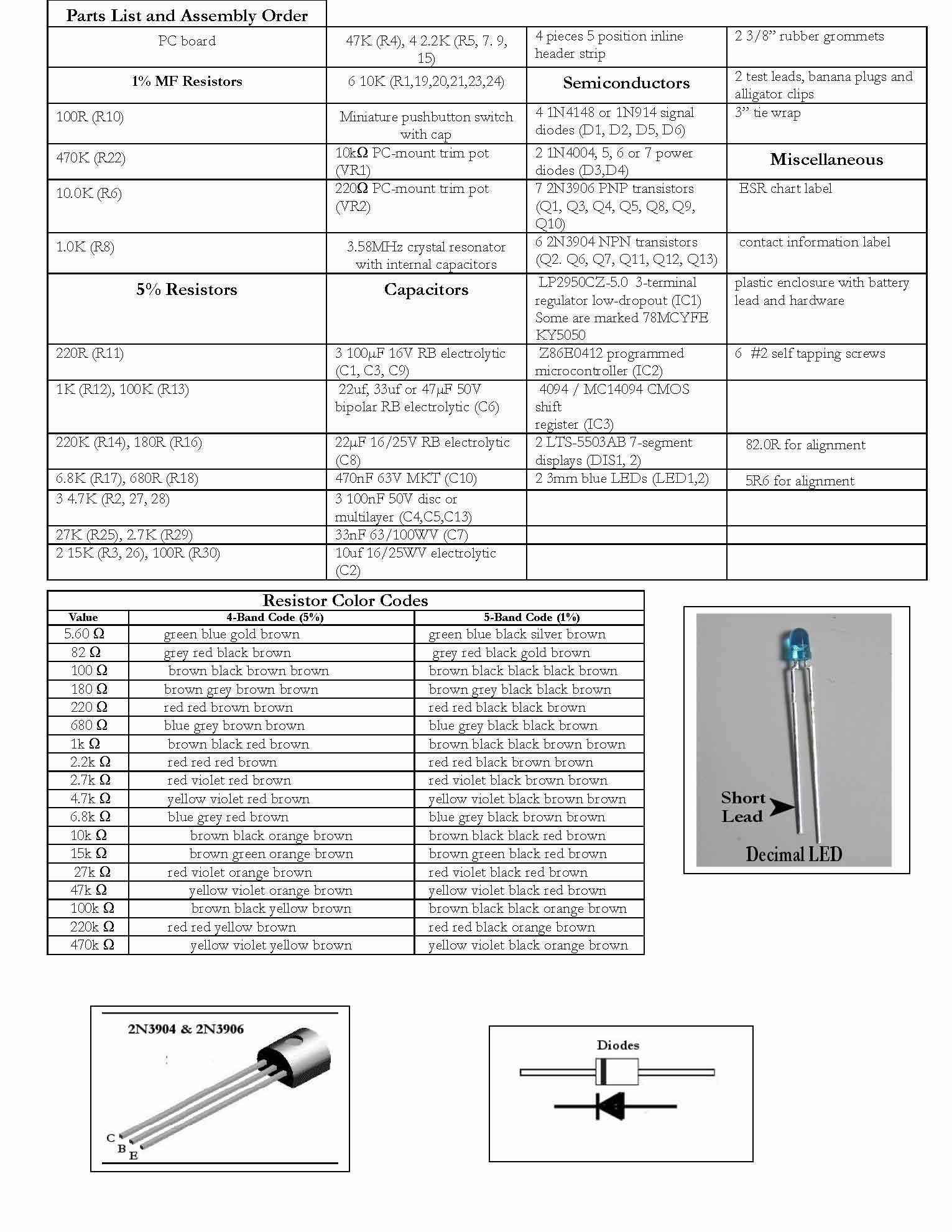

                      Here is the BLUE ESR manual, I do not see anything regarding to 70K resistor, no fine print that I can see.

                            470k resistor my bad figured that out but still don't have that resistor and they are sending me one.

                                    also want to note not to be whatever but the 470 k 1% resistor is supposed to be "yellow violet yellow brown" if you look at the pics that does not exist and the only other blue resistor i have is the calibration one so yeah it was mispackaged it really messed with me but it sorted just waiting for that one lone resistor to come in... i understand how you think i totally put it together wrong well yeah wrong resistors LOL when they sent me the 5% i found the values i needed and corrected them and yes the 220k and 220r has been corrected so that being said there was mistakes on both parts they just threw a monkey wrench in for me that's all ...all is good i will get this beast working....

                                      Good show, my man. You're gaining experience already.
                                      Note, however, that a 470k 1% resistor color code is not yellow-violet-yellow-brown; that's the code for the same resistor value, but it's not a 1% tolerance resistor. Take a look at the "resistor color code" table the BOM again. 470k, 1% has a 5-band code (not 4): yellow-violet-black-orange-brown. (4-7-0-K-1%), the K representing 3 zeros (color code: orange=3, this is the multiplier band), or in other words, 470,000 ohms or 470k, 1%.
                                      The last color band in a 5-band resistor represents the resistor tolerance. The 3rd digit band used in the 5-band resistor is used as a multiplier in a 4-band resistor, and the fourth band (if it exists on it) is the tolerance. Carbon resistors that don't have a tolerance band (a 3-band resistor) is always 20%.
                                      Note that the "4-band code (5%)" column in the "resistor color code" table is incorrect:
                                      the fourth band in the four-band resistor in your kit is not "brown", it's "gold". Gold represents 5% tolerance. So a 470k 5% resistor is yellow-violet-yellow-gold, not yellow-violet-yellow-brown. All those "brown" colors in the 4th band should be "gold" in that column.

                                        I said in the previous post that "a 470k 1% resistor color code is not yellow-violet-yellow-brown; that's the code for the same resistor value, but it's not a 1% tolerance resistor." A small error, because the last color band in a 4-band resistor--brown--is 1%, but the "4-band code (5%)" column in the "resistor color code" table in the BOM is still incorrect; all the 4th band color (brown) should be "gold".
                                        That will be reflected in your kit of 5% resistors. Your 470k resistor will have 5 bands on it, not 4.
