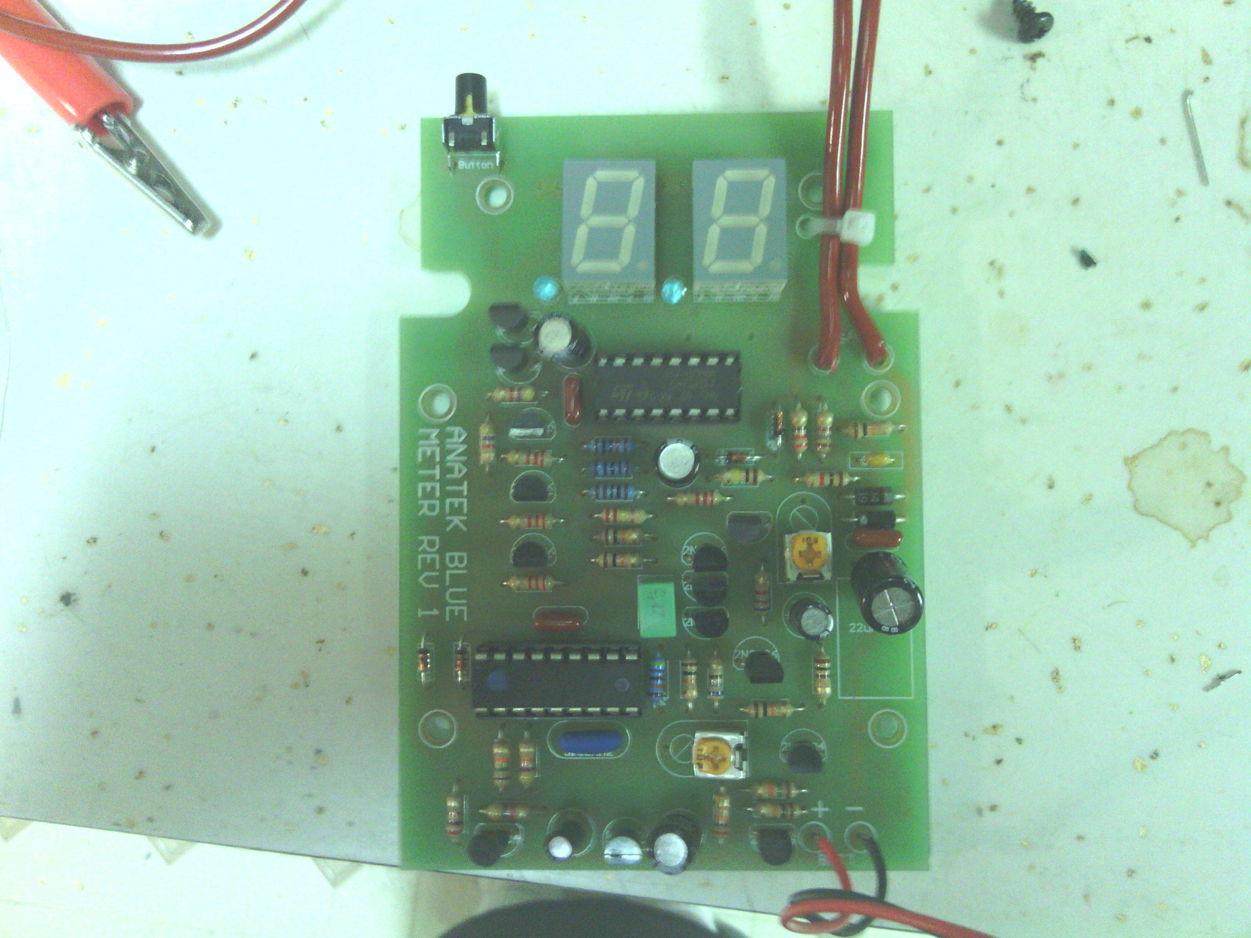

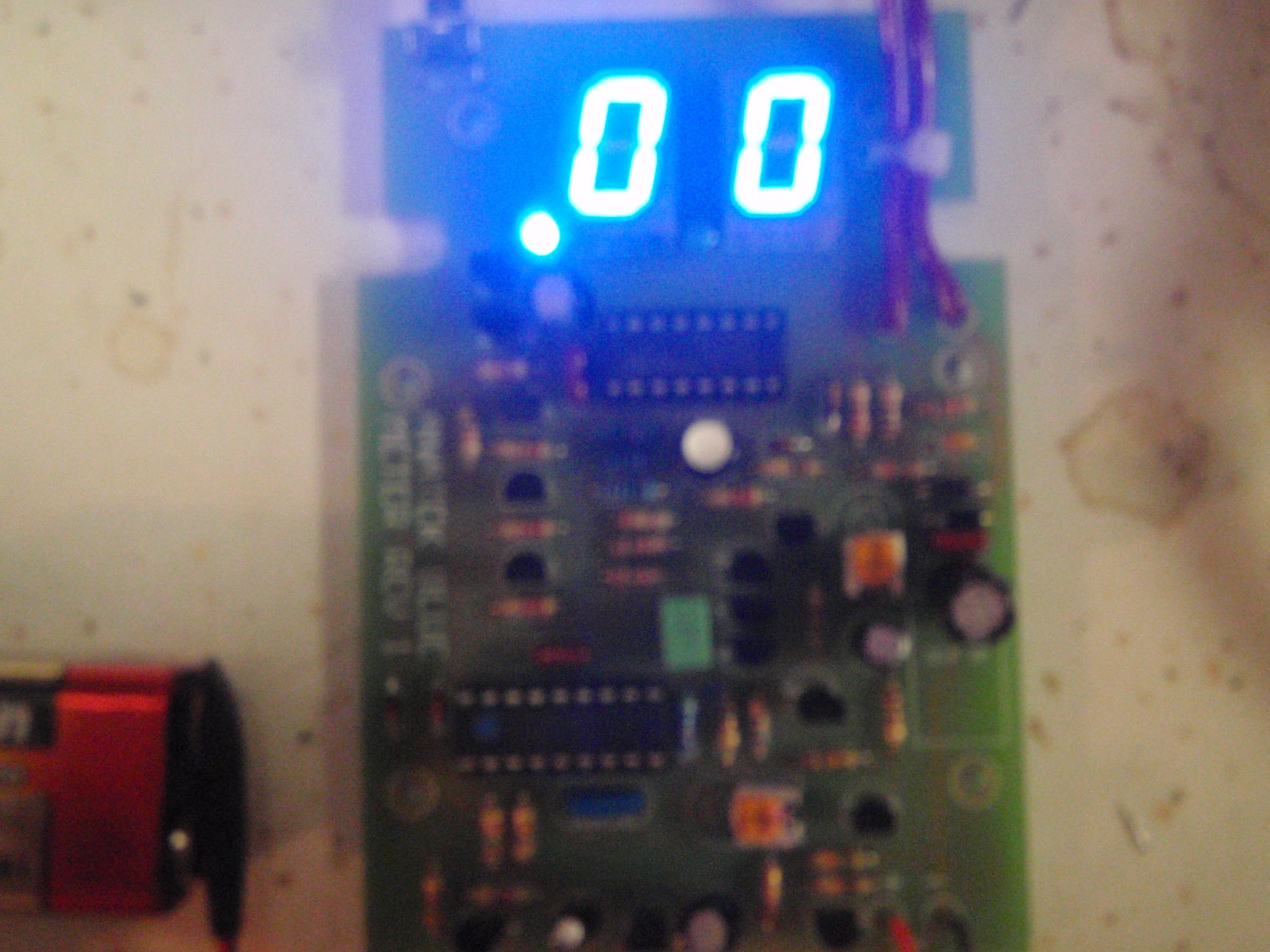

    ok guys i got me one of these meters and put it all together and all i get is .00 and an f2 error when shut off the adjustable pots do absolutely nothing, no response when i short the leads and or use the calibration resistors no response at all whatsoever and i am stumped....makes me sick of 80 bucks out the door if i can't get this thing to work....

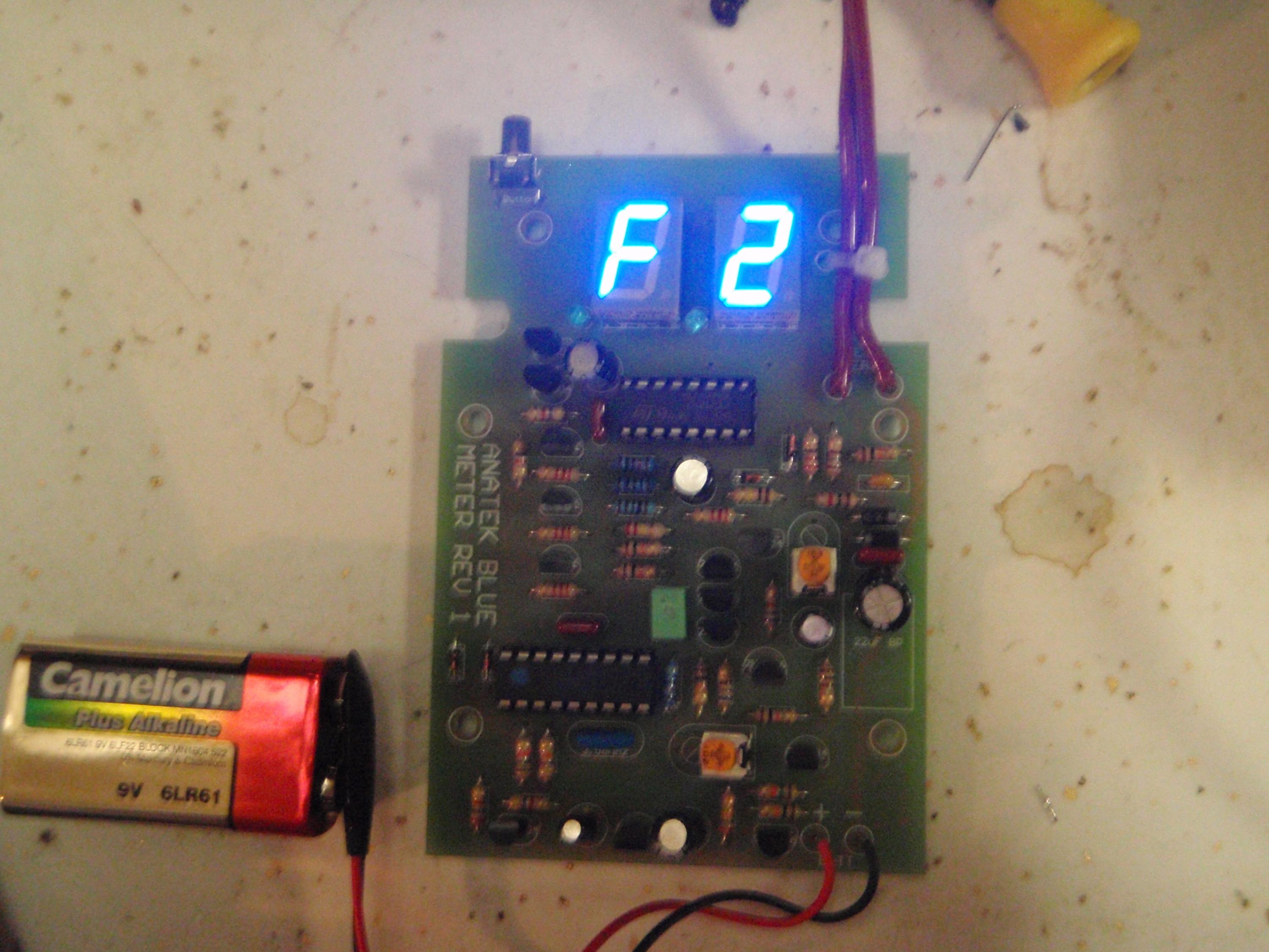

      pics taken with droid hopefully better for ya guys any imput any kind of suggestion would help i checked connections everything i can think of and still not working ugh!!!!!! it shows the horzontal line on left for a split second then goes to .00 then holding power button will give me the f2 error then it will auto shutoff, if i turn it back on same thing line split second then .00 and if i leave it alone it will shut off in 3 mins.....with no error but again pots do nothing and leads do nothing on a cap or resistor does nothing.....

        F2: C10 is charging too slowly (or not at all). Check around Q9, Q10 (2N3906), R22 (470kΩ), R19 & R20 (10kΩ)
        and C10 (470nF).

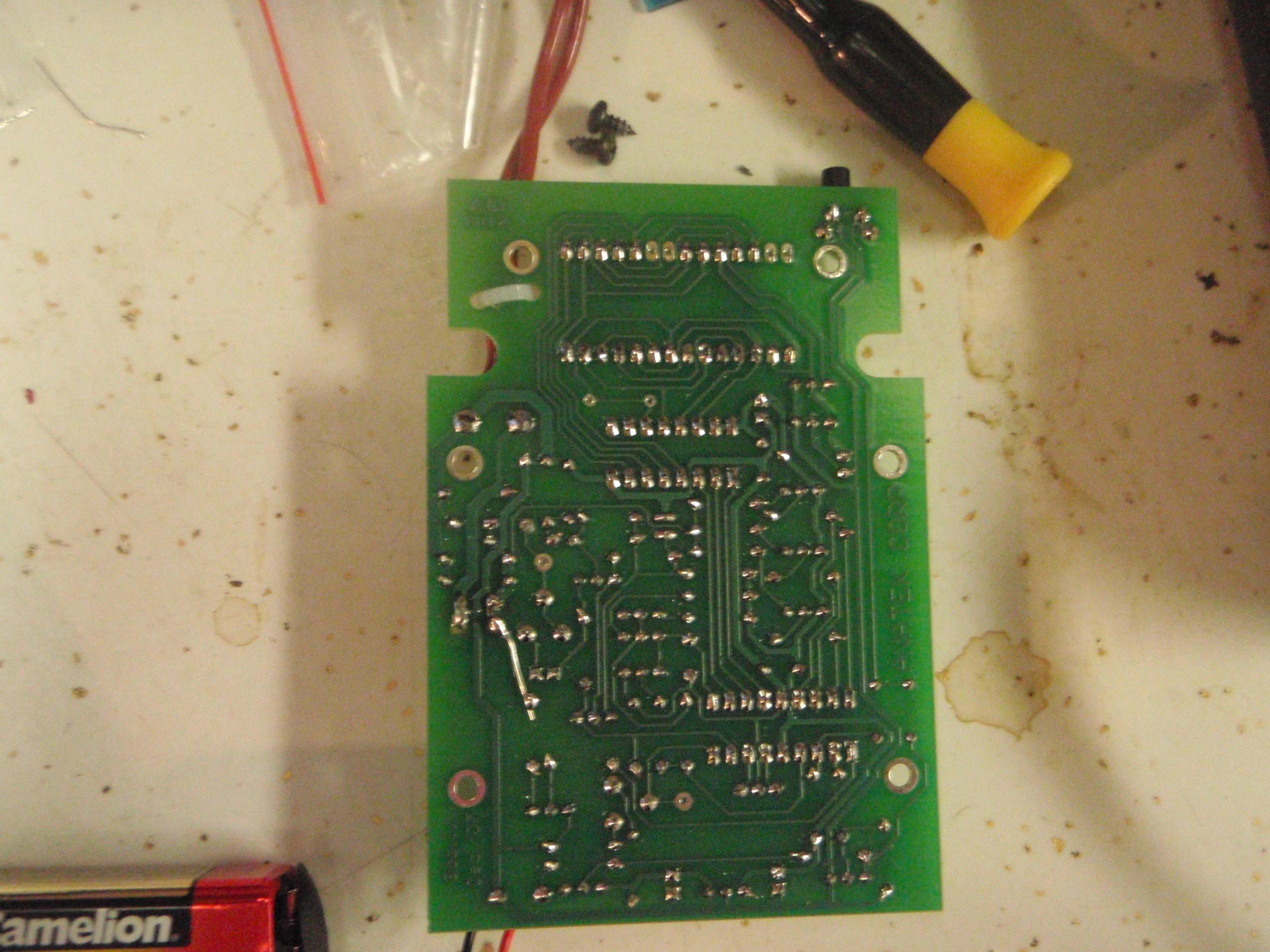

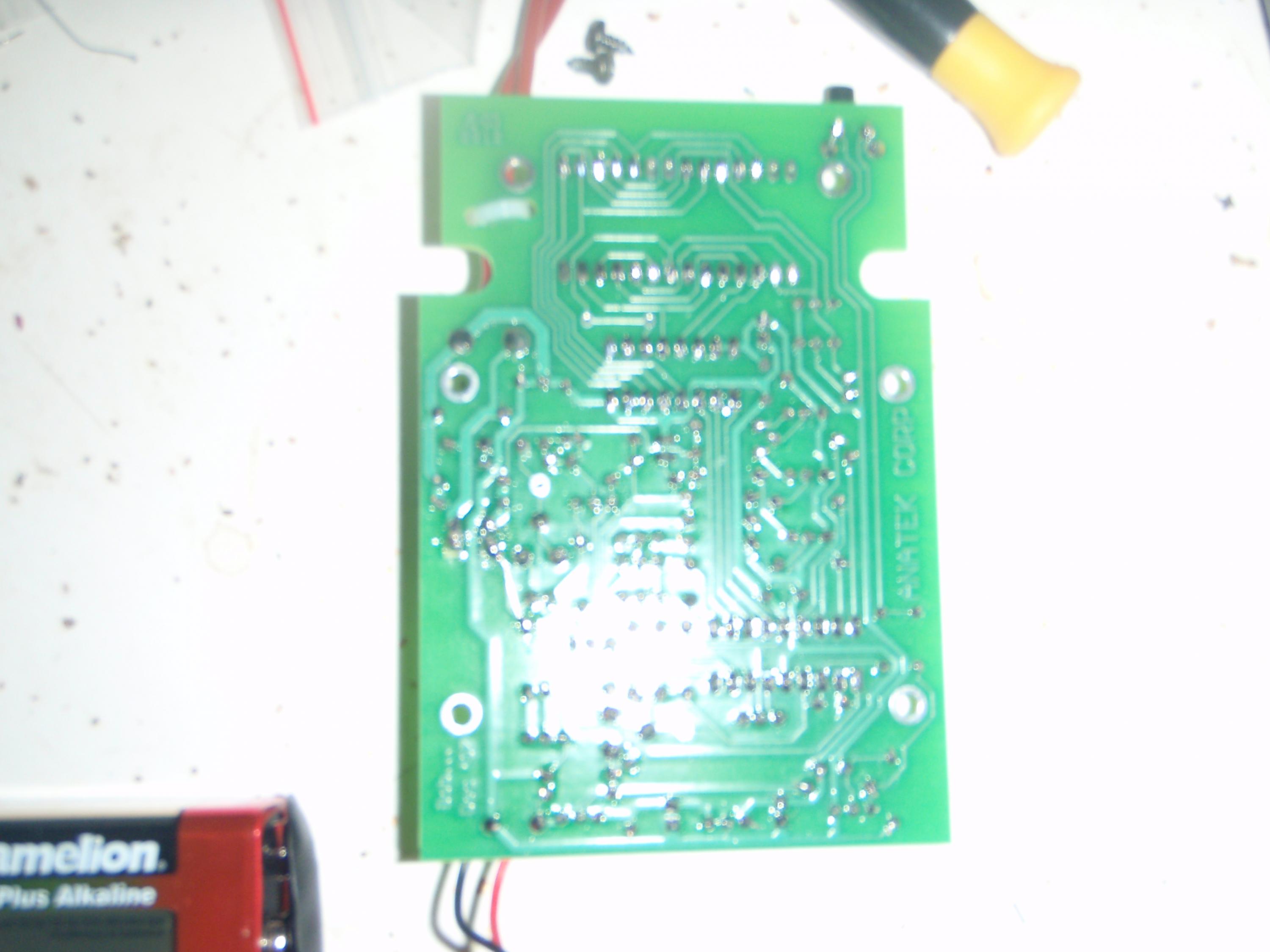

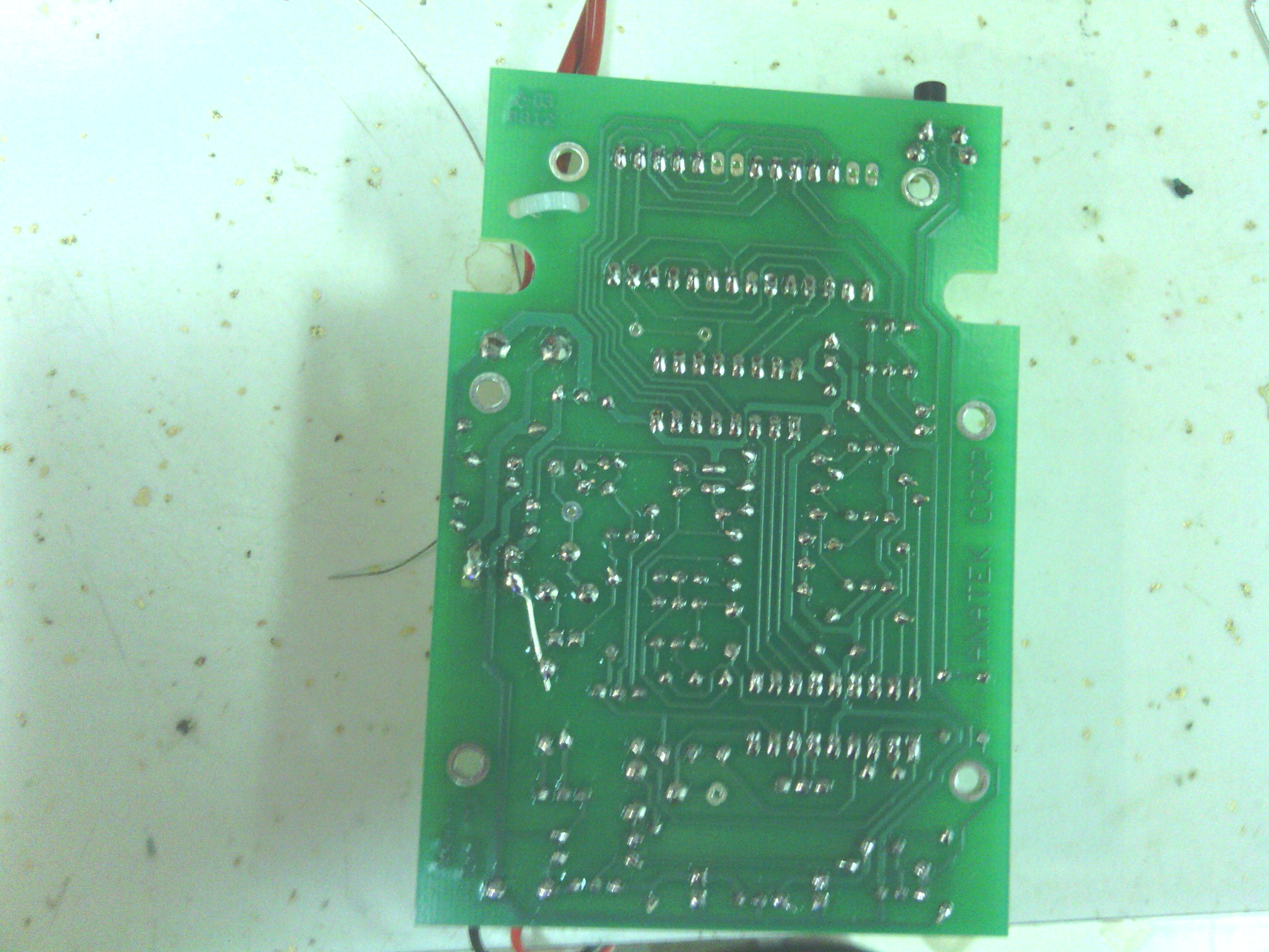

              It is a little hard for me to see in the photo, but It appears that the two capacitors (small yellow one and a larger red mylar one), that are located close to the pair of rectifier diodes, look like they each have one lead that is not soldered. You may want to rotate the board 180 degrees and resolder some of the joints that look like they have gaps in their solder joints.
              Also, check for any unintended solder bridges where the traces pass very close to each other. There may be a short somewhere.

                        yeah i do and upon rechecking everything i found 2 errors i made and 2 errors they made LOL i had the 1k and 100k backwards and fixed that however they gave me 2 wrong parts supposed to be 1% 70k resistor and a 220k 5% resistor i will be getting a hold of anatek to get this corrected i tried to find suitable replacements laying around all i could find is 50k and 200k ugh not quite LOL..seems like its getting common with parts errors with anatek these days upon researching and its quite a pain when that happens.....thanks bud your quite helpfull with the tv sets been finding ya all over the net when i research tv repair...

                                I just took a look at the pictures of your blue esr meter.VR1 and VR2 appear to be swapped.I would also suggest that you closely check the color codes on your resistors.It is hard to tell from your pictures, but some of them don't look correct.

                                        VR1 is 10k ohms(labeled 103)
                                        VR2 is 200 ohms(labeled 201)
