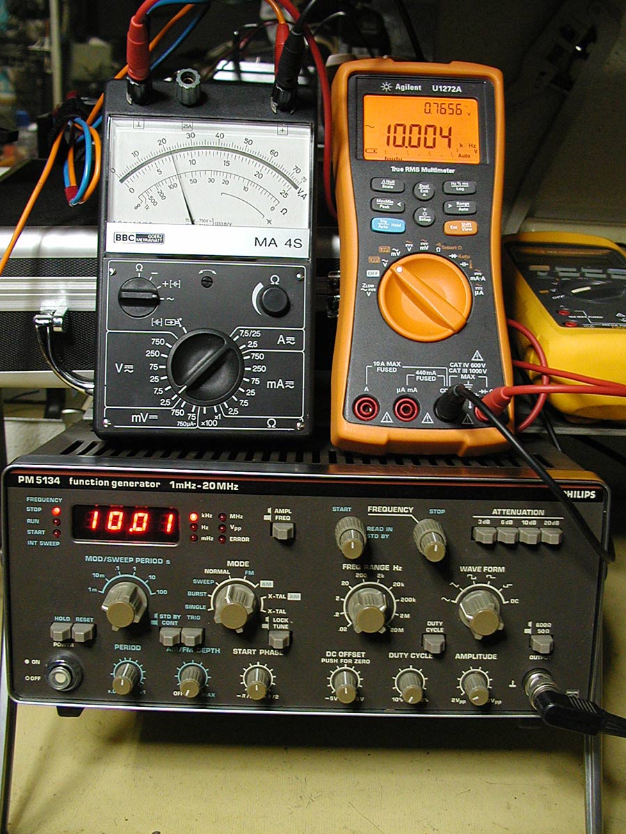

                Well I do not wish to scare anyone
                But this is my BBC Metrawatt MA4S (industrial version 80s)
                Which jumps high even at 10KHz regarding volt measurement.
                But they can be found only at the German eBay.
