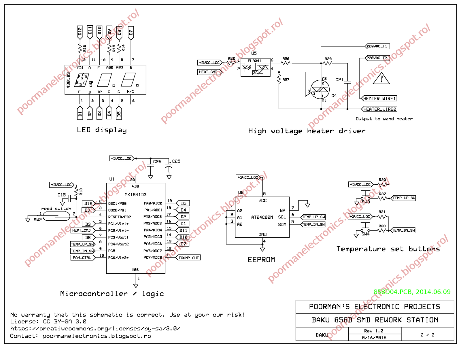

                              Hi to all,
                              I have a Sigma R700 (858D clone) and would like to repair it.
                              PCB is marked SBK858D 2017.01.03
                              The heater is always ON no matter it is on the holder or not. I troubleshooted the whole circuit and the reed switch is good.
                              On microcontroller input P0.1, I get 5V when off the holder and 0V when on the holder.
                              Am I missing something here ? Any other conditions in the firmware would keep the heater ON all the time ?
                              Thanks !

                                Re: [FAQ] Atten 858d problem S-E (or 5-E) or stuck in 498'C.
                                Whatever controls the heater, probably a Triac, may be shorted?
                                  I originally thought about it but it controls according to temp setpoint. This part seems to work.
                                    • 31260
                                    so your saying the standby function isnt working, but it heats to whatever temperature you set?
                                    • jmbinette
                                      • Nov 2017
                                      • 10
                                      That is exactly right
                                        • 31260
                                        not much to it if it matches either of these:
