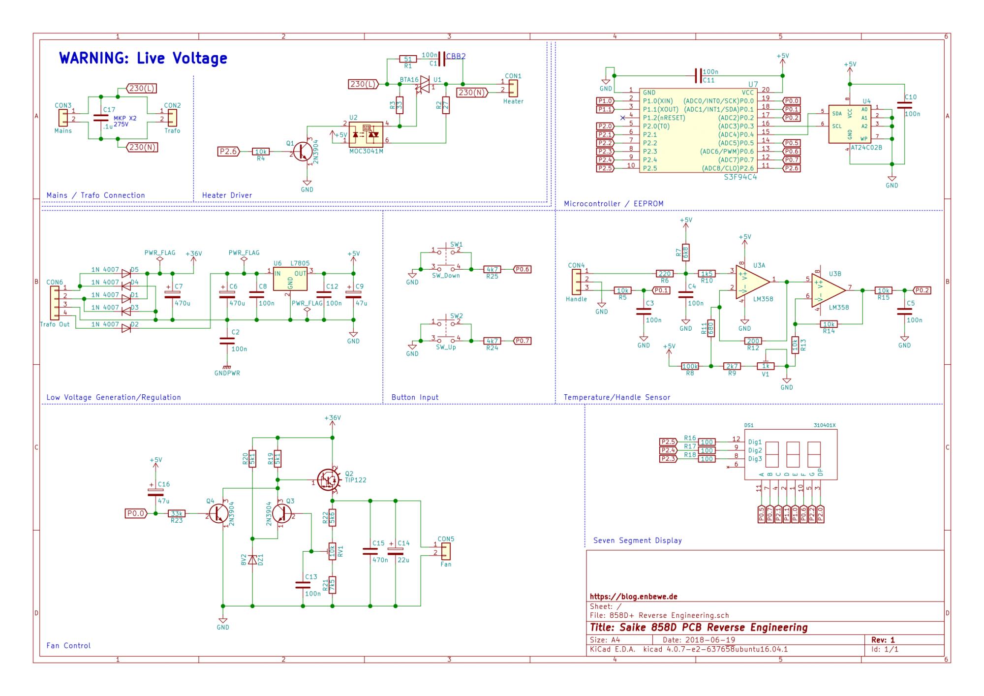

    Re: [FAQ] Atten 858d problem S-E (or 5-E) or stuck in 498'C.
    Originally posted by stj
    not much to it if it matches either of these:
    Actually it matches this schematic (resistor and cap ID are different but circuit is the same.
      The triacs (BTA16-600B) are known to short circuit and the heater stays stuck on. Very dangerous and will burn down your house! Never leave these cheap chinese stations plugged in all the time, I pull the power cord after I am finished.
      The triac does need a heatsink, so make sure you have one or it will just overheat and short.
      The exact 858D schematic depends on your PCB version. Post pictures if you are not sure. This is 858D+ schematic which is similar.

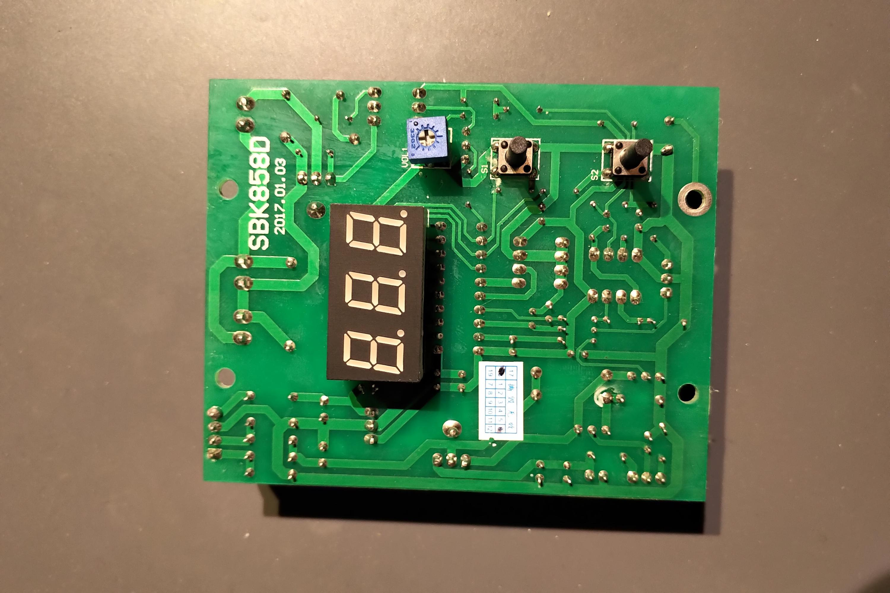

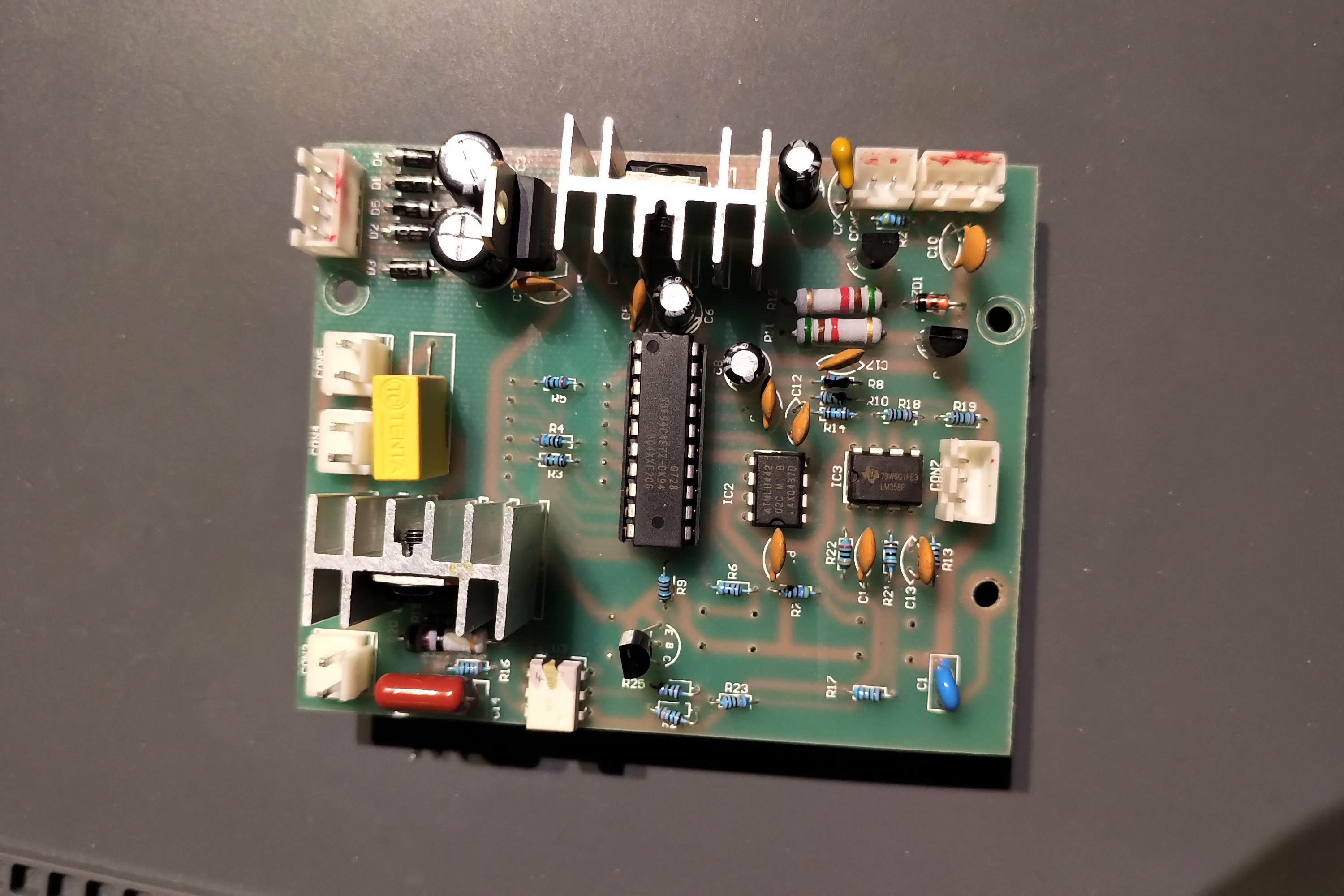

                  Originally posted by redwire
                  Are you positive you have the right MCU pin?
                  The reed switch sees the magnet only when in the cradle, so it closes and I/P goes from 5V to 0V.
                  The chinese are trying to put hardware copy-protection in their soldering stations, as they steal firmware from others. To prevent cloning, the firmware guy will move an I/P pin so the clone pc boards no longer work. Small chance but this might be what you're seeing.
                  For the record, here is another PCB to add to the "clones database" ! lol
                  I re-tested everything and pin 18 on the IC is really switching from 5V to 0V(Wand on the holder)
                  • Agent24
                    I see dead caps
                    • Oct 2007
                    • 5083
                    • New Zealand
                    #29
                    I think what redwire is saying, is that Pin 18 may not be the pin the firmware is actually expecting the sleep signal on. As far as the software is concerned, Pin 18 may not even exist - the software might be waiting to see that sleep signal on say, Pin 17 instead.
                    Or, the software might not even have a sleep function at all!
                    -David VanHorn

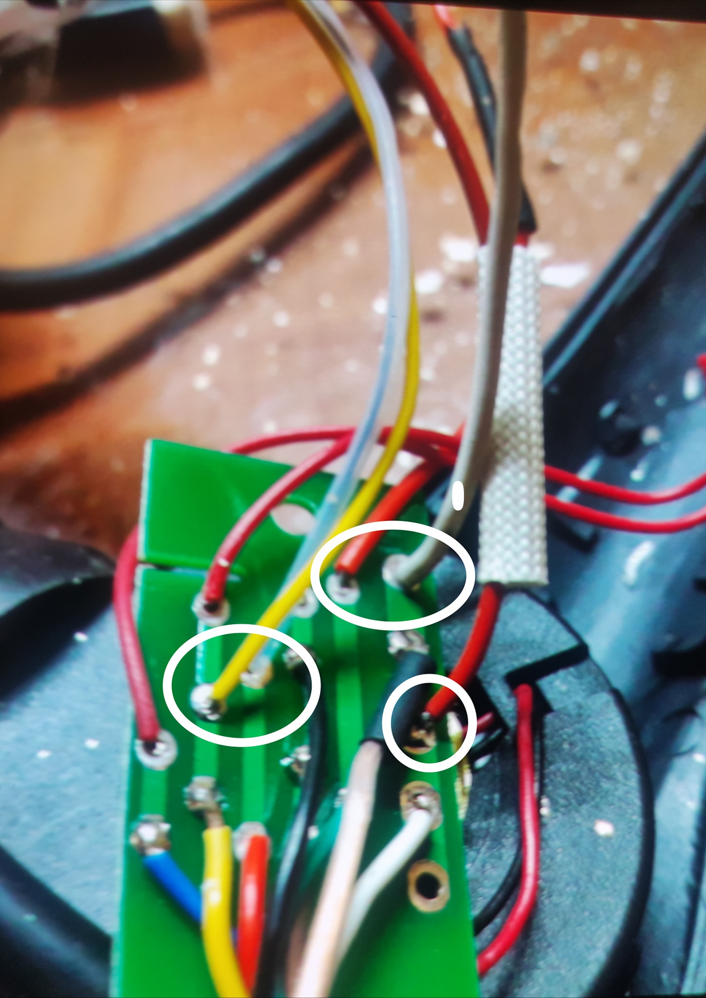

                                      Originally posted by senndogg
                                      Its only a week i have been working with my new Atten 858D+ heating station and i have experienced a problem. The station showed S-E in the digital display, the blower fan was ok but it was NOT heating. Searching the web showed that the heating element was gone, this was an error code, but it was not true. Measuring it showed 70 Ohms. Also the mosfet which drives it was not shorted. The station was also stuck in 498'C sometimes, again no heat.
                                      Browsing again and saw some unresolved topics, there is one at a well-known polish forum. Mine is in warranty too but i was not thinking about shipping it ti China.
                                      After close inspection at the small circuit in the gun, i could distinguish a cold joint at the soldering of the thermocouple sensor. Bingo!
                                      Now the heating is working great again!
                                      Thanks for reading.
                                      First pic is the Atten 858D+. At the moment it is OK, SLP means "sleeping".
                                      Second pic is the culprit.

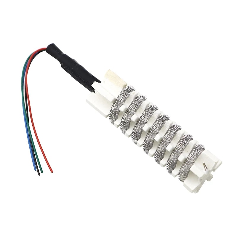

                                      @senndogg I am sorry for bring back to live your post, but I would need yur help on that.
                                      I have bought a heating element replacement for my toasted old one and I have issue identifying the wiring. The wires on the replacement are totally different and even same colored. I can't tell also which one got to Positive and which on Negative. Can you help? I attach the pictures.
                                      You see the replacement has 2 x black , 1 x red, 1 x Green, 1 x Blue wires.
                                      The one black is thick, so I guess this is the main voltage, which is the grey one in my original wiring. I hope you can help me where to solder each.
                                        • 31260
                                        #39
                                        on the element, you can use a multimeter to find the 2 wires by continuity test to the coil.
                                        the other 2 wires will be the sensor.
                                        then check that by setting your meter to read mV and heat the sensor with a hair dryer or something and you should see the voltage rise.
                                        that will also tell you which wire is + and which is -
                                        • MadMaxGR
                                          • Dec 2020
                                          • 3
                                          • Cyprus
                                          #40
                                          The wires are wrapped inside the element, is difficult to do continuity test, but I can figure out which one goes where if I can find the Positive and negative.
