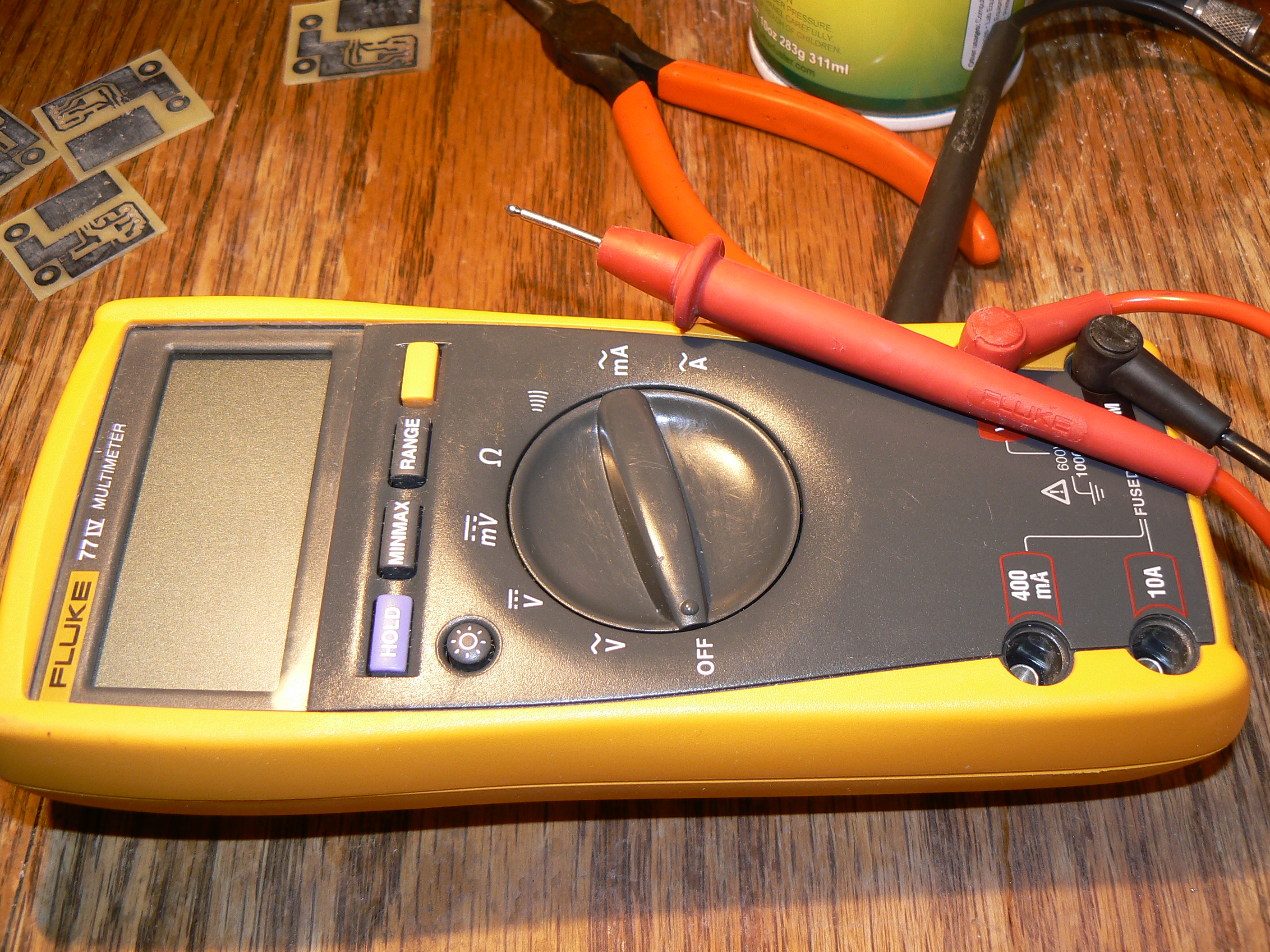

    My new (used) Fluke 77 Series IV DMM

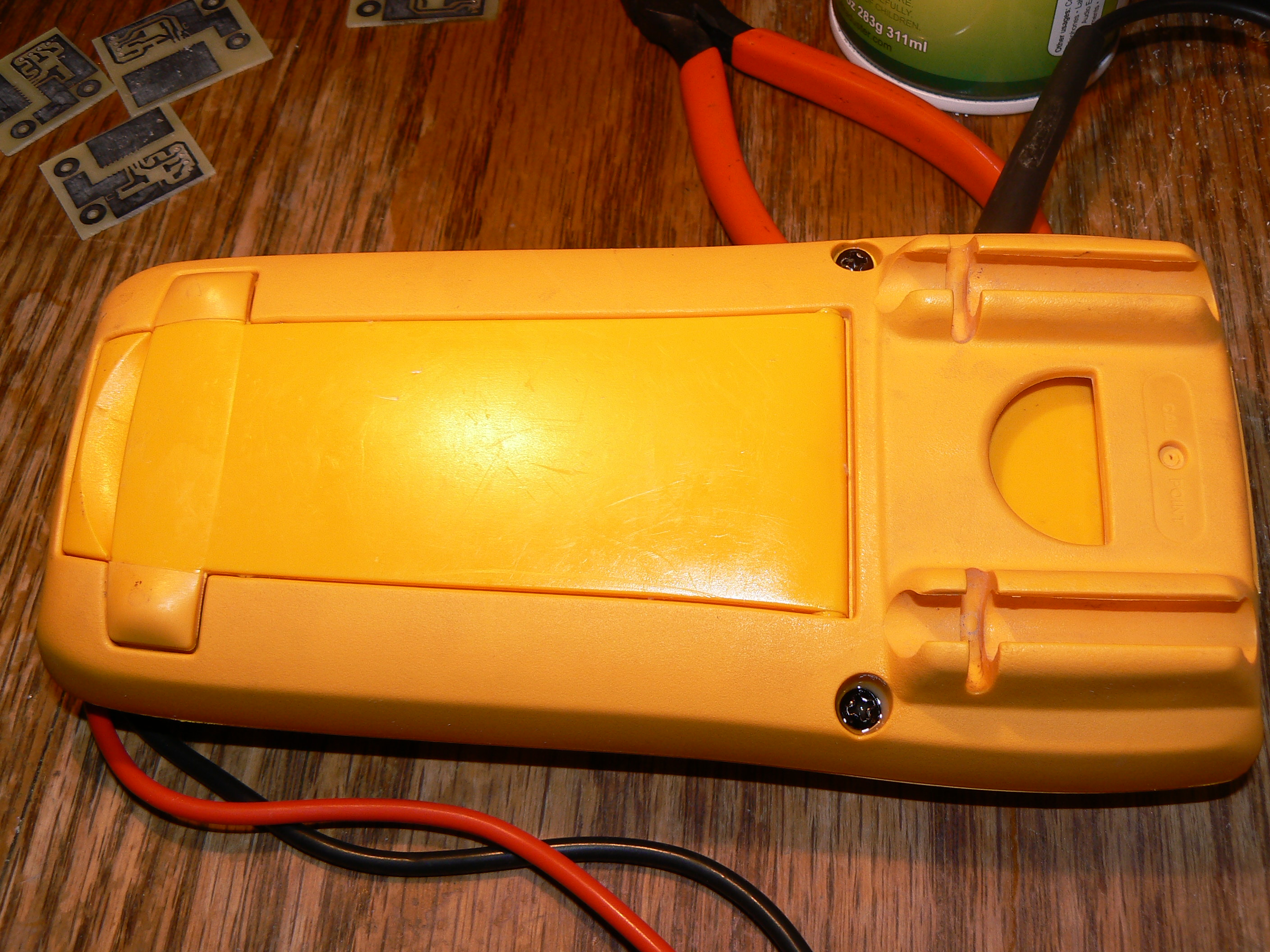

    After a recent power supply incident I decided it was time to relegate my 20+ year old Fluke 21 back to its' original purpose of automotive work. I bought this meter at a pawn shop in 1992 and it has served me well, so much so that I have a great sentimental attachment to it. Recently I have found myself needing a meter with more features. I found what I thought was a good deal on a Fluke 113 but I soon discovered it was not good for much of anything I wanted to do.
    Today I thought I would go to a local pawn shop to have a look at selection they had available. I figured if it worked for me before it could work for me again. Although I had only intended to look, I could not pass on this meter. I was able to get it out the door for $39 after taxes and at the time it still had a screen protector on the lens. Granted, it did have a lot of grease stains that made it look bad, but I was able to take care of that with just a little effort. I think I got a good deal, I paid over $60 for my Fluke 21 in 1992, and this meter can do so much more.
    I am sure there are some on this forum that would not find this meter suitable for there needs or they are just Fluke haters and I can understand that as I am that way about certain items or brands that others seem to like much to my dismay. I happen to like Flukes (with the the exception of the 113) and I do not see that changing anytime soon. If this meter gives me the same level of service as my old trusty Fluke 21 I think my money was very well spent.
    If you have read this far, I hope I have not bored you to death and thanks for taking the time to read this post.
    Some pumice soap like gojo or fast orange will make the holster look like new again.
        It was a GoJo clone that I used to clean it. It is good at removing sticker residue which the meter also had on it. I am thinking that the dirty appearance is why it was so cheap. I was only concerned with its' functionality and features and it had everything I was looking for so when opportunity knocks it is best to answer.

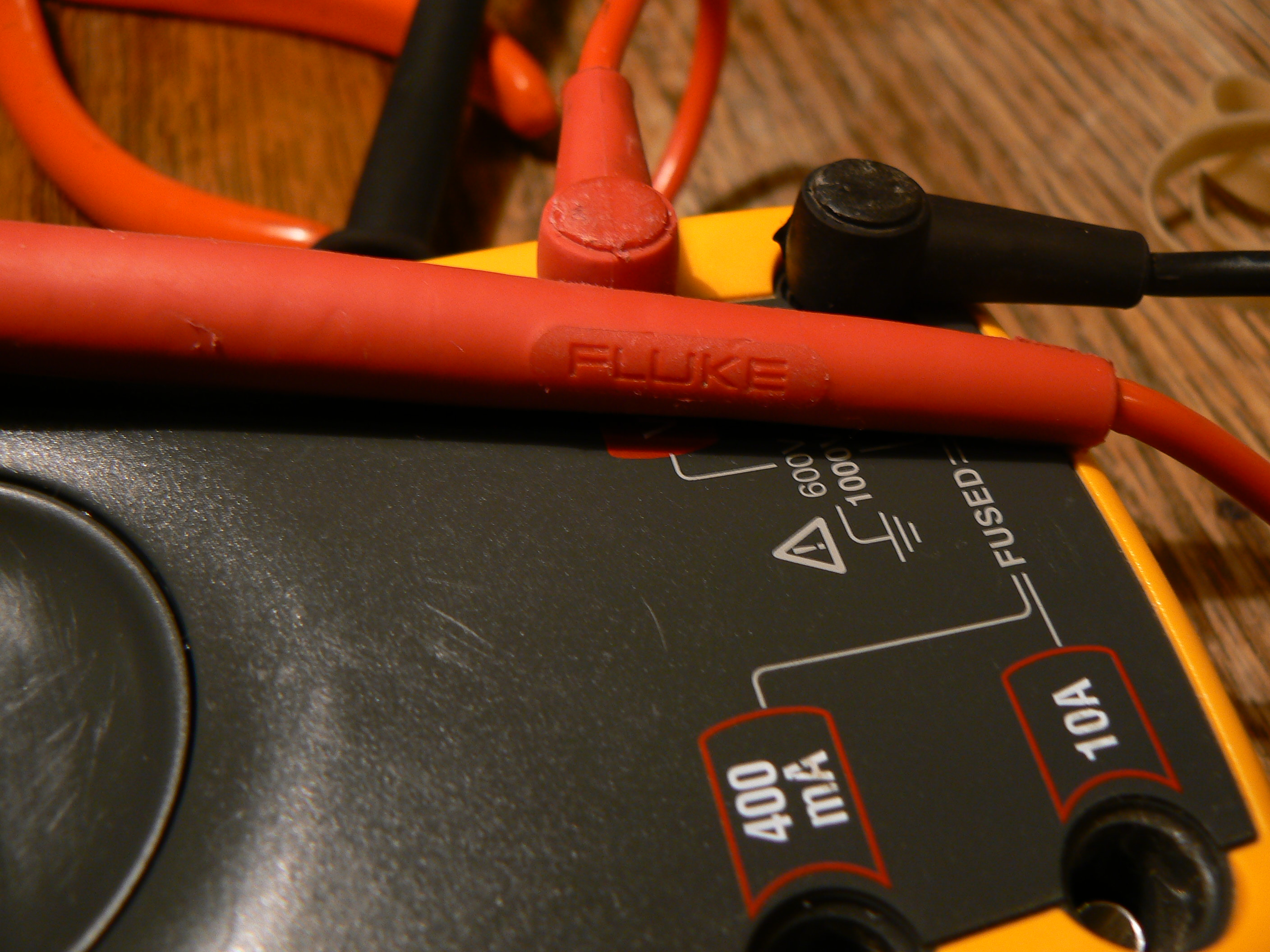

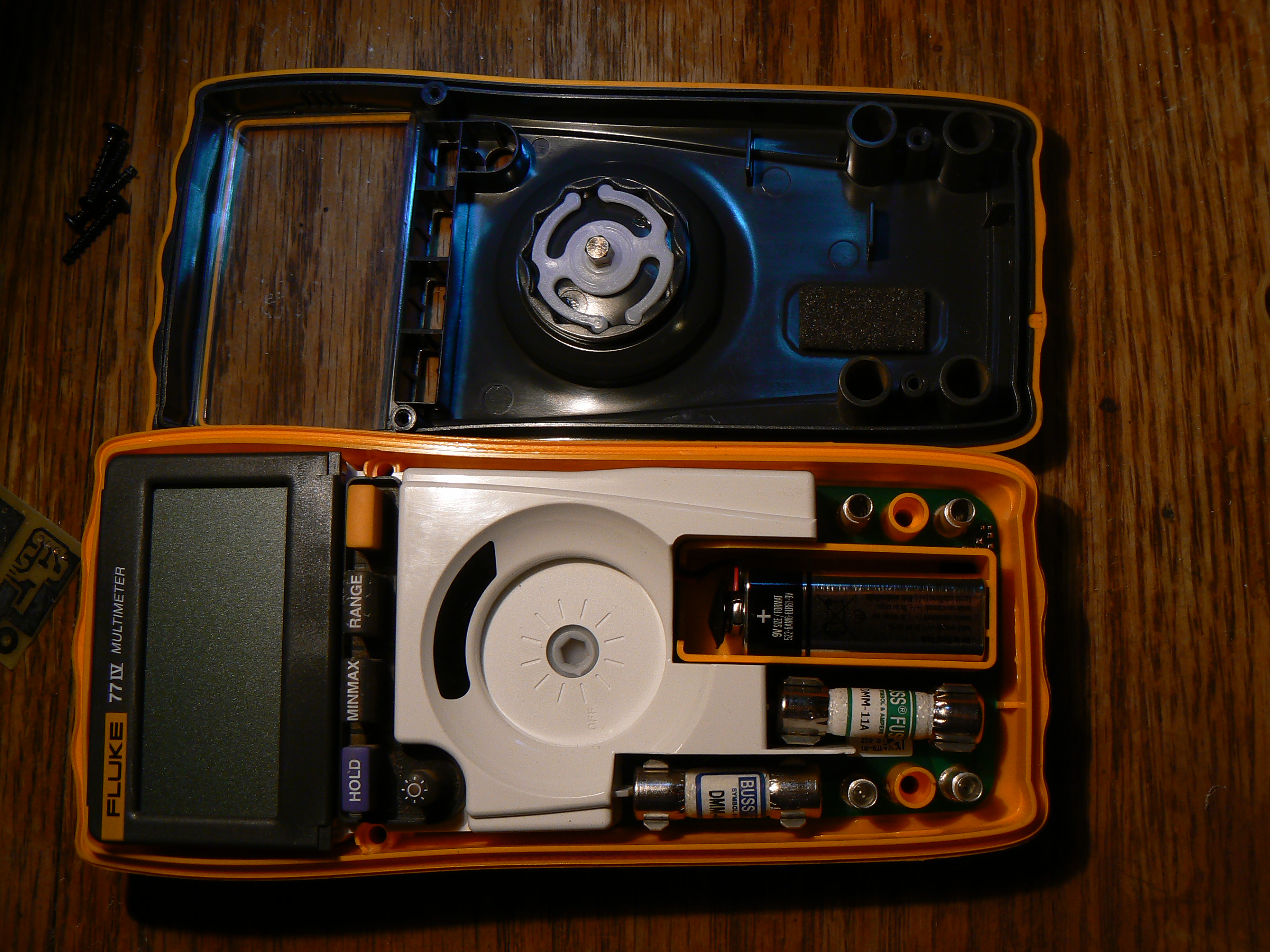

        1) Make sure your fuses are good. Sometimes, people sell multimeters as working perfectly, but do not know the fuses are blown. Just put the multimeter in ohms mode and stick the red probe into each amp jack. If the reading is 0L, the fuse is blown.
        The fuses in any Fluke multimeter are expensive ($7 to $10 each).
        0.1 ohm on the 10A connector and 1.7 ohm on the 400mA connector.
                Those fuses are good.

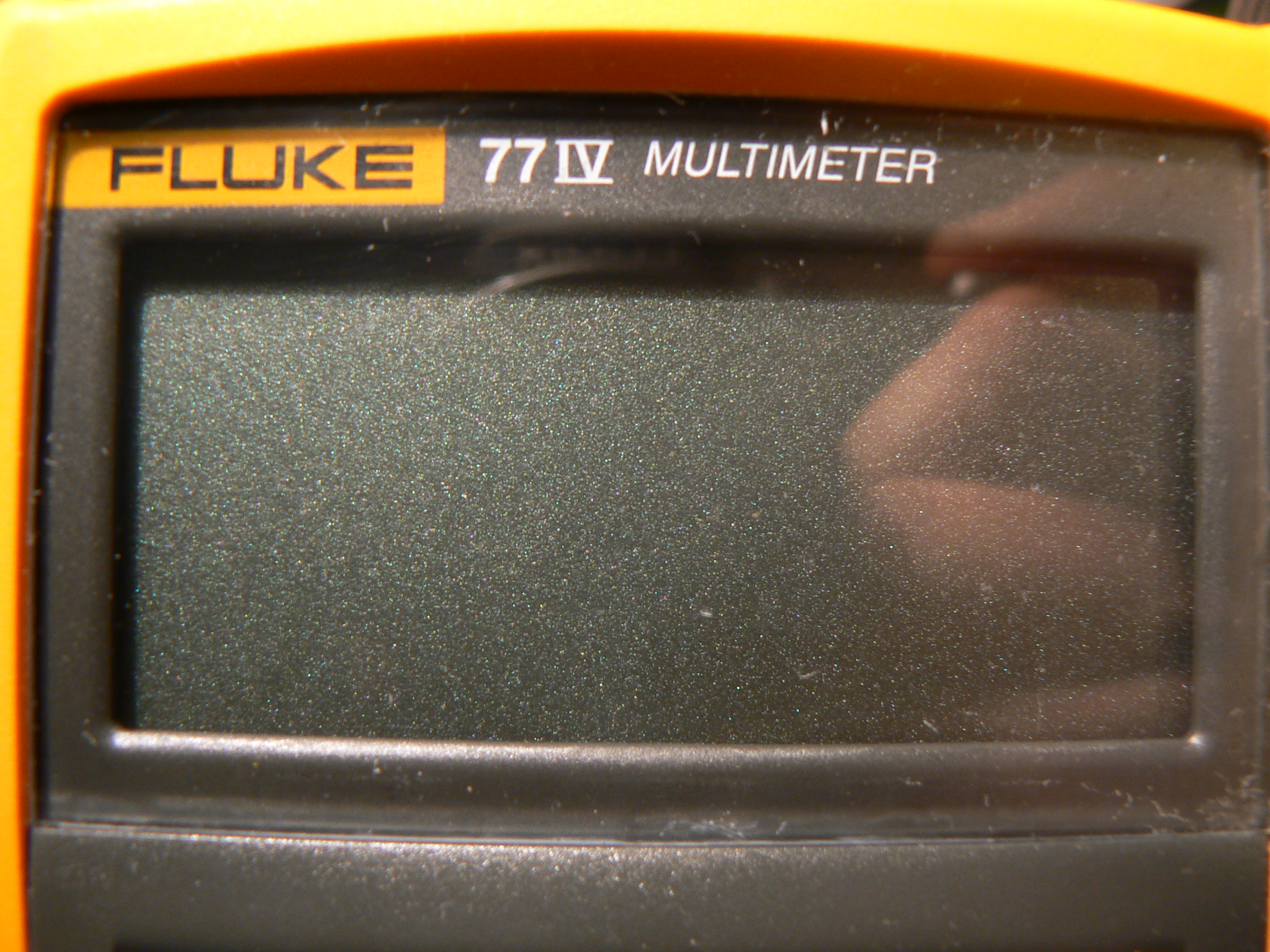

                  I didn't notice it earlier in your photo, but the yellow silkscreening seems to have faded or been rubbed off (from a cleaner) for all the secondary functions?
                    I noticed that this morning myself so I suppose I will have to mark it myself. I do not know if it was the hand cleaner or the 90% rubbing alcohol that I used to clean off the hand cleaner but they are gone. I would have rather not have had this happen but it does not affect its' operation and I can always mark it myself so I am not going to loose any sleep over it.

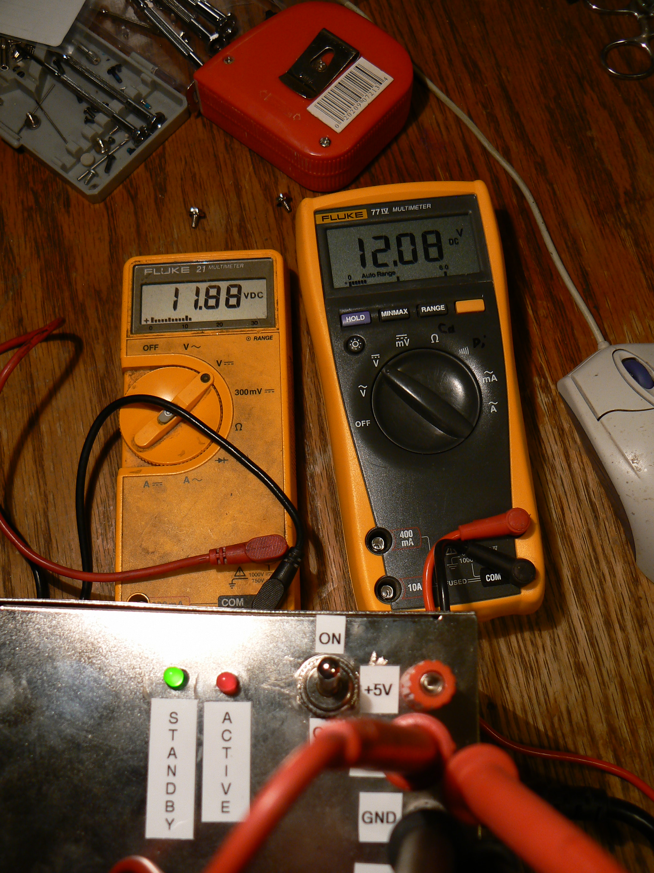

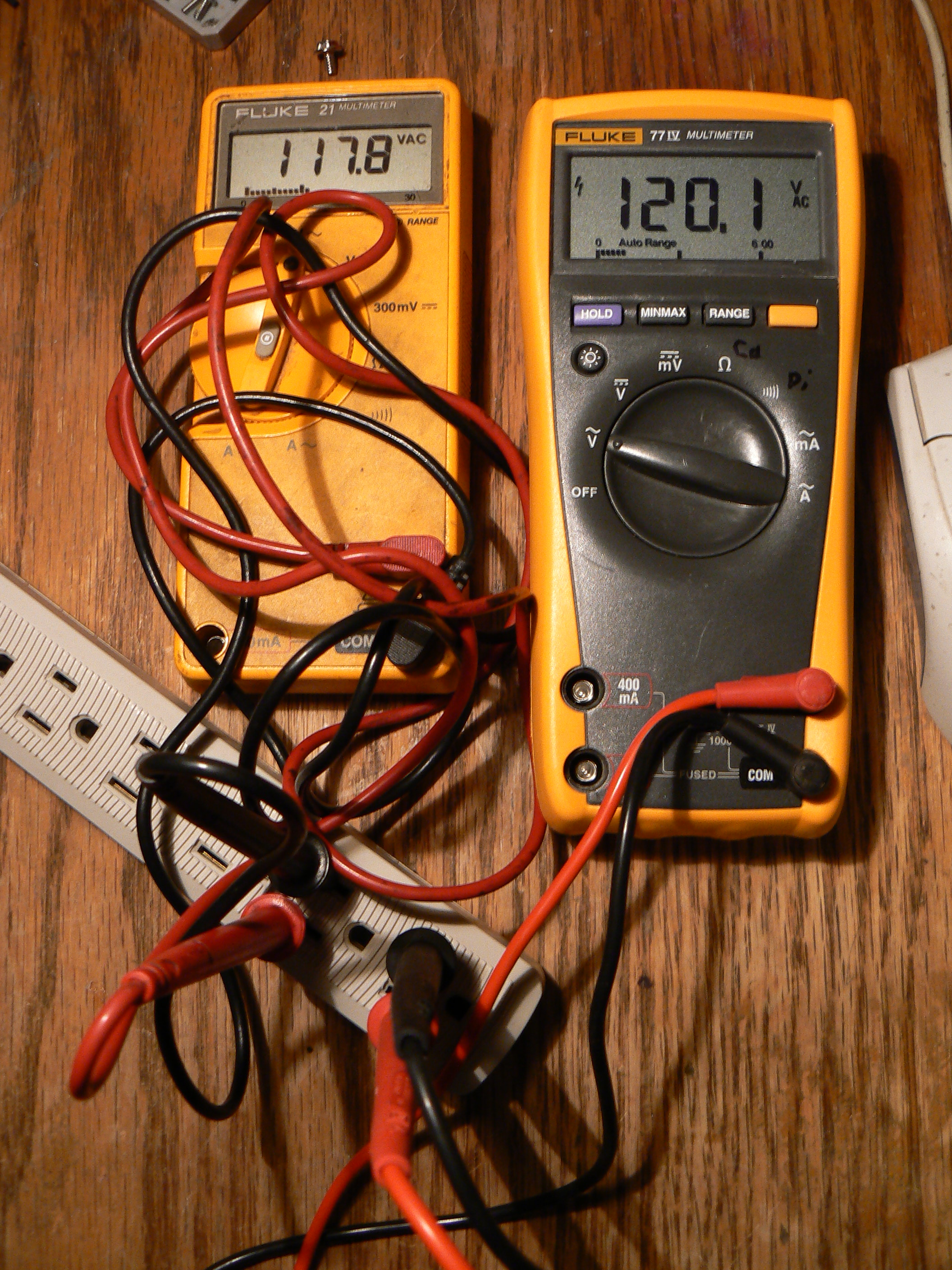

                                  Re: My new (used) Fluke 77 Series IV DMM
                                  For fun, hookup up Fluke 21 and 77 IV to the same ATX power supply and measure the 5V and 12V DC rails using the molex connectors. Try the same for measuring an AA battery so we can see it down to the mV resolution.
                                  It would be interesting to see if the Fluke 21 has kept its calibration over 20 years.
                                  I have to admit that I thought the two would be close but... it was not too be. I will now have to carry one or both to work with me and compare them to the calibrated Fluke 179 to see which one is off. I suspect and hope it is my 21 as it is close enough for automotive work anyway.
                                    If the Fluke 21 is off, you can adjust it quite easily. There is only 1 pot (DC V) to turn and it is to the left of that 0 ohm resistor. There is no pot for AC V.
                                    If the Fluke 77 IV is off, you can't adjust it at home. The 77 IV like the 179 is closed case calibration.
                                      Use a 3.000V DC source for calibration. I find that the green pin on some ATX power supplies is close to 3.000V. Have the other calibrated meter plugged in at the same time so both read the same value.
                                        I have purchased 3 used 20+ year old Fluke 70 series style multimeters and all have been within spec (0.3% + 1 digit) in the DCV range. The 77 II that I cleaned up with was the "worst" at 4mV off, but still within specifications.
                                        If your Fluke 21 is the one that is off, that is the worst drift I have personally seen in an older Fluke.
