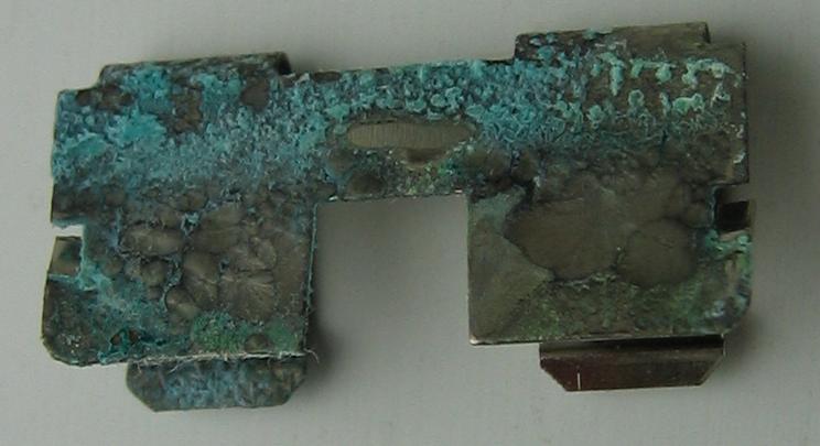

    Also posted on eevblog where most of the multimeter people hang out, but I want to get more opinions and suggestions from people here.

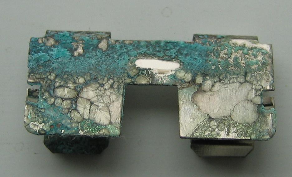

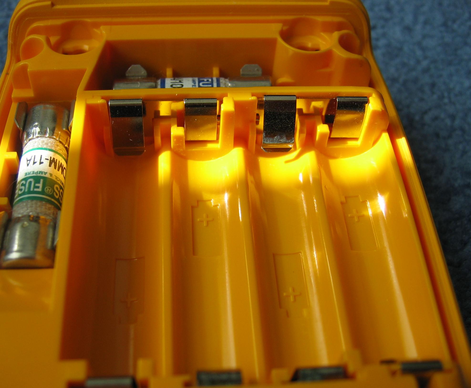

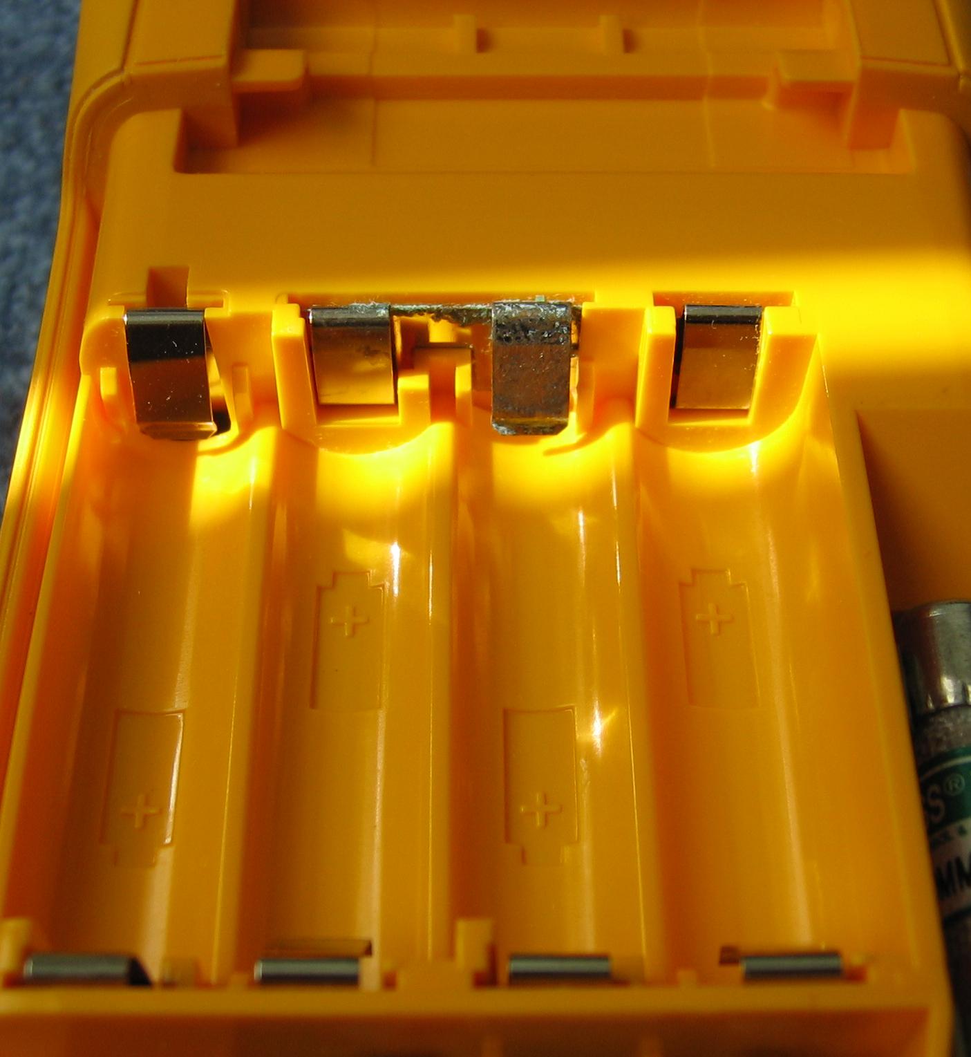

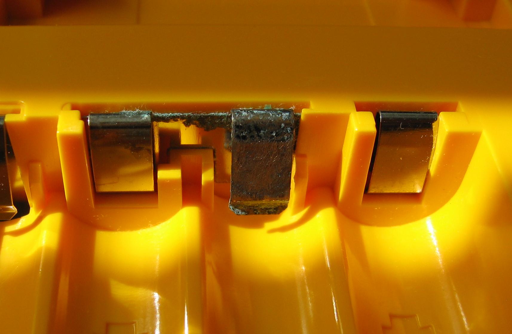

    I bought this used Fluke 187 off ebay. Opening up the battery compartment reveals some past battery leakage/corrosion. The supplied batteries are not leaking and are Duracell Procell with expiry date 2017.
    I have read about using baking soda and vinegar to neutralize the corrosion as per
    http://www.eevblog.com/forum/beginne...ked-batteries/
    So I applied the mix using a q-tip, but as you can see, there is still corrosion (the two middle cell holders)? Is it just a matter of applying more of the mix over and over again? Ideally, I would like to "soak" the entire back case overnight, but I'm afraid of damaging or staining the case.
    I don't *think* the main pcb was affected by the corrosion due to the design of the back plastic casing. I can't detect any corrison on the main board. All the rotary functions seem to work correctly.
    I want to make sure there are no long term problems as I expect this multimeter to last a long time. I will be using nimh batteries for this Fluke 187.
    Suggestions are welcome.

    Re: Fluke 187 corroded battery terminals - how to clean?
    The meter should be ok, electrolyte is only conductive as a liquid (not a crystallized salt). As for the batteries, who knows... I'd try the meter with some fresh alakalines before I risked some NiMHs on it.
      emery cloth an a small screw driver, the baking soda vinegar neutralized it, can clean it with the emery an a small screw diver.
        Baking soda is for acid batteries. Duracell Procells are alkaline batteries. Baking soda is not of use.
        if it's dried already, it shouldn't be of electrical concern, see my post above.

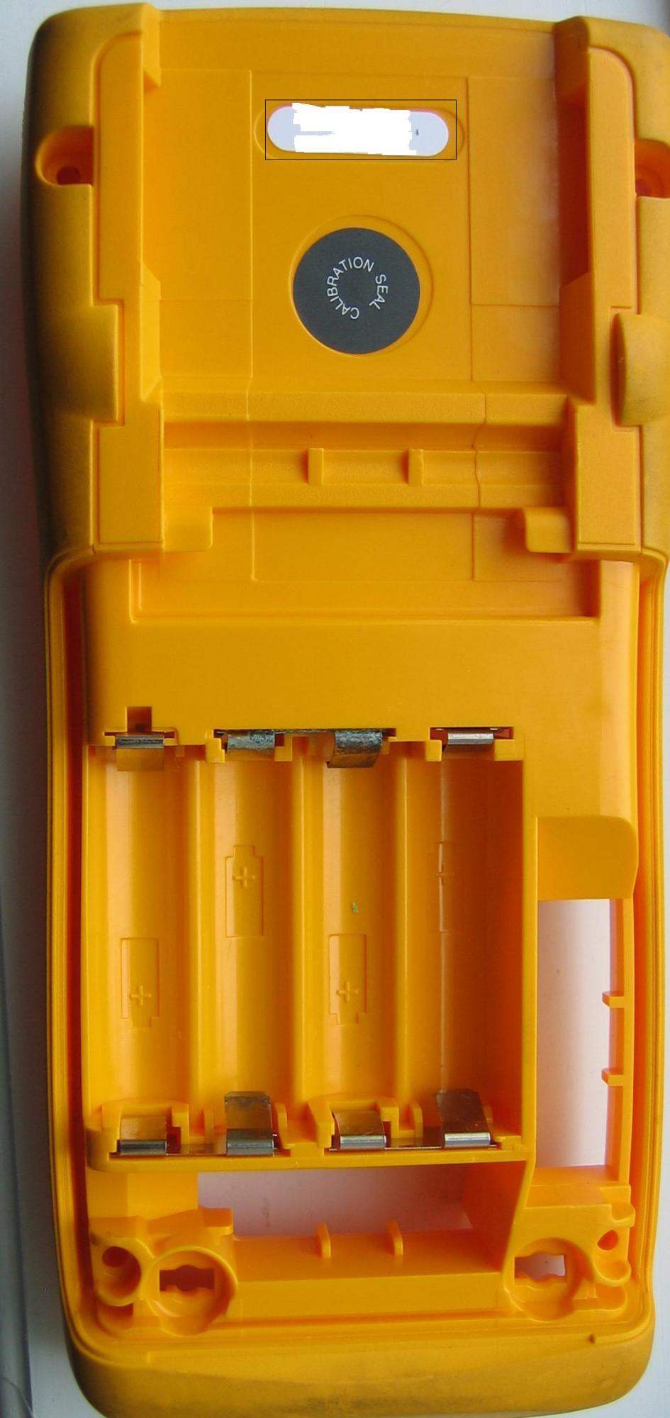

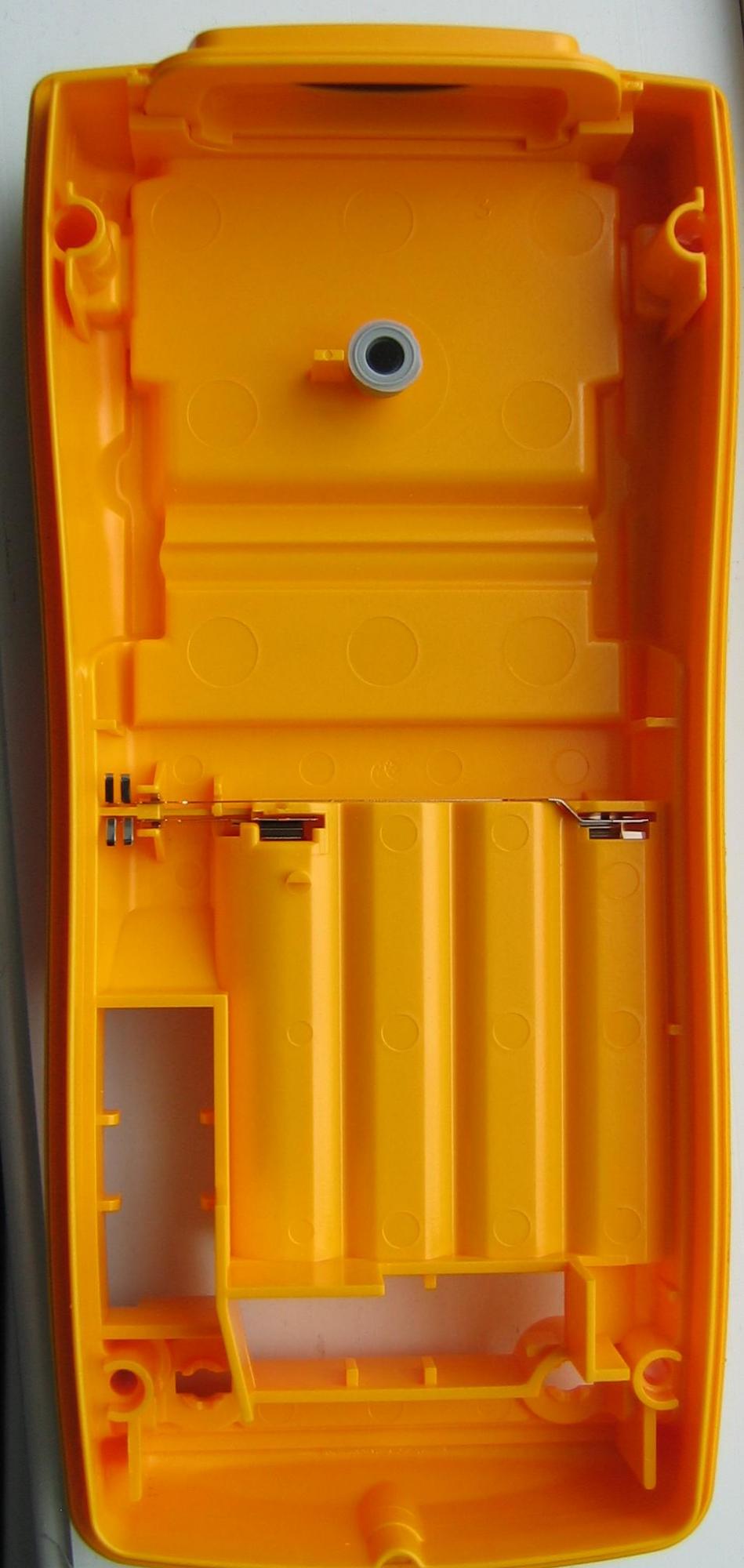

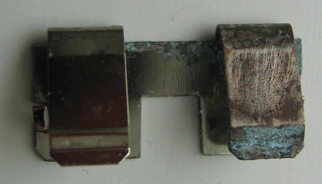

          Both of those battery contact strips are removable. There may be a little tab that needs depressed or rebent to provide tension again when you reinstall them. Pull them off, agitate the plastic casing in hot detergent solution and briefly scrub with a toothbrush, rinse, shake remaining water out, and air dry.
          Probably was alkaline batteries that leaked, you could try applying a mild acid to the contact strips then polish the metal with a toothbrush and metal polish or use fine sandpaper. As a last step if you happen to have any, you could very lightly tin the contacts with silver solder, though if you apply too much they won't fit back in the casing so in the worst case just heat the contacts and fling excess solder off while molten. Retinning the contacts isn't really necessary but it may be a longer lasting fix that way as the bare metal can oxidize again.
          Depending on the contact size and perhaps your ability to whittle, you might be able to get replacement contacts to fit. Either contact Fluke to see if the parts are available or places like Digikey have a few random styles though I don't know which are most compatible.

              I didn't know replacement parts existed, but Excavatoree over at eevblog mentioned they were available.
              However, they are $9.56 EACH (ripoff).
              http://www.ebay.com/itm/370609154201
              The seller also doesn't ship outside USA.
              So I will look through digikey for a possible replacement.

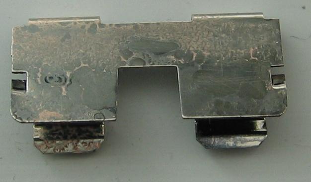

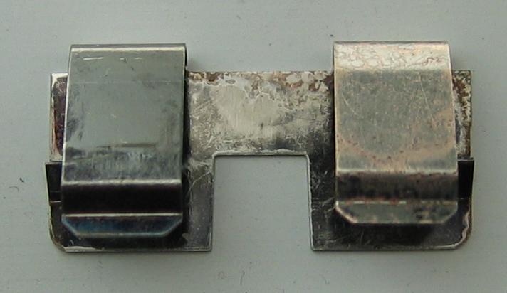

                So thanks to all the helpful suggestions and comments, I ended being able to get the contacts out thanks to a-fluke's ebay auction photos. I couldn't see the "hidden" tabs late last night and it has been cloudy all day.
                I was able to get the worst corroded contact out without any damage and let it soak in vinegar for about 1 hour. Then I neutralized it by adding baking soda and let it sit for about 30 minutes. Then I gave it a wash with tap water (I don't have any distilled at home).
                Here is the result. Do you think it is the best I can do given the tools (vinegar, baking soda, toothbrush)?
                I wasn't able to remove the other not so badly corroded contact for fear of damaging it so I left it alone and tried my best to use a toothbrush/q-tip.
                PS. I have a reminder now to check my batteries in all my multimeters every 6 months.
                  I would definitely hit them with some emery cloth or fine grit sandpaper or something to brighten them up a bit.
                    Personally I always use mechanical means (scrape with a blade, then fine-grit sandpaper) rather than chemicals.
                      That is pretty good clean up jobs, may be you can coat it with Silicone grease.
                        They are clean enough except that I would use mechanical means to further clean the area of contact with the batteries like very (VERY) fine grit sandpaper then a metal polish. Same goes for the contact(s) still in the meter housing.
