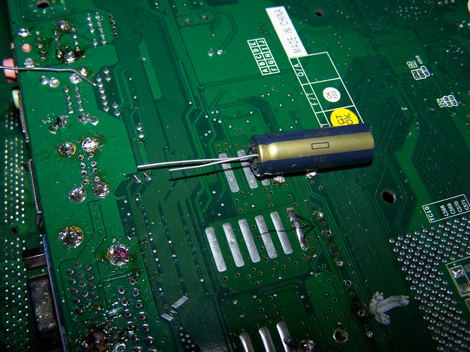

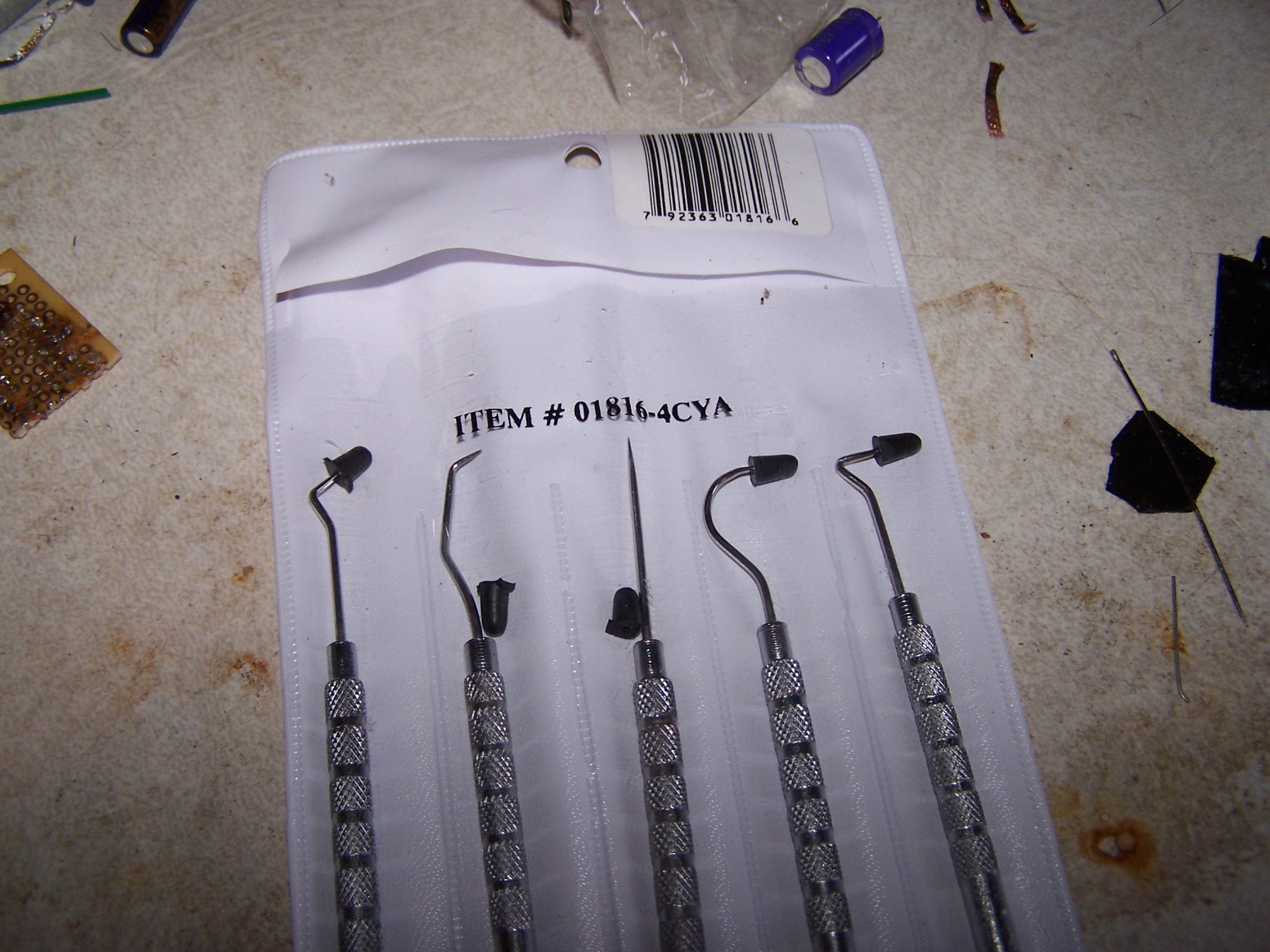

Today, I found this at harbor frieght:
They also happened to be on sale this week... $2.99 instead of $4.99

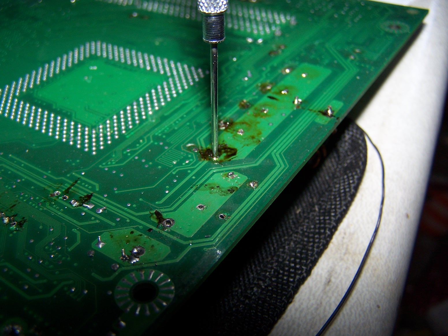

Logically, one would aim for the striaght pick:

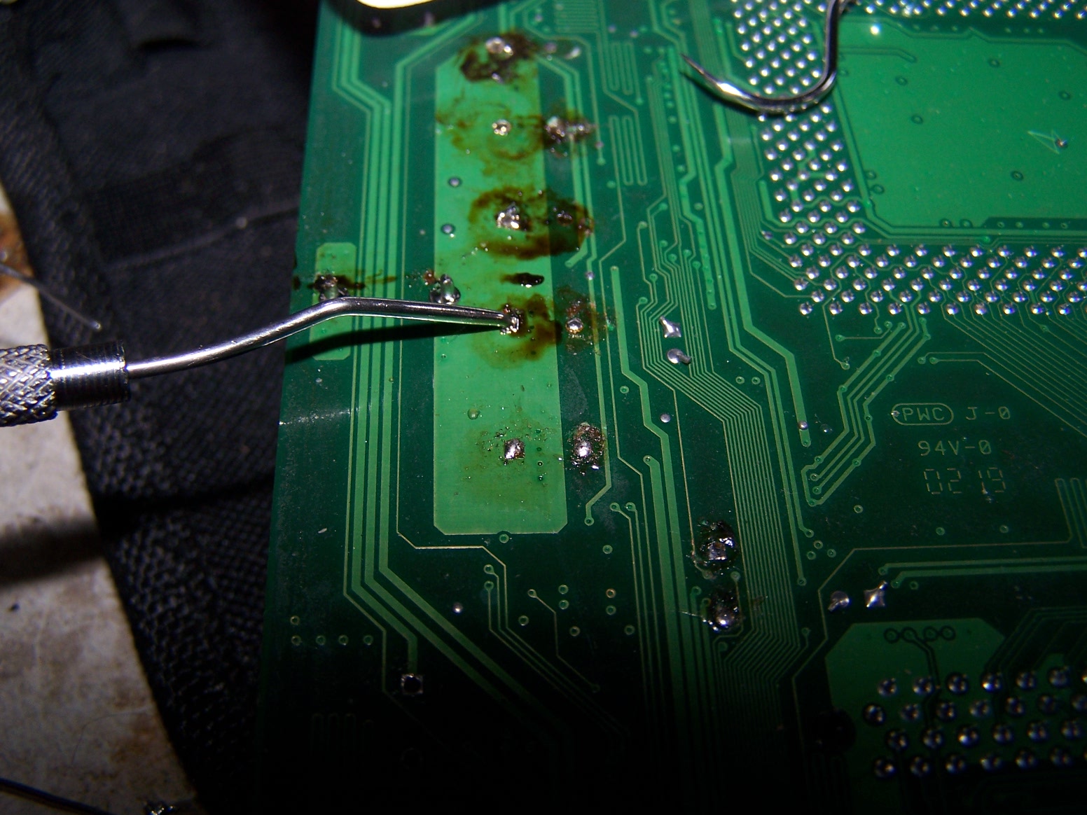

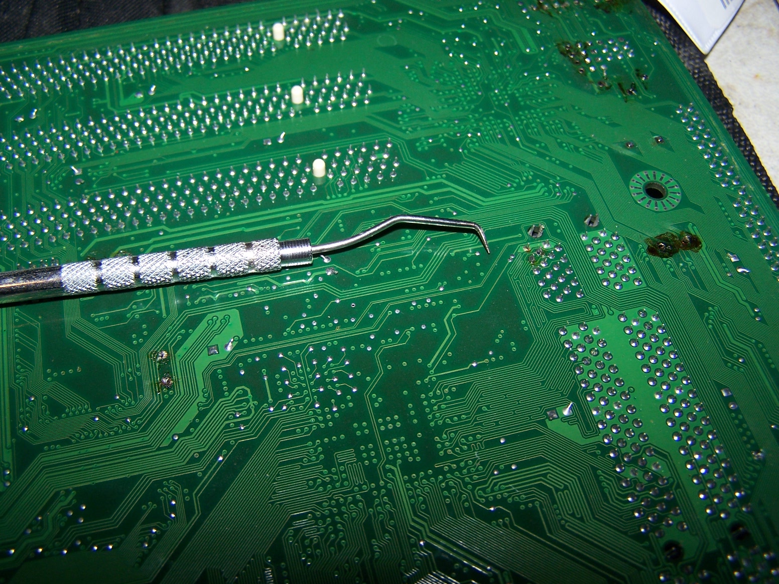

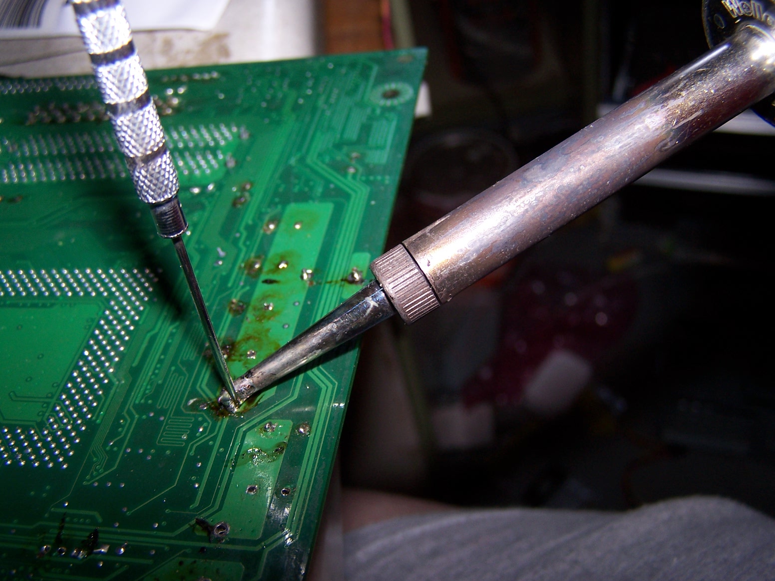

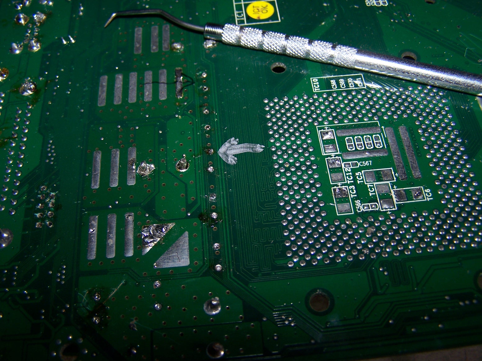

Which can be used like a dentist's pick:
... But on most boards will not go all the way through:
This is a problem... It makes it easy to accidentally push out the hole liners, which can kill a board.

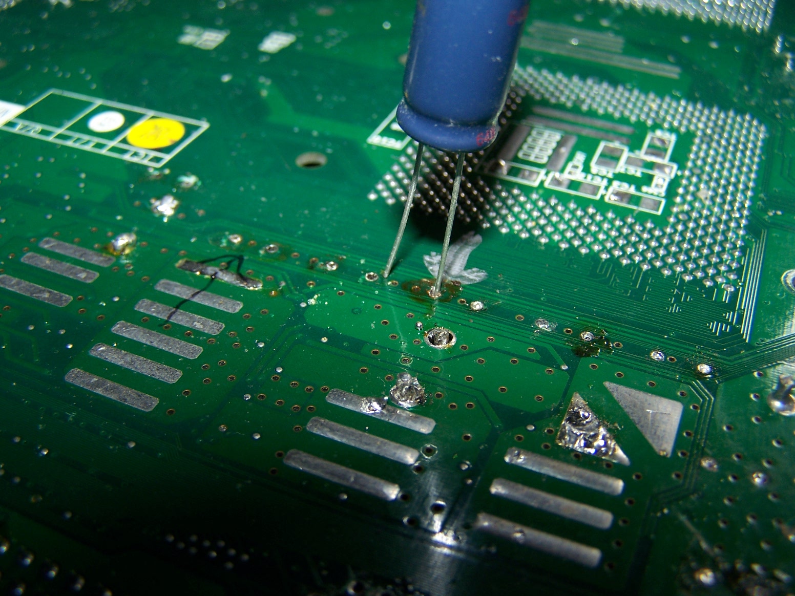

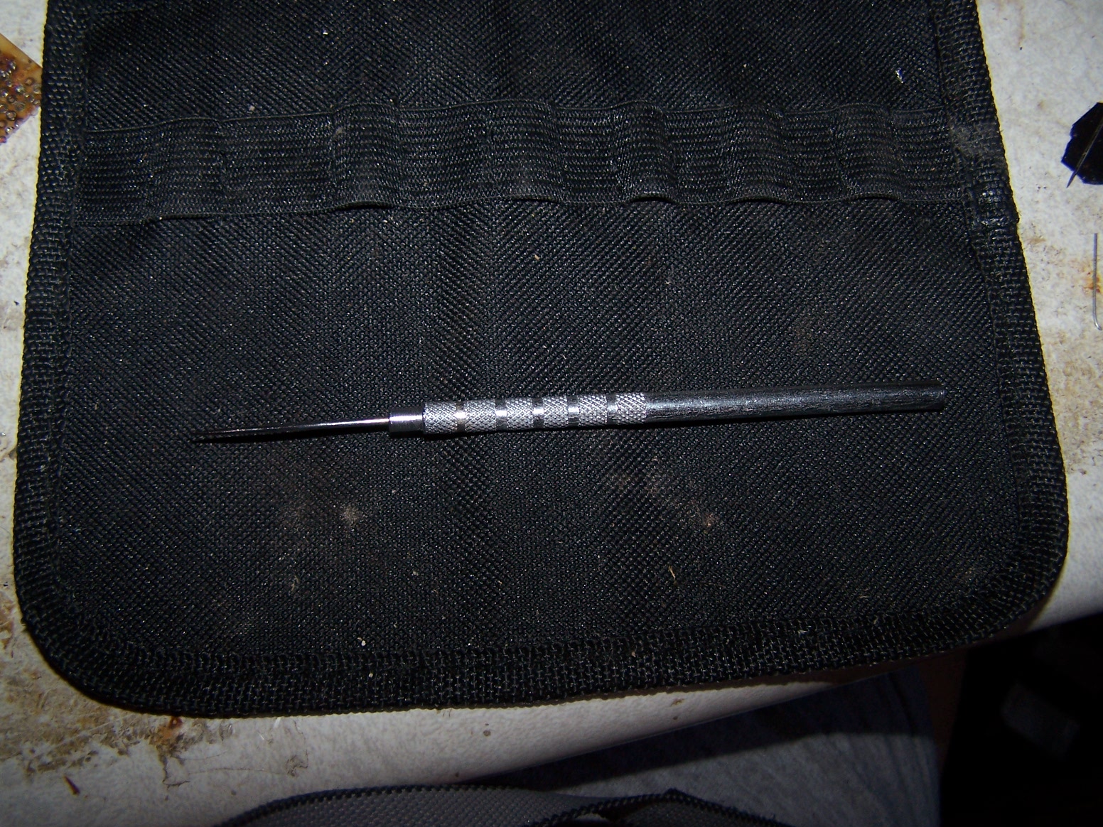

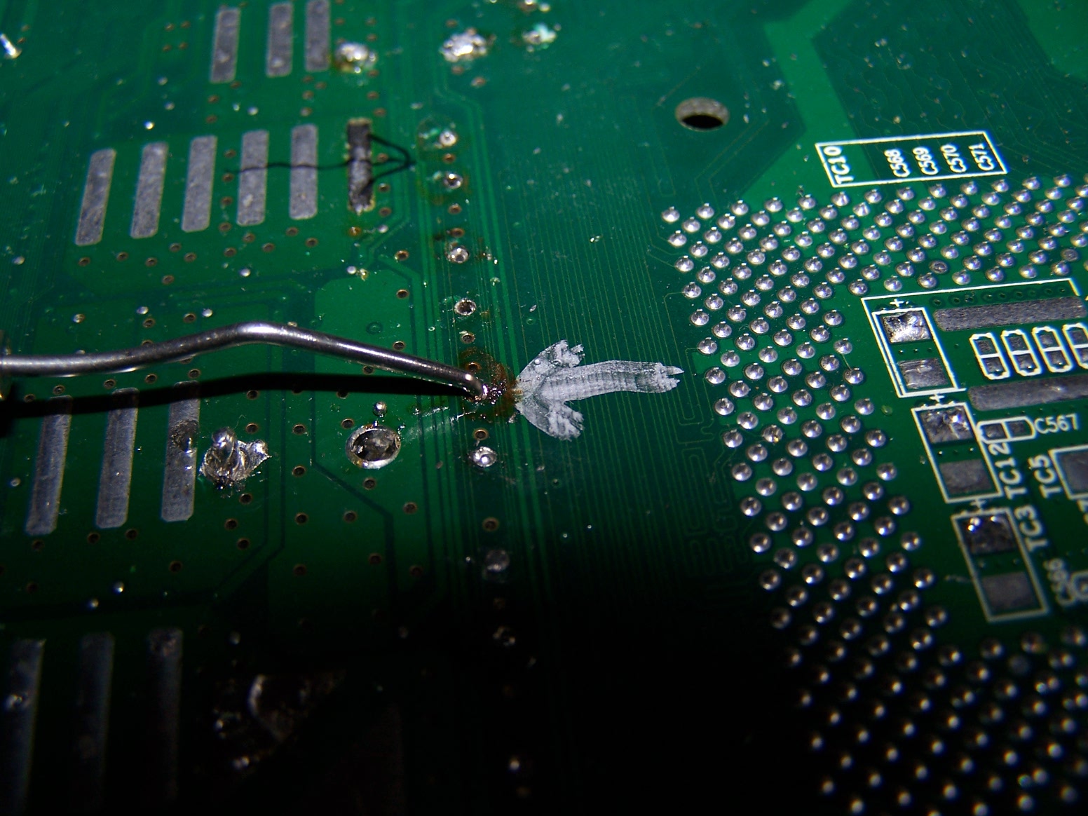

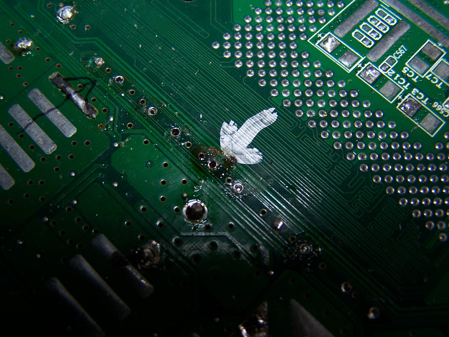

However, the other picks work better on small holes, this one especially:
In addition to having a seemingly more gradual taper, they also prevent pushing too far:
The other non-straight picks also work to varying degrees. The straight pick also works well on larger holes (like on modern dual layer PSU boards).
I thought I would let the community know that this exists... heck, they work better thent he electronics soldering picks a few Aisles over. They also are a lot easier to come by than dentist picks, which can be hard to source locally.
Comments?
