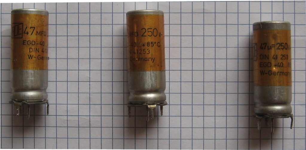

    I've built the ESR meter that I found at this address.
    My digital DC Voltmeter got no button to set ZERO volt on display, so when I supply the 555esrMeter the two boundaries are:
    No cap at test point = 1.355V
    Shorted test point = 0.069V
    The fine adjust sensitivity 1 V/ohm is not working properly in my circuit so please don't think the value is the real esr in ohm.
    I've tested over 100 different electrolytics with this circuit, but I don't understand how much reliable this meter could be.
    For example: I've tested these 47uF electrolytics:
    [year 2011, new] Sanyo ME AX 47uF 100V = 0.108
    [year 2010, new] Yageo SEK 47uF 250V = 0.226
    [year 2008, new] Jamicon TK 47uF 63V = 0.182
    [year 2002, used] Lelon RGA 47uF 50V = 0.200
    [year 1991, used] Rubycon CEW 47uF 100V = 0.208
    Then I take 3 Roe electrolytics, 47uF:
    [year 1987, used] ROE EGD 47uF 250V = 0.082
    Could it be? After 24 years they are better than a modern low esr 47uF electrolytic such as Sanyo?

    May be partially shorted.
    Same condition as causes excessive leakage current.
    Do they show the same [or at least low] ohms without the ESR meter?

        In reading elsewhere those are audio caps and they are Low ESR.
        They are rated at 100Hz and 10kHz though so I dunno what it should be at 100kHz.
        Couldn't find your value but here's one from same series:
        250v - 220 uF - 25x45mm
        tan δ 100 Hz MAX.: 0.07
        ESR @ 100 Hz (Ω): 0.505 Ω
        Z @ 10 kHz MAX. (Ω): 0.195 Ω
        IR 100 Hz TUC (A): 1.075 A

          These caps were placed after three diodes that rectifiers the voltage coming from the secondary winding of the switching transformer in a colour crt tv.
          The bottom gaskets are in very good condition and sniffing at the bottom they don't smell, so I'm going to reuse these in the tv because for the moment I can't find nothing better.

                            The higher the voltage of an electrolytic capacitor (given the same capacity) the better the ESR will be.
                            So you cannot really compare ESRs of a 50V and a 250V cap.
                            0.082 is not too far from the Sanyo 100V with 0.108.
                            The Yageo would be comparable voltagewise but I assume the quality of the Yageo isn´t very good.
                            ROE by the way stands for "Roederstein" a German brand.
