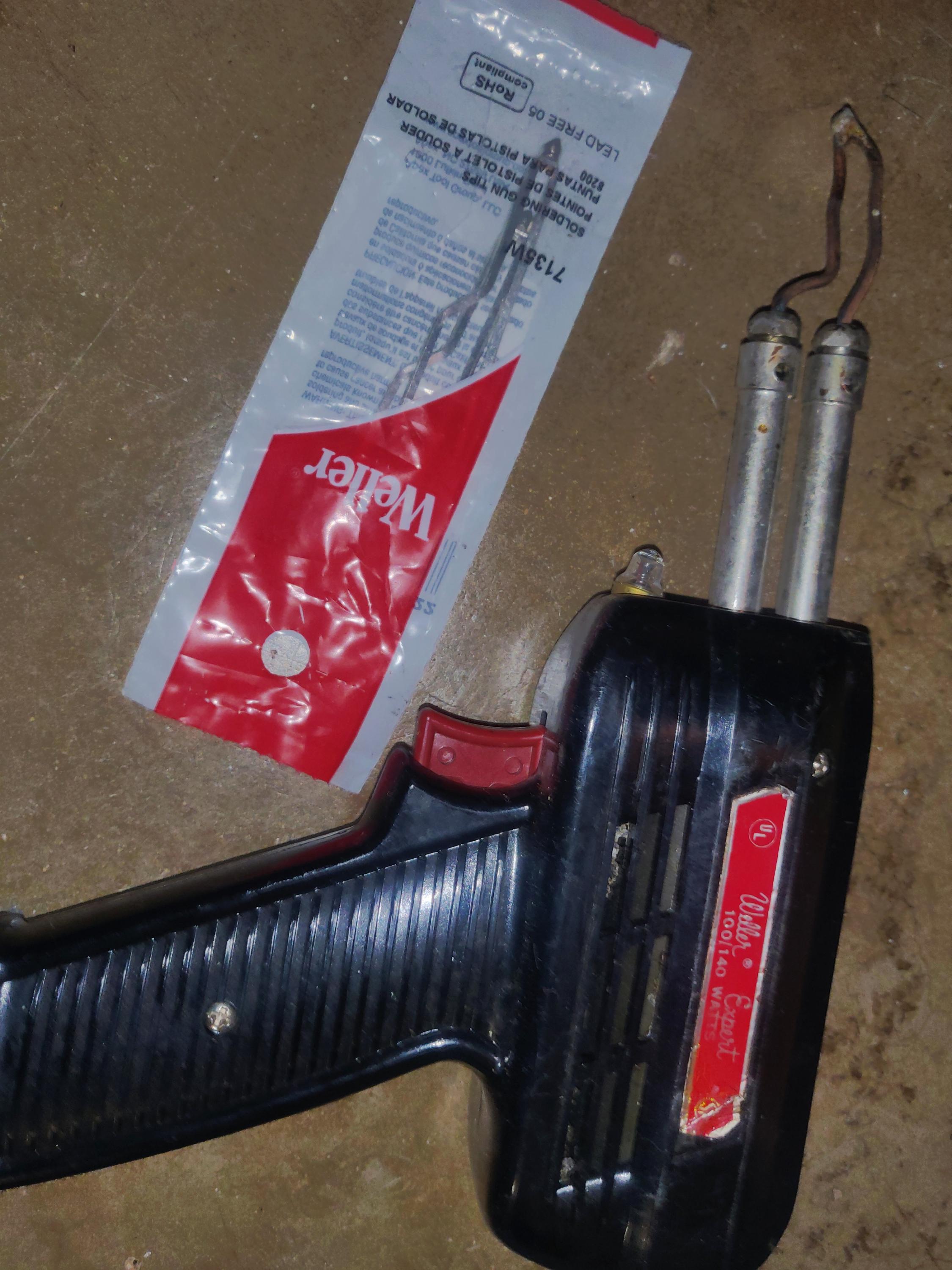

    Someone gave me two of these 100/140w weller soldering guns. Yes, I know it runs current right through the tip, but might be nice to really get some heat into some big wires that need to be soldered.
    So, worth a place on the bench, or chuck it?

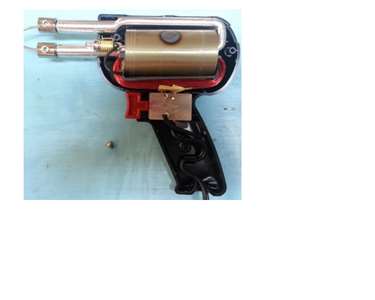

                          You don't keep power on constantly with a soldering gun - the tip heats up hotter and hotter and eventually overheats. So it is customary to pull and release the trigger every few seconds as you are soldering. Weller tips have a big copper end with lots of thermal mass, so it stays hot for many seconds with the trigger off.
                          For melting or cutting plastic rope, you are the man doing temp control lol.
                          They also have a duty cycle rating of 2 min on/5 min off or something like that.
                          This is how we soldered with them, when dinosaurs roamed the earth lol.
                          Don't forget to tighten and re-tighten the nuts to clear up oxide and any poor connection.
                          The little #222 incandescent lamp also shows secondary voltage (I think) and should not flicker or go really bright - it reveals a bad tip connection. It's a 2.25V 0.25A lamp.
                          No back-EMF (trigger-off, or power-step down) due to the secondary having a short as a load- assumes a perfect transformer with no flux leakage or air gap, all the magnetic energy in the core, from all of the winding.
                          But this is a half pop-can winding, like an I-core. There should be no spark across the switch when triggering off or down power... but... there is.

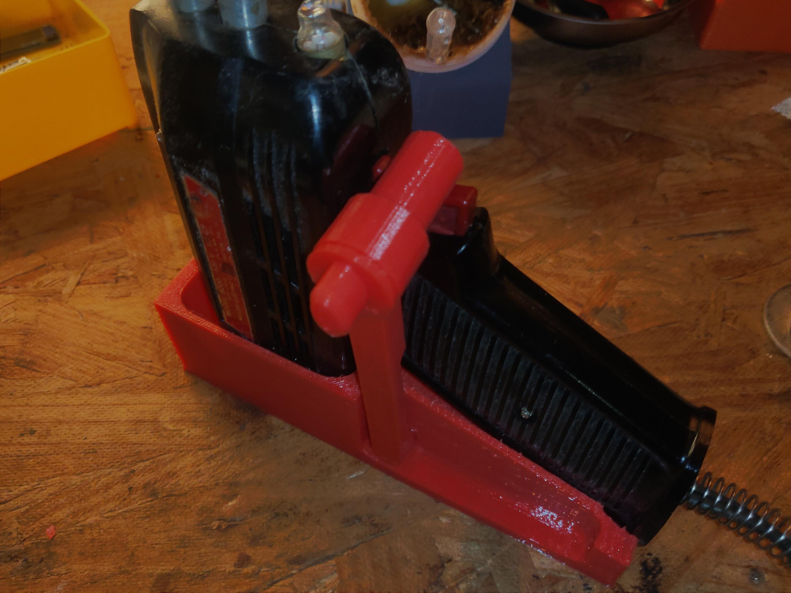

                              Printed a stand with a trigger hold down bar. The stand seems firm, Ithink the trigger hold down bar could use some tuning, both for functionality and also for printability.
                              (not my design, btw)
                              https://www.thingiverse.com/thing:3812661

                                interesting, might have to print one...I always have to put the gun top down, as it seems to hold up the best without a stand that way and most likely keeps the tip from touchdown.
                                Incidentally are all versions of the 8200 physically the same? I know some of them have different triggers - where if you half pull is 100W and full pull is 140W, and the other version is 140W half pull and 100W full pull?
                                There's the 8200, 8200N, and the 8200PK? Some seem to use set screws, and mine uses a hex nut. Heard the hex nut ones are easy to strip, so it's not as good...or is it?
                                BTW yours looks like it has a #222 bulb, mine and the one in the thingiverse photos have the unfocused bulb...

                                  I can't say if that bulb was stock, these irons have truly unknown provenance, they could have come out of a trash can.
                                  I took a closer look at my other one, and wow. No bulb, looks like the top had been broken off at some point, and somone spilled black epoxy all over the top to keep it together. If I disassemble one to make a permanent handleless bench top iron, it's going to be that one.
                                  Before I do anything rash, has anyone ever needed to dual wield two soldering guns? 140w seems like it would do nearly anything I could find myself working on.

                                      Just a note regarding your trigger hold down. These soldering guns have a 1:4 duty cycle, 1 min on, 4 min off, just something to consider.
