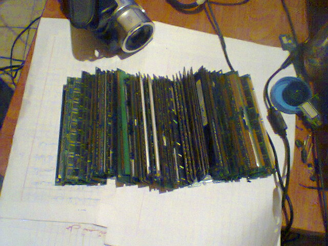

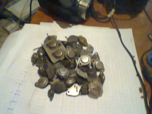

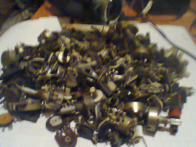

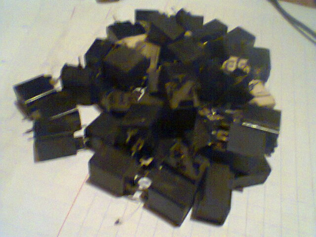

                                        Re: Benchtop Power Supply Question
                                        Originally posted by sam_sam_sam
                                        Interesting
                                        Enjoy these gems ...
