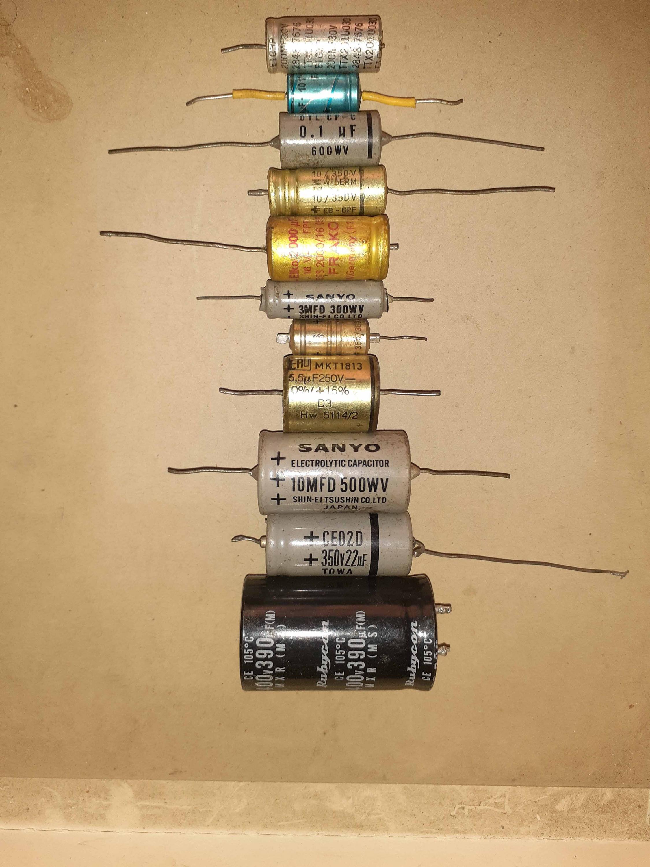

        I have almost finished a diagram's prototype for the laptops PSU project . So far , my choice went for a parallel series of LM338 , backed up by parallel diodes as illustrated in an image previously , while leaving a chance for additional ones , as necessary . Right now , I estimate LM338 power at 5A maximum , to stay on safe side , and for each another 5A , I'll add another one ..
        When the project is finished , although the delays and distractions were more than to count , It will be available only for some particular friends , and through PM's .
        In the meantime and for the people who liked my backups parts , my Sony Cam is back on line after some repairs , so I may re-post the previous images which were very bad , and yet , you know there are some size limits for uploads , so I'll resize them in PS as necessary .
        Here's a sample of my vintage capacitors .

          that picture looks like my dustbin after a repair
