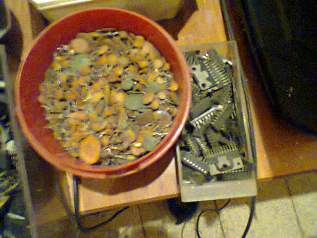

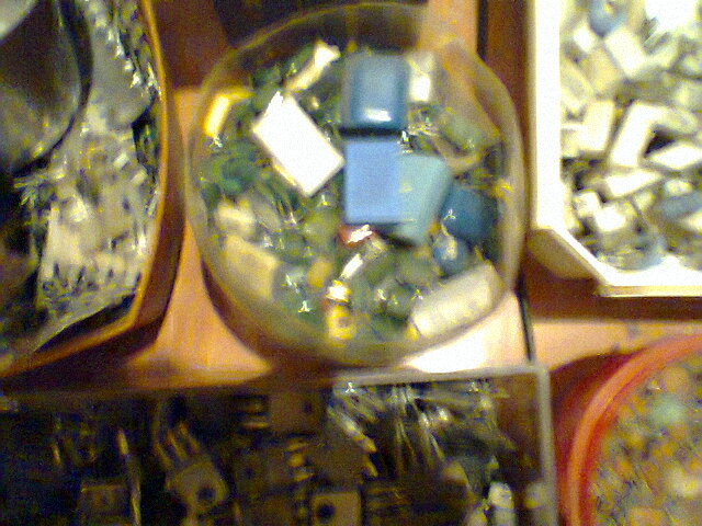

                            #33
                            Re: Benchtop Power Supply Question
                            Like I promised , some examples of my backup parts
                              • Jul 2011
                              • 6065
                              #34
                              WOW How often do you used these reclaimed parts in your projects

                                  • jiroy
                                    • Jun 2016
                                    • 2416
                                    • Lebanon
                                    #37

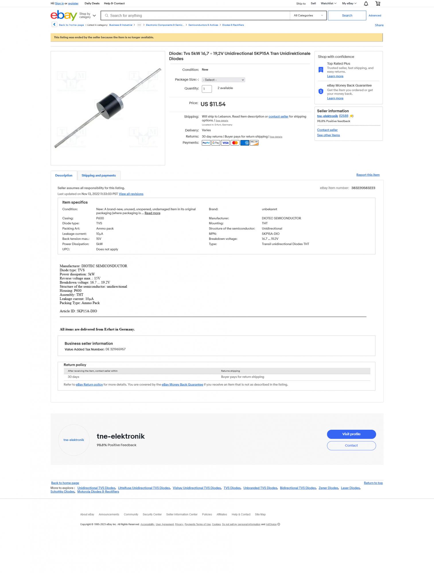

                                          So far , I've finished the over-voltage timer , and looking to start designing the main board .
                                          Till now I've decided on one winding DC part (low AC) with one tapped center , despite that two windings are better for noise and easier repair . Anyway , I won't wind it until I finished designing the whole circuit , including protection ones . It's the preferred method anyway to work it in reverse , since it will be decisive in core's calculation .
                                          Right now , I'm studying the different options of diodes or rectifiers ..Attached some of the primary ideas , but nothing decisive yet ..
