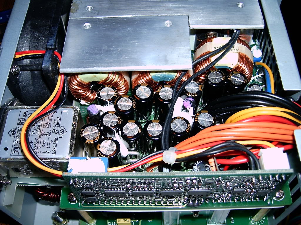

                            • acstech
                              GrumpyModerator
                              • Jul 2007
                              • 1432
                              Re: Can PSUs Cause Bad Caps?
                              Yes, it does have open holes on every rail, even ground. I added 2x PCI-E 6-pin power connectors to mine to run an 8800GTX. It runs that, an Intel QX9650, a P45 board, and 3 hard drives all very well. I've even measured ripple with an oscilloscope and it stays within spec even in a running computer (running 3dmark).
                              I'm of the opinion that the AcBel will fulfil the requirements of 98% of the computers out there, if you're willing to do a little soldering.
                              I have pics that I took a while back that I can post if anyone's interested. I think that was before the PCI-E connectors though.

                                I never saw the big attraction to the ACBEL API4FS06.
                                They are cheap but only ~70% efficiency, have craps [usually OST], and look like a they are a bitch to recap.
                                To recap you need:
                                8 - 3300uF @ 10v - 10x25mm
                                6 - 2200uF @ 16v - 10x25mm
                                3 - 1000uF @ 16v - 8x20mm
                                That shoots any initial purchase savings all to hell.
                                Lately for regular PC's I pick up used Earthwatts and recap them.
                                [Never actually found blown caps yet, just craps I don't like around.]
                                Easy to recap and 80+ efficiency.
                                Used 550w can be had for $20-$30 [including shipping] on eBay if you aren't in a hurry.
                                I've gotten a few 650w for $30-35.
                                I do have a lot of lower efficiency FSP, Delta, older Antec, HEC, and so forth sitting around that are fine [good caps as original or recapped] that have been replaced by 80+ units.
                                The servers use Corsair 750-850 watt units.
                                [Although that's probably overkill for all but one of them.]
