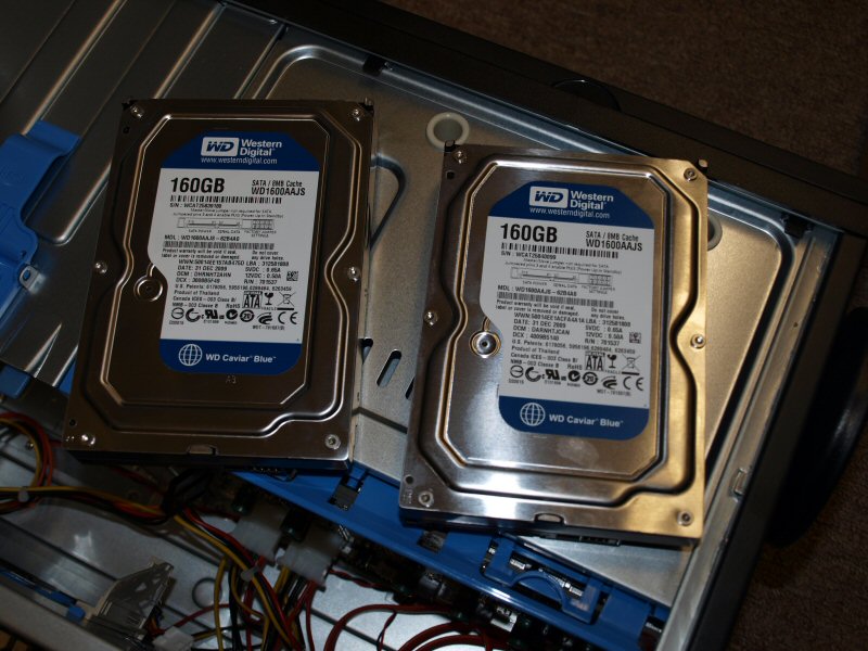

                    I assembled the system last night. I used those 2 WD Blue 160GB drives in a mirror for the OS. The 3ware controller likes them, so atleast they won't go to waste.
                    I ran into one hitch though......When I was installing Windows, it would boot from the CD, get to the point of 'starting windows', and then BSoD with a strange error of "MACHINE_CHECK_EXCEPTION".... I've never in all my years seen that one..... Long story short after googling possible solutions for a couple hours.... Apparently AMD chipsets for this platform can not run more than 6 ranks of RAM at DDR400 speed. To test this, I removed 4GB of the RAM, for a total of 12gb, windows installed without a hitch. If I slow the RAM speed down to DDR333, it runs perfect on all 16gb, so the information I researched was accurate. With 16gb, that makes 8 ranks, 12gb is 6 ranks....so I have a choice, I can run 12gb @ DDR400 or 16GB @ DDR333.... I haven't made up my mind how I want to run it yet....

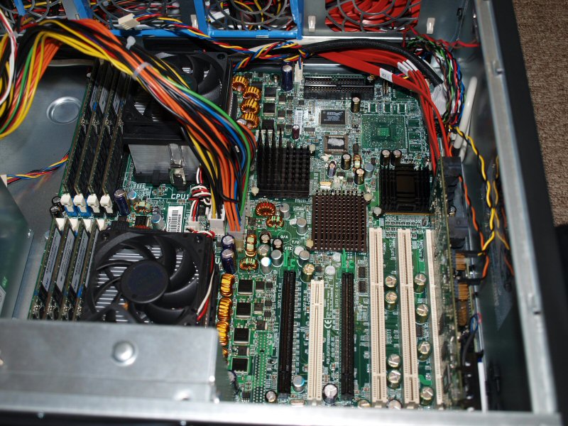

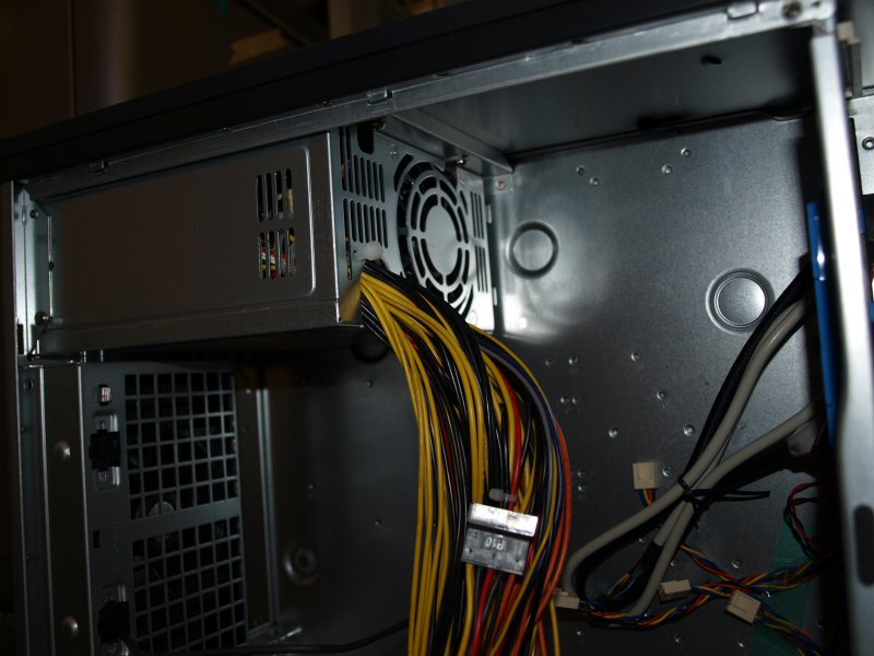

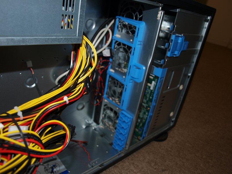

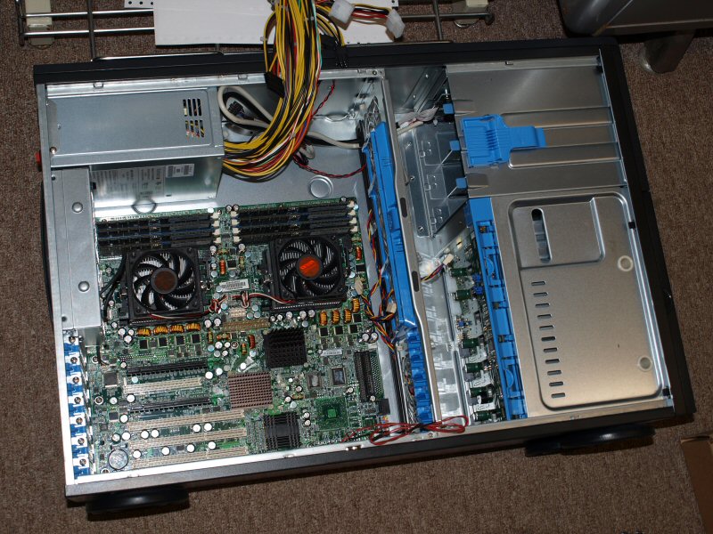

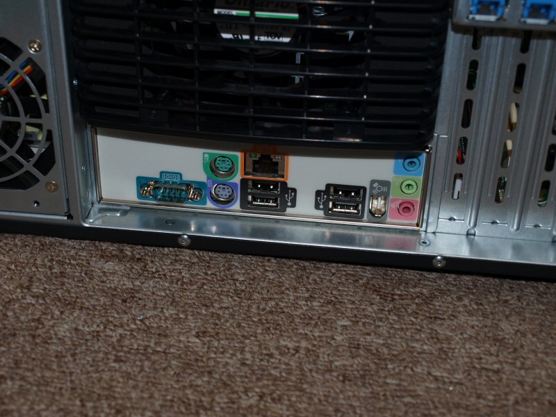

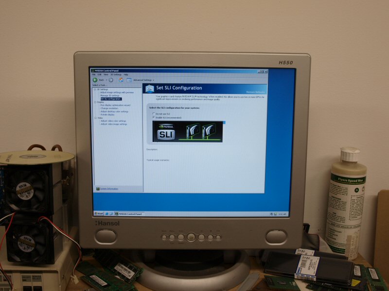

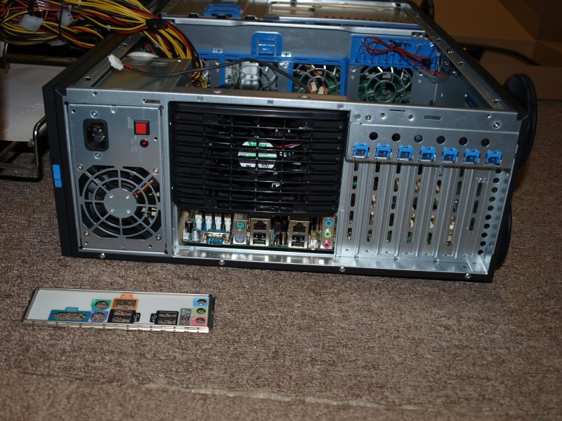

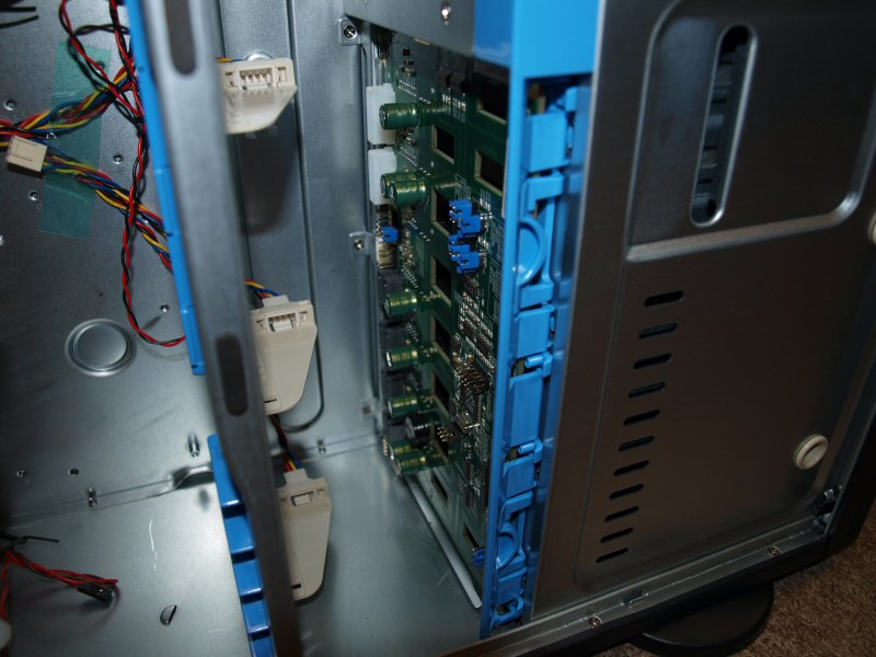

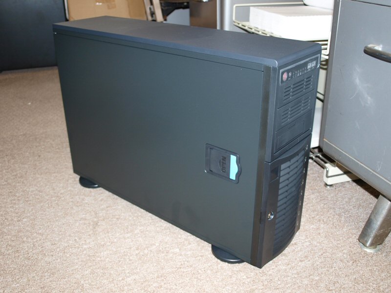

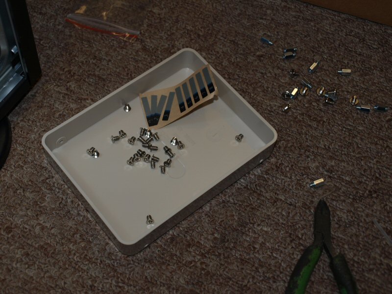

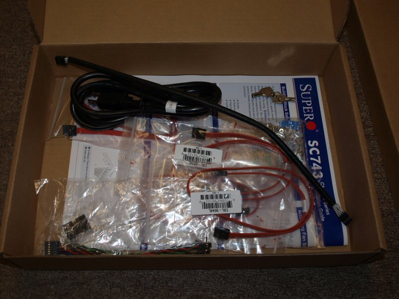

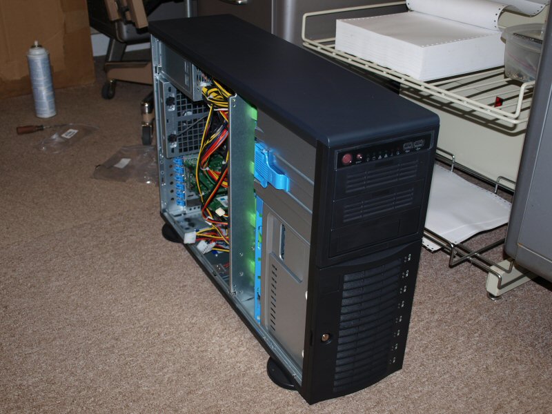

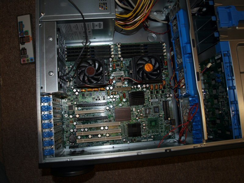

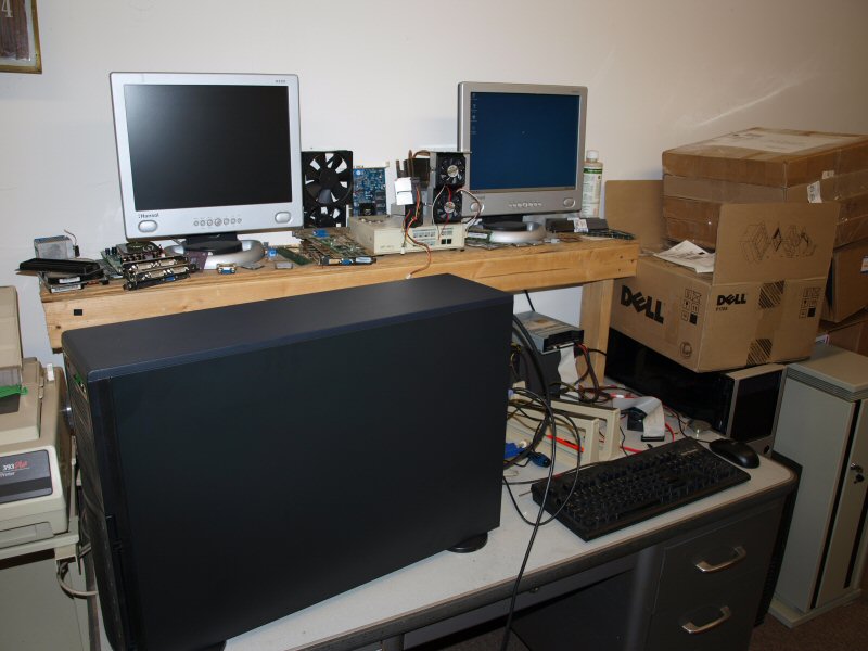

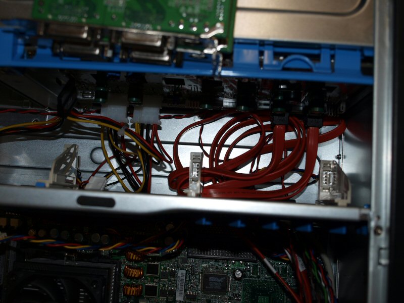

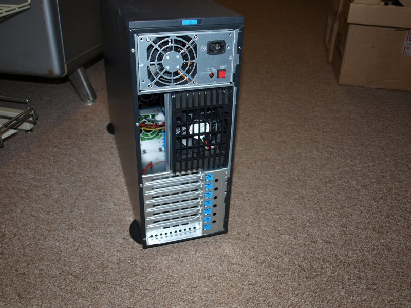

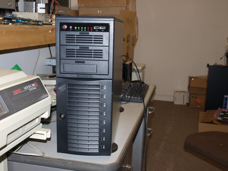

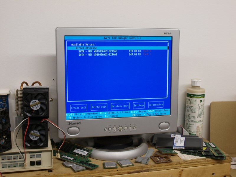

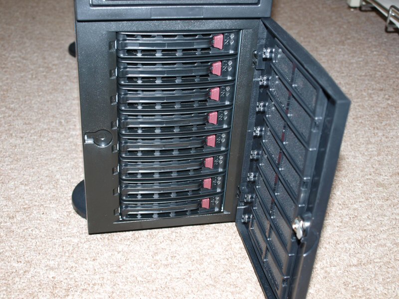

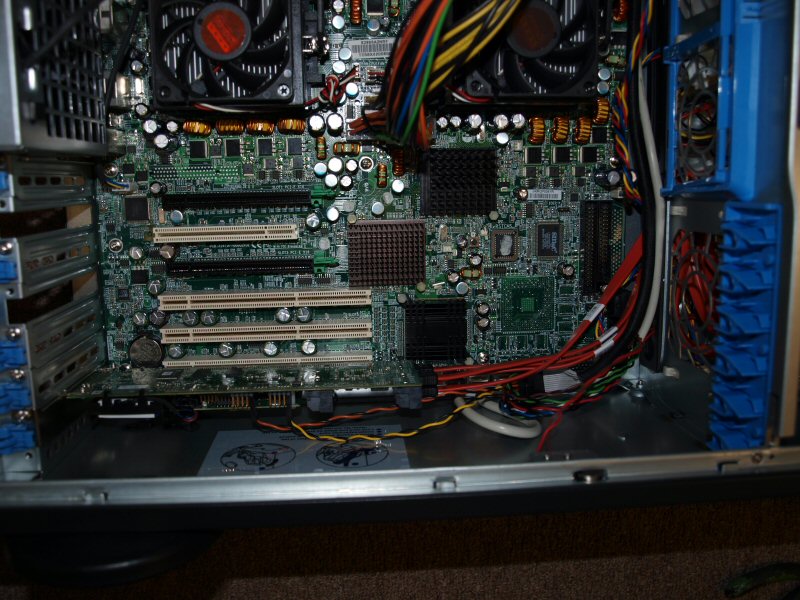

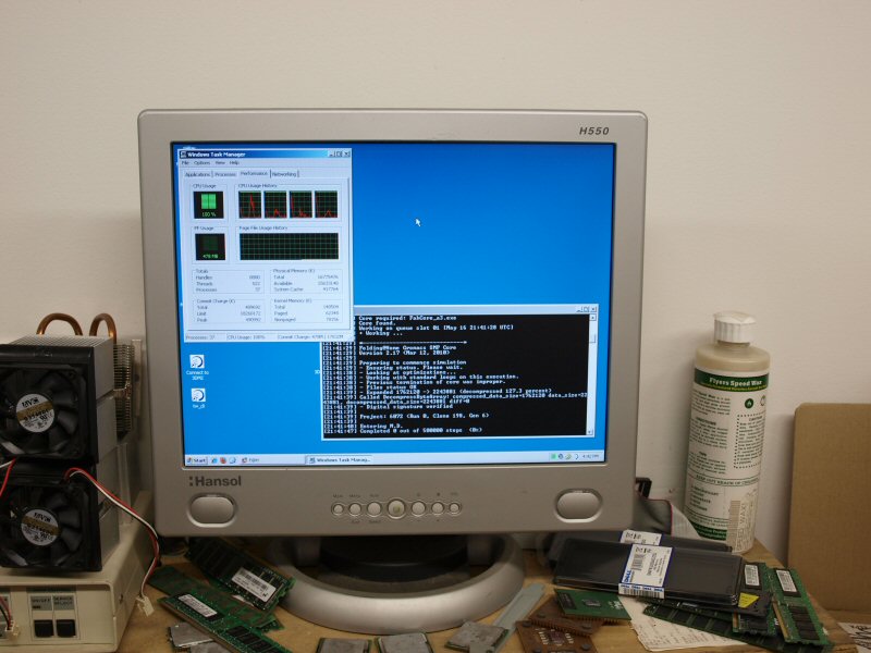

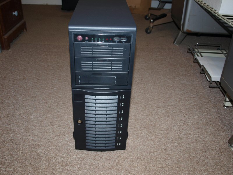

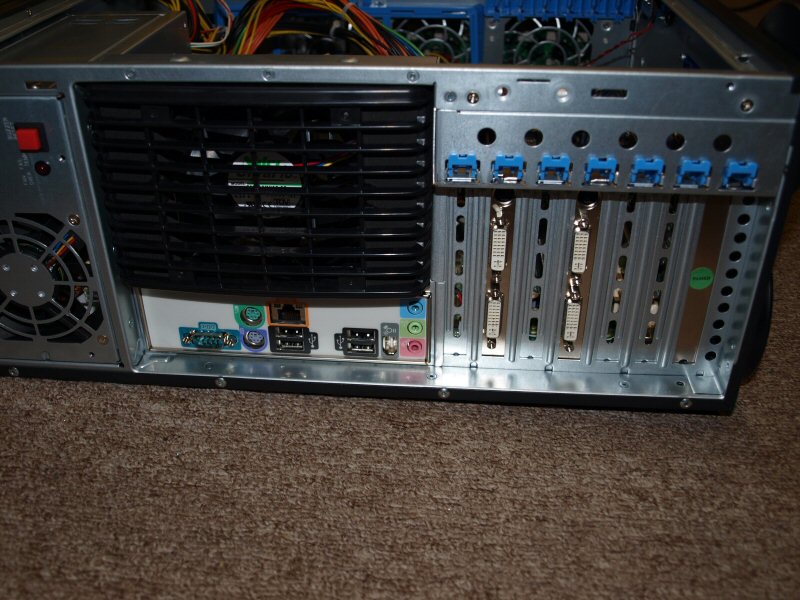

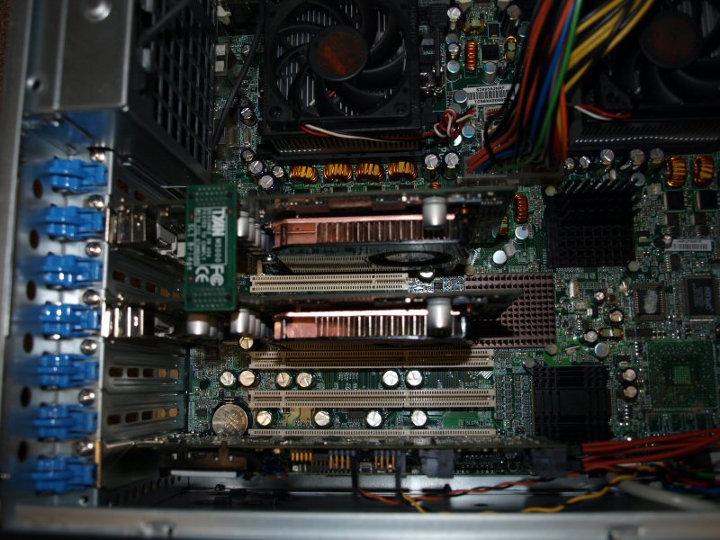

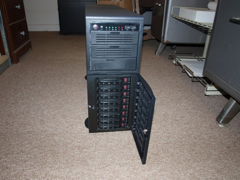

                              The last round of pics.......I hope nobody is on a dialup...... I removed all the motherboard heatsinks and scraped off the crusty heatsink compound and replaced it with fresh goop. Did all the final testing, and away I went!
                              The case has been waiting patiently for a couple weeks...
                              A few shots of the case itself:
                              SAS Backplane from the back side:
                              Midplane with 4x 80mm fans:
                              865W Supermicro PSU:
                              Box-o-goodies:
                              Motherboard test fit & standoffs mounted:
                              Motherboard installed and mounted up:
                              3ware 9550 installed:
                              2x 7600GT's mounted:

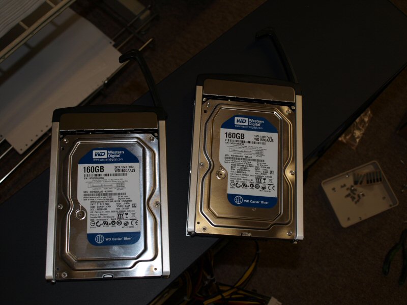

                              Those silly WD Blues that the GX620 and Imac didn't like:
                              Drives mounted in the SAS trays:
                              The SM "dummy drives" that come out of those SAS trays sure do make good screw holders:
                              Ready for the acid test:
                              It POST's:
                              3ware says hello to the Blues.....config'd in a mirror:
                              SLI Enabled:
                              Damn, that's a big case!
                              ....AND FOLDING AWAY! SMP client, all 4 cores in use. This should bump my PPD a bit!
                              It's running 16gb of RAM at DDR333 speed (see above post as to why it won't run all 16gb @ ddr400 speed). I may try 12gb @ DDR400 speed and see how it does for with folding....
                              This project is now coming to a close finally...........
