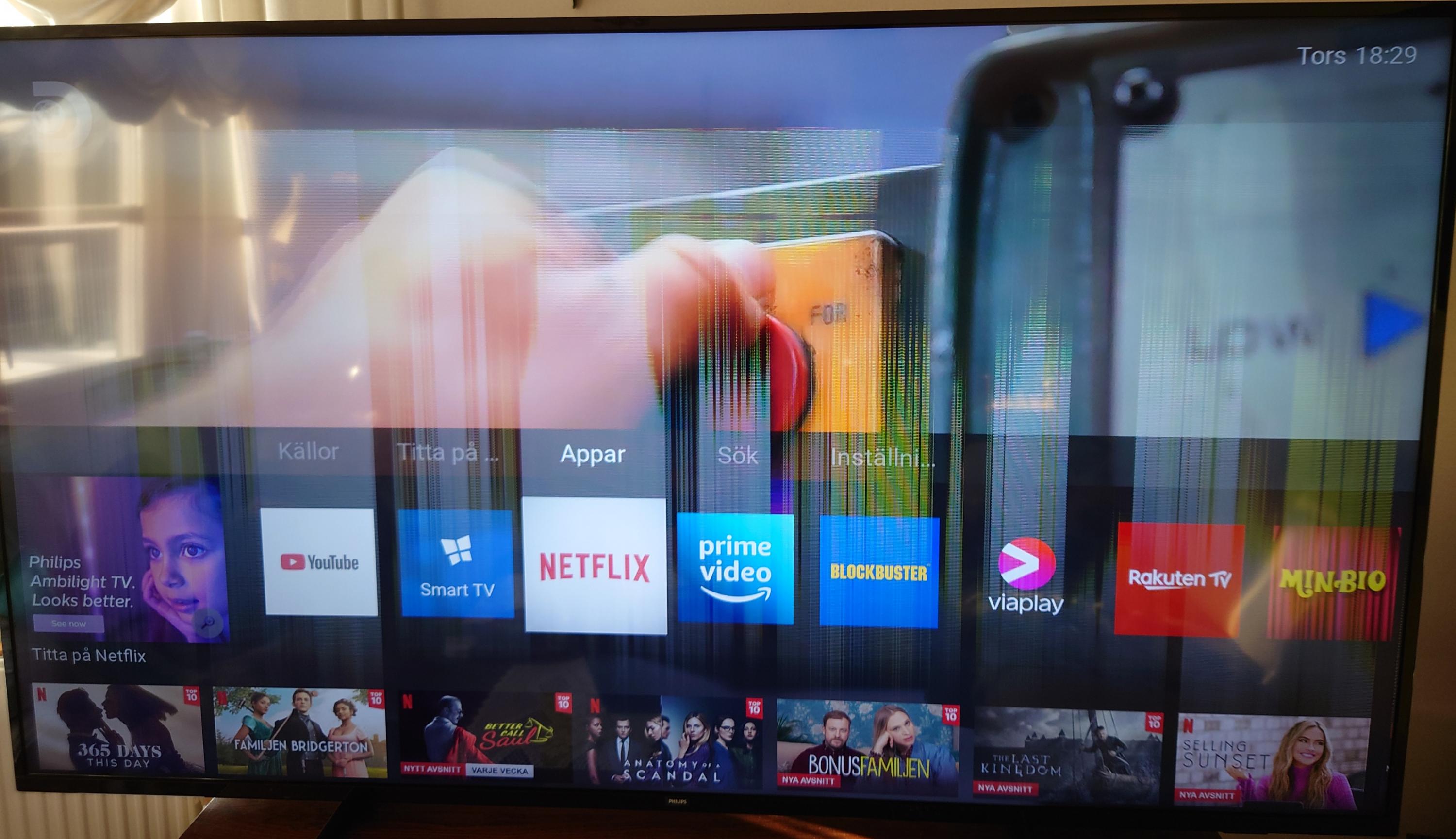

    My mother's Philips 70PUS7505/12 TV suddenly began to display this kind of behavior:
    Contrast differences from a light area to a dark area above, become "echoed" vertically upwards.
    It's the same behavior with all colors as long as there is a relative contrast difference between them.
    There are no other issues; the backlight works fine, the Error code buffer is all zeros.
    I tried it on each HDMI-input, the result was the same.
    I tried in another resolution, still the same.
    I tried with three different sources; tv-decoder, media player, laptop, no difference.
    I tried fiddling all the picture-related controls on the TV, but nothing had an impact on the problem.

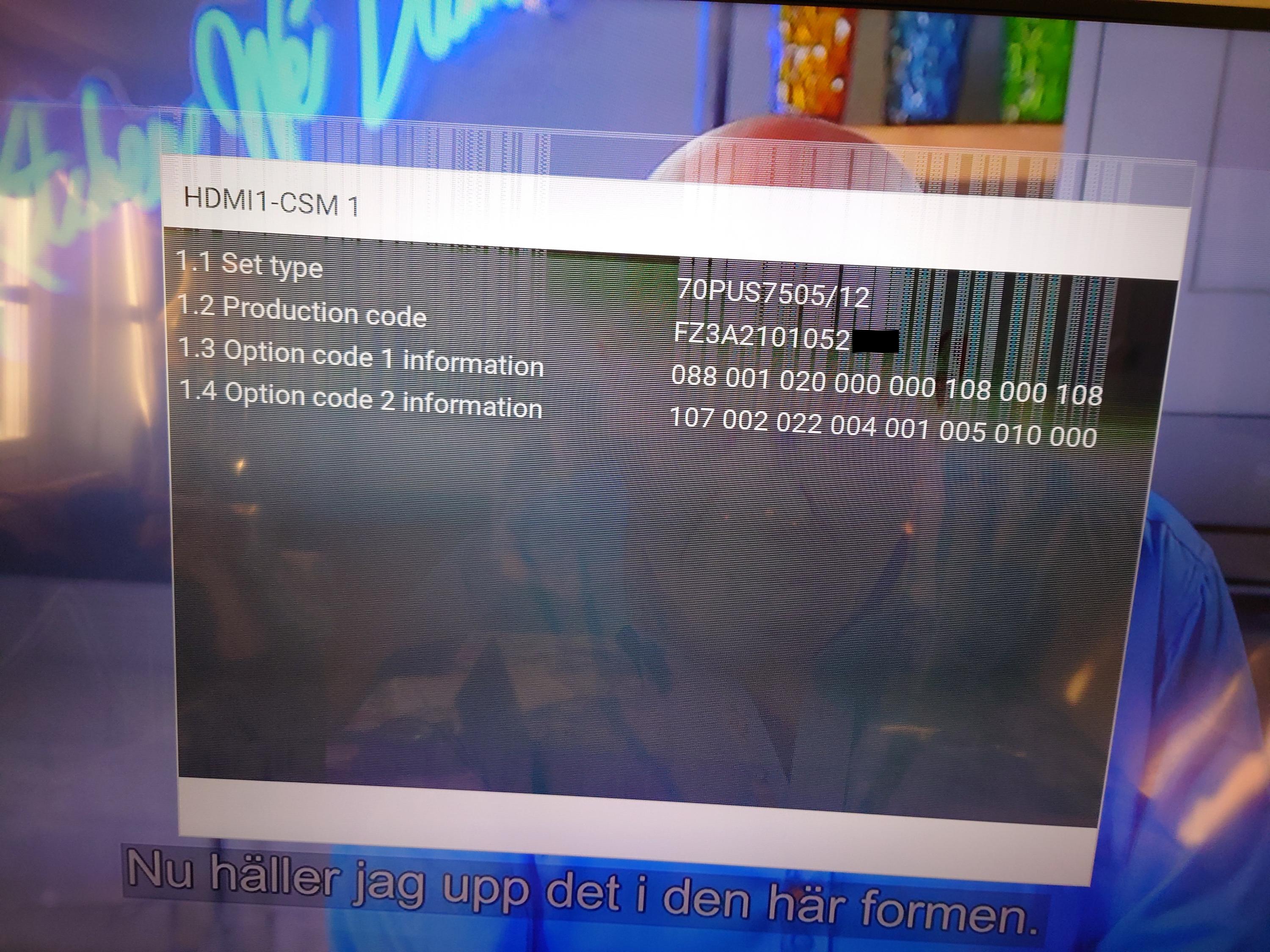

    The back label says:
    Code:
    Model:      70PUS7505/12
    Serial:     FZ3A2101052xxx
    Set Option: 016
    Chassis:    S TPN20.6E LA

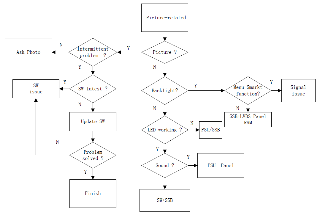

    The service manual is available here.
    The troubleshooting flowchart in the service manual shows:
    The flowchart suggests updating to the latest software when experiencing a picture-related issue which is non-intermittent.
    There was an update available, so I installed that but the problem still persists without any difference.

    first make sure your connections are secure and clean, ie tcon ribbon cables and lvds cable from mainboard to tcon, can clean with isoprophyl alcohol, some use a pencil eraser, not too vigorously they can be delicate, if no joy, something to try, may have to play with width and location of tape: https://www.youtube.com/watch?v=Jt4myvliNow

      it could be a bad tcon, if the above doesn't work maybe heat up the tcon board with a hairdryer then try tv, see if there's any change.

        Re: Philips 70PUS7505/12 - Contrasts in image are echoed vertically upwards
        Thanks for the reply!
        I contemplated something like that, but I was expecting the problem to be isolated to either half of the panel in that case.
        It's consistent across the entire screen, and there is no "glitching" in the artefacting, it's completely static and only follows changes in the video source.
        So the artefacting is completely still when the video is not moving, for example in menus.
        But this type of problem in the T-CON can appear in this "static" way too, you say?
        I remember reading a comment some time ago about what the tape-solution does, if I recall correctly it's a matter of feeding power simultaneously from both ends of (vertical?) lines across the entire panel to power the LEDs on those lines.
        If there is a problem with the power output from one side in that it can't maintain the voltage or supply enough current, this affects the entire line with interference.
        The tape is then used to mask away the power delivery from the detected bad side, so that the good side can supply power to the entire line without interference.
        Is my understanding correct?
