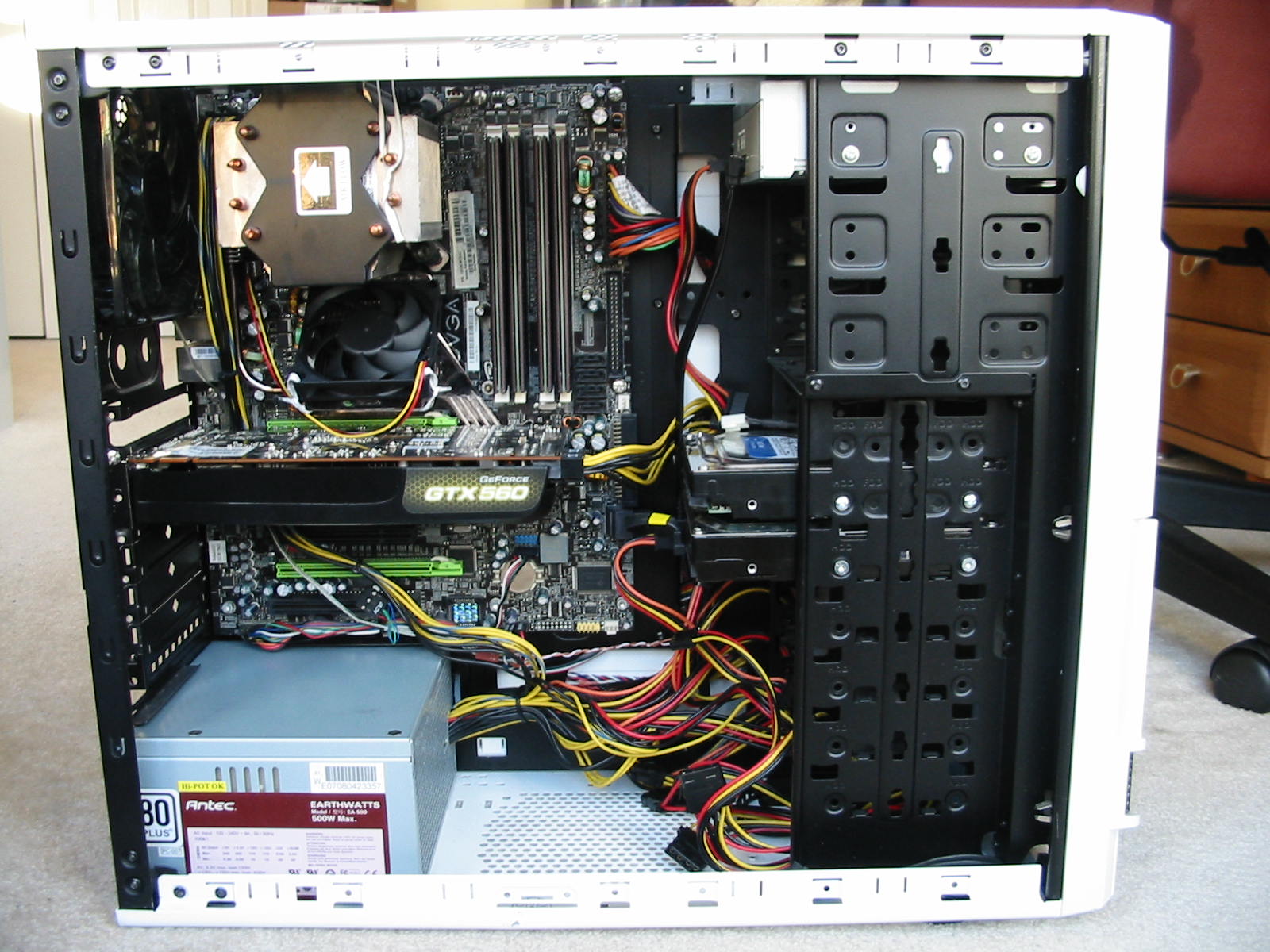

            my E-VGA 780i-SLI PC "build" v2
            Update on the E-VGA 780i-SLI PC…
            A few years ago, I found an E-VGA GeForce GTX560 Ti 2 GB video card at a yard sale for $10 and immediately snatched it. Since then, it's been in my head that this is the video card I'd like to eventually have in the 780i-SLI PC. The GT430 was really just more of a system β€œtest card”… and having the problems it had with crashing @ stock clocks, I knew I'd be replacing it for something better. But what I didn't like about the E-VGA GeForce GTX560 Ti is that it's a fairly hot-running card (160W TDP) with a not-so-great single overhead fan on dual-slot HS. Thus, I was a bit reluctant to use it, until I could find a cheap after-market cooler that is better. Well, instead I found another E-VGA GeForce GTX560 video card recently for $10 on my local CL – and this one was a regular non-Ti version with only 1 GB of VRAM (i.e. a very common card). So I decided to use that one as the β€œsacrificial lamb” (after all, TDP difference between the Ti and non-TI version is only 10W – that is, the GTX560 non-TI is rated for 150W TDP with the same cooler as the Ti.)
            To use this β€œnew” video card in the 780i-SLI build, however, I knew I would need a bigger PSU as that FSP 400W probably wasn't going to cut it with its combined 12V rails power being only 300W (it would have been right on the edge with the Q6600's 150W max. rated dissipation and the GTX560's TDP of 150W.) Thus, I figured now would also be a good time to test one of my β€œhigher-end” repaired PSUs: the Enermax Pro 82+ EPR525AWT.
            (Link to the repair thread can be found here.)
            While installing the GTX560 and the Enermax PSU, I gave the PC a bit of β€œcable management” this time.
            It's still far from looking clean, but definitely not as bad as before.

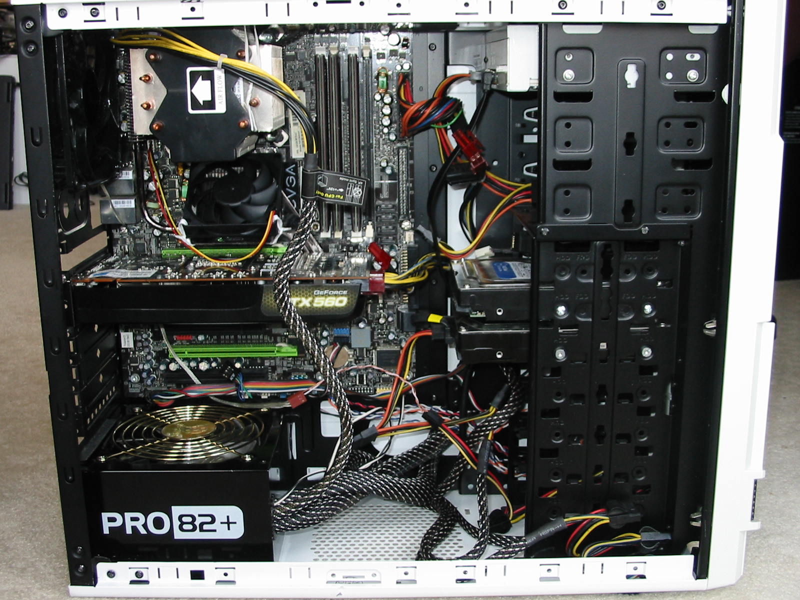

            Well, I couldn't have the PC running this way. So I decided to do another PSU swap: this time, I used my recapped Antec EarthWatts EA-500. In fact, when I bought the Antec PSU a few years ago as well, I specifically bought it for the GTX560 Ti, as I didn't have any other PSUs at the time with two 6-pin PCI-E power plugs. So perhaps this PSU really was just β€œmeant to be” paired with this PC?
            As I was a lot more confident in the Antec PSU, I put a tiny bit more work into the system cable management again, which resulted in this:
            Yes, that 7V-mod kludge for the rear fan is still there with the Ethernet wires plugged into a floppy connector. But apart from that, everything else is plugged in properly. I even re-rerouted and tidied-up the front panel cables a bit. Of course, this being a non-modular PSU, there's always going to be that mess of cables in the HDD cage area. But again, I'm not after building a great-looking system. So all of the cable organization I did was purely for fun.
            That aside, how did the Antec PSU do with the same set of tests as the Enermax PSU?
            Well, for starters, it did NOT shut down when I tried to do the OCCT PSU test. And in terms of power draw, the Antec drew only about 5-10 Watts higher from the wall than the Enermax – at least at the same tests that I could run with the Enermax where it didn't shut down. This seems to make sense, as the APFC circuit in the Antec should actually make the PSU slightly more inefficient. But where I lost a little bit of power, I gained in near unity PFC (which I'm sure the power company will appreciate). And on the OCCT PSU test, the power draw was somewhere around 340-350 Watts, IIRC – right what I expected it to be with that CPU and GPU (and the silly hot-running 780i-SLI chipset.)

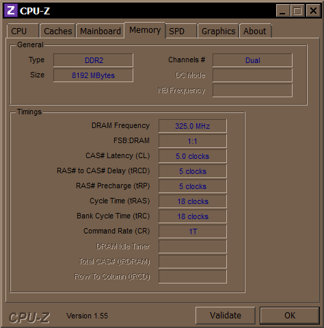

              my E-VGA 780i-SLI PC "build" v3
              This left one last thing that I’ve wanted to do: upgrade the RAM to 8 GB as planned originally. As the 4th matched RAM stick seemed to have issues, I tried another 2GB Corsair XMS stick – same timings and voltage, but this one was a version 4.7 vs. 4.3 for the other three sticks (or the other way around? I can’t remember. )
              I inserted that into the 4th slot, hit the power button and… BEEP BEEP BEEP… – the motherboard wasn’t happy again. (And neither was I! ) I removed that β€œnew” 4th RAM stick, pressed power button again, and PC POSTed fine.
              - Was the 4th slot dead? Or perhaps I have to raise the RAM voltage?
              To test my RAM voltage theory, I upped the RAM voltage to 1.85V (it was previously at 1.825V). I tried both v4.3 and 4.7 sticks one more time, but PC refused to boot with them again.
              Continuing to mess around, I decided to run the FSB:RAM ratio 1:1. To do that, all I had to do was set the RAM frequency to 667 MHz. But I never do things the β€œproper” way, do I? Instead, I set the FSB to 1300 MHz (from 1333 previously, since the board let’s me choose any value I want – at least between 400 and 1600 MHz, that is.) This lowered my CPU over-clock only slightly to 2.925 GHz instead of 3 GHz. I figured it shouldn’t make much of a difference in performance but might make a slight difference for stability purposes. (?)
              Thus, in order to run 1:1 FSB:RAM with this β€œweird” FSB clock above, I had to set the RAM at 650 MHz. Figured a slight under-clock on the RAM with whatever timings it used for 667 MHz might help with stability. As the evening was nearing and I got tired of messing with this PC, I connected it back for use – this also gave me good opportunity to test the PC with the β€œweird” FSB and RAM clocks more thoroughly. Overall, I didn’t encounter any issues, save for the YouTube BSOD issue, which seemed to be there even before I played with the RAM.
              After nearly a week of testing and playing, it was time for another attempt at installing 8 GB. So I tried the 4th module again, same as last time. And unsurprisingly, the board beeped and didn’t POST once again. I removed the 4th module and tried to power the PC, as usual. But this time, she kept on beeping.
              - What the fffffffffffffffffffffffffffffffff!!!
              I removed all the RAM sticks, except the one in the first slot. Can it POST? –Nope!
              - Seriously now!!! Made me wish the system would just explode into a fireball so at least I would know it’s dead.
              But it didn’t. And I am a stubborn one too.
              So I tried a single but different module in slot one – this time a 1 GB stick with same timings. PC didn’t POST but didn’t beep either. Instead, it just cycled through some BIOS POST codes. I re-inserted the module again. Now the PC POSTed β€œfine” again… albeit with CMOS settings all lost for whatever reason.
              *Sigh* I think we may have other issues here.
              At this point, I just didn’t trust any of the RAM tests I had done with the 780i-SLI motherboard. So I opened my closet, grabbed the first DDR2 PC I saw, and started testing all these pesky 2GB Corsair XMS sticks. But surprisingly, they all worked/passed fine – including the v4.7 module and the original 4th matched (v4.3) module that I thought was faulty. So it looked more and more like the issue was with the 780i-SLI motherboard.
              Thus, I went back to it and started again with just a single 2 GB Corsair module – PC POSTed and ran OK.
              I then added a second 2 GB stick and attempted POST – system OK again.
              Next, added 3rd and 4th stick, but this time 1 GB modules with same timing – system OK again. What?! So the 4th slot does appear to work! FFFFUUUUU E-VGA gremlins!
              This tripped an idea in my head: perhaps there’s an issue with the timings when I do the 4 matched RAM sticks? So I went in BIOS and set all RAM timing manually to 5-5-5-18, then changed the RAM frequency to 650 MHz (and FSB to 1300 MHz.) PC POSTed fine, as I expected. Main difference was that I was now running 6 GB in dual-channel (2x 2GB + 2x 1GB) instead of 6 GB in single channel (3x 2 GB).
              So what’s next? – I removed the two 1 GB modules and inserted the remaining two 2 GB Corsair XMS modules (that is, with the 4th module that I initially thought was faulty in slot 2a.) I then pressed the power button and… BINGO! – System finally POSTed with 8 GB of RAM in dual-channel mode.
              - About F*ing time!!! Seriously!
              … And that brings us to the above picture I posted, which is why it shows the finished PC with 4x 2GB matched RAM sticks.
              Whew! What a hassle to get that memory to 8 GB! I’m not touching those RAM modules ever again! (Except only if I run into issues again.) As it currently stands, the PC has been running for over a week now with the 8 GB memory config and no problems. Again, aside from YouTube giving me BSODs, the system has been pretty stable otherwise. Or is it? Time will tell with more testing. As I said, I’ve been using it mostly just to play games on every other evening or so. Haven’t tried it much with any other β€œdaily” tasks, so we will see how it goes.

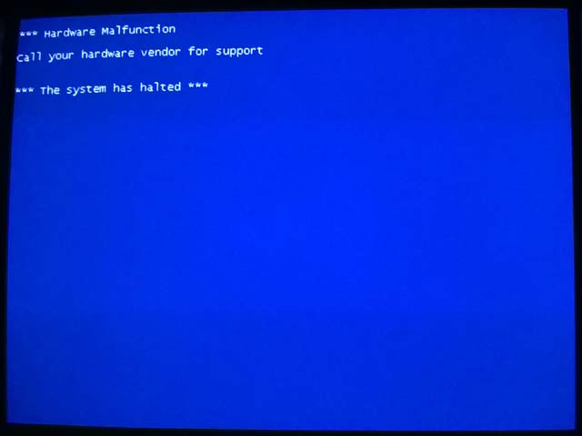

              Speaking of the random BSODs I get when watching YouTube:
              Originally posted by TechGeek
              momaka: could you post a photo of the BSOD?
              Yes, sorry for the delay. Here you go:
              https://www.badcaps.net/forum/attach...1&d=1554002748
              As mentioned, it doesn't really give any info about what's failing. In fact, I wonder if that BSOD could be more bland.

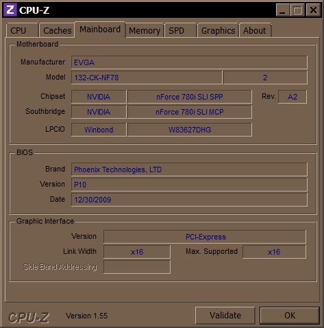

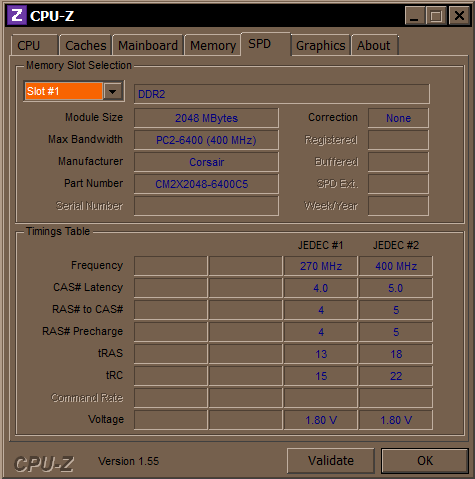

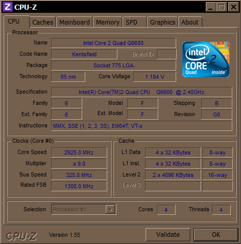

                E-VGA 780i-SLI PC v3 final specs
                Just in case anyone is confused with the above β€œgreat wall of text” … here are the final specs of this PC that I think will stay like this for a while:
                CPU: Intel Core 2 Quad Q6600 @ 2.925 MHz (1300 MHz FSB) and 1.23125V V_core
                Motherboard: E-VGA 780i-SLI (model 132-CK-NF78-A1) with modded 70 mm chipset fan
                RAM: 8 GB (4x2GB) Corsair XMS PC-6400 DDR2, 5-5-5-18, 1.80V, ver:4.3 <- running at 650 MHz and 5-5-5-18 manual timings with 1T CR
                Video Card: E-VGA GeForce GTX 560 SC 1GB DDR5
                CPU cooler: Dell XPS 630 (0N764D) 4-copper heatpipe cooler
                HDD: 500 GB Samsung (Seagate?) HDD
                Optical: DH-16ABSH11B Philips Lite On DVD-R/RW
                PSU: 500W Antec EarthWatts EA-500 (recapped)
                Case: Thermaltake Commander MS-I Snow Edition
                And CPU-Z screenshots:

                  A-ha! It does one long-two short for the RAM on yours as well, like mine, by my educated guess. And for mixed sticks, I simply cranked the DRAM voltage to 1.90V, after I saw one of my Asus socket 775 motherboards crash on the motherboard logo. (freeze at motherboard logo) (When I had DDR2)
                  IIRC, I only saw that BSOD error when I had what I think was a wrong jumper combination, for the onboard audio jumpers on my Chaintech CT-7AJA2E (socket 462) motherboard, when I had a T-bird, LOL.
