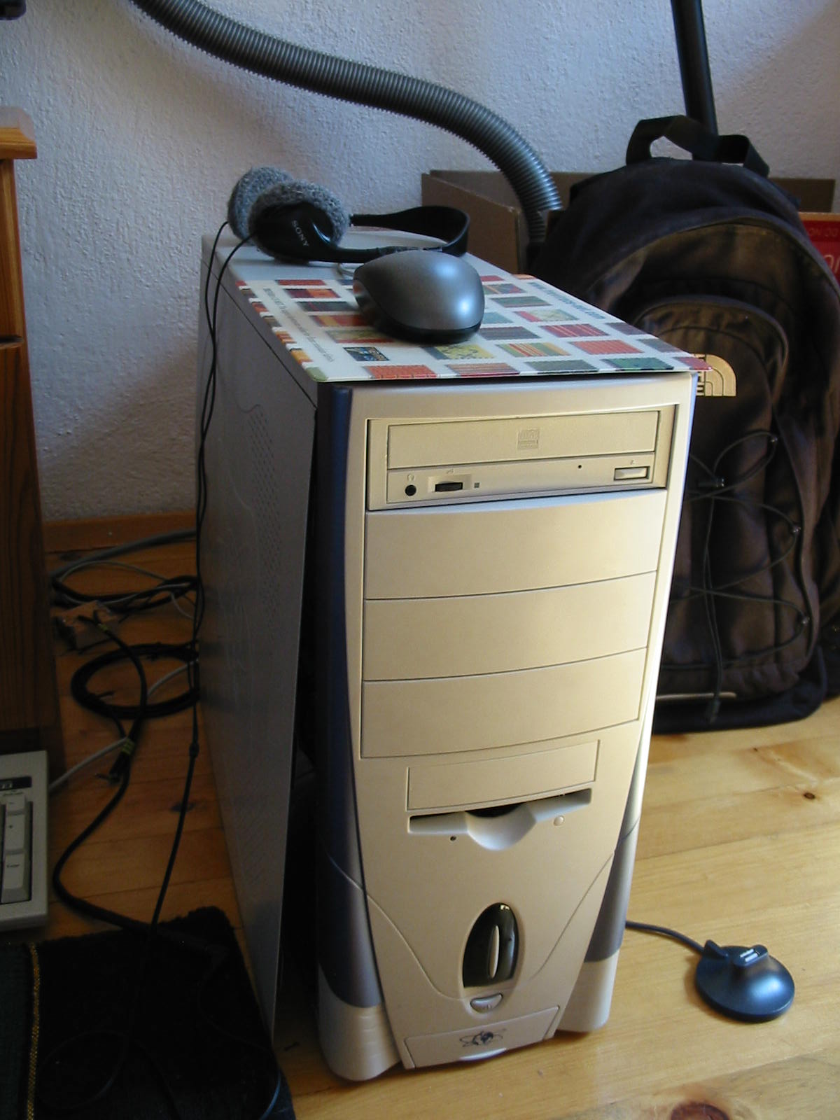

        Here, I will (re)post a final version of my Pentium 3 PC setup at my grandmother's countryside house. Pictures:
        https://www.badcaps.net/forum/attach...1&d=1445650322
        https://www.badcaps.net/forum/attach...1&d=1445650324
        What can I say? as usual.
        Every year (for the last 5 years) I say to myself that I will get a desk and I never do. So when I get to the house, I just pull the PC and its bits out of storage and set it up as you see. When I leave, everything is taken apart and stored again.
        Anyways, here are the PC specifications:
        - CPU: 933 MHz Intel Pentium 3 Coppermine @ 133 MHz FBS
        - Motherboard: Gigabyte GA-60XT ATX motherboard (socket 370)
        - RAM: 512 MB SDRAM @ 133 MHz (2x 128 MB and 1x 256 MB)
        - Video Card: (Mad Dog?) ATI Radeon 7200 with 64 MB video RAM
        - Sound Card: Yamaha YMF-724 (DS-XG/DS-1) PCI audio card with TEA2025 dedicated amp IC
        - HDD: 1x 120 GB IBM Deskstar with 99k power-on hours (but zero bad and reallocated sectors)
        - Optical drive: LG CED-8080B CD-RW
        - PSU: 250W Deer DR-250ATX (partially recaped and modded)
        - CASE: cheap. Enough said.
        - Monitor: Dell (Samsung) M782 17" CRT monitor (dumpster-picked, very good condition and no screen burn-in)
        - Keyboard: old (but still a rubber-dome type), has "Turbo" key
        - Mouse: Genius optical. Not sure what model, but it is okay quality and is quiet in terms of button click noise.
        - Speakers: from a Sharp CMS-R400CDH stereo system. 3-way, with 4", 8 Ohm drivers IIRC. Rated for 10 Watts RMS. Driven directly by the amp on the Yamaha sound card above. They sound pretty good and can still go fairly loud.
        - OS: Windows XP SP2 (as usual)
        Overall, the PC specs are pretty much the same as I posted them before. Old specs can be seen here:
        https://www.badcaps.net/forum/showpo...&postcount=314
        Really, the only things I have changed is:
        - the hard drive, which formerly consisted of 1x 17 GB Seagate ST317221A and 1x 20 GB Maxtor 5T020H2 - both of which are still inside the PC. If for some reason the IBM Deskstar fails, I can hook the old HDDs back, and PC will be running again.
        - the monitor (the old '94/'95 Sony Trinitron M41KKA16X is starting to get tired and there is either bad caps inside its video signal board or bad joints because the curved vertical streaks that it had when I got it are starting to get worse)
        - added some resistors and diodes in series with the fan inside the PSU, because it is hardwired to 12V otherwise, and it really does make a lot of noise.
        - the speakers above... I used to use headphones only before, or a cheap pair of those typical low-quality rectangular PC speakers that came free with many PCs back in the day. These Sharp speakers are so much better.
        So that's the whole PC setup. I don't think I am going to change anything on it anymore. It used mostly for transferring/storing pictures while I am there, listening to music, and the occasional older game like Counter-Strike 1.5 (talk about oldschool there ), Need For Speed (High Stakes or Porsche Unleashed), and Mafia. Those games run absolutely wonderful on that PC.
          That case is also built by Deer. The side panel drawing (or whatever that is) gives it away. For a matter,my "TronForce3" system uses a JNC (Deer) case that has the same panel. It has fancy thermal sensors It's one of the newer ones which came with the usual gutless Deers - the ones with 2003 and 2005 chips. I still have 2 of the 2003 ones. One is a solid 250-300W (though 250W more likely due to 4 diodes on the primary and EI-33ASH transformer)and the other is a 200W. (the former that I use is the Fortrex ST-400W (see pic of its guts) and the other is some noname PSU (literally no label)based on the same platform (Y-B2002) as the Fortrex ST-400W)
          And yes,the K bungs on the caps on the Deer I use with my dual core PC (Pentium E2160 1.80GHz) are legit Rubycons. I actually checked that. Two Ruby ZLs and a Rubycon MHZ - do you have any idea if this is some discontinued series?
            Really? You mean that planet logo (can also be seen on the front of the case)?
            Well, that's good to know, because I always wondered who made this piece of... well, I'll refrain from cursing here. Let's just say the metal is so thin that tin cans are probably more robust. But it serves the purpose, I guess.
            That said, the current Deer PSU inside it did not actually come with that case. It came from a different PC I trash picked. It's just a coincidence that I put it in a Deer case again. Maybe Deers like to stick together.
                                I see a different style outlet!

                                  Re: Post your system.......
                                  ^ Yup, that's a Schuko plug, because that house is in Eastern Europe.
