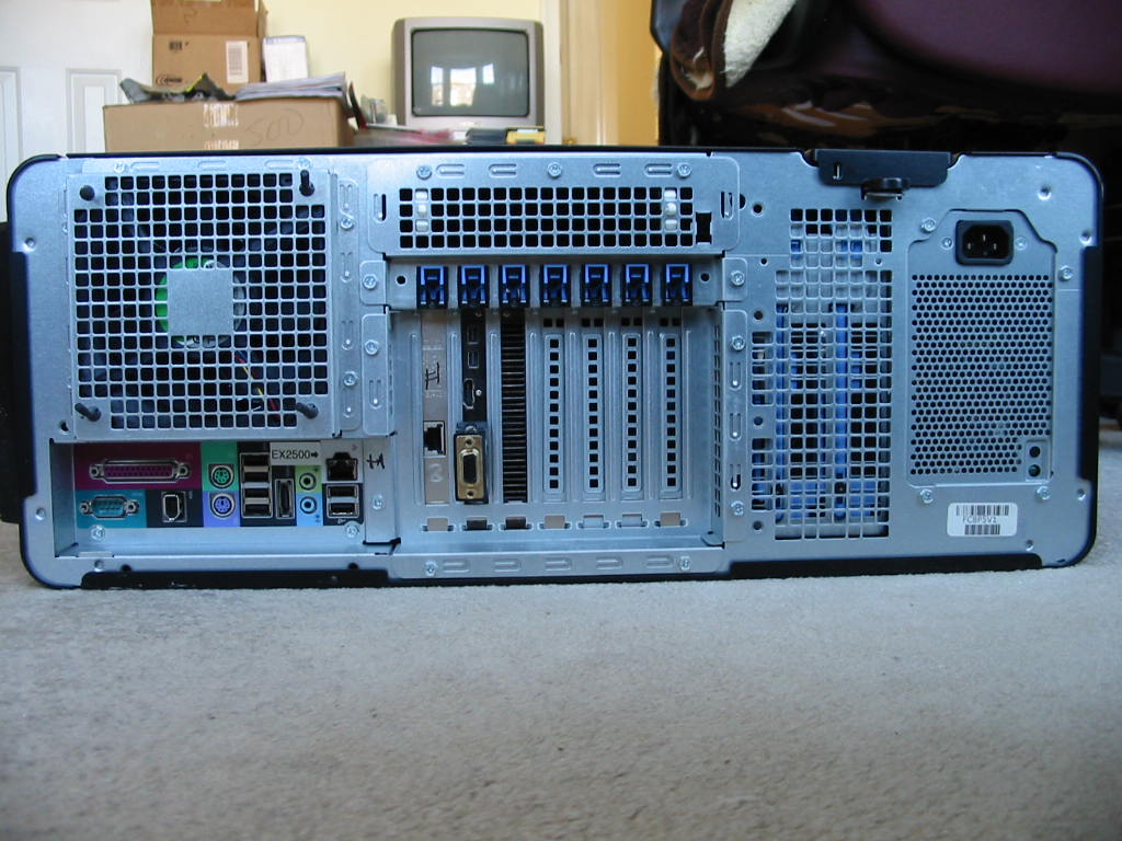

    Some pictures of the build…
    Front & back:

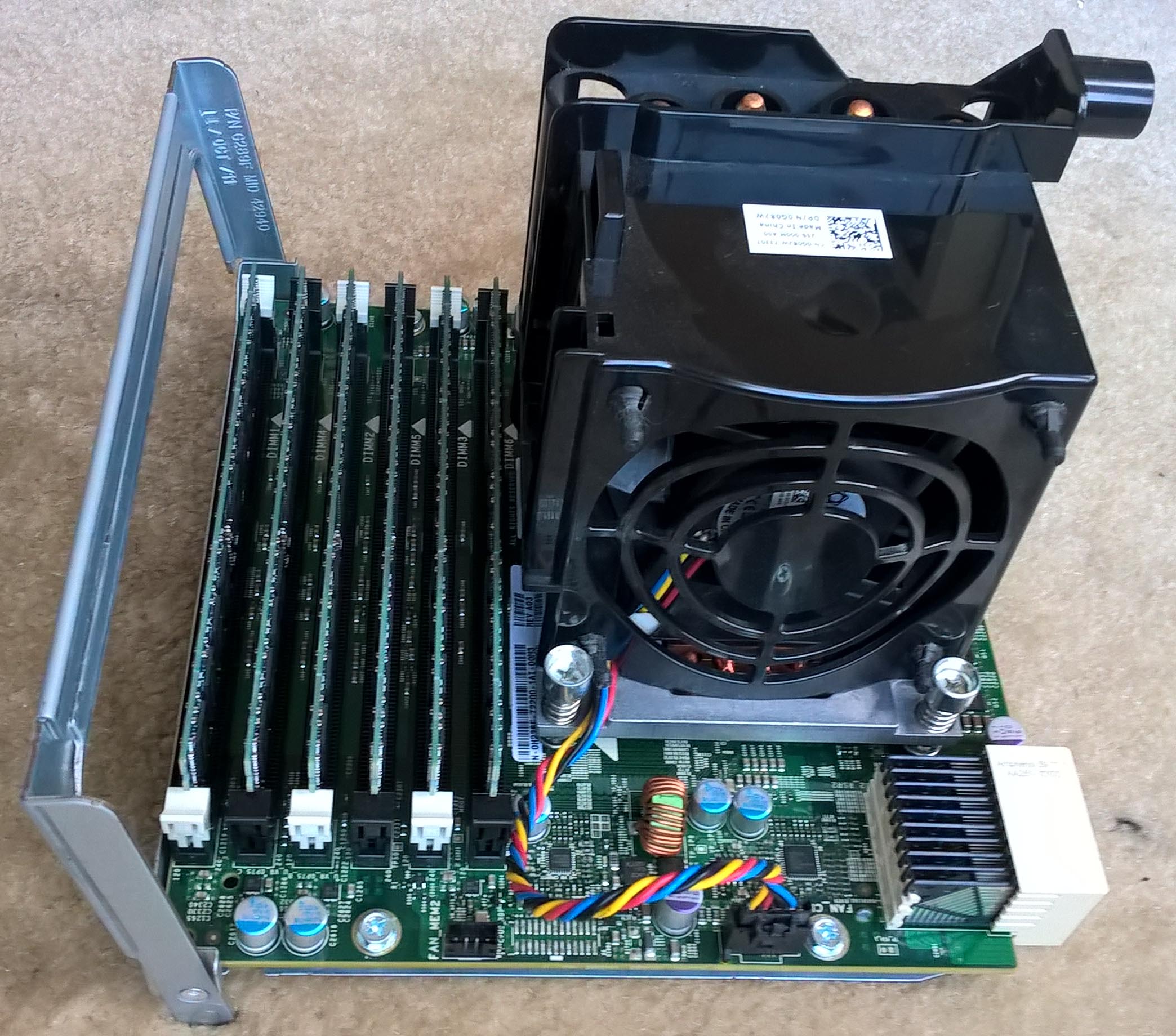

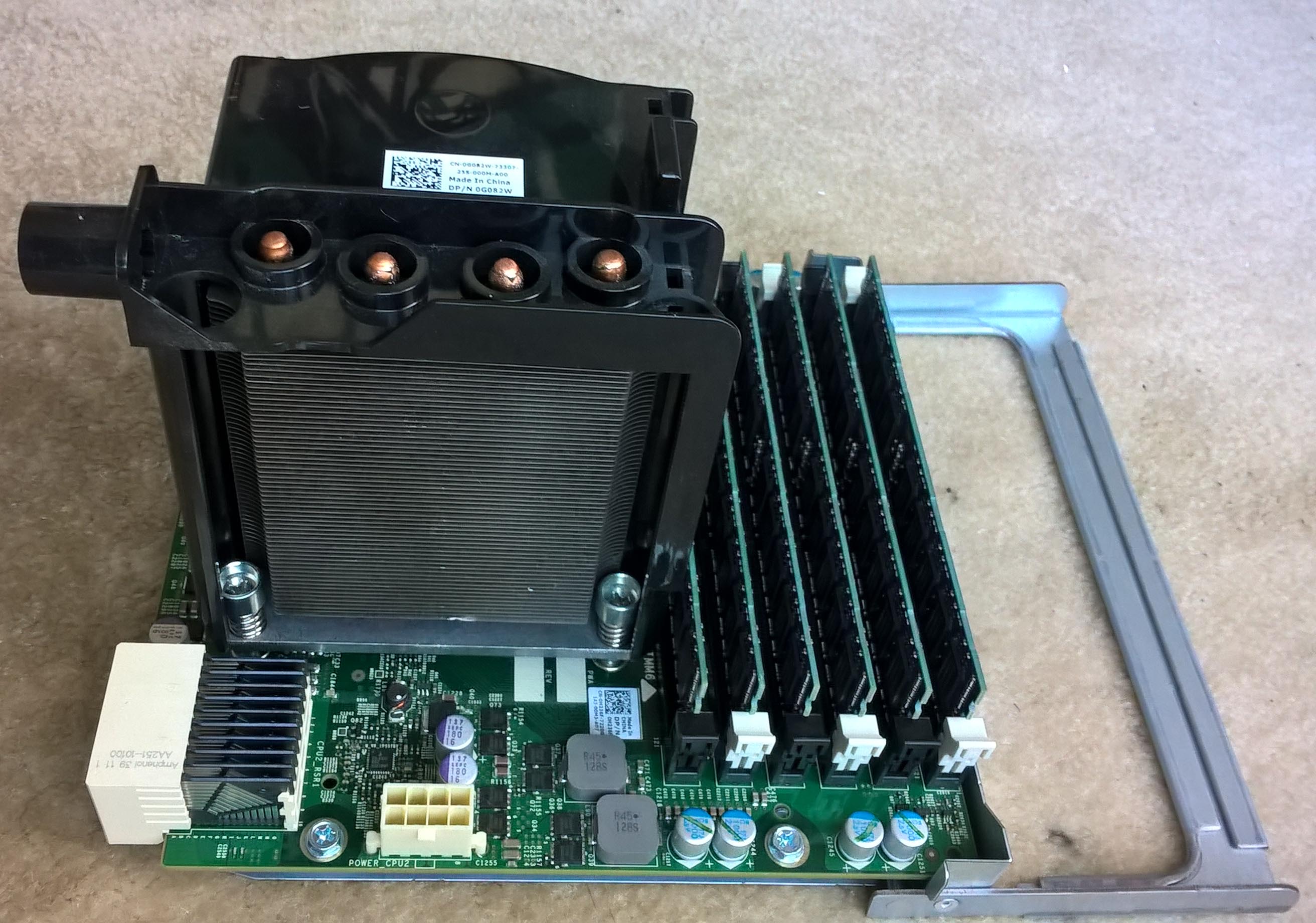

    CPU riser board:

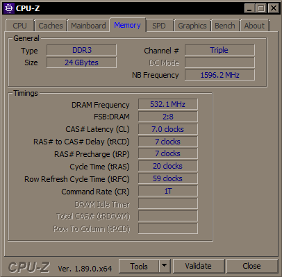

    I didn’t stick with the stock RAM for too long. Here’s the system once the 24 GB of RAM showed up (but still with the 2x Xeon E5606 CPUs, as can be seen with the RAM running at lower frequency.)
    Once the 2x E5649 CPU showed up, this also increased the RAM frequency from 533 MHz to 666 MHz (as did the NB frequency, from 1.6 GHz to 2.13 GHz.)
