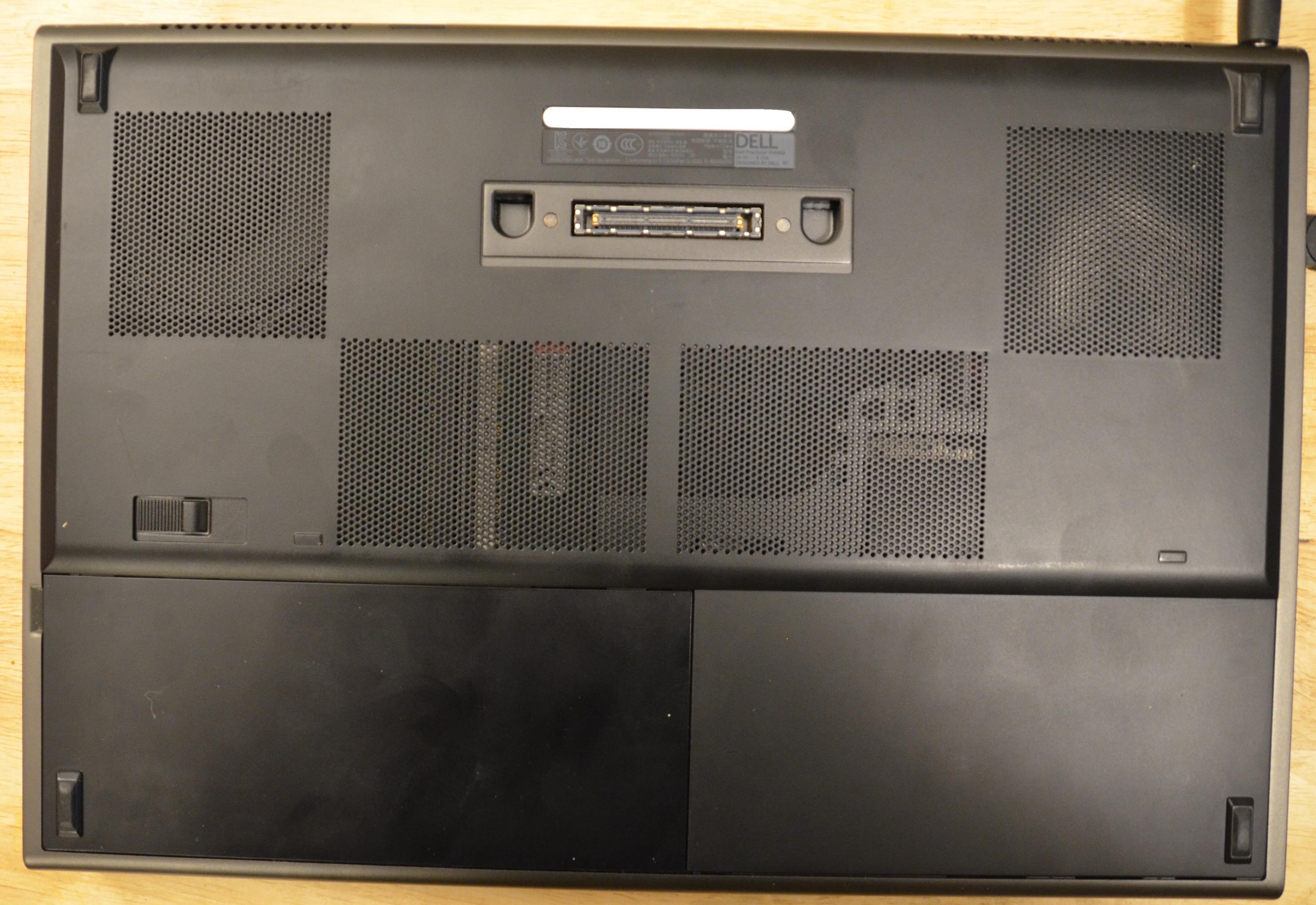

        While I've owned many systems one has definitively earned its place as my least favorite. Its one and only Dell Latitude E6540.
        I bought it second hand back in 2017, it was in a mint condition. Everything works, all the documentation is present and doing some tests revealed that everything's running just fine. It was a system with an i7 4800MQ, Radeon HD 8790M, 8GB ram and 256 GB SSD. As a cherry on top it has a fairly good FHD TN panel with good contrast.
        I bought it for college for the intentions of using it for what its made for: doing productive things like programming and running simulation software instead of, you know, gaming . However things didn't turn out that way.
        Lets start off with things that have gone wrong with it, shall we?
        It powered on from sleep and kept working for an approximately two hours inside of carrying bag. The wrath of the overheating E6540 killed the keyboard... Should I have turned it off instead of let it go to sleep, yes. But from all of the laptops that I've had my hands on, not a single one powered on from sleep without deliberately doing so (ie moving a mouse to power it on).
        Second, it has killed a replacement battery. I still wonder how.
        Third. Who at Dell decided that a system that houses an 47 W TDP CPU and, atleast, 50W TDP GPU should be cooled by a tiny radiator with a fan that has no direct air flow over it. Without any modifications the i7 4800MQ throttles like there's no tomorrow, its nuts!
        Fourth. 3 of 4 USB port don't like to power anything more power thirsty than a mouse dongle. There's a revision 2.0 motherboard floating around EBay which should fix that issue..
        Honestly my biggest mistake is that over the past two years I poured money to fix the thing since I can't admit that I purchased a lemon of a laptop.
        After all of those shenanigans that I've dealt with its now a dependable laptop that just works. So there's a happy ending for it.
          Re: Post your system.......
          Particularly annoying when the Precision line with similar CPUs/GPUs had plenty of cooling, here's my M4800:
          I guess Dell figured that most Latitides would have dual-core CPUs and IGP so "why bother designing a cooling solution for the relatively small percentage with quad-core CPUs and discrete graphics".

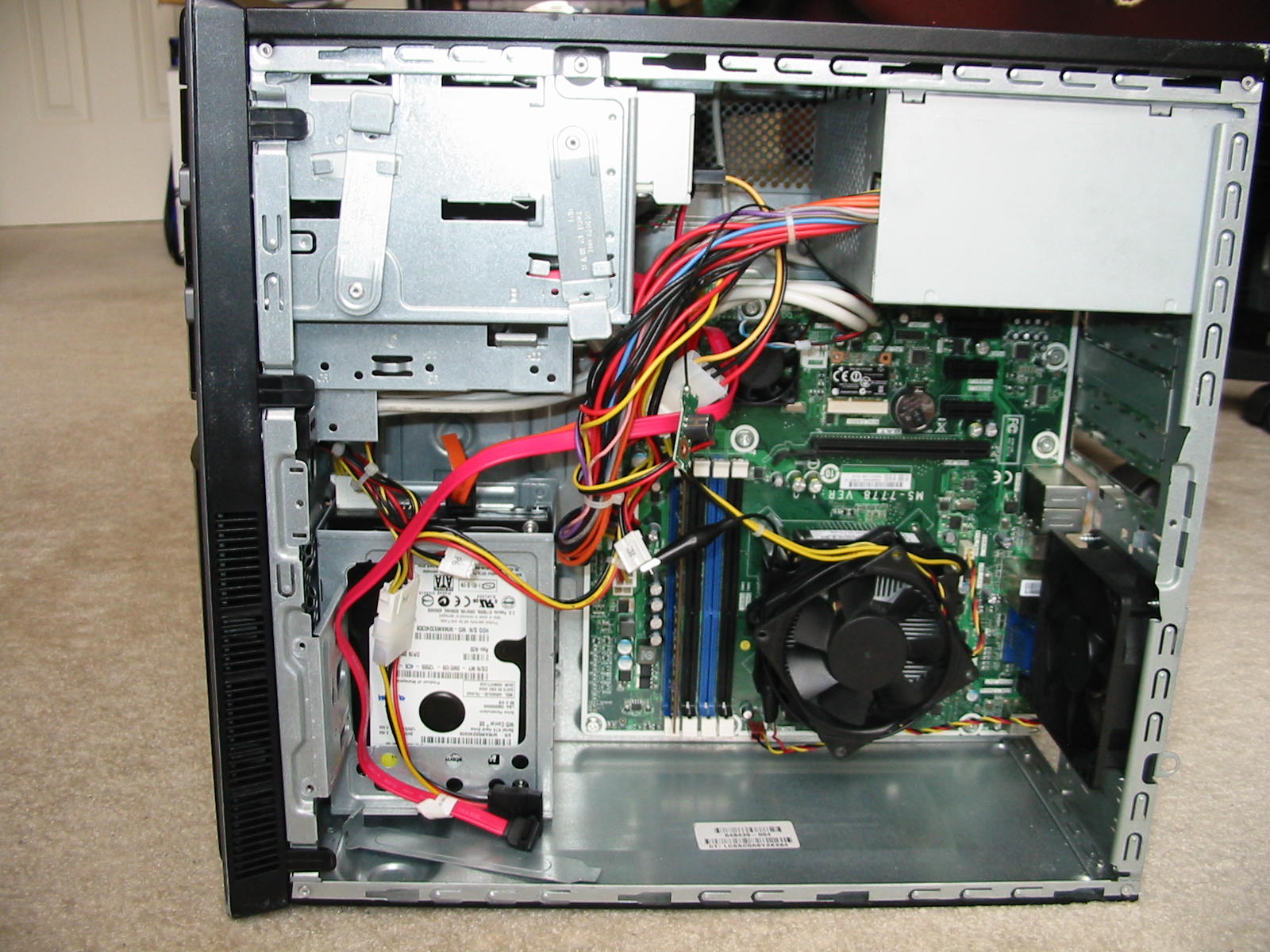

            HP Pavilion p7-1534... a.k.a. the APU "experiment"
            Here is a PC I put together somewhat quickly not too long ago: HP Pavilion p7-1534 motherboard stuffed in a p7-1233w case with the cheapest APU. I call it the “APU experiment”, though calling it the “scrap HP APU build” wouldn't be entirely wrong (hey, it even features a “Scrapper Lite” IGP – how appropriate! )
            Specs….
            CPU (or APU, if you will ): AMD A4-5300 with onboard Radeon HD 7480d
            Motherboard: HP JasmineR [MSI MS-7778 v1.0] from HP Pavilion p7-1534
            RAM: 8 GB (1x 8GB) Samsung PC3-12800 DDR3, 1.50V
            Video Card: see APU above ^ … with 512 MB of shared memory @ 800 MHz
            CPU cooler: OEM Intel socket 775 heatsink with 80 mm 3-pin fan (Sunnon 1.44W)
            HDD: 80 GB Western Digital WD800JD, SATA (for now.)
            PSU: 250W Bestec ATX-250-12Z (“mostly” recapped )
            Optical: DVD-RW (forgot which brand and model), SATA – came with the case
            Case: HP Pavilion p7-1233W
            OS: Windows 7 starter x64 (for now.)
            Some pictures…

            A “little” history...
            ... of how/why this PC came together.
            (You better know when I say “little”, prepare to read a book )
            So, awhile back, I got many scrap PCs from a local PC repair shop. The case for the PC above was one of the many from that lot. It was empty with nothing inside it.
            Around the same time, I also won an auction with scrap RAM (mostly DDR2) from an eBay seller. The RAM all turned out to be working and came out at less than $1 per GB, IIRC. Happy with the good deal I got, I found the same seller had several auctions for scrap CPUs. In one of them, there was an AMD A8-6600k and some high-end -looking Intel LGA11xx CPU (turns out it was not, but that's another story ). Thinking I might get a good deal again, I bid and won that CPU auction.
            The A8-6600k APU from the auction looked OK – just had a ton of bent pins, like the rest of the CPUs (mostly Pentium 4's that were all working.) I straightened the pins out and started looking for an FM2 motherboard (on eBay again, because… where else? ) Found the HP Jasmine / MS-7778 motherboard above for a very decent price for an FM2 mobo (under $20 with shipping, IIRC.)
            As always, I research things before I buy. The MS-7778 v1.0 motherboard is supposed to be a “JasmineR” model. There is also a blue-colored PCB of this motherboard, the MS-7778 v0.8, or simply “Jasmine”. What's the difference? (I will withhold making Aladdin jokes here ) JasmineR supports 5k, 6k, and 7k series of APUs (like the A8-6600k I have), whereas the regular Jasmine does not and only supports 5k series APUs.
            Thus, everything looked like it was going to work out well – in fact, very well, as that HP motherboard was a perfect fit for the case. The A8 APU would also match the “AMD A8 Vision” logo on the case. It's like, it was all meant to be … until it wasn't . Testing the motherboard with the APU got me nowhere: no freezing screen, no POST, no POST codes, not even any beeping (except when RAM was removed – got “no RAM” beeps then.) For a while, I thought the motherboard was bad, because the package it came in was severely smashed and had tire marks on it (not sure if USPS or who, but someone… or rather some vehicle, did step on that package on one side.) Moreover, it seemed unlikely that a socketed CPU/APU would be bad.
            After a few months, I decided to throw more money into this project (or curiosity pit, really. ) I thought about buying another motherboard first, because I found some conflicting information online regarding certain JasmineR motherboards not being compatible with 6k and 7k APUs. But after more thinking (… I want to say my head exploded ), a cheaper and easier route seemed to be getting another APU, as ATX/m-ATX FM2 motherboards were not that easy to find (still aren't) and fairly expensive for what they are. This time, however, I was set on getting a known compatible APU. Not wanting to spend too much either, I went for the cheapest APU: the A4-5300. Got one on sale for $10 shipped (guess from where again? )
            With the A4-5300, that MS-7778 motherboard booted right up with a proud HP logo! Digging in the BIOS revealed it came out of a Pavilion p7-1534 PC. On that note, this is where things get confusing, because according to the HP website, the p7-1534 comes with a blue-colored Jasmine [MS-7778 v0.8] PCB. So how is it that my green-colored MS-7778 v1.0 PCB is a regular Jasmine and not a JasmineR??? Did HP run short on v0.8 motherboards and then started flashing v1.0 PCBs?
            Whatever the case, that A4 APU did the trick and worked just fine (more on that later in the post.) As for the A8-6600k APU… surprisingly, that thing is dead! How do I know? Well, with a bit of luck and patience, I found and bought another FM2 motherboard for cheap – a Gigabyte GA-F2A68HM-H. This one IS known to be compatible with the 6k and 7k series of APUs. When I tested the A8-6600k in it, the motherboard wouldn't even power up. Almost made me think I had gotten a dud motherboard (again.) To confirm, I stuck the A4-5300 in the Gigabyte mobo. Sure enough, the new Gigabyte mobo also work and booted fine. So I went back to the 6600k to double-check and… NOPE! No boot, again. Repeated the same procedure on the MS-7778, and every time, the A8-6600k didn't work. So the A8 APU really IS dead! Go figure. Perhaps that Radeon IGP is the culprit? This is the first time I bump into a dead socketed CPU, BTW. It's a shame, because the IGP in the A8 and A10 APUs are actually not terrible for entry-level gaming and graphics.
            So, that's how the parts above came about for this PC. There's not much else to it. Of course, as with all my builds, I did do a bit of ghetto-mod work here and there (well, when did I ever -not- do that? ) The built-in wireless module, for example, didn't come with antennas. So what I did: took some WiFi antennas out of my “PS3 junk box” and stuck those on there. You can see one of them is mounted on the back of the PC to one of the PSU screws. The other one is just hanging inside the case on the ATX wires. There's no cover for this case, so that's why I left the antenna there. Can't get more ghetto than that! But the antennas work well and I get good WiFi.
            Another item I couldn't help to not mod: the cooling:
            https://www.badcaps.net/forum/attach...5&d=1566518698
            https://www.badcaps.net/forum/attach...4&d=1566518698
            And link to thread of those pictures can be found here.
            For those who don't want to click the link and read there… in short, I adapted a socket 775 heatsink (that had busted mounting screw posts) to fit on this motherboard, which seems to be using a mounting pattern similar (if not the same) to LGA115x.
            Besides the socket 775 heatsink “hacks”, I also did some “work” on the fan wiring. Namely, I removed the original 80 mm 4-pin PWM fan from the CPU cooler, because the BIOS throttles it down way too much – I could see the blades barely turning over. This made even such low-power APU as the A4-5300 run hot, along with the surrounding motherboard components in the CPU VRM.
            Obviously, that wasn't cutting it for my cooling “standards”. So what did I do? – I placed an 80 mm 3-pin fan on the heatsink and connected it to the motherboard's -rear- fan connector, which has speed regulation (and uses a 3-pin connector), but turns the fan faster. Meanwhile, to keep the motherboard happy in terms of seeing an RPM reading for the CPU fan, I connected the case's rear fan to the CPU fan header. Of course, since the CPU fan header is a 4-pin (meaning, it supplies full 12V on the fan Vcc pin all the time), this would have made the rear case fan run at 100%, which would be very loud. To eliminate that issue, I pulled the rear fan's Vcc wire and connected it directly to 5V. It runs a lot slower, but still pushes plenty of air. Not that it matters when there is no case cover (yet! – I'm working on one… and it likely will be ghetto too.)
            https://www.badcaps.net/forum/attach...1&d=1566519612
            Last but not least, I added a 40 mm fan to the chipset heatsink. The chipset doesn't really run that hot. But in a very warm room, such as mine, it can get uncomfortable to touch. So the 40 mm fan takes care of that. Moreover, it doesn't add any noise, because I have it running at 5V. It barely moves any air at that voltage, but it's more than enough to keep the chipset cool.
            So the result with all that cooler modding: cool-running APU that tops at 52°C @ max load with a room temperature of ~28°C (~83°F). Good enough for me now.
