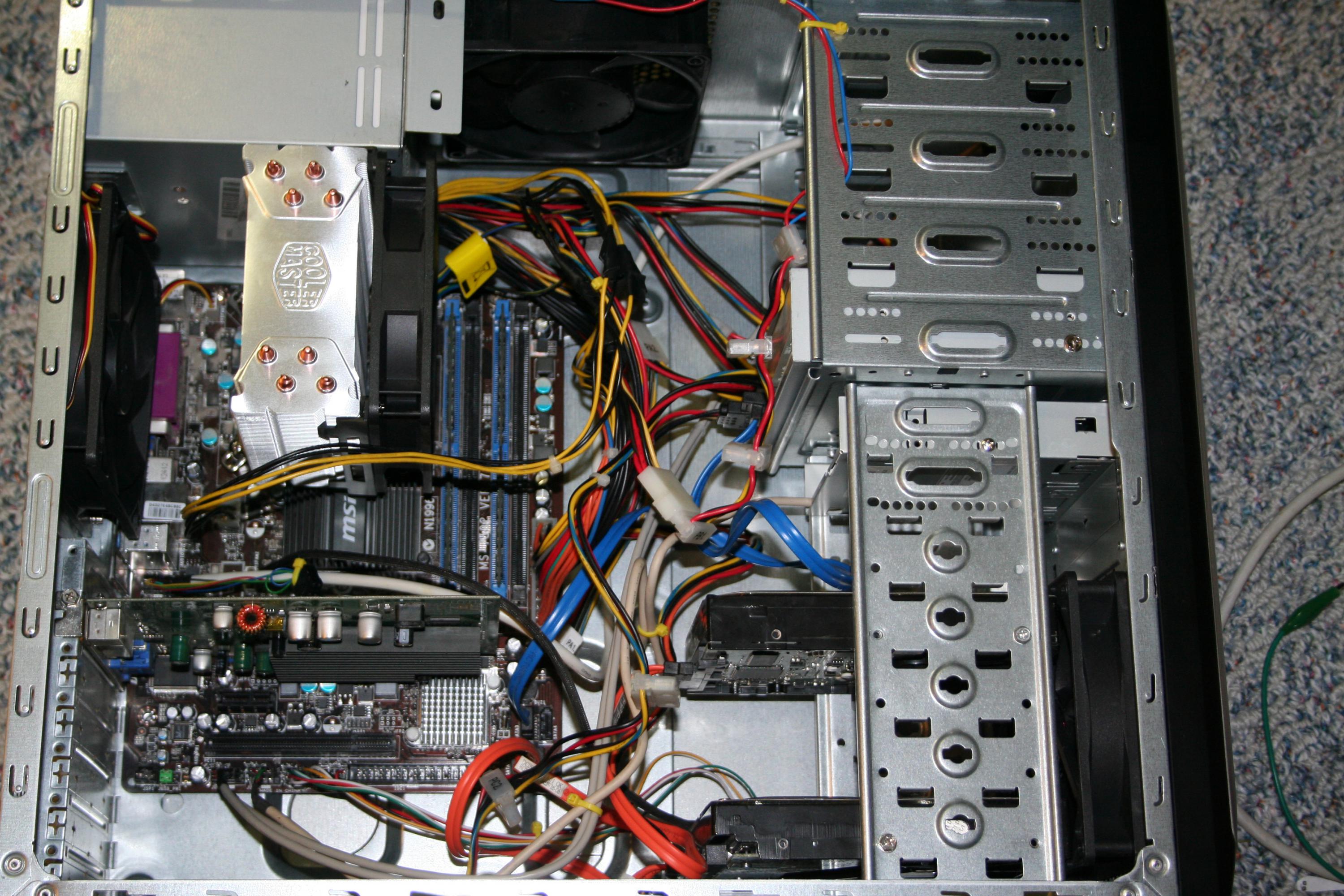

    Intel Core 2 Quad Q6600, overclocked to 2.7GHz, cooled by a Cooler Master Hyper 212 Plus. 2Gb of DDR2-667 (though the speed is higher due to overclock), dual 500Gb hard drives, a crappy NVidia GeForce 7300LE, an AcBel 550W power supply modded with a 4-pin ATX12V connector (that's what the electrical tape is .) As for fannage, we have the Cooler Master heatsink fan, the rear fan that came with the case, a Worst Buy fan in front, and two Papst MultiFan 4212H's tapped off spare Molex connectors (one on top, one on the side panel.) The green alligator lead, white cord, and bit of shredded paper are not part of the computer.
