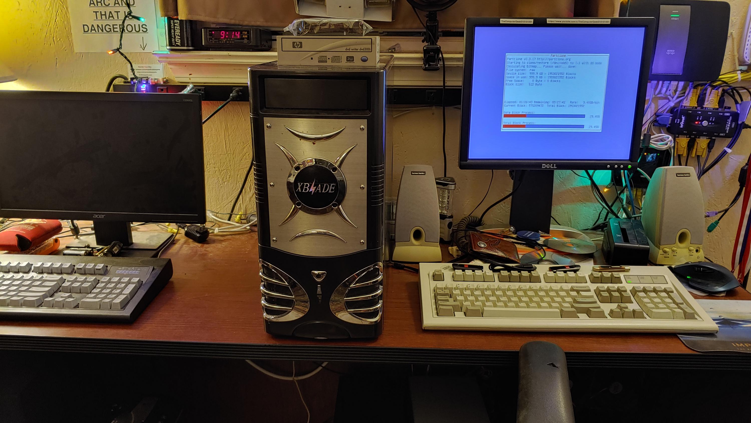

                Re: Repurposing a 2004 Athlon 64 system in 2021

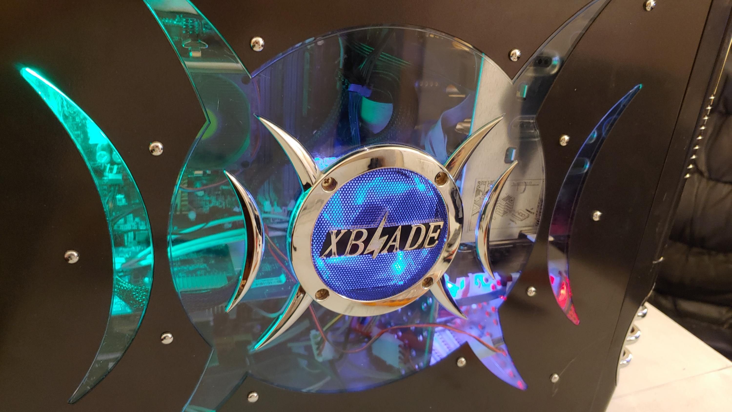

                Still not sure what I'll do with my Xblade case with the P4 in it...

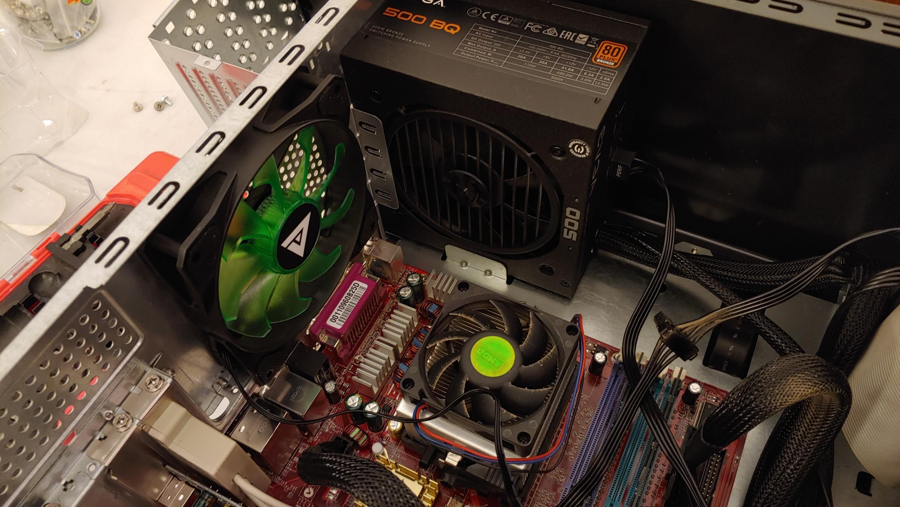

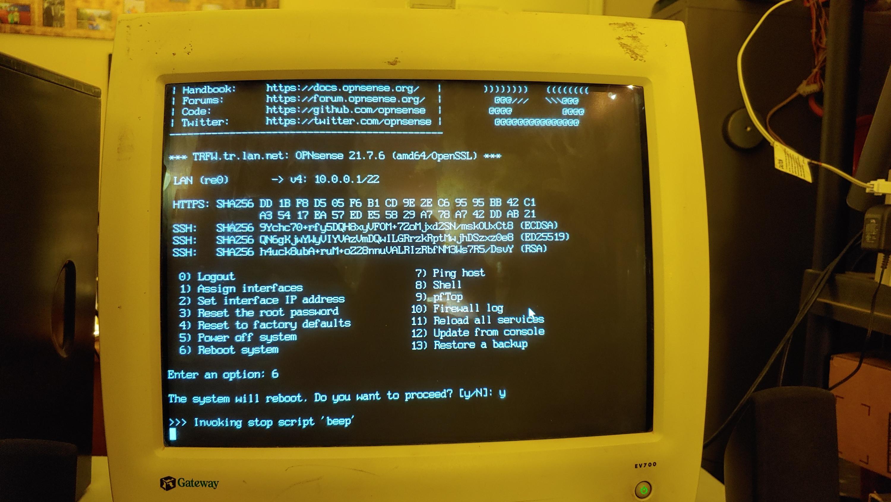

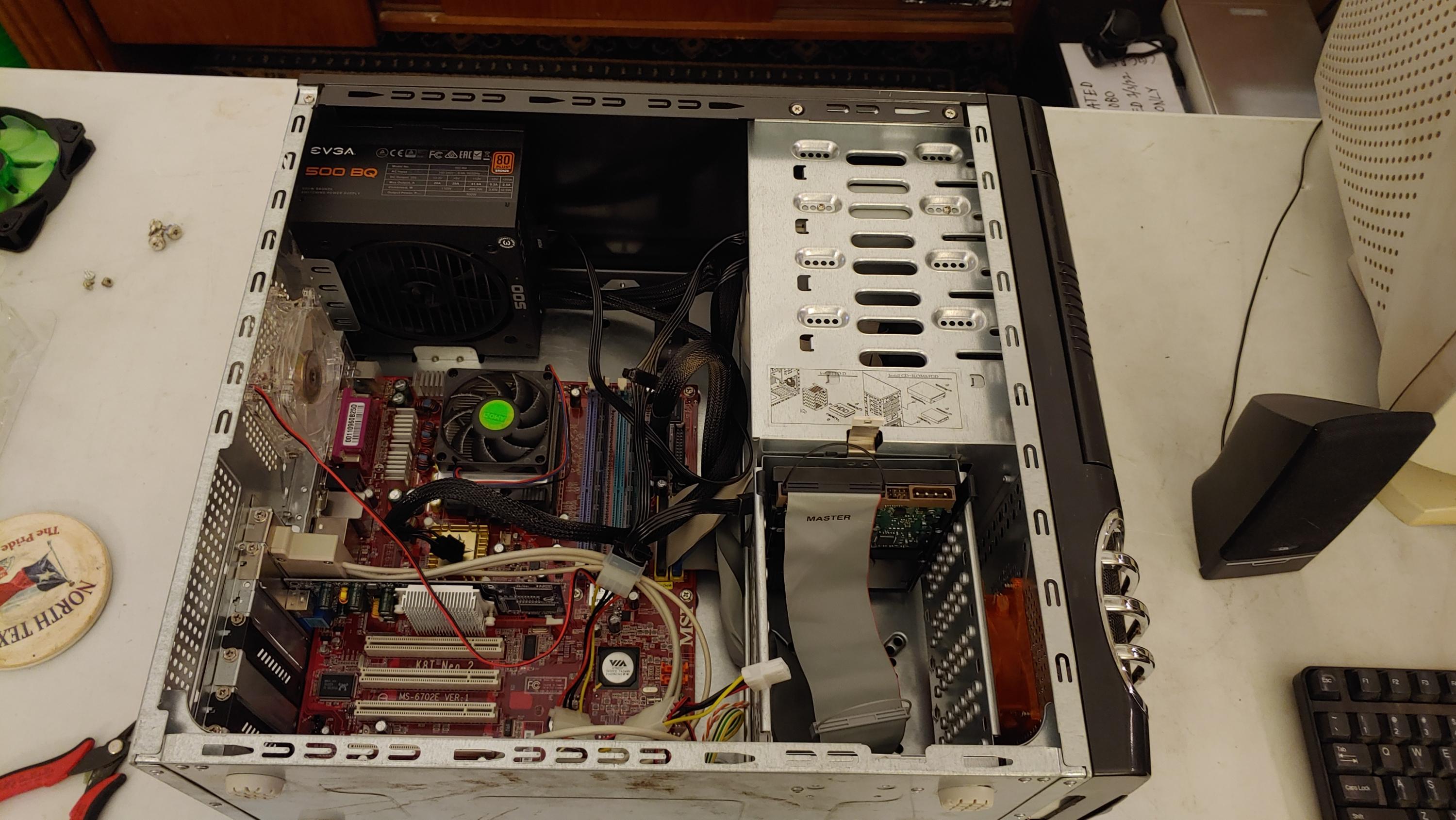

                        So it begins! The next phase of life for this old beast!
                        System hooked up for a quick test to make sure it still works before I modify it.
                        Booting into OPNsense one last time...
                        Confirmed alive, shutting down.
                        Under the knife once again...

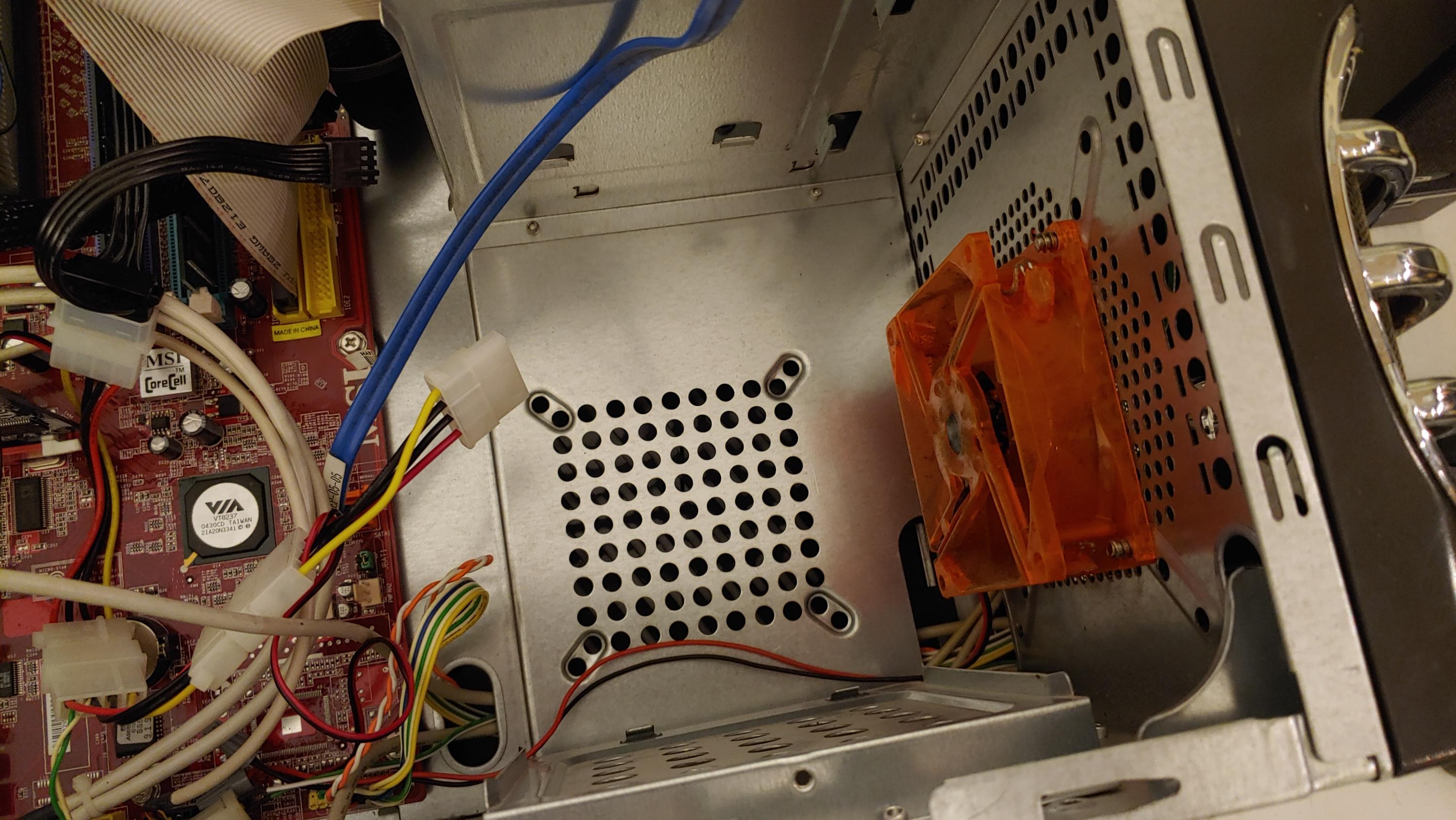

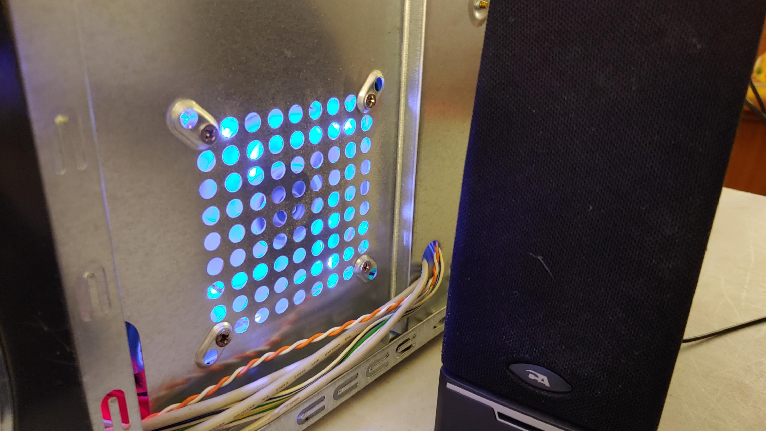

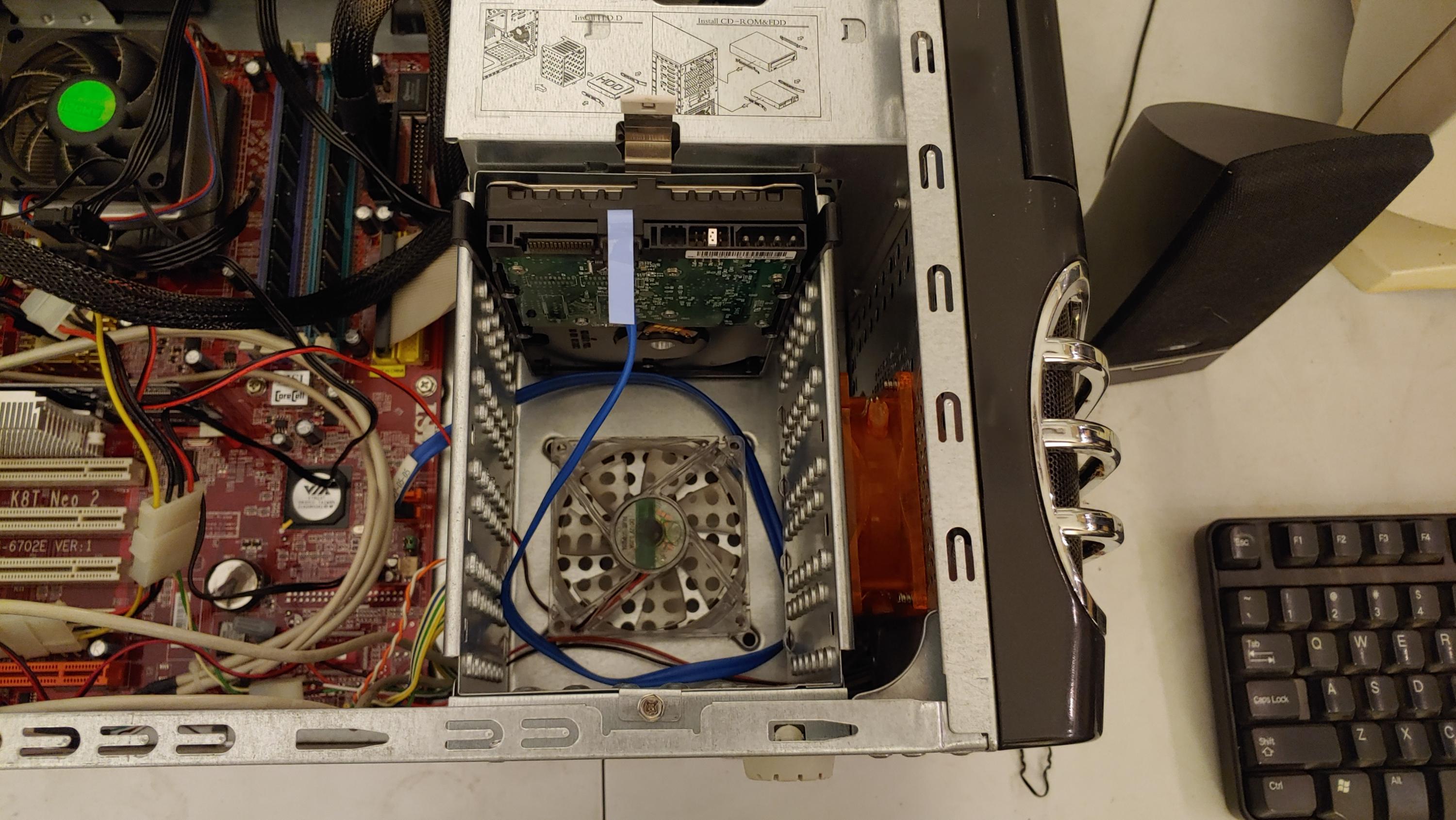

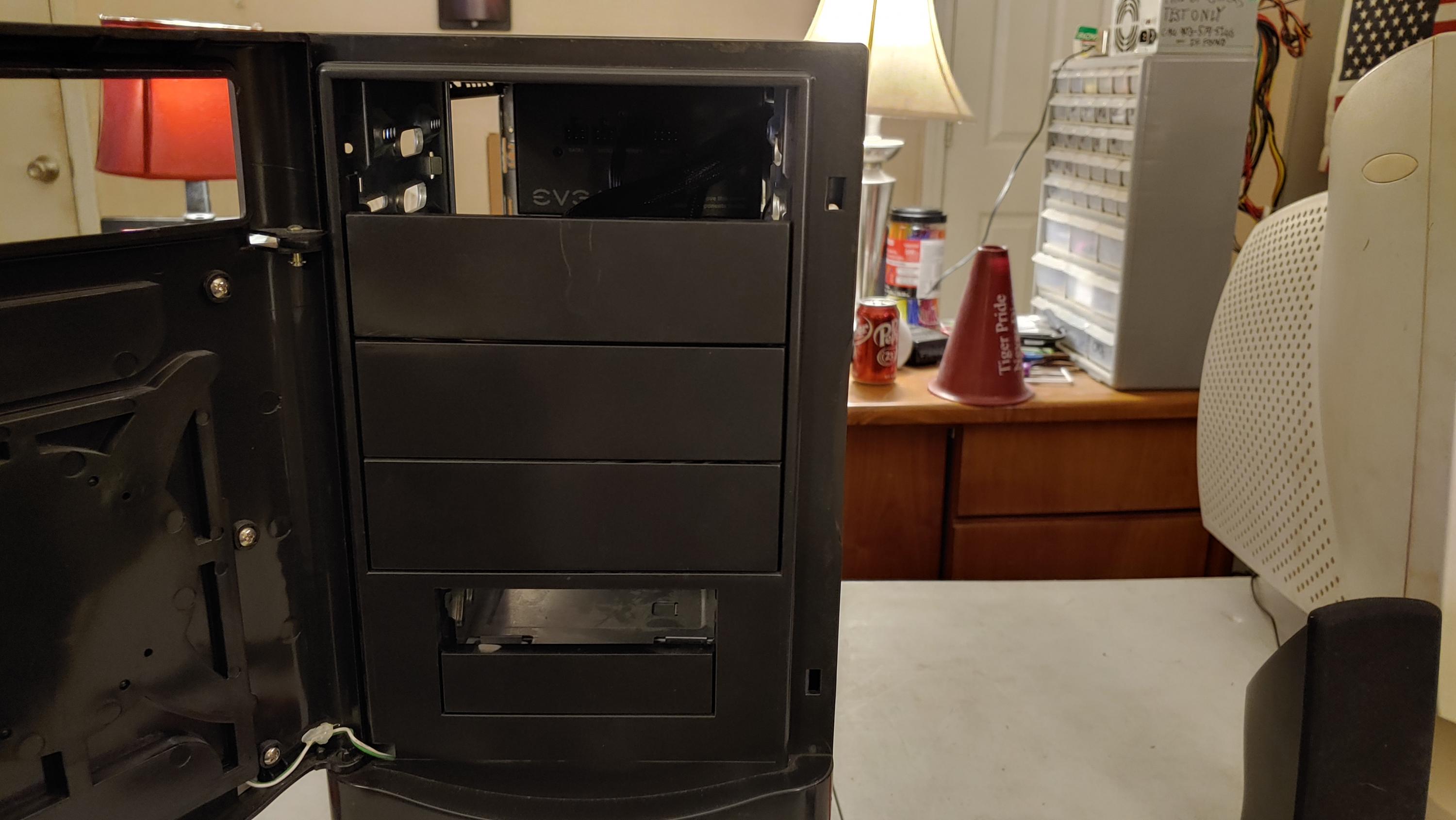

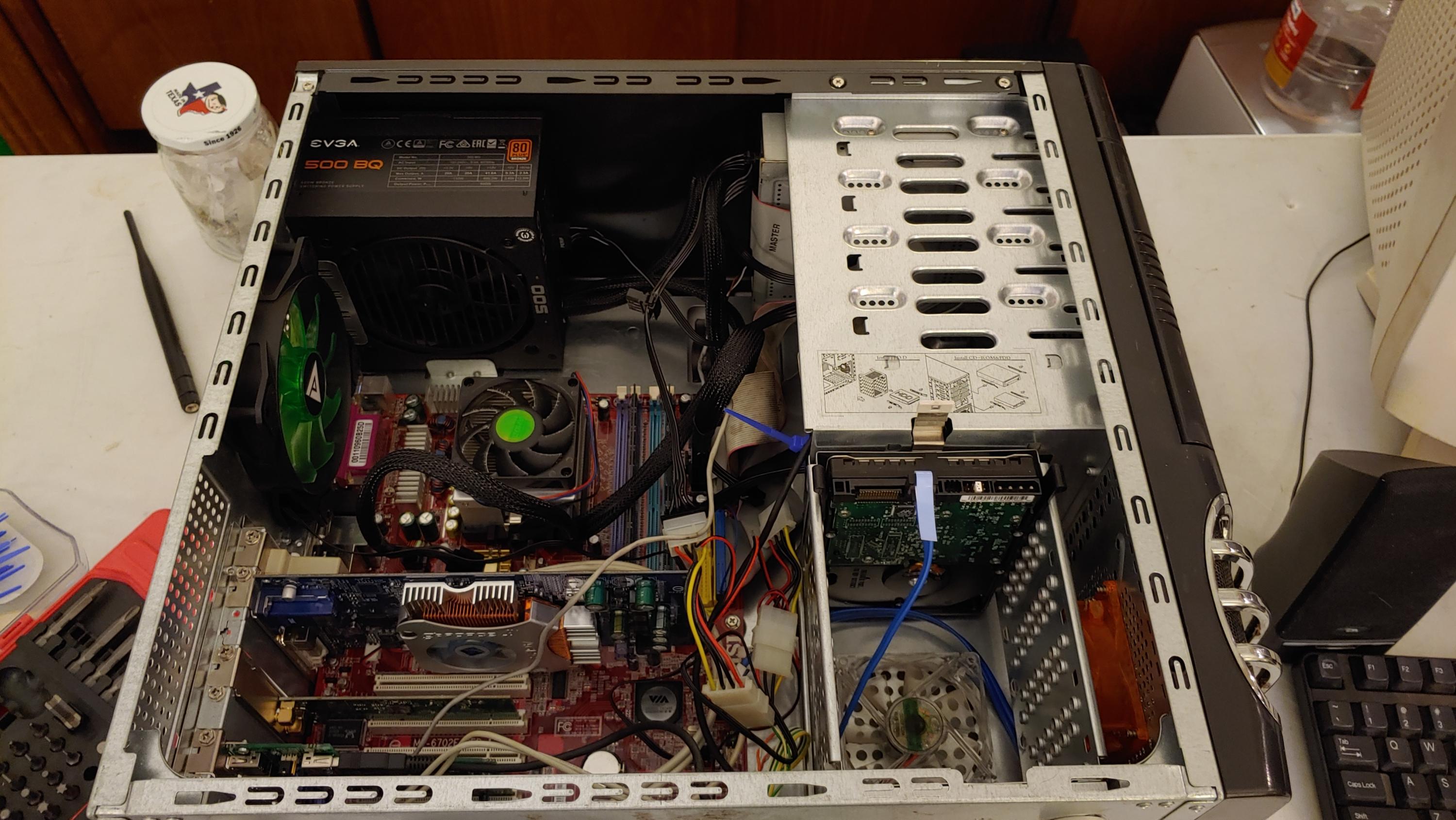

                        Hard drive cage pulled. HMMM, what to do with that fan slot?

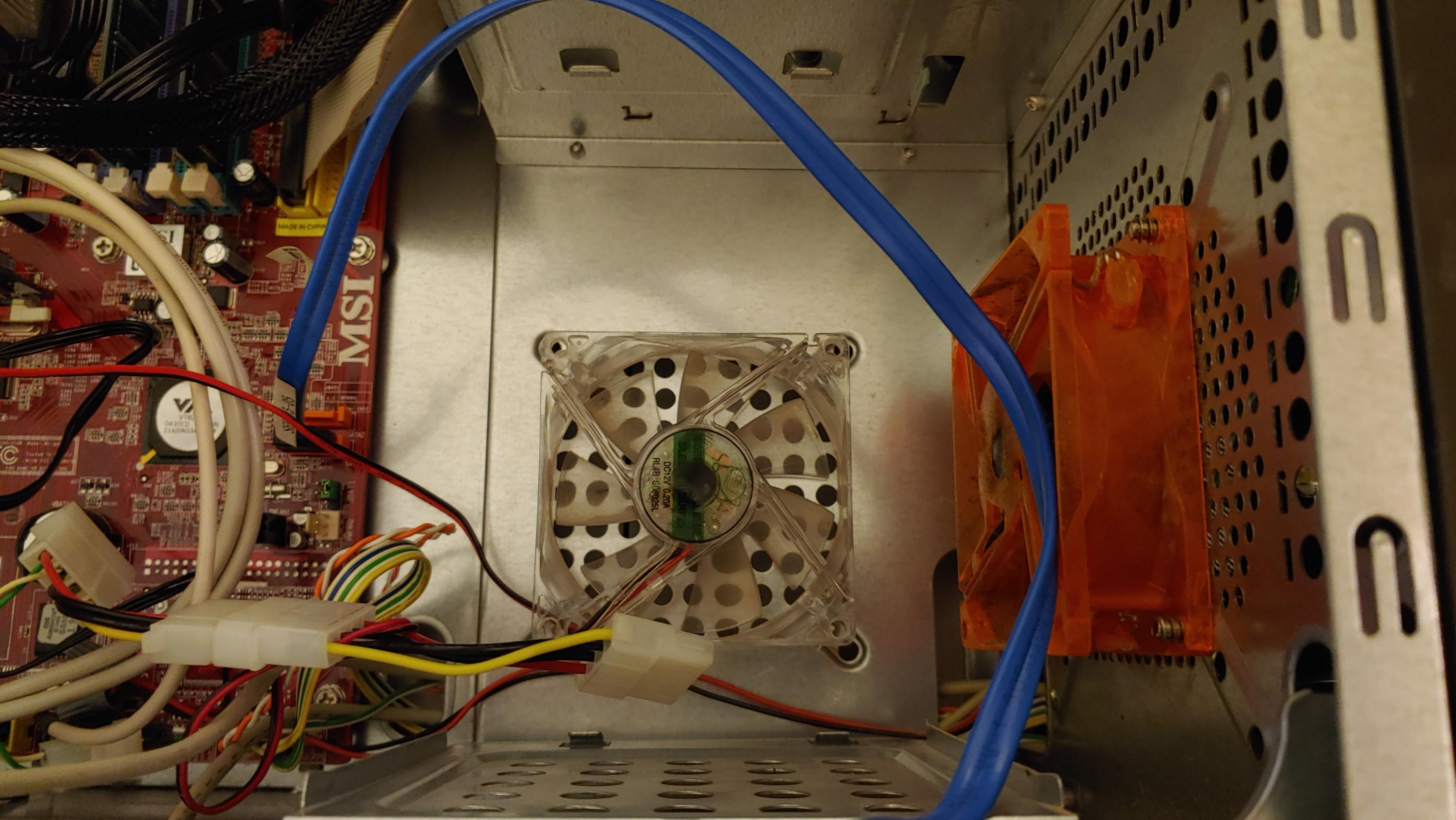

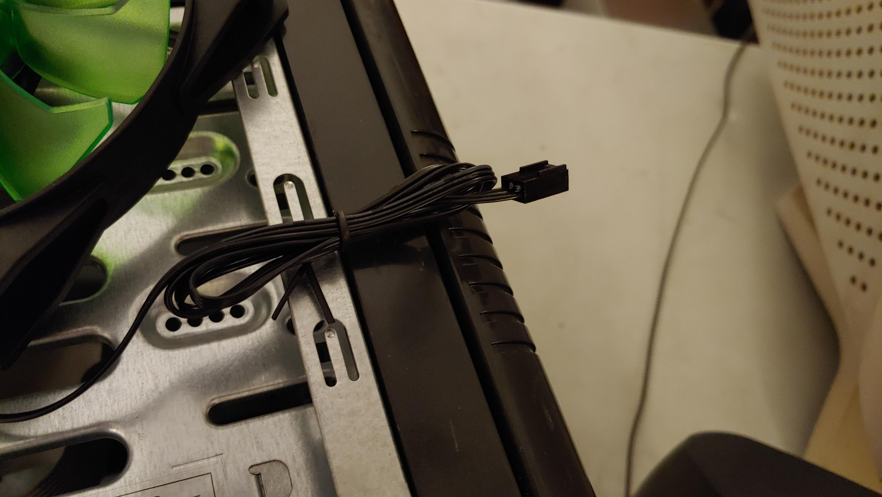

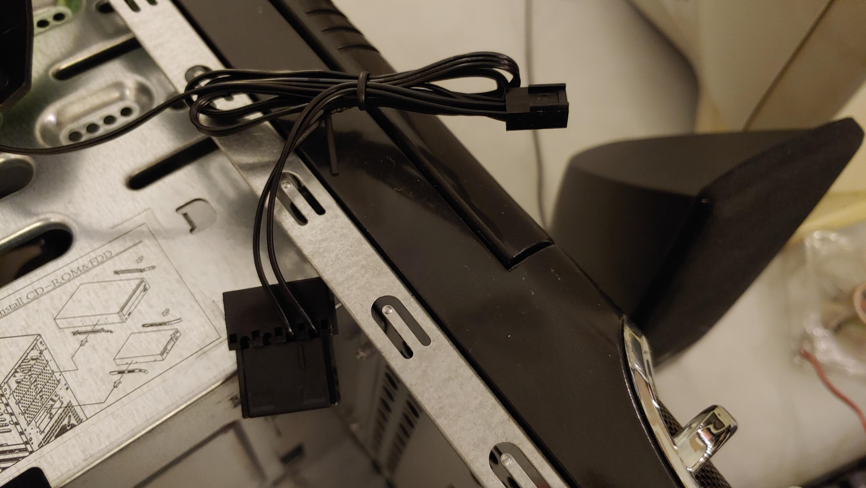

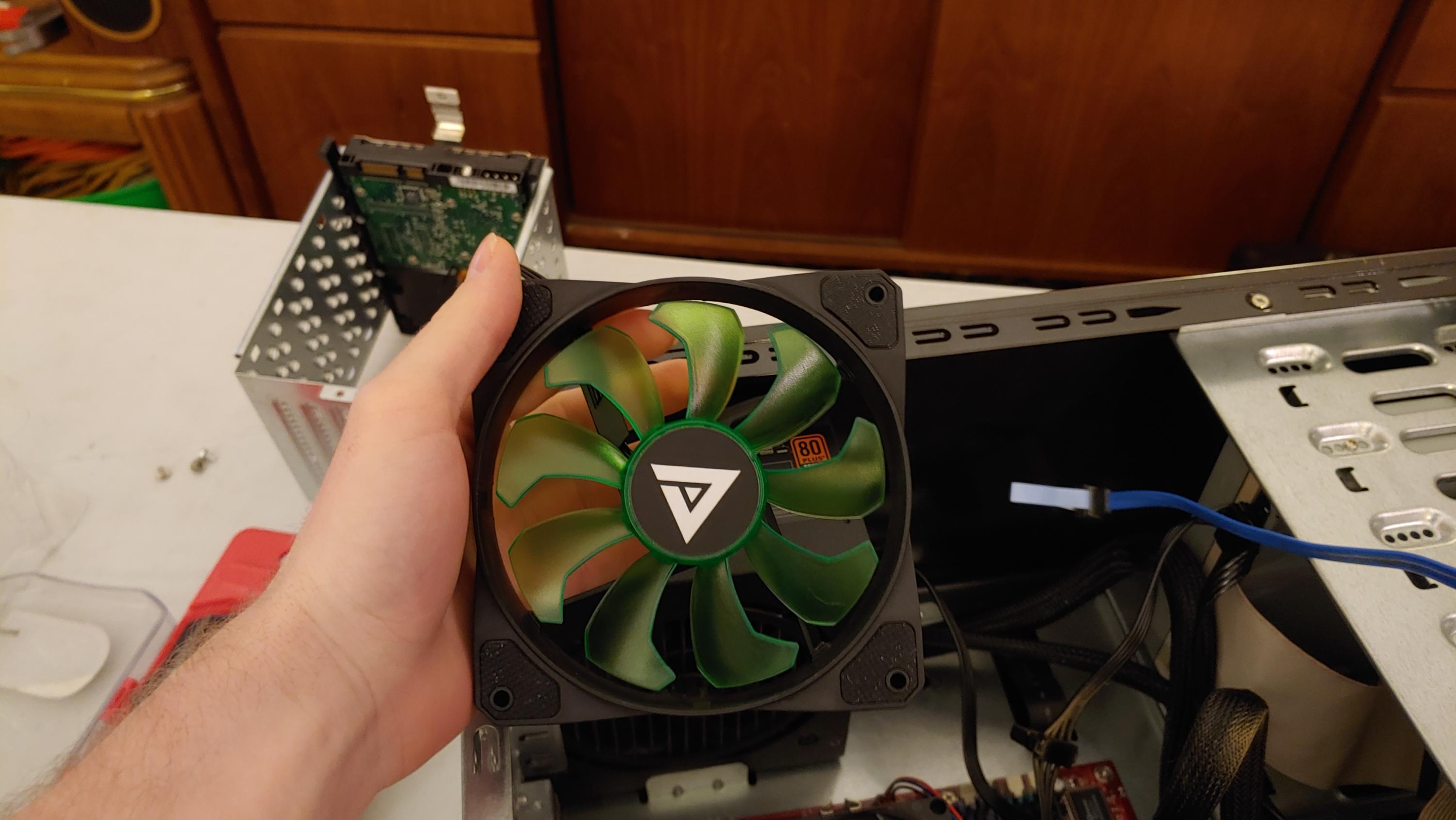

                        Fan upgrade time! Putting this Apevia 120mm fan in the back and moving the old rear case fan into that hard drive fan slot. But...
                        ...It's got one of those annoying Molex connectors that do not in any way belong on a fan that's also got a 3-pin connector. Don't hardwire it on there, just give me an adapter.
                        And cured.
                        Fan installed.
                        Rear case fan moved.
                        SATA hard drive reinstalled. This is a WD Velociraptor 10K 73GB drive. It's the drive that this system came with back in 2004 when it was built.

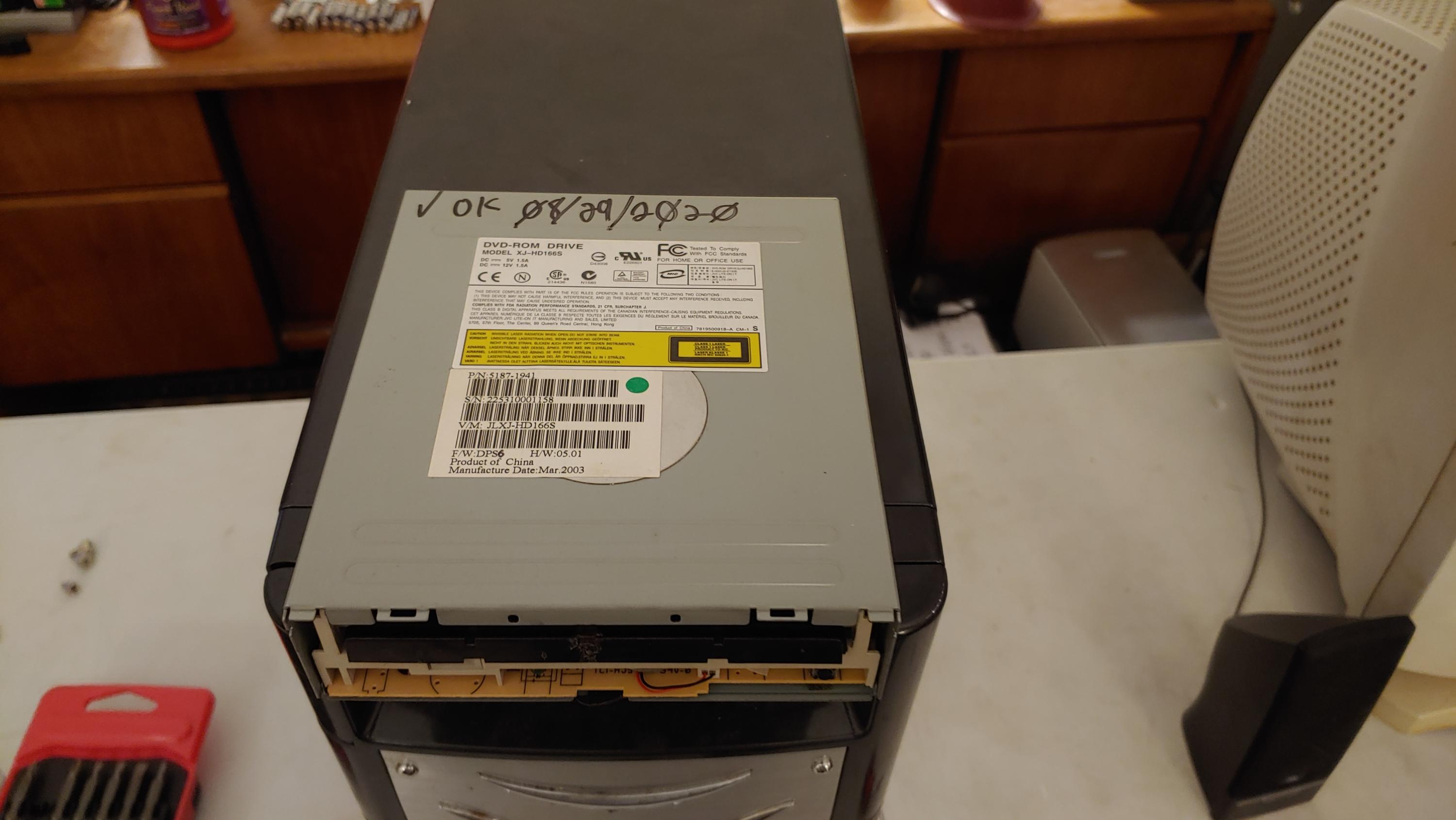

                        Removed the old, slightly busted but still working DVD reader.
                        Moved blanking plates around again. I'm going to install a floppy drive so that I can load the SATA drivers for the SATA controller on the motherboard before installing Windows 2000 and XP.

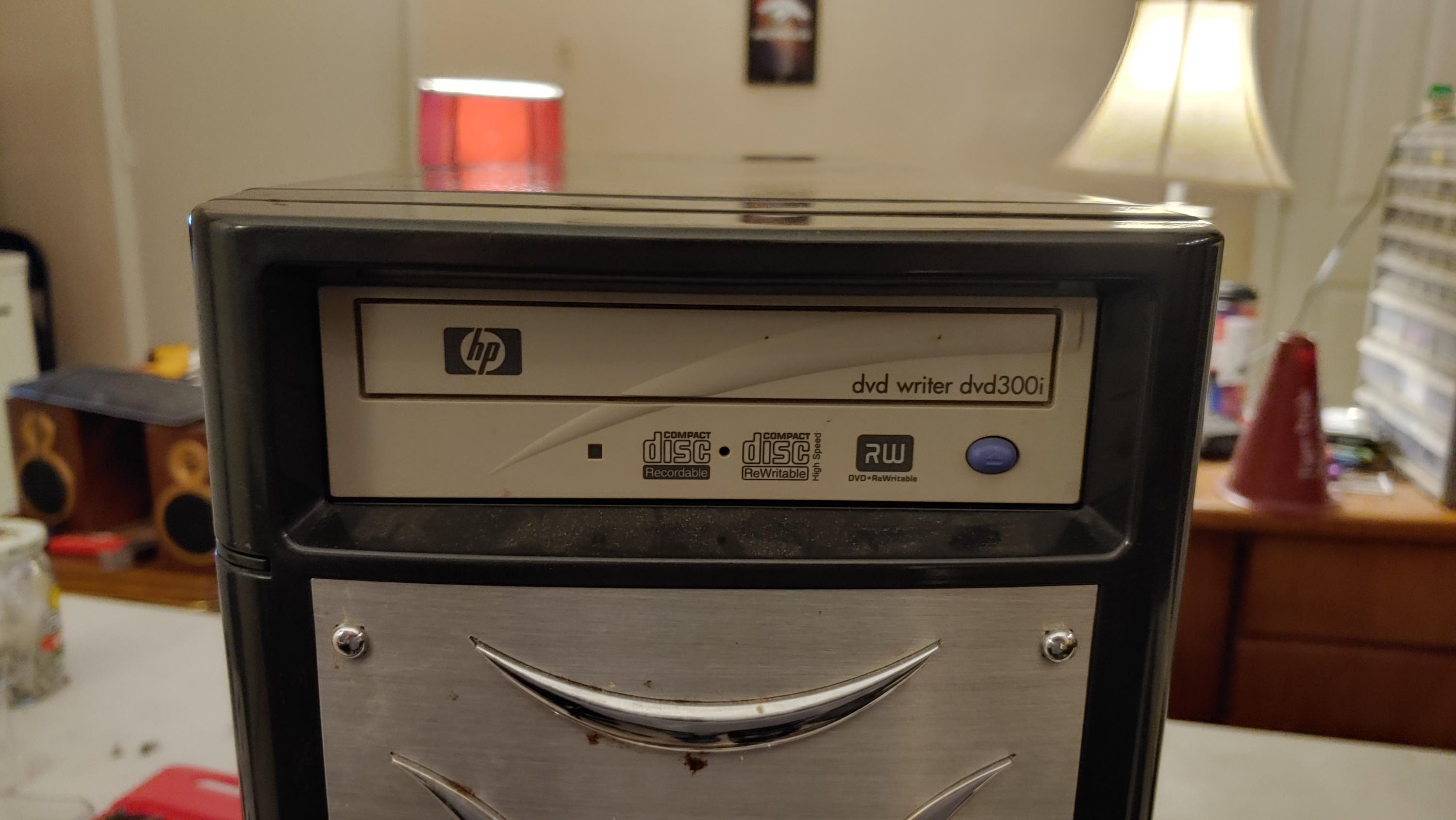

                        Here's the "new" DVD burner installed in the system.
                        And that's about as far as I got this morning before I sent myself on a wild goose chase looking for other stuff that I'll need to complete this build, such as a 34-pin floppy drive cable, 4-pin cable for the digital audio (from the optical drive), and some other odds and ends. More to come later!

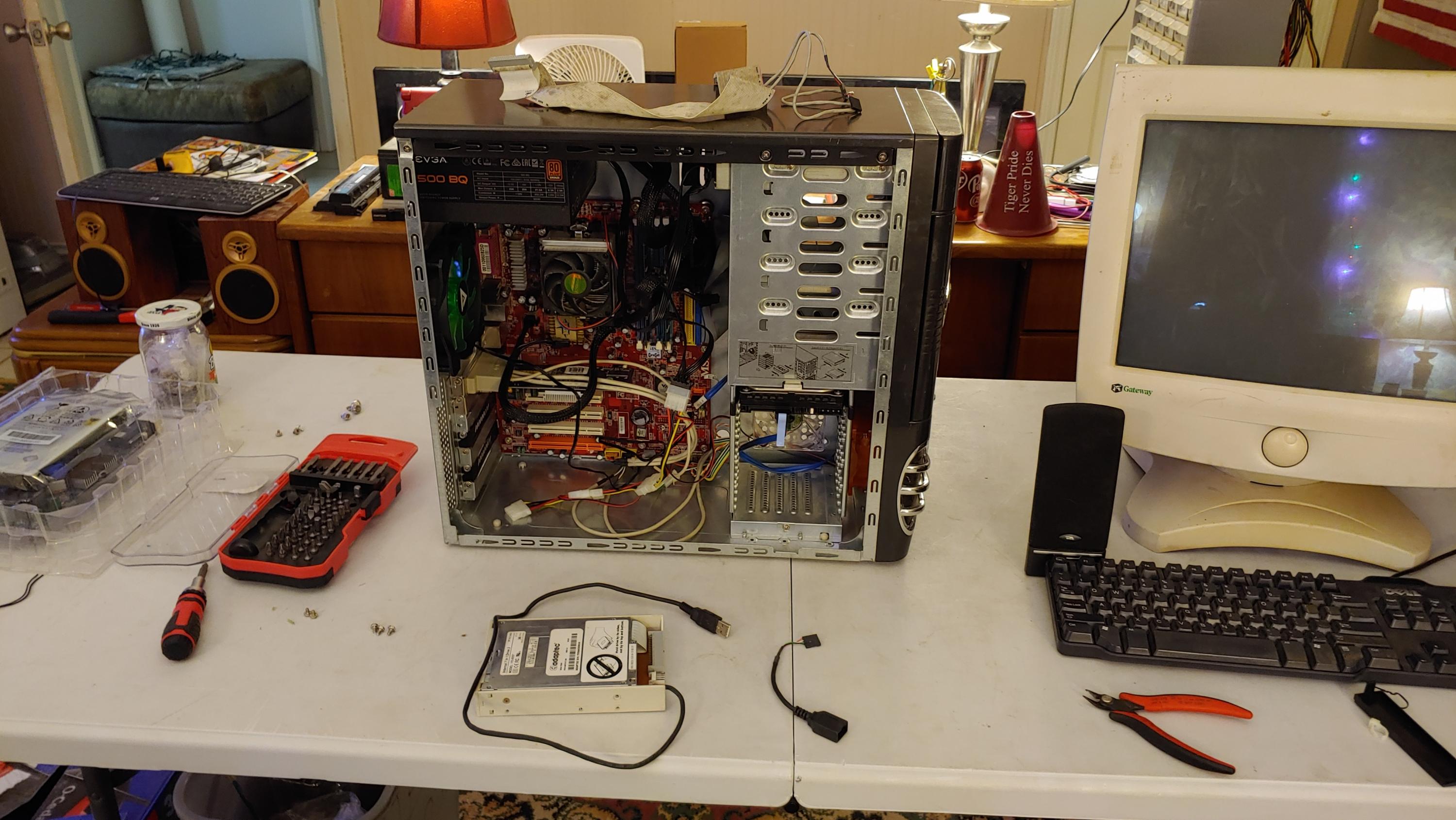

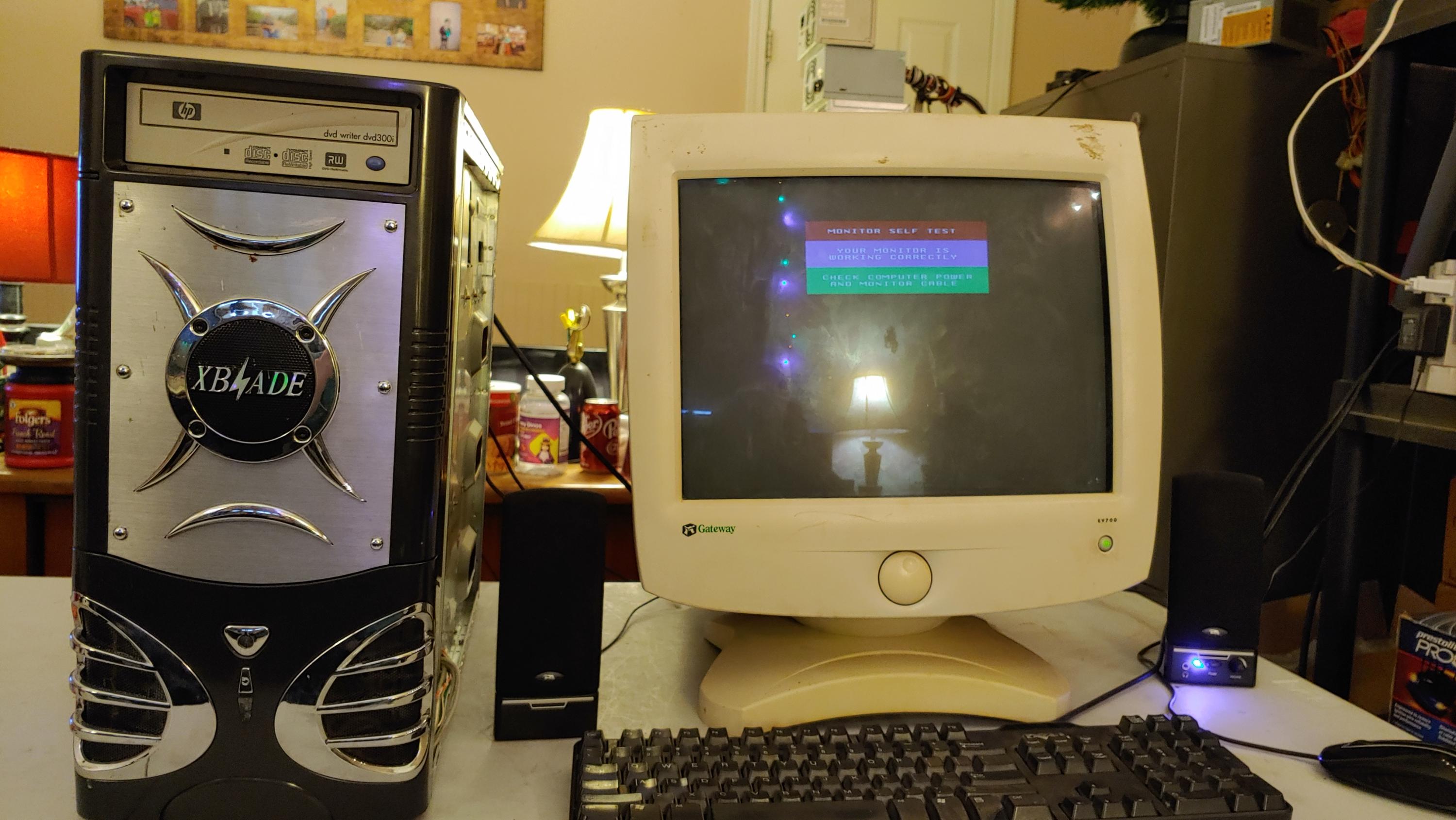

                          LOTS of high-res inline photos incoming!

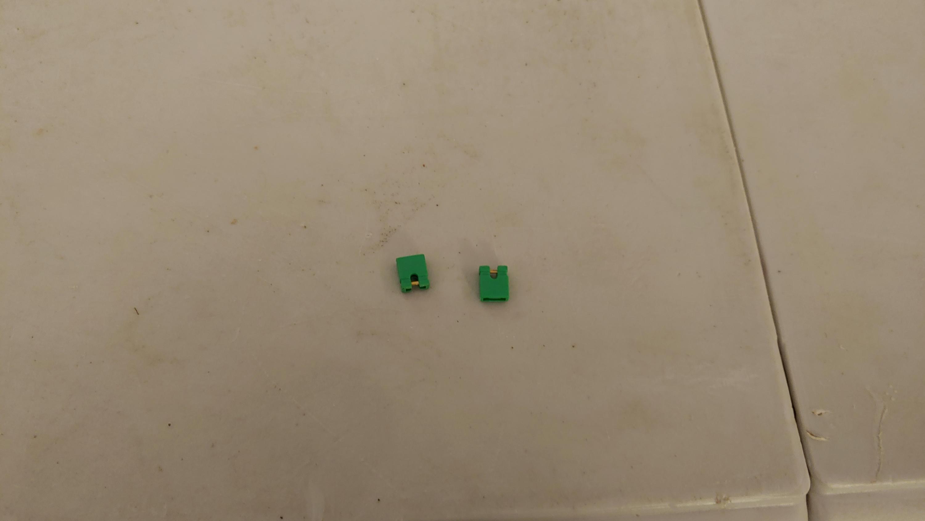

                          Now that I've weeded out dial-up/DSL users by incinerating their modems and phone line gateways, let's begin.

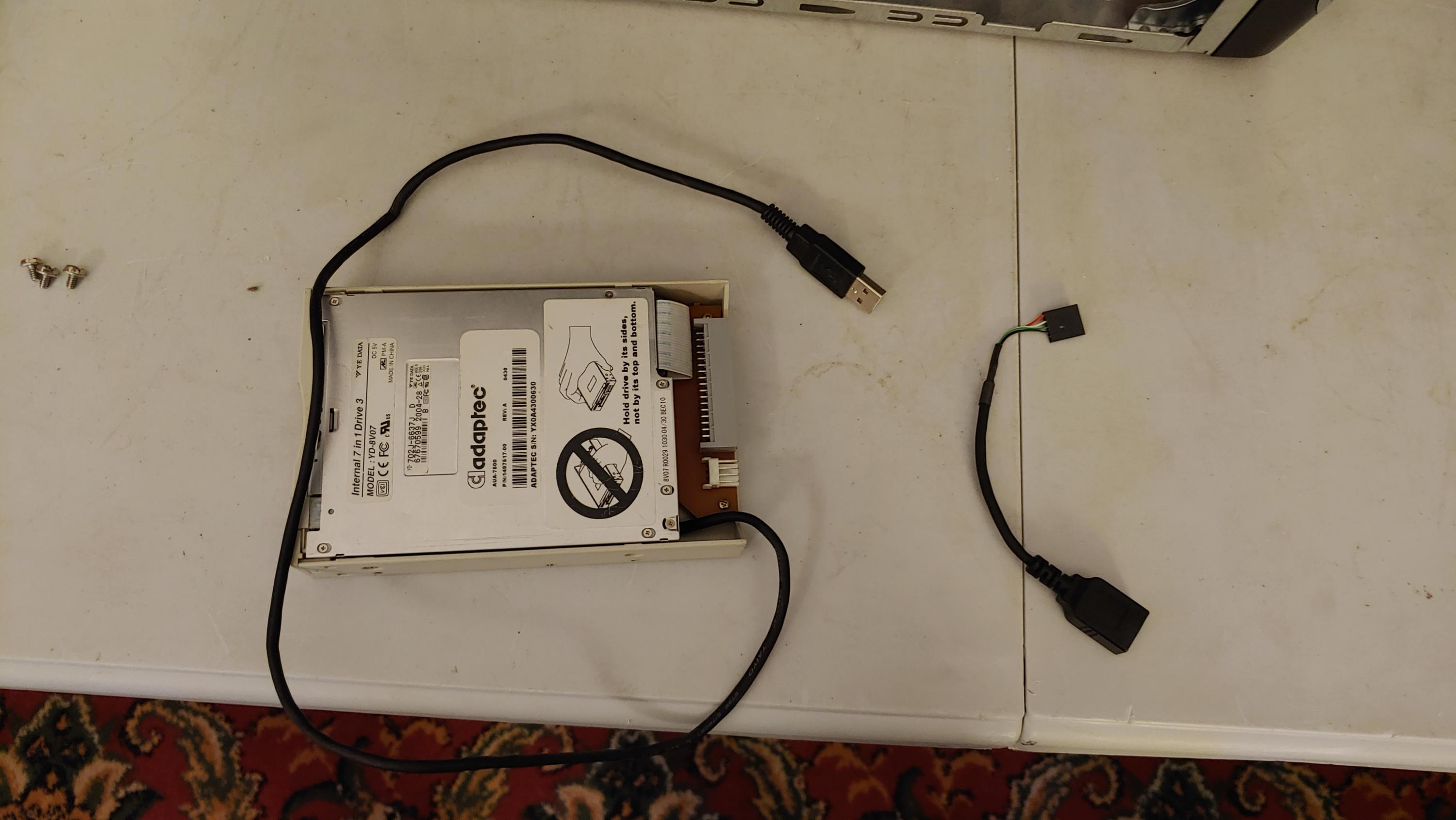

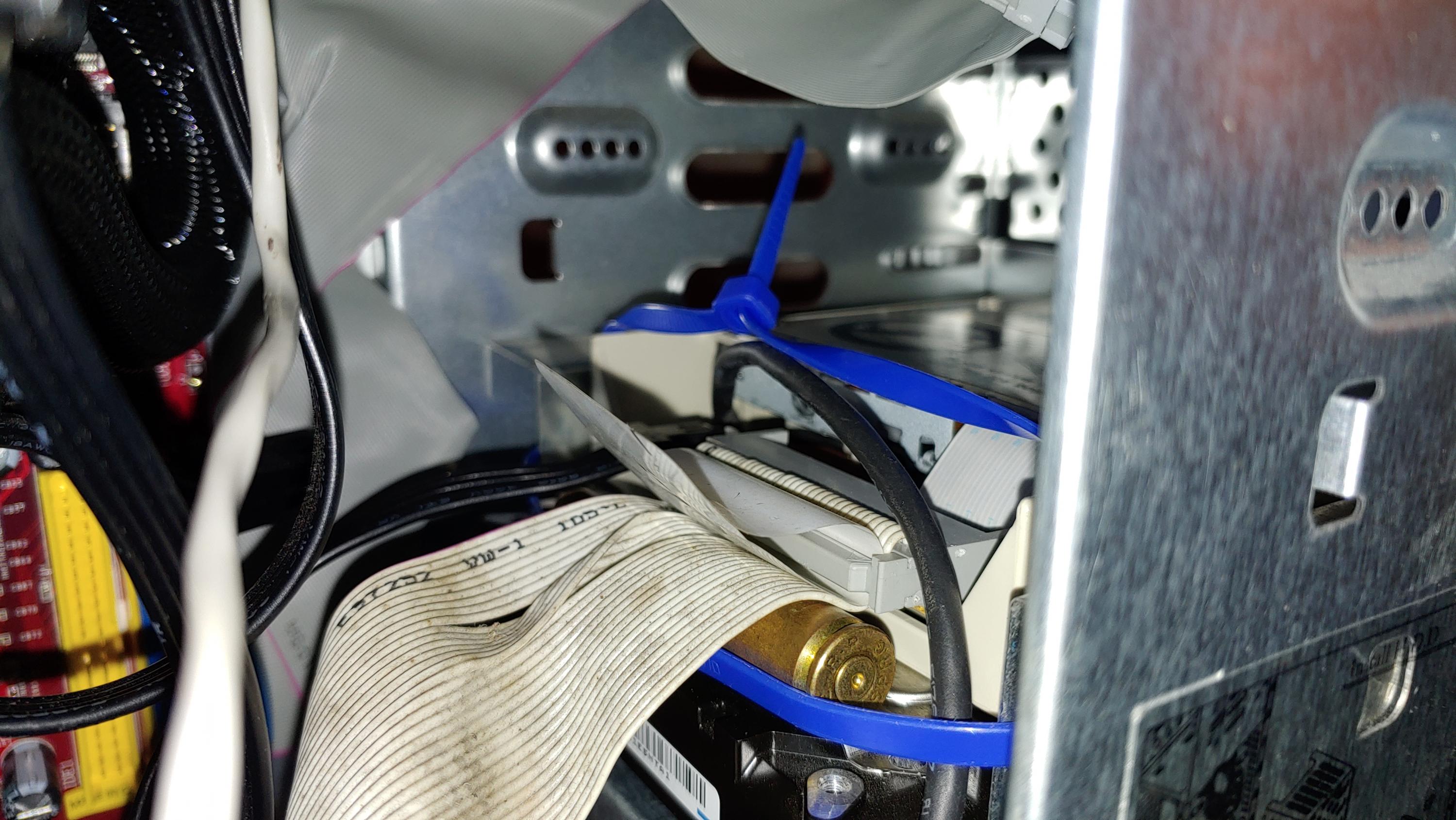

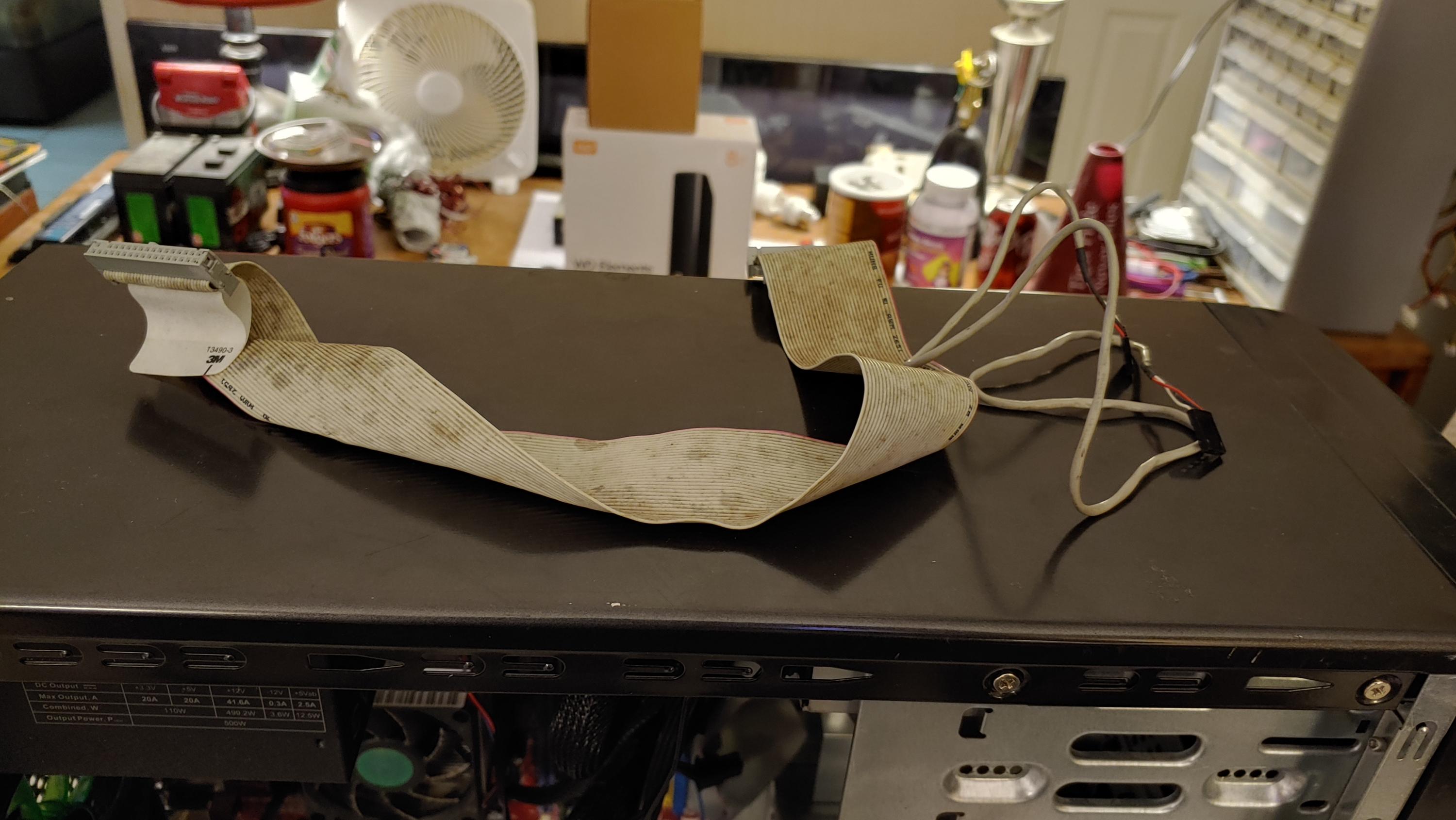

                          Several hours later- all odds and ends found. Floppy drive, 34-pin floppy cable, a USB adapter (which I ended up not using), and one of those CD audio cables.

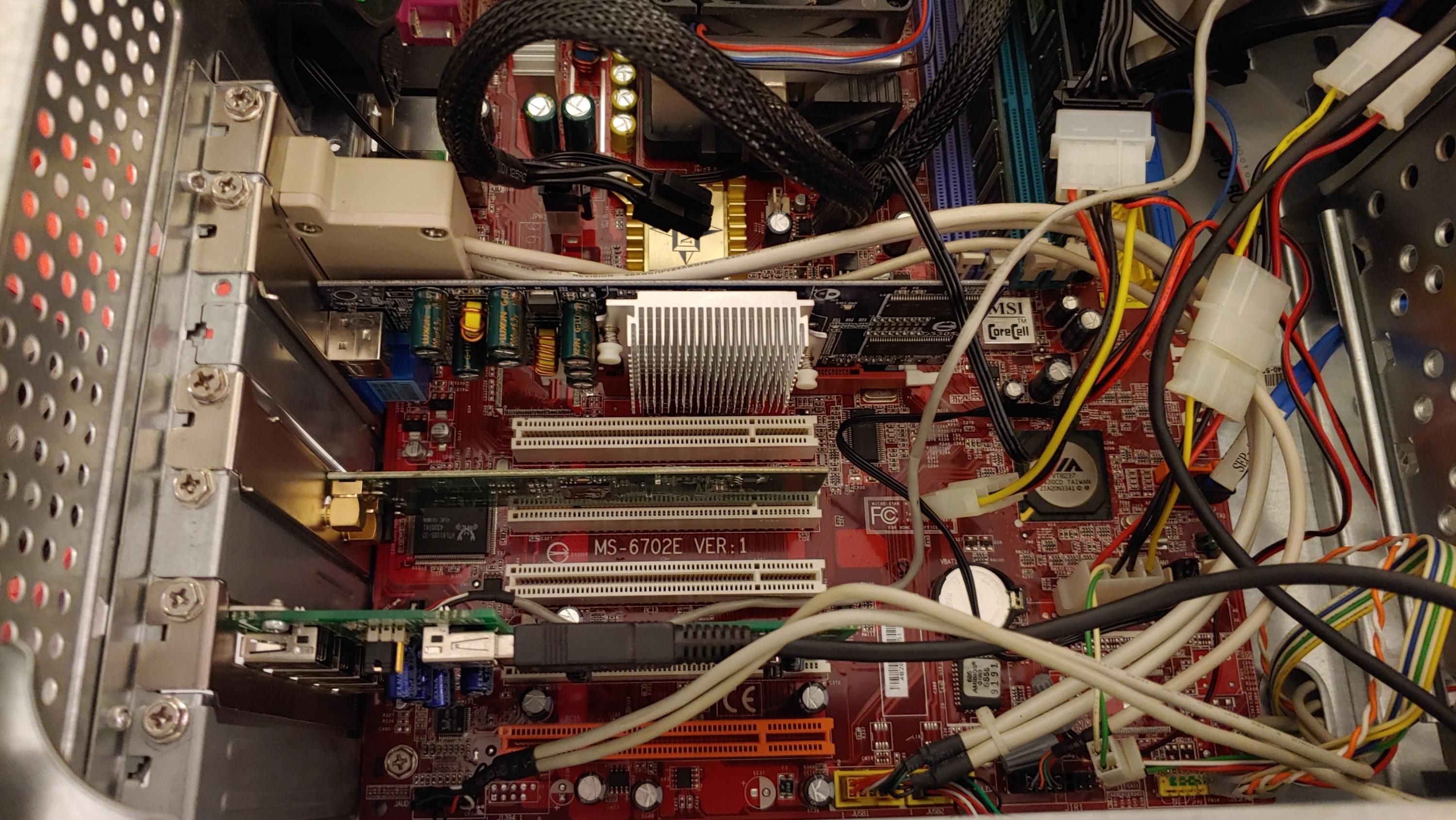

                          CD audio cable plugged in. It was rather tricky to get to due to all of the other cabling that was in the way.

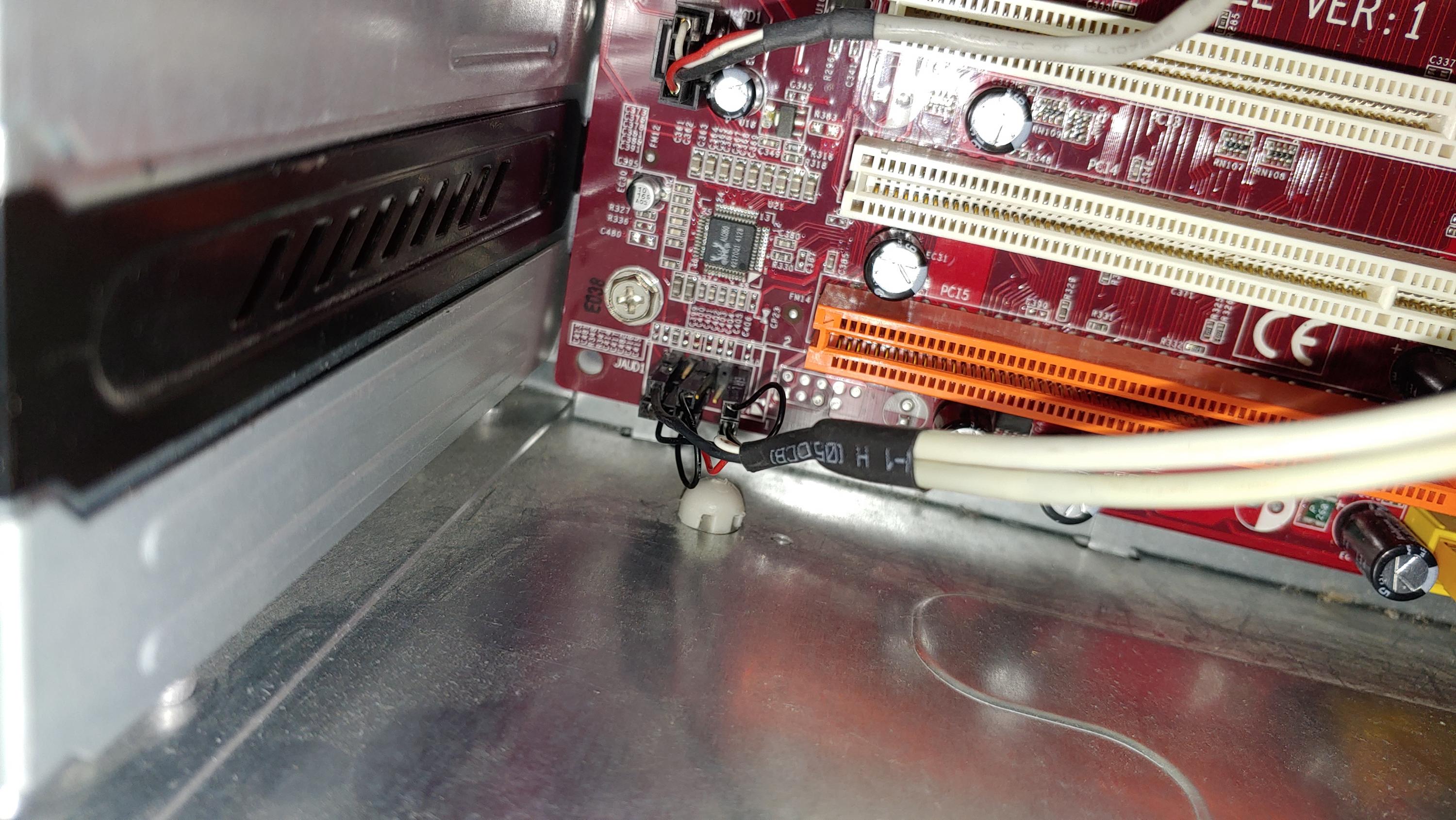

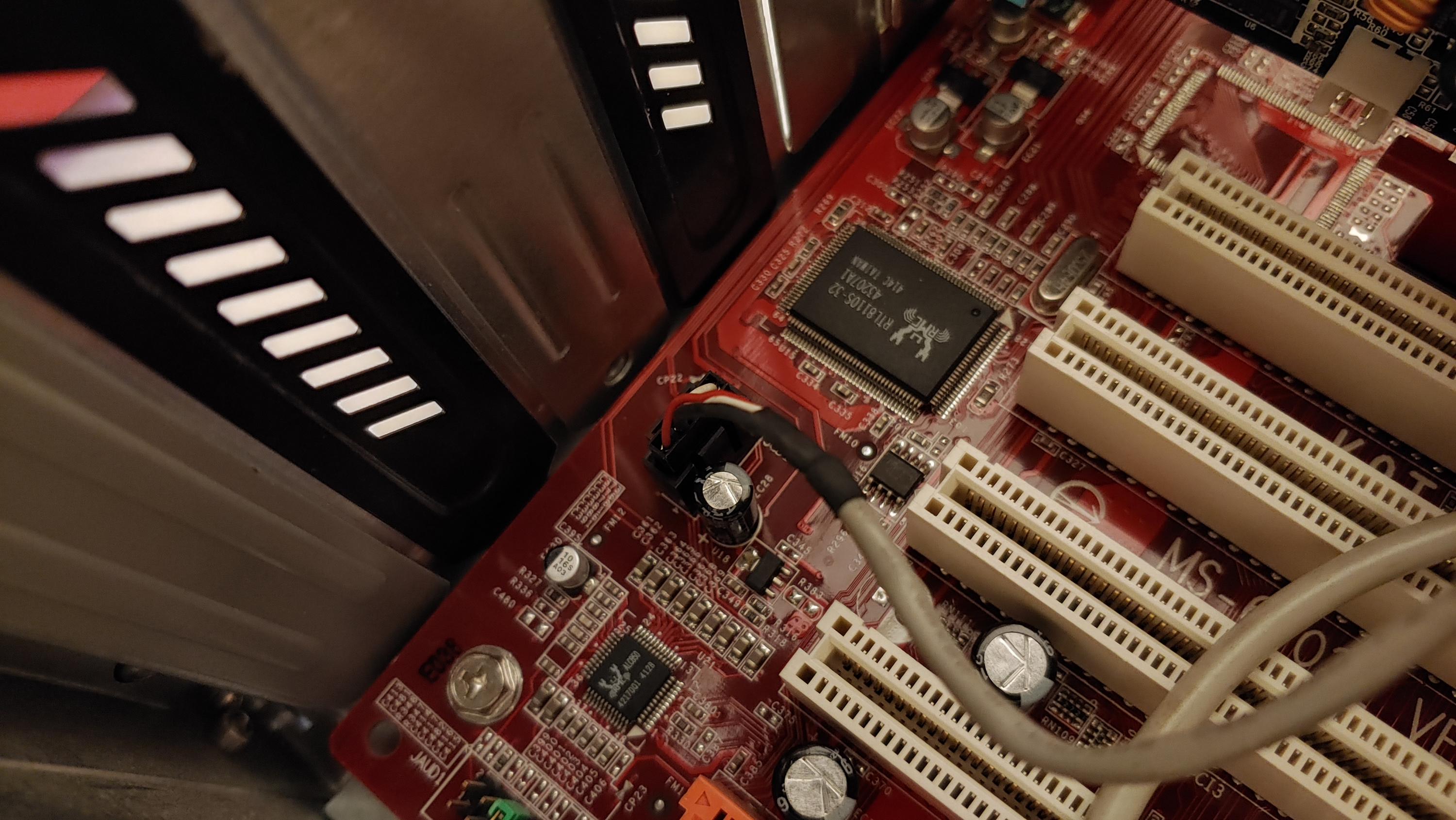

                          Motherboard audio header populated.

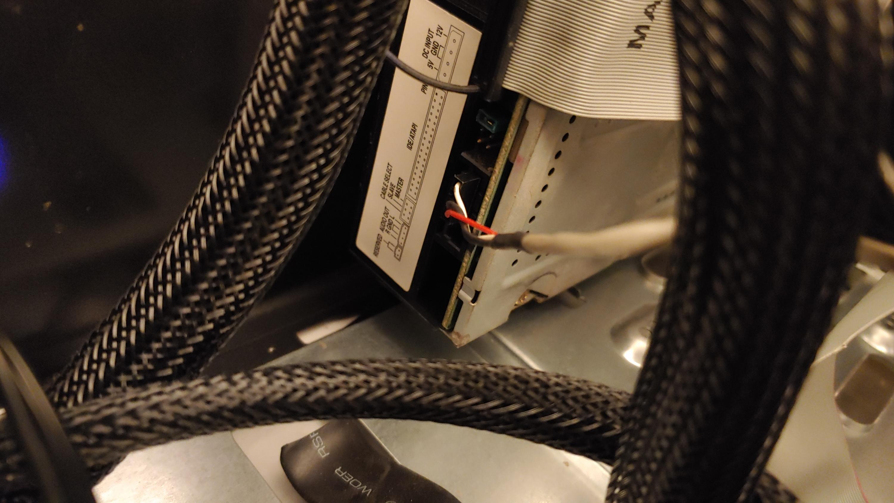

                          Floppy drive installed.
                          Yes, that is EXACTLY what you think that is. Floppy drive is sitting on top of a dead Seagate drive. It's kept from floating around with 2 blue zipties and a bullet casing to keep it from slipping back into the case.
                          Front panel audio hooked up. First time in the 17+ years it's been since the system was built that this header had ever been connected.

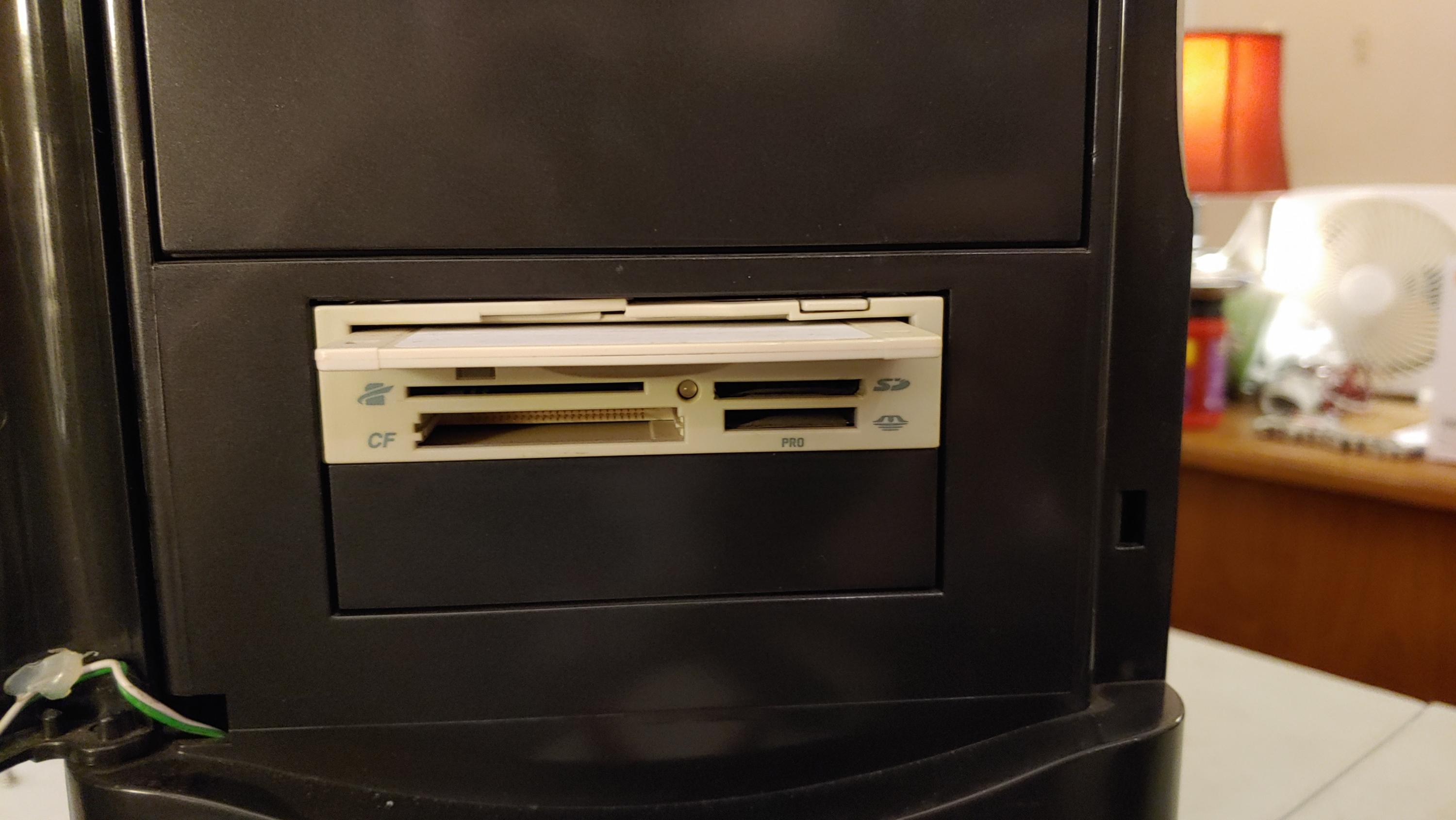

                          Wireless card and USB 2.0 card installed. The card reader part of the combo floppy drive is plugged into it.

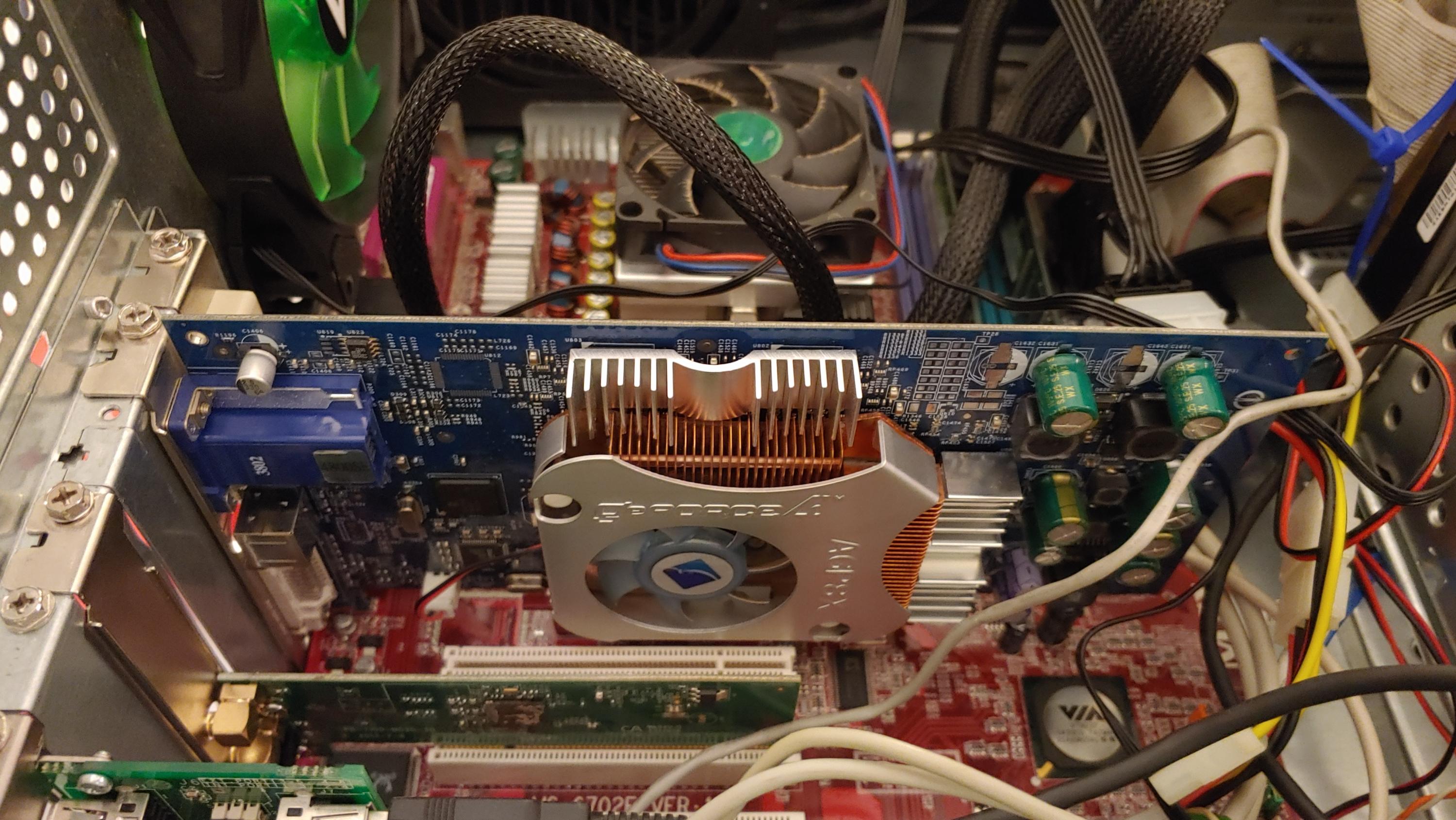

                          GeForce4 Ti 4800SE GPU reinstalled.
                          And this is probably why the onboard audio had never really worked right. These were connected across sense pins that told the audio controller that there were headphones connected.

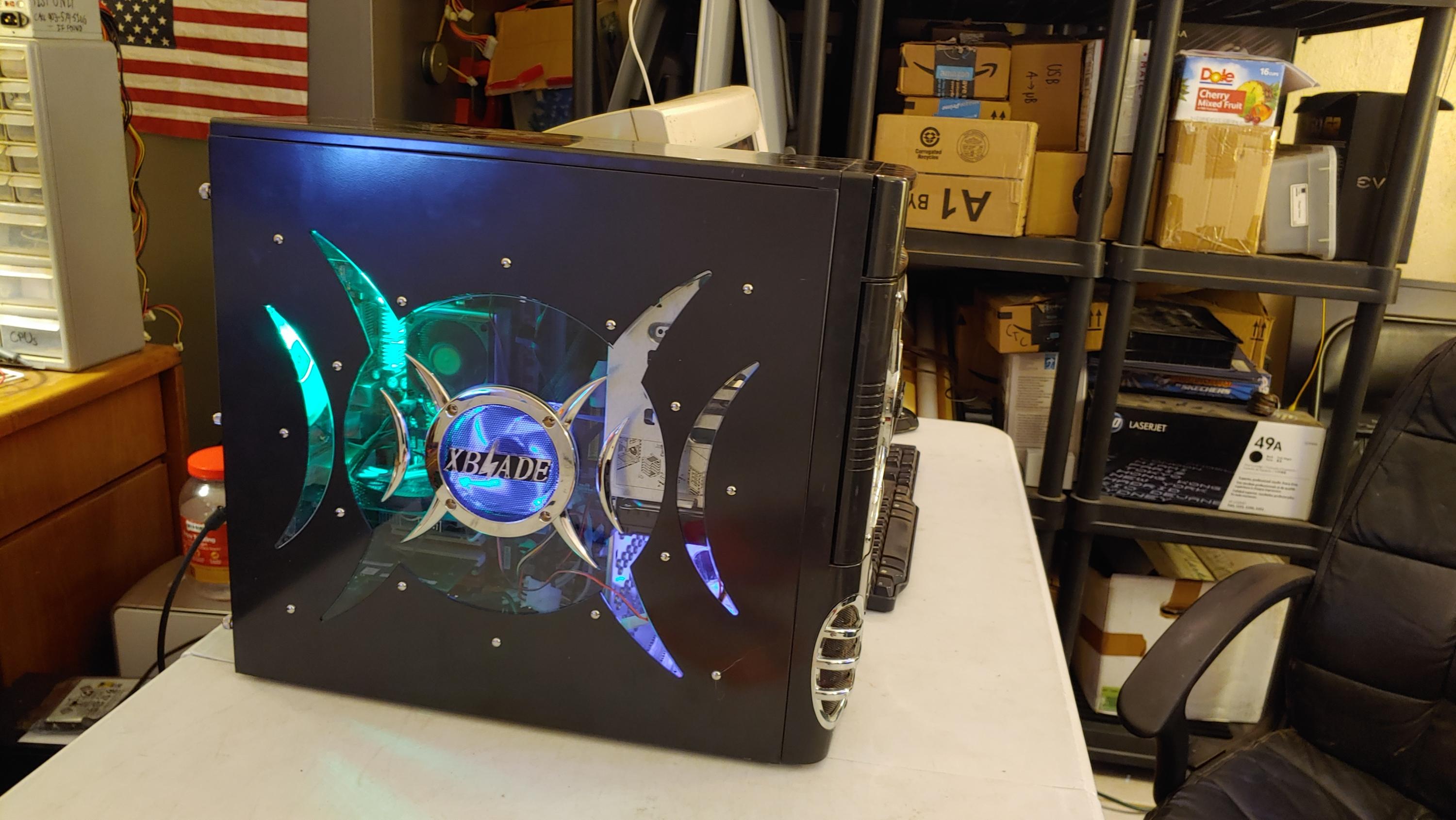

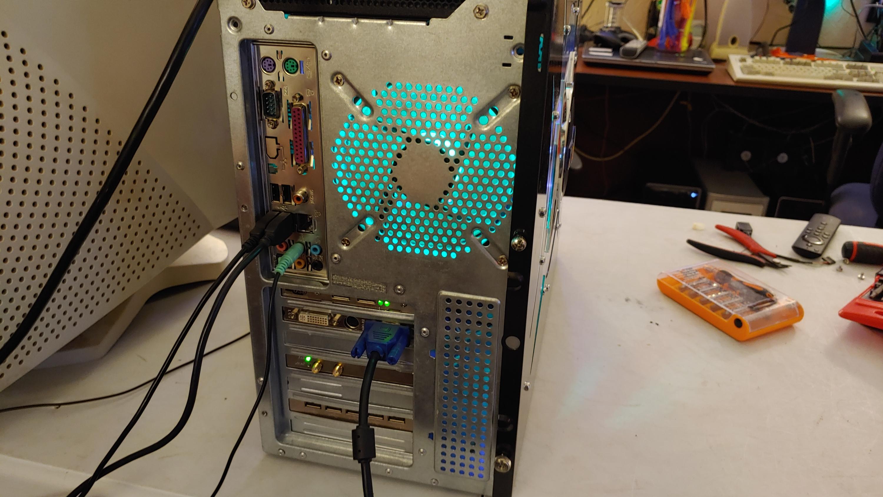

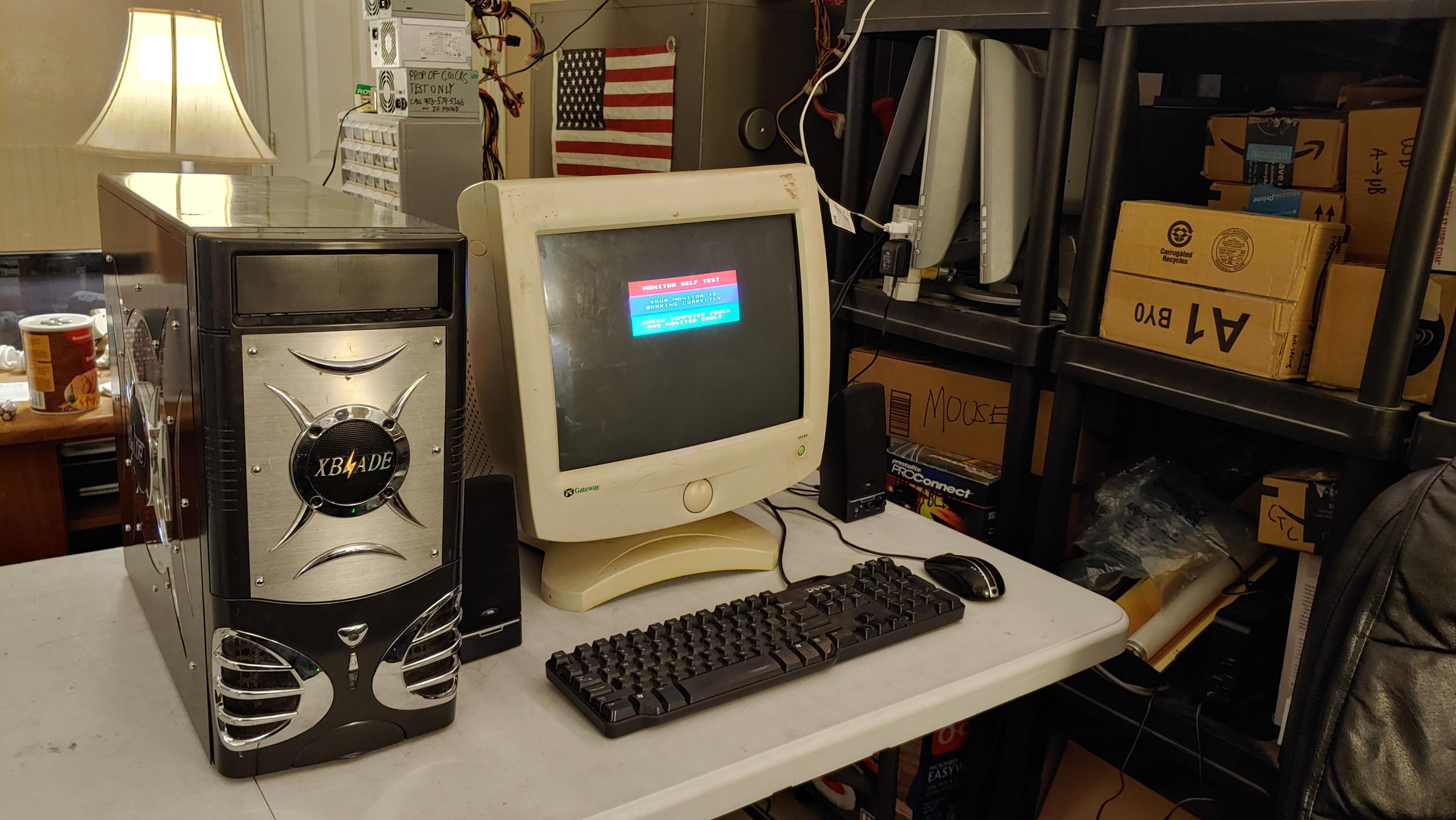

                          Fully reassembled.
                          Hooked up...
                          ...and IT'S ALIVE!
                          Butt shot...
                          Side shot...

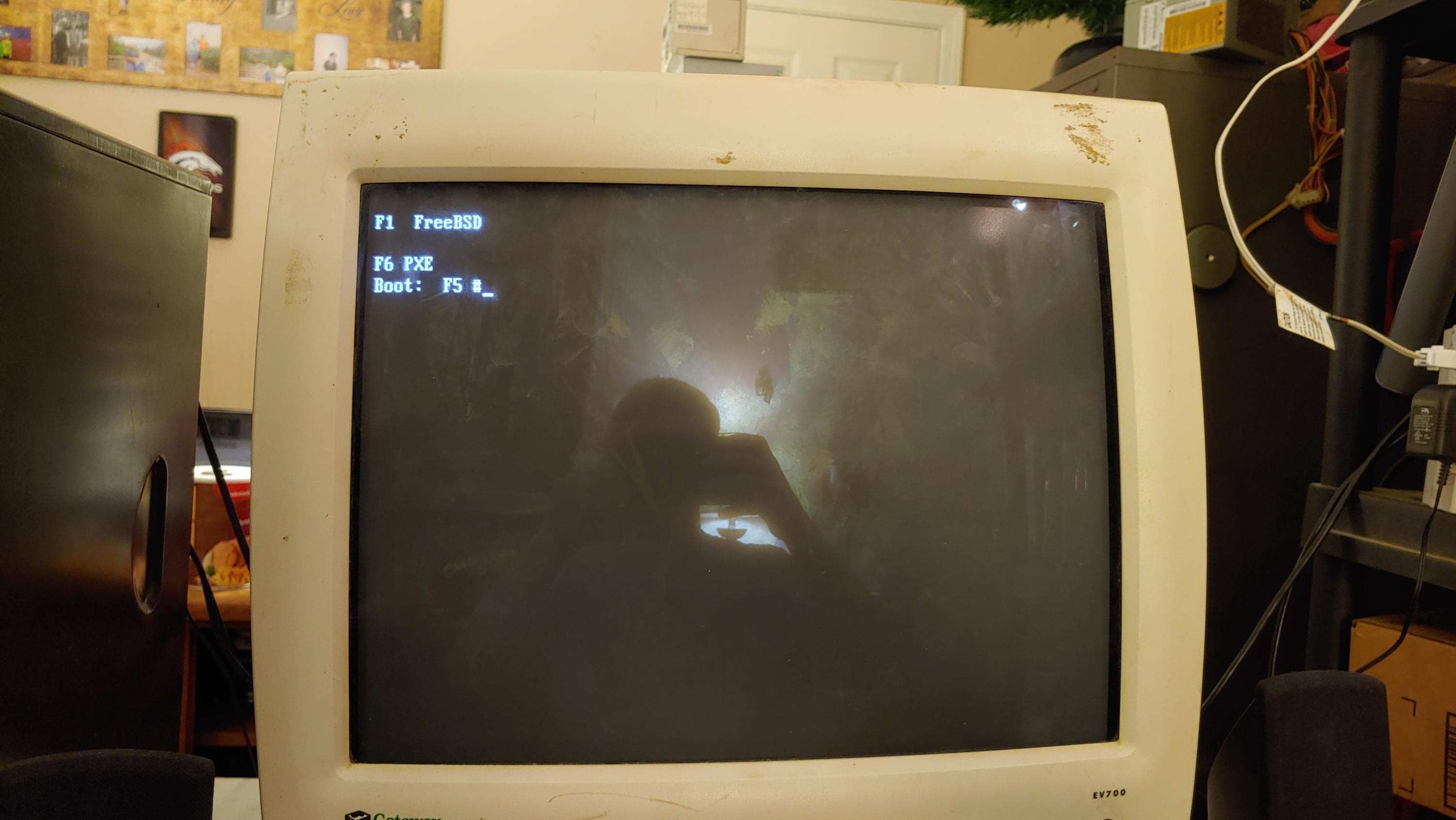

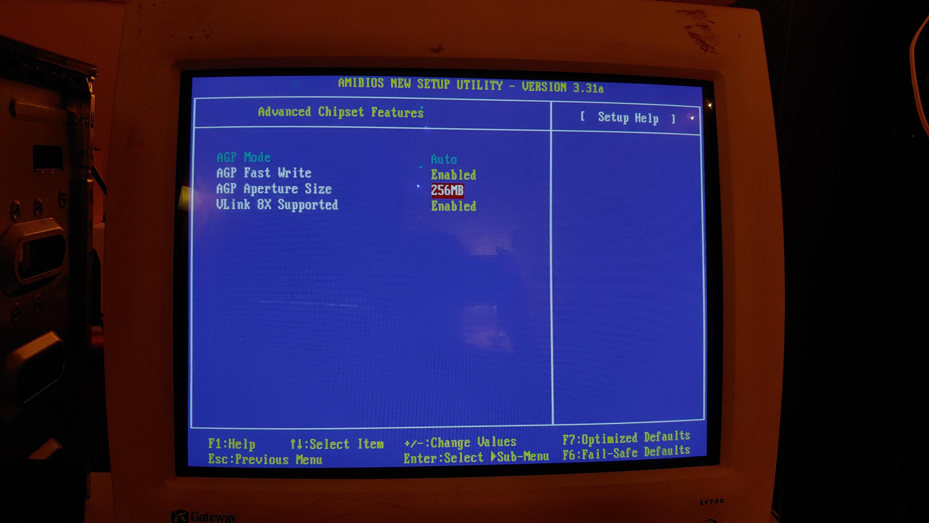

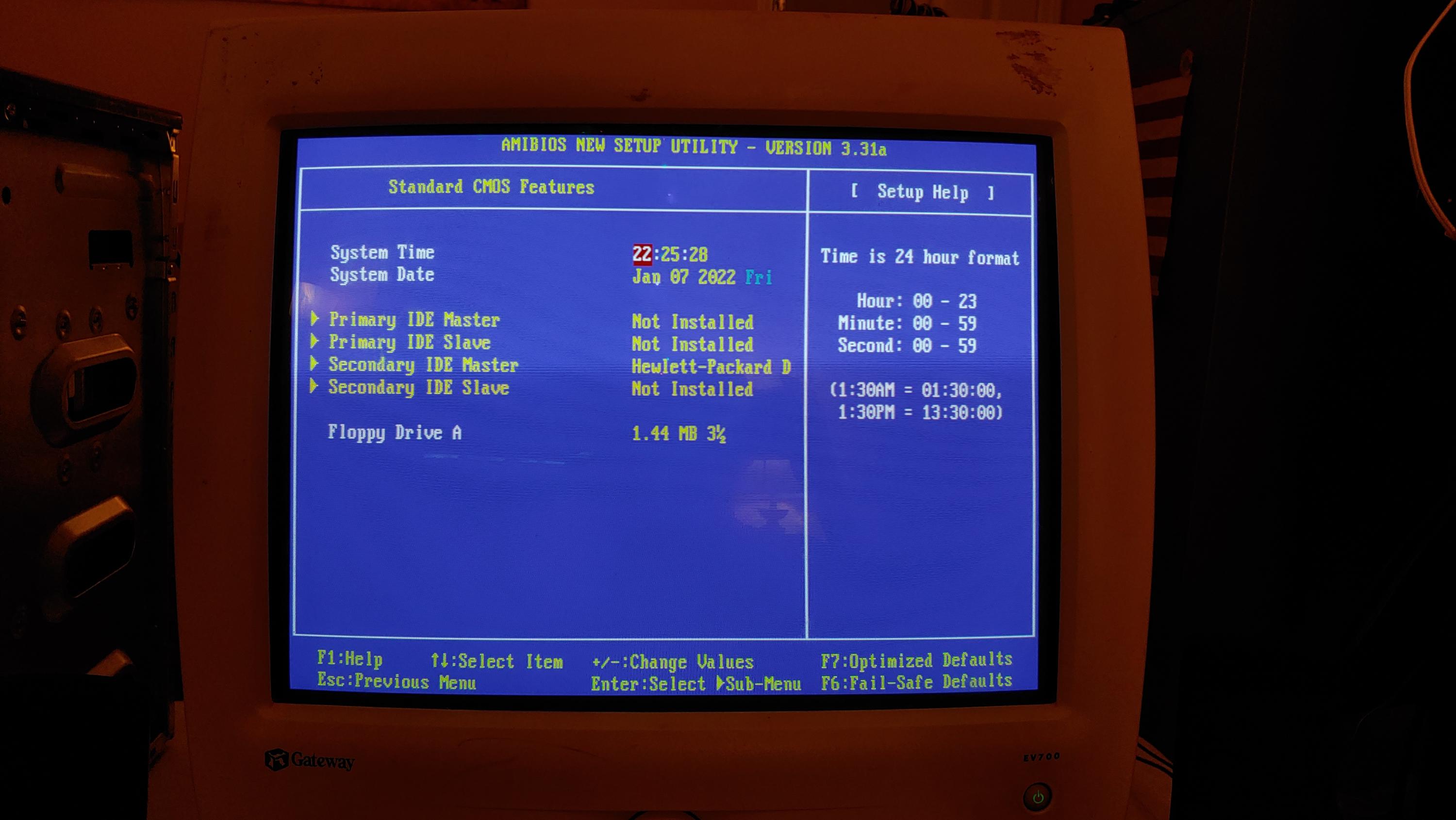

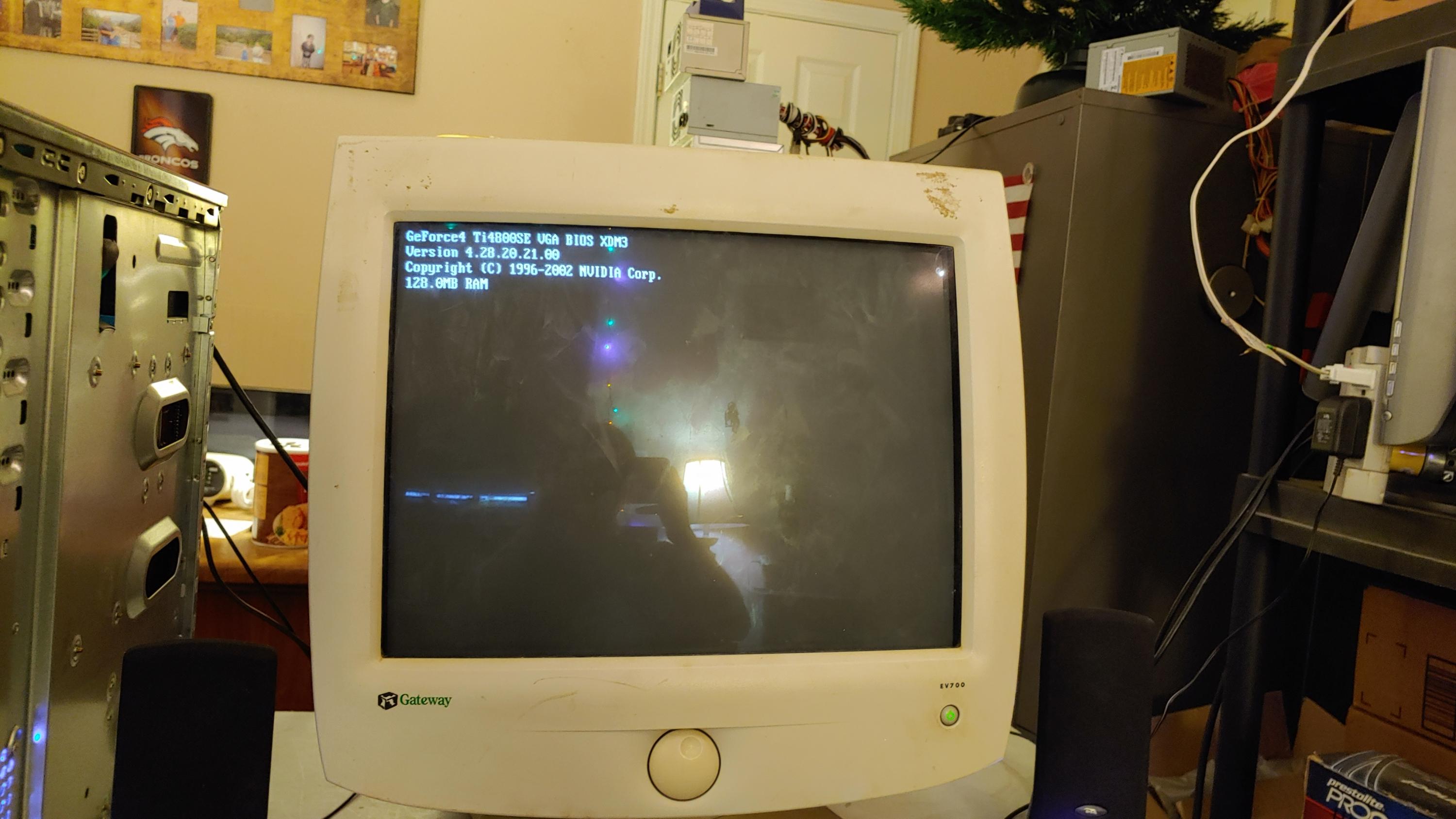

                          Headed into the BIOS to configure things.
                          Enabled the FDD...
                          Set the AGP aperture size...
                          ...and more to come soon.

                                  Nailed it! RE GPU: It ran basically 24/7 for 14 years on that GeForce4 Ti 4800SE, plus however long it was on in it's previous leases on life.
                                  Nice!
                                  14 years of 24/7?! That's actually quite amazing. Normally those GeForce 4 TI cards don't last this long, despite having wire-bonded cores.
                                  Then again, the heatsink on yours looks a little better than the stock/reference ones, so that may be why too. Make sure to keep its fan running well, or the GPU will fail quickly.
                                  https://www.badcaps.net/forum/attach...1&d=1641573654
                                  Those are pretty neat for a retro built - lots of speed for the legacy stuff, especially XP.
                                  BTW, why not move the HDD down a few slots. It is a Raptor after all - could use some cooling from the fan you just installed.
                                  If you were closer, we could do a trade: me give you a black DVD drive and you give me the beige one.
                                  Don't know why, but I've never ran across that many DVD-RW drives in beige. CD-RW, though - no problems, I got plenty of those.
                                  My OCD tells me that floppy drive cable needs a wash.
                                  https://www.badcaps.net/forum/attach...1&d=1641660284
                                  Analog audio cable for the optical drive?! I don't think I've ever used one in the last 15 years of PC building. And if a system came with one, I removed it, unless it was some ancient system that actually needed it. Correct me if I am wrong, but weren't those cables only needed way back in the day when audio hardware was just too... simplistic? IIRC, this was needed back in the day if an audio card didn't have proper decoding ability, so the optical send it analog audio directly. On a "modern" motherboard like this one, I don't think there are any benefits... but again, correct me if I am wrong. I have a good number of these cables and have always wondered if there's any use for them.
                                  Dang! TC recapped even that small cap next to the audio controller with a tiny Rubycon (I'm guessing 5V regulated rail.)

                                  Now black floppies is also something I don't have many of (1, I think?)
                                  It's a nice card reader + floppy, though.
                                  Now that is EPIC!
                                  It actually does scream early/mid 2000's PC now, as quite a lot of people back in those days did all kinds of mods to their PCs... you know, back when PCs weren't all black-everything and no wires to be seen anywhere in sight. The bullet, though:
                                  YES! A CRT!
                                  I approve of this union. Retro PC, you may now kiss the CRT monitor!
                                  Those LED fans give a nice glow!

                                      Originally posted by momaka
                                      Nice!
                                      The fan seems fine, and I gave everything a THOROUGH dusting back when I got the system in late-2018. Before, the GPU fan was a tad rumbly and the CPU heatsink was so packed with dust it couldn't breathe. How did that system survive!?
                                      I'm particularly fond of this drive. It's taken more than a bit of abuse and it still works fine.
                                      I do it so it eases load off of the ATAPI bus. It also annoys me quite a bit to hear the drive spinning up and down over and over when I'm playing a CD, instead of keeping at a steady 1x speed. Older computers with slower ATA busses could benefit greatly from this, too.
                                      Noted.
                                      Trade?
                                      Now that is EPIC!
                                      Noted. I do love these old cases that just scream for cheezy lighted fans everywhere. Just not a fan of mounting rails for everything.
                                      YES! A CRT!
                                      Gateway EV700B from October 2000. Fits things nicely.
                                      They sure do.
