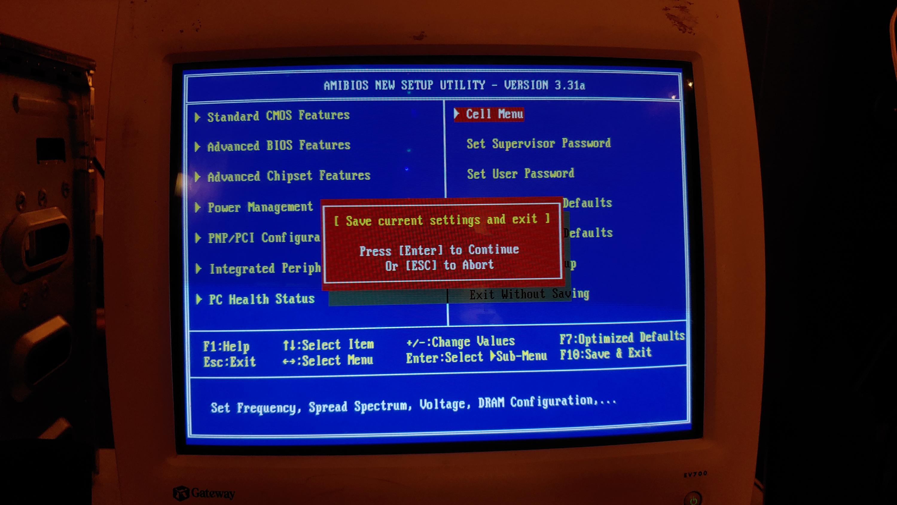

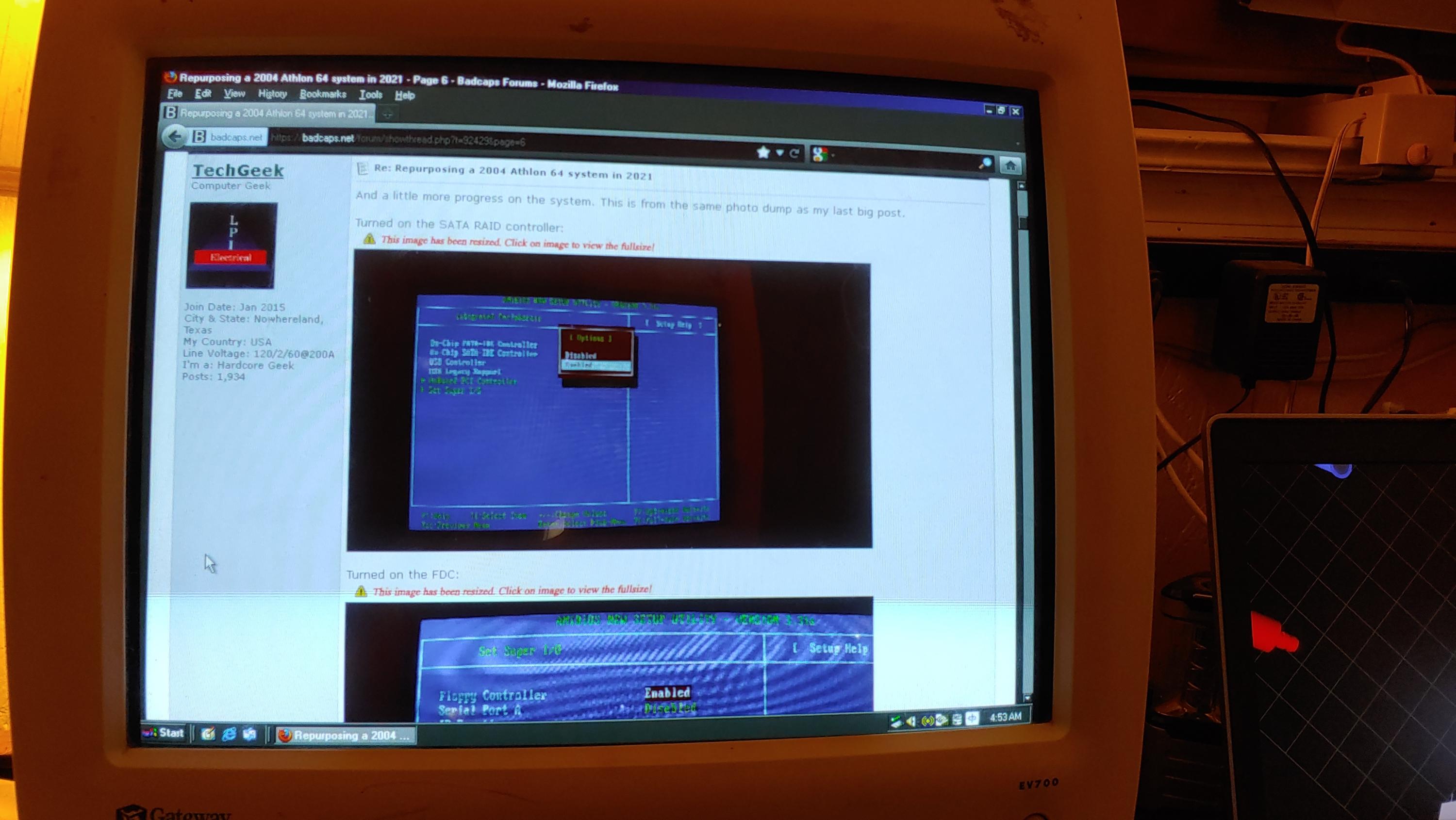

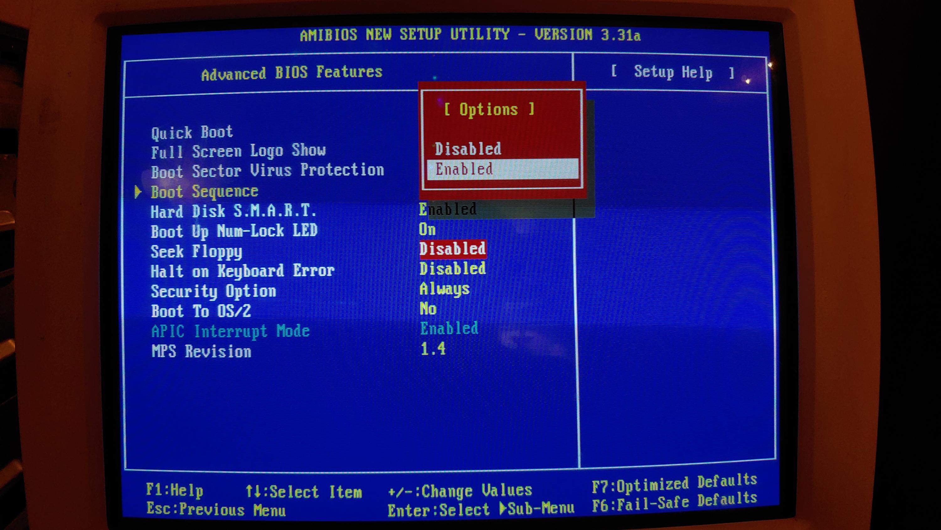

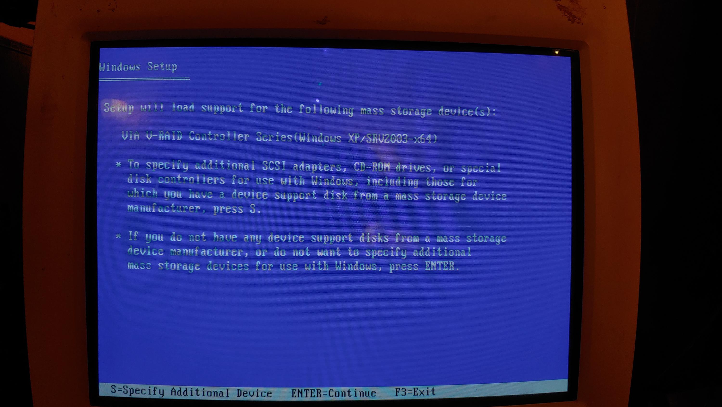

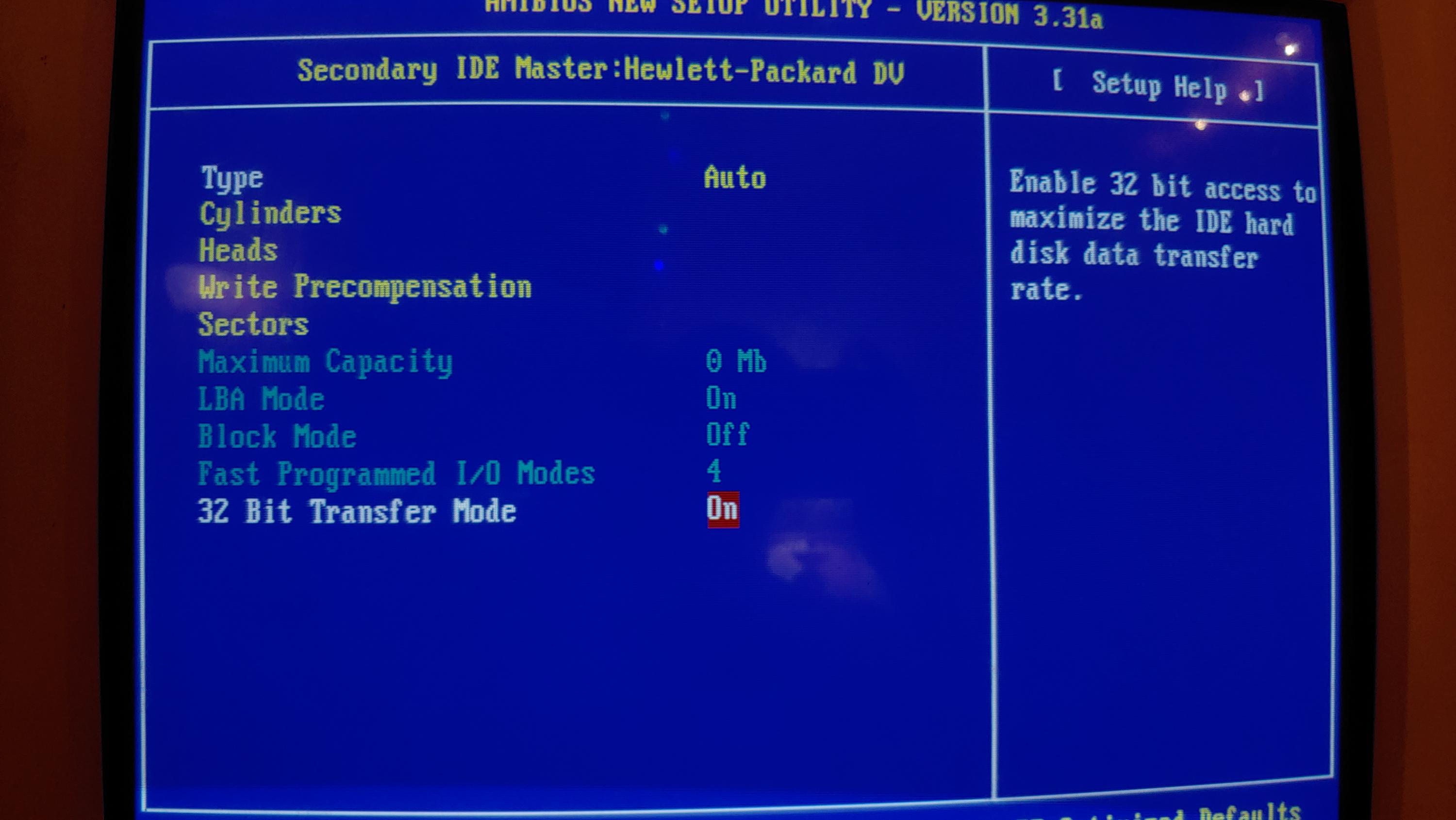

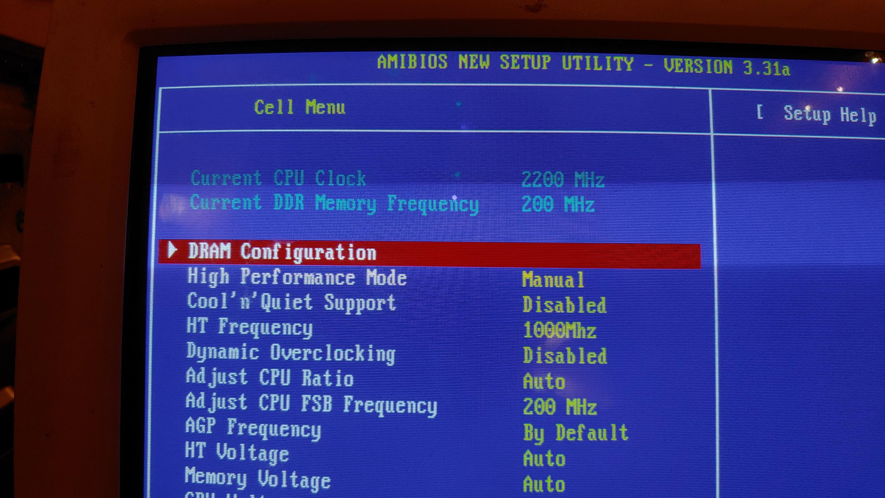

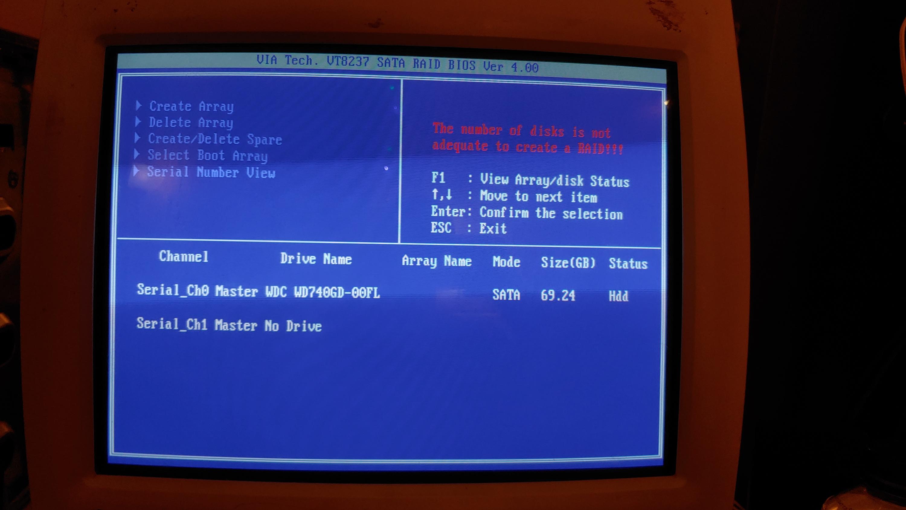

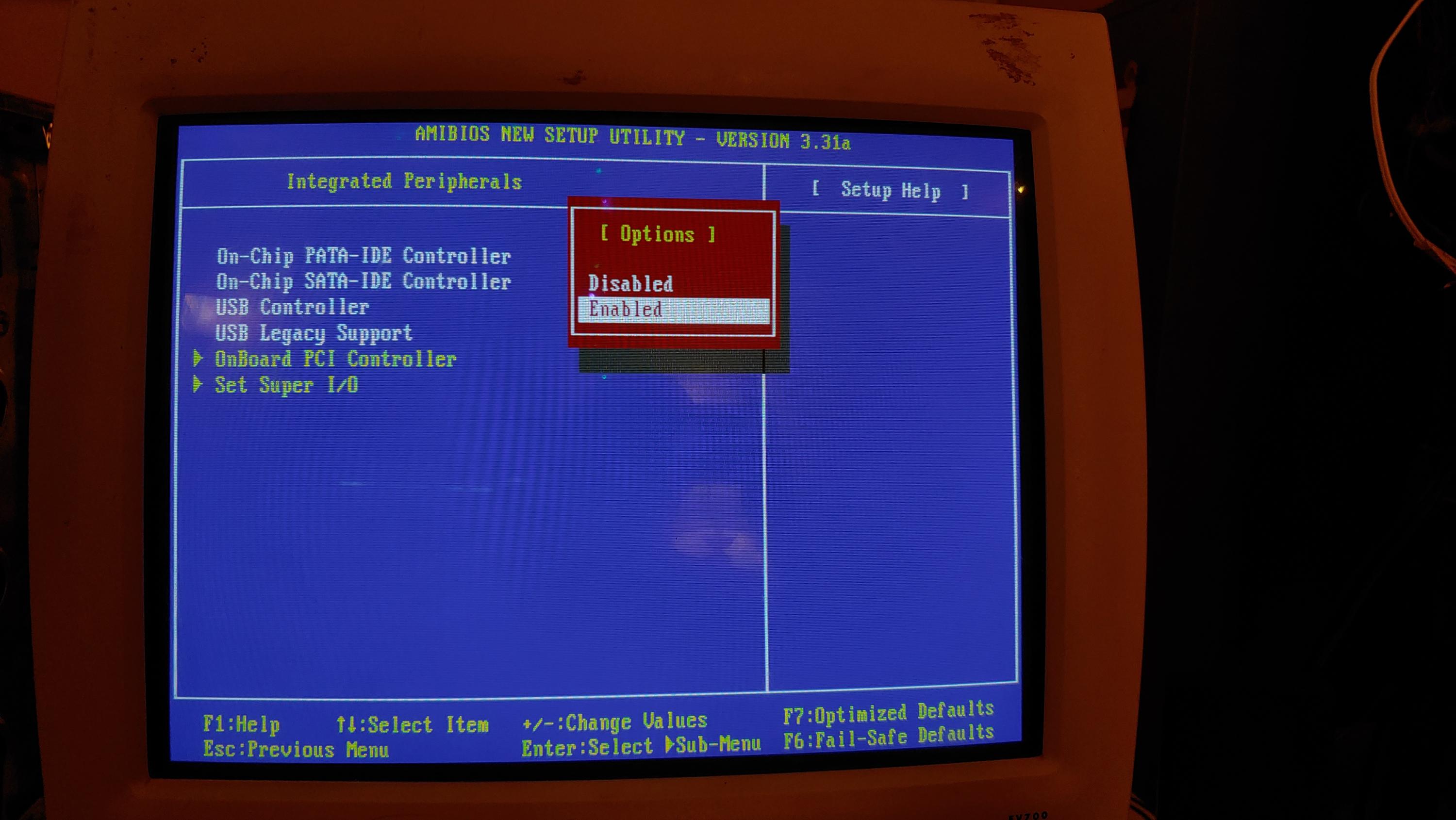

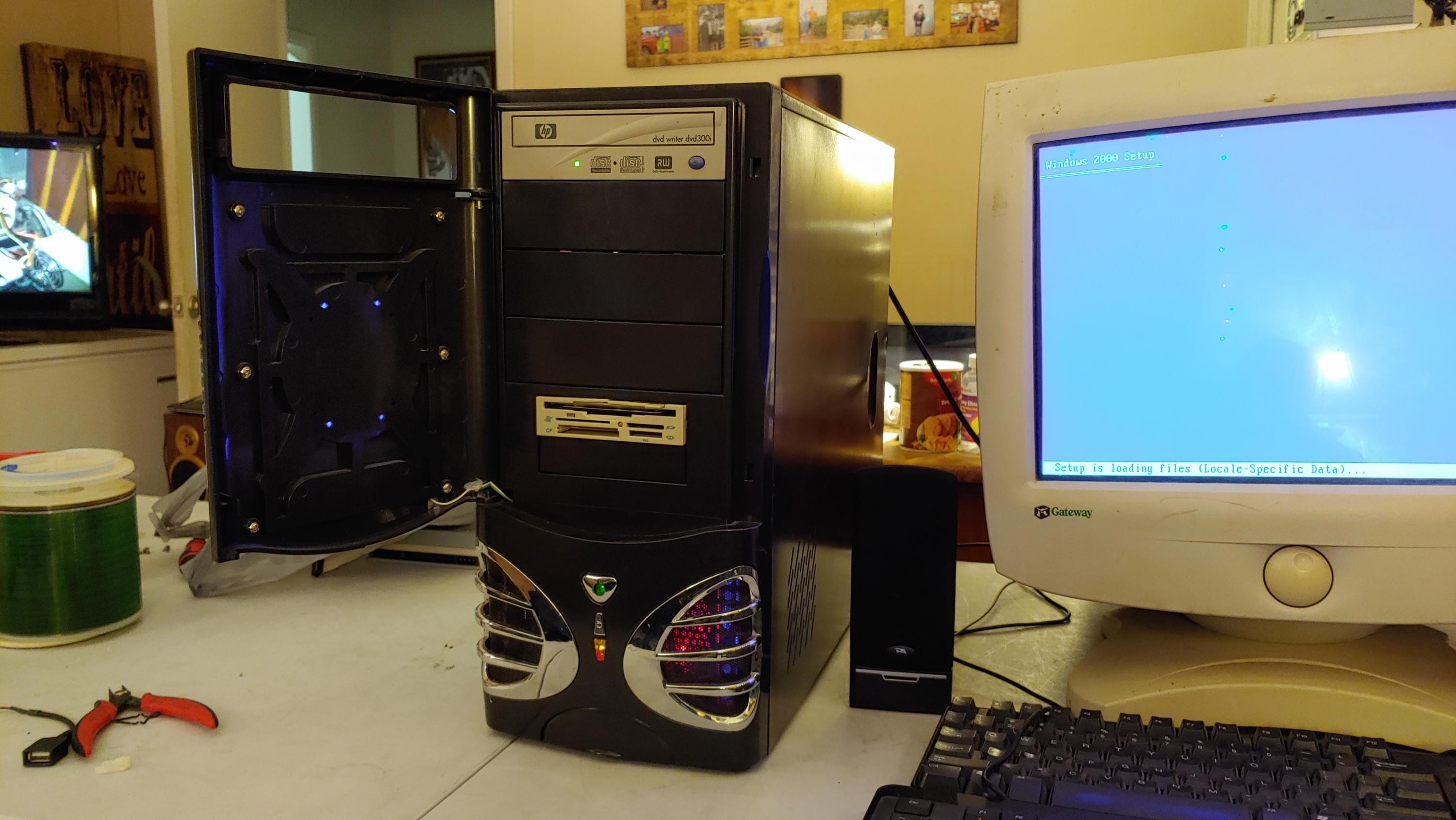

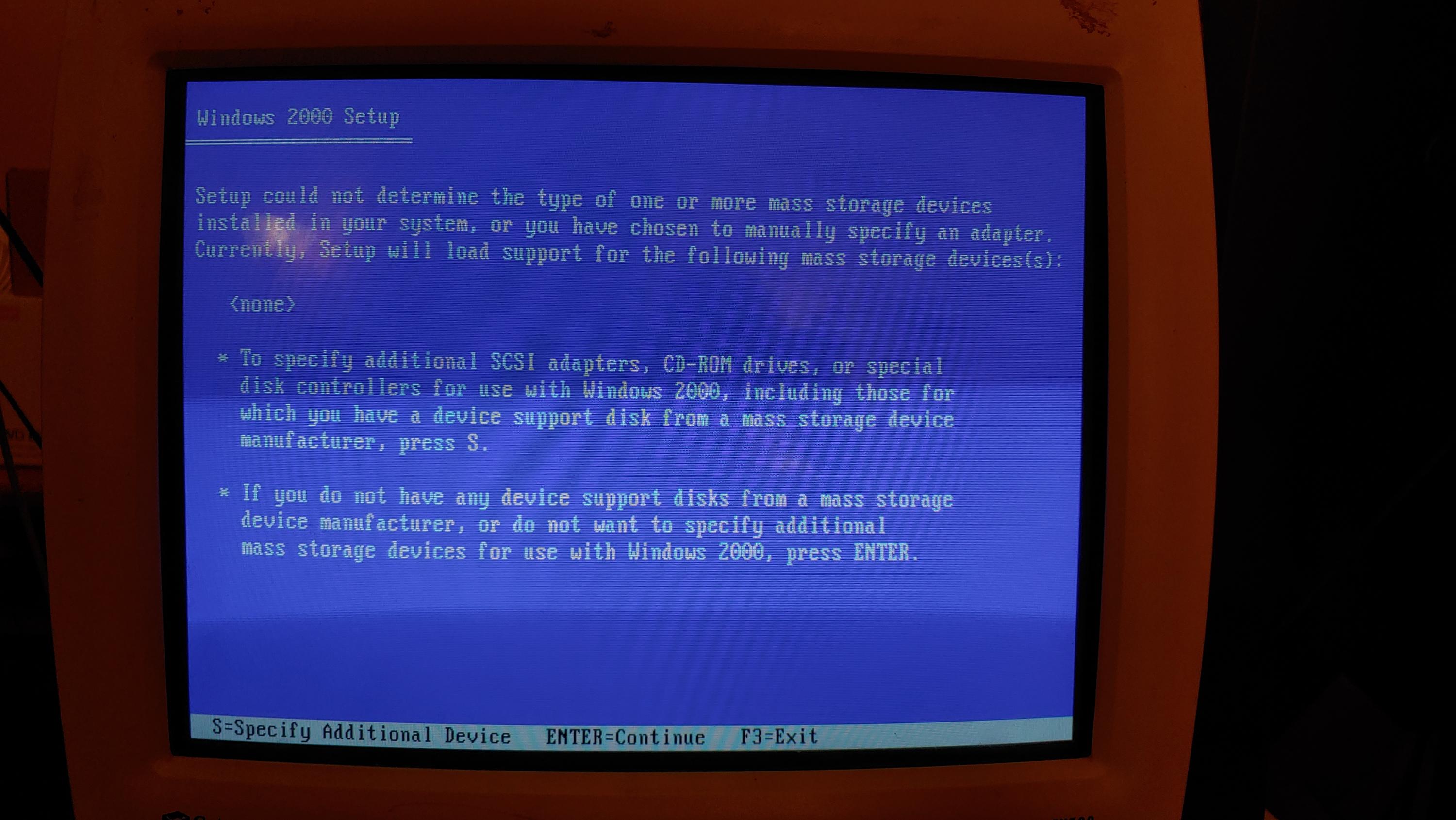

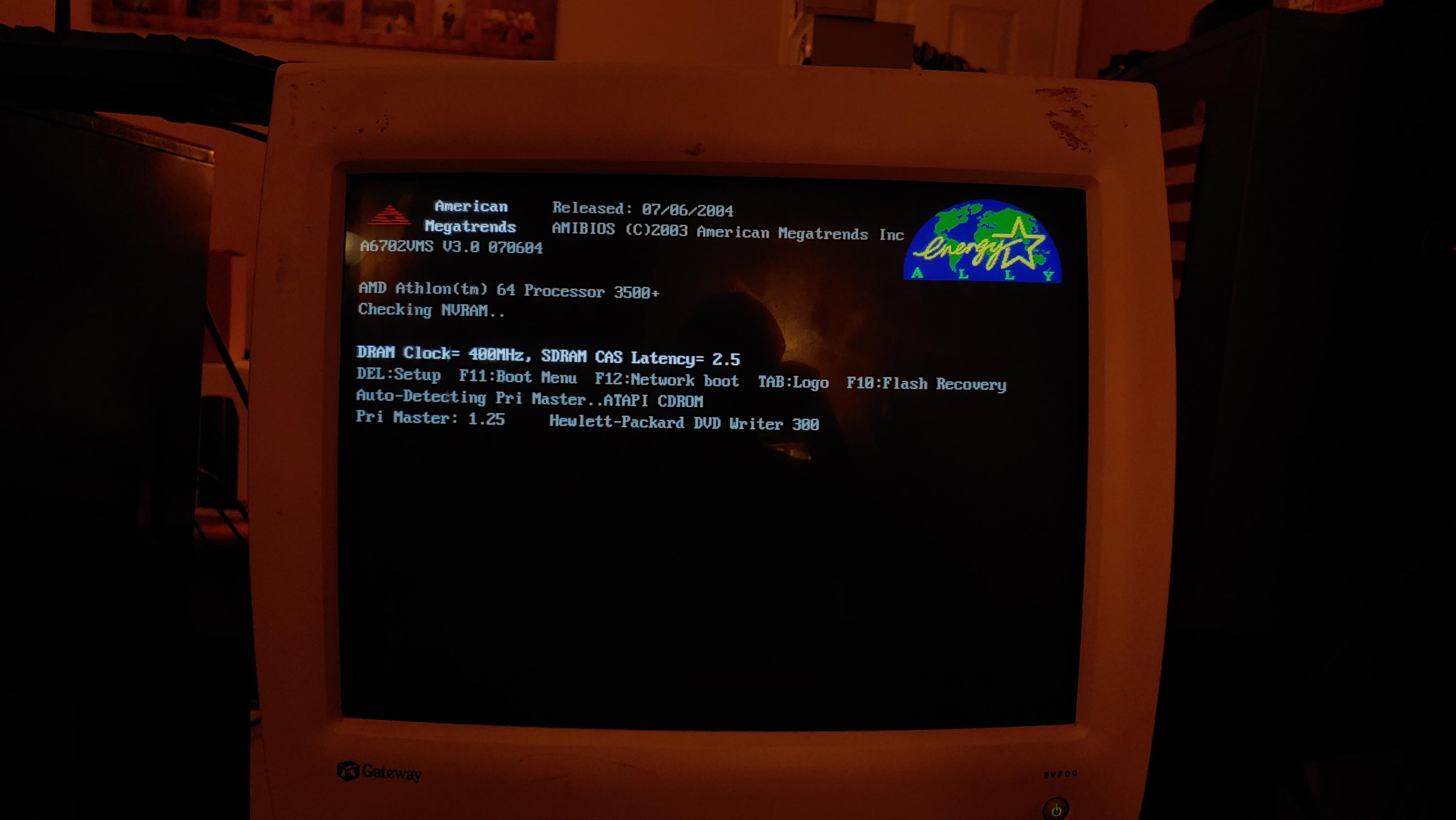

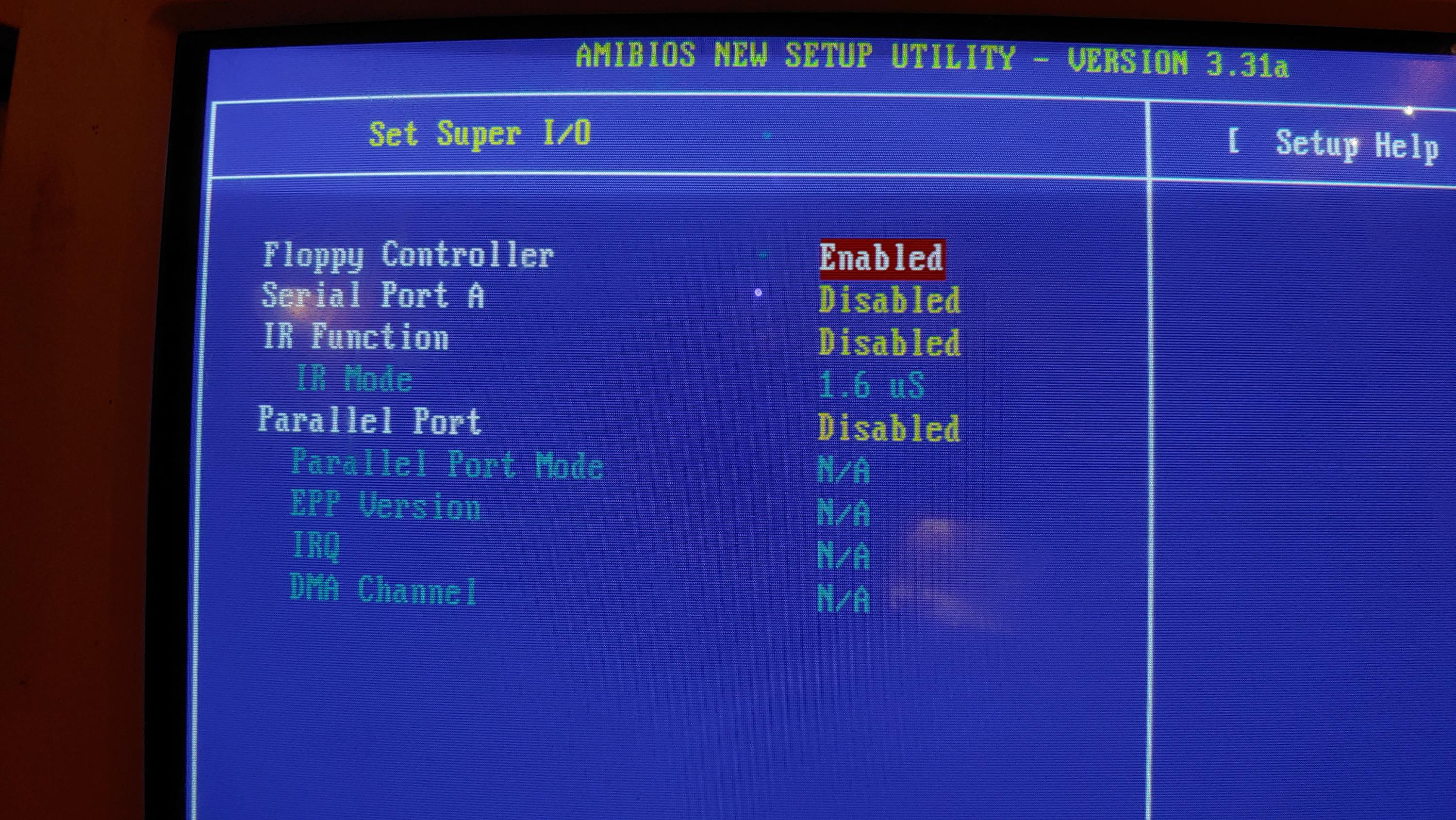

      And a little more progress on the system. This is from the same photo dump as my last big post.

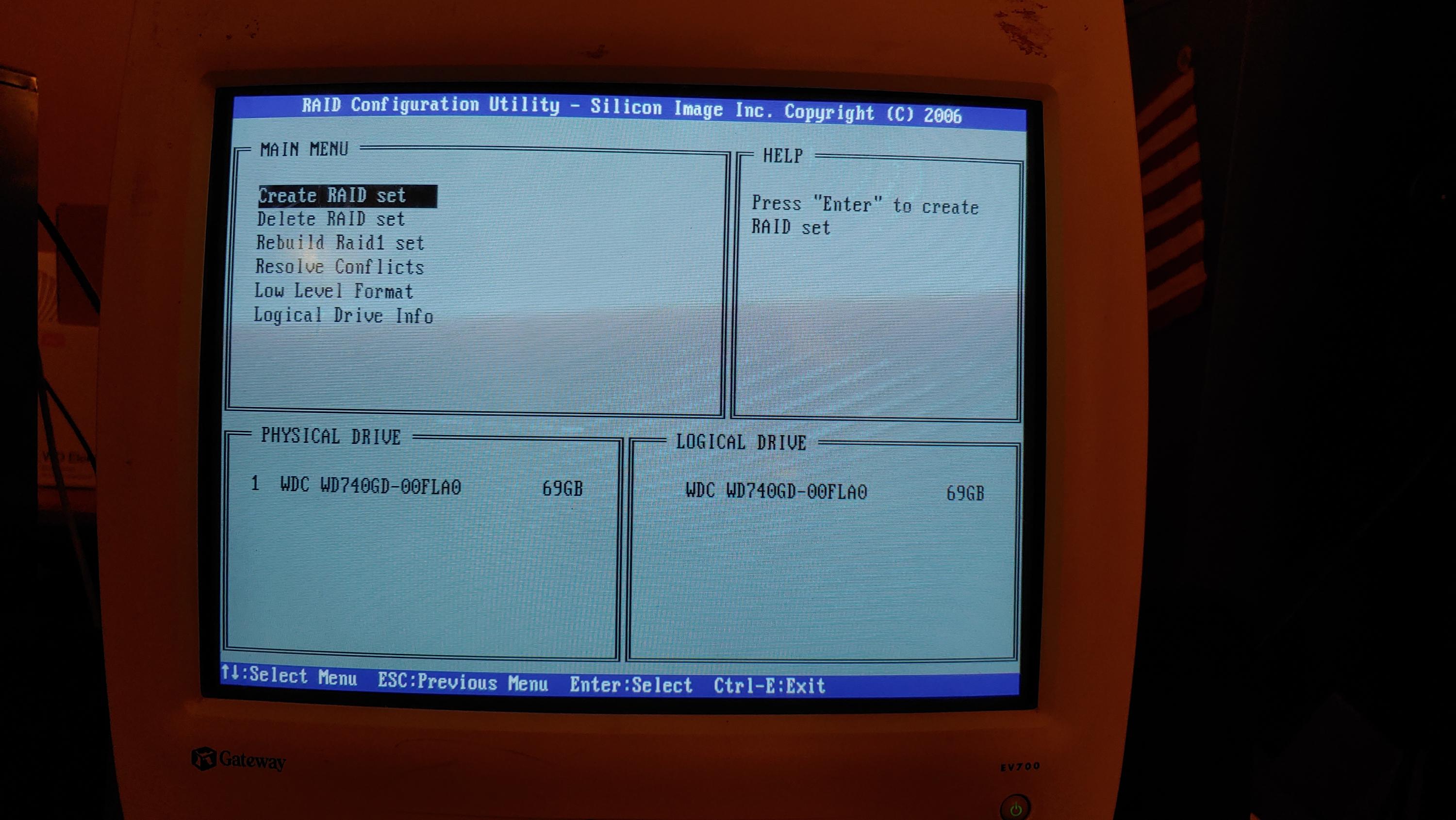

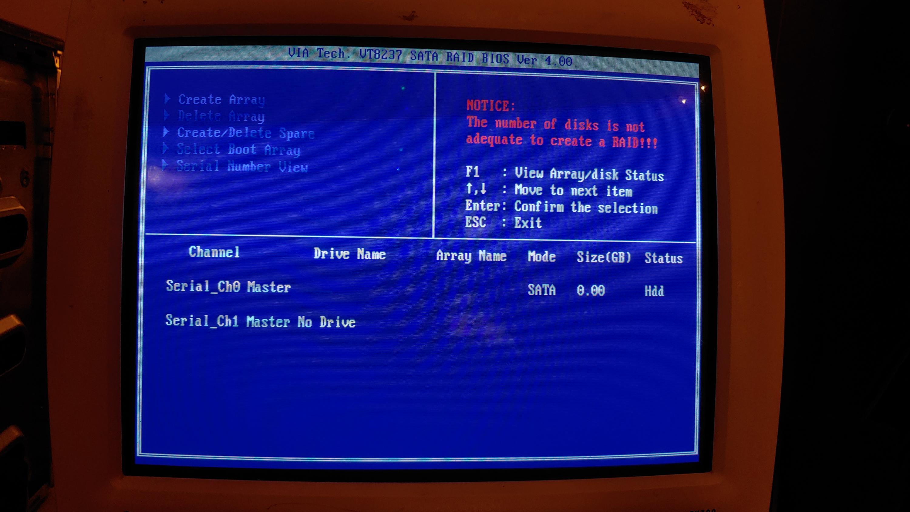

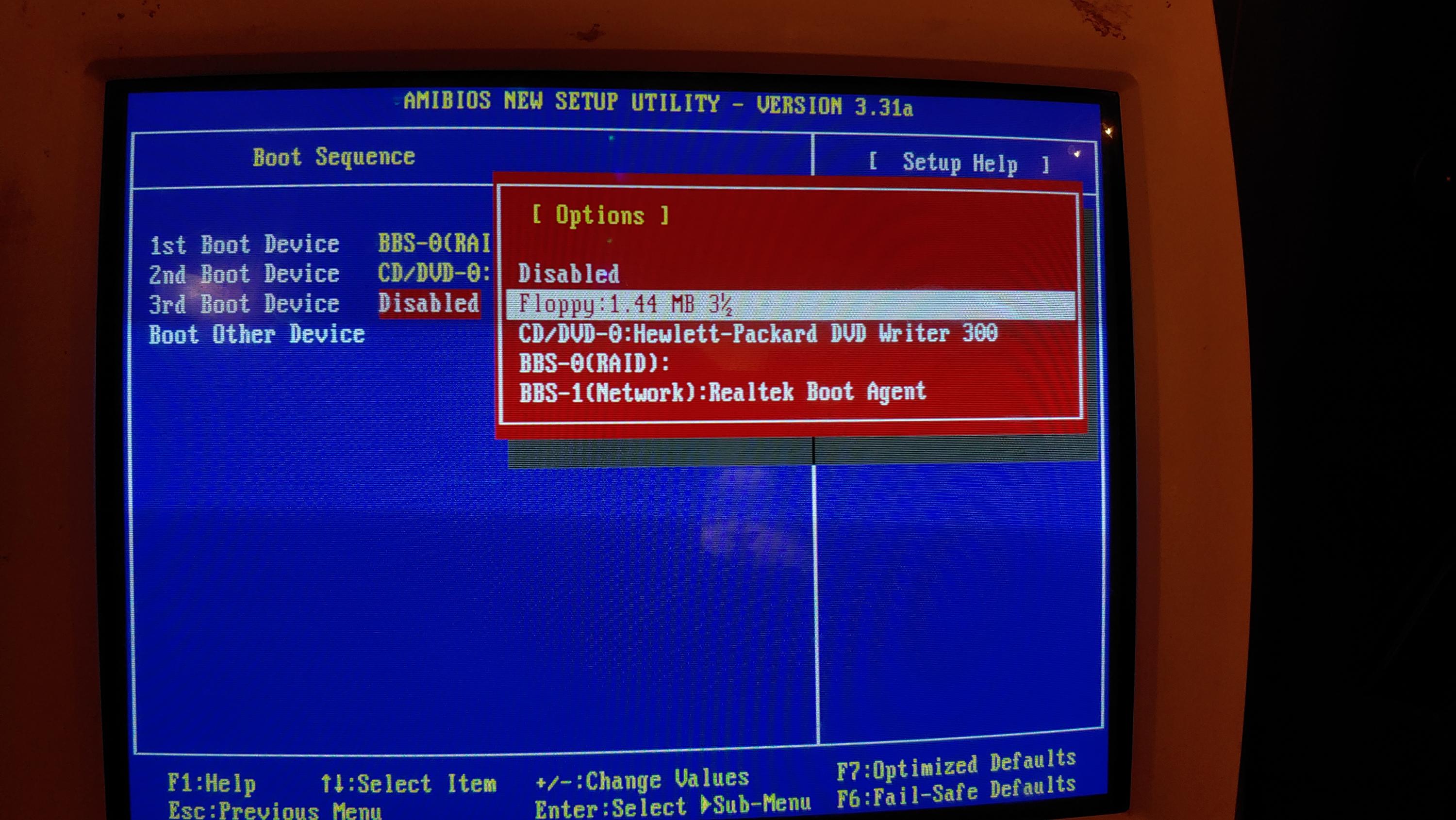

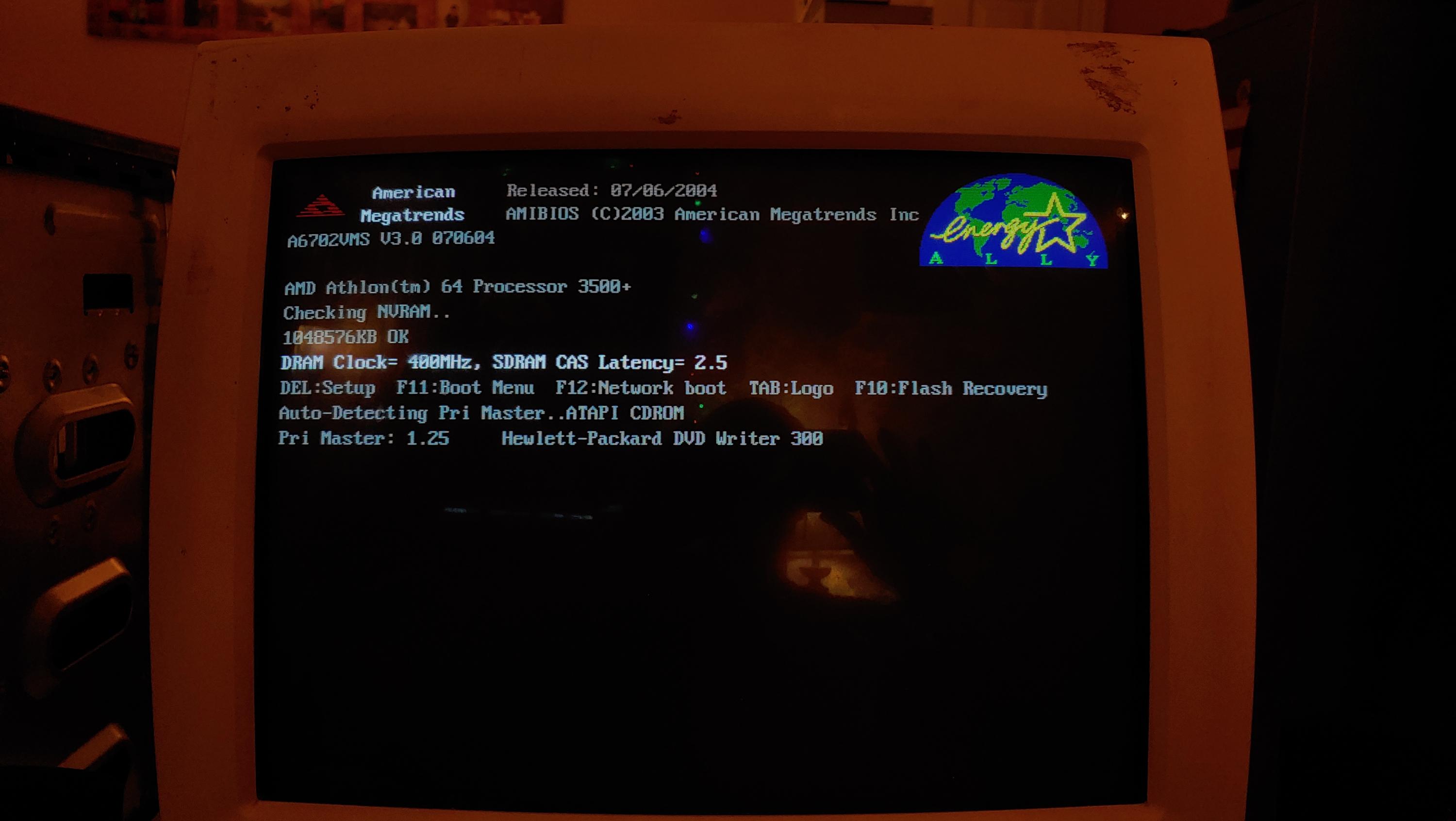

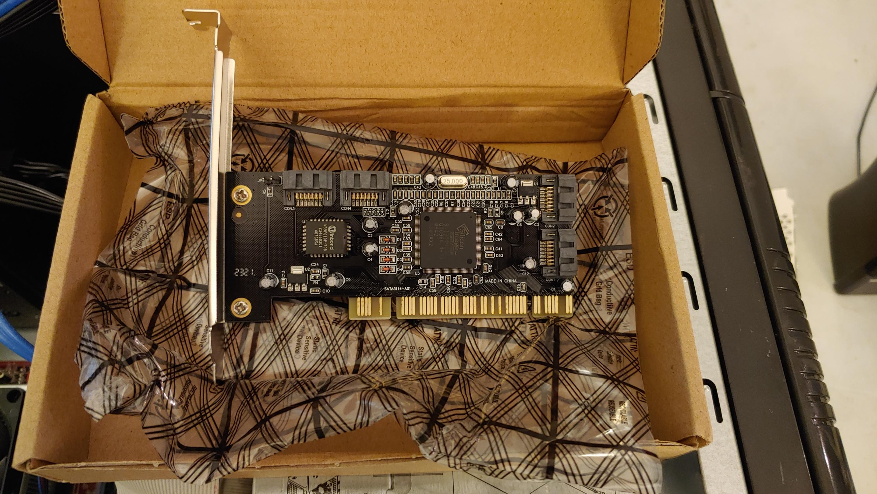

      Turned on the SATA RAID controller:
      Turned on the FDC:
      Not sure why I took this, but here it is:
      Turned on FDD seek @ POST:
      Saving and exiting.
      Some signs of life from the SATA RAID controller, but it's not entirely sure what the hard disk is:
      Don't do this- some older drives may not take kindly to it:

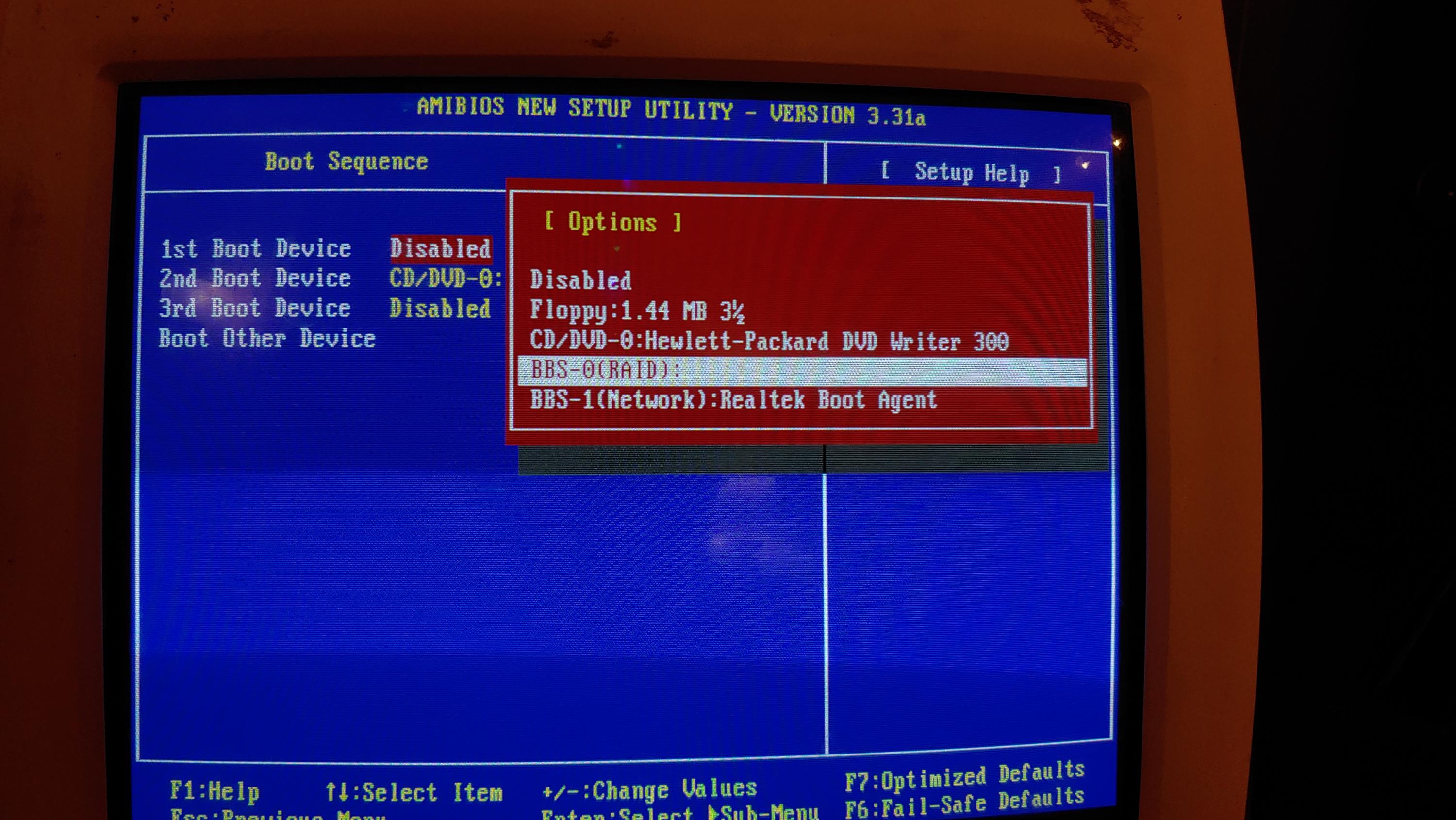

      Putting the SATA RAID controller on the boot order:
      Putting the FDD on the boot order:
      And after disabling Spread Spectrum Clocking on the hard drive, things look a lot better:
      And apparently there's a valid boot sector on the hard drive- not sure how that happened.

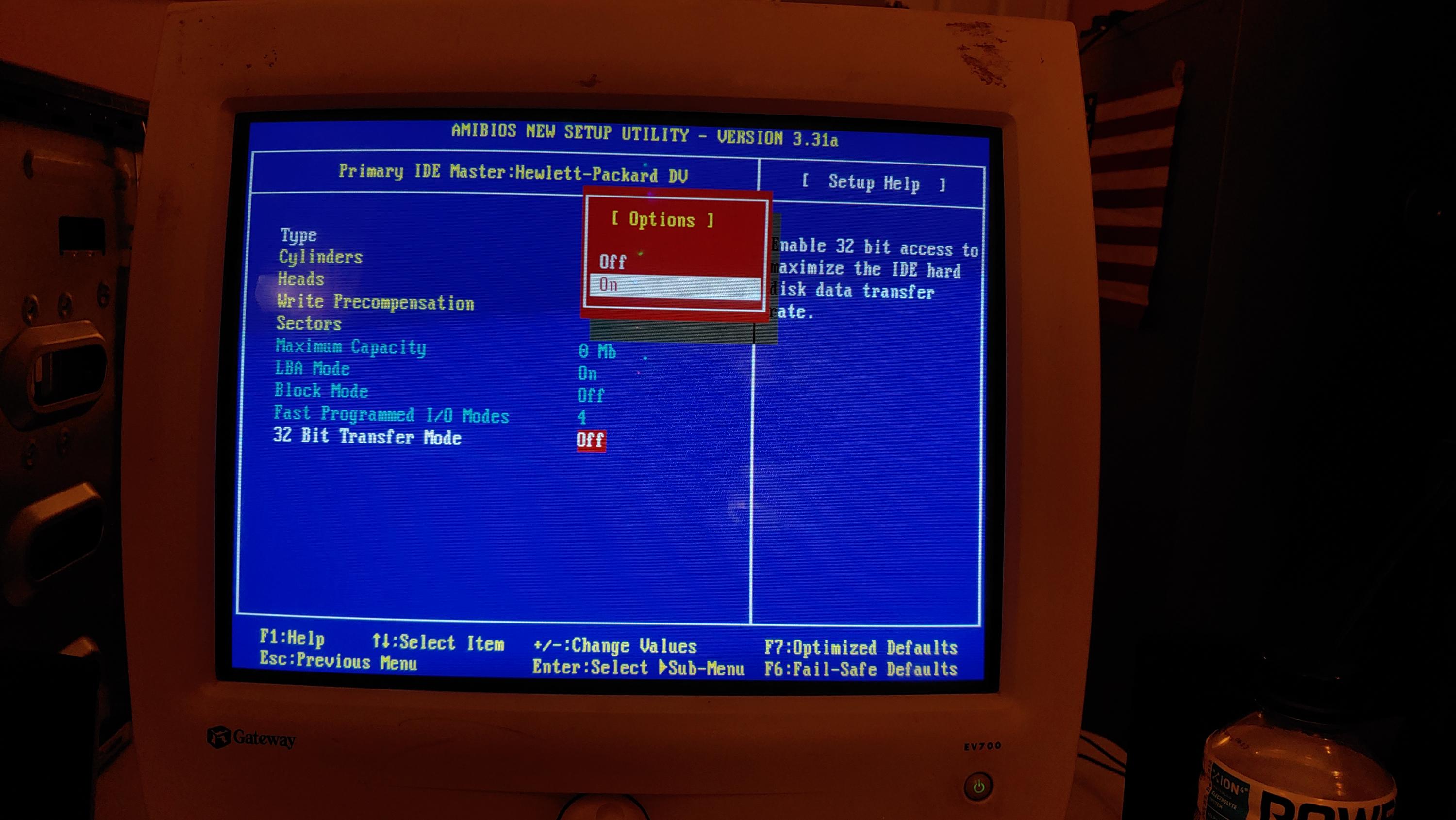

      Turning off 32-bit transfer mode as the optical drive doesn't like it.
      Turned off the unused IDE channels:

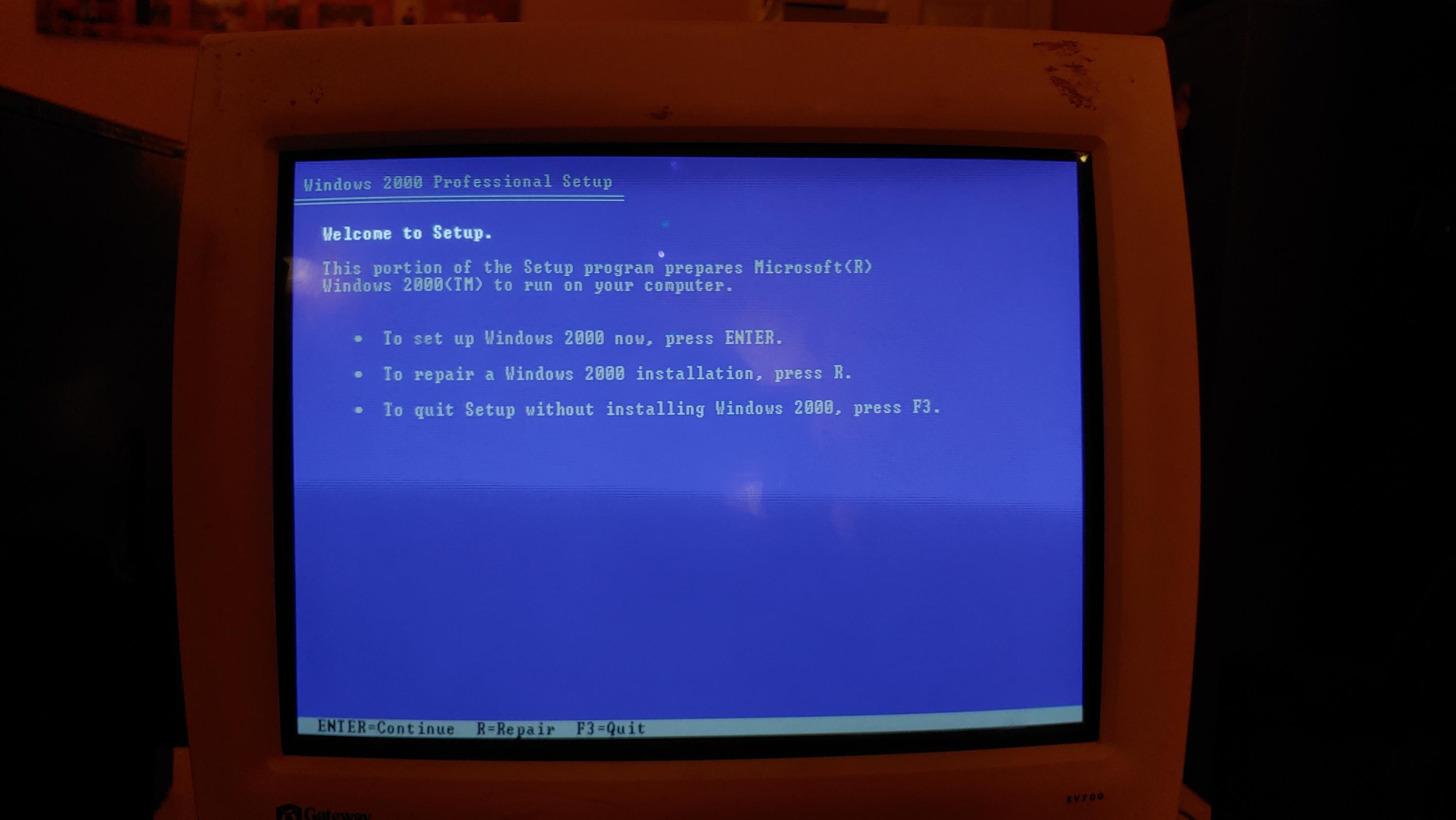

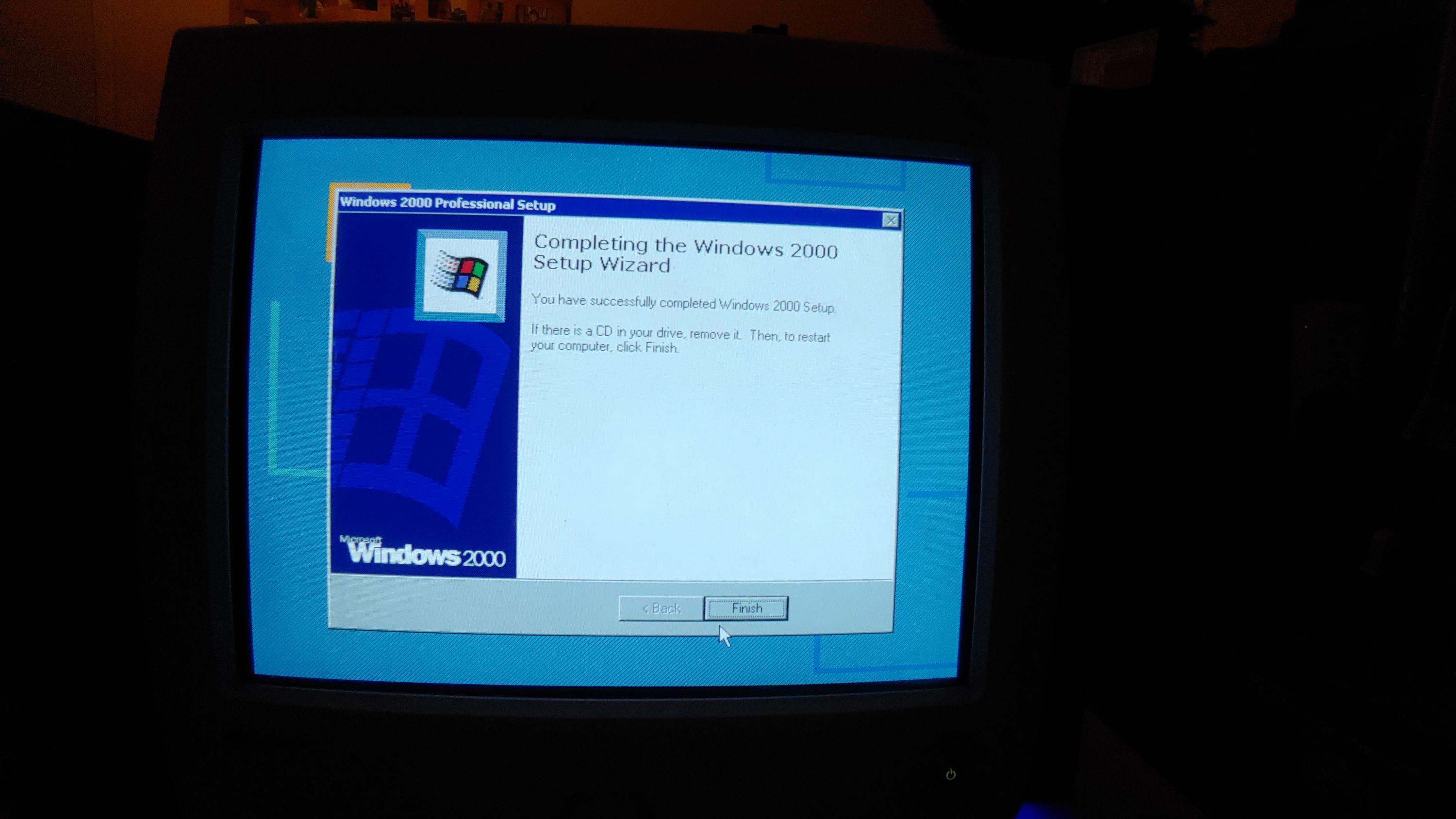

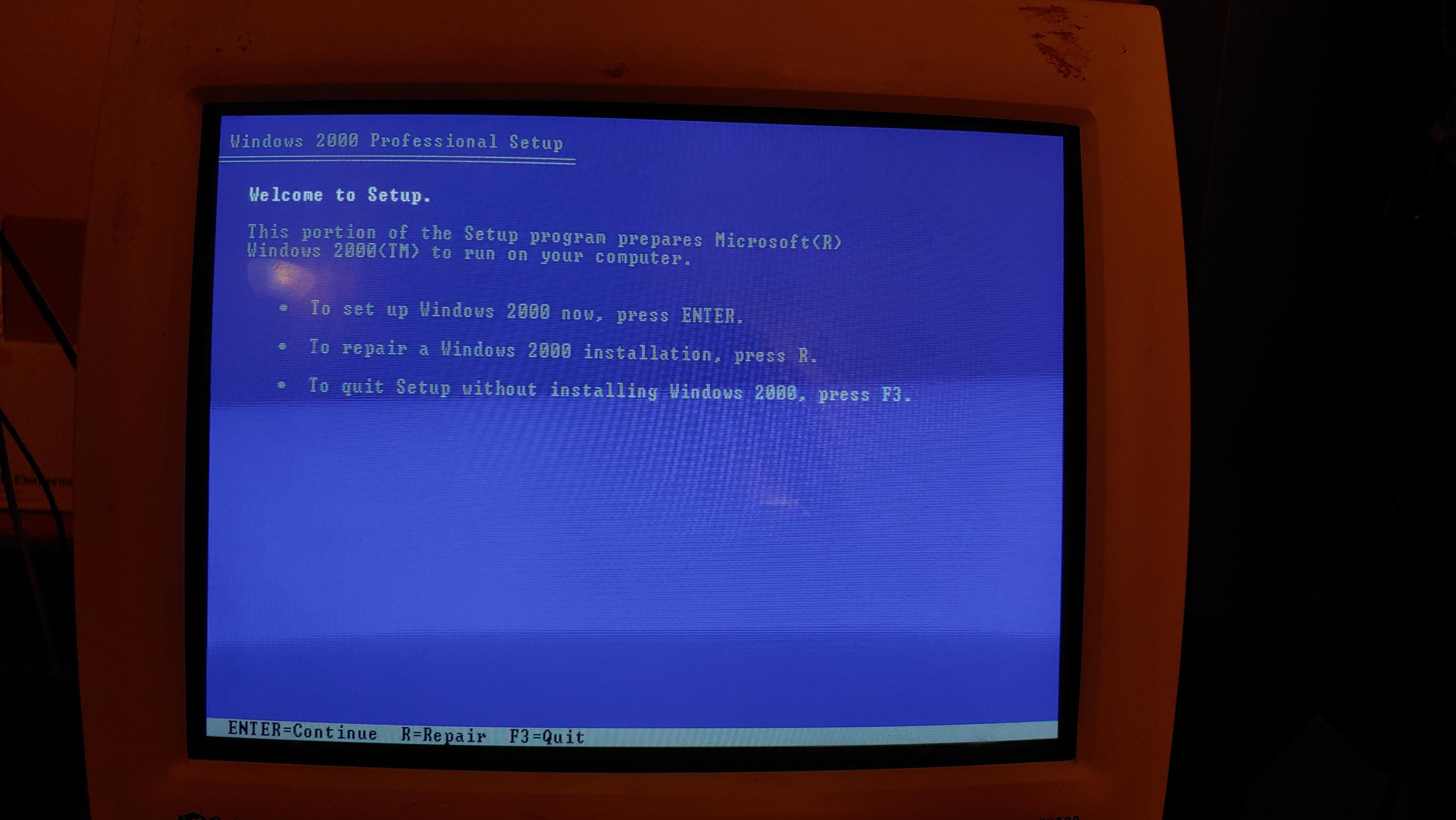

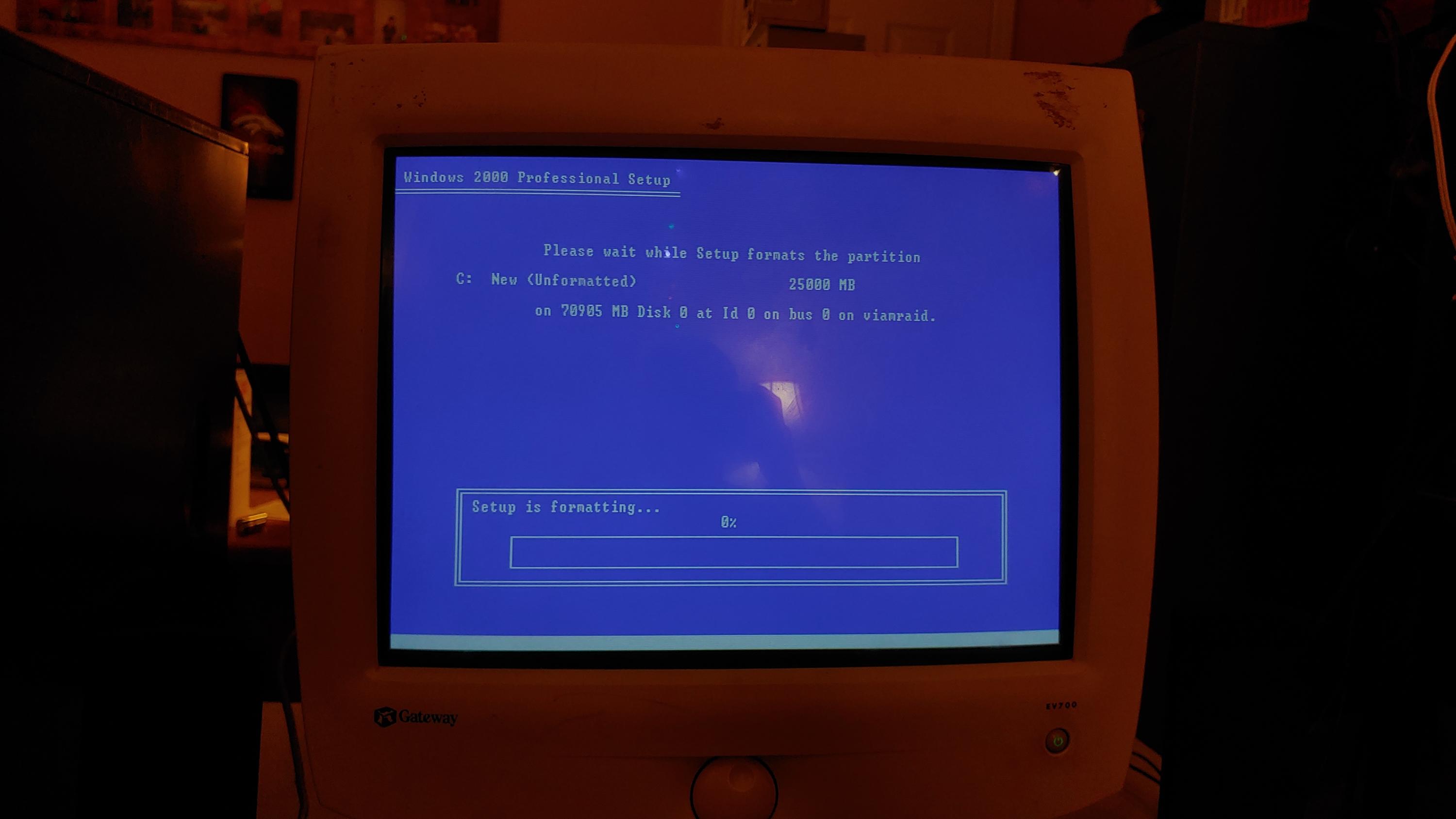

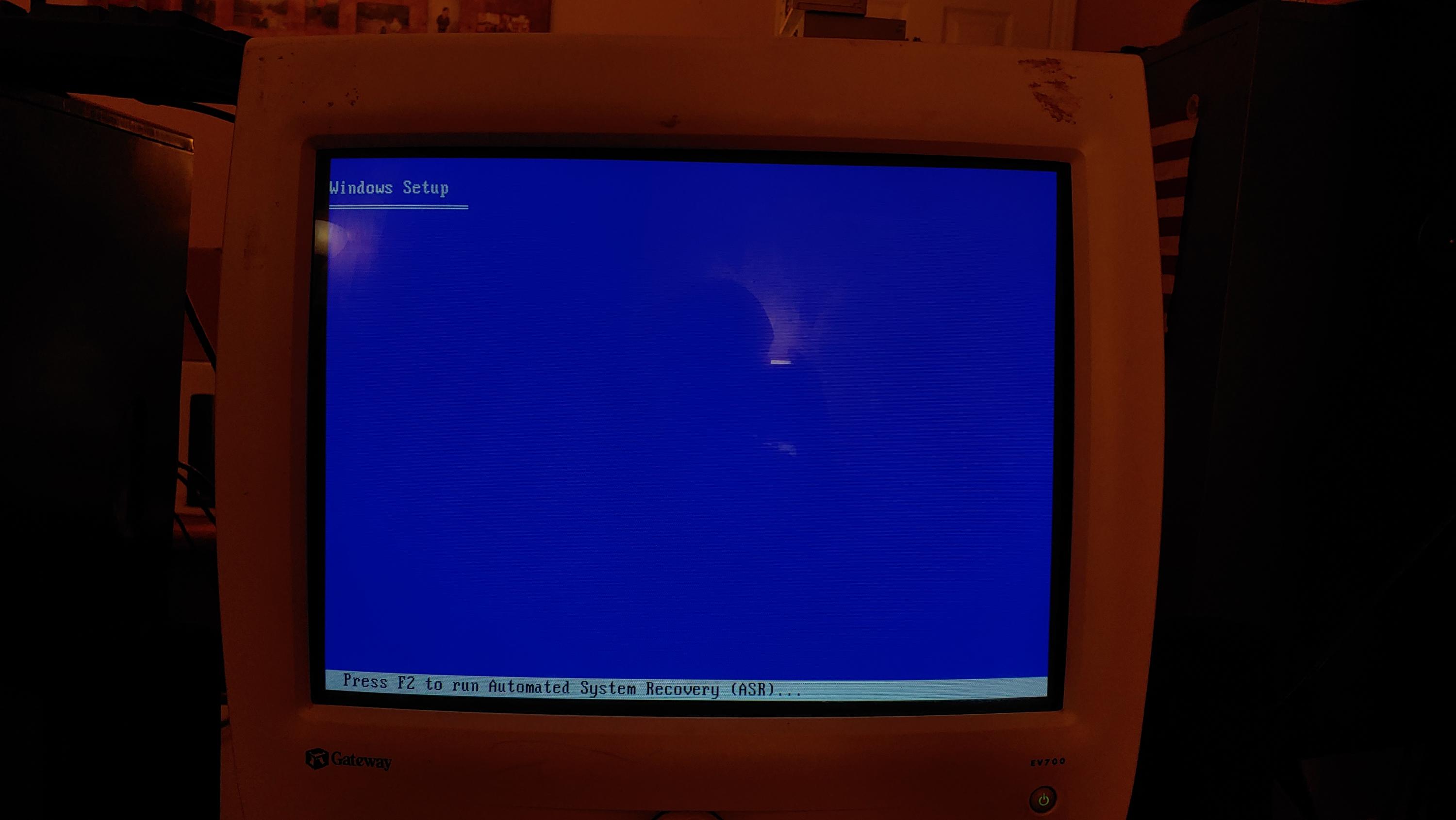

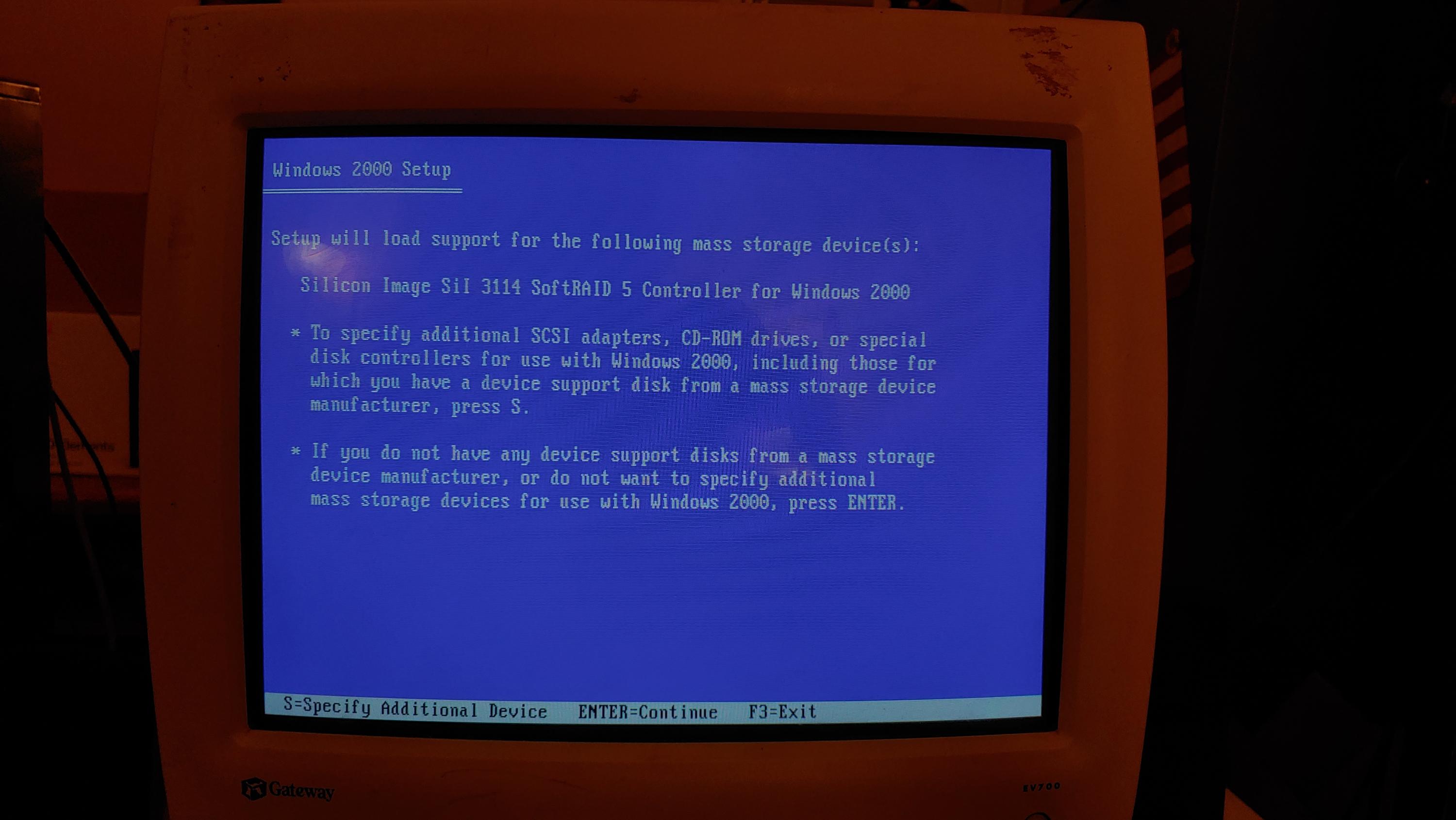

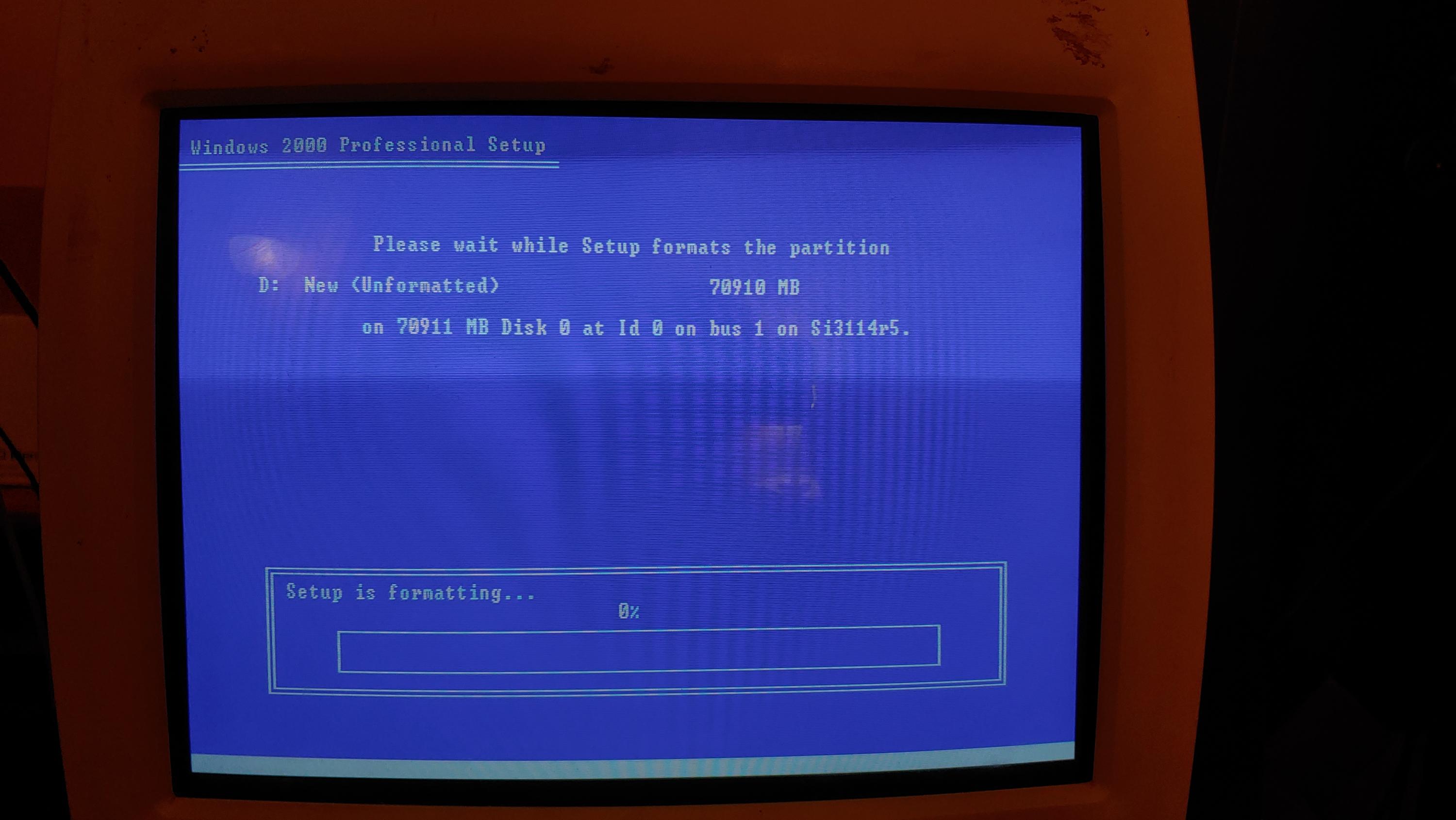

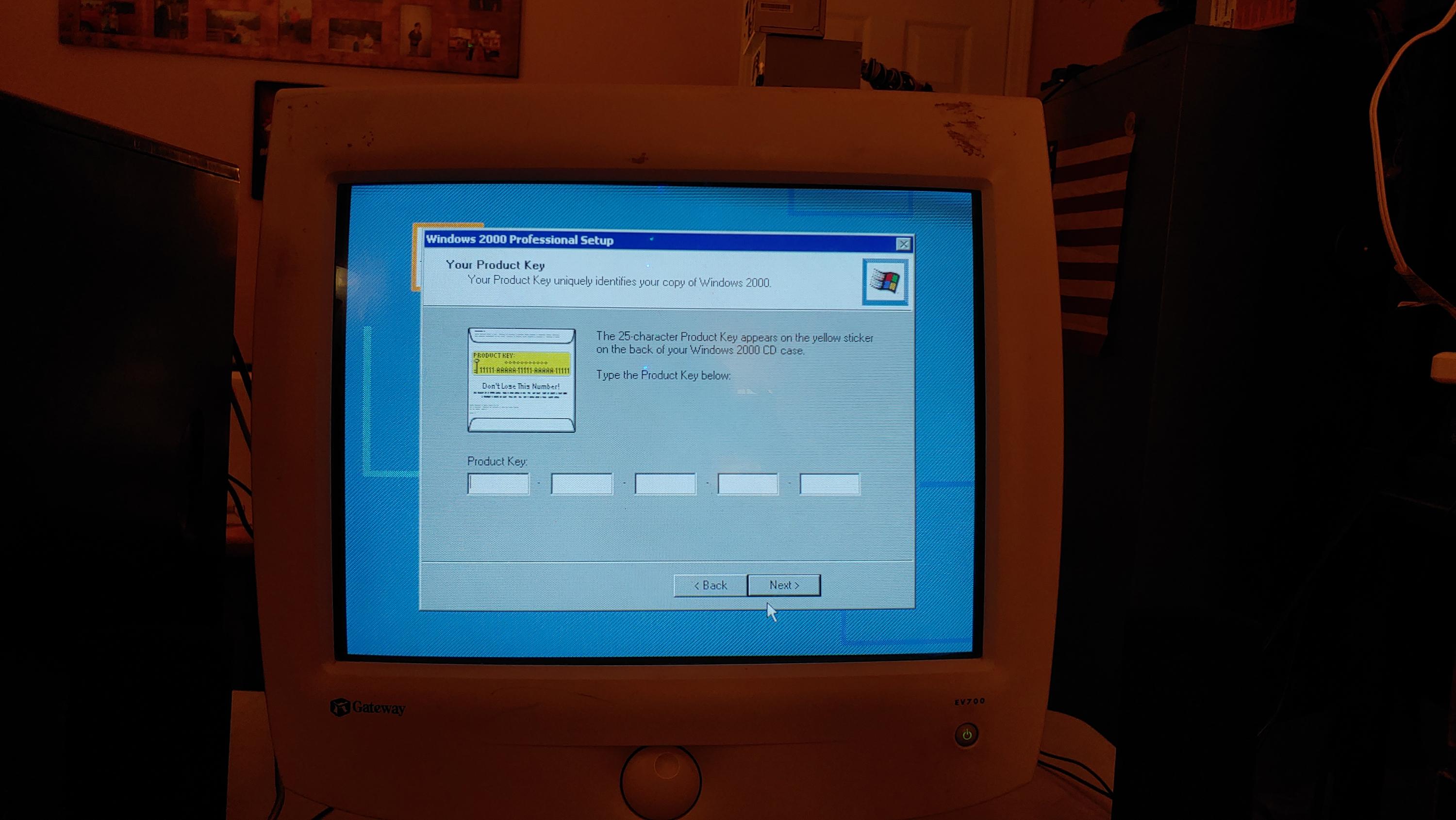

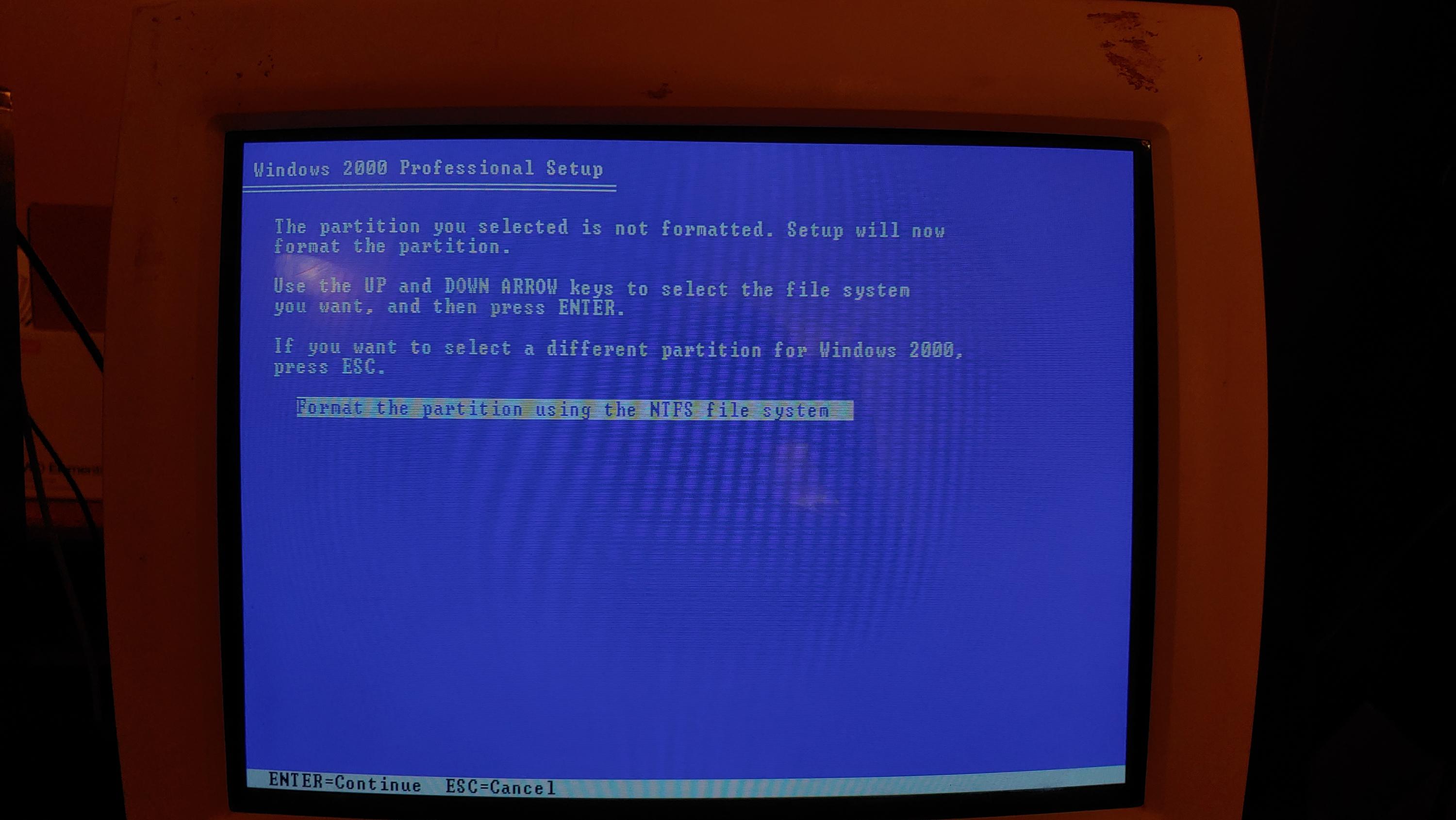

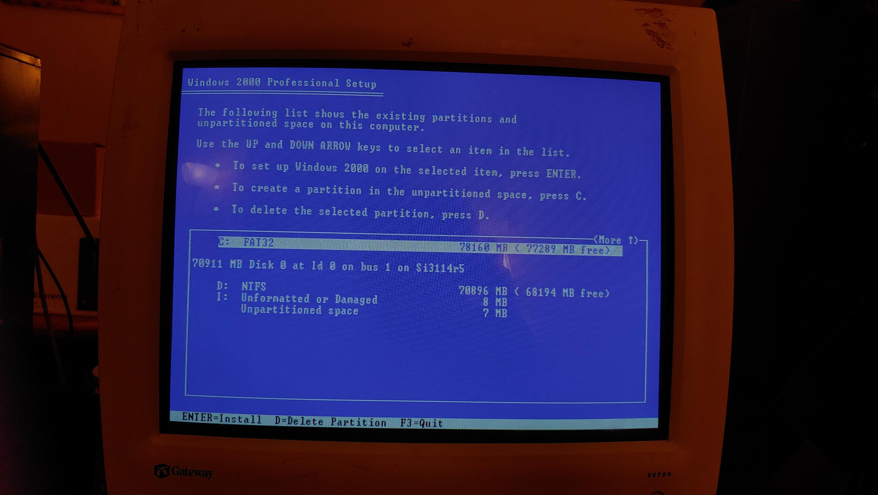

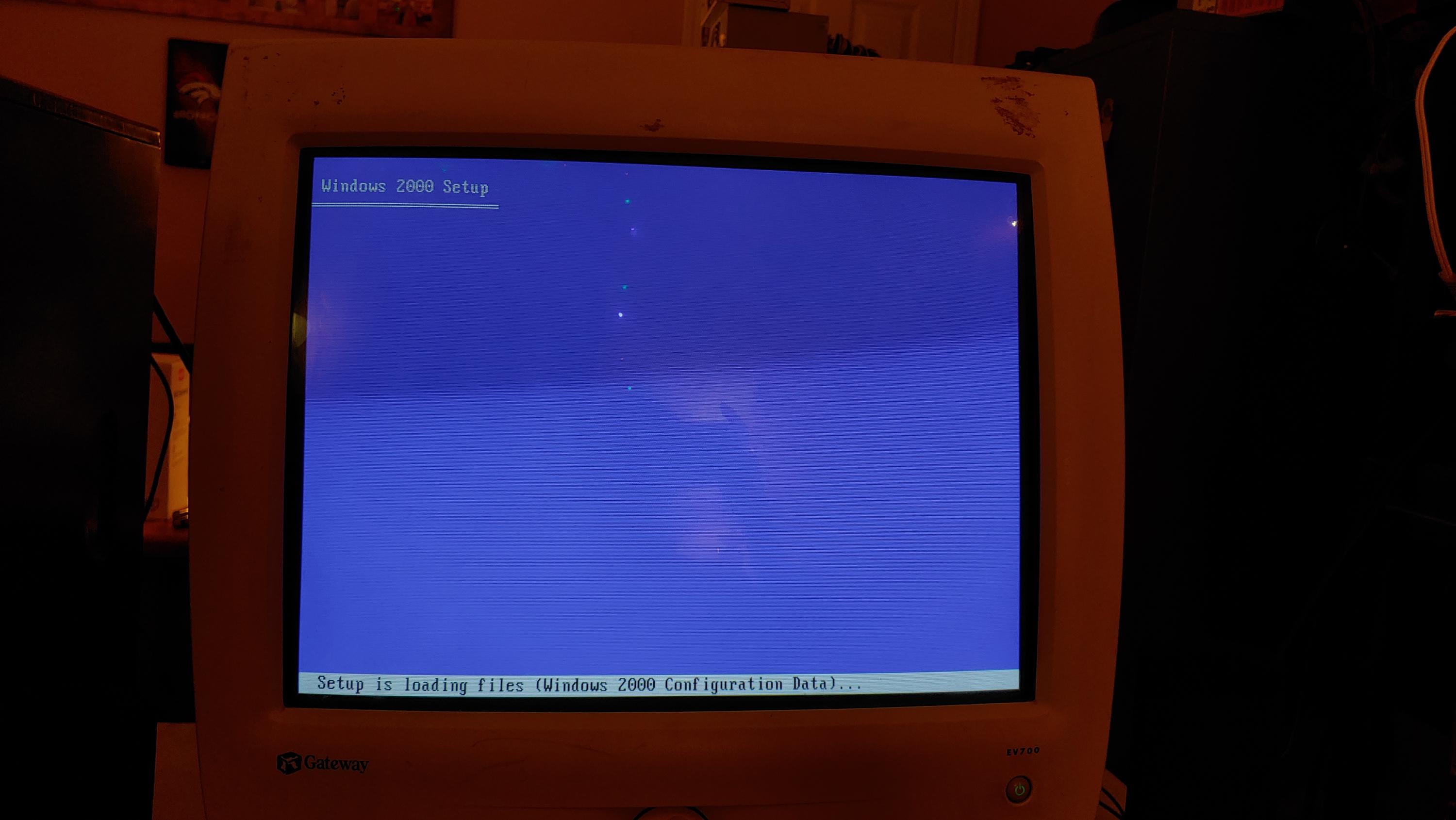

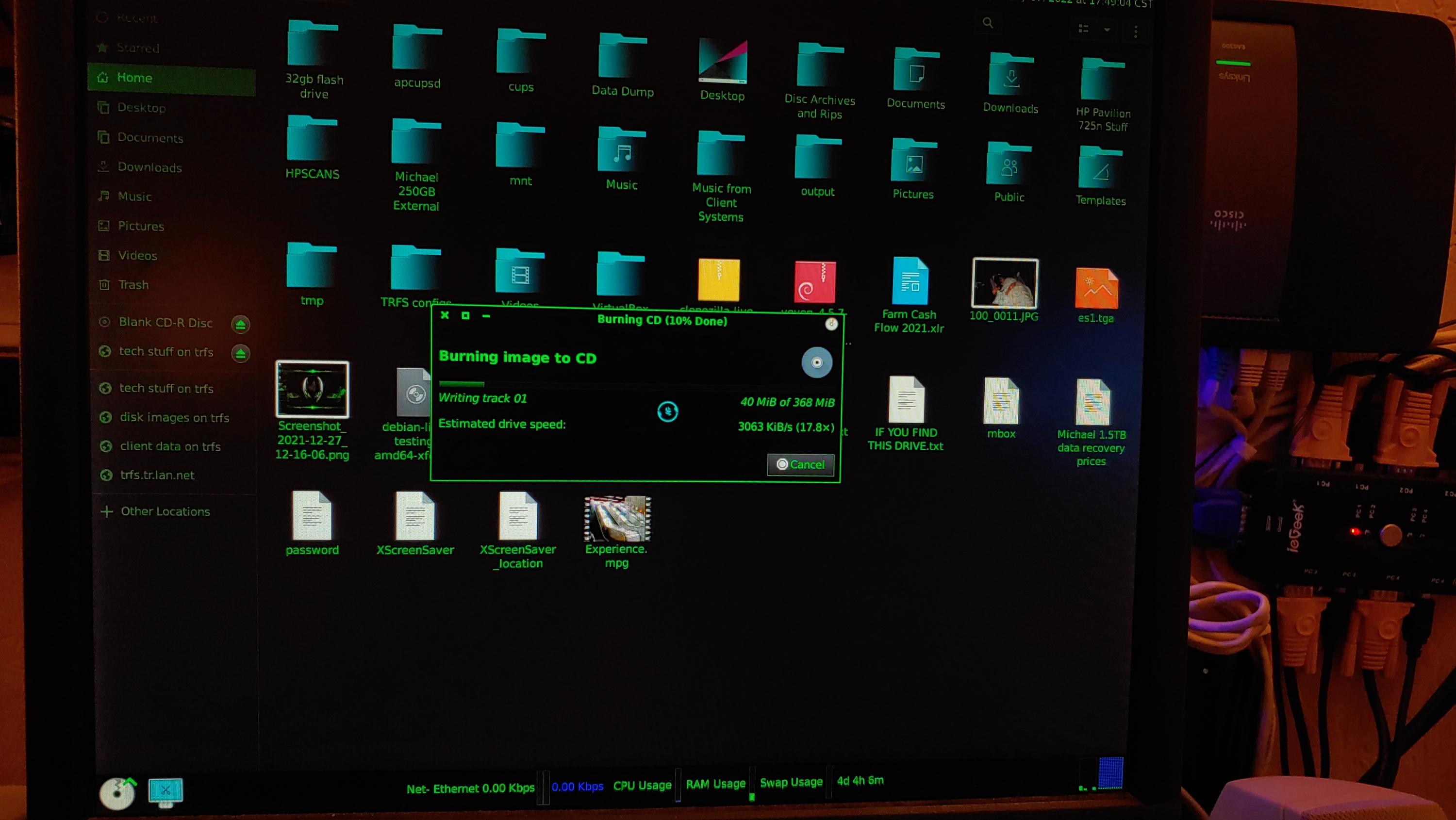

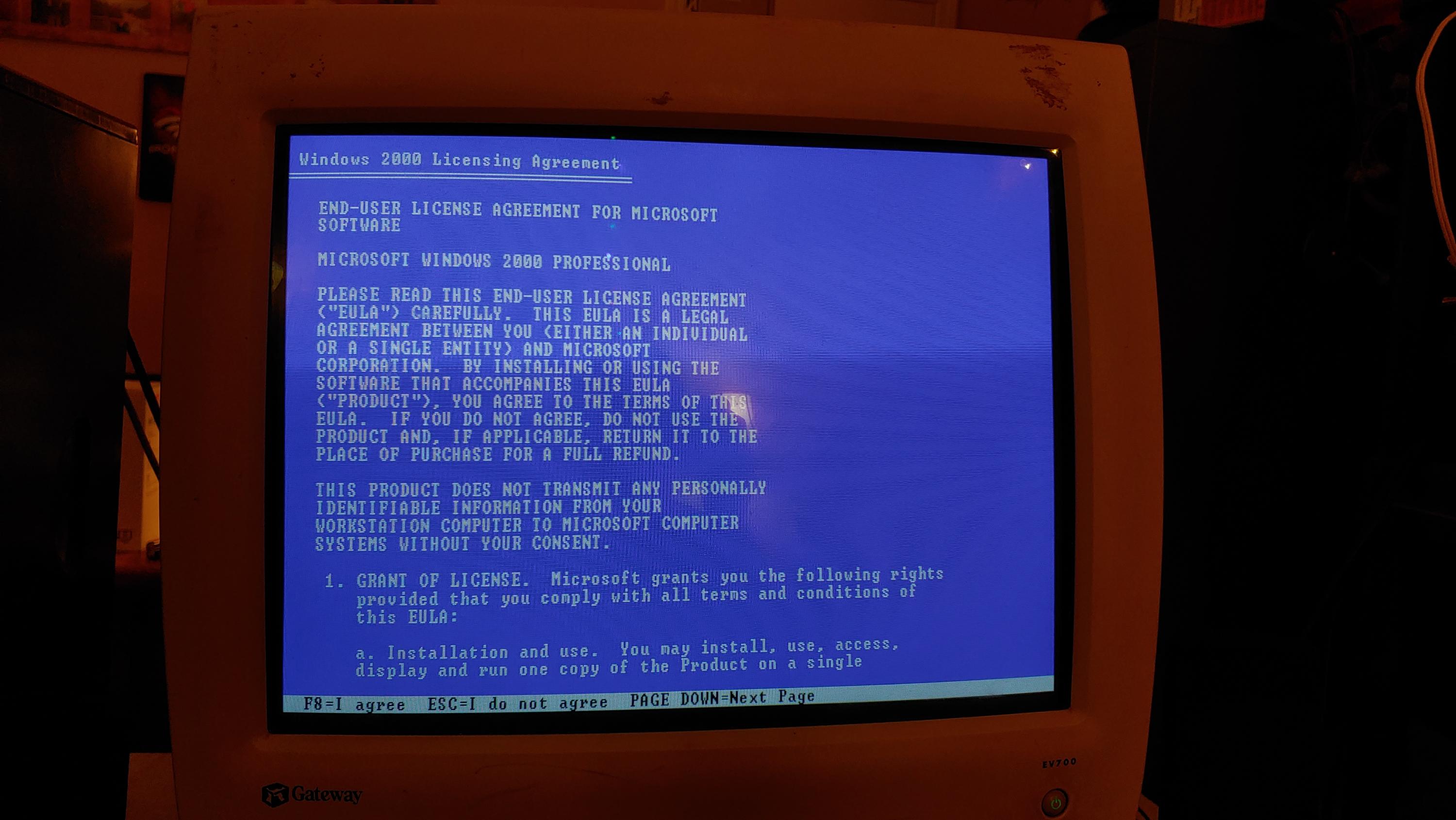

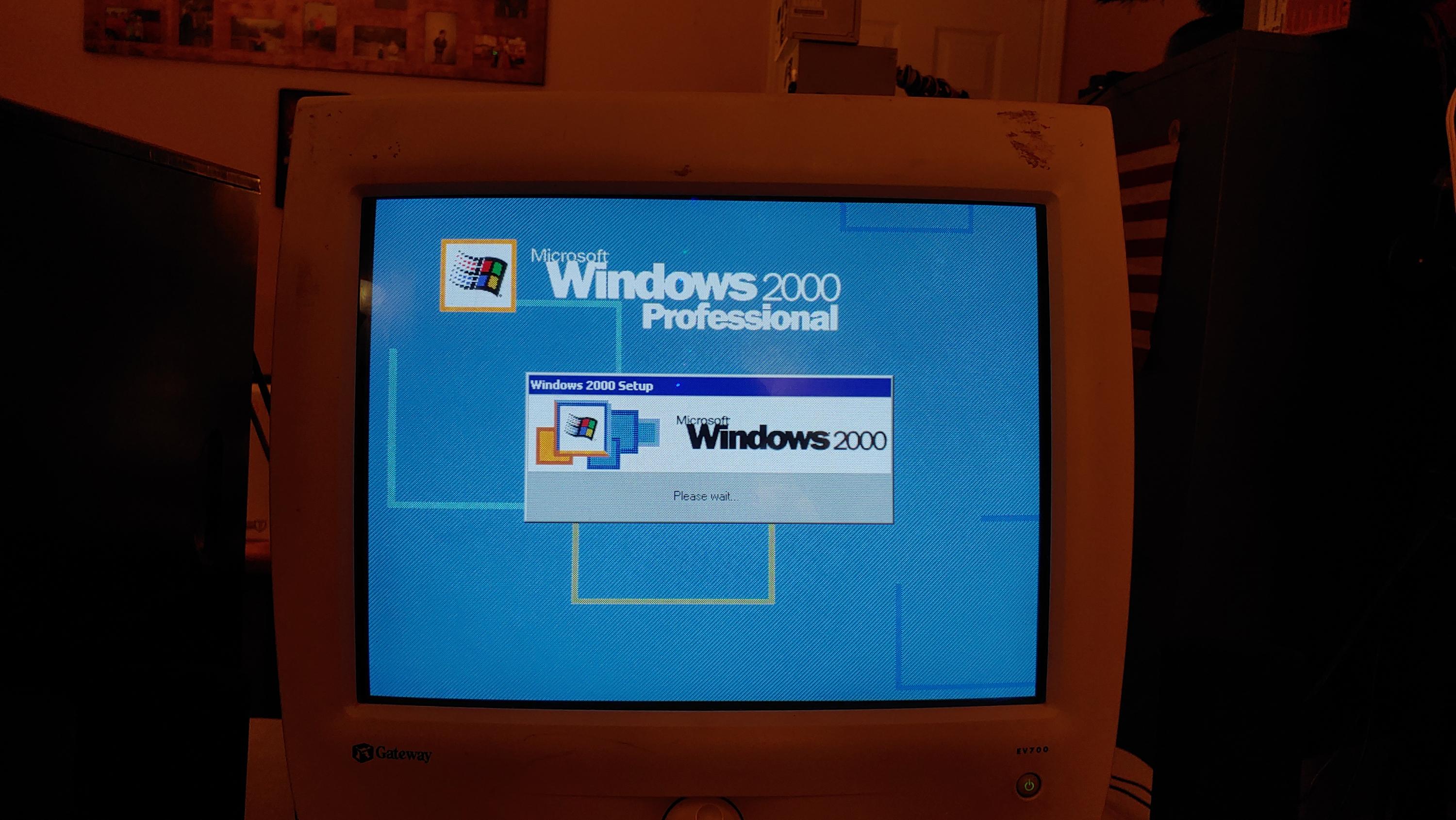

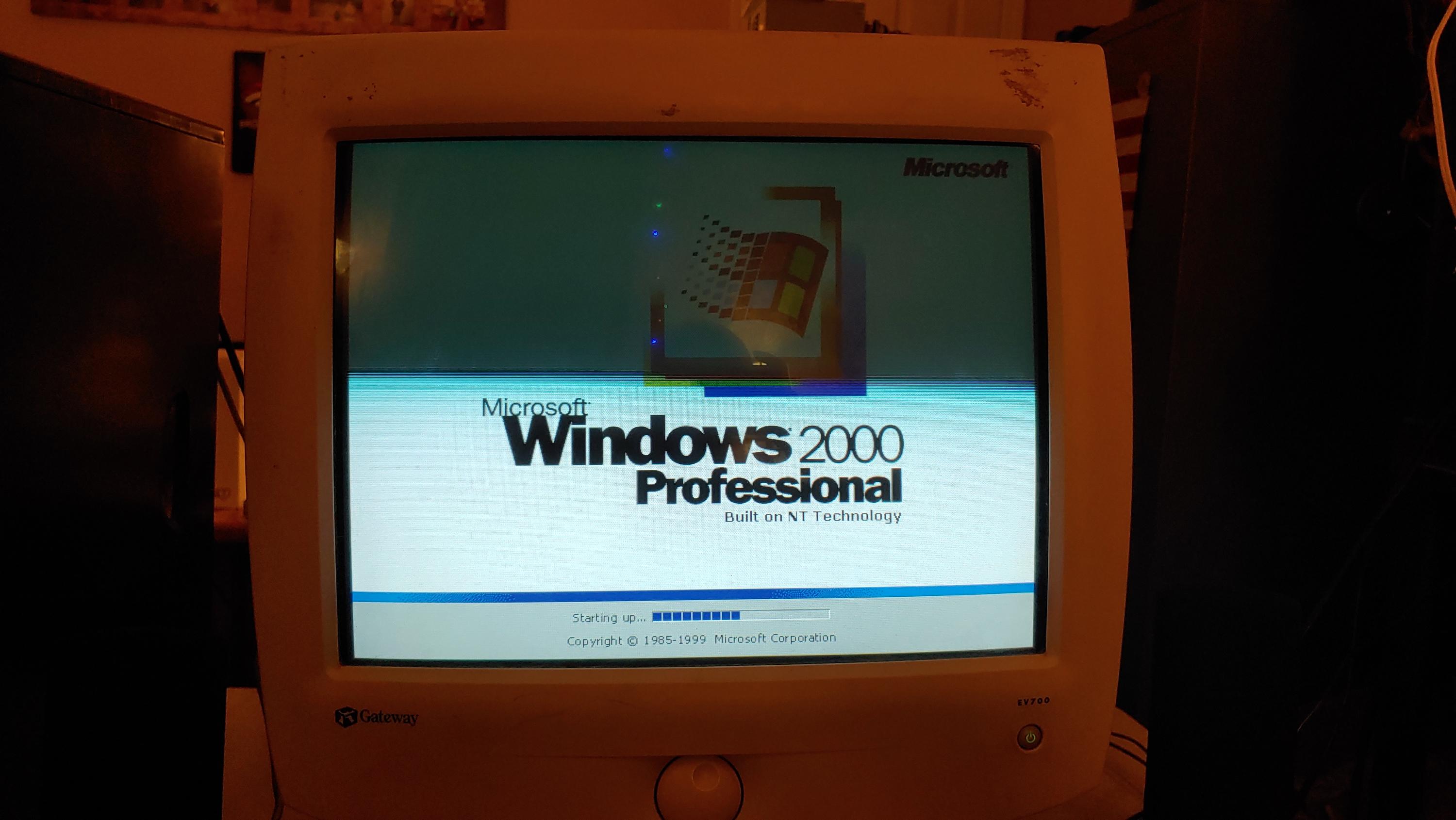

      Burning Windows 2000 Professional SP4 to CD:

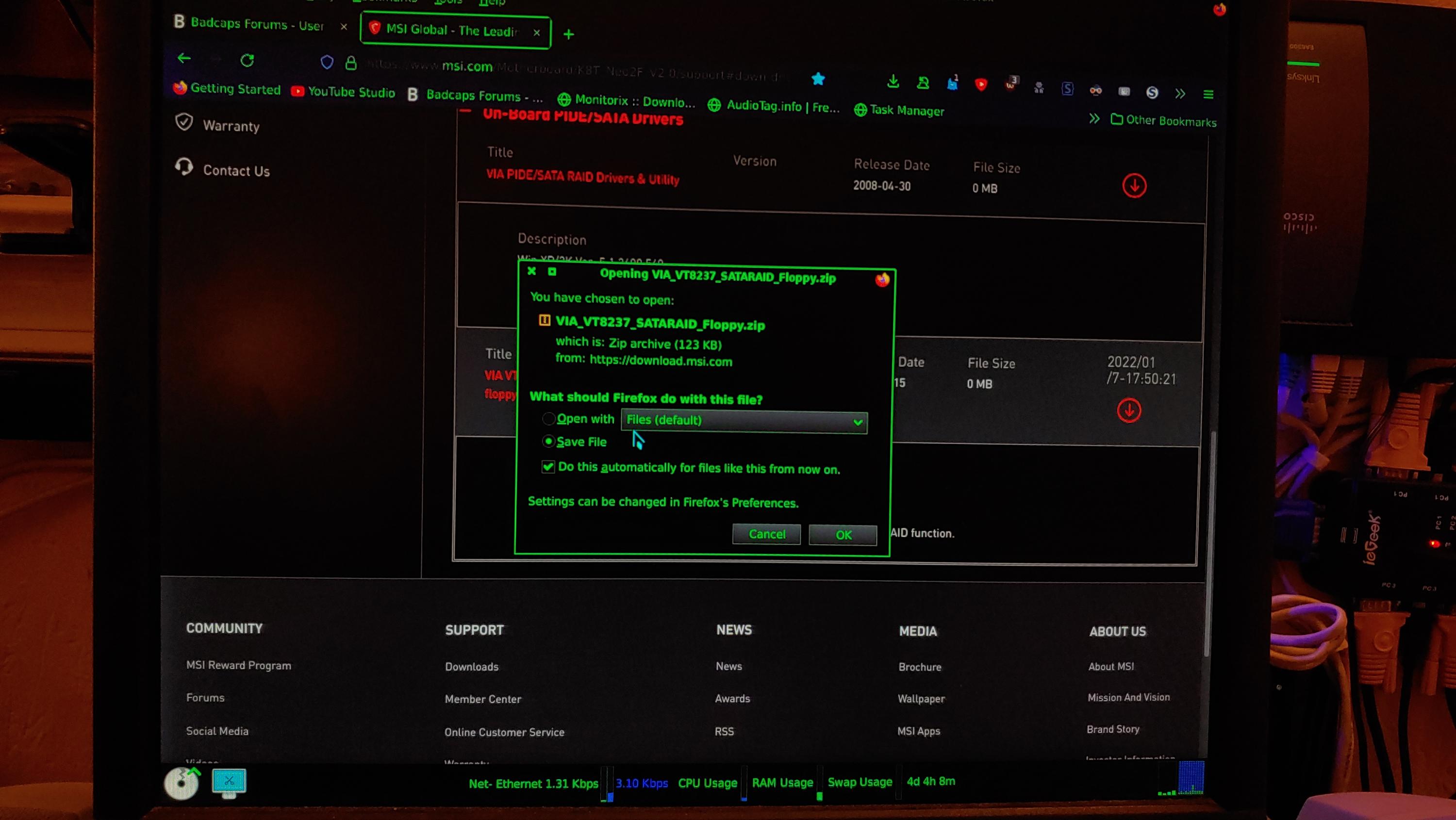

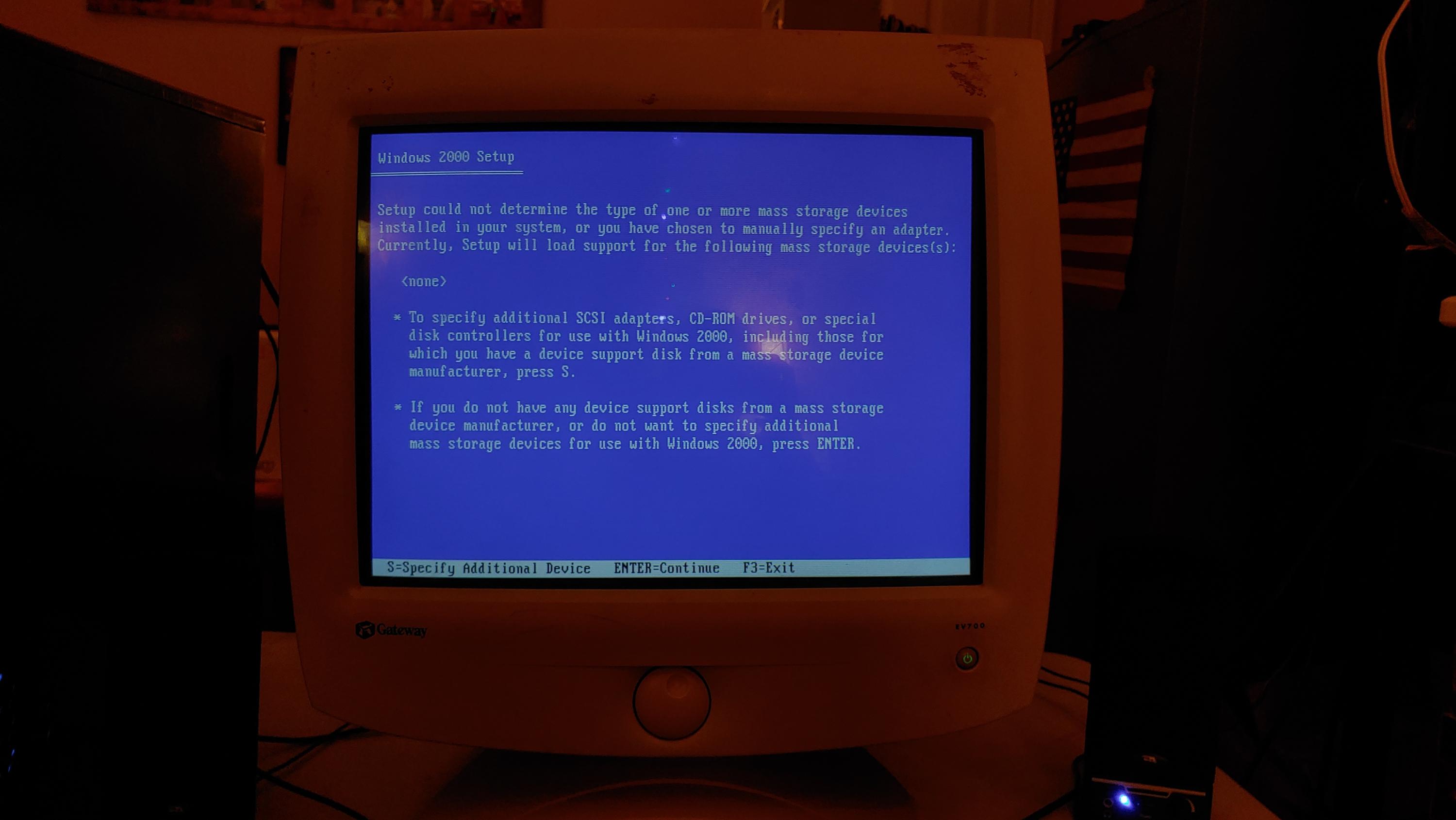

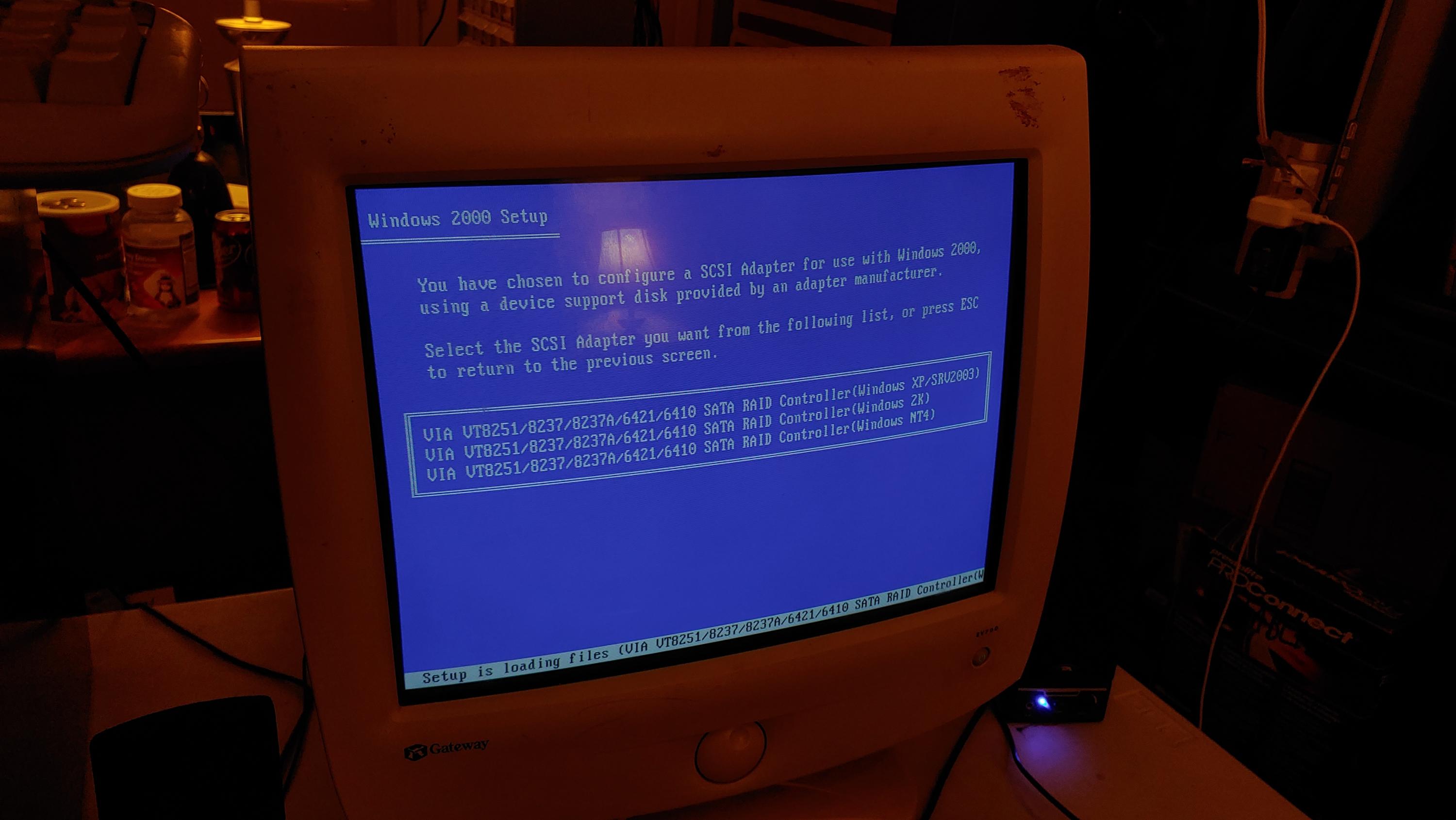

      Preparing the driver diskette for the SATA RAID controller:
      And done. (Or so I thought)

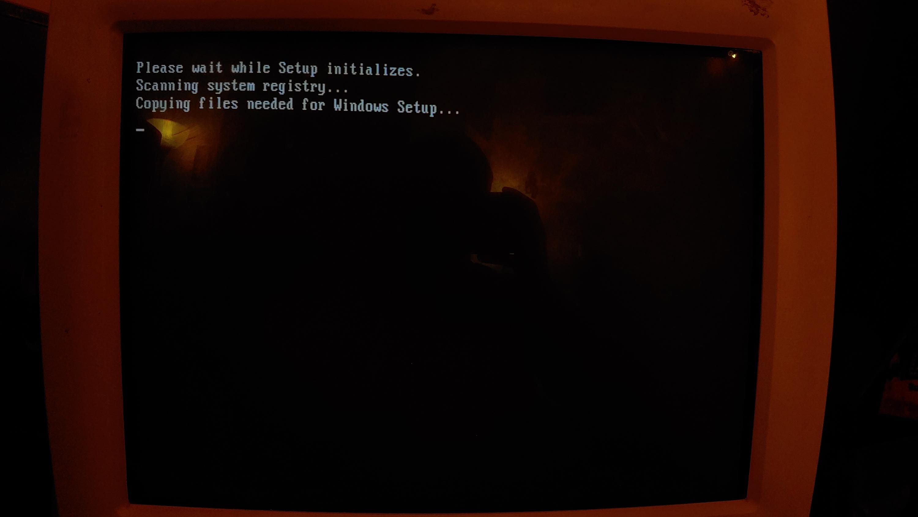

      Booting up...
      Oops, put the driver files in the wrong place:
      And fixed.
      Installing...

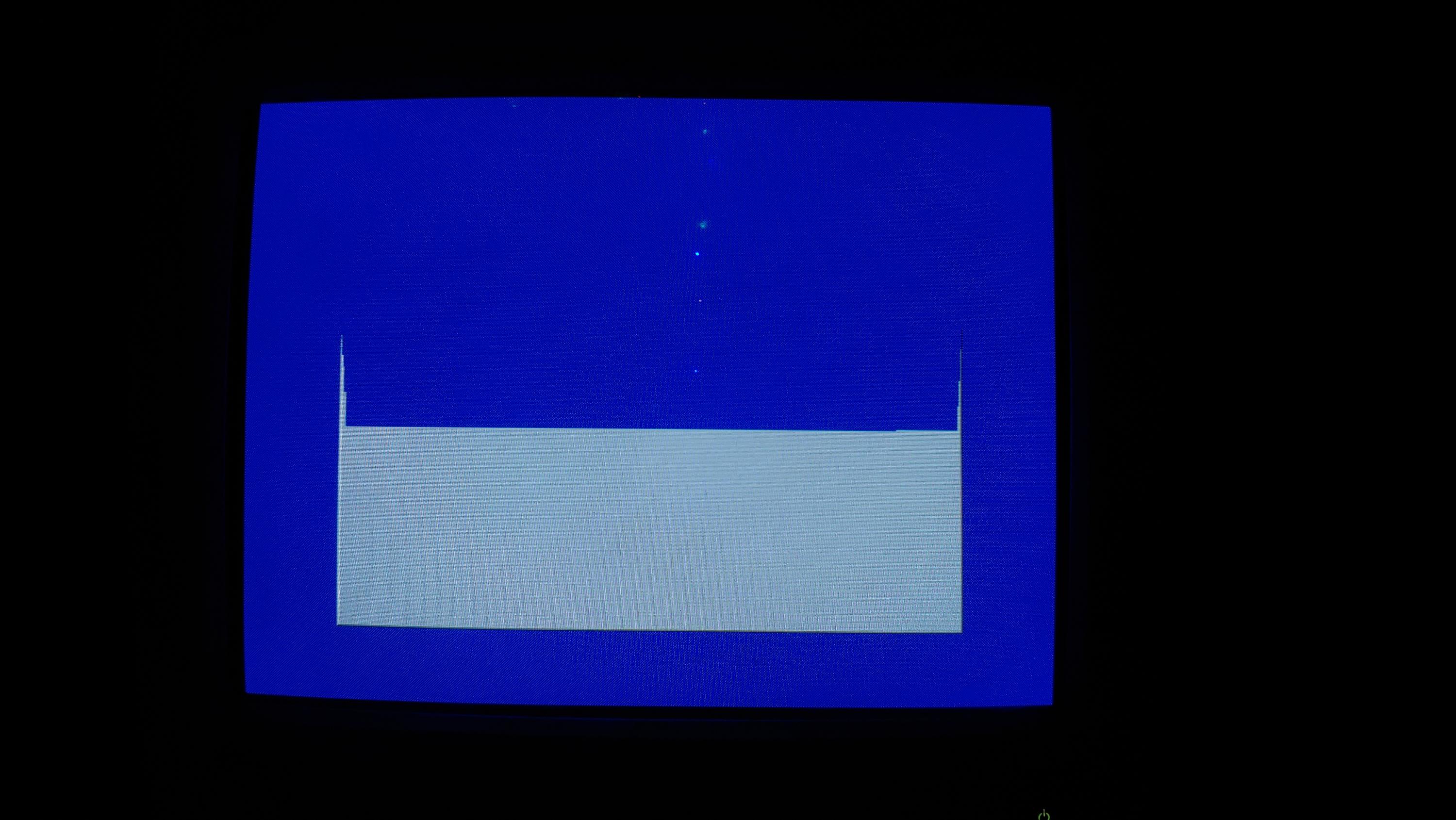

      *F8*
      First boot!
      More setup...
      Some Googling cured this problem.
      And dead ahead is the attachment limit. More to come later!

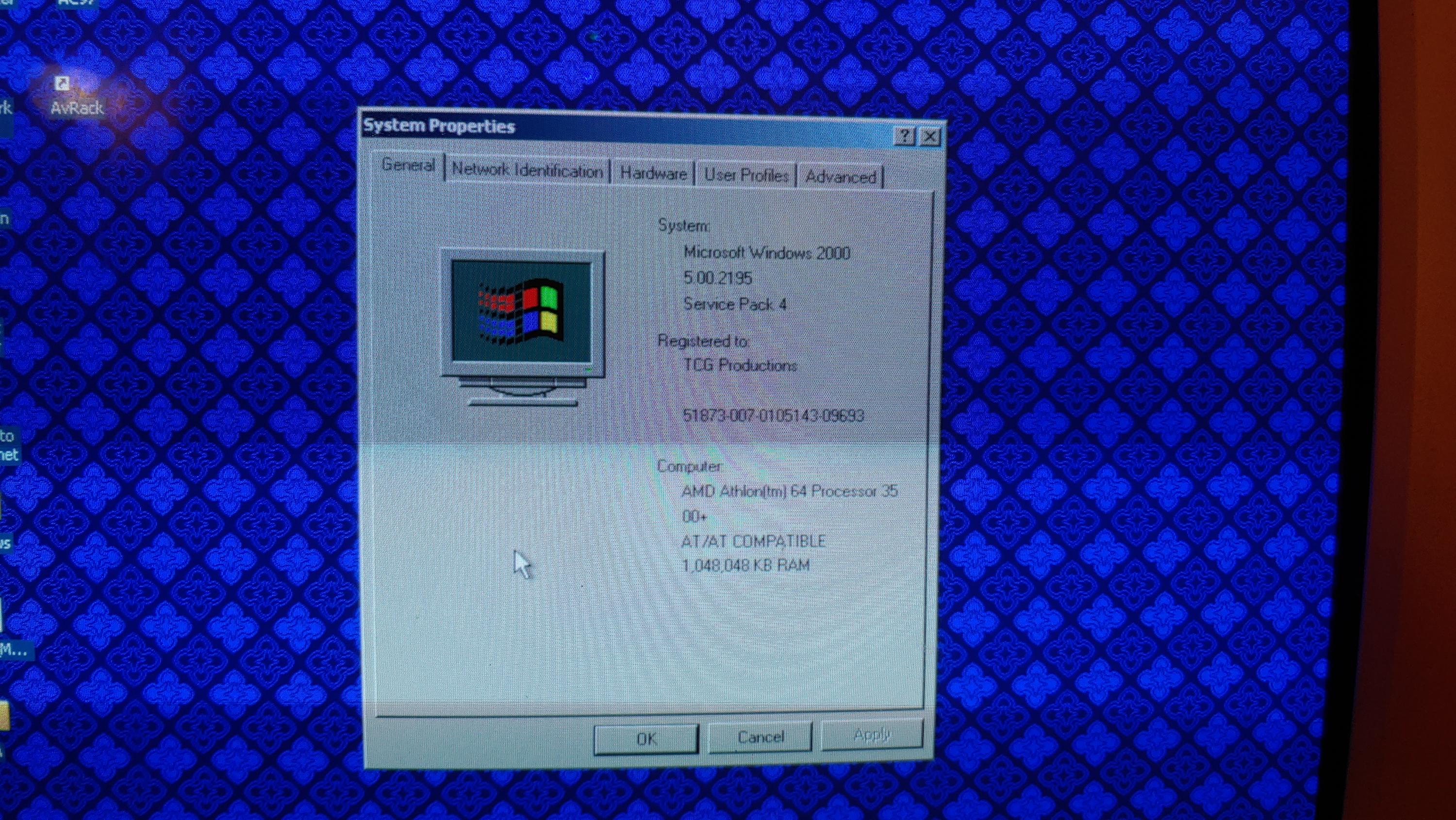

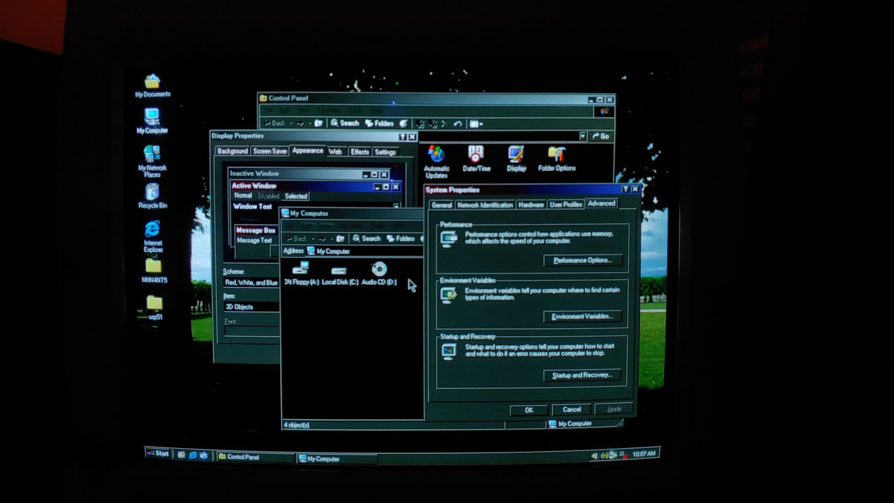

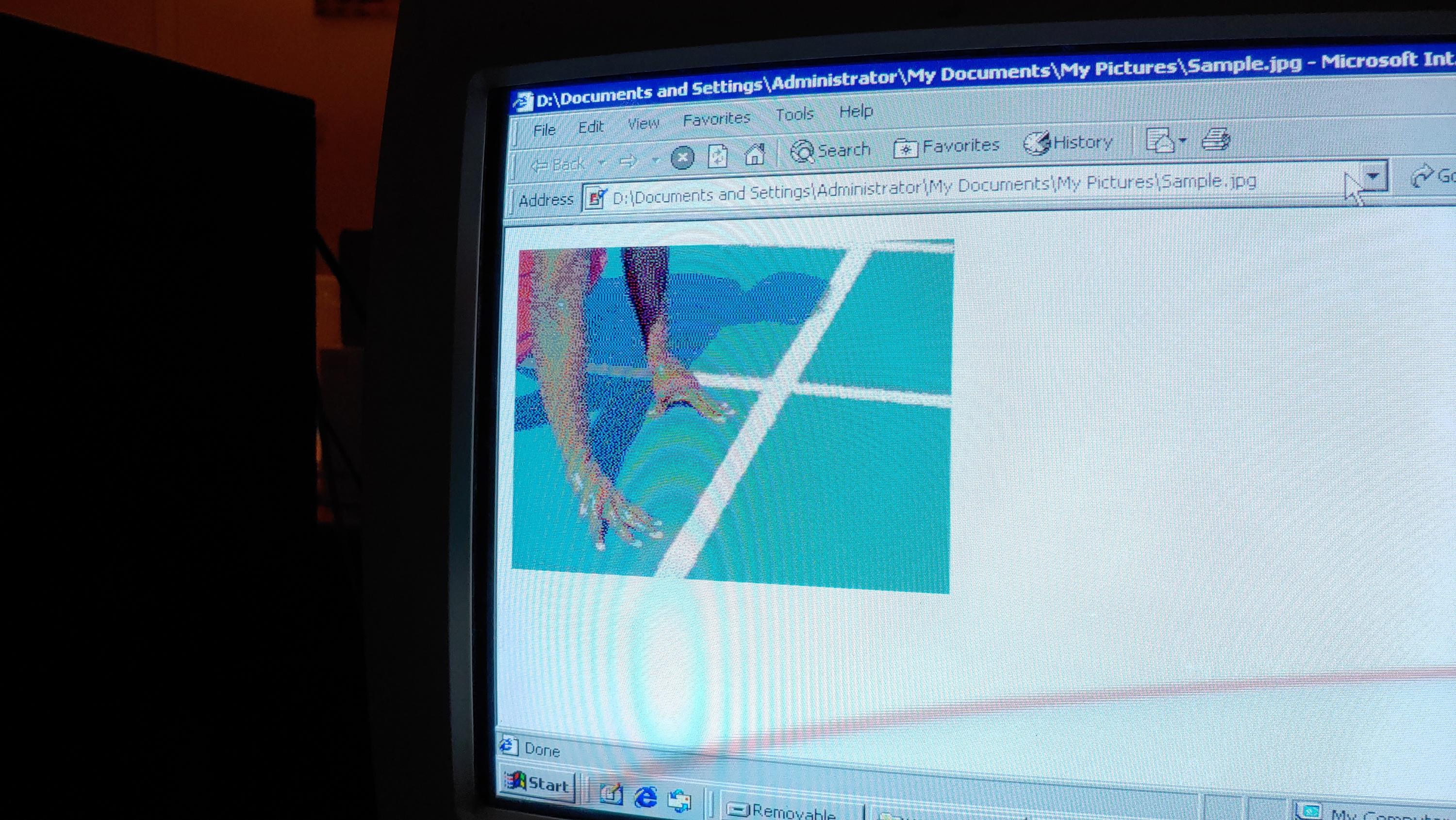

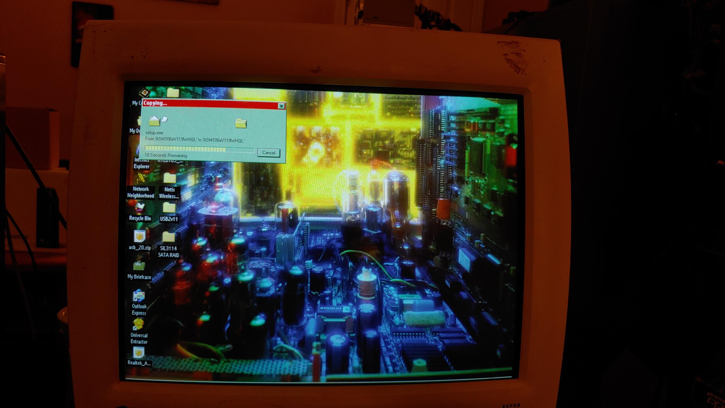

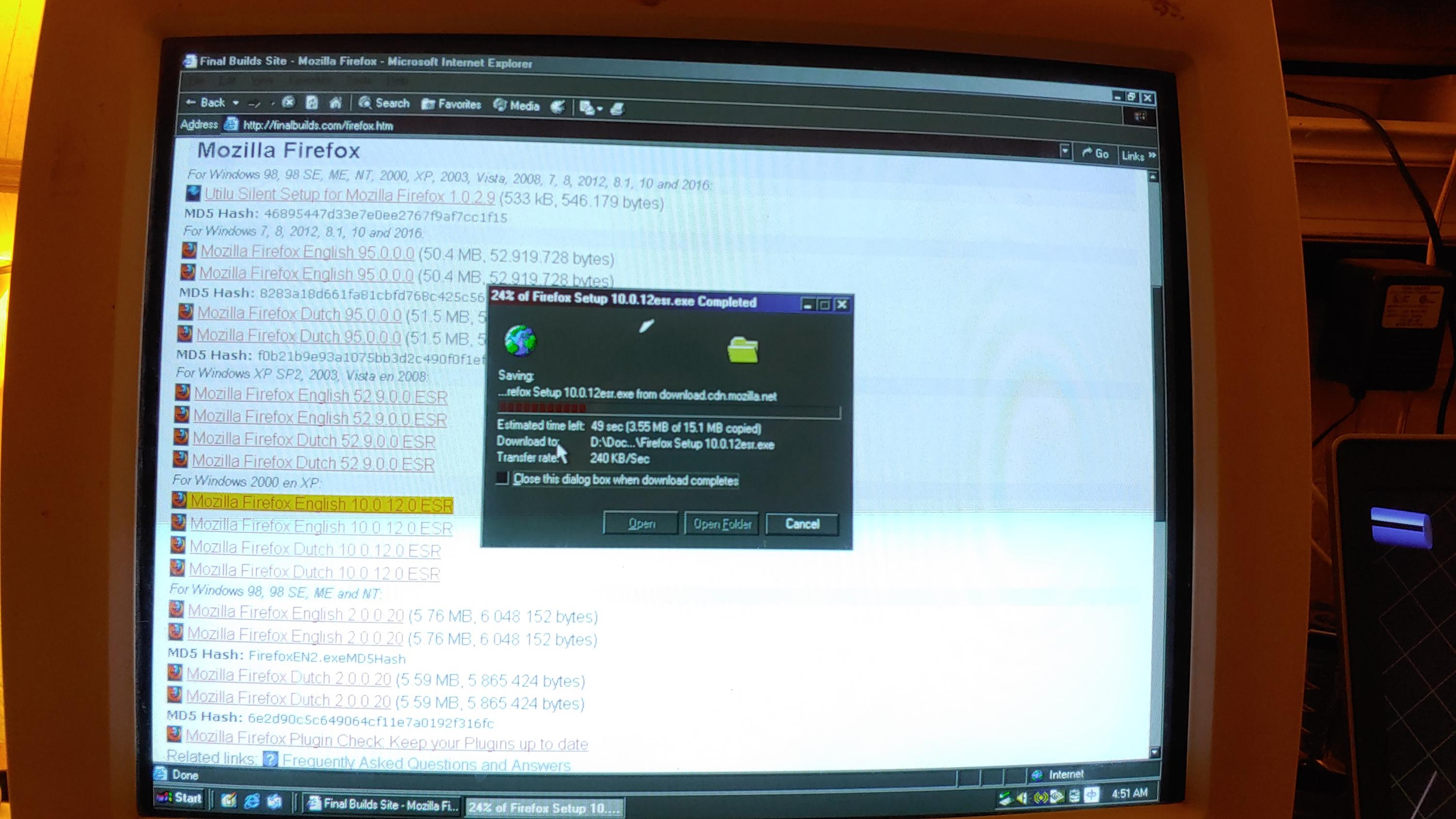

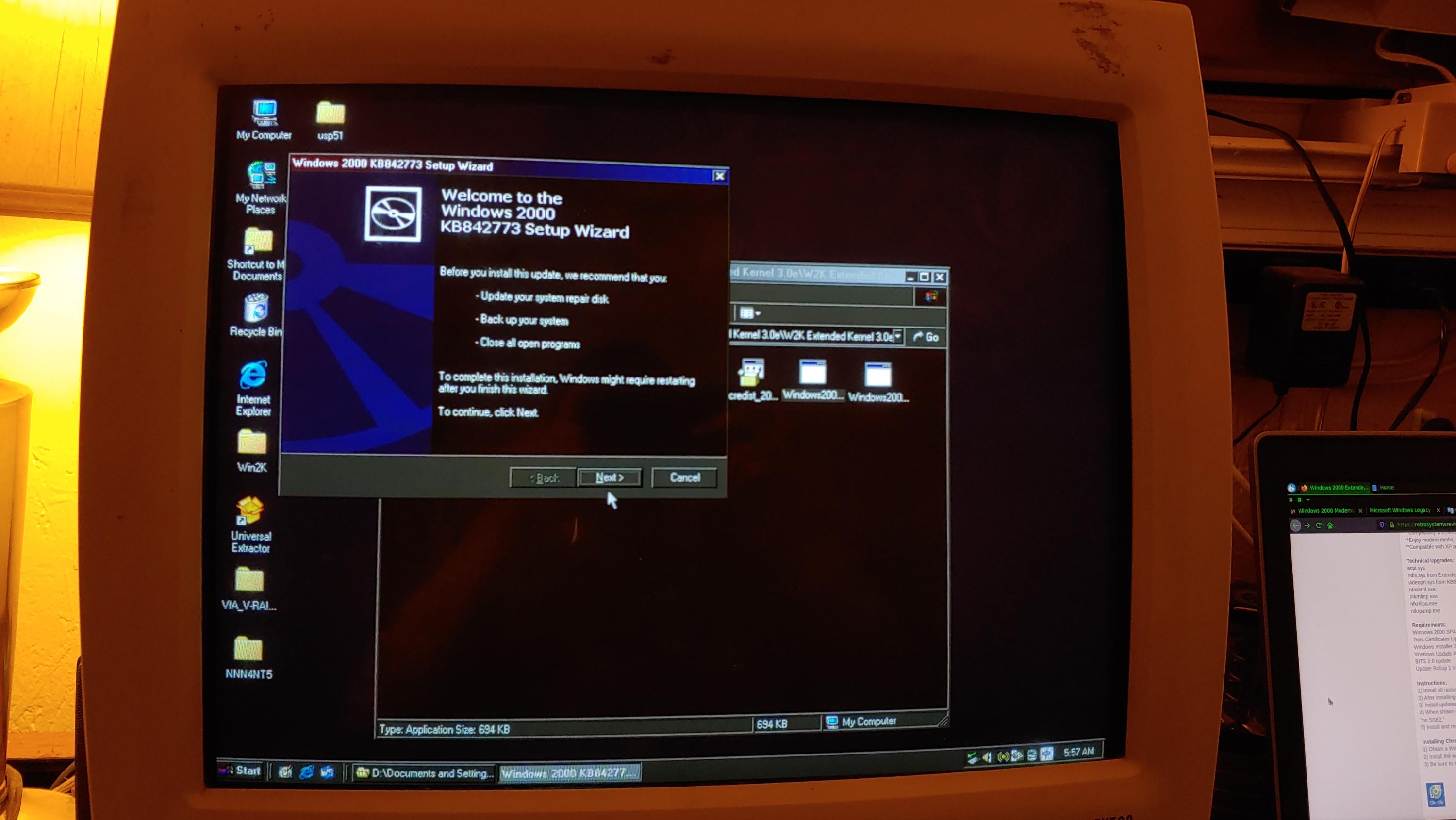

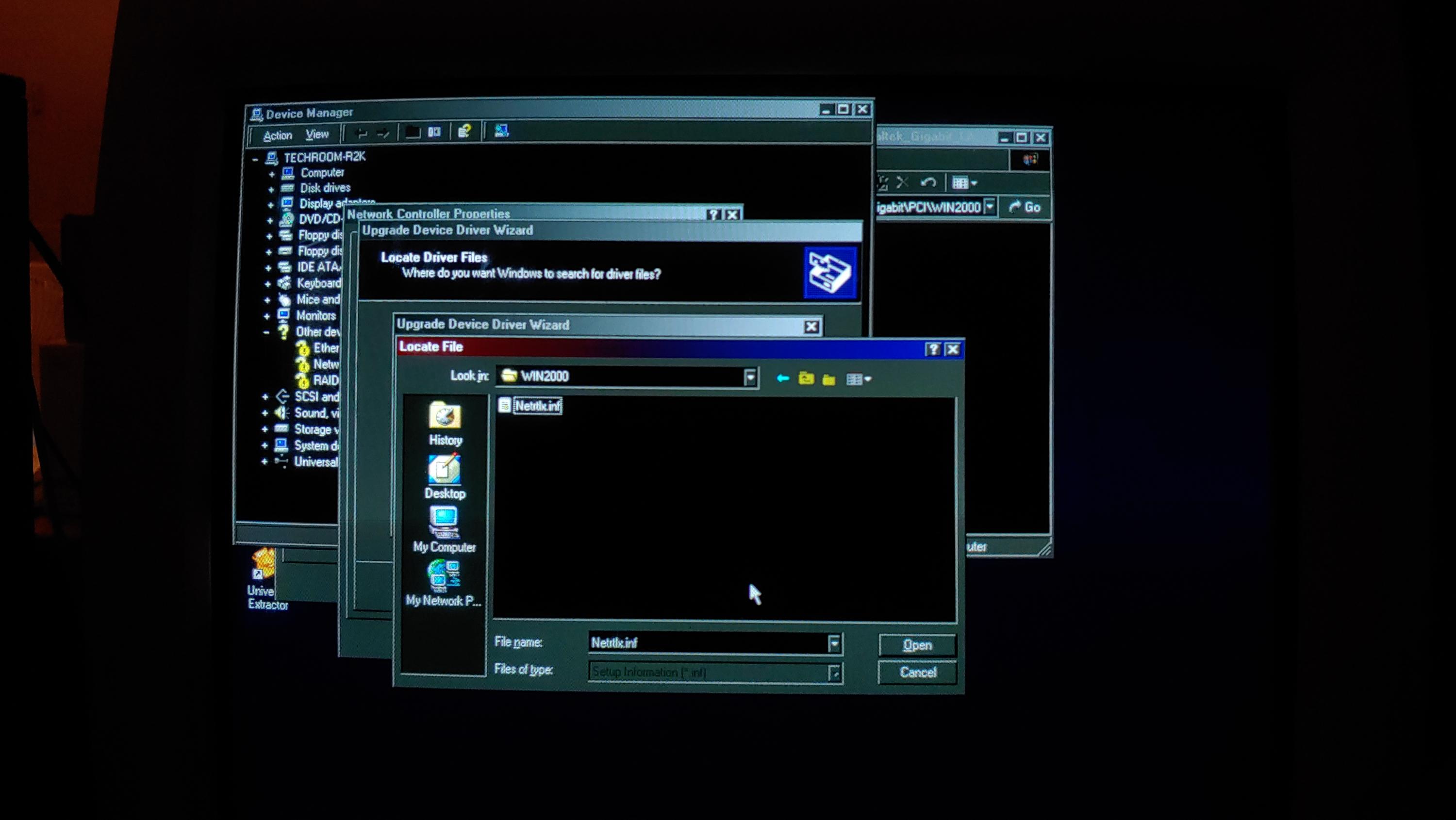

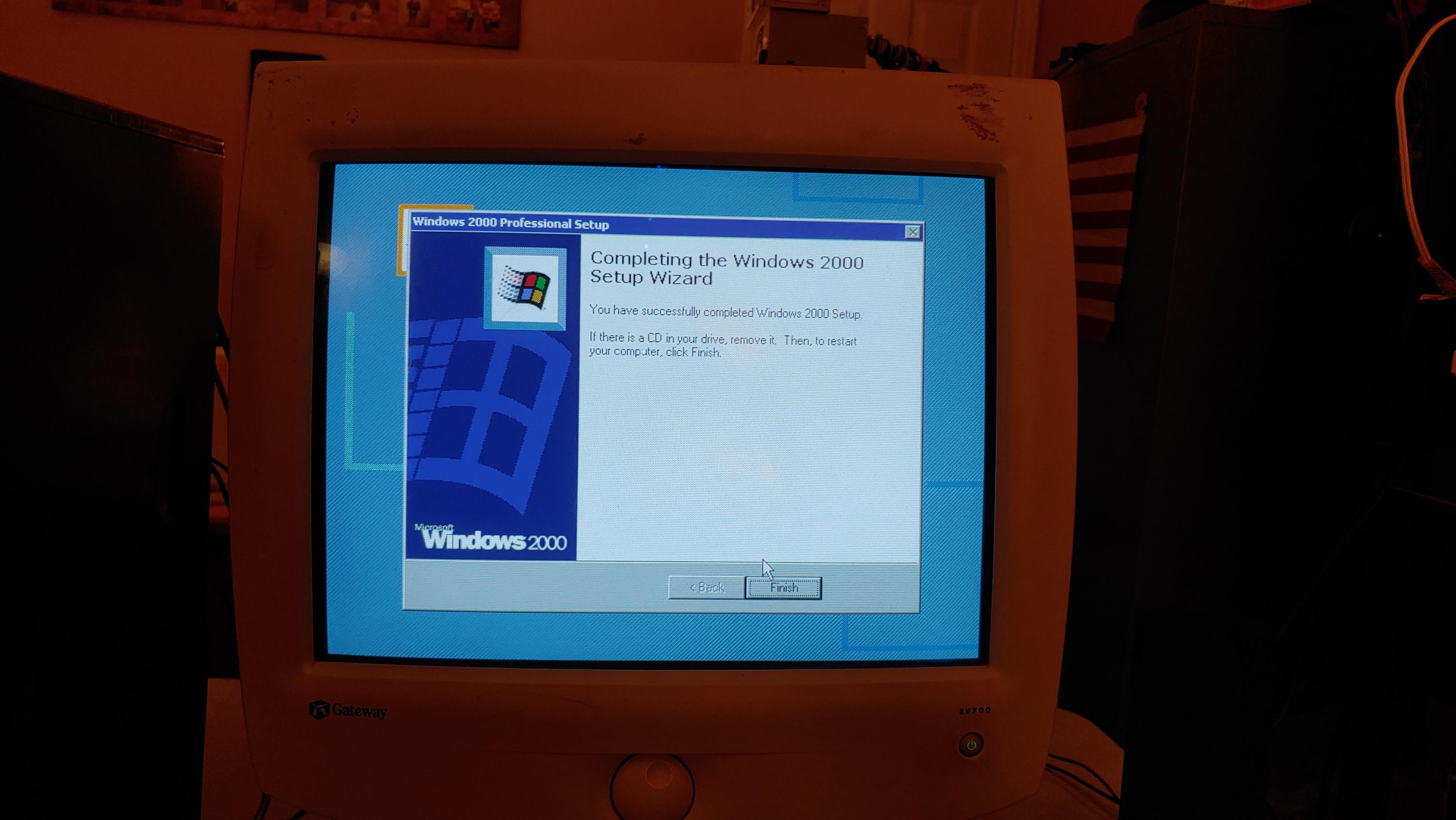

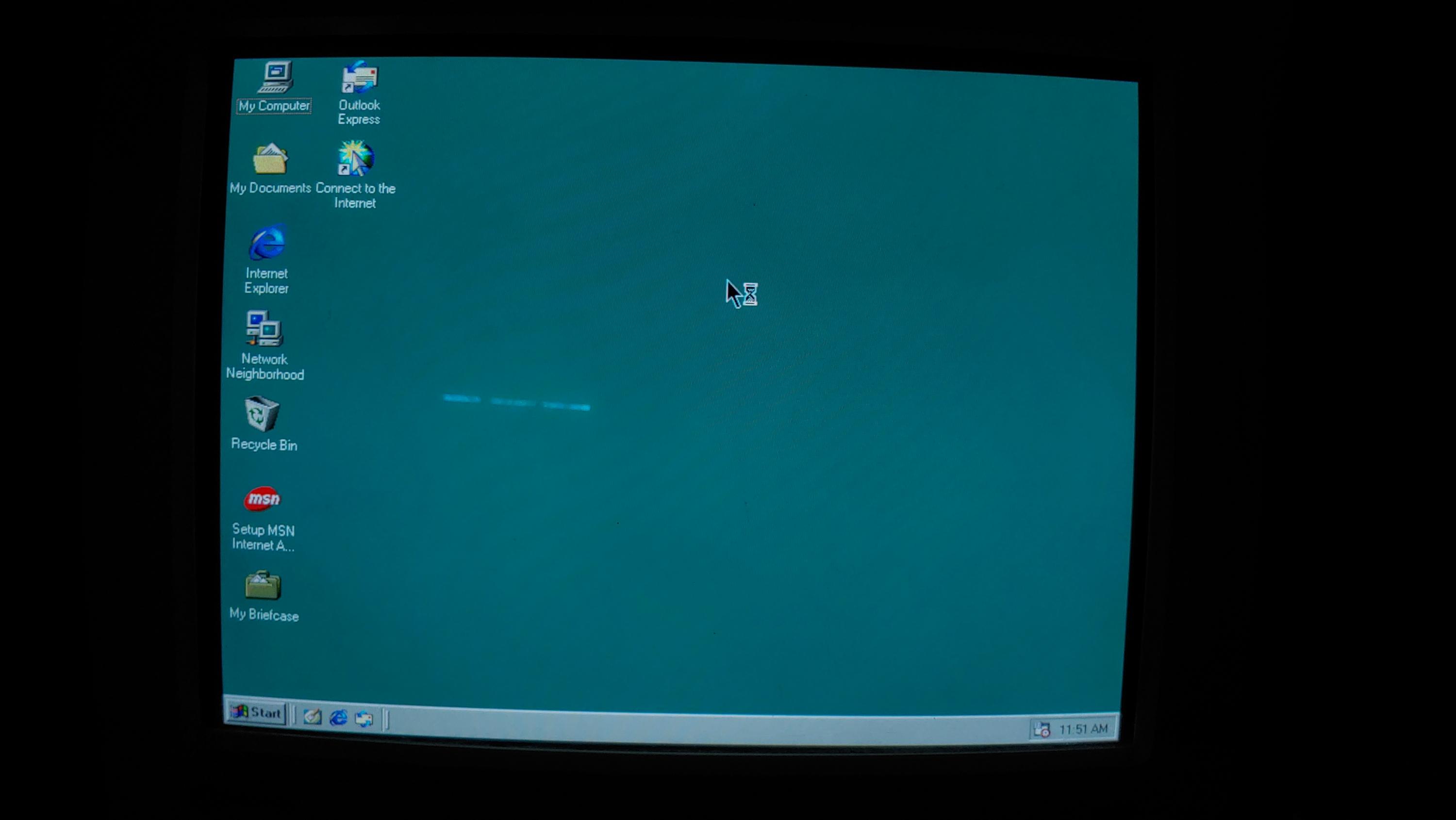

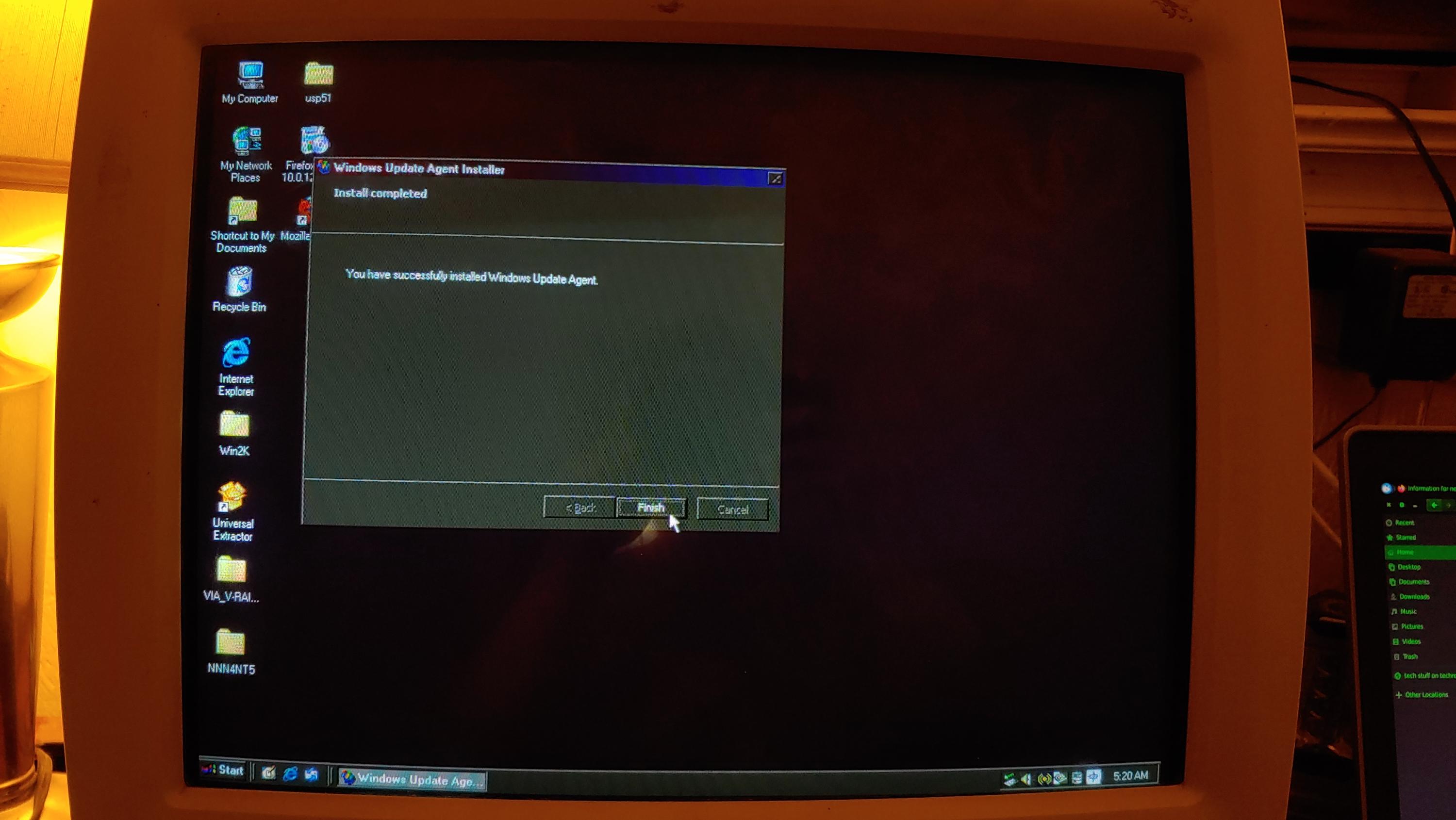

            And here we have a little more progress on the system. Let's begin.
            Setup complete!
            Disabling an annoying "feature"...

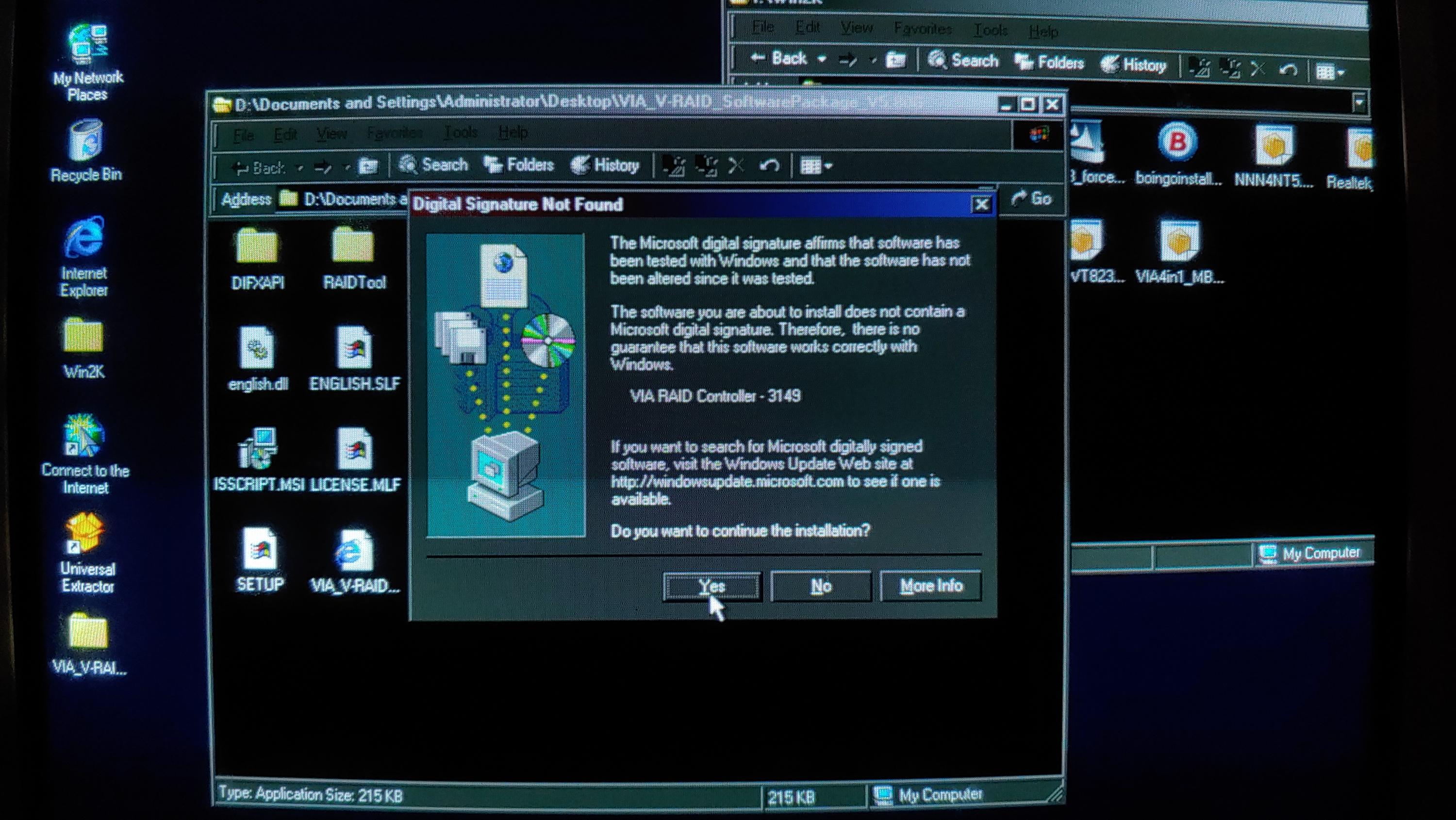

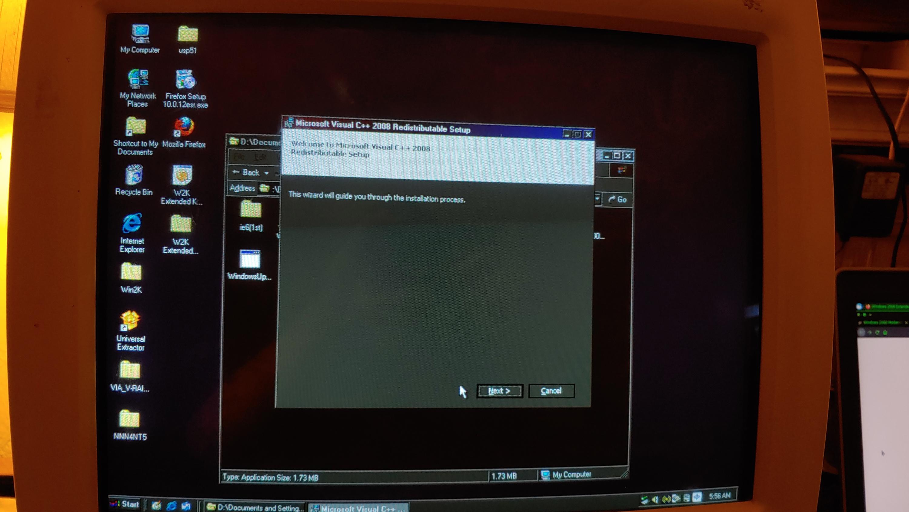

            Installing drivers...

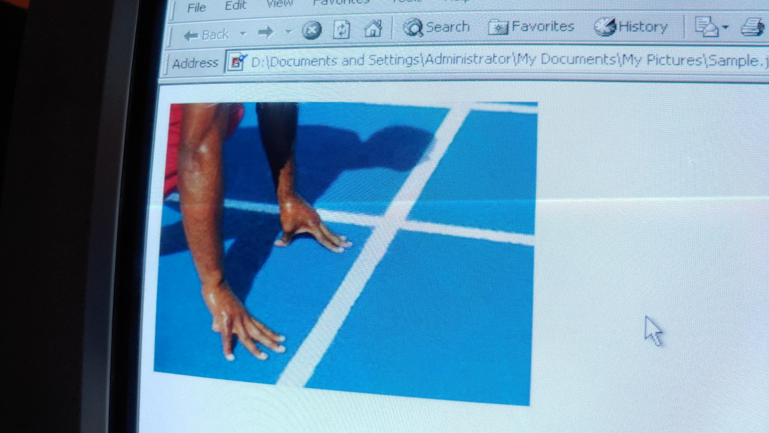

            That looks a whole lot better.

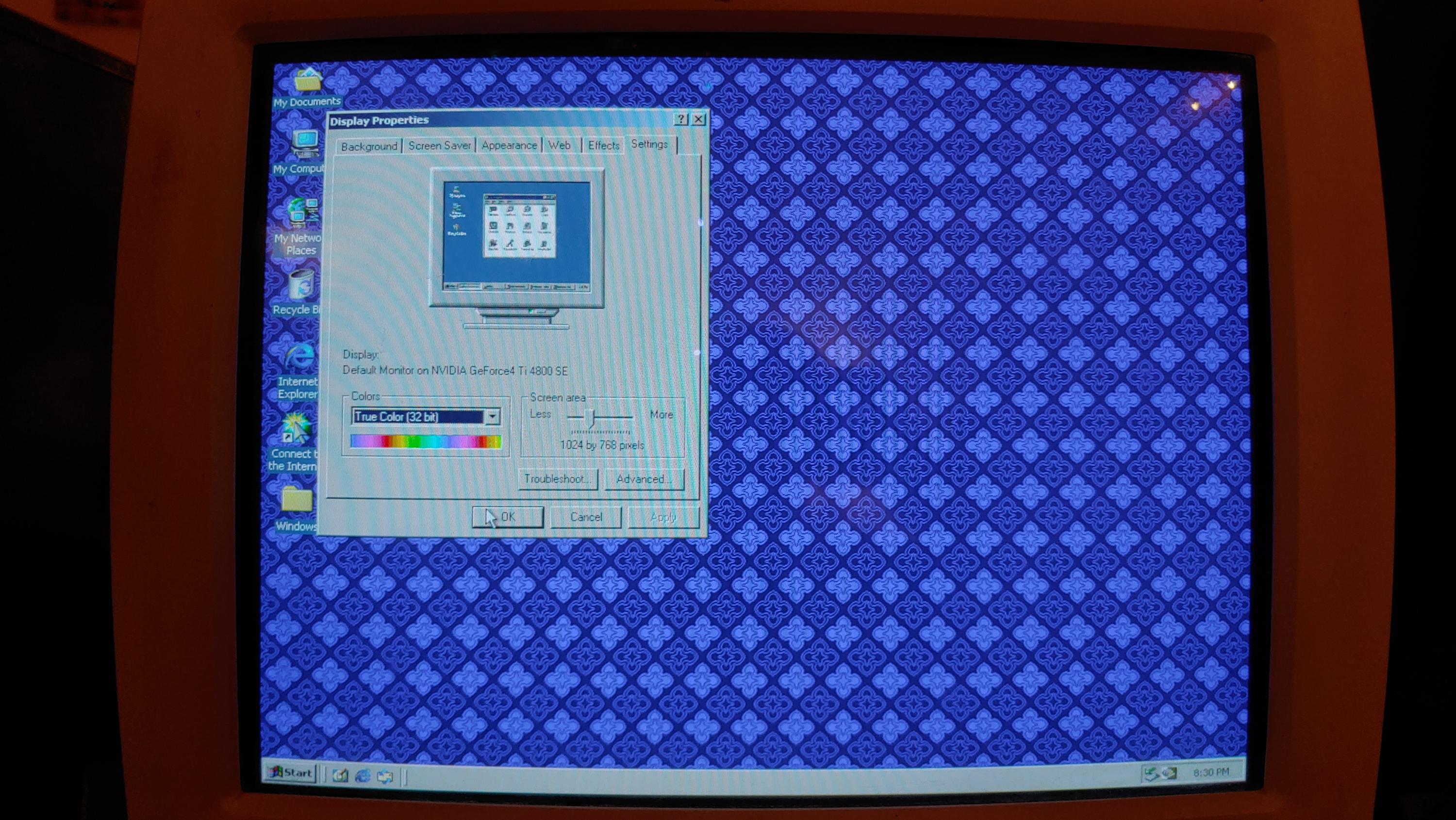

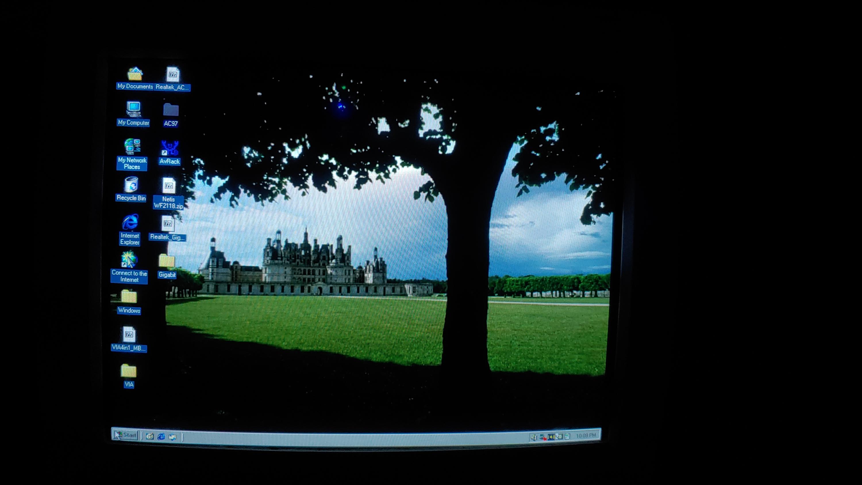

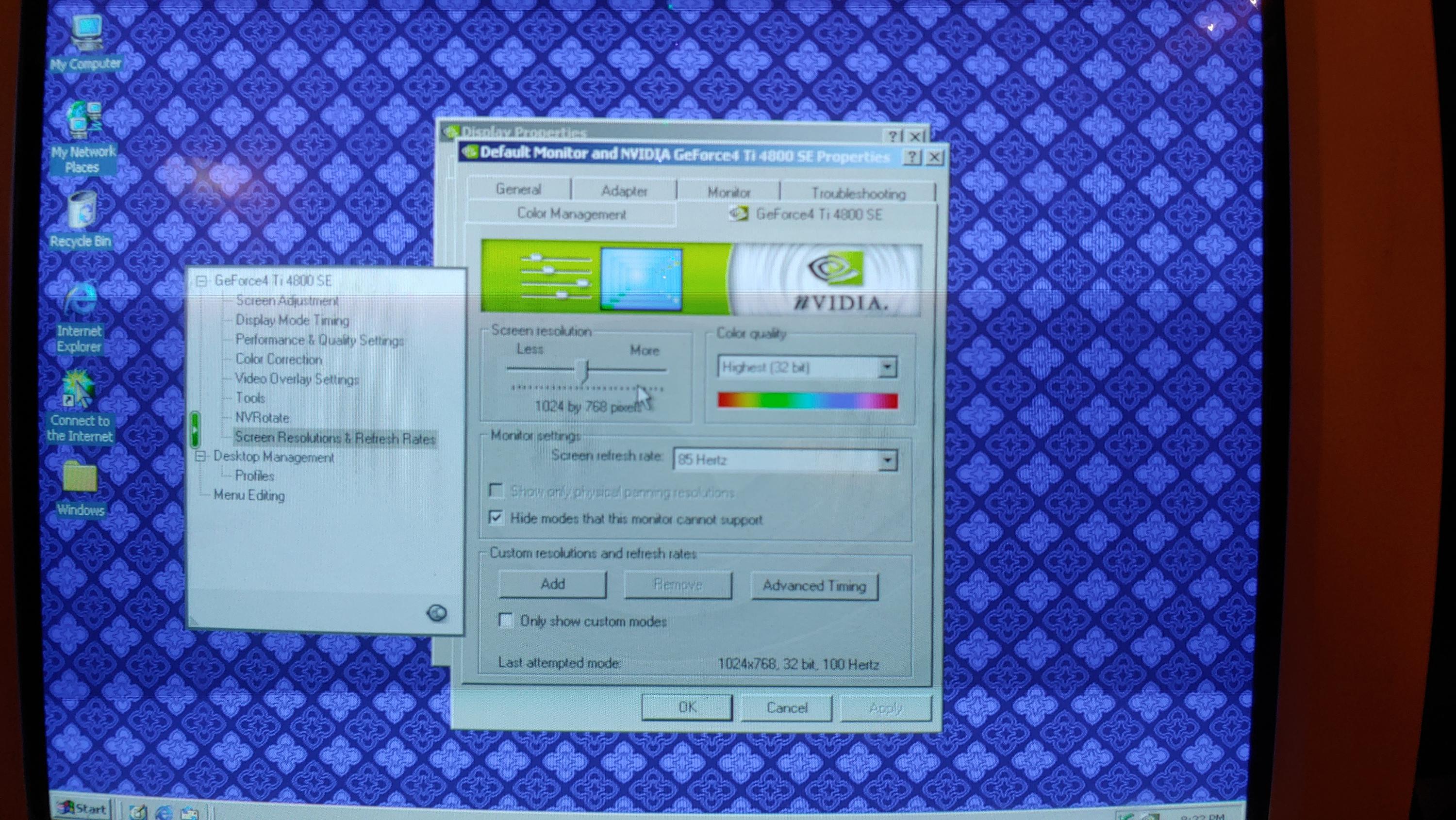

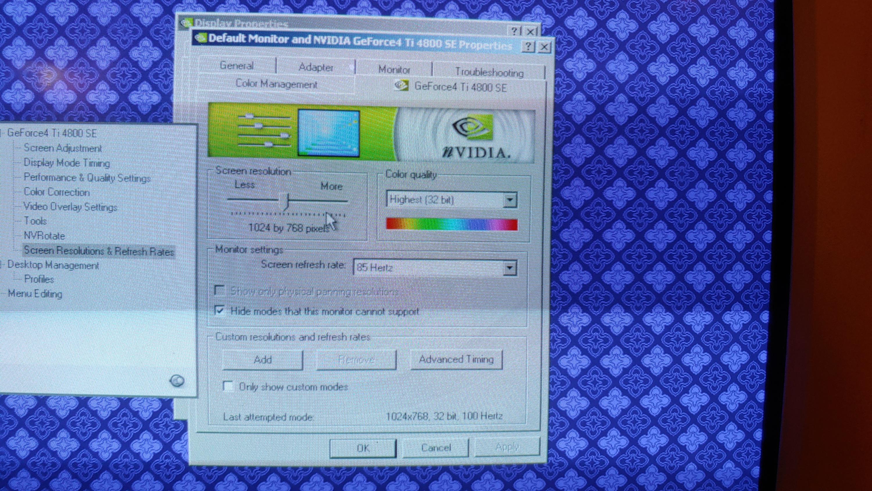

            Setting screen resolution...
            ...to 1024x768@85Hz.

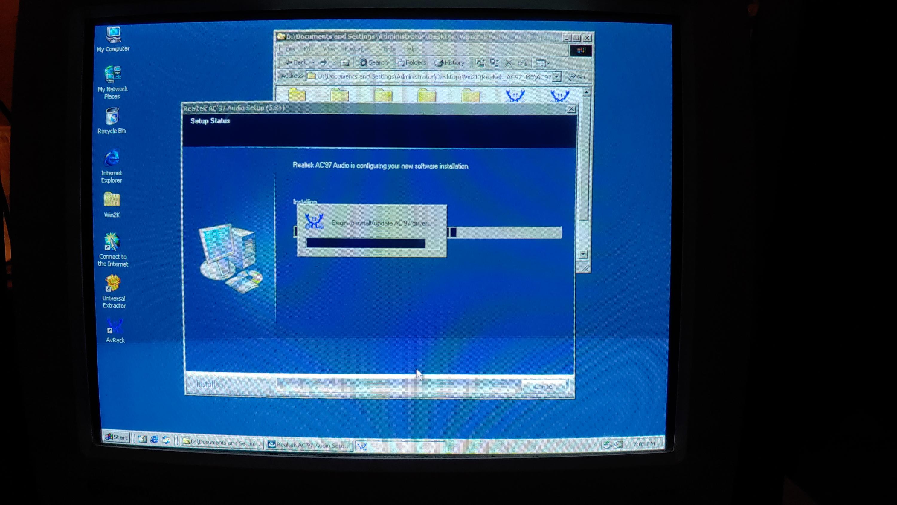

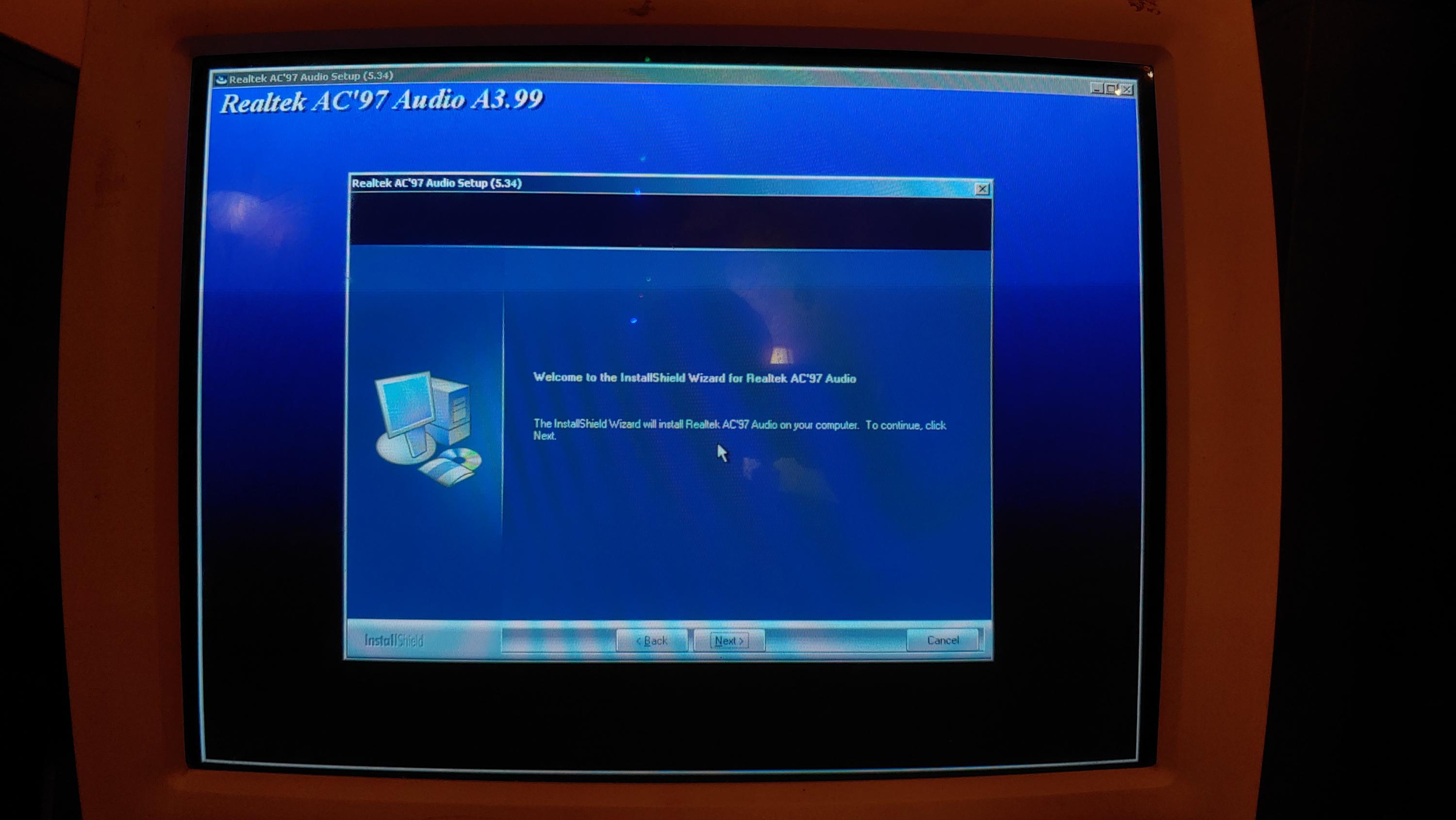

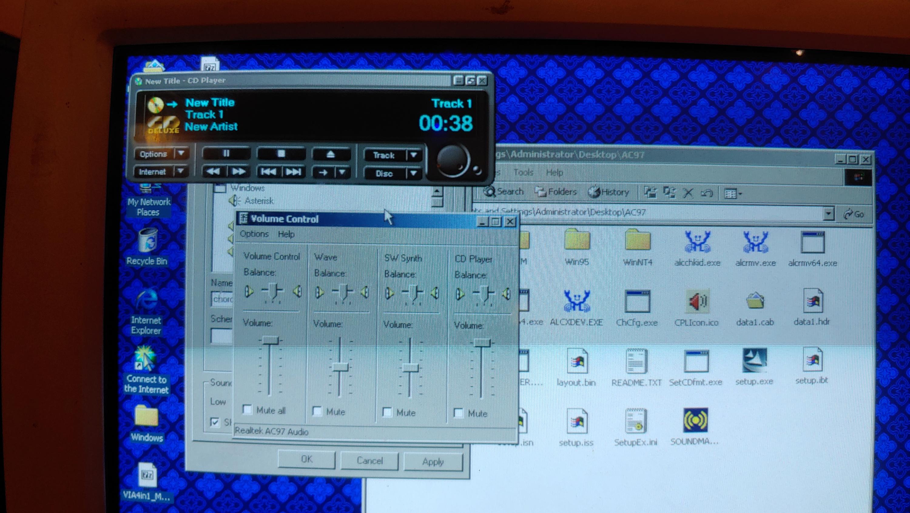

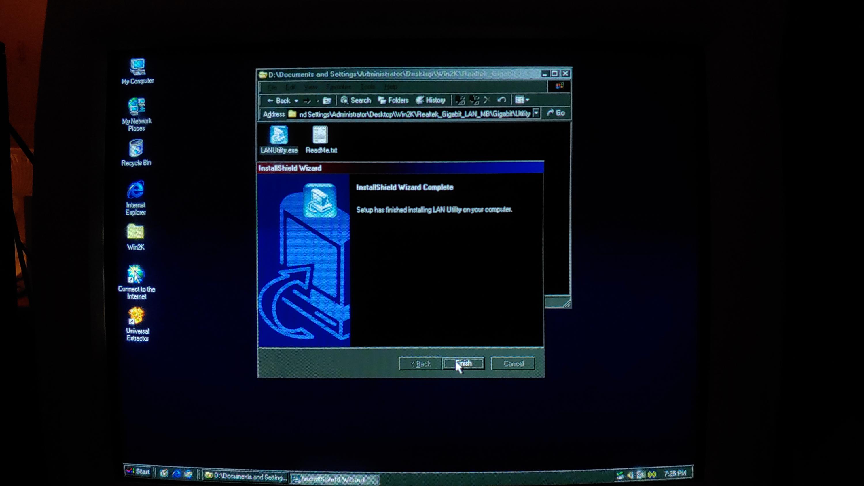

            Installing sound drivers.
            And done! That 4-pin audio cable is actually having analog audio routed over it instead of over the system's ATA bus. I've tried it both ways, and using a direct analog output always seems to work better and more reliably as compared to stuffing digital data over an already crammed ATA bus.

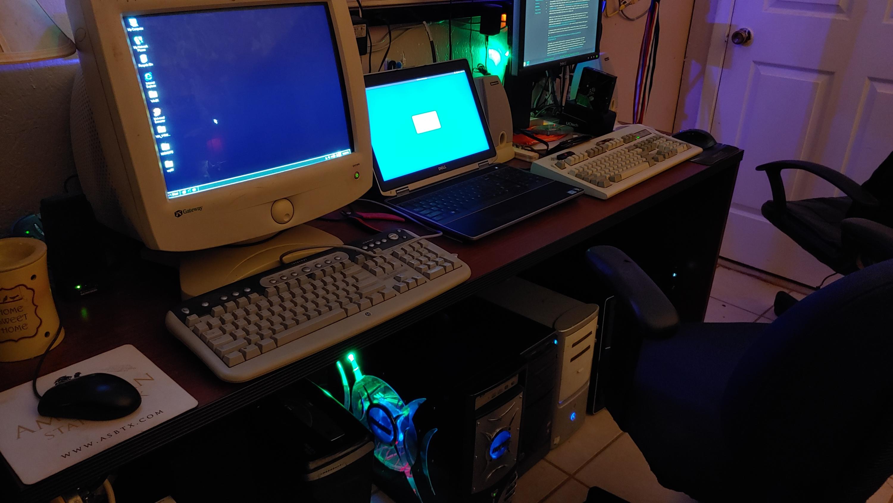

            About the system:

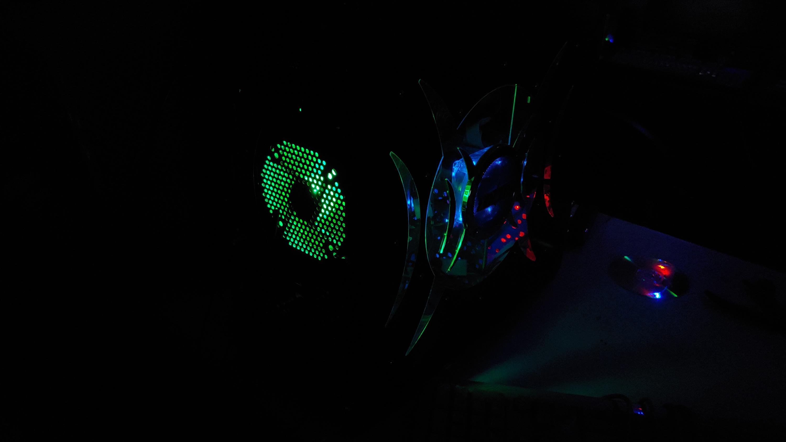

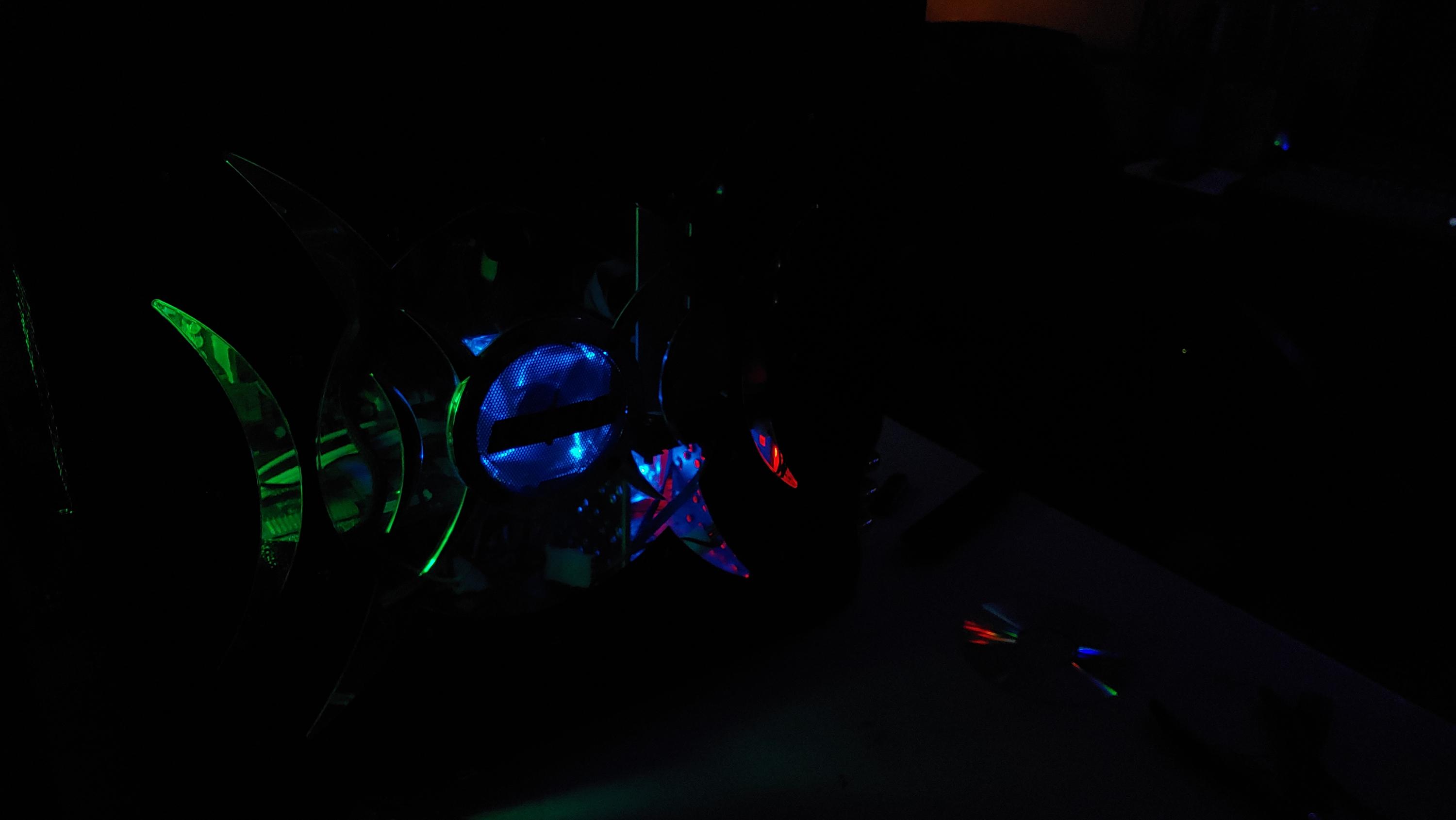

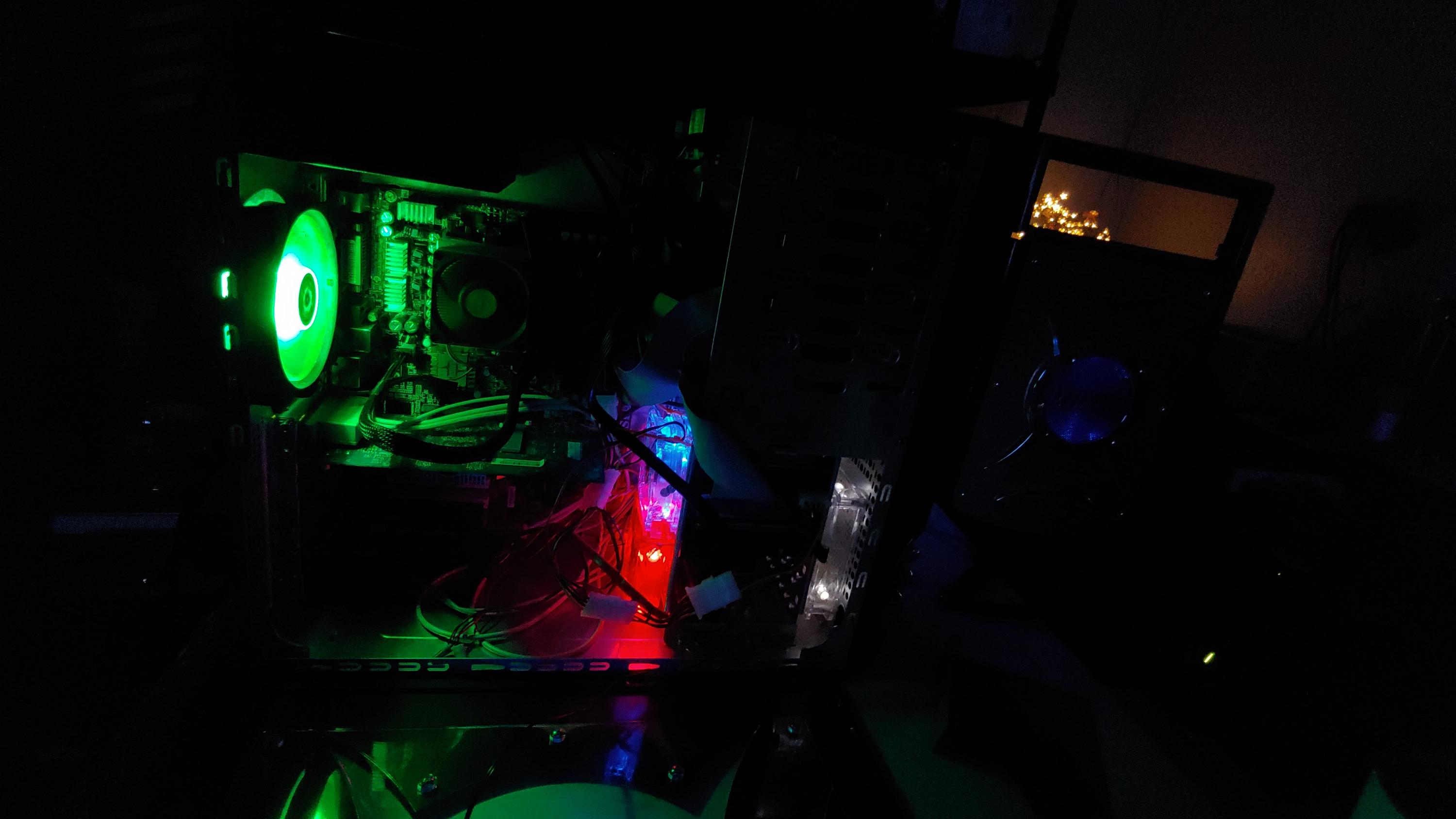

            Now for some case shots.
            A bit later...

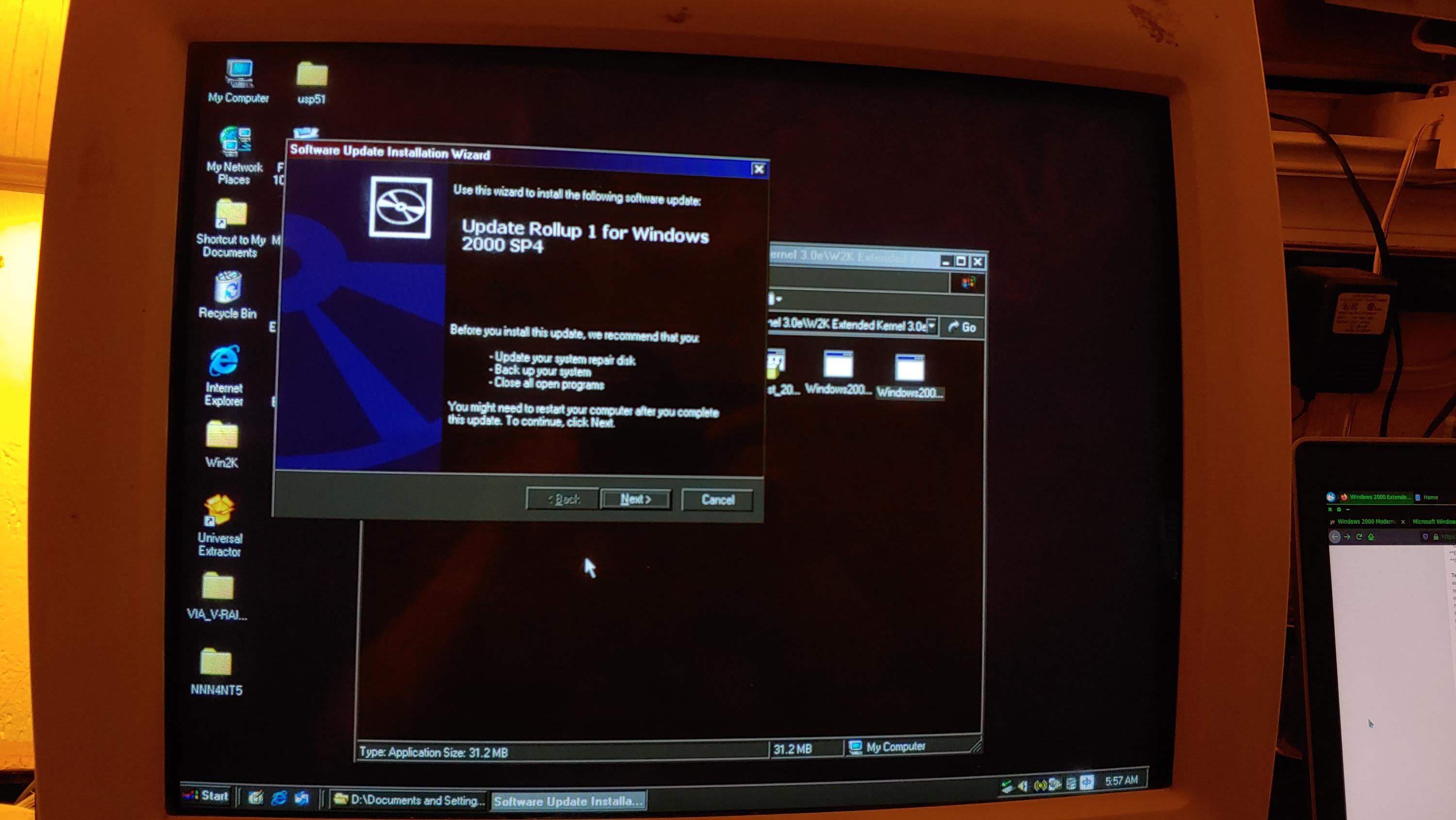

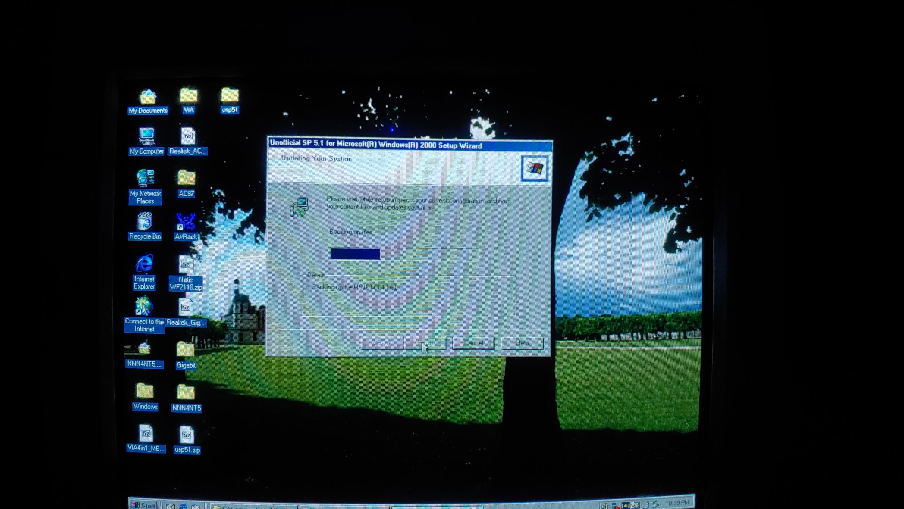

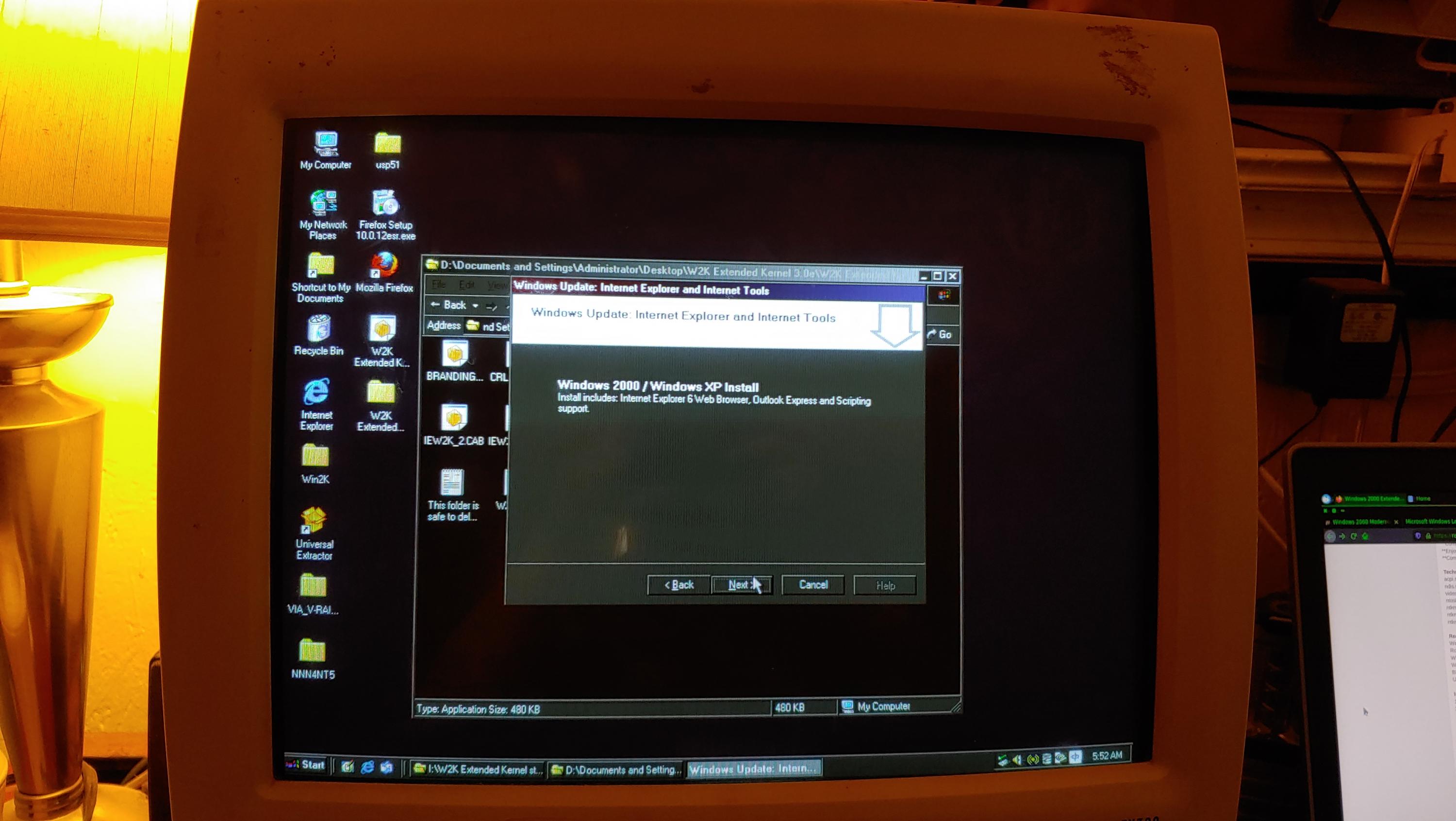

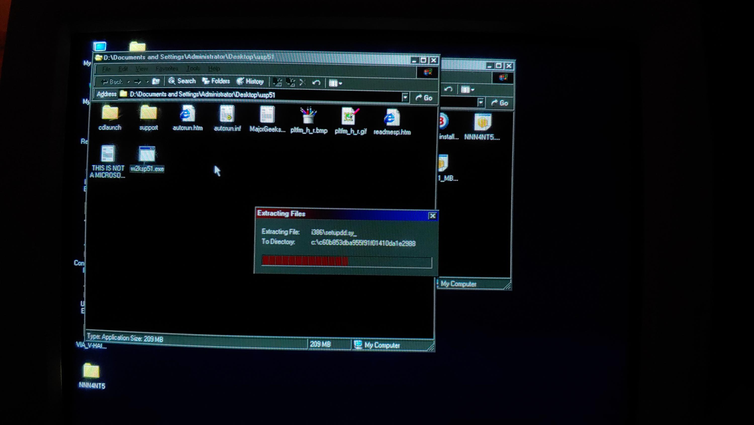

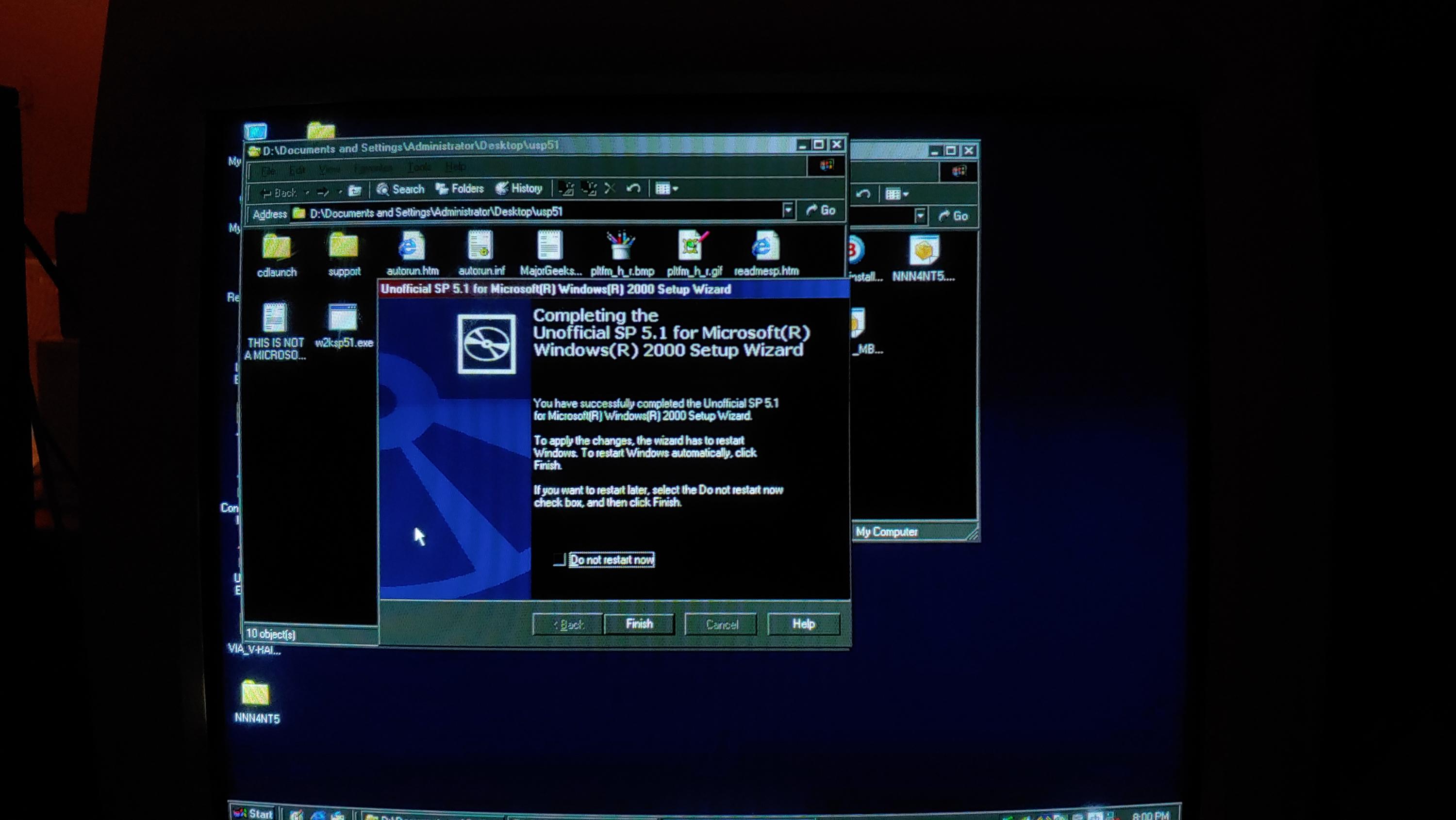

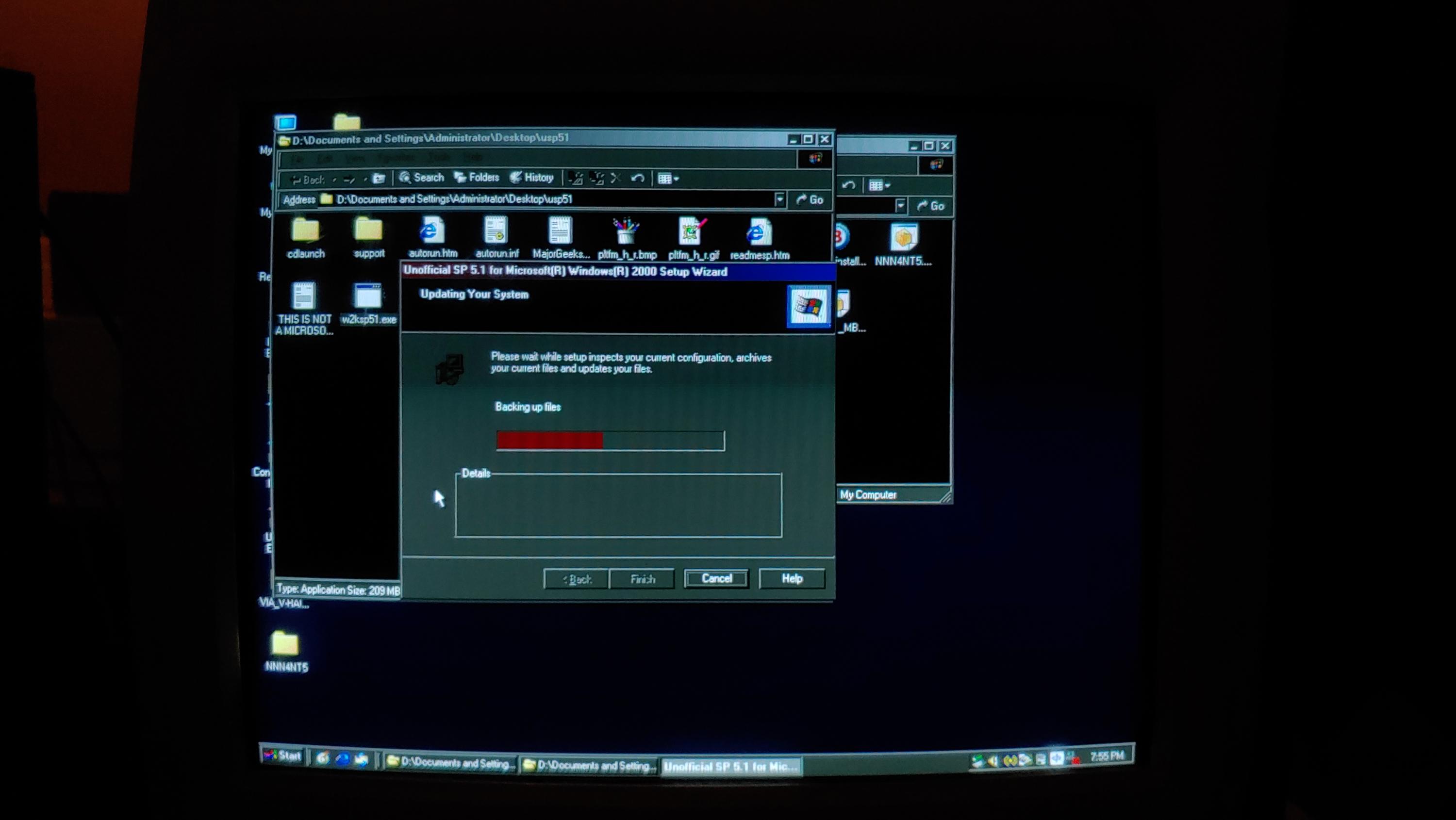

            Preparing to install the unofficial Service Pack 5.1 update:
            Installing...
            ...and done.
            Showing it off once again:

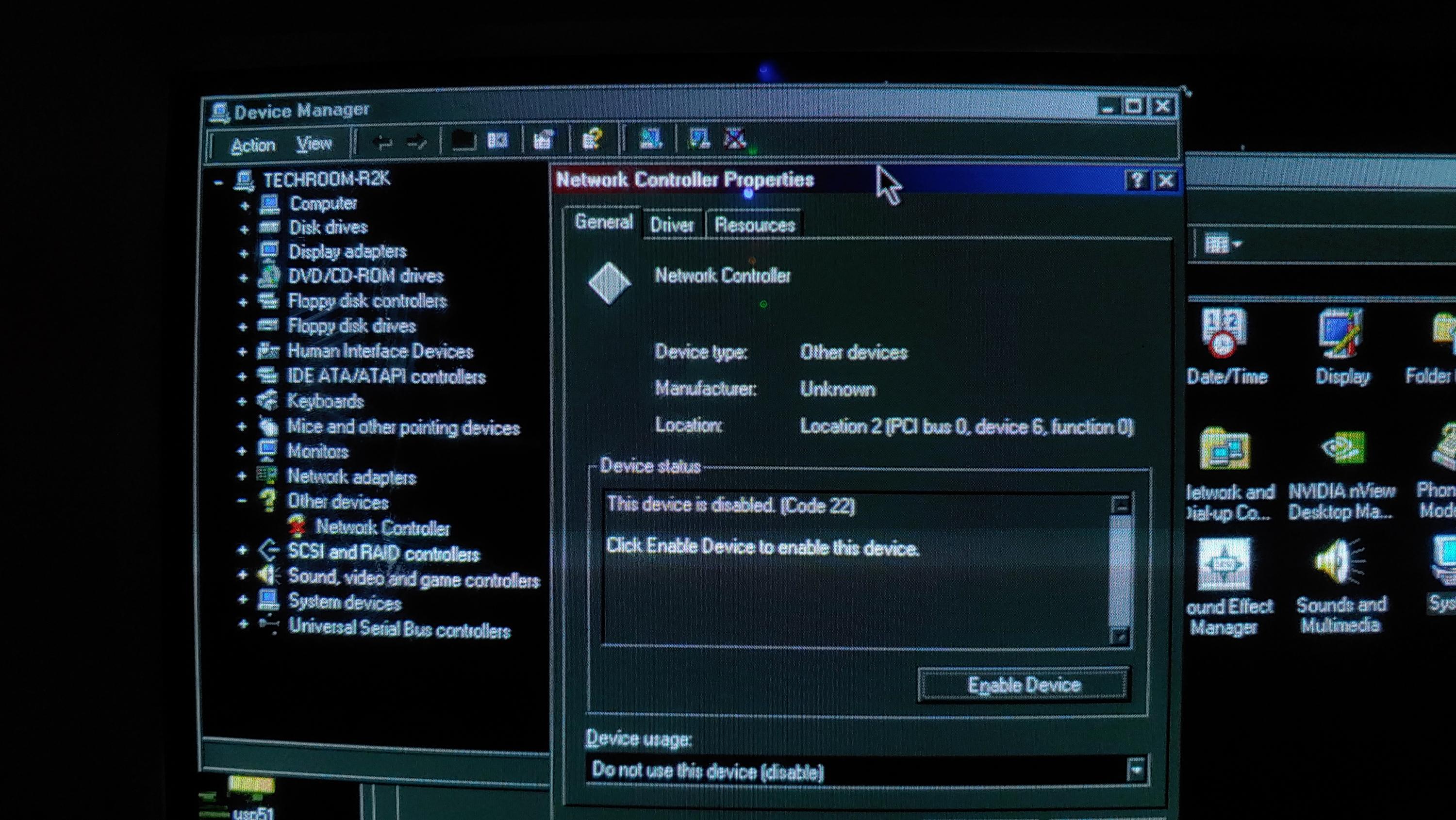

            Locked out the wireless card since I can't find any Windows-2000 compatible drivers for it.
            And that's all I've got for now. Stay tuned, more changes coming up later today!

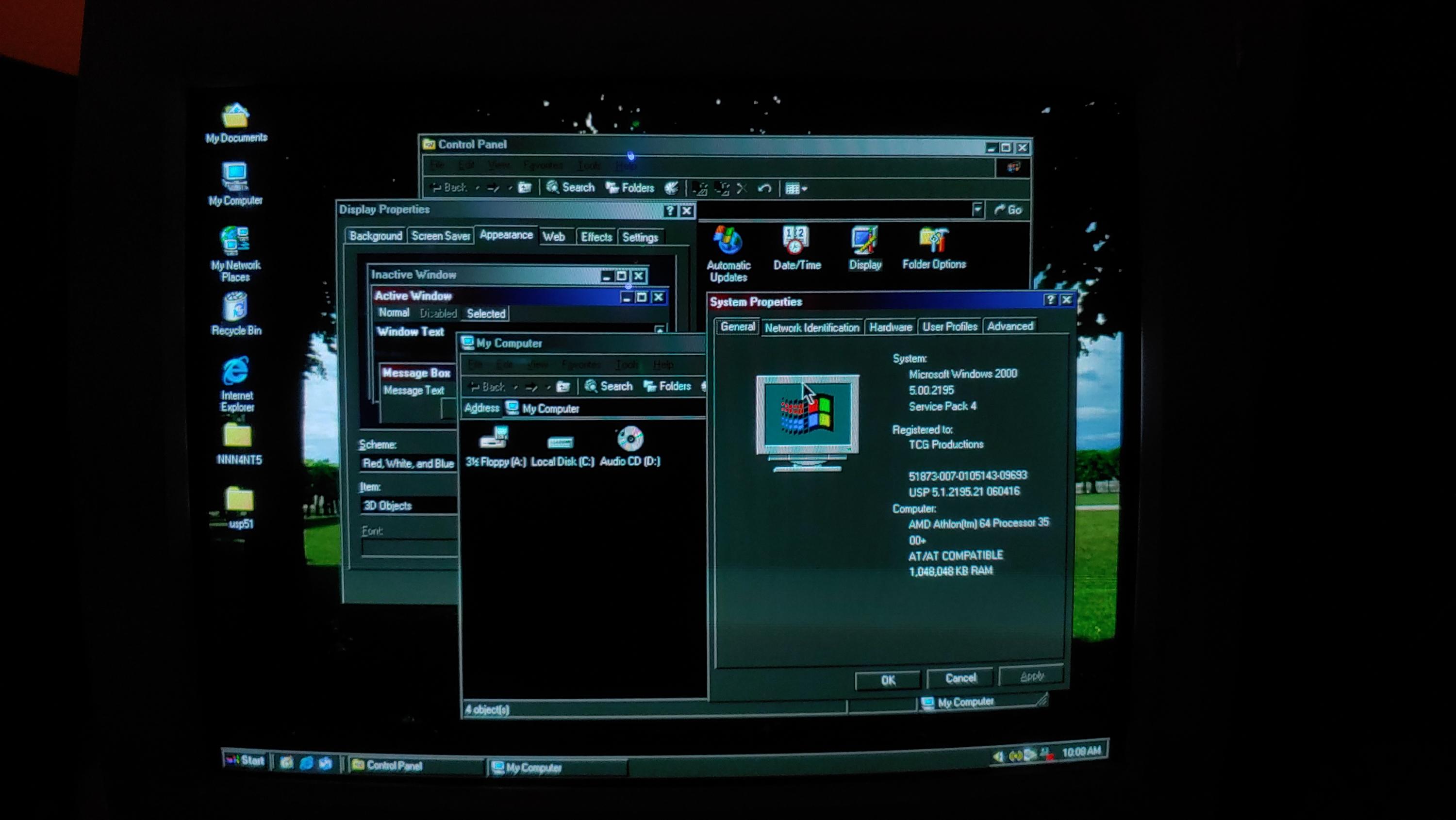

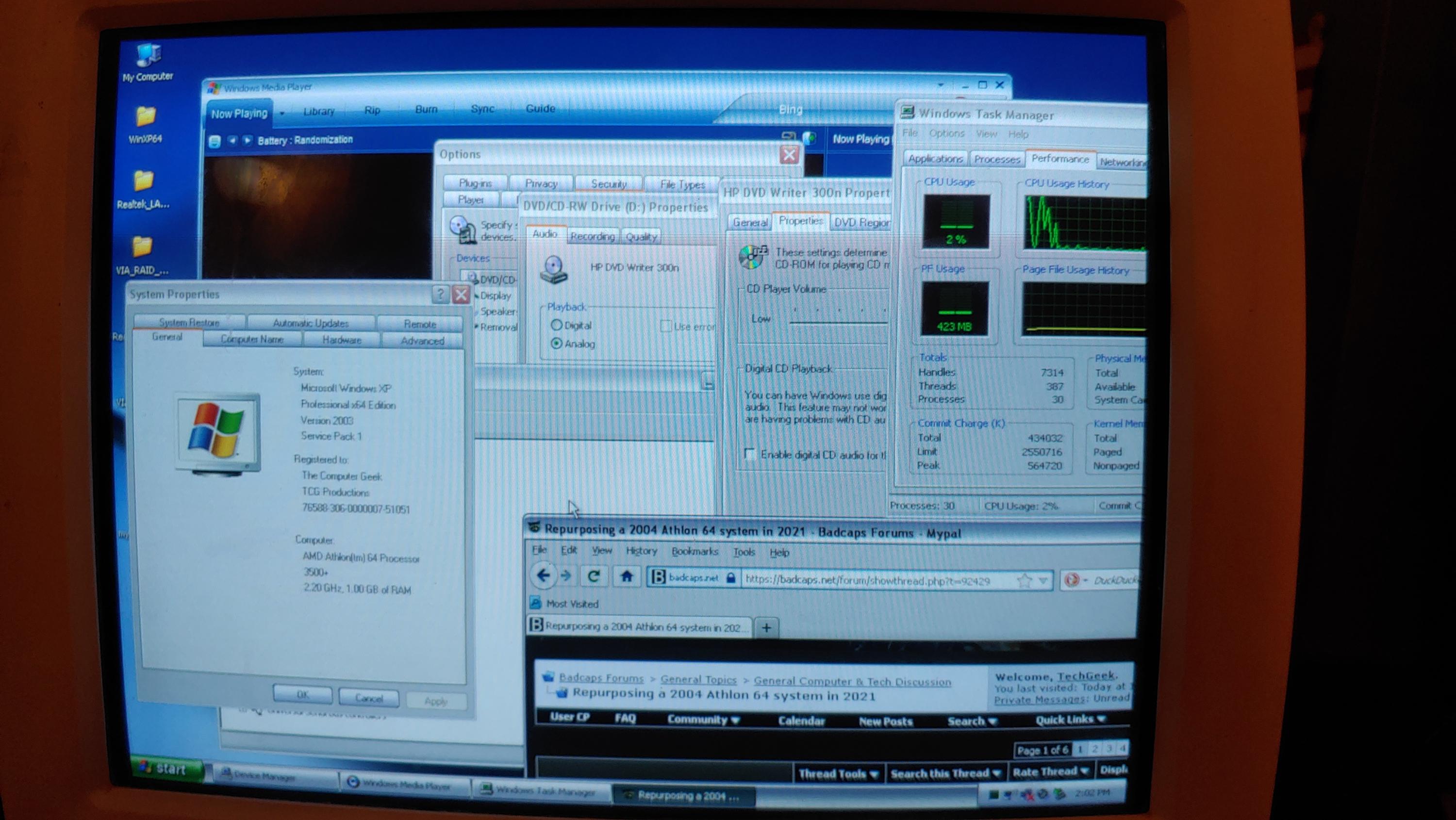

              Somehow, my previous post lost all of its pictures. Take 2...
              Setup complete!

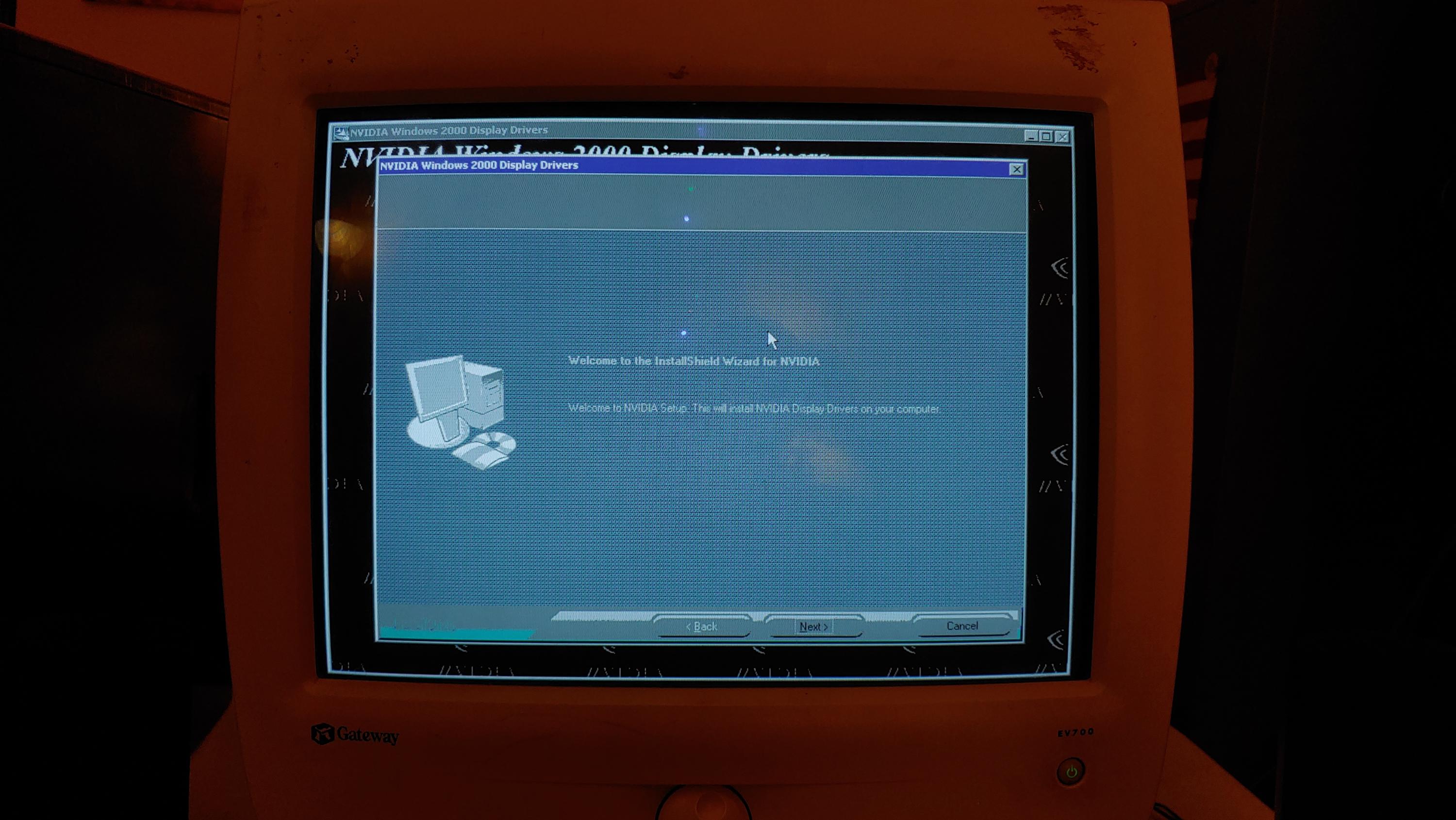

              Installing graphics drivers...
              ...and done.

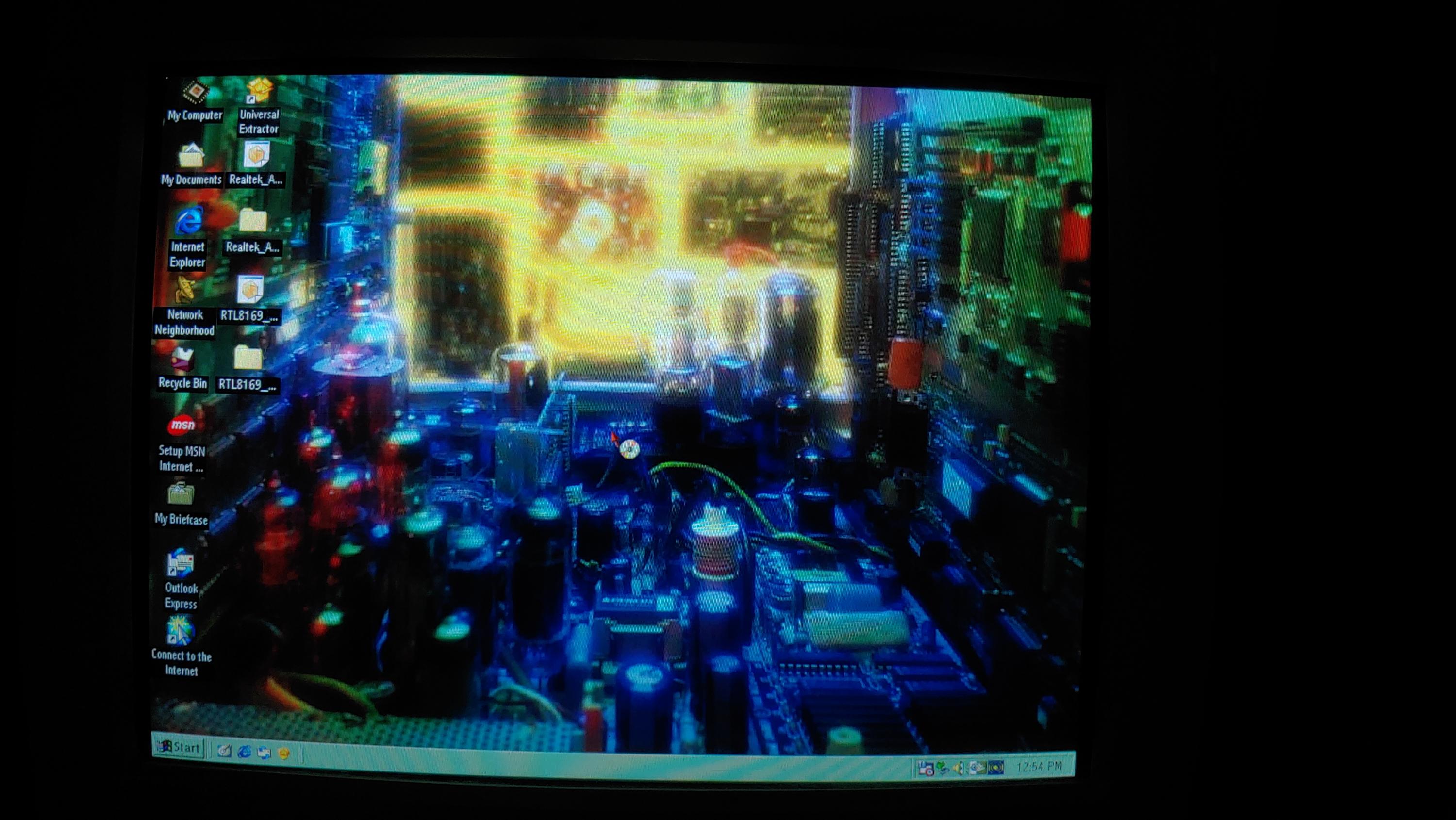

              Setting display resolution...
              ...to 1024x768 @ 85Hz.

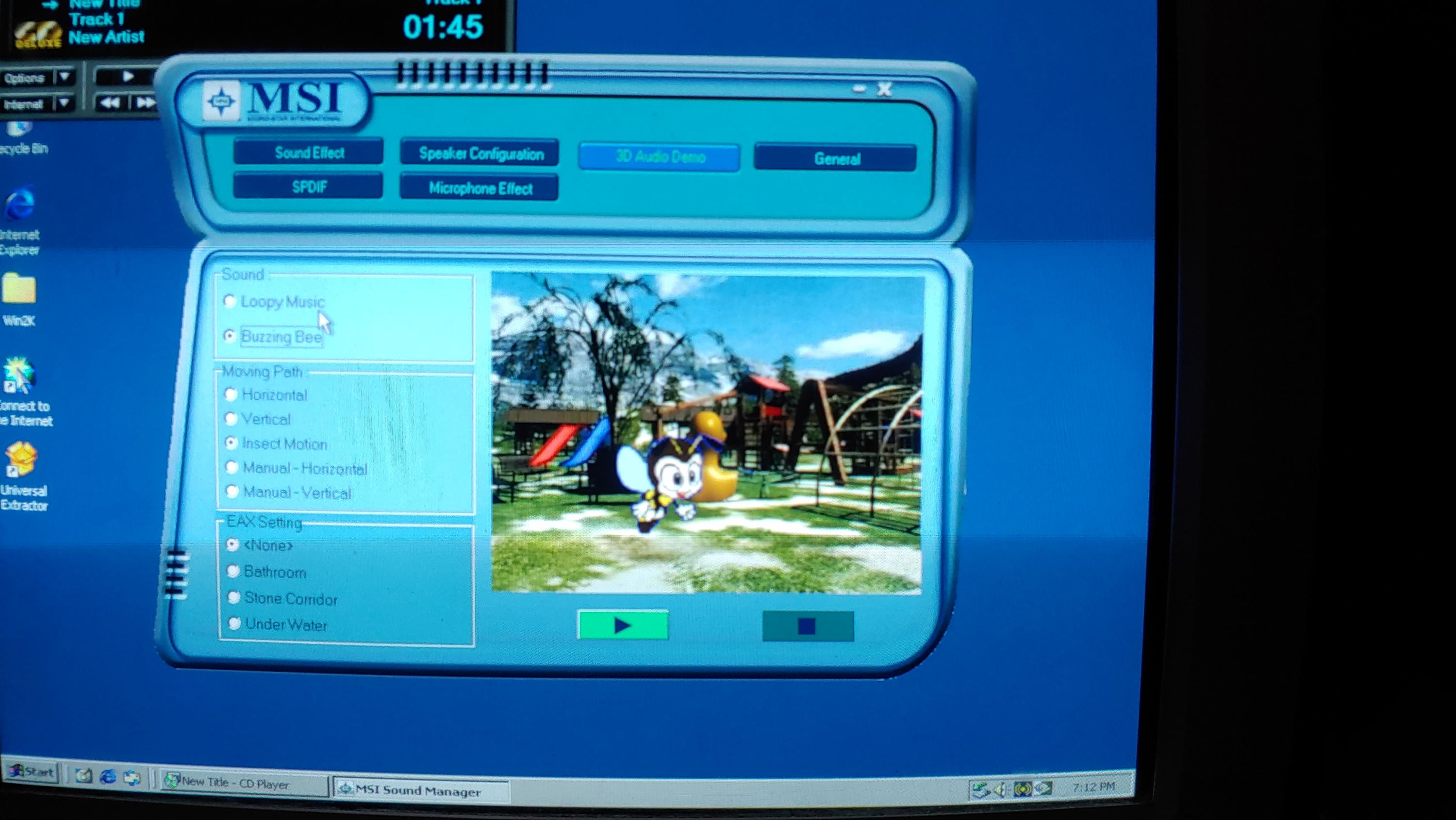

              Installing audio drivers...
              ...and done. That 4-pin audio cable is actually having analog audio routed over it instead of over the system's ATA bus. I've tried it both ways, and using a direct analog output always seems to work better and more reliably as compared to stuffing digital data down an already crammed ATA bus.
              About the system:
              Case shots:

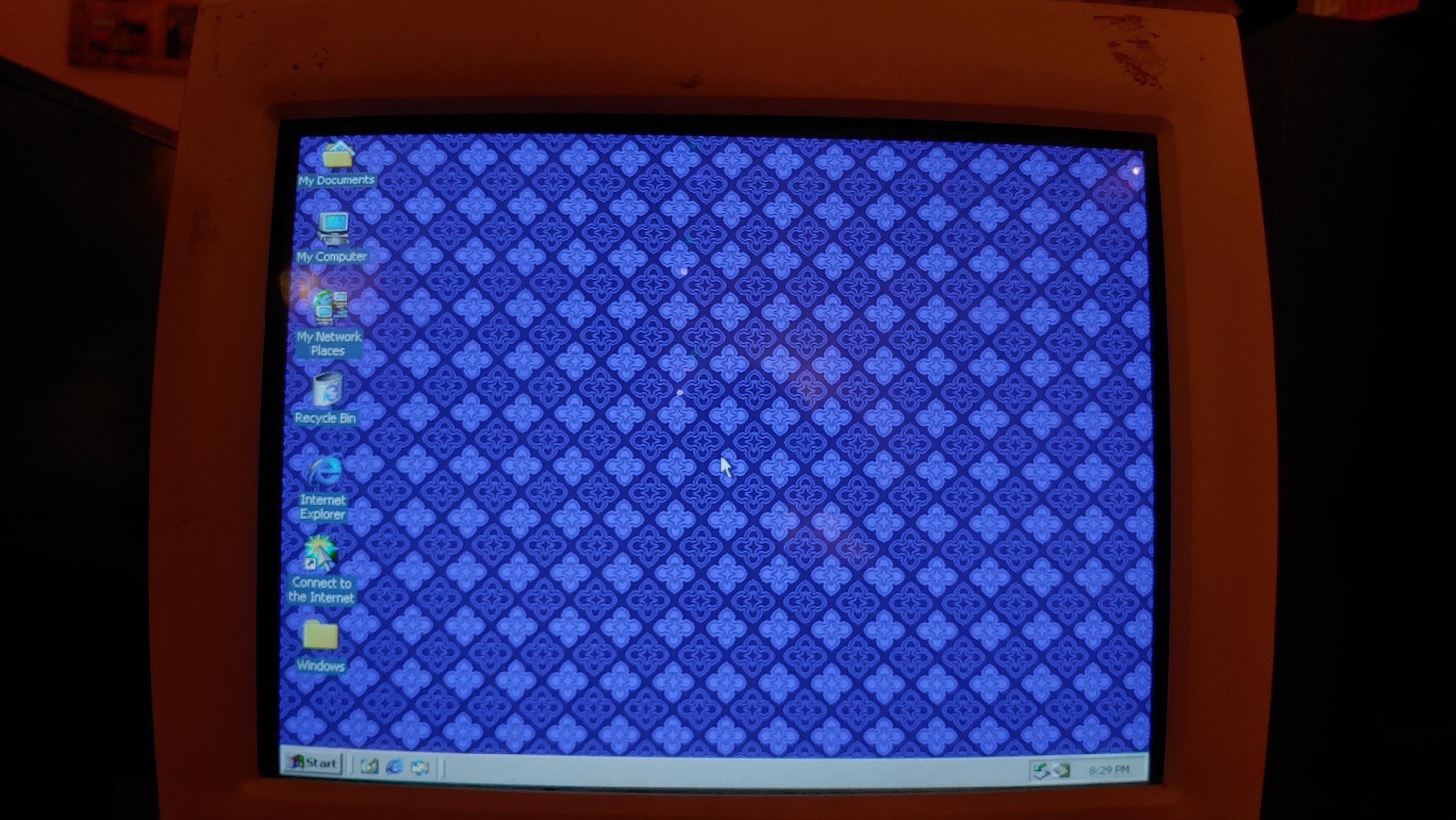

              Some more customization later...

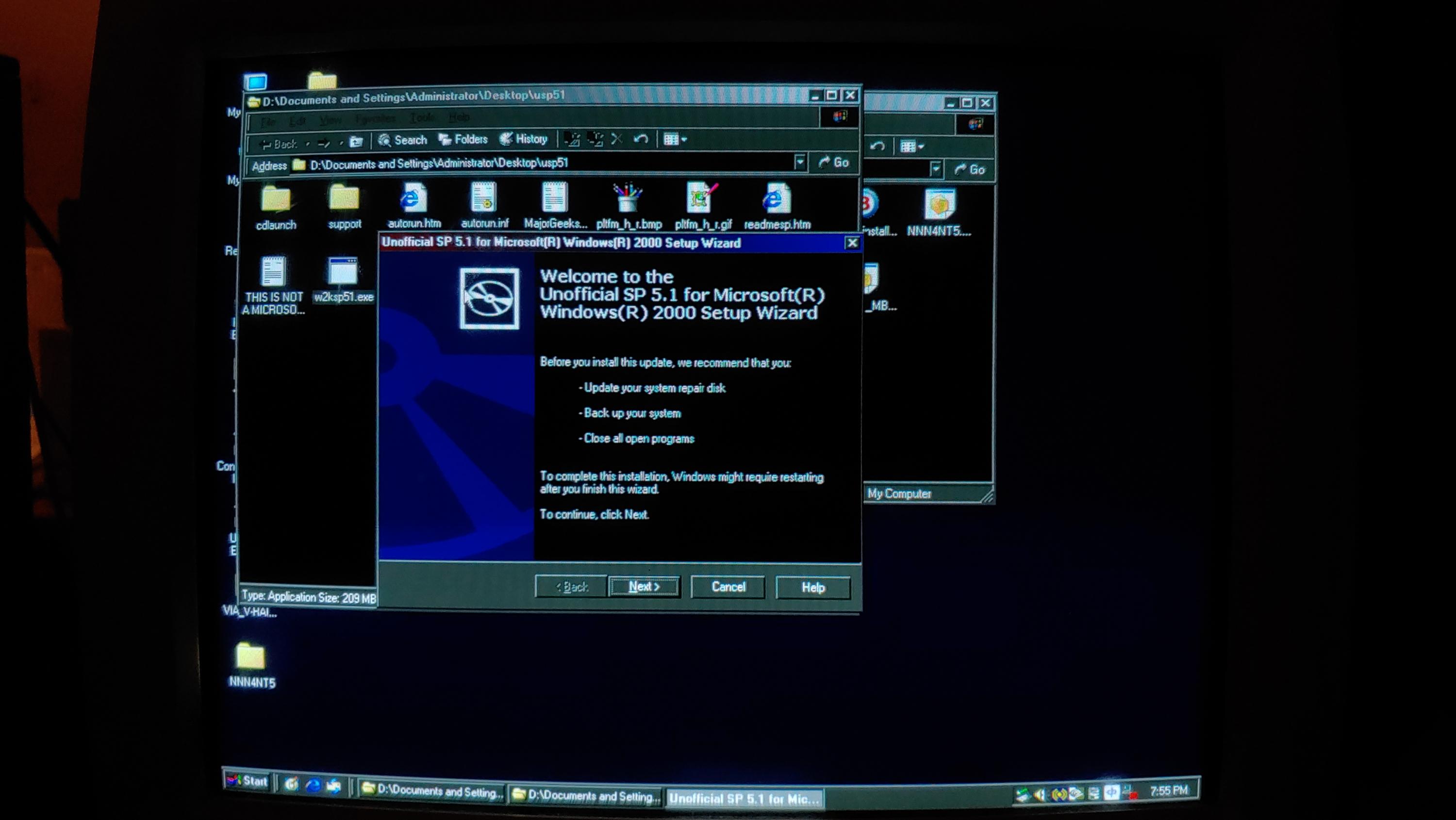

              Preparing to install the unofficial Service Pack 5.1...
              Installing...
              ...and done.

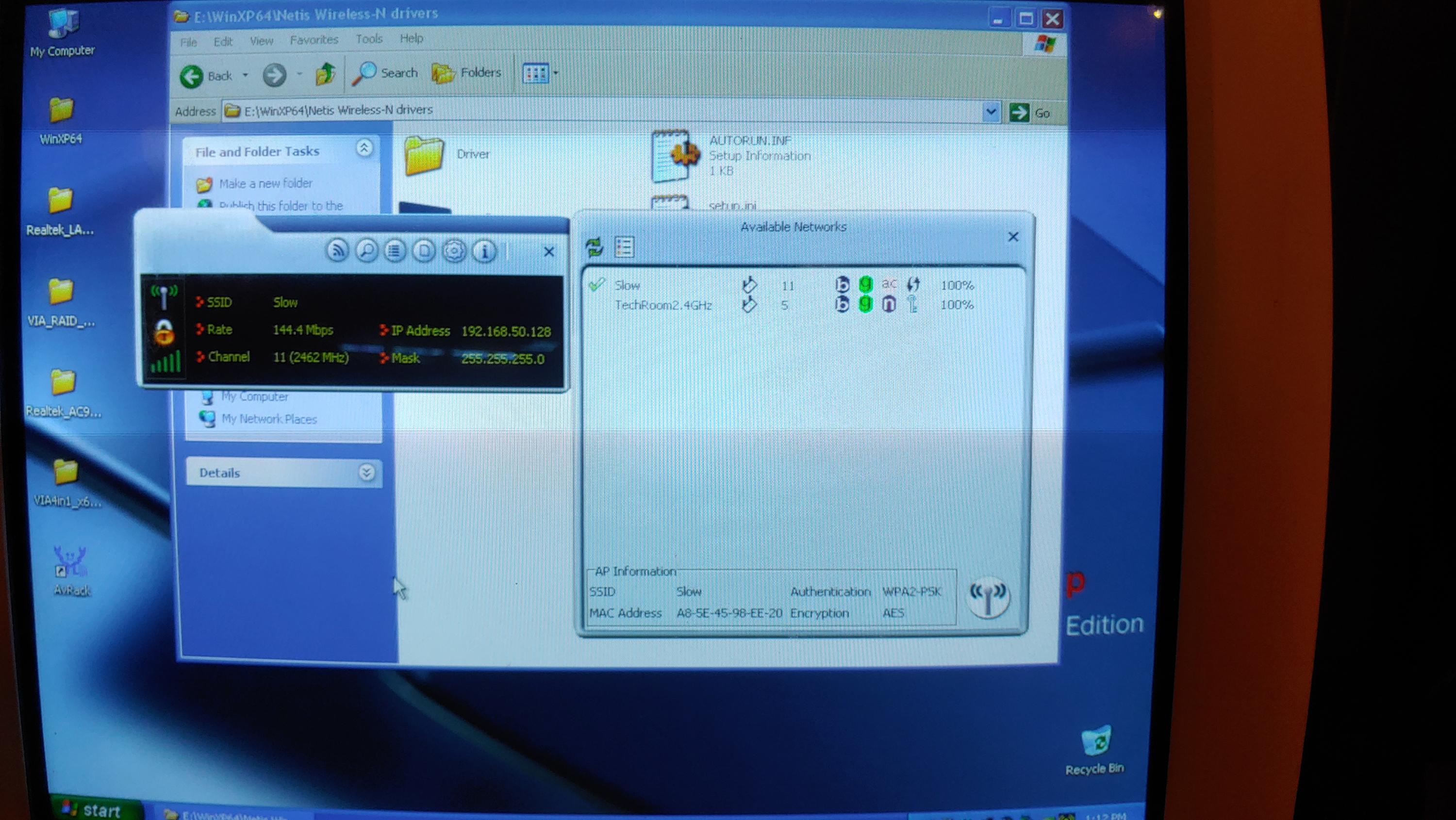

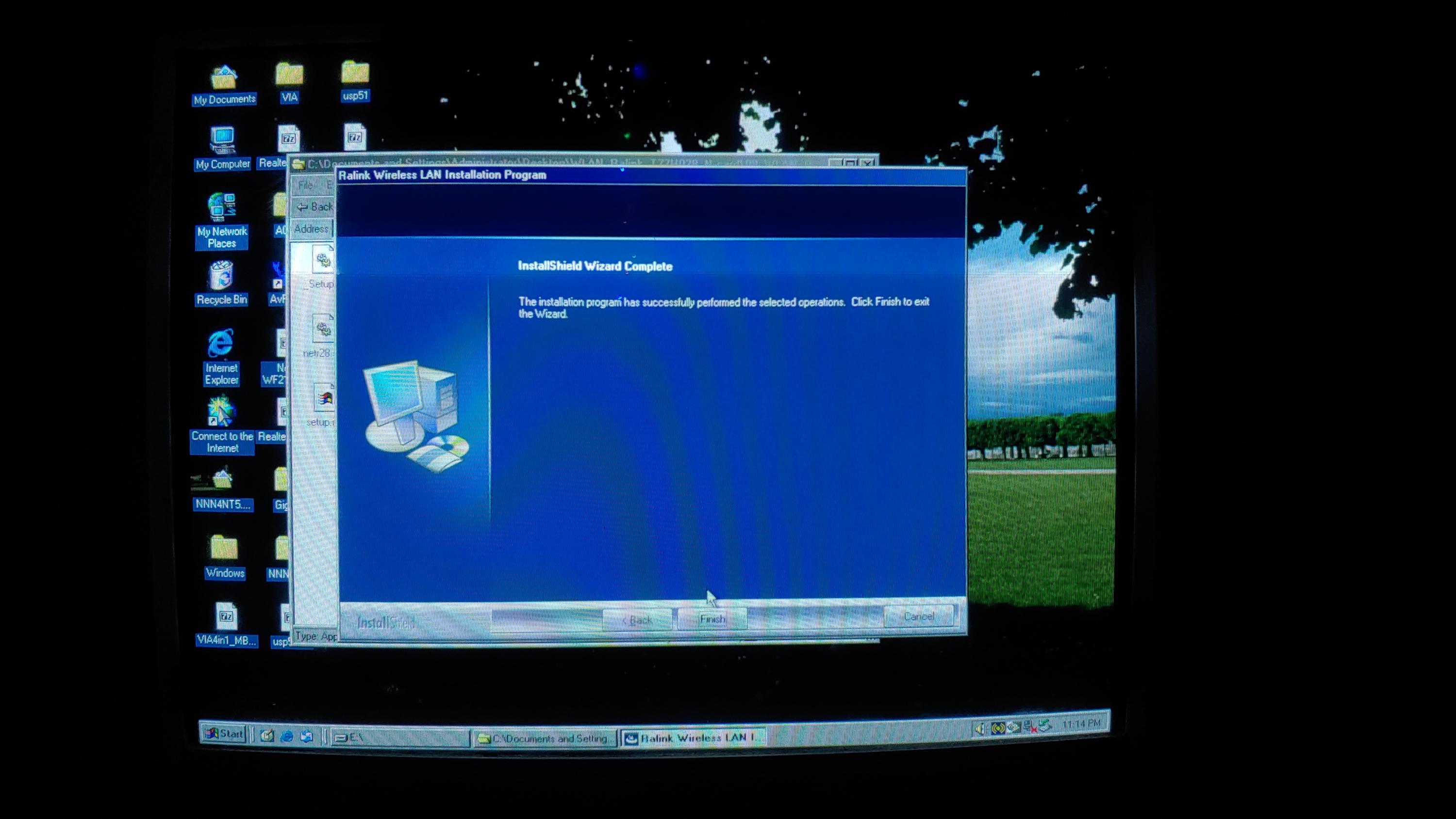

              I couldn't find any Windows-2000 compatible drivers for the wireless card, so I ended up disabling it in the Device Manager.
              More coming soon. (And hopefully with pictures!)

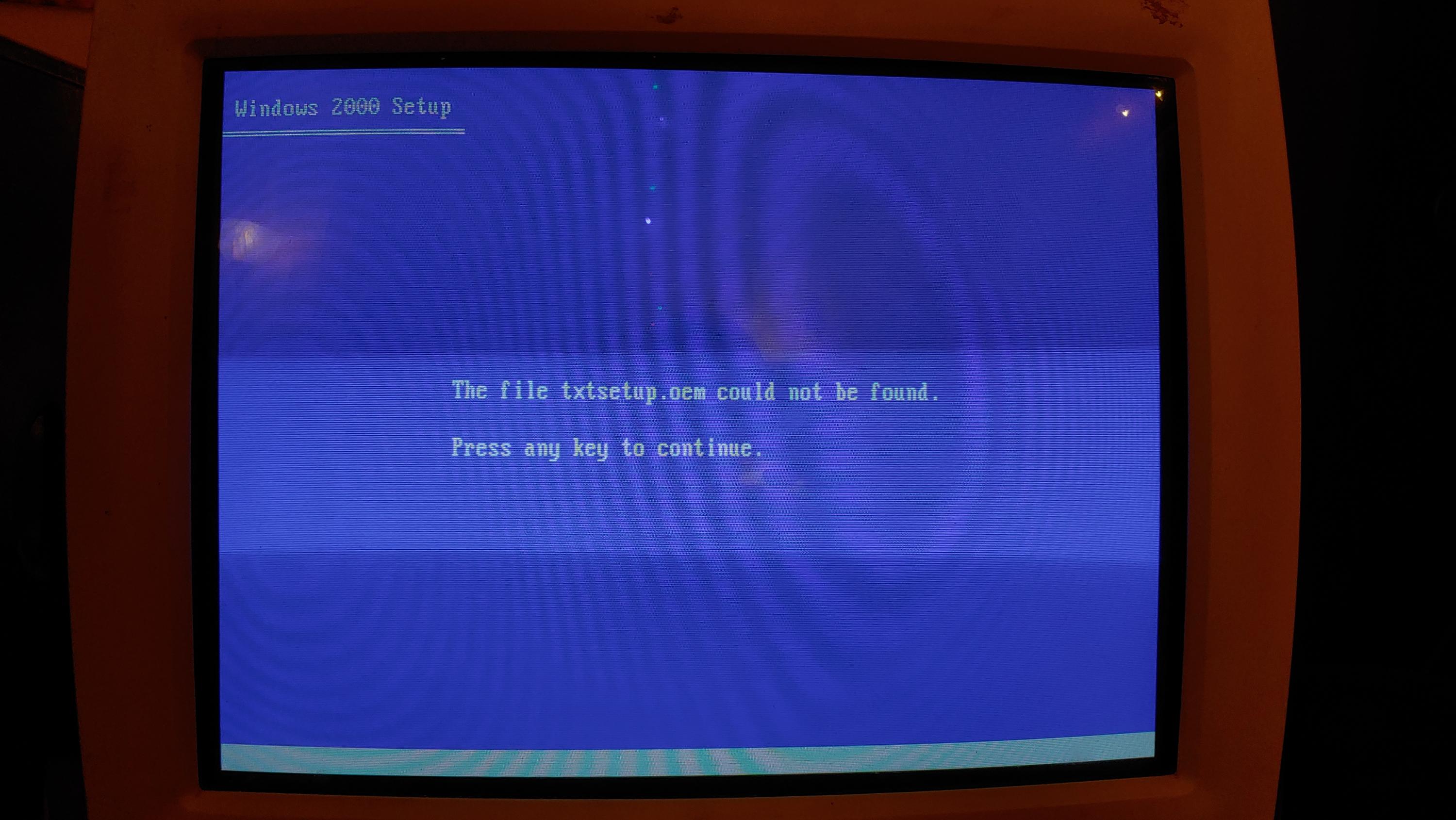

                Re: Repurposing a 2004 Athlon 64 system in 2021

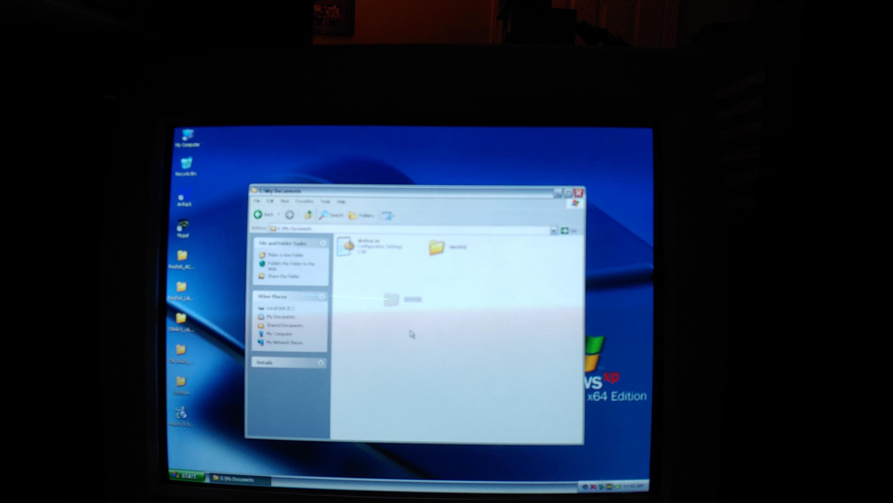

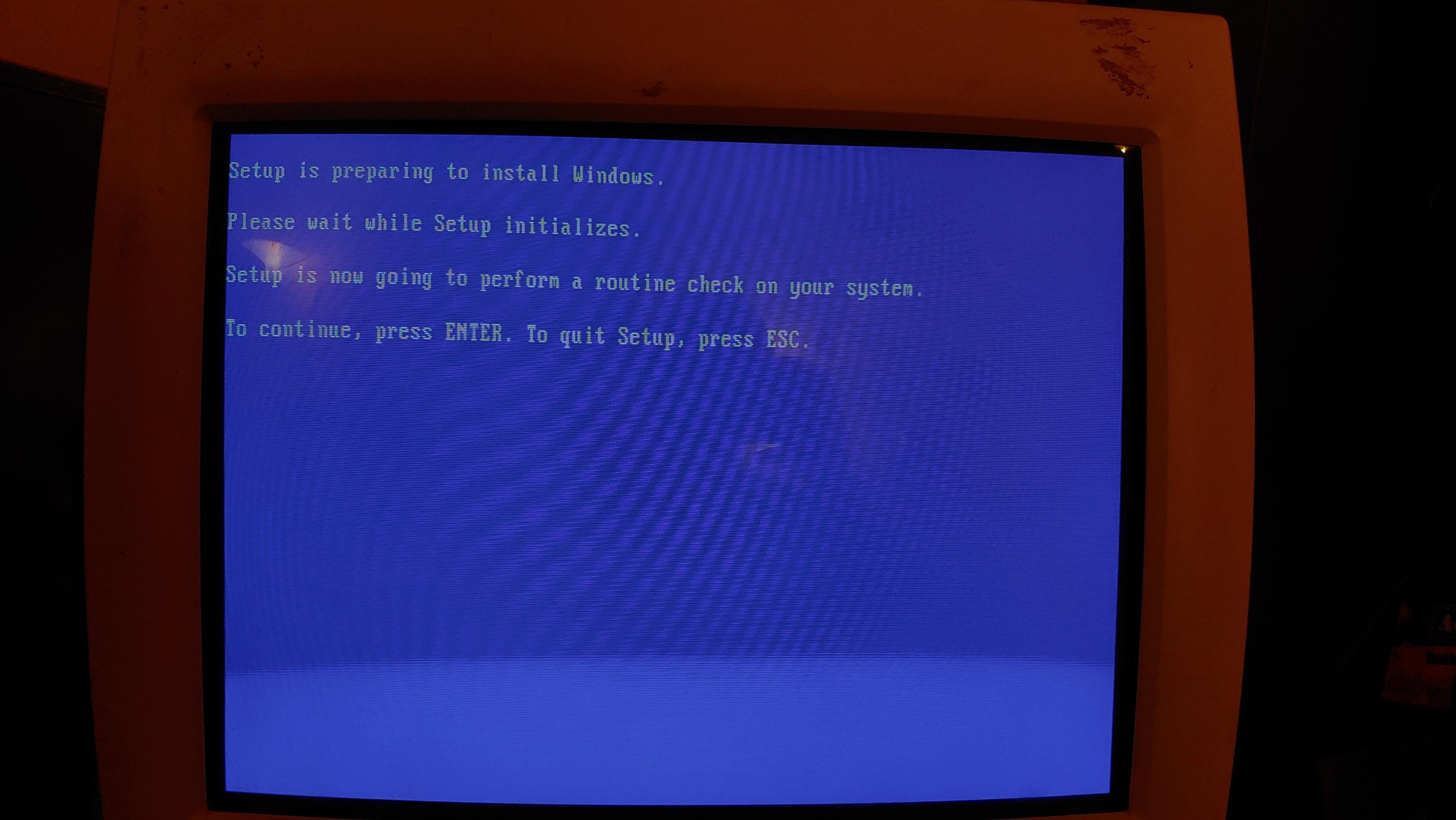

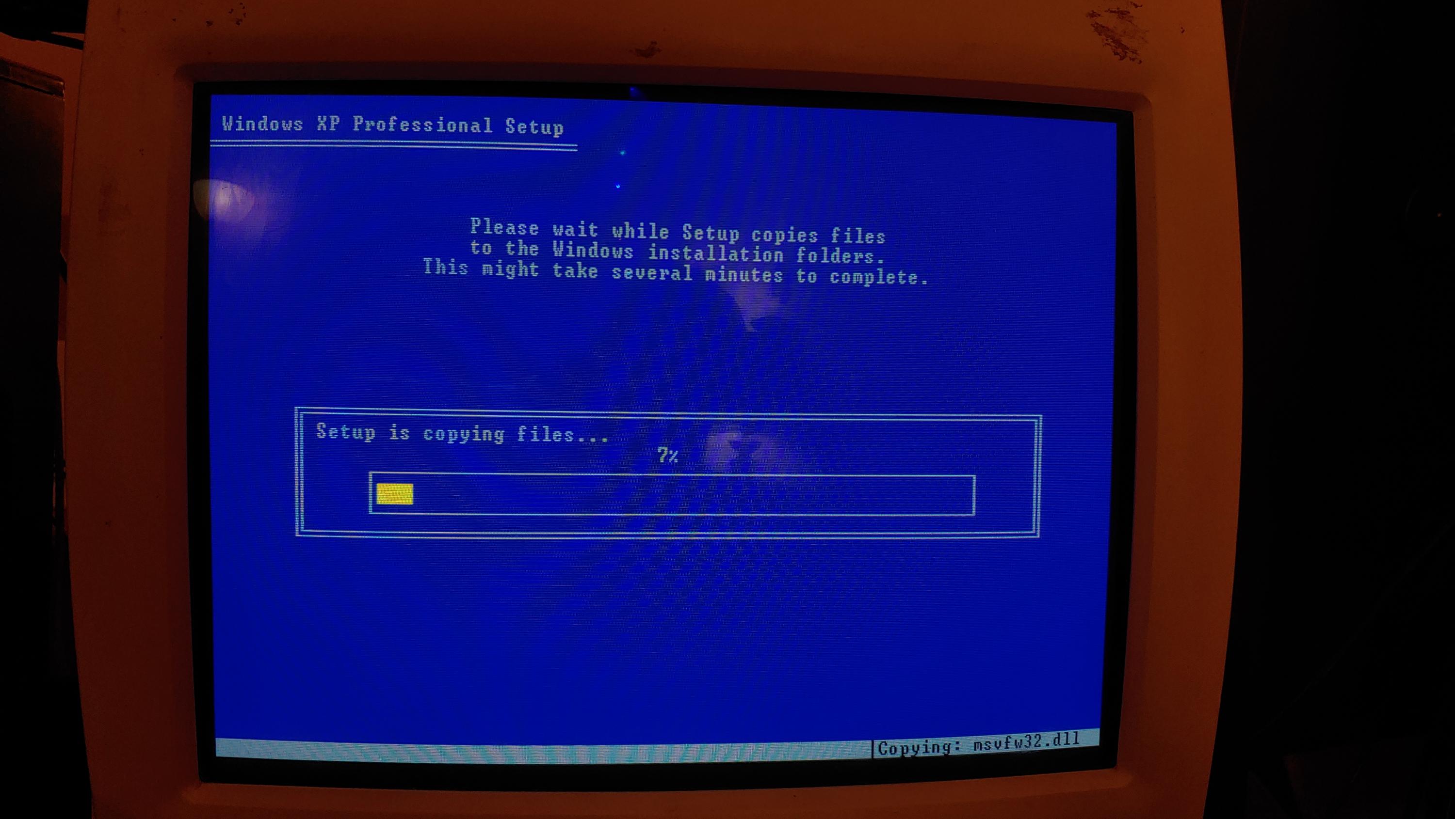

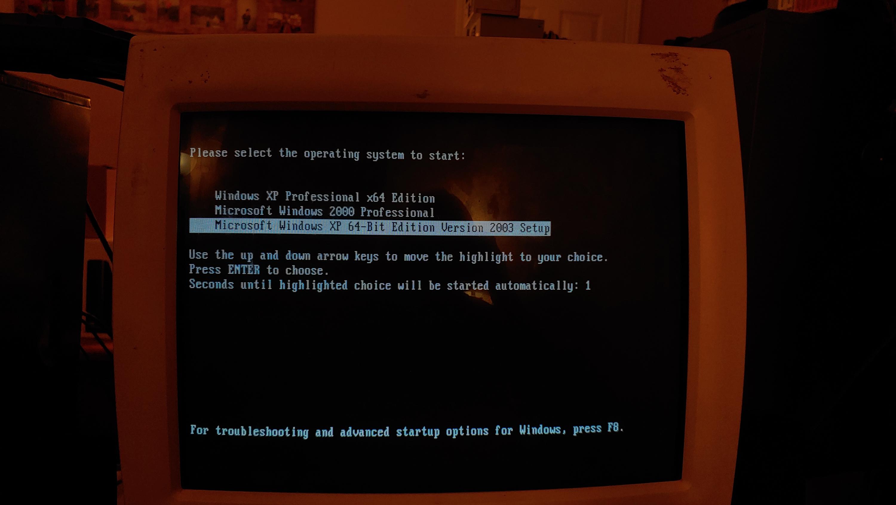

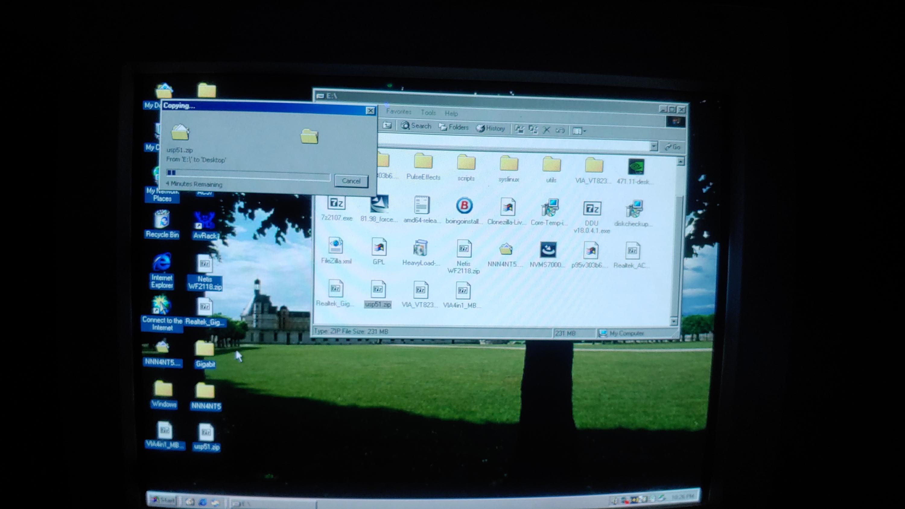

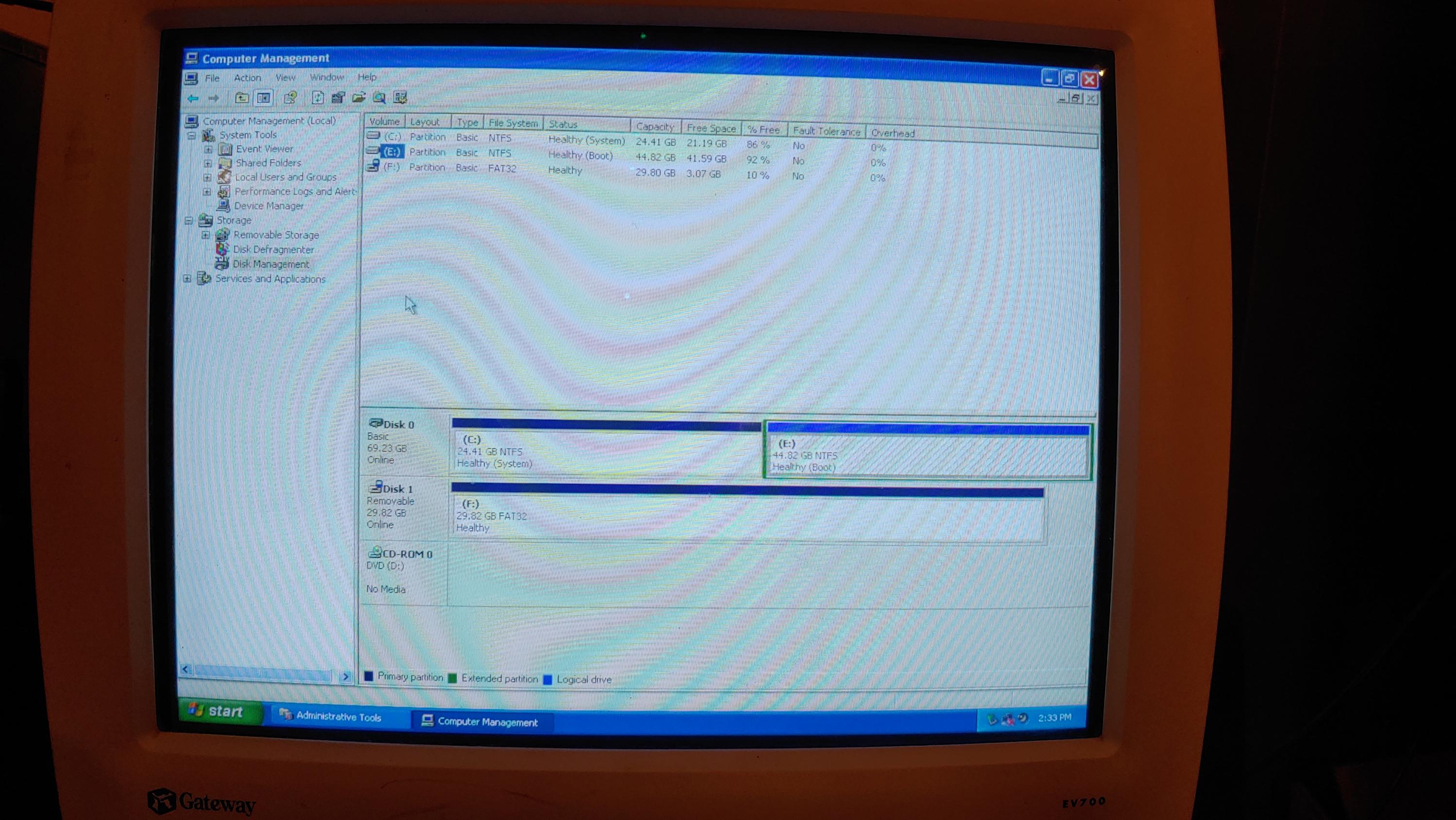

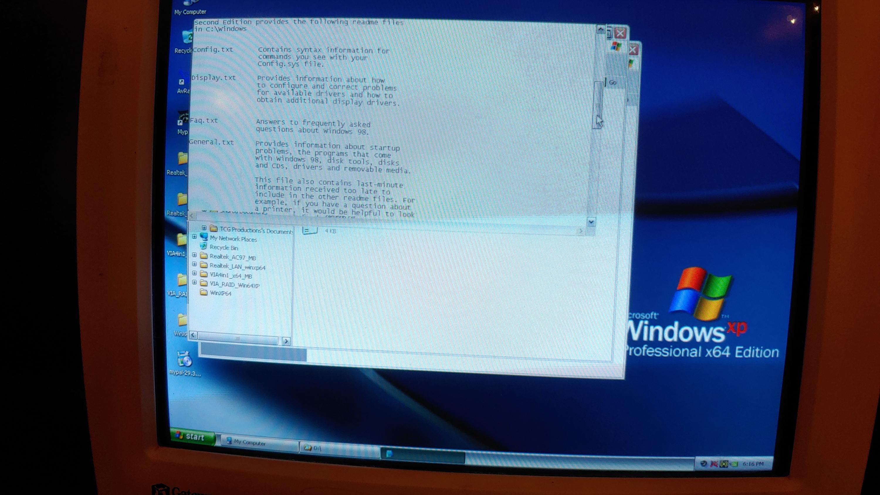

                Been rather busy with the system the past few days, so I've got more than a little bit of a backlog of pictures to clear out. Here we gooooooo... *crash*

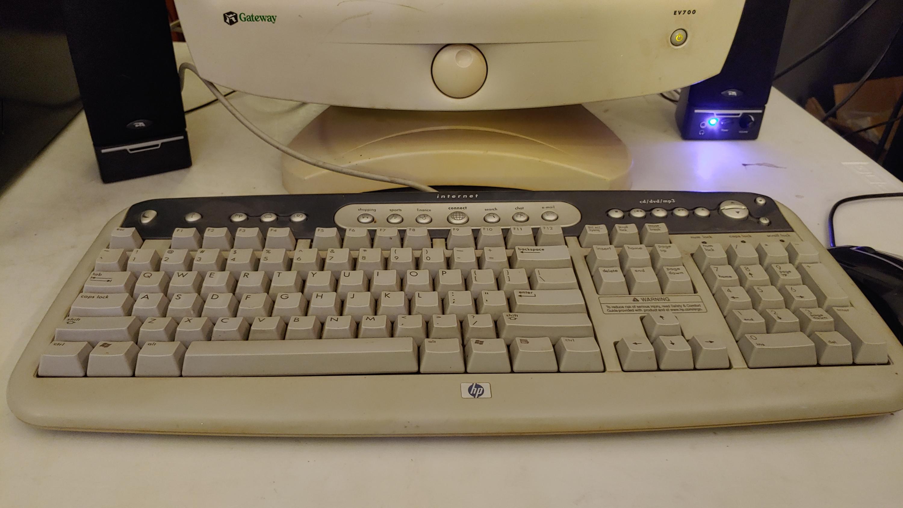

                Had to switch to a PS/2 keyboard due to emulation problems with USB keyboards.

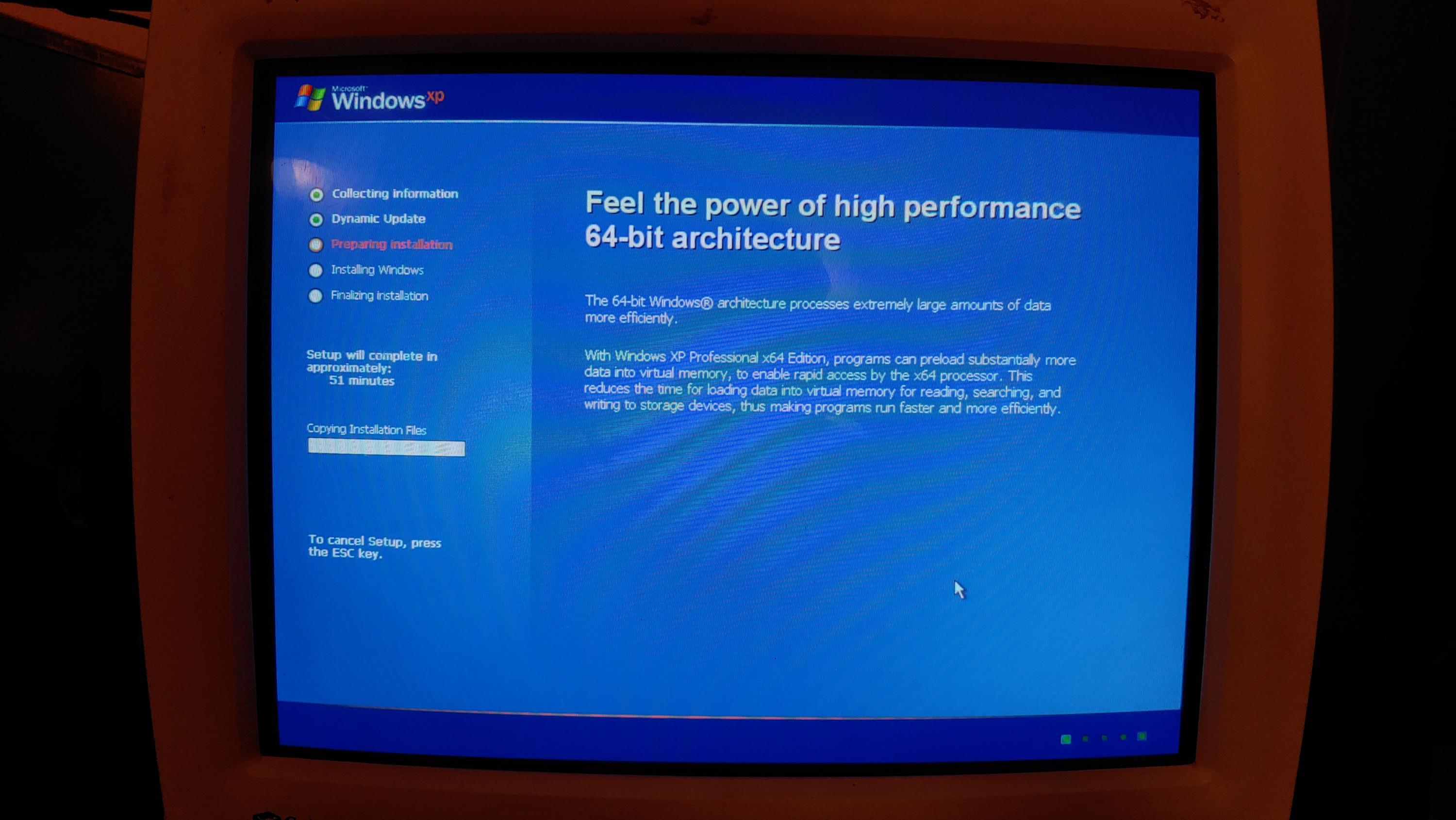

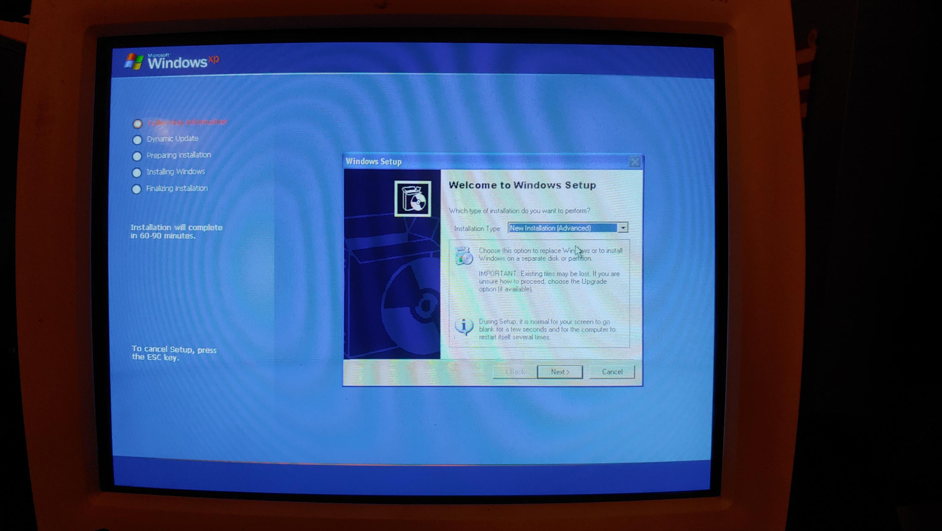

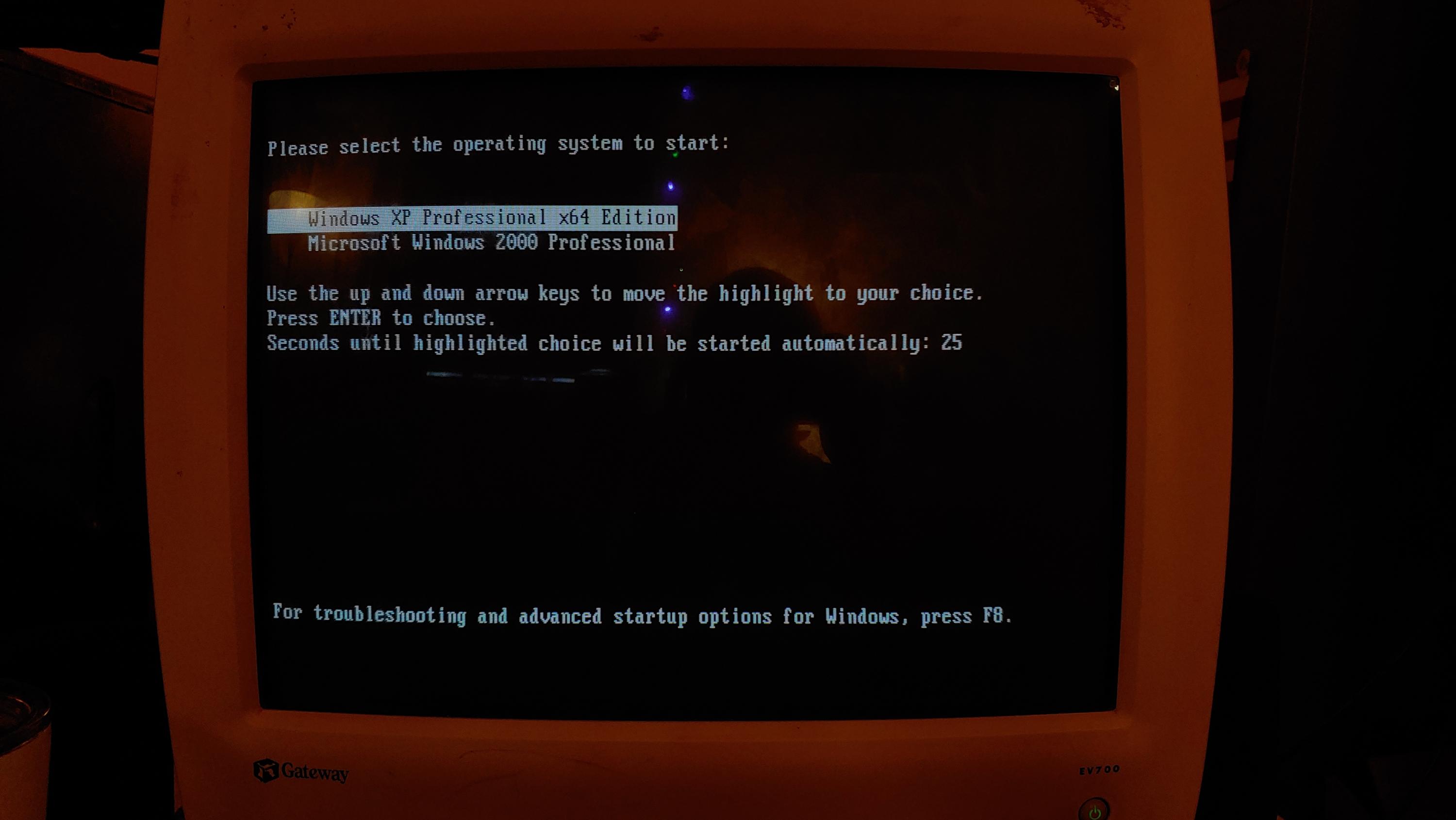

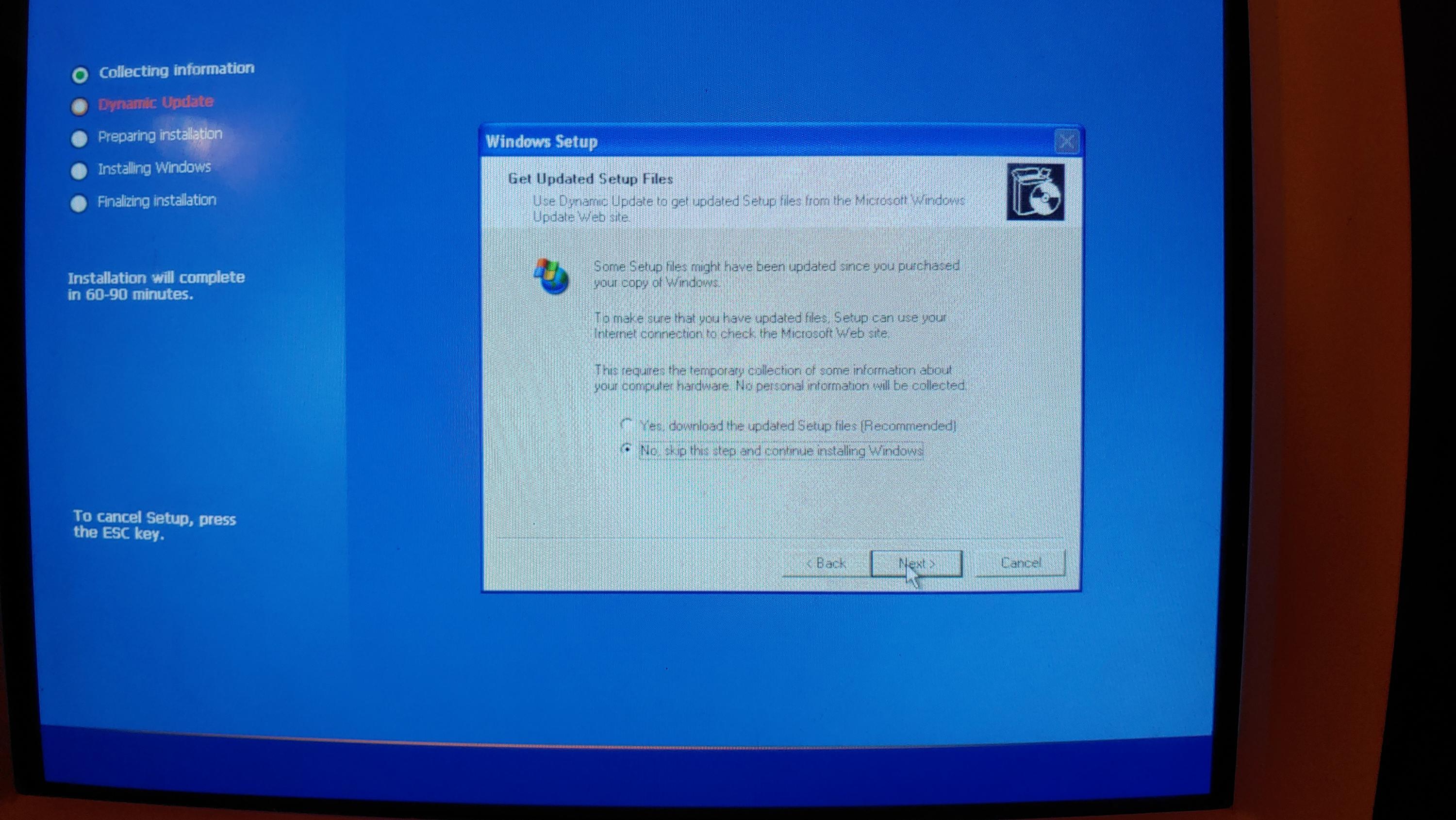

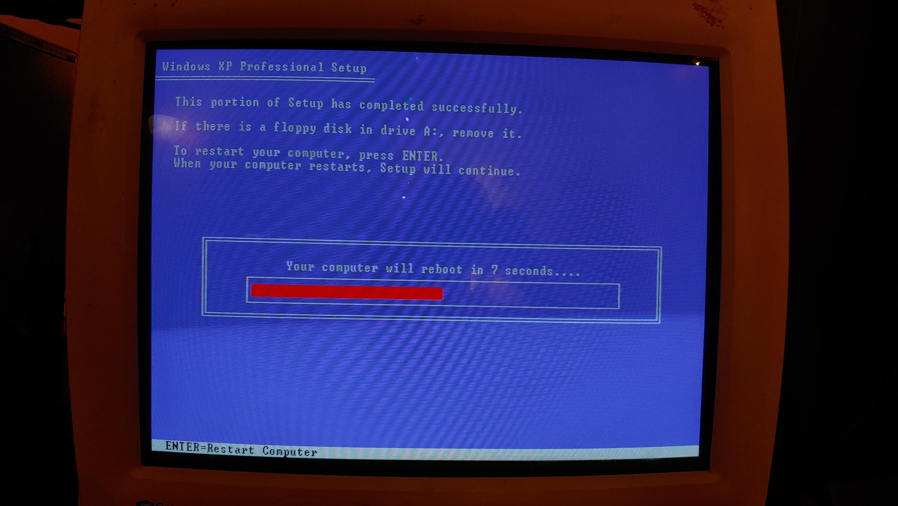

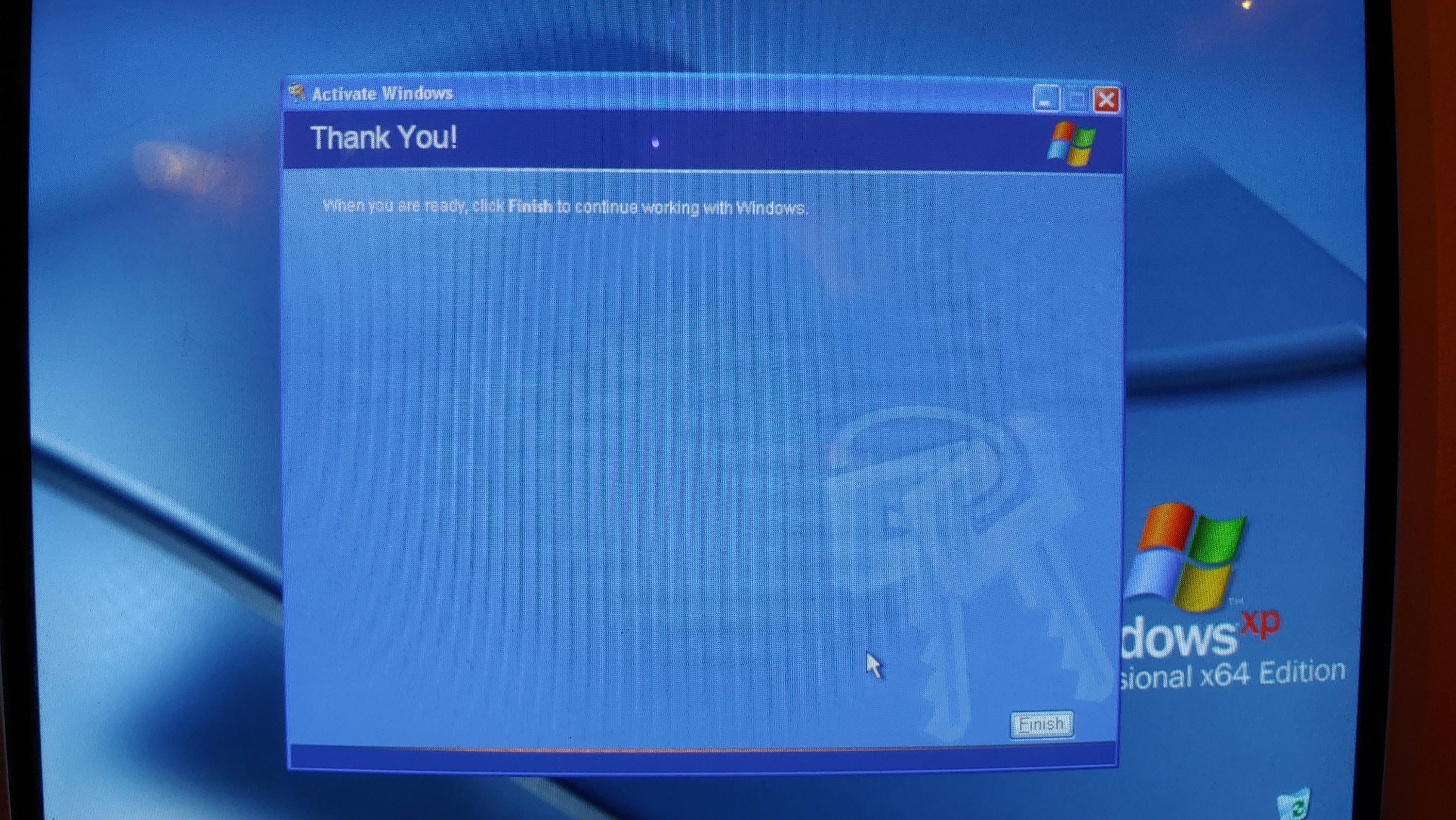

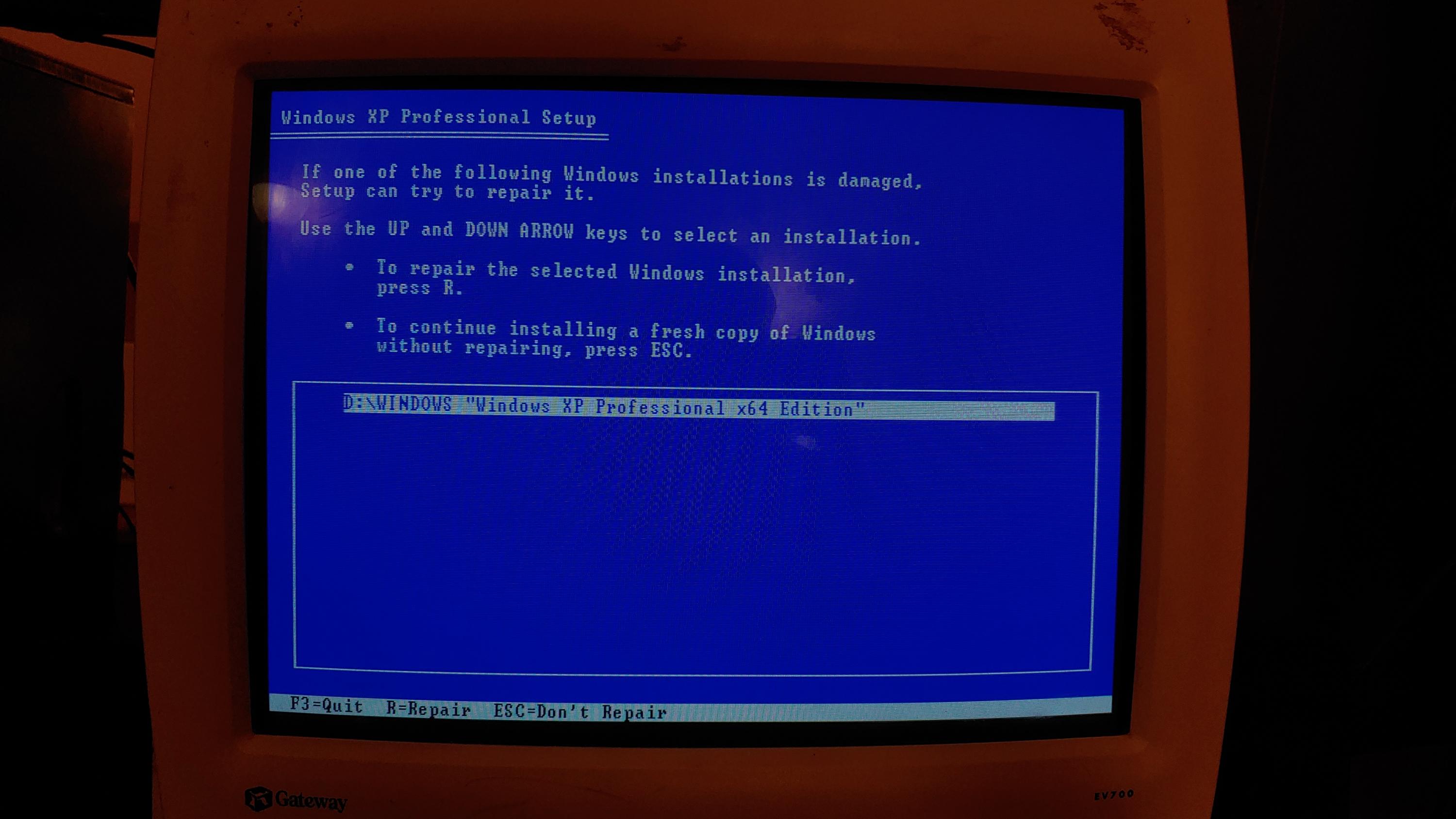

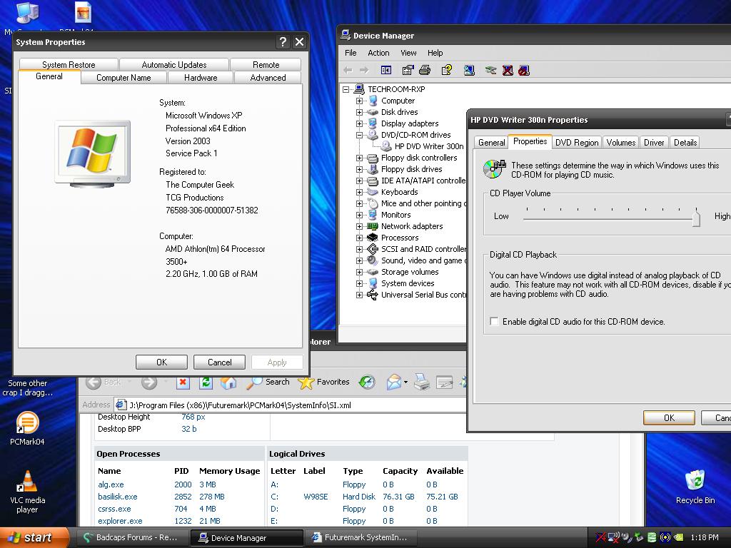

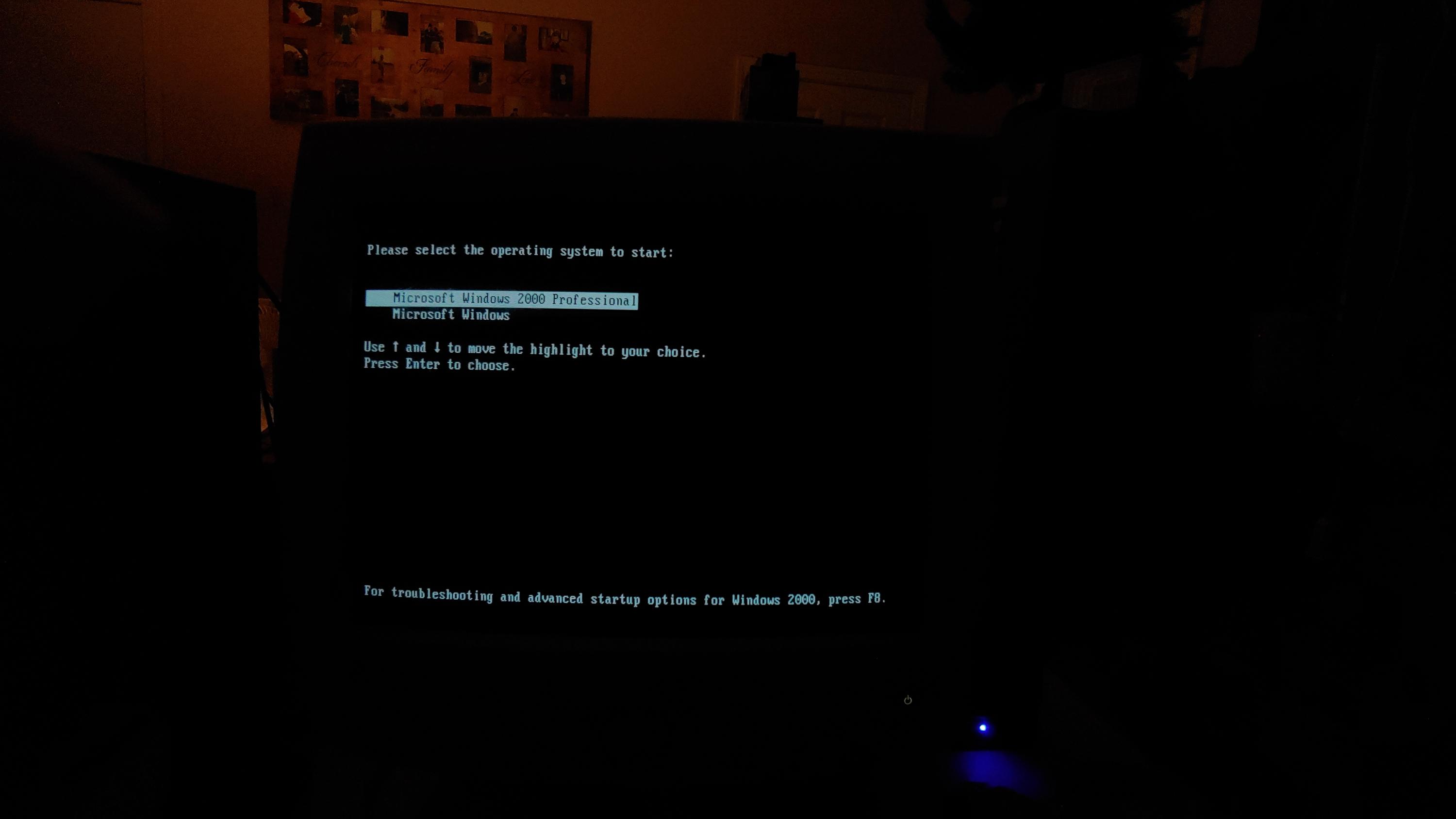

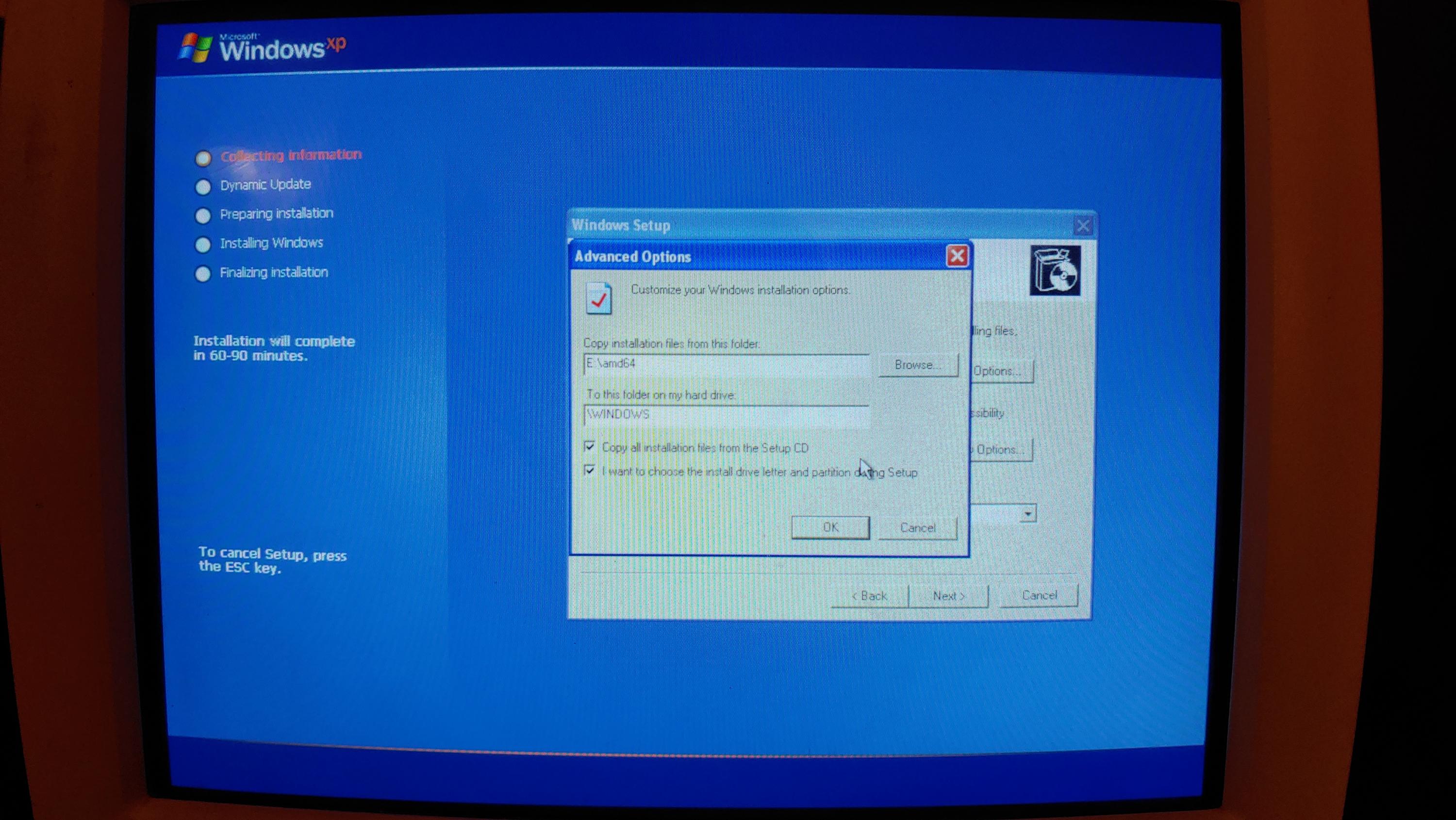

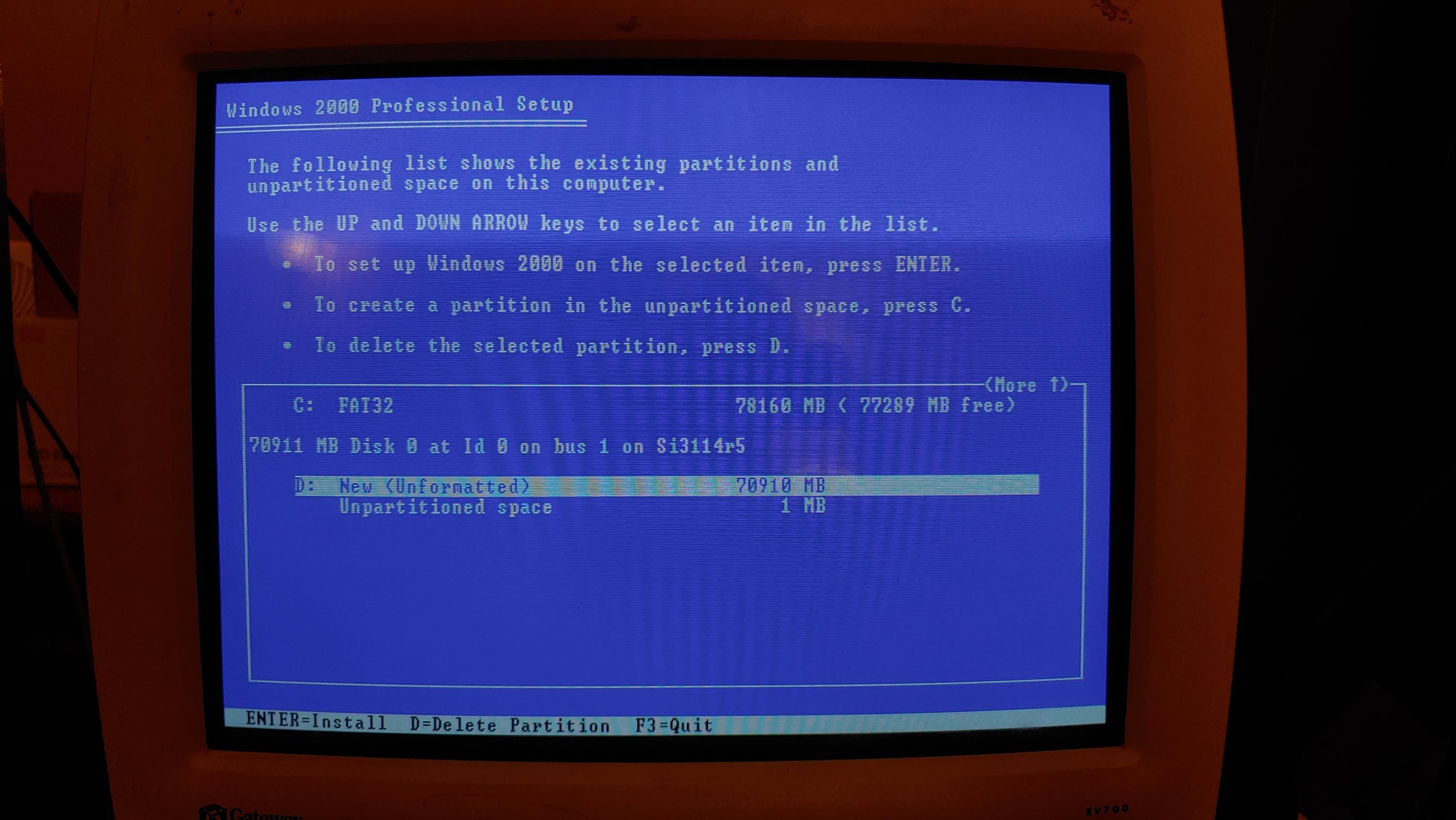

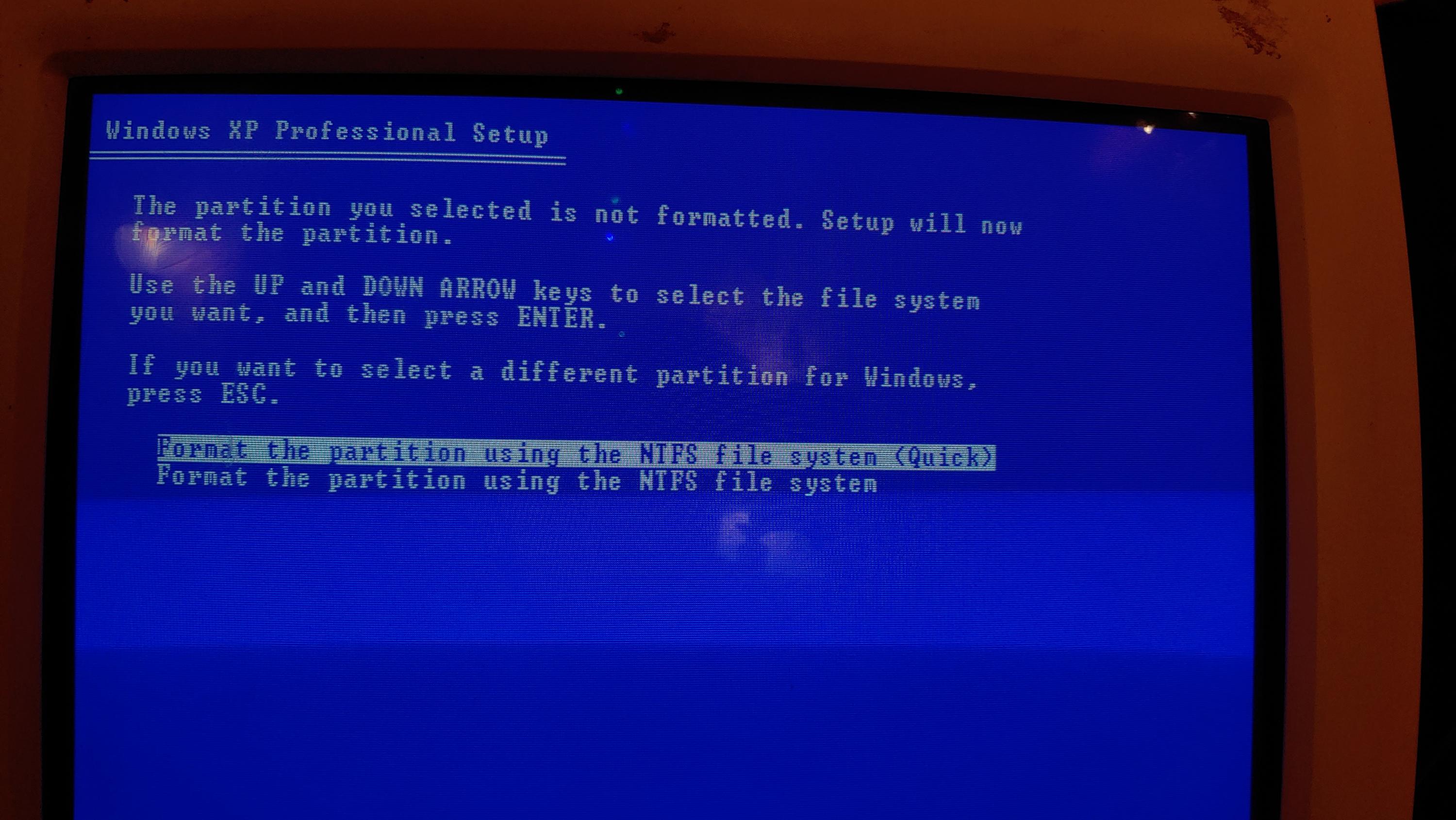

                Testbedding Windows XP x64. Yes I wiped out my Windows 2000 installation, but we'll put that back in place later.
                Installation...

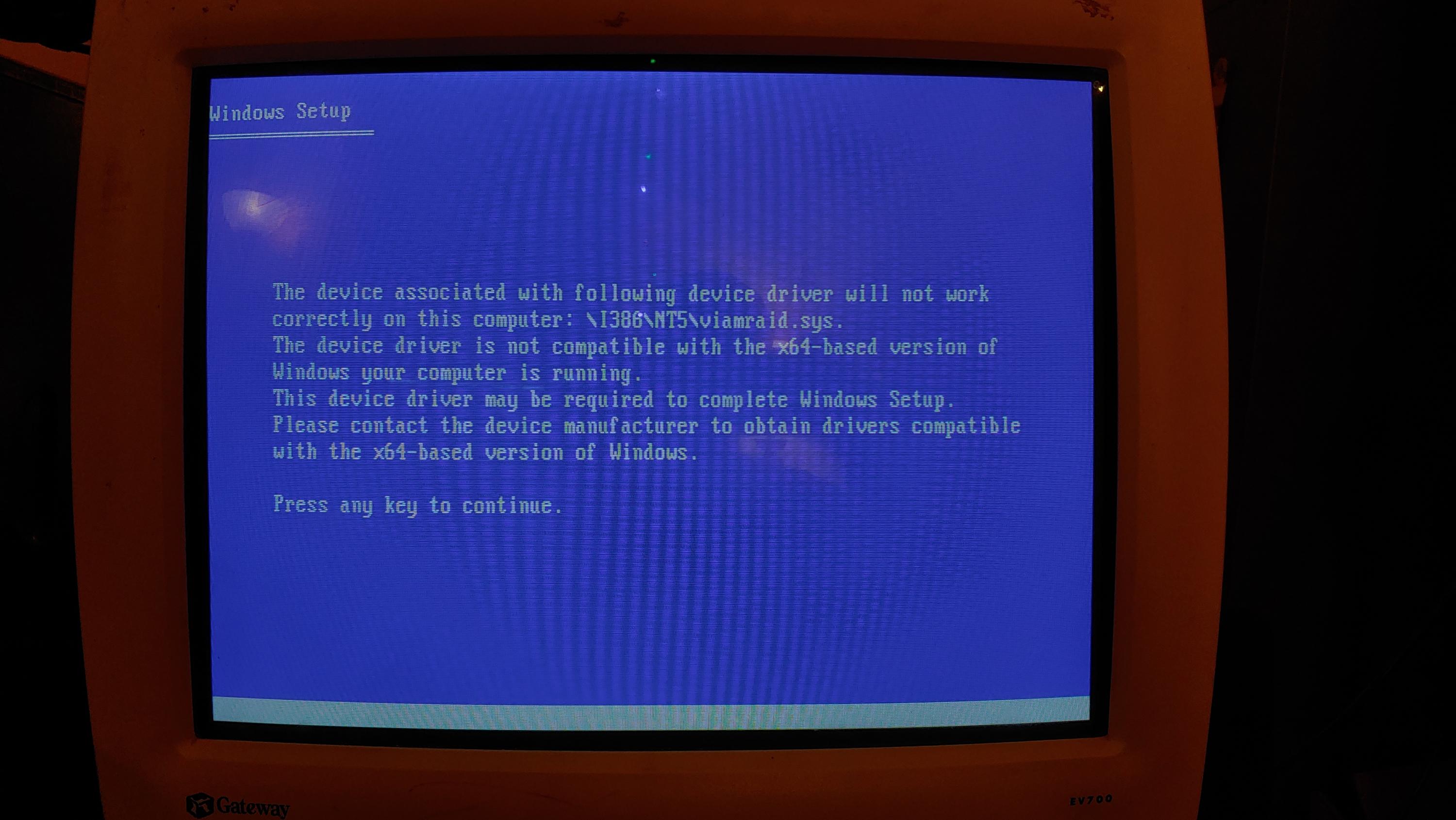

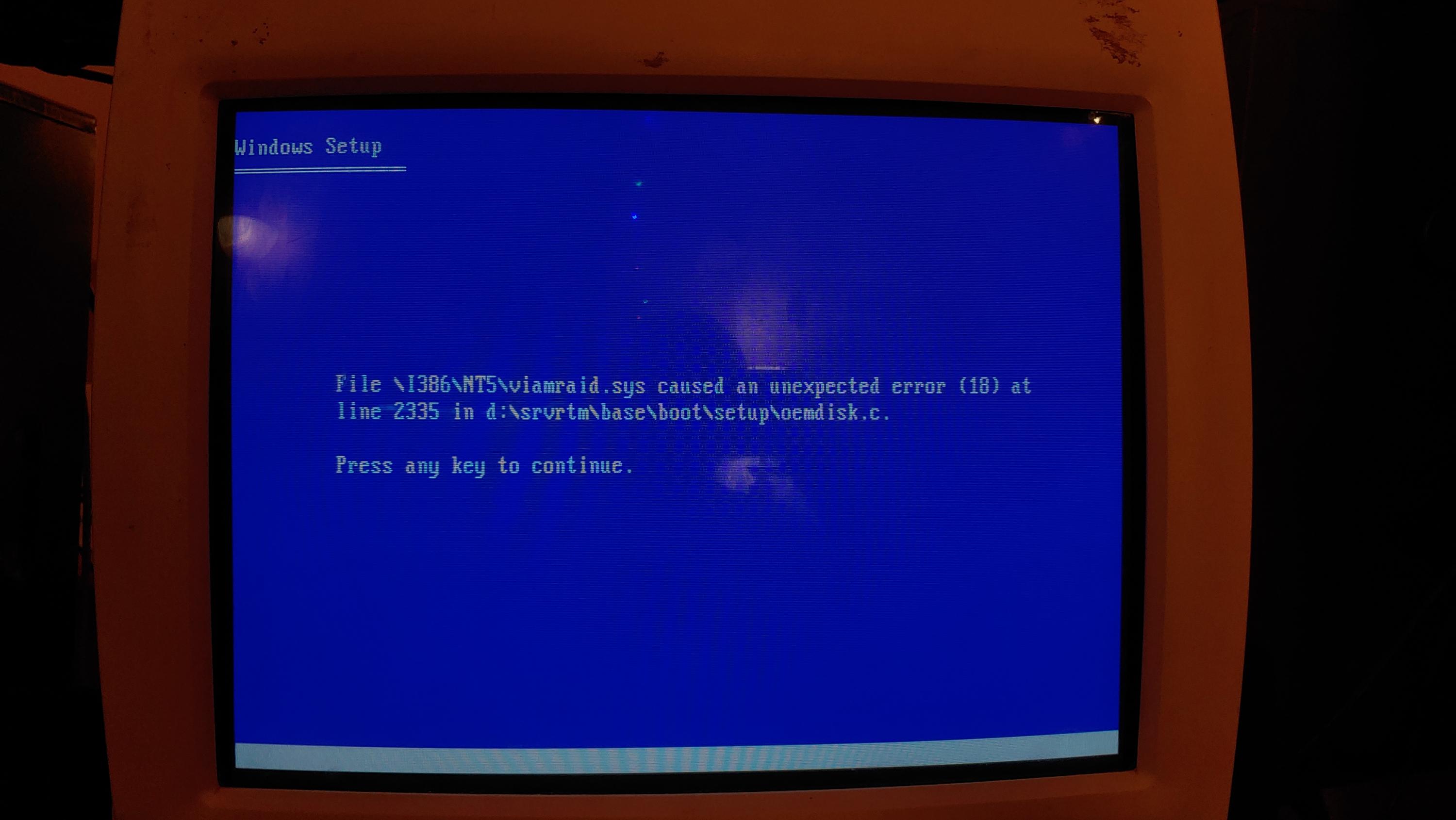

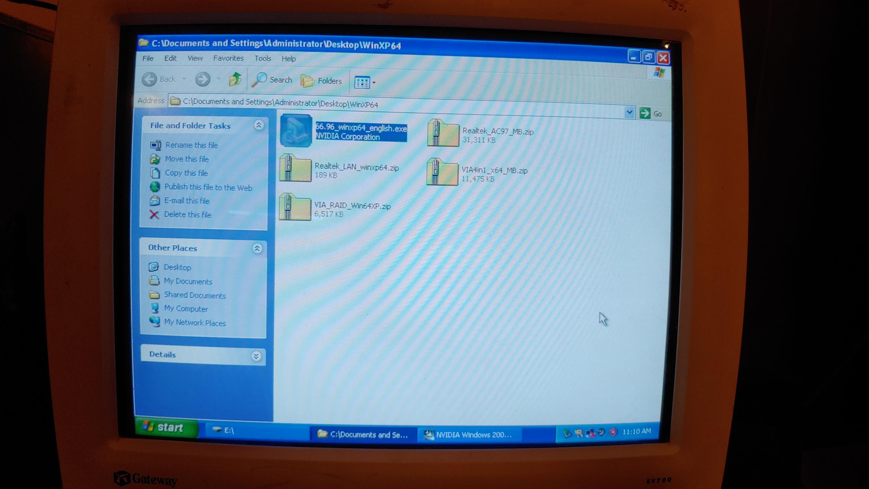

                First set of issues I ran into: x86/x64 drivers incompatibility.
                Solved.
                About to enter the graphical setup phase...
                ...and installation complete.
                Booting...

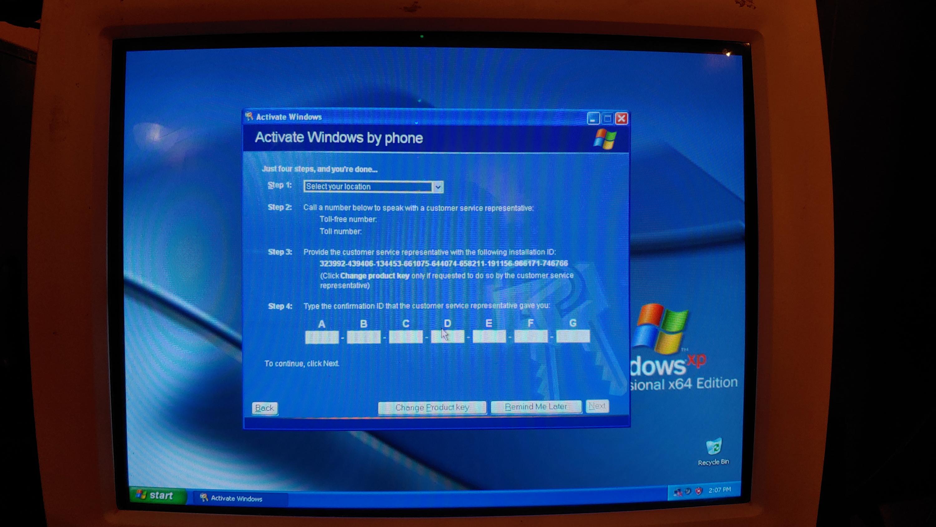

                Time for this stupid song-and-dance:
                Done.

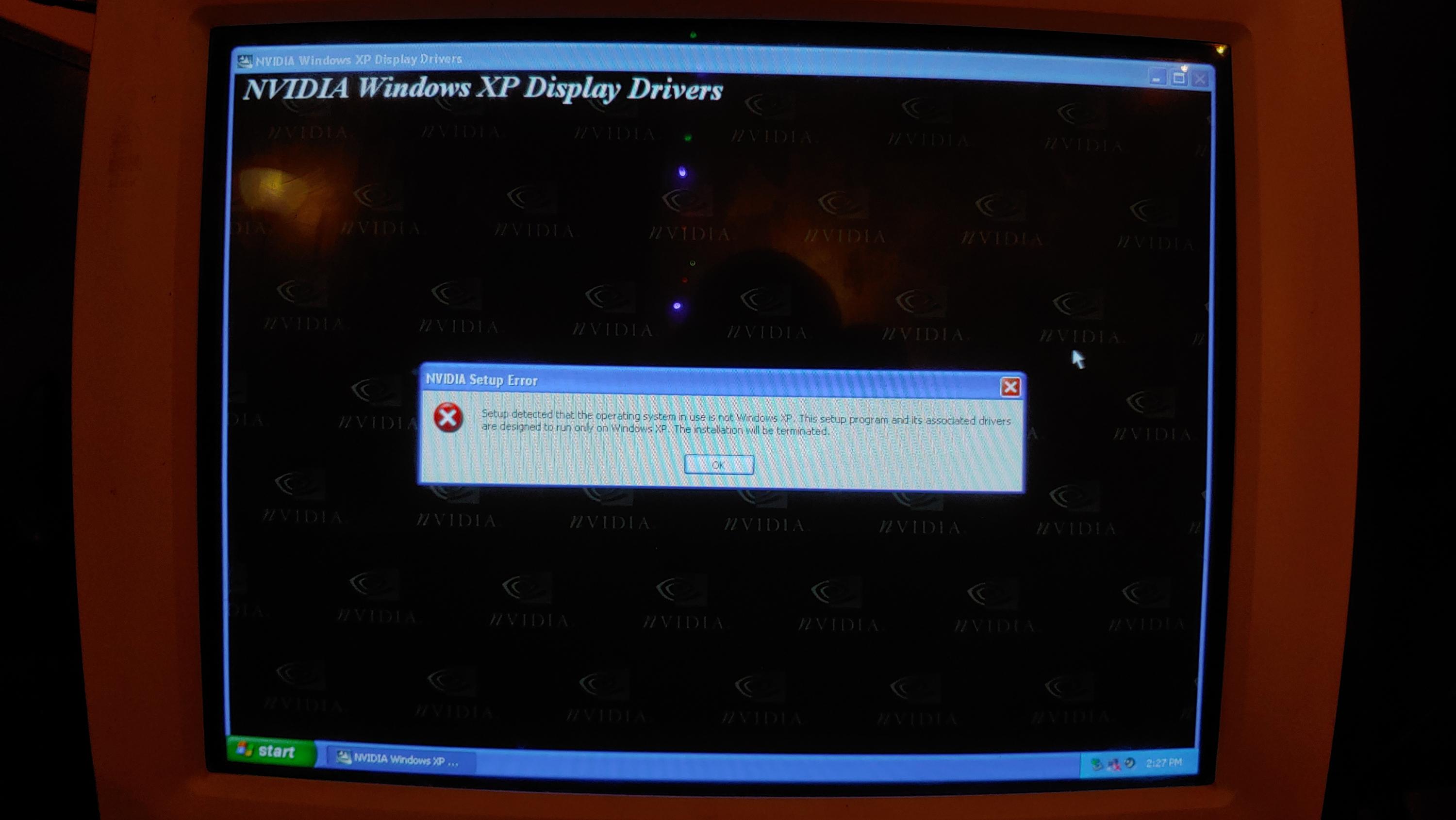

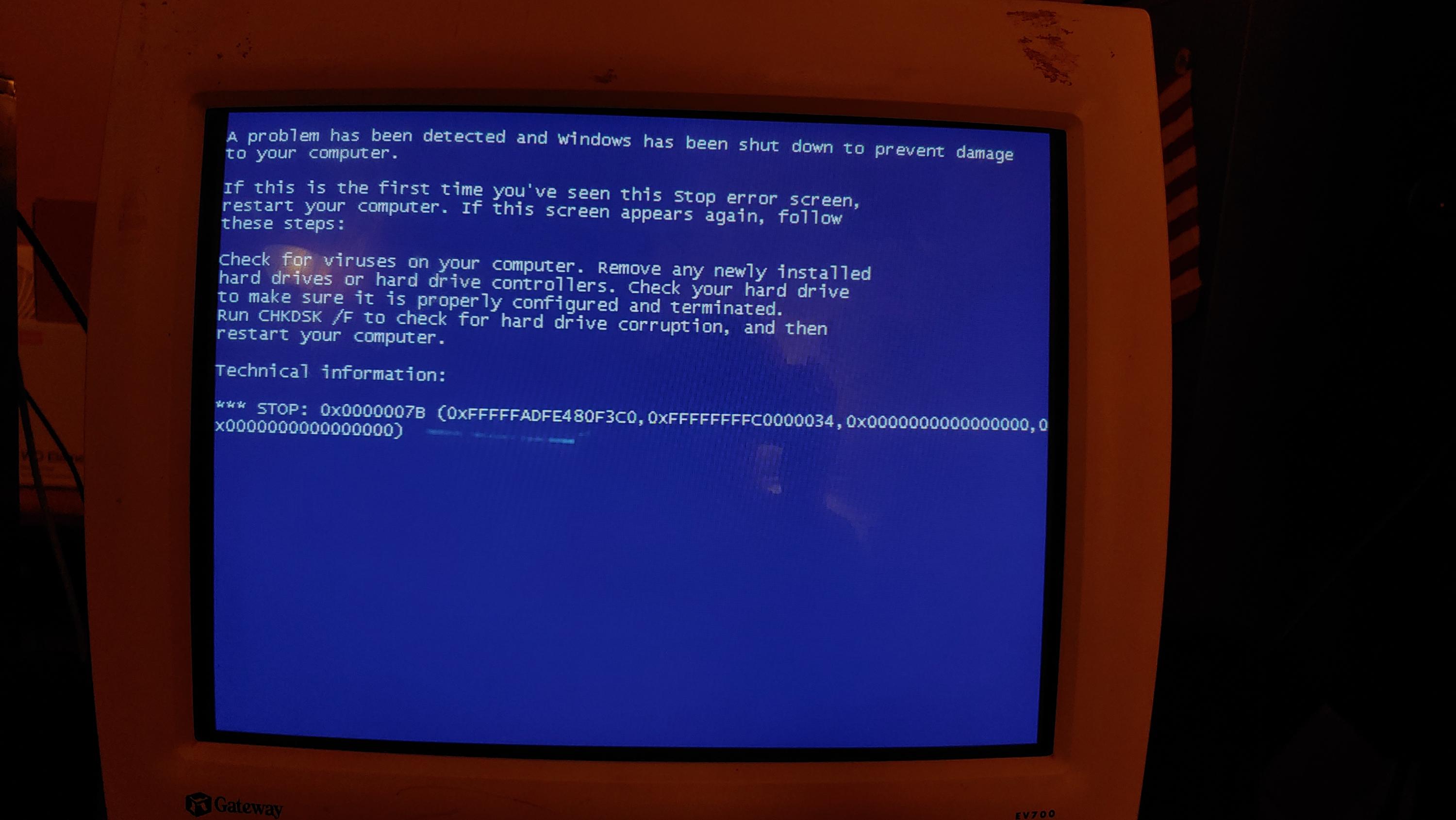

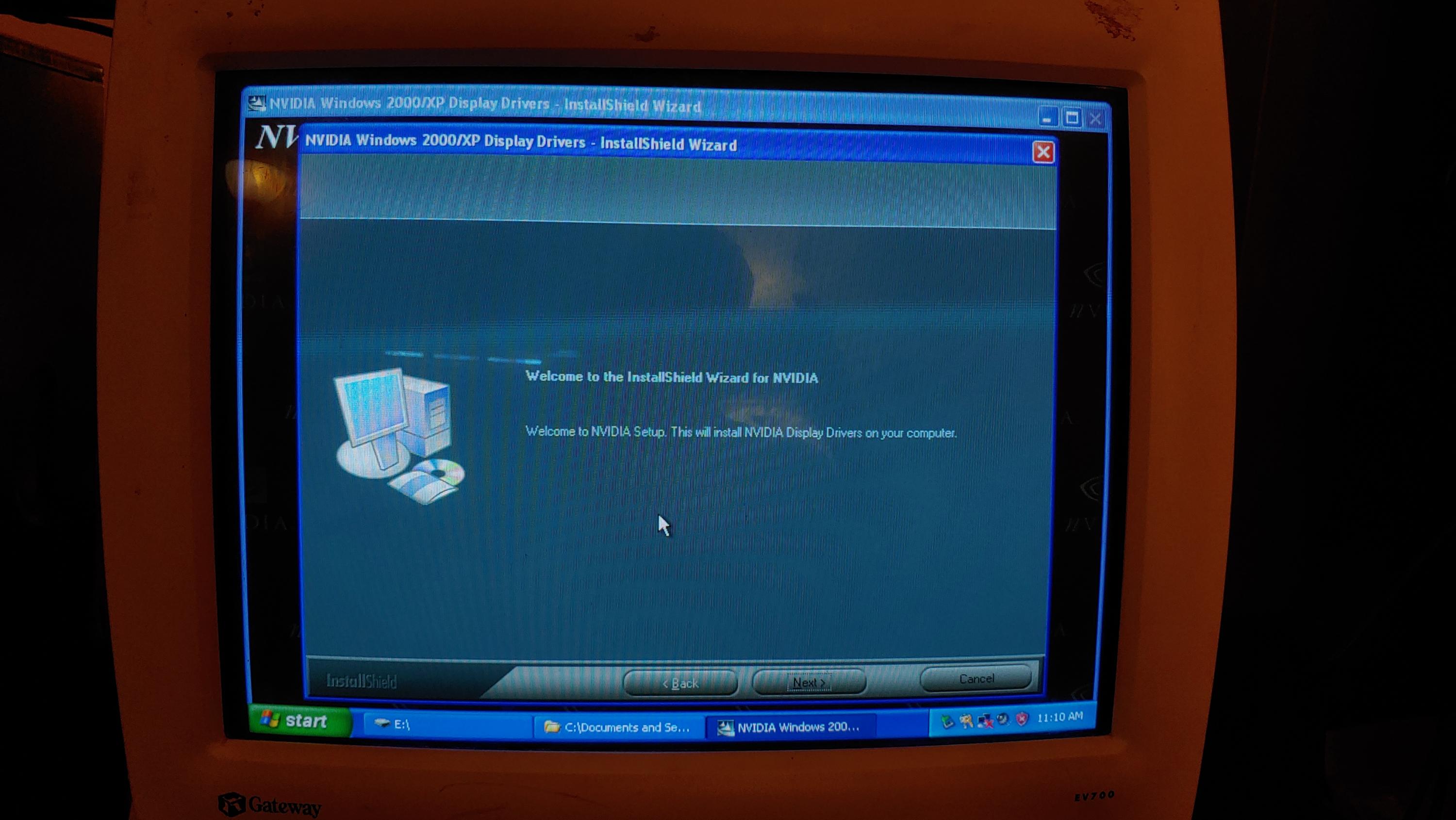

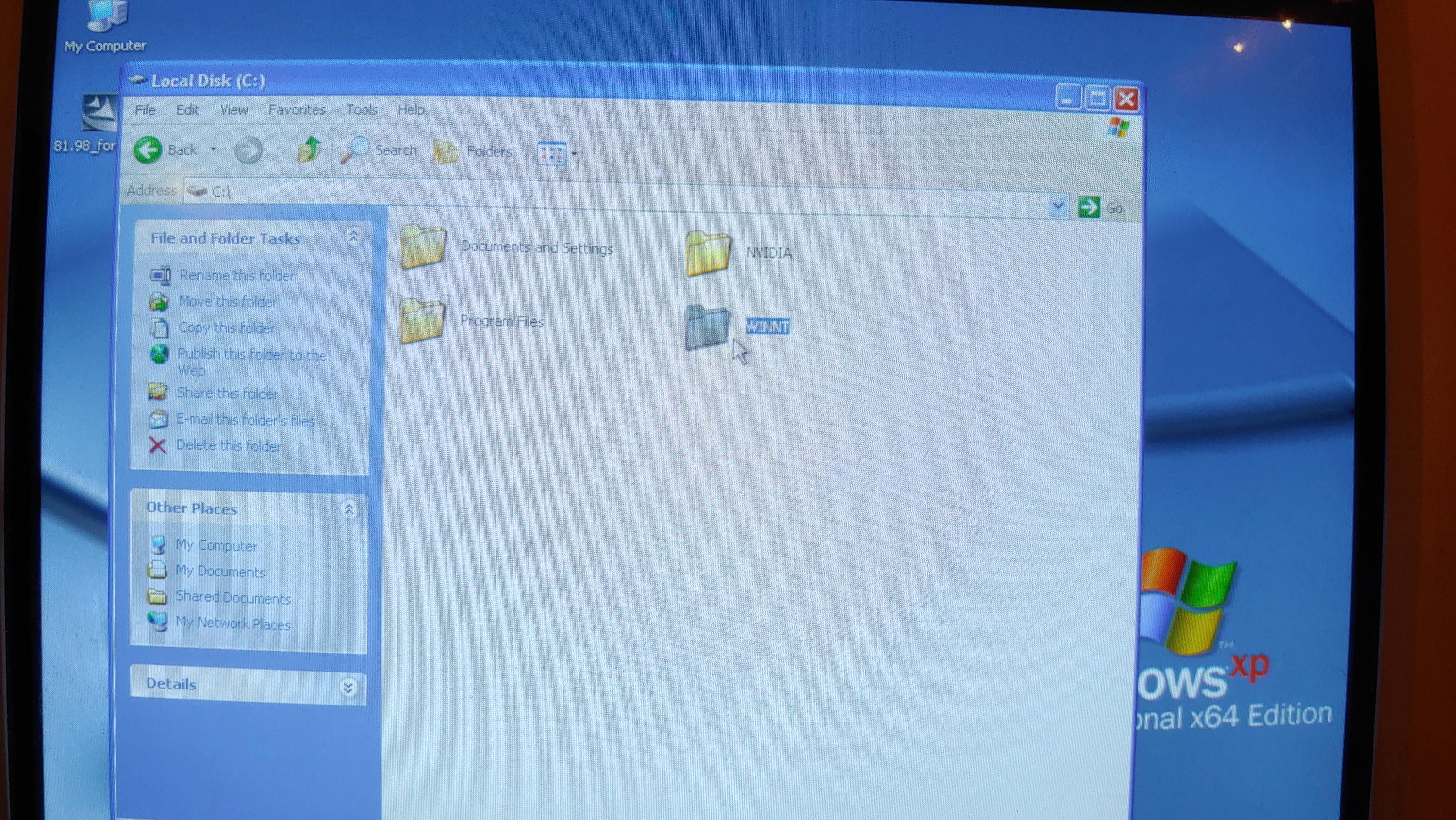

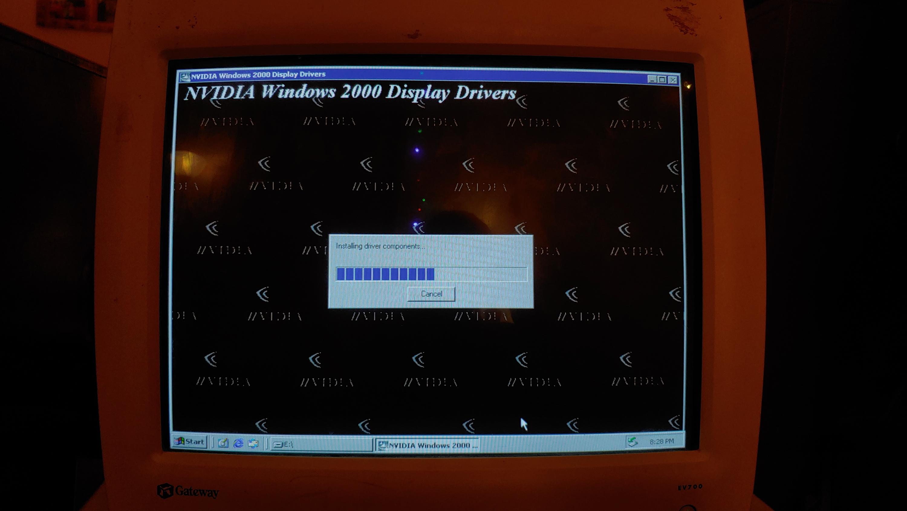

                Nvidia driver woes:
                And here I discovered that C:\ doesn't always have to be the system partition.

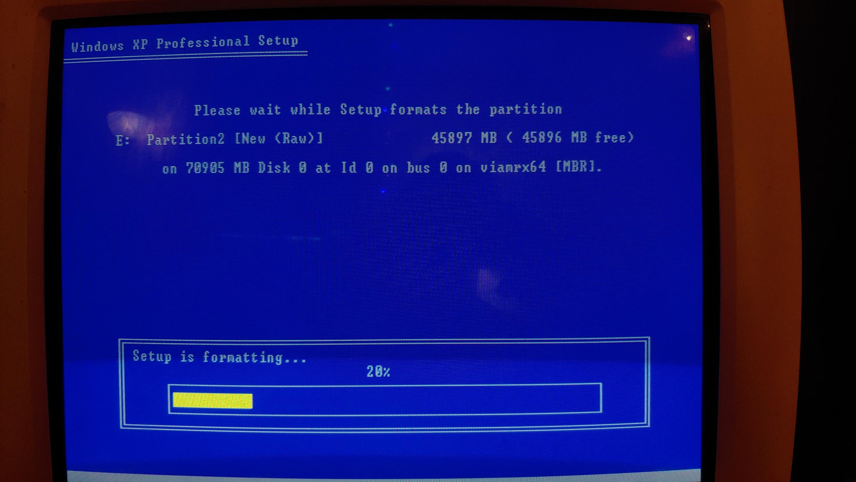

                Reinstalling, False Start Edition:
                Reboot...
                And this is where I realized that my plan of action was not one that would work.

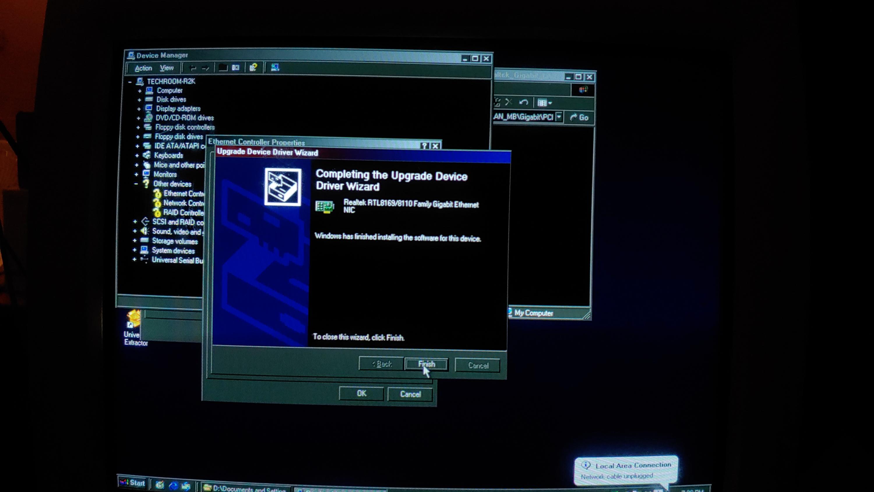

                One reinstallation (and many hours later)- WinXP x64 reinstalled and drivers gathered. Nvidia does NOT make it easy to find older legacy drivers for WinXP x64.

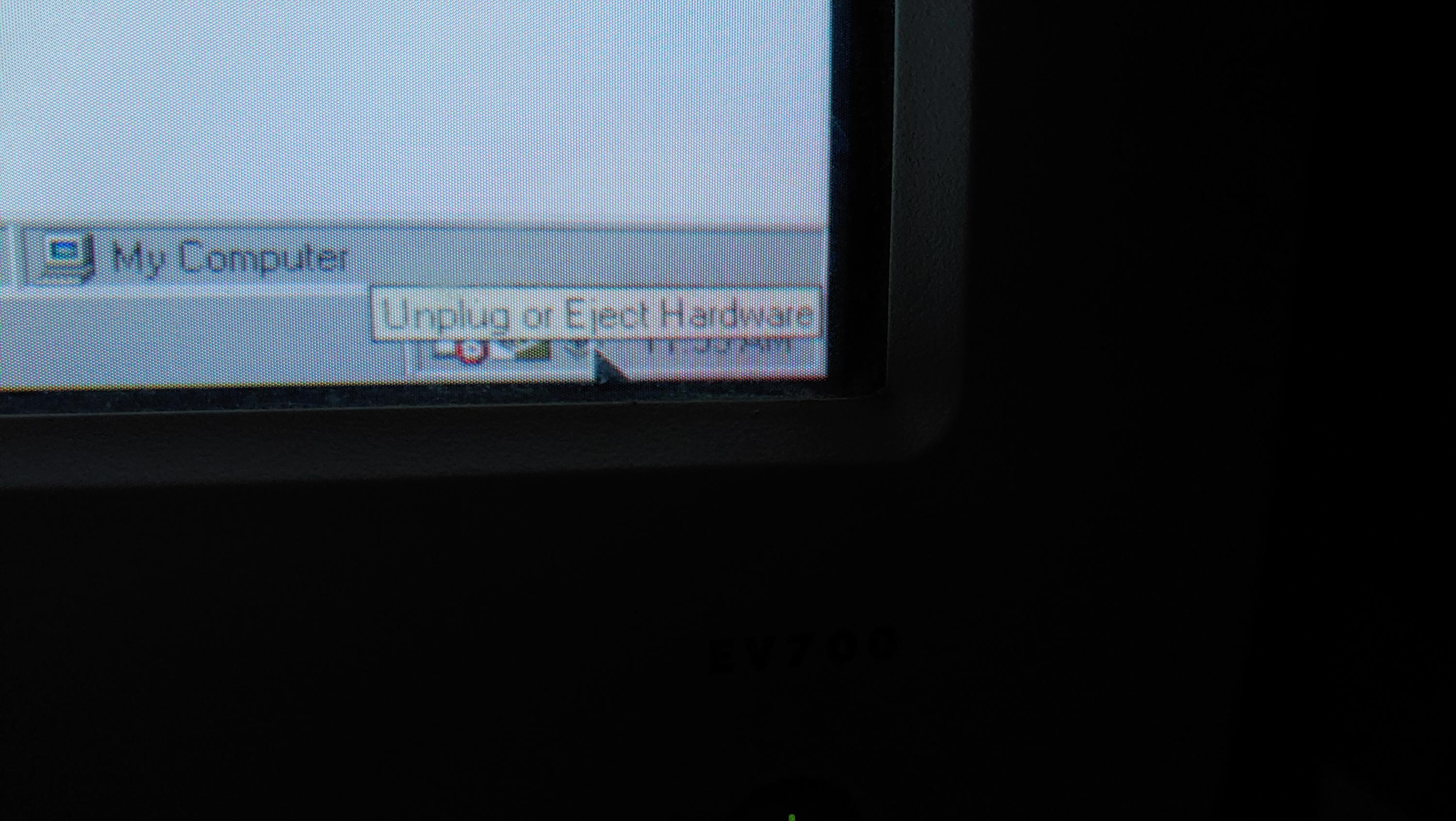

                Installing drivers.
                And some time later, plus a few false starts on the wireless software later, things are up and running pretty well.
                And staring me right in the face is the attachment limit, yet again. More megaposts coming up soon.

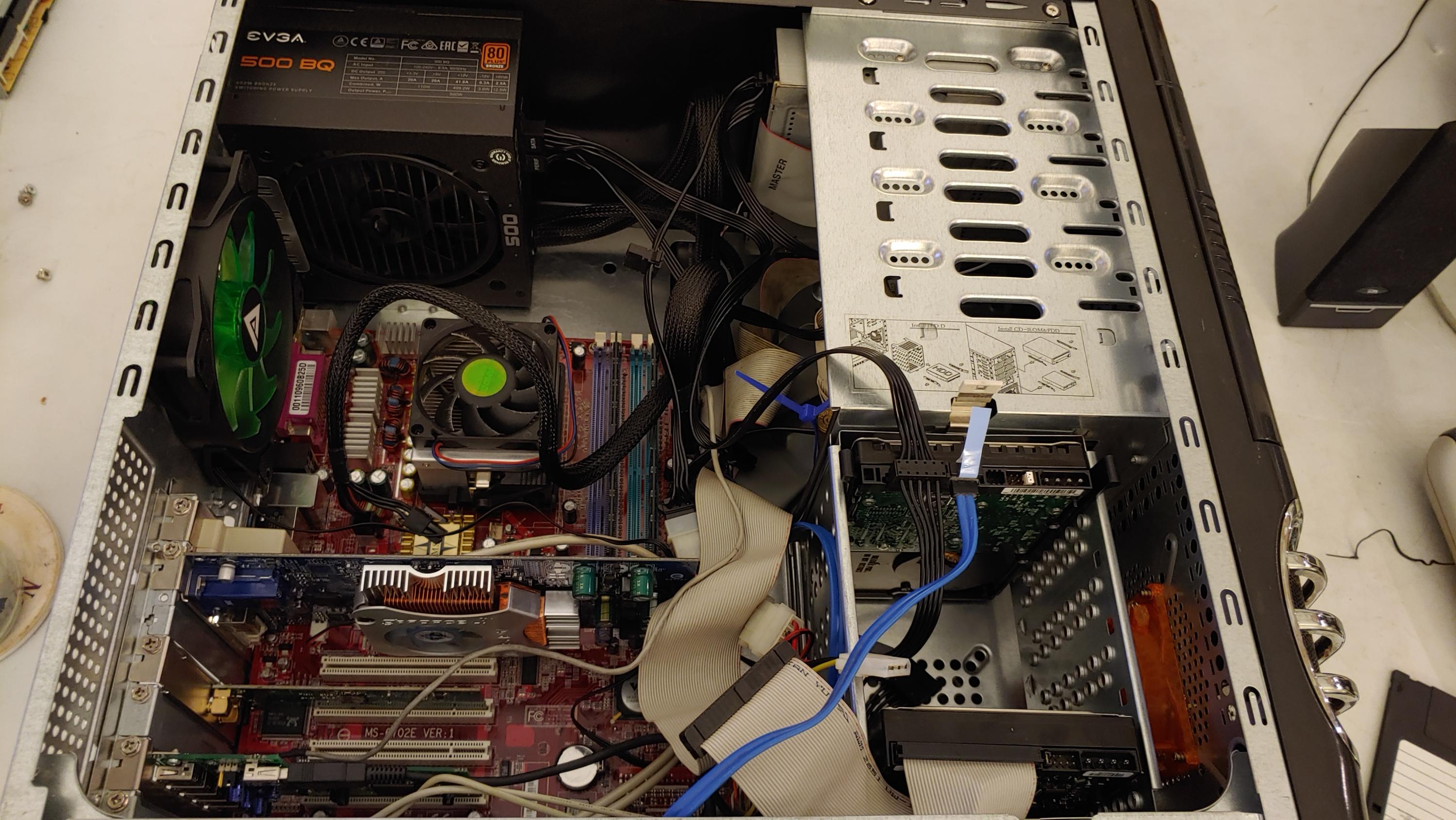

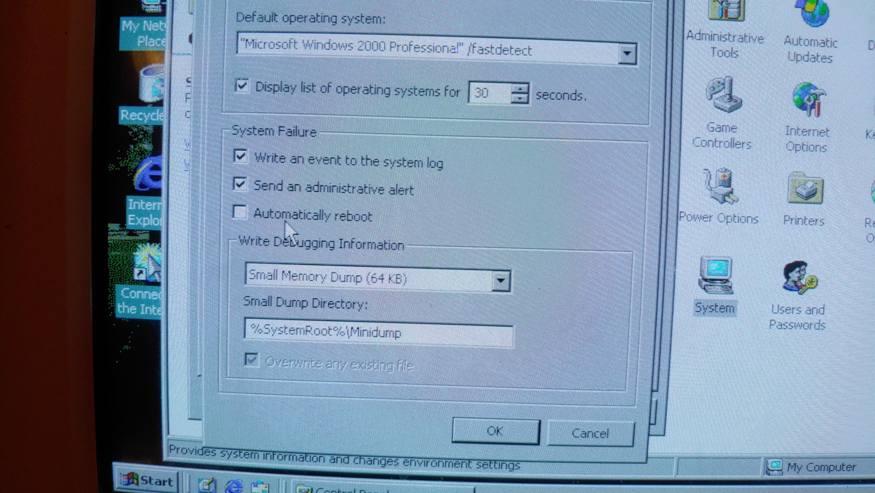

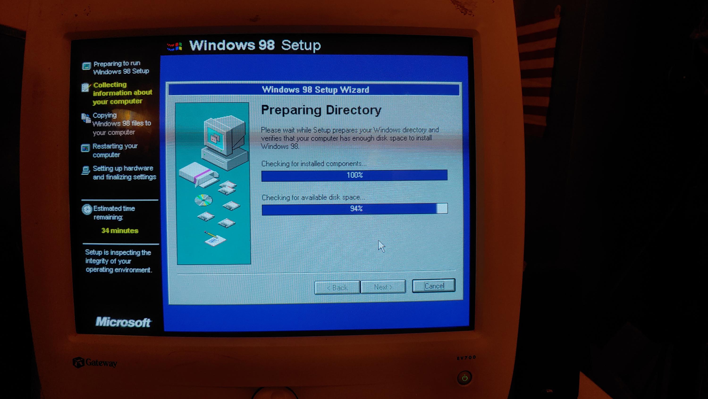

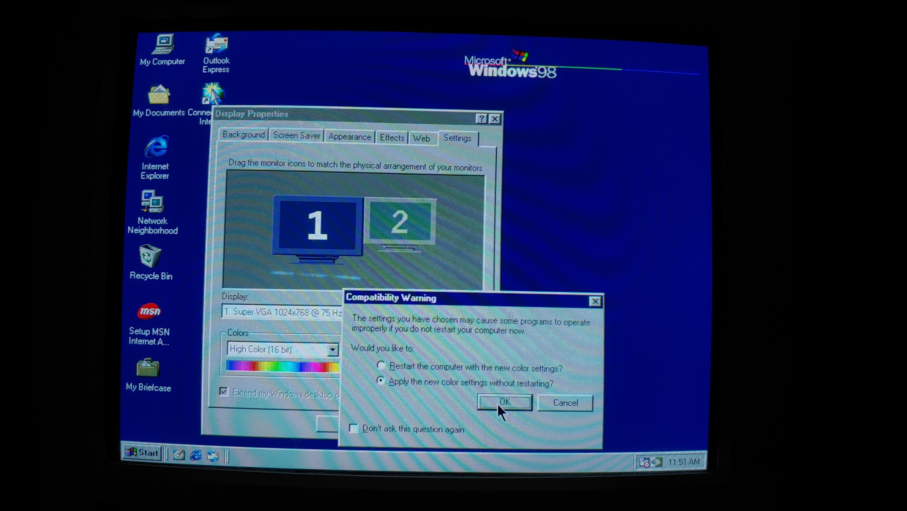

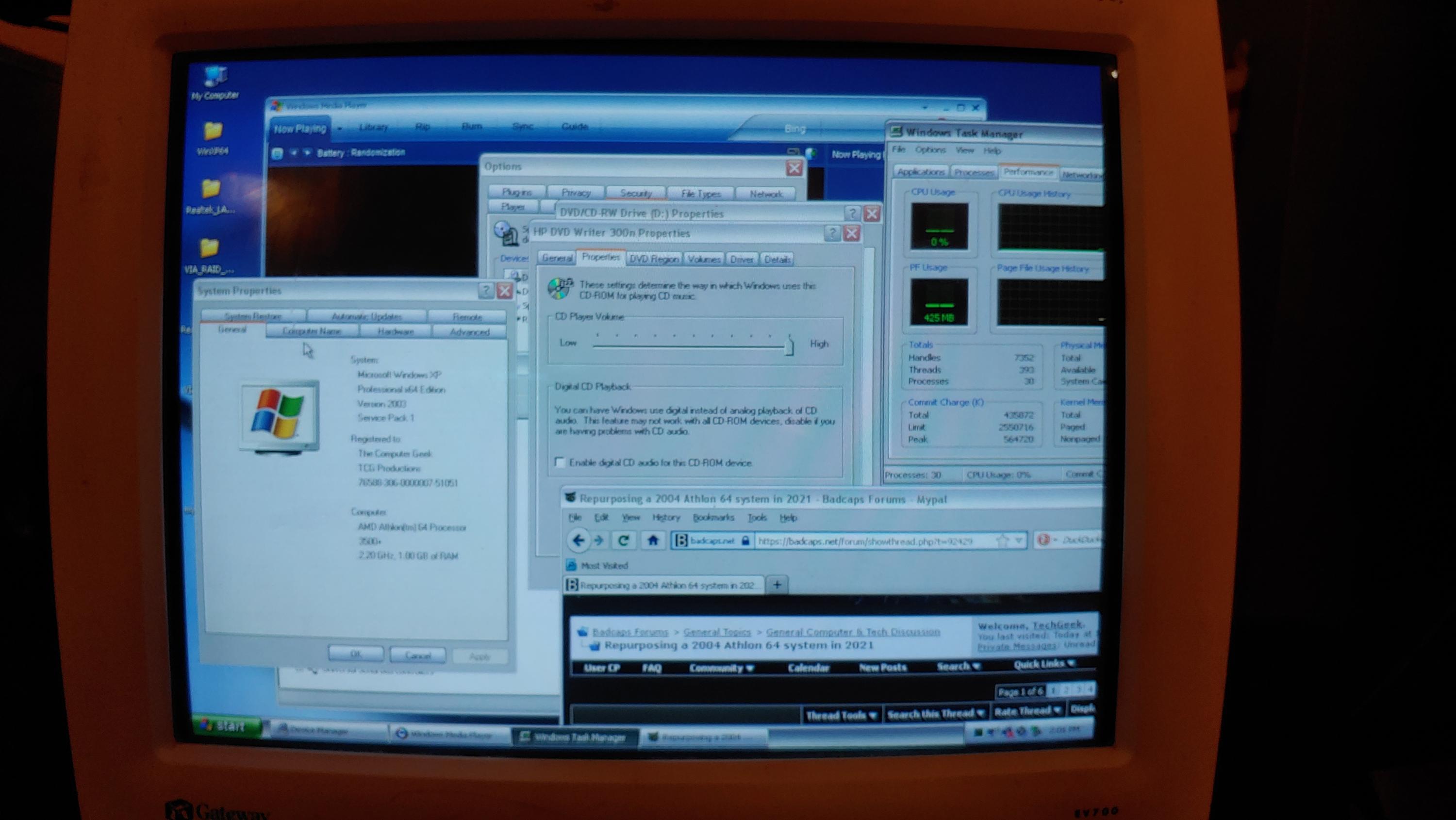

                  Another huge mega-post incoming... hope you've got fans pointing at your modems, because they're about to get a little HOT!

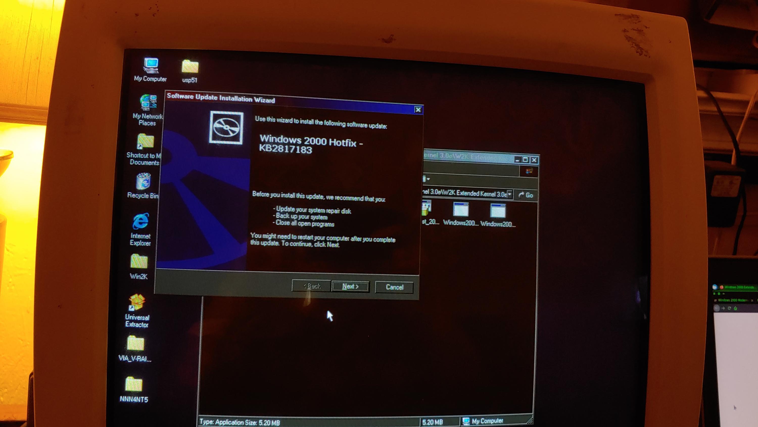

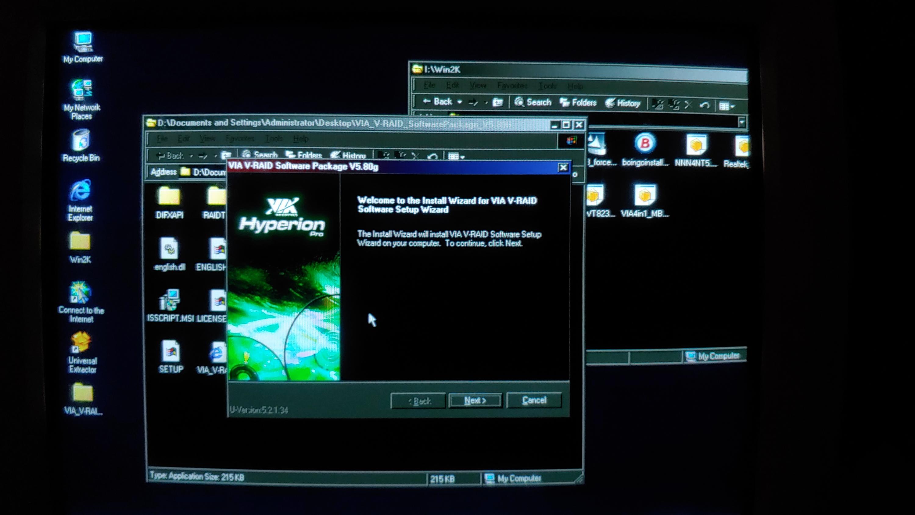

                  Some time later- Opened up a slew of windows, including the 2 configuration panels that you need to get into to turn off digital audio from the optical drive.
                  Momaka- hats off to you for this one!

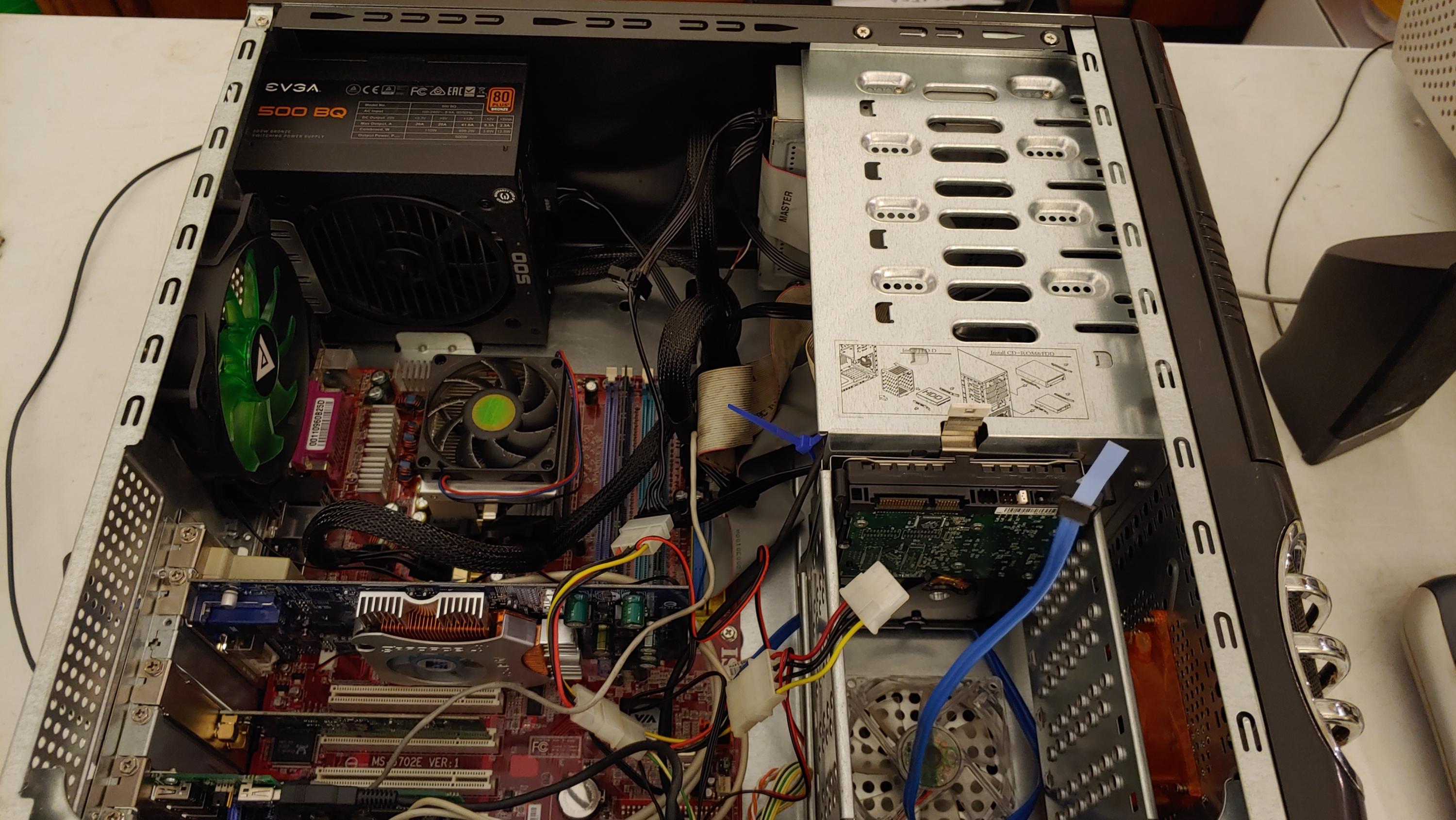

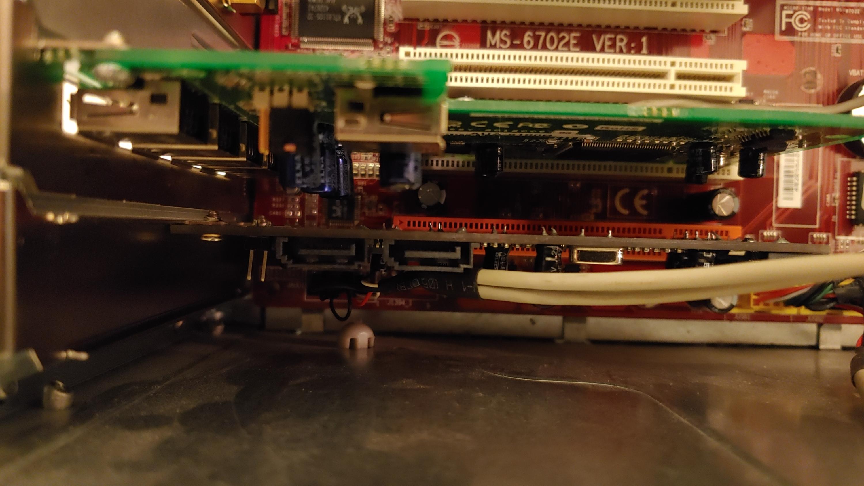

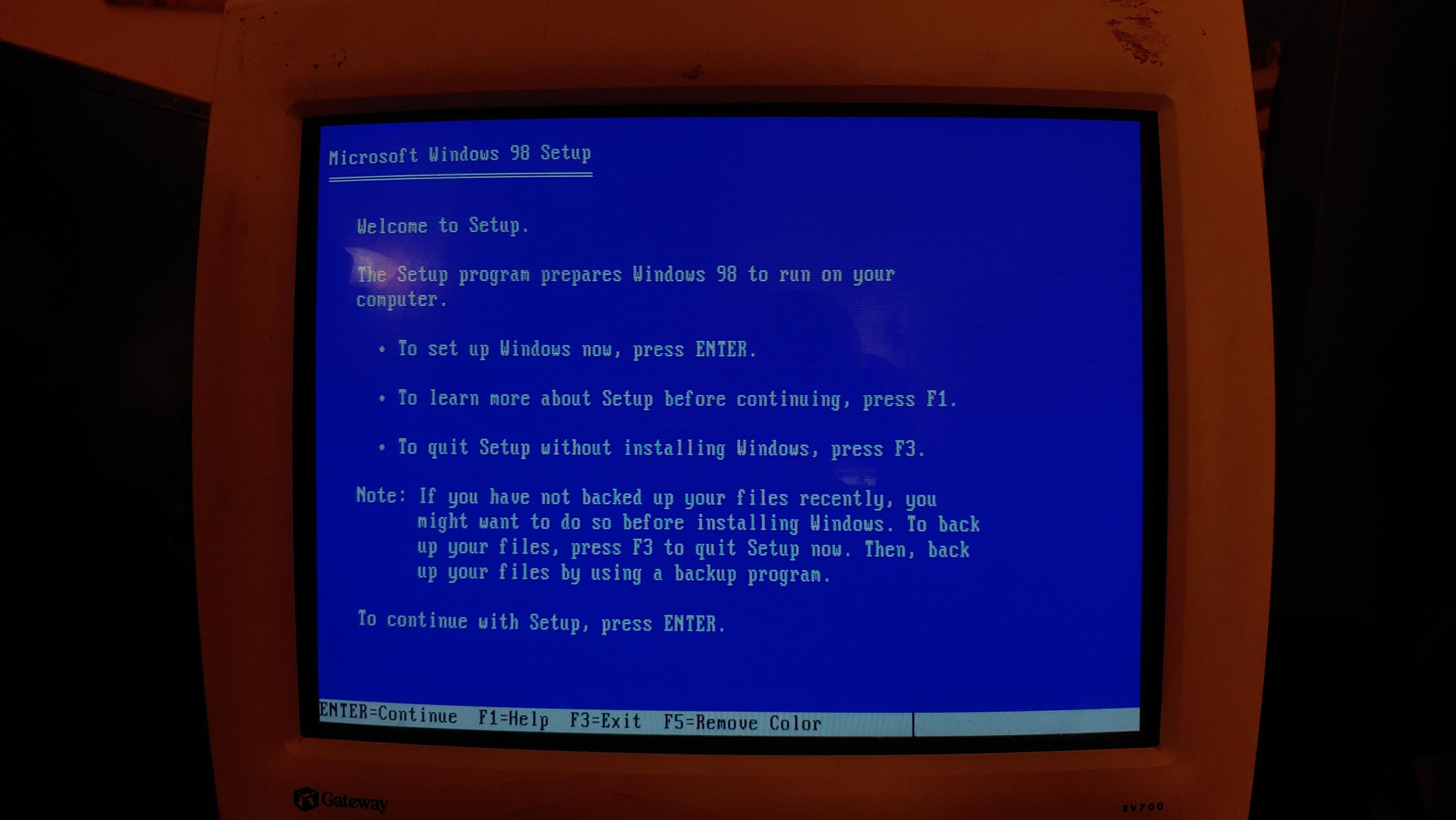

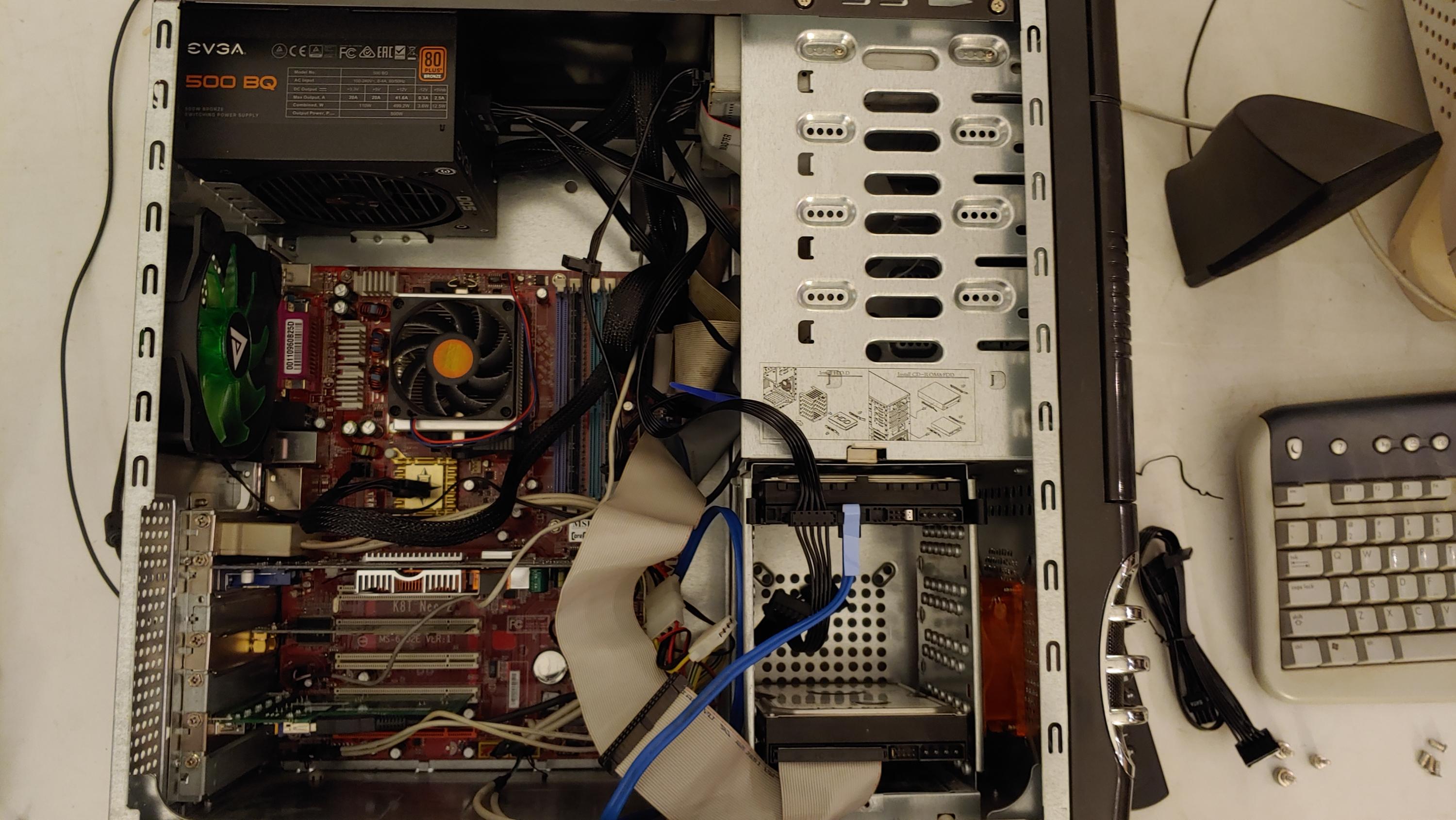

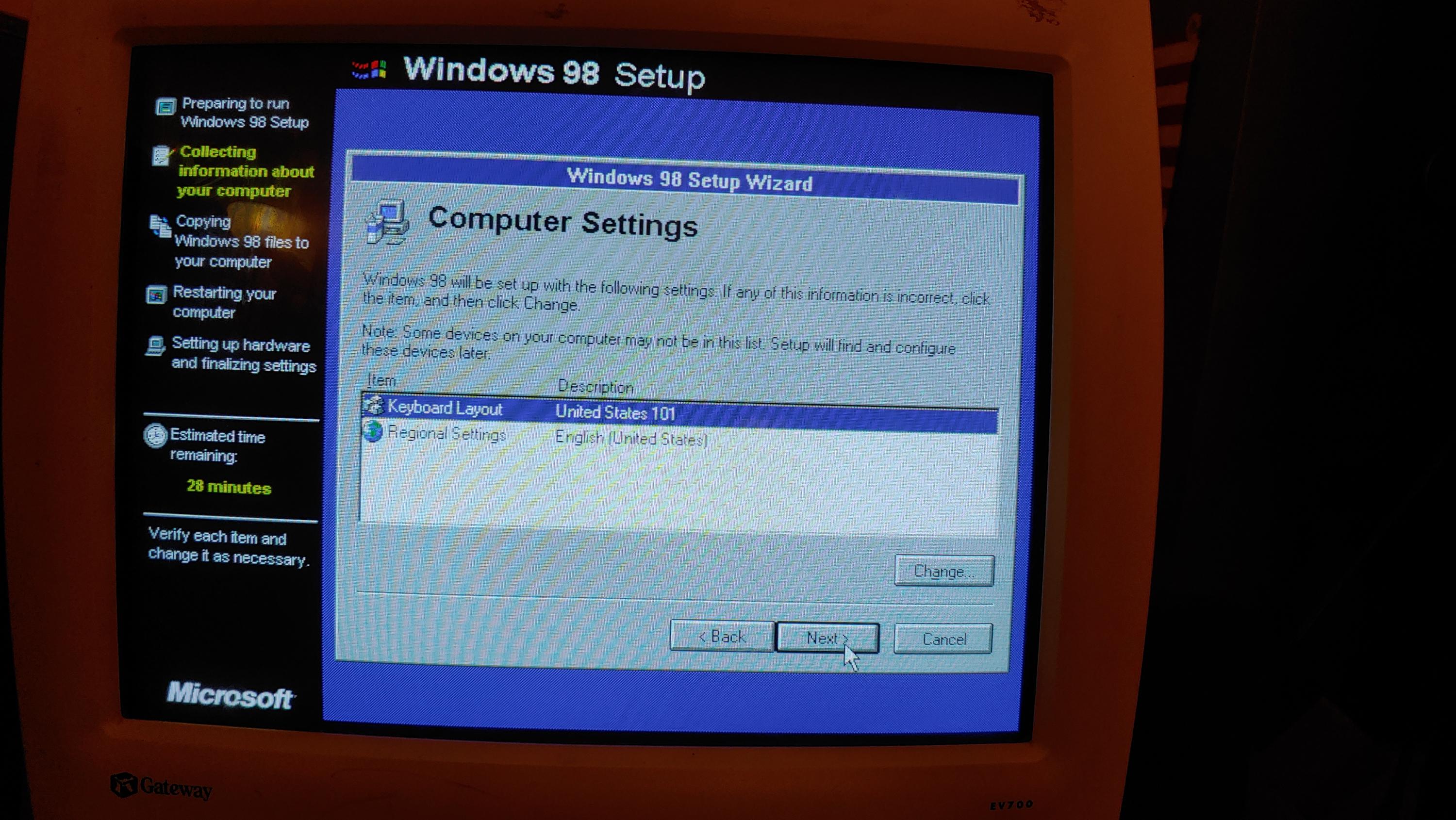

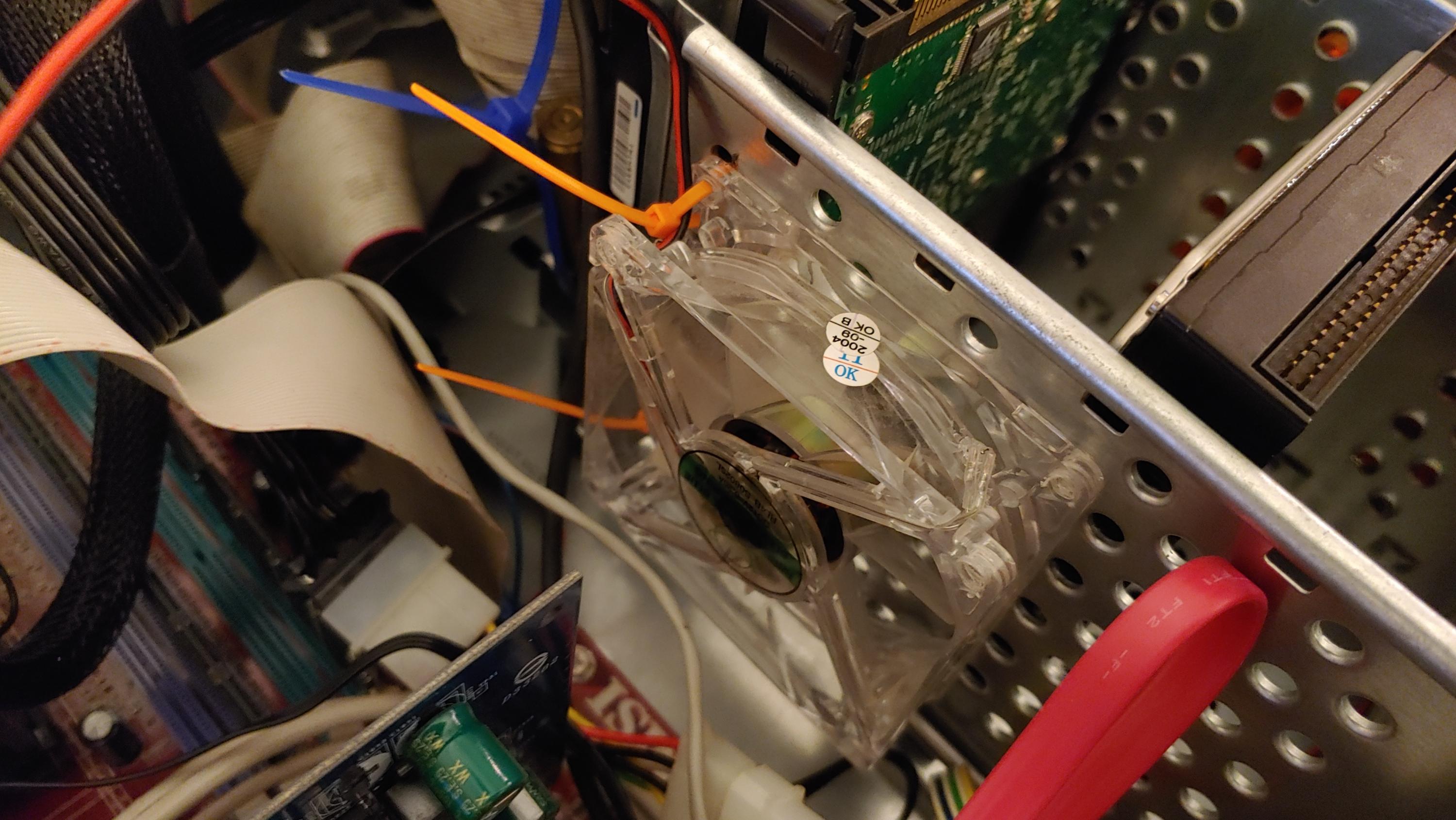

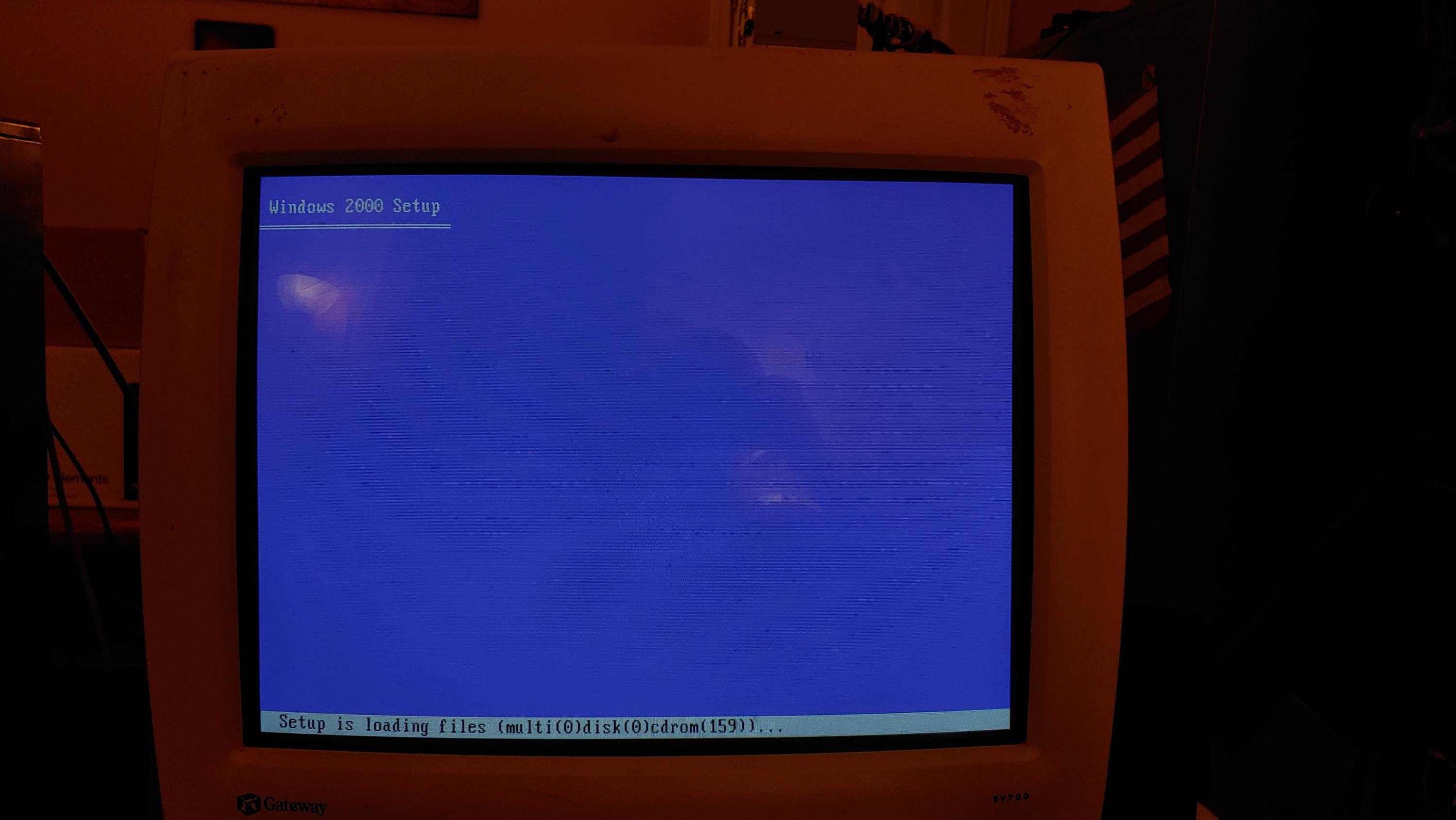

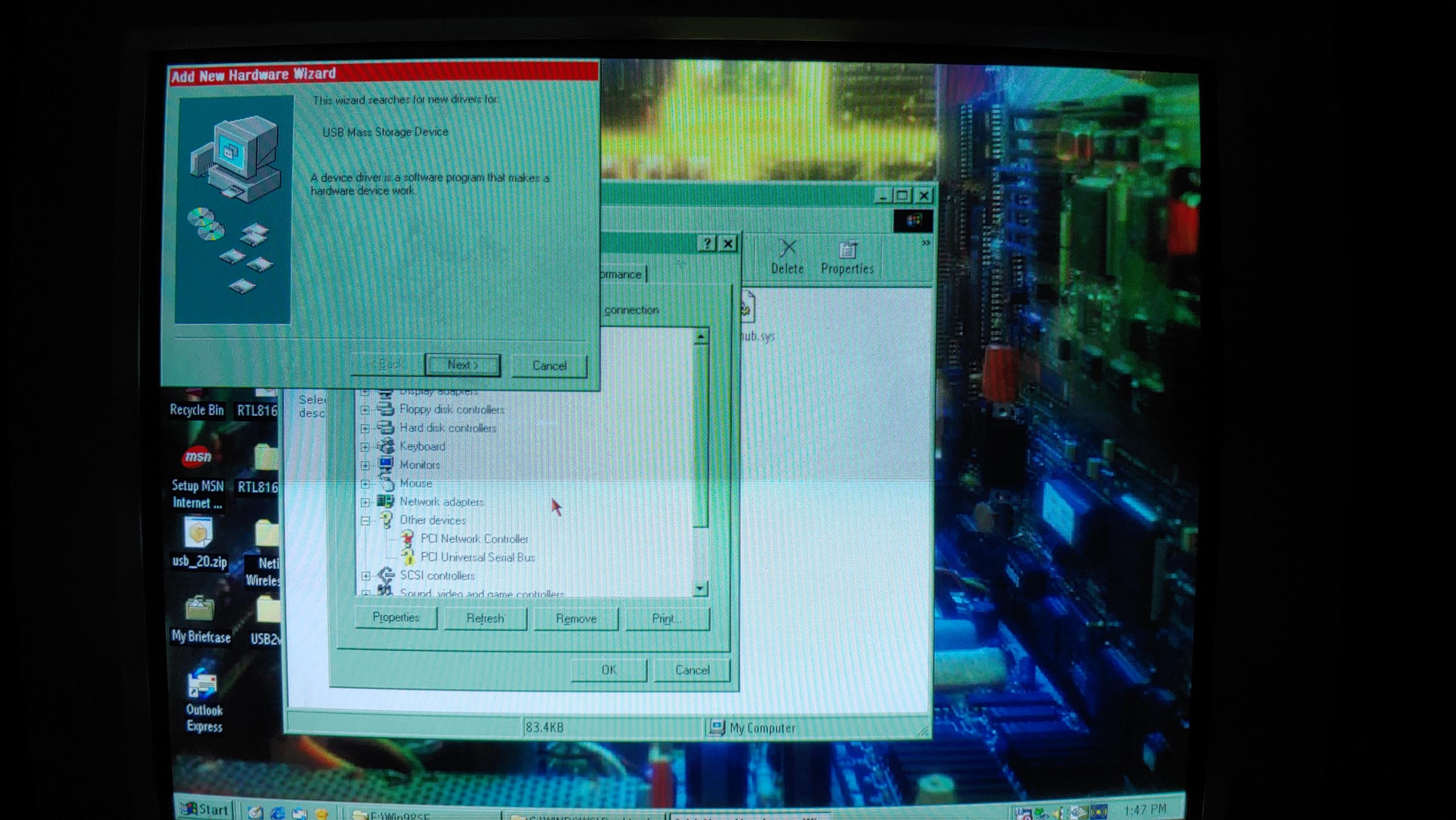

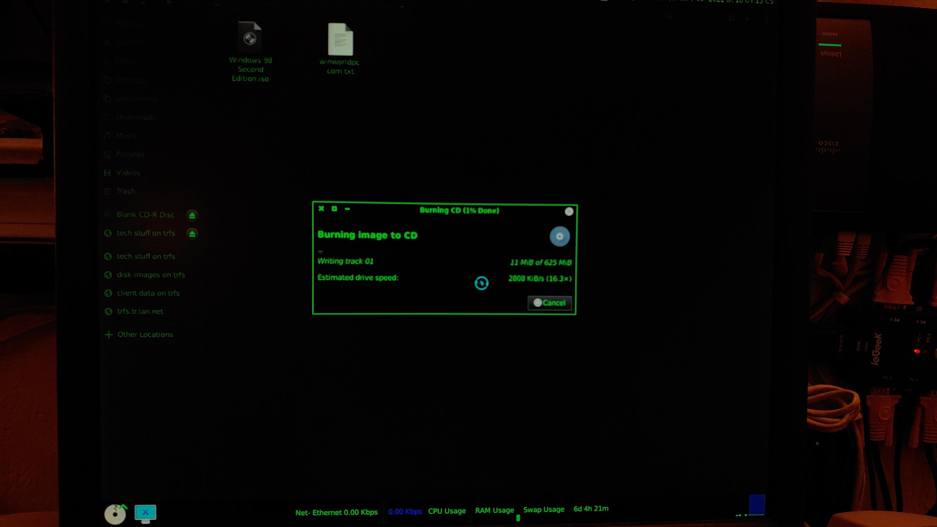

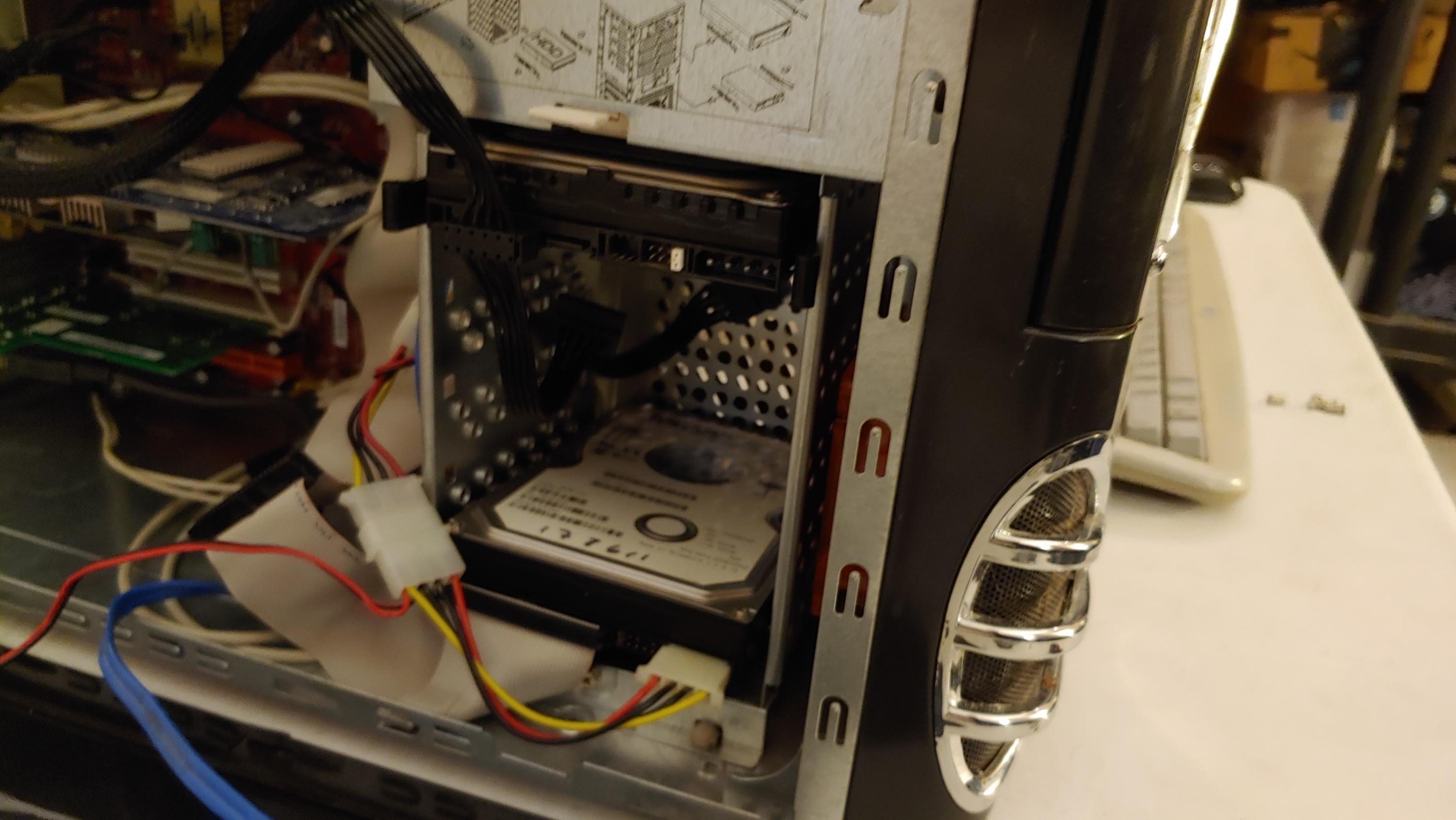

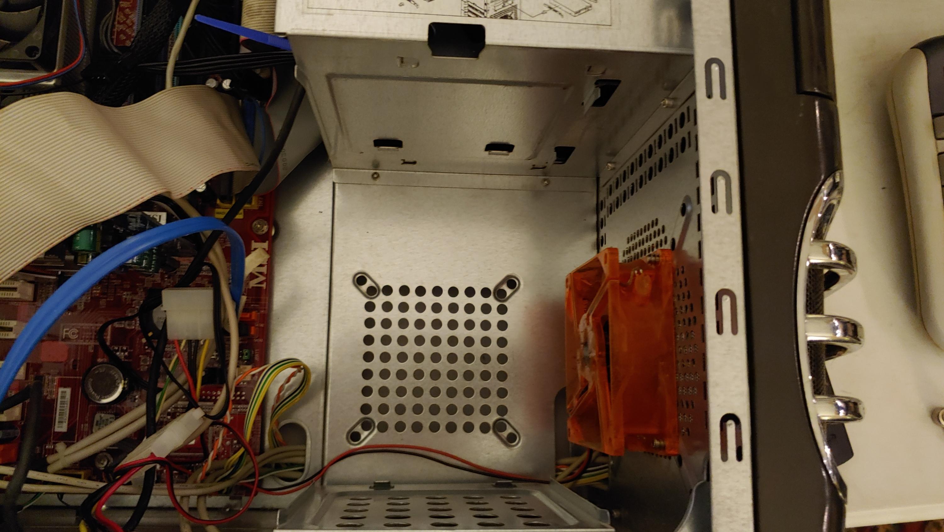

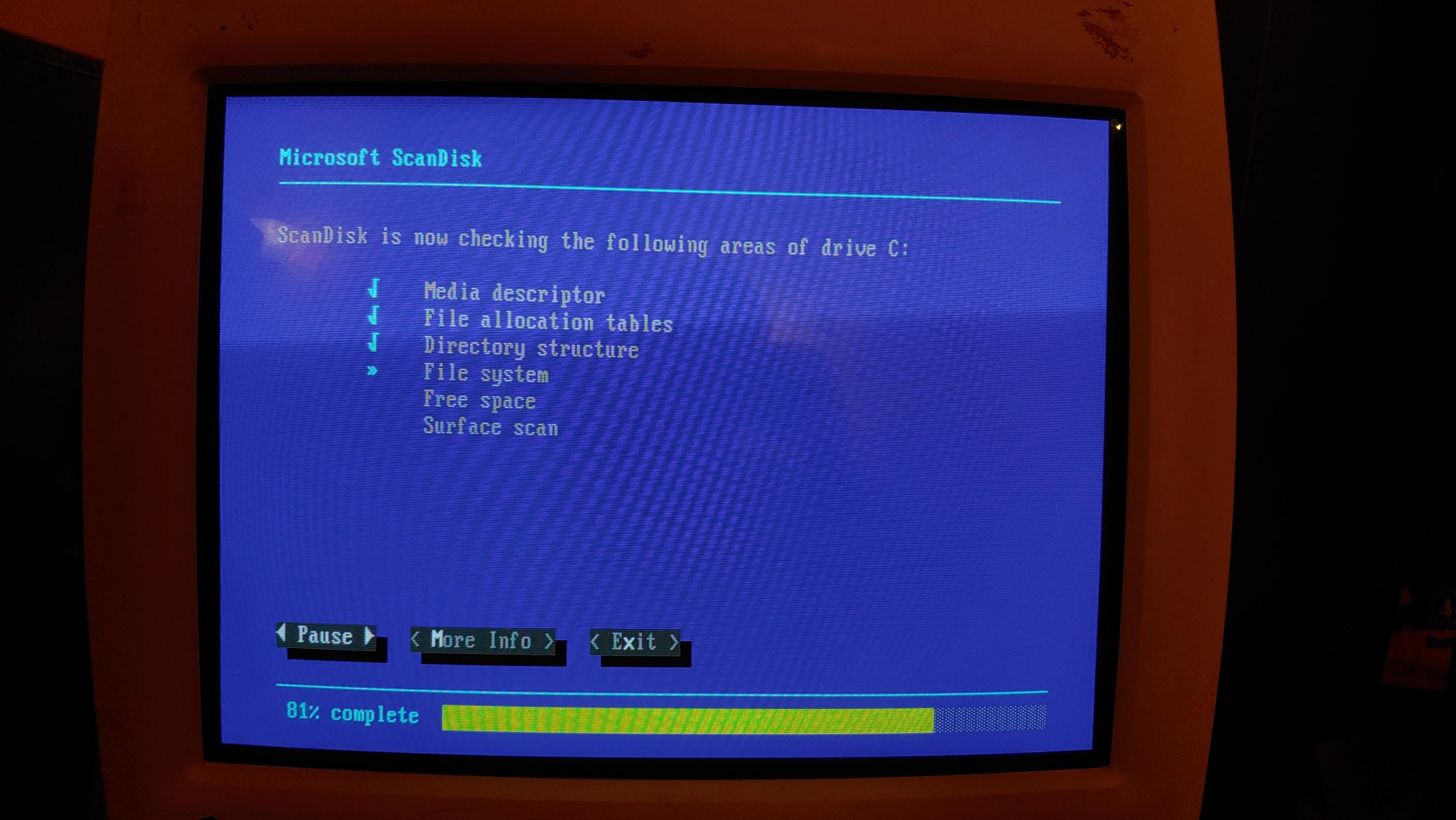

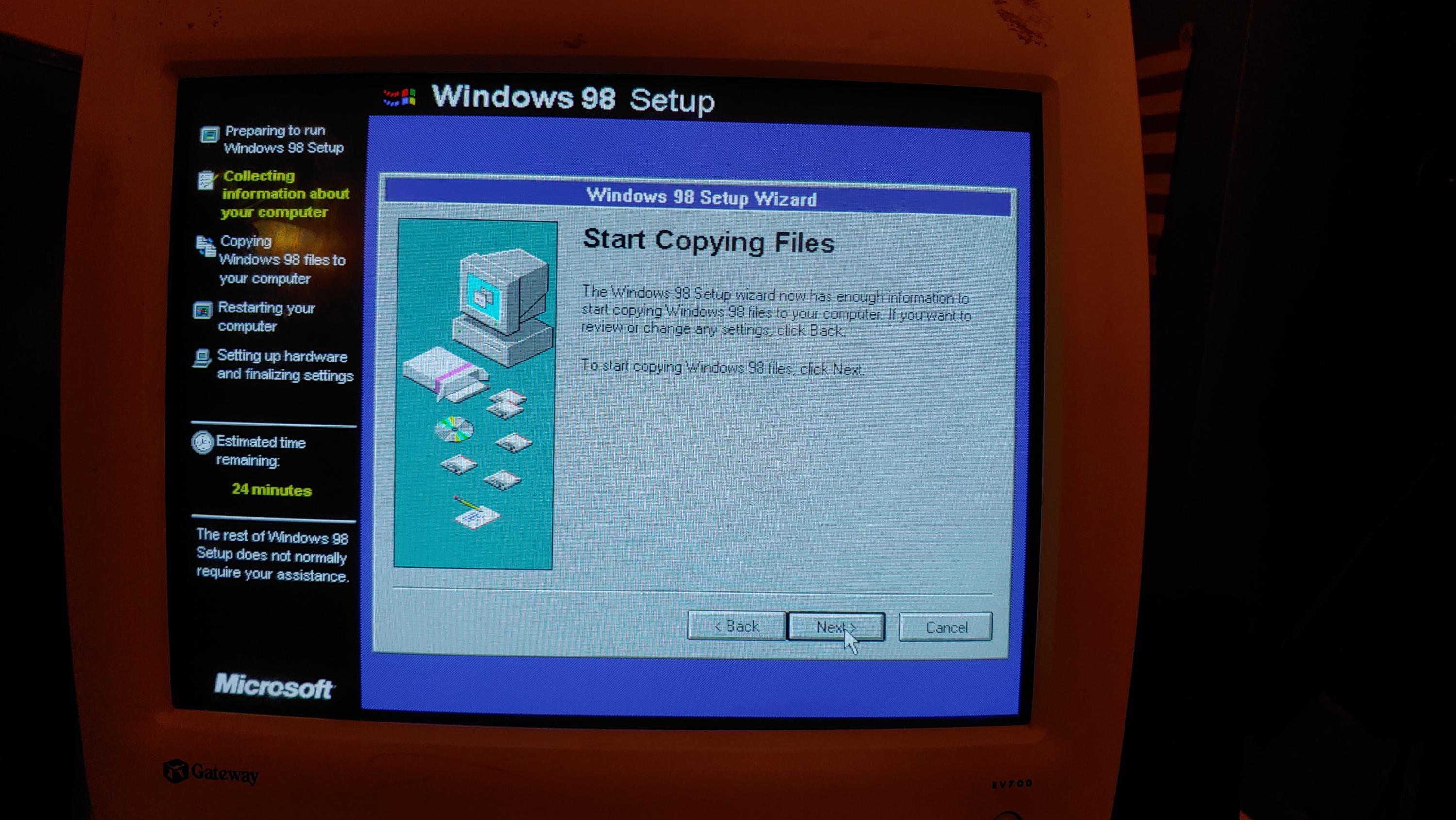

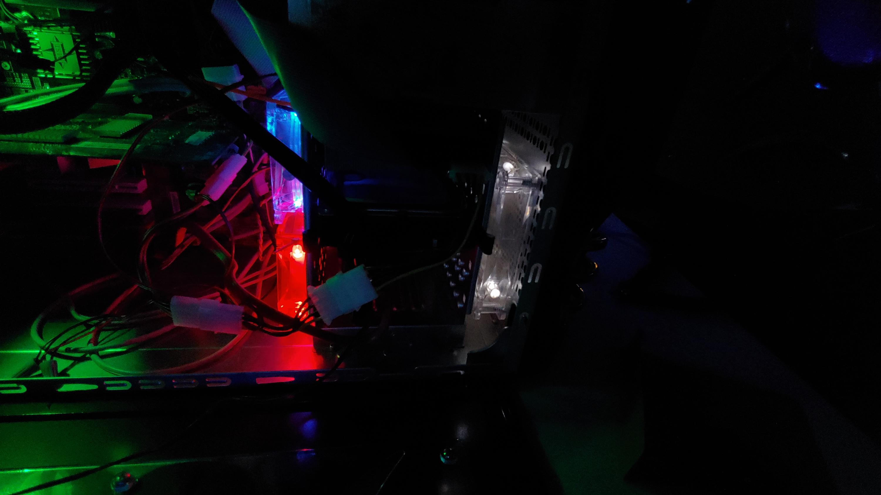

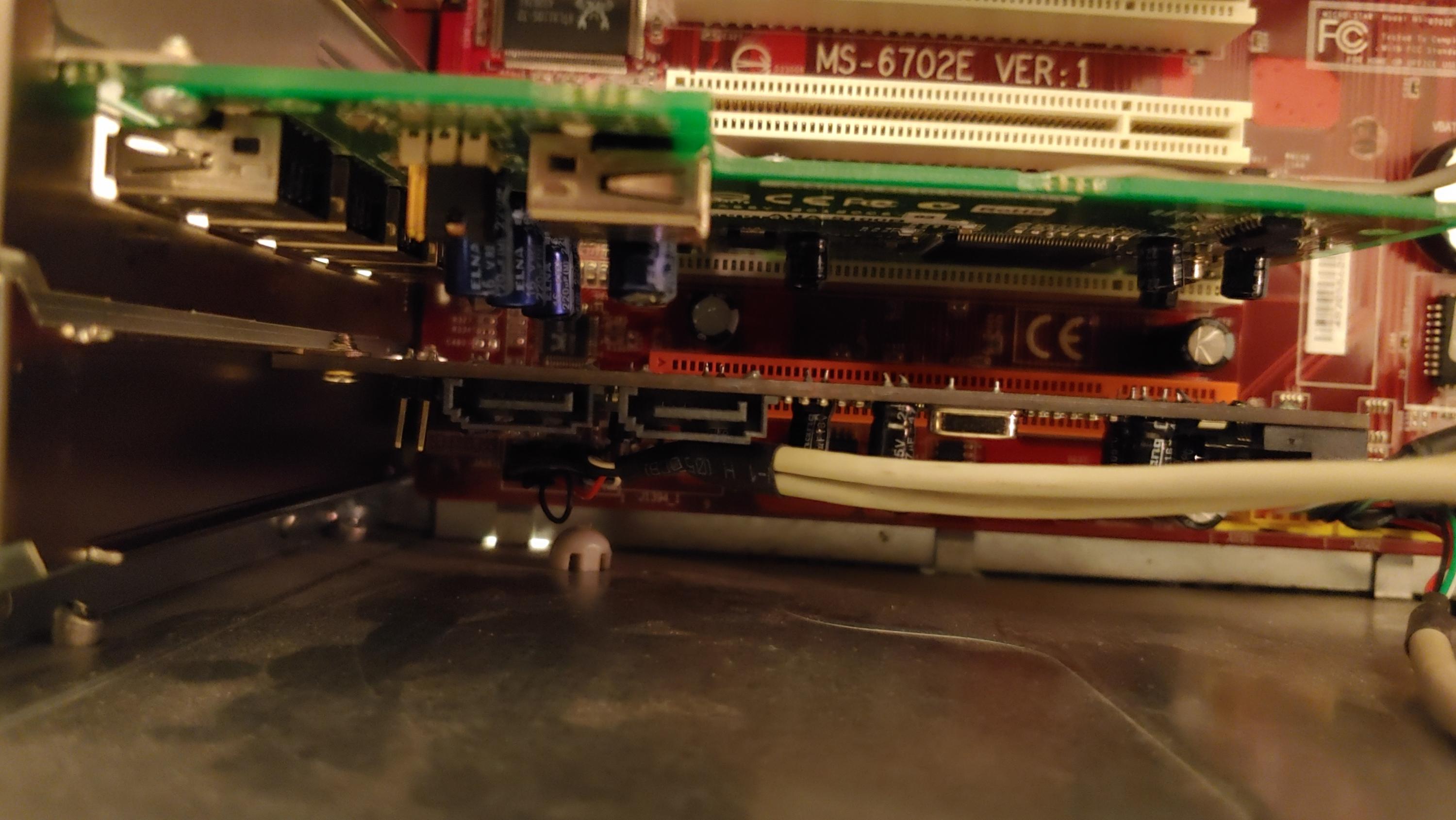

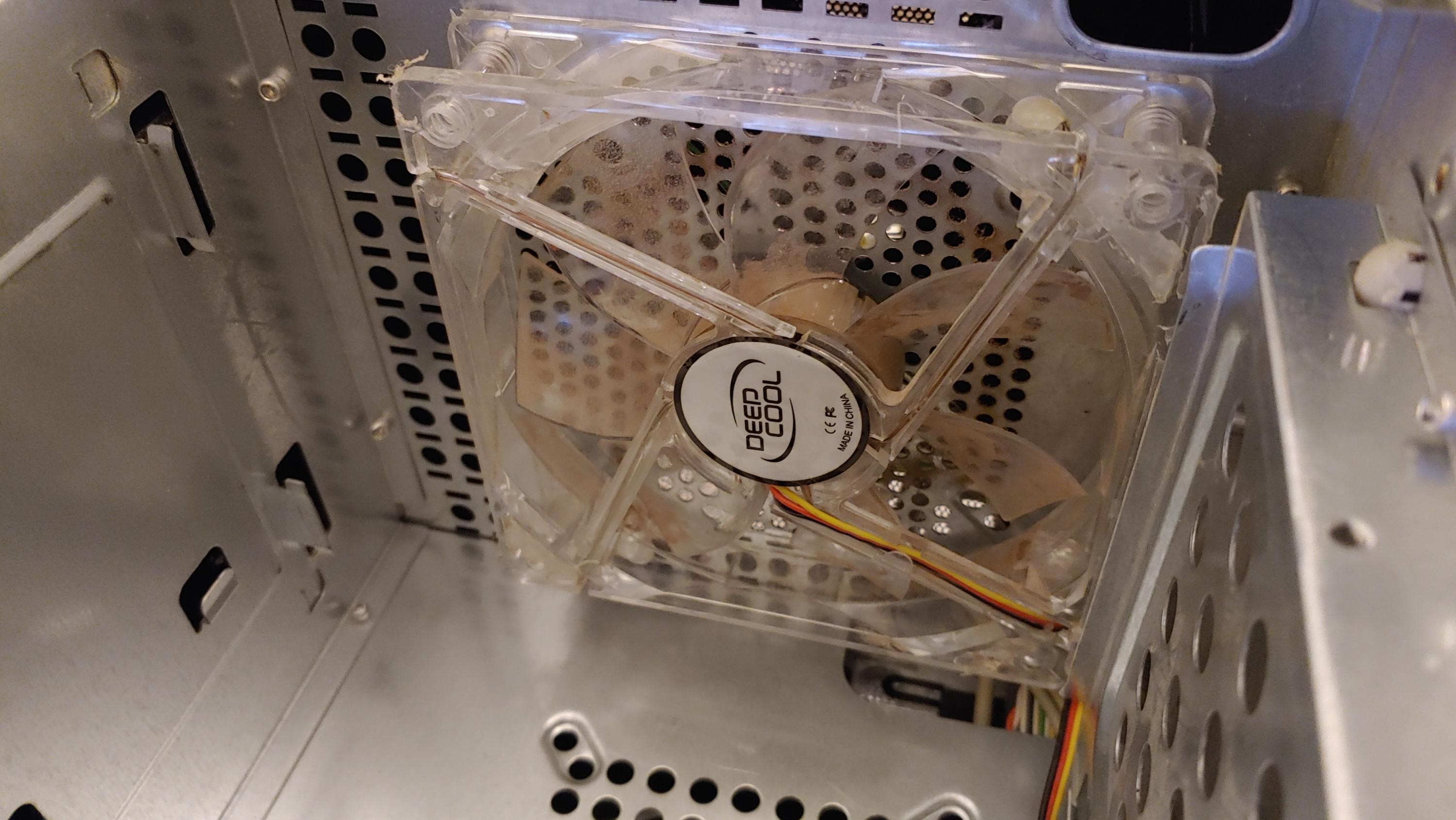

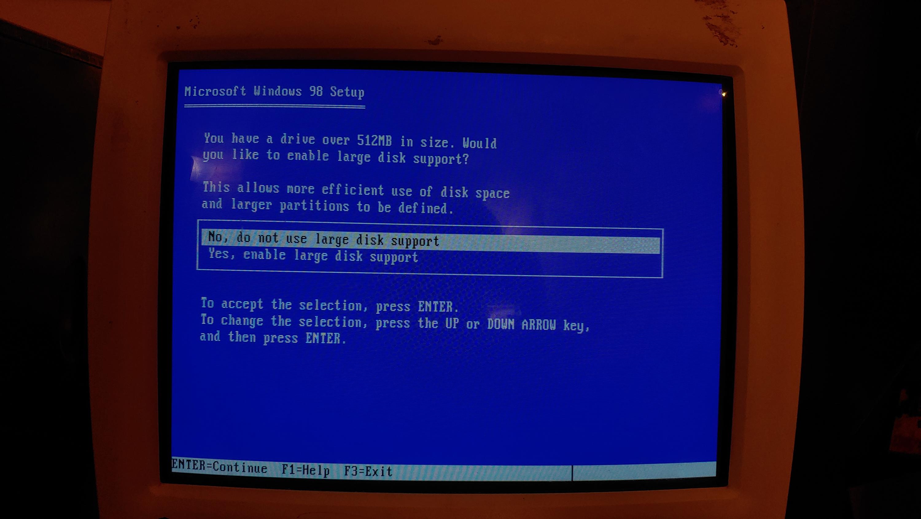

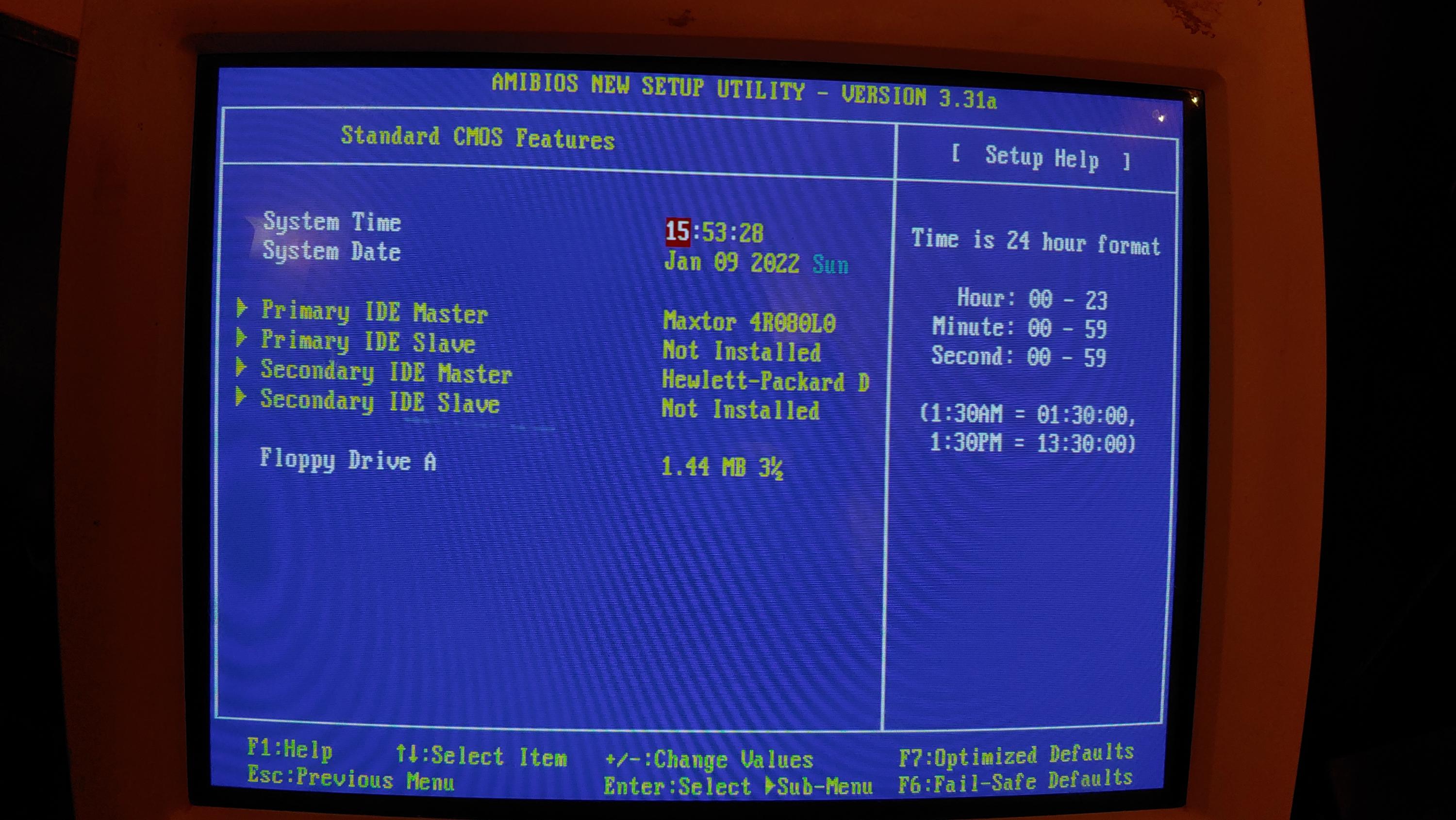

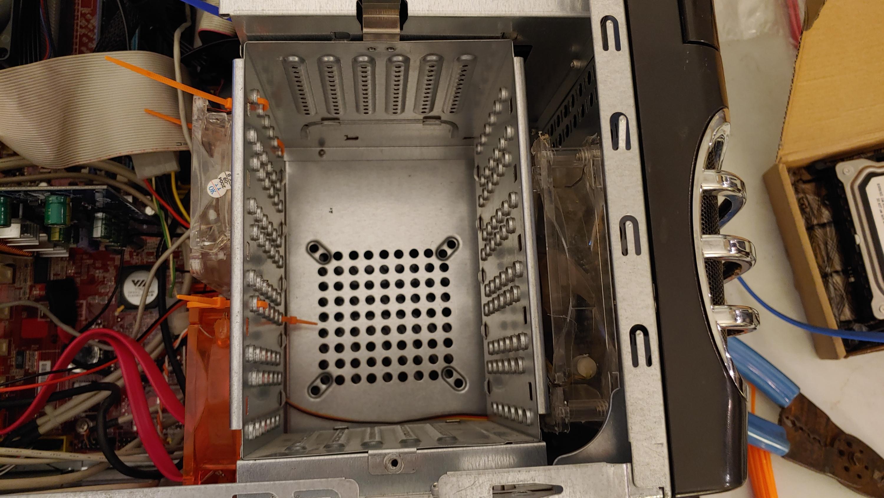

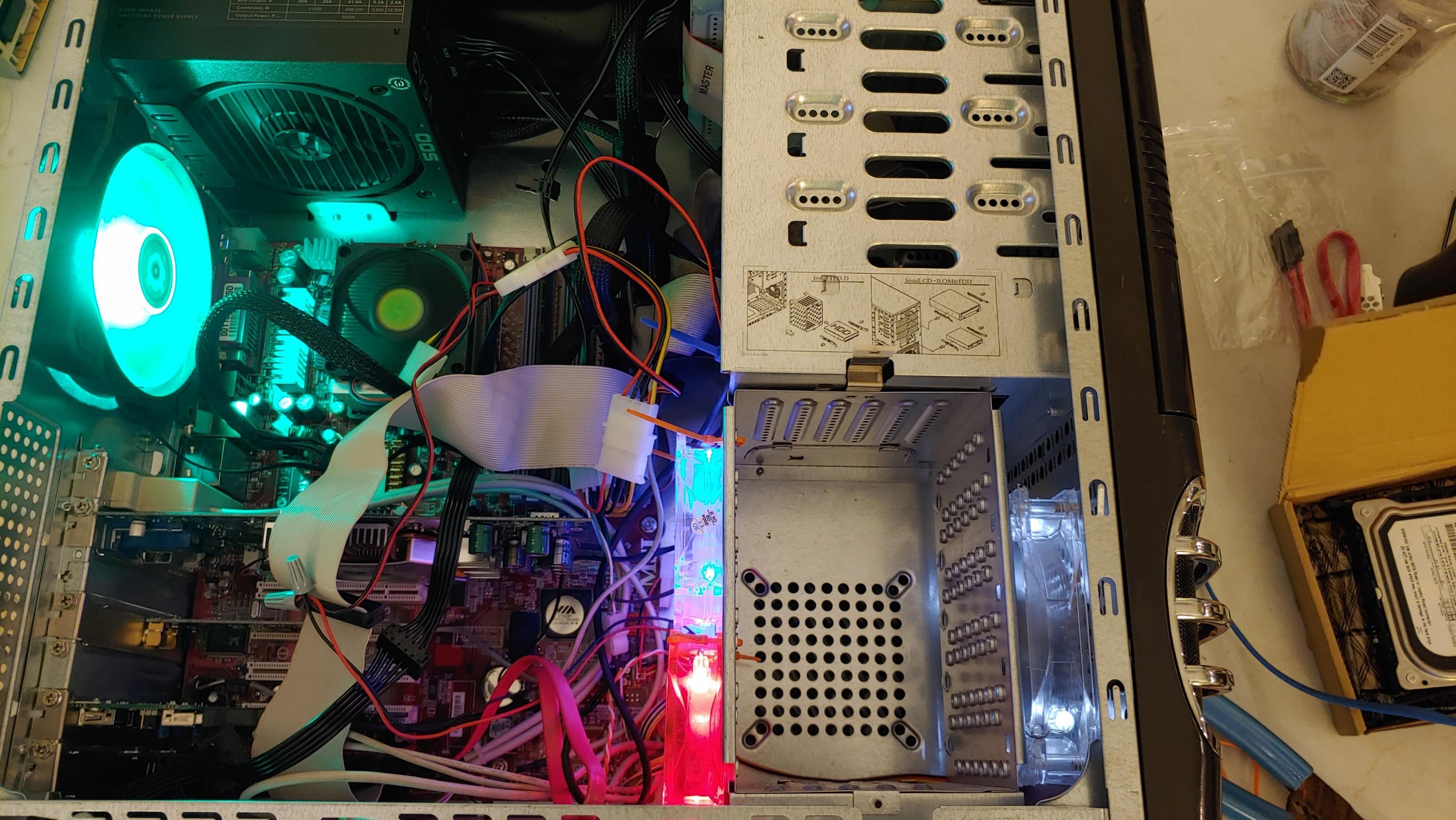

                  Installing an 80GB Maxtor drive so I can install Windows 98SE. System opened up once again...
                  Had to remove the fan I put in the hard drive cage because it prevents the installation of any hard drive below the topmost slot.
                  And done.
                  Detected by BIOS.

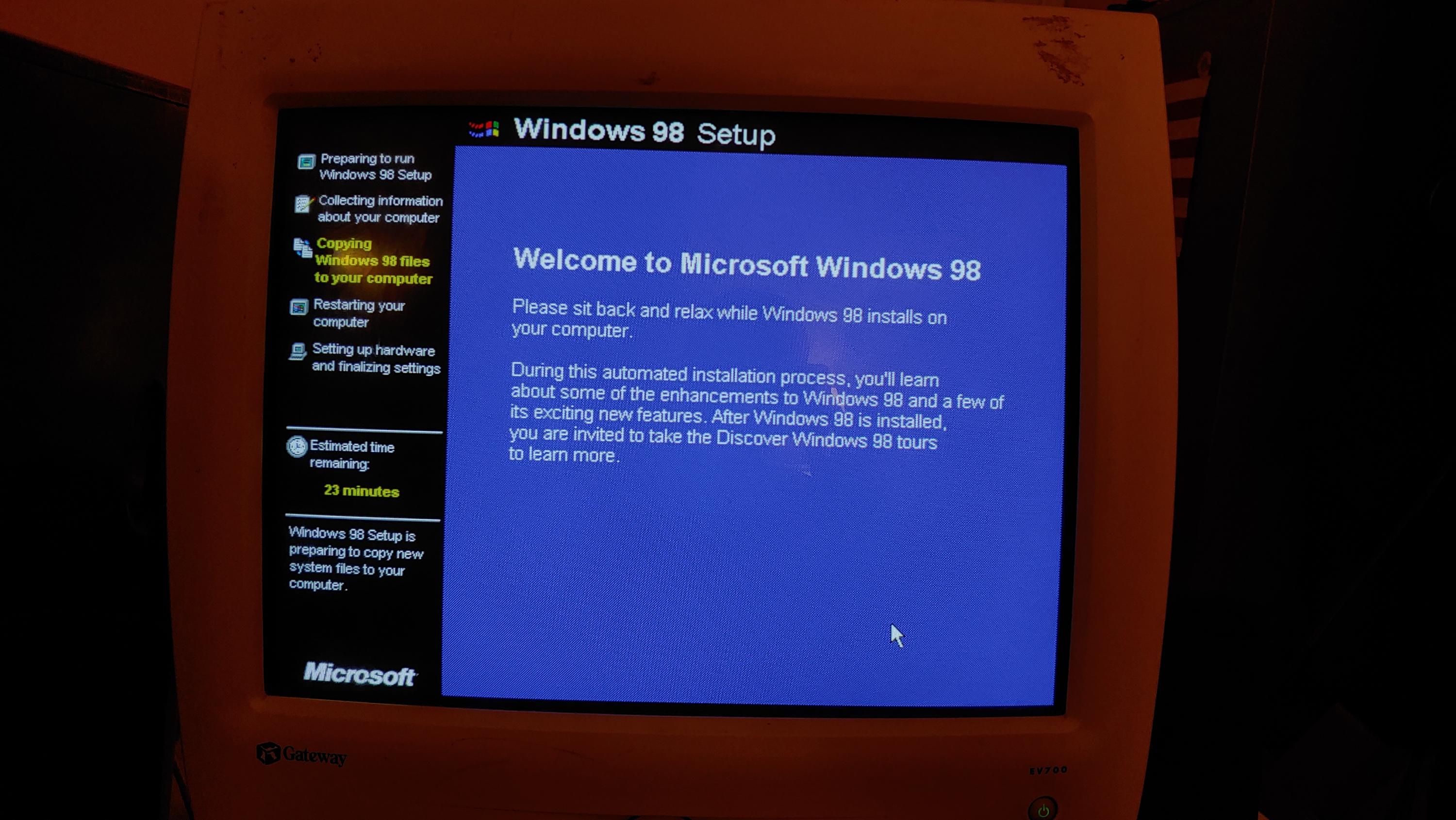

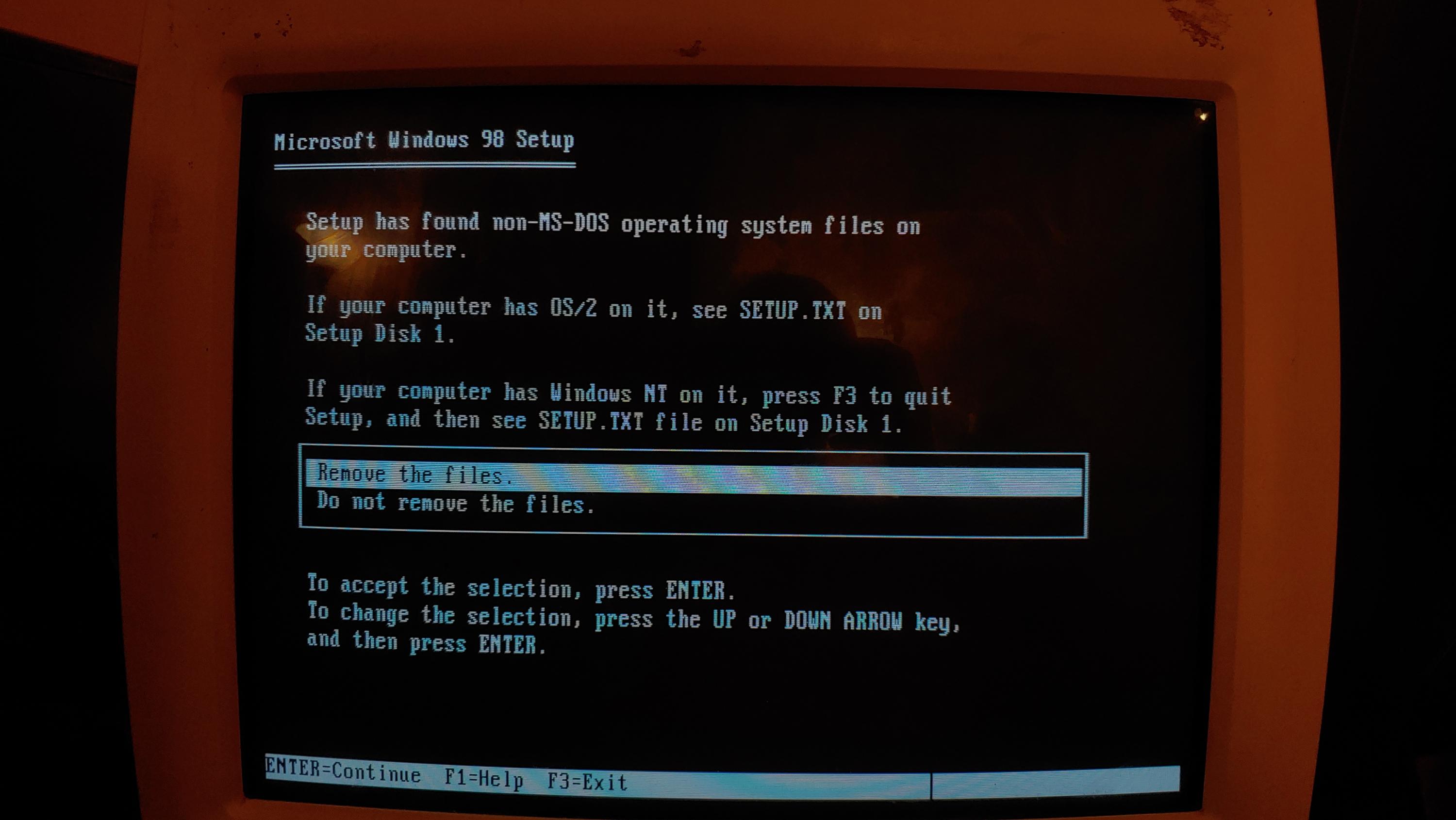

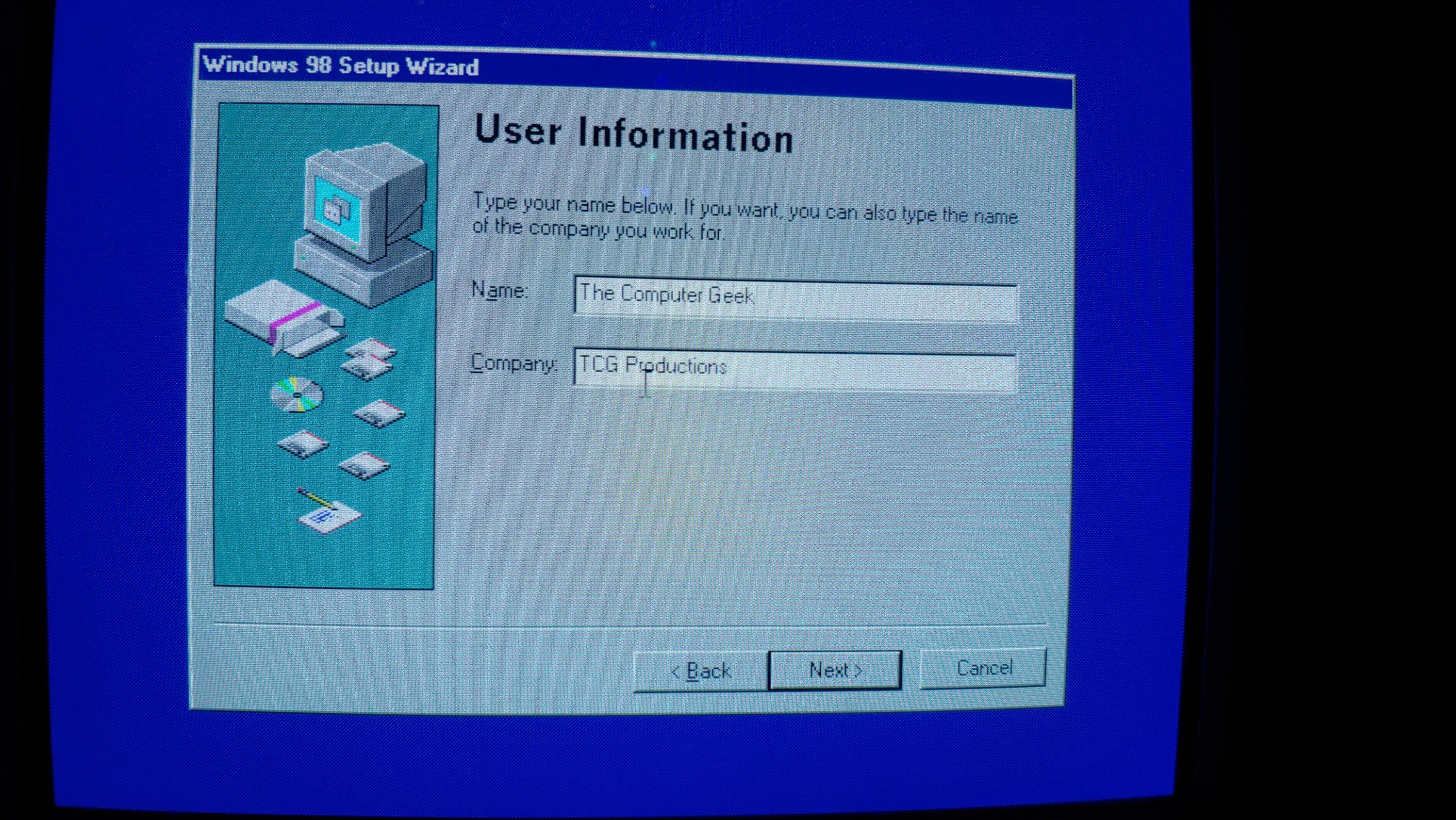

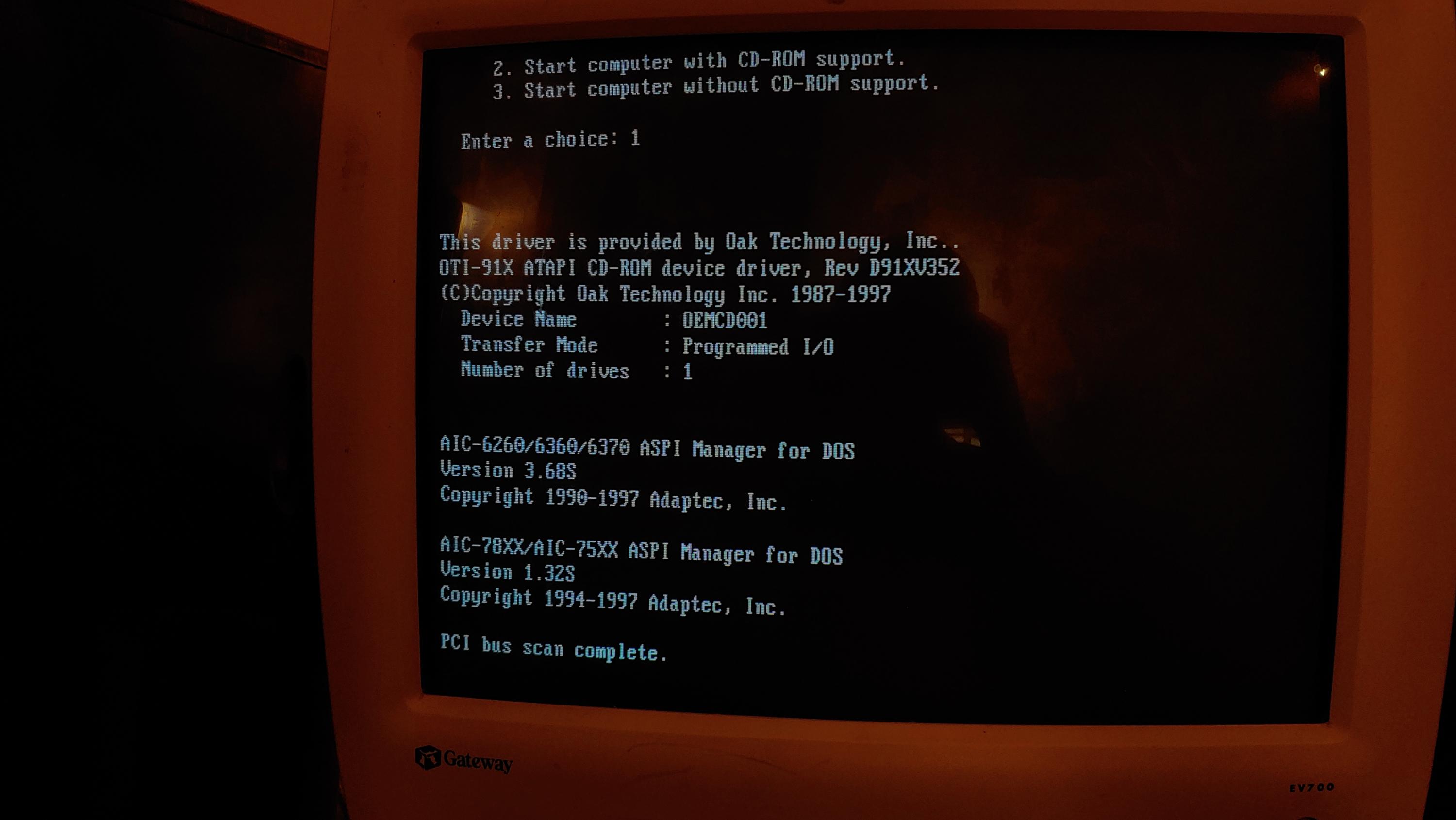

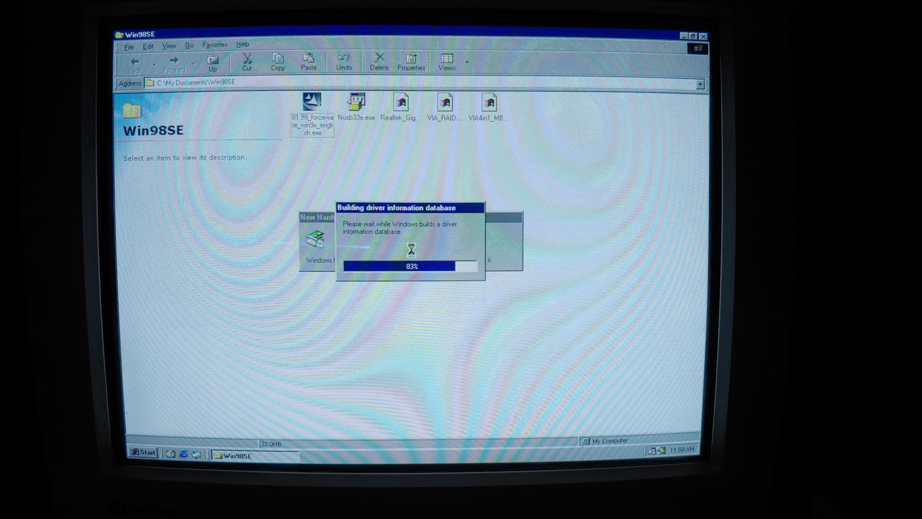

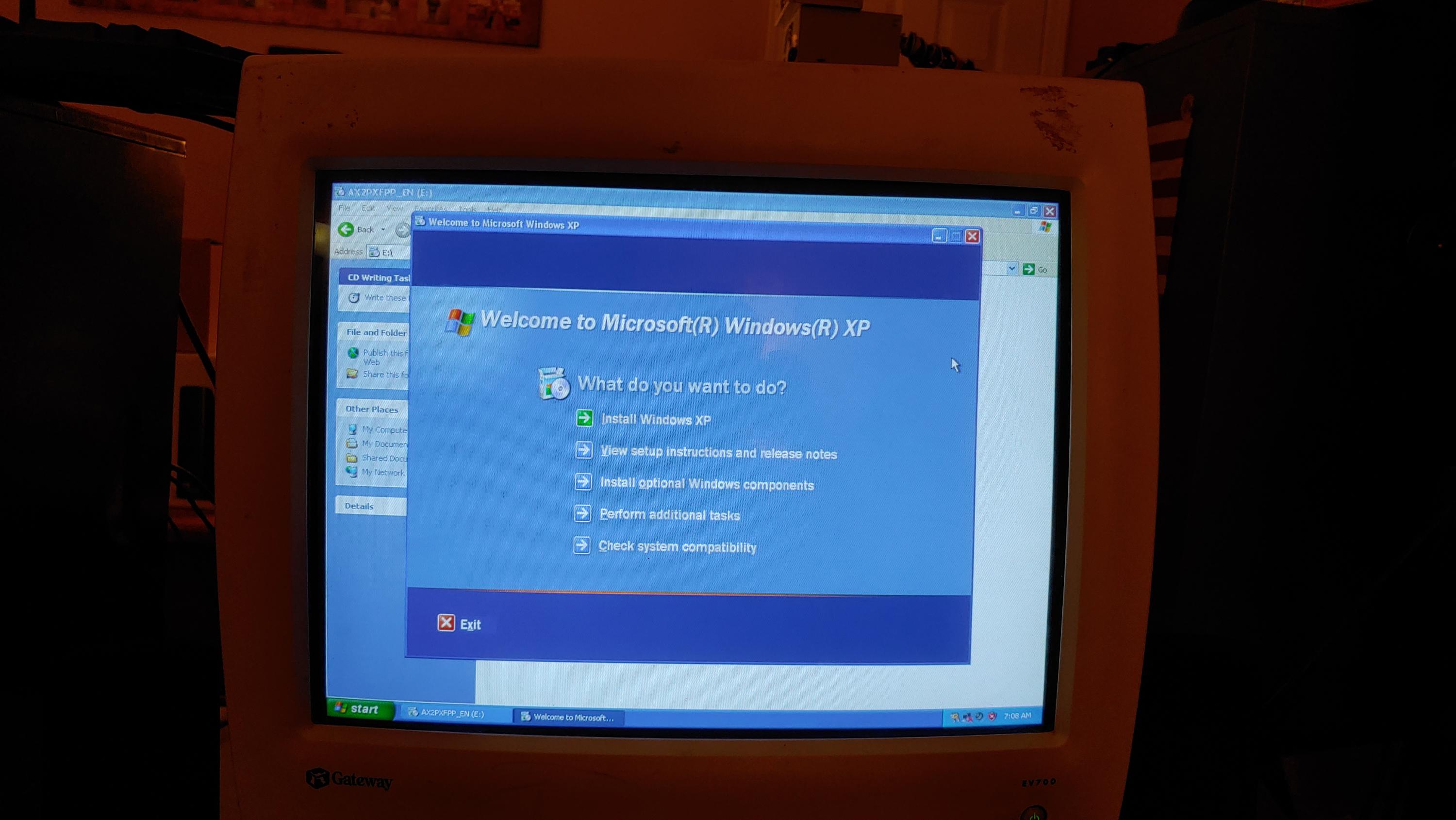

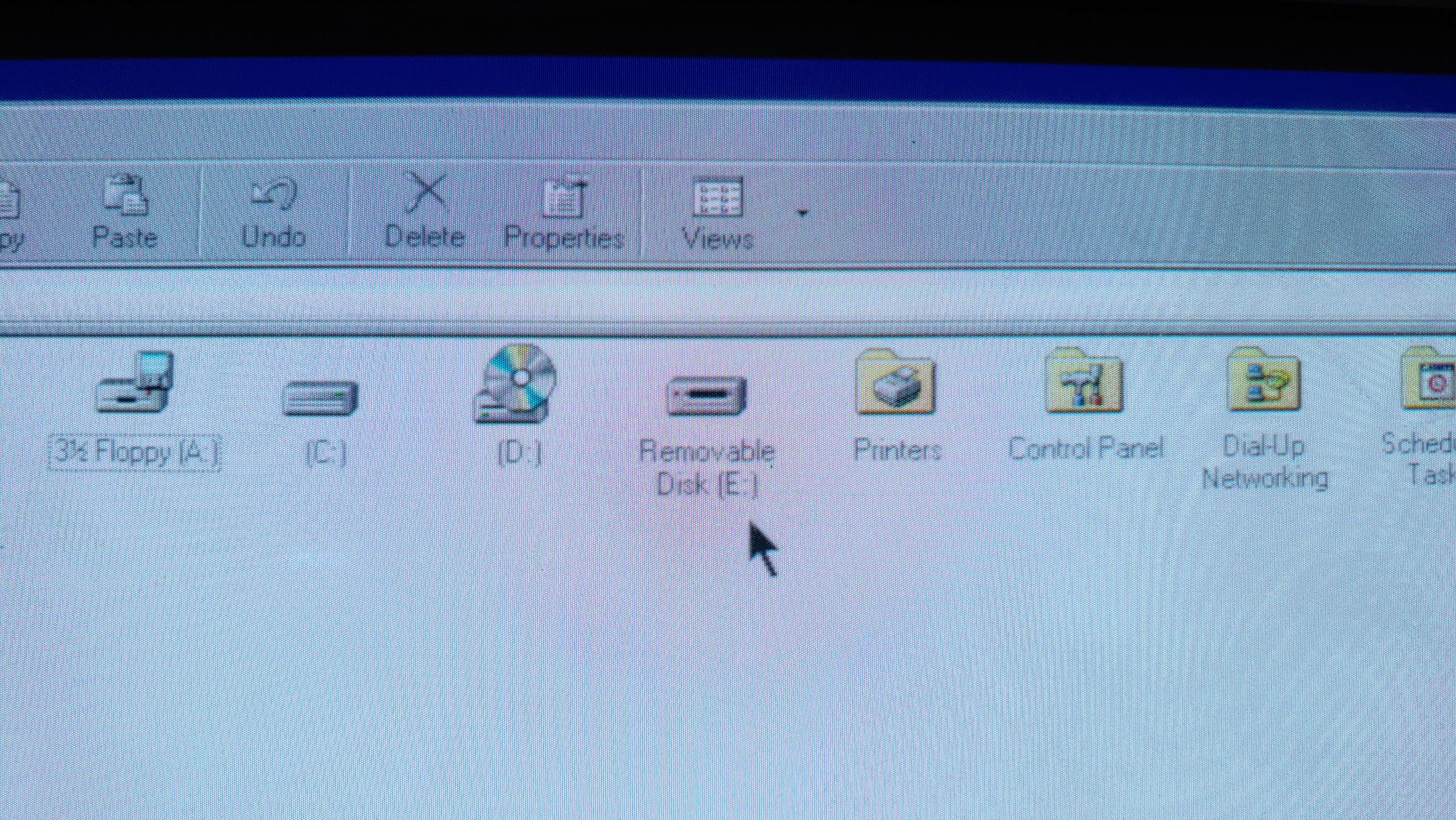

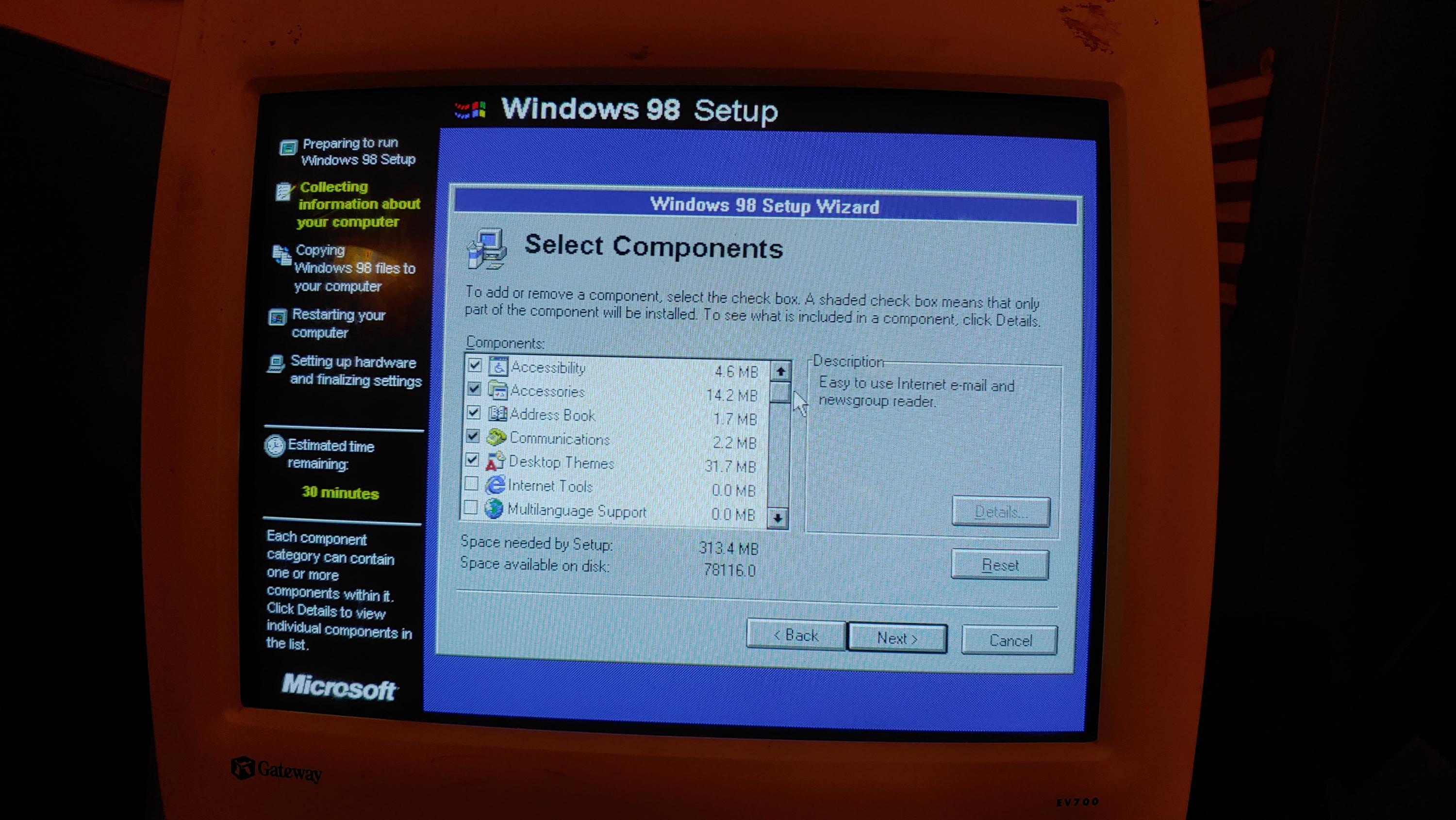

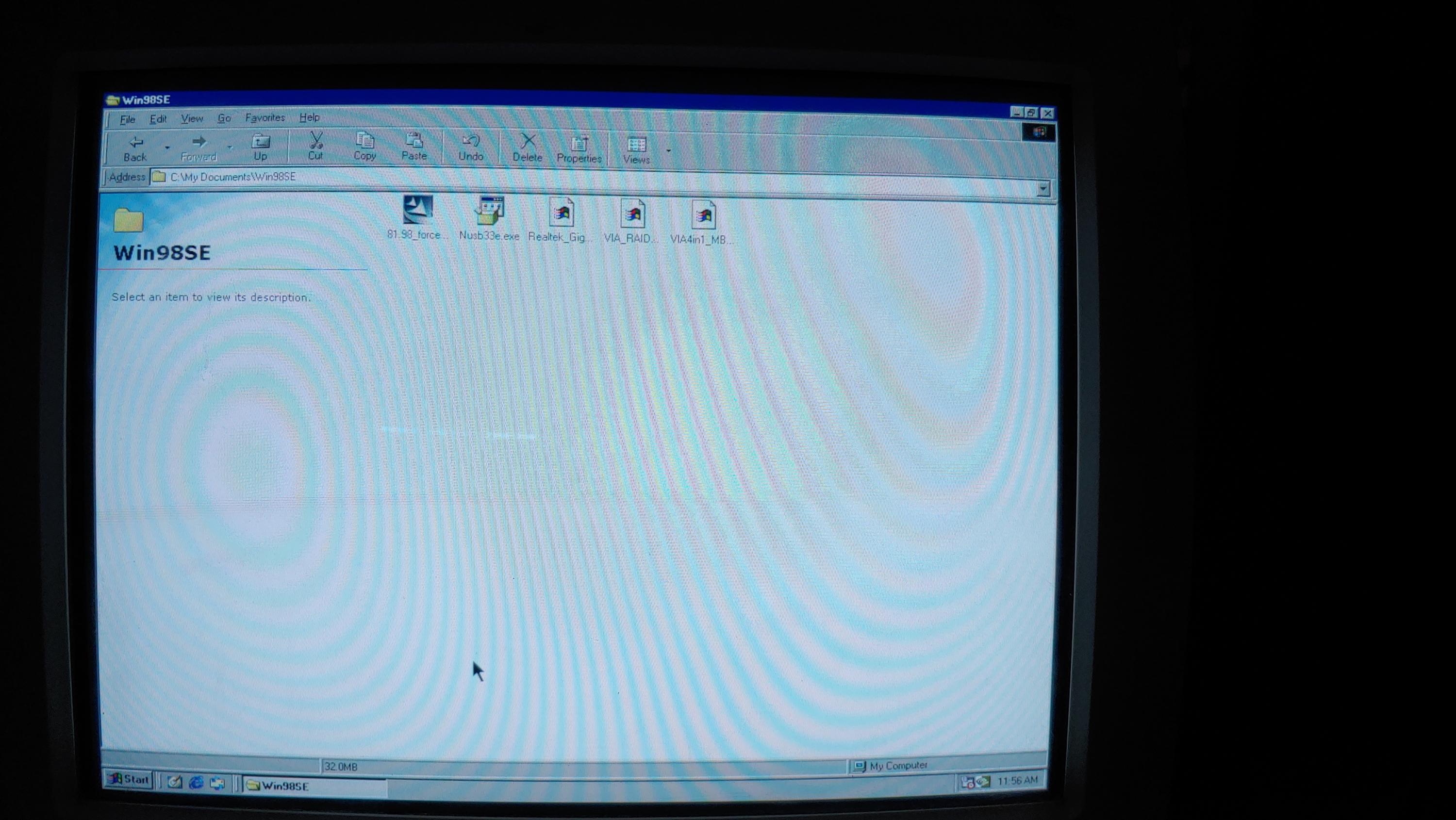

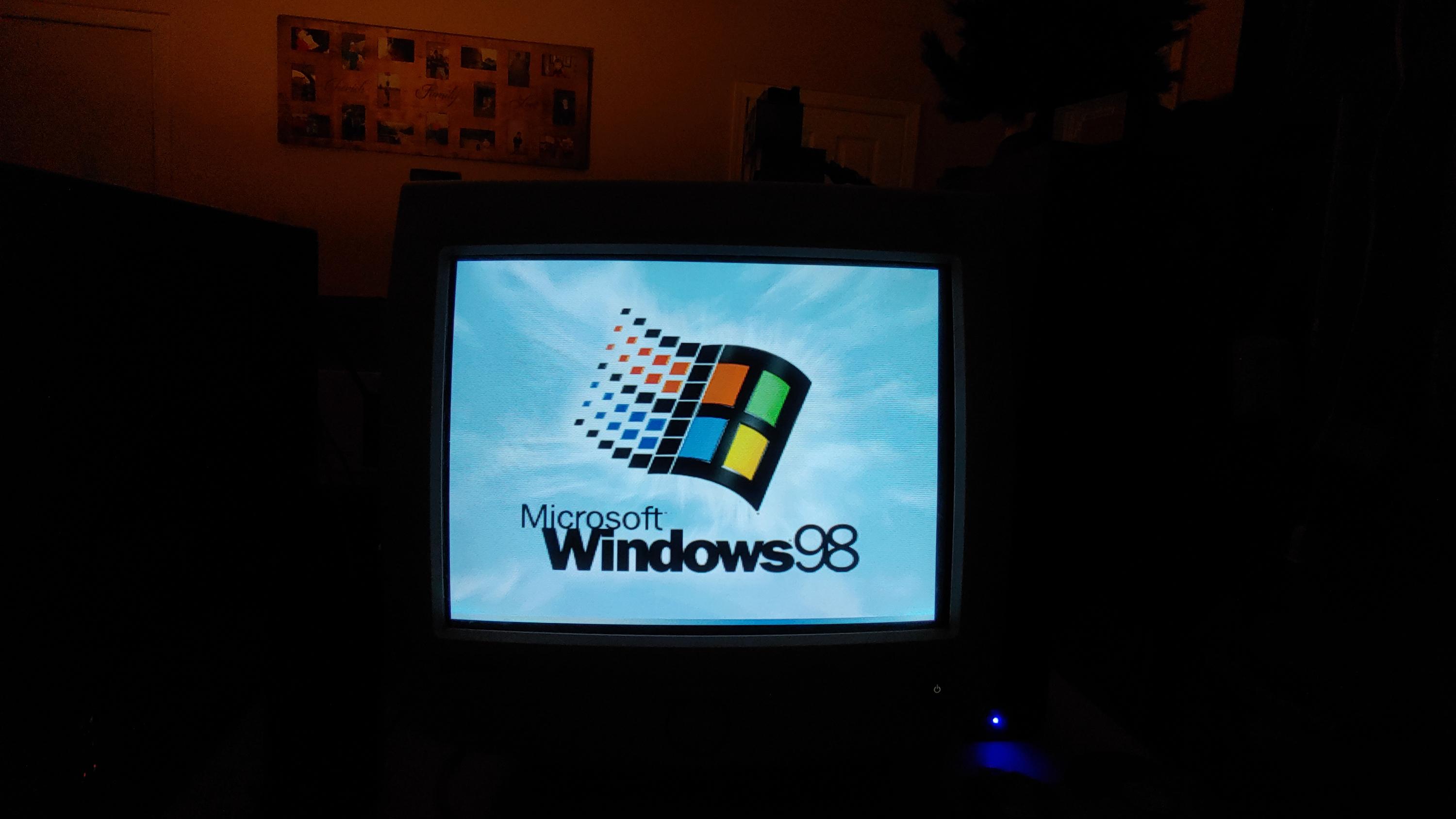

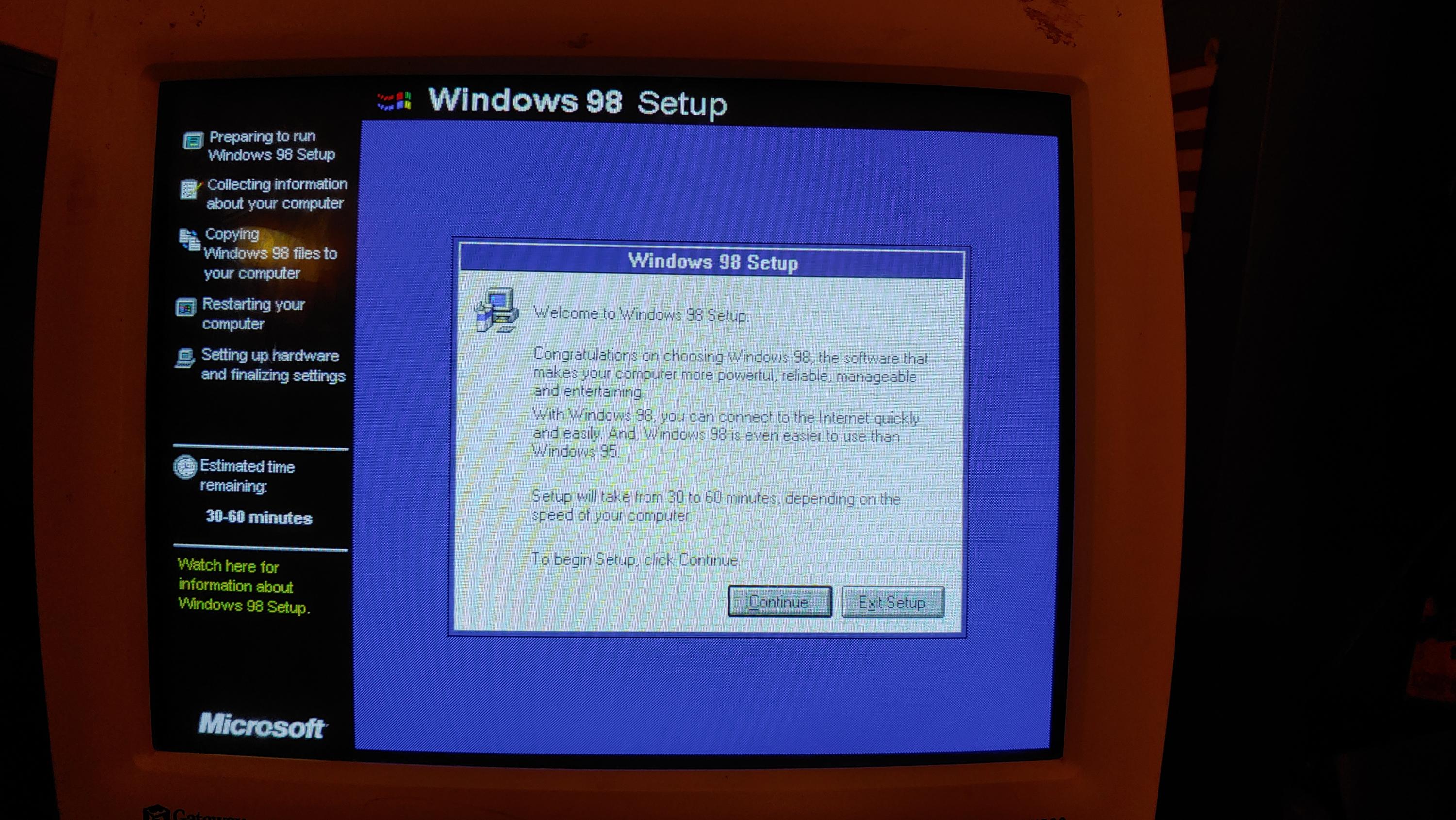

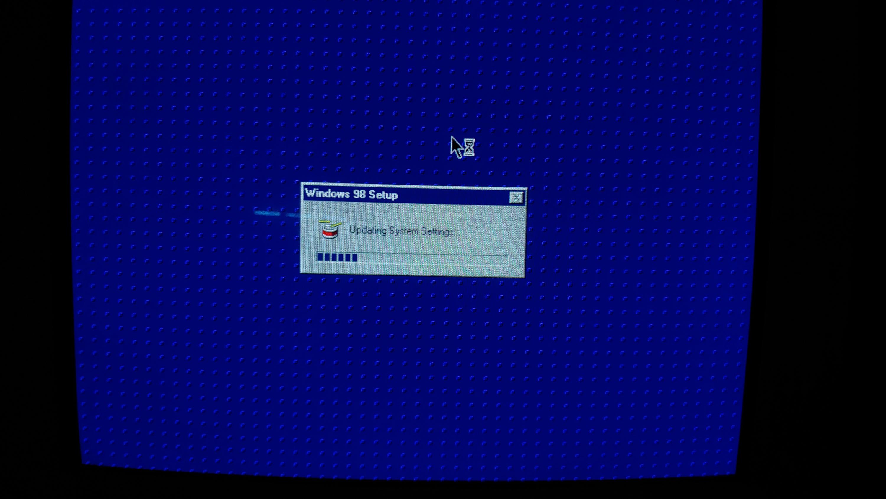

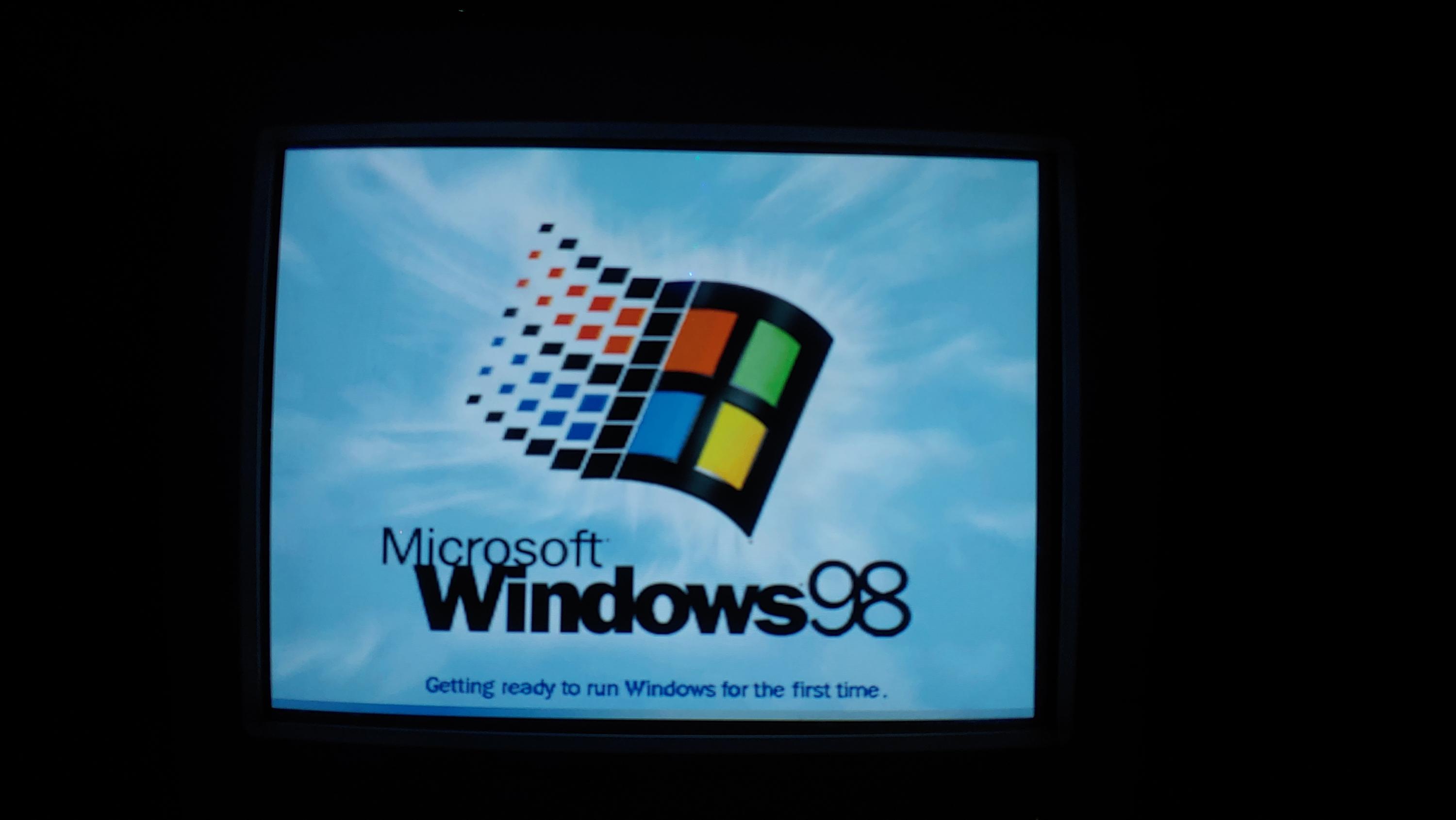

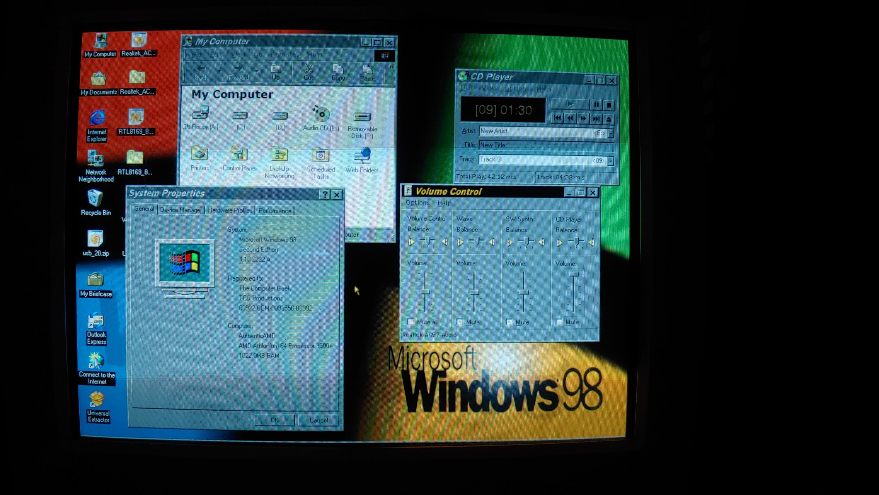

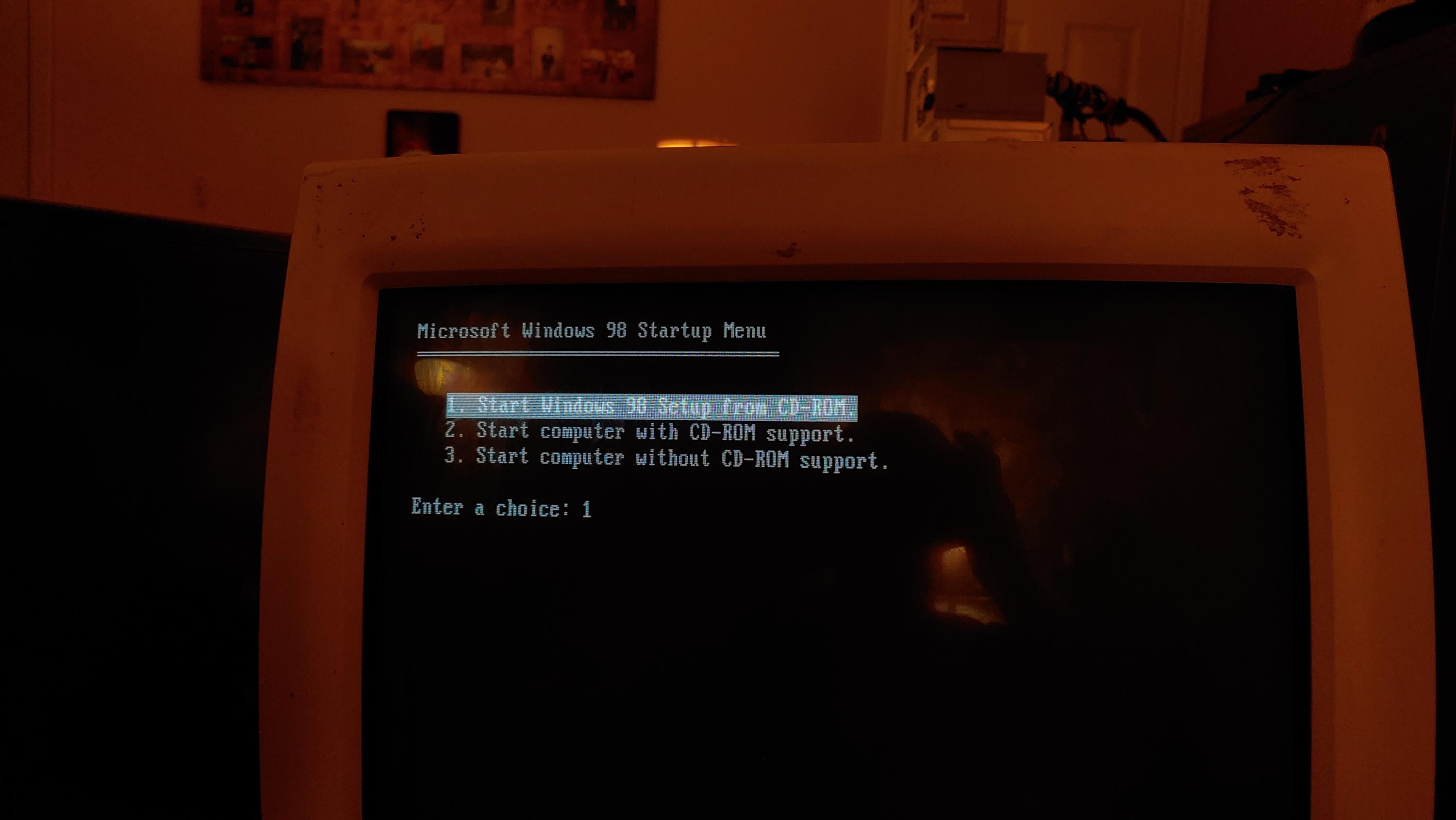

                  Burning Windows 98SE to CD...

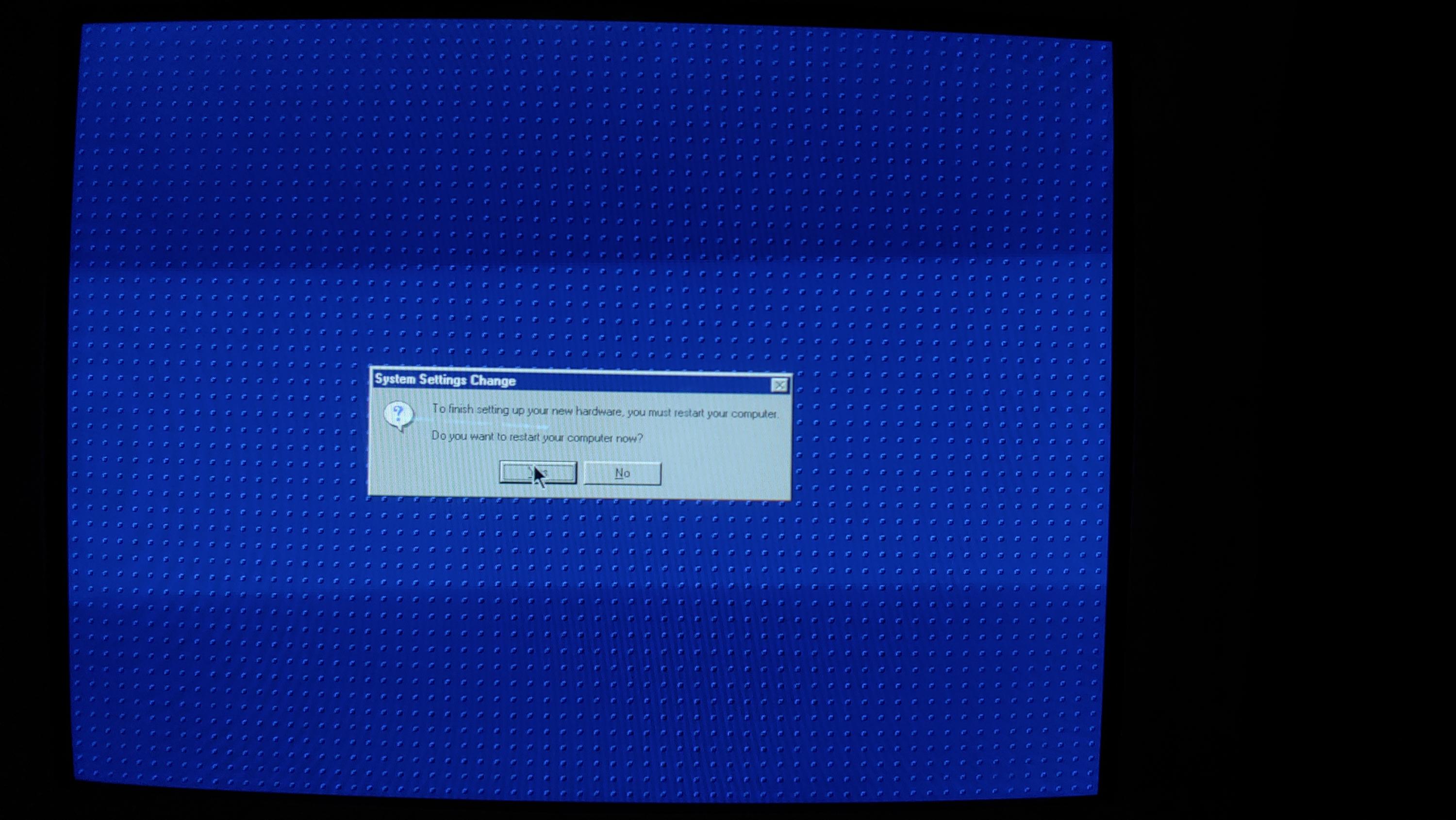

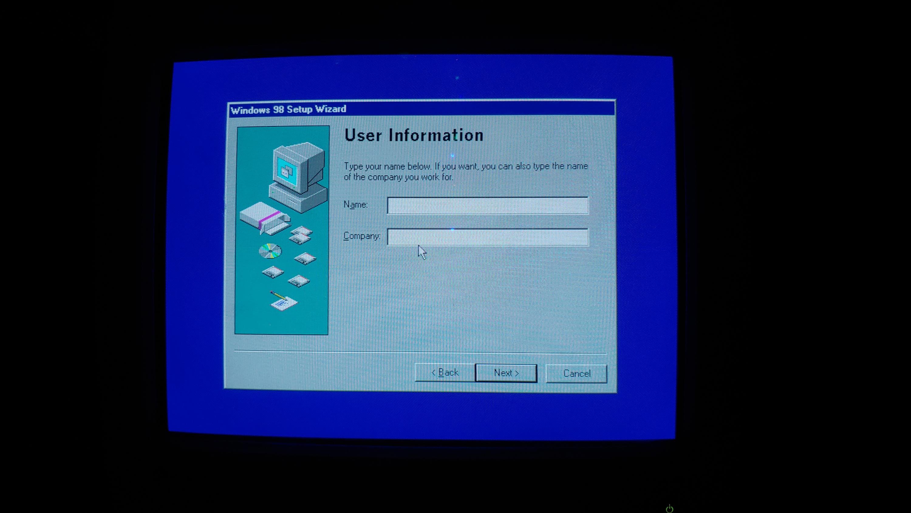

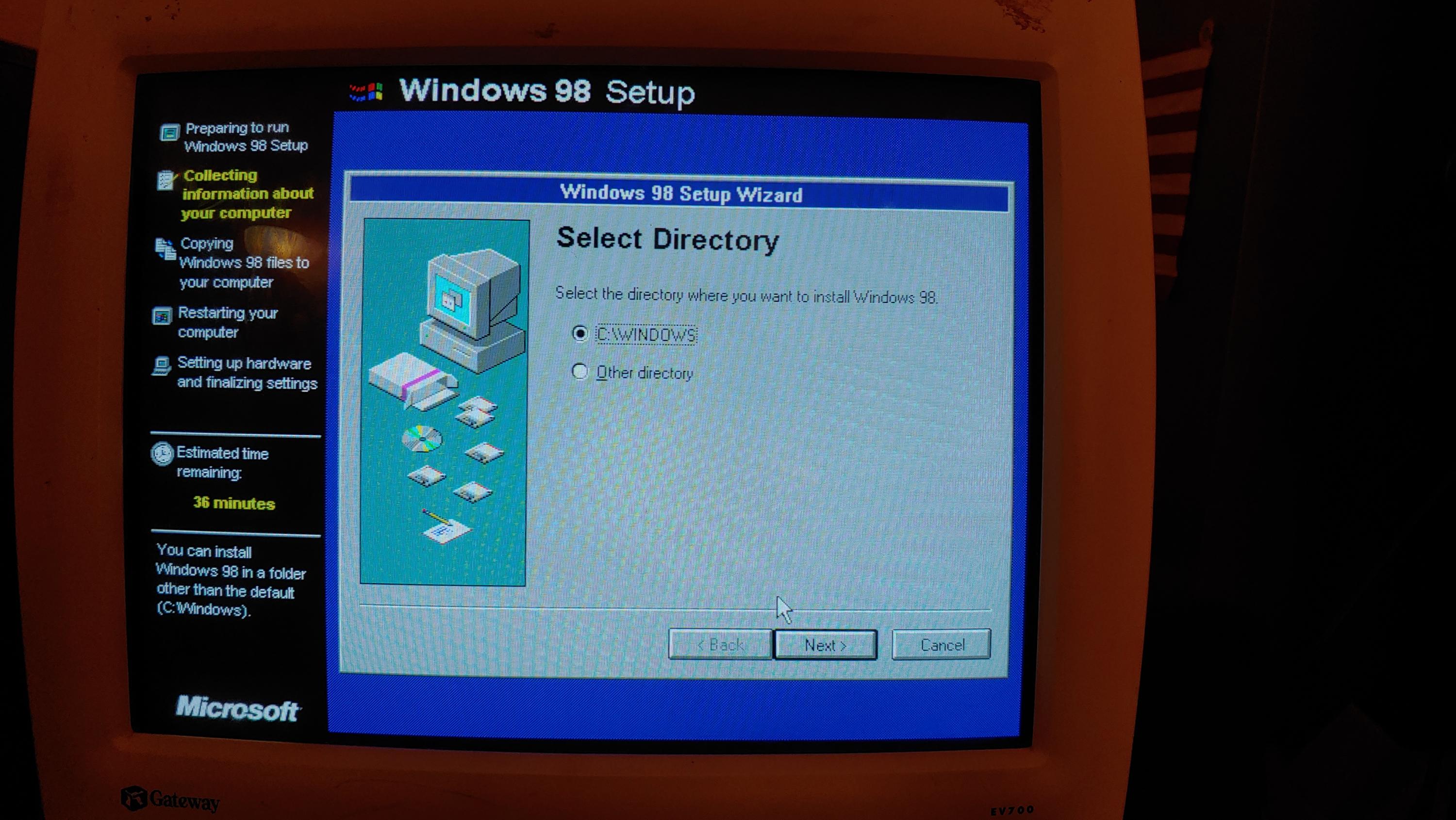

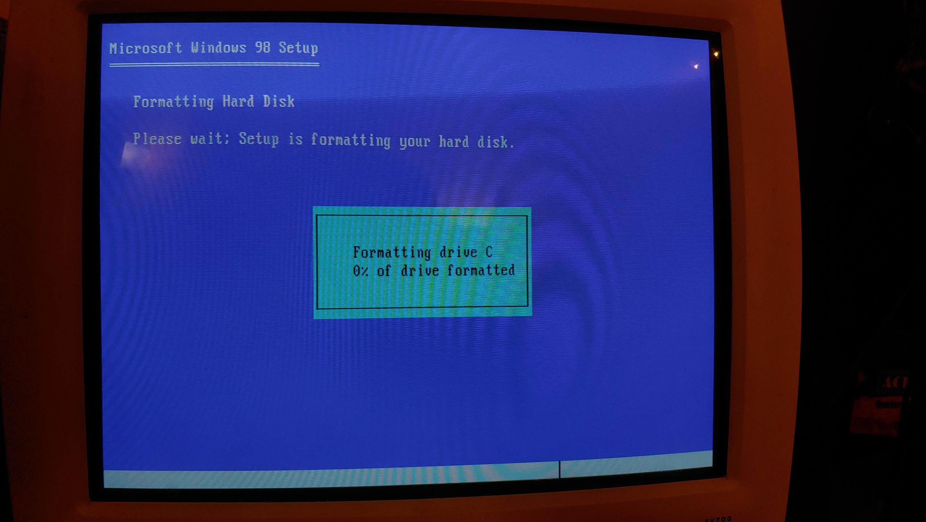

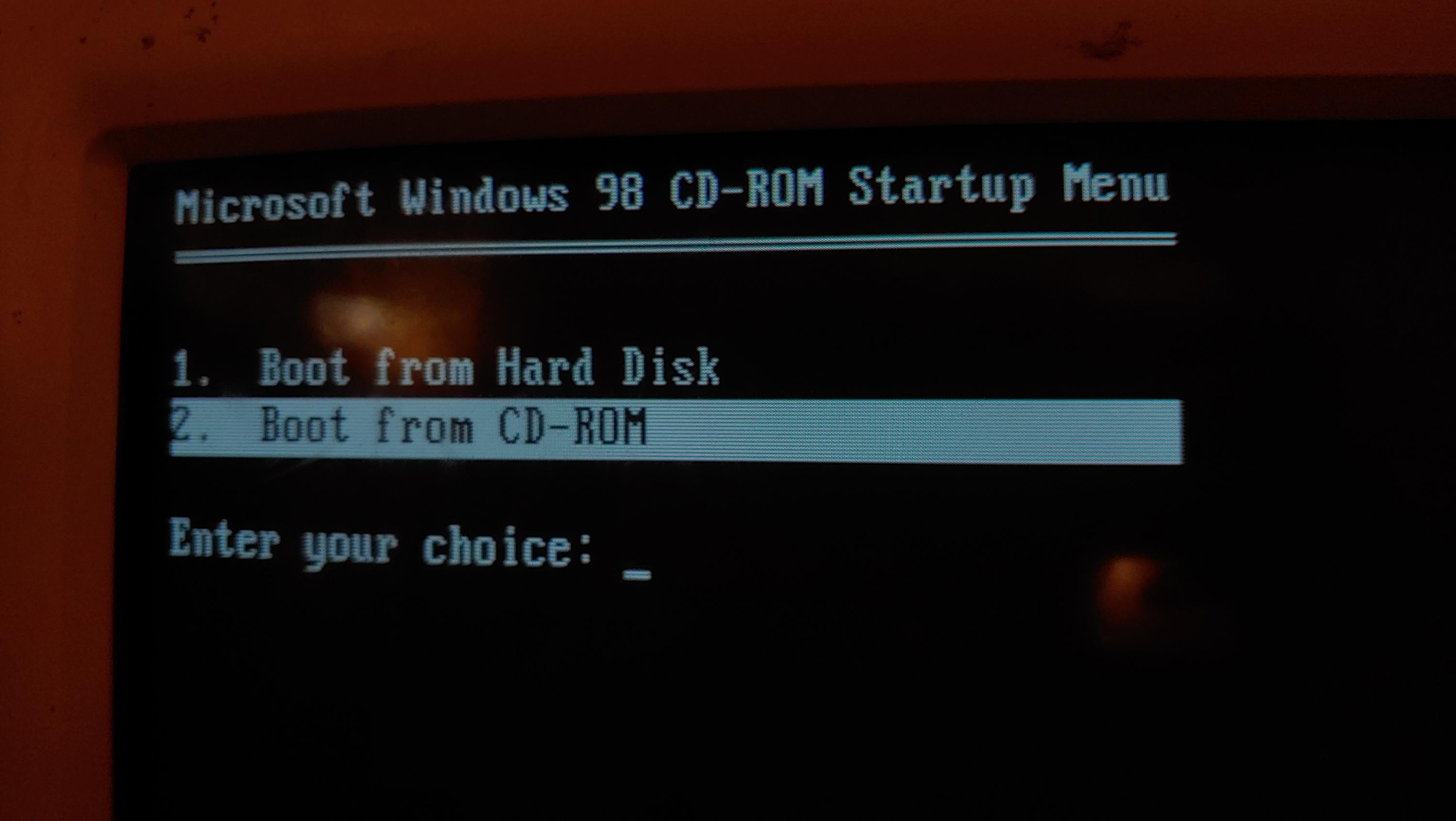

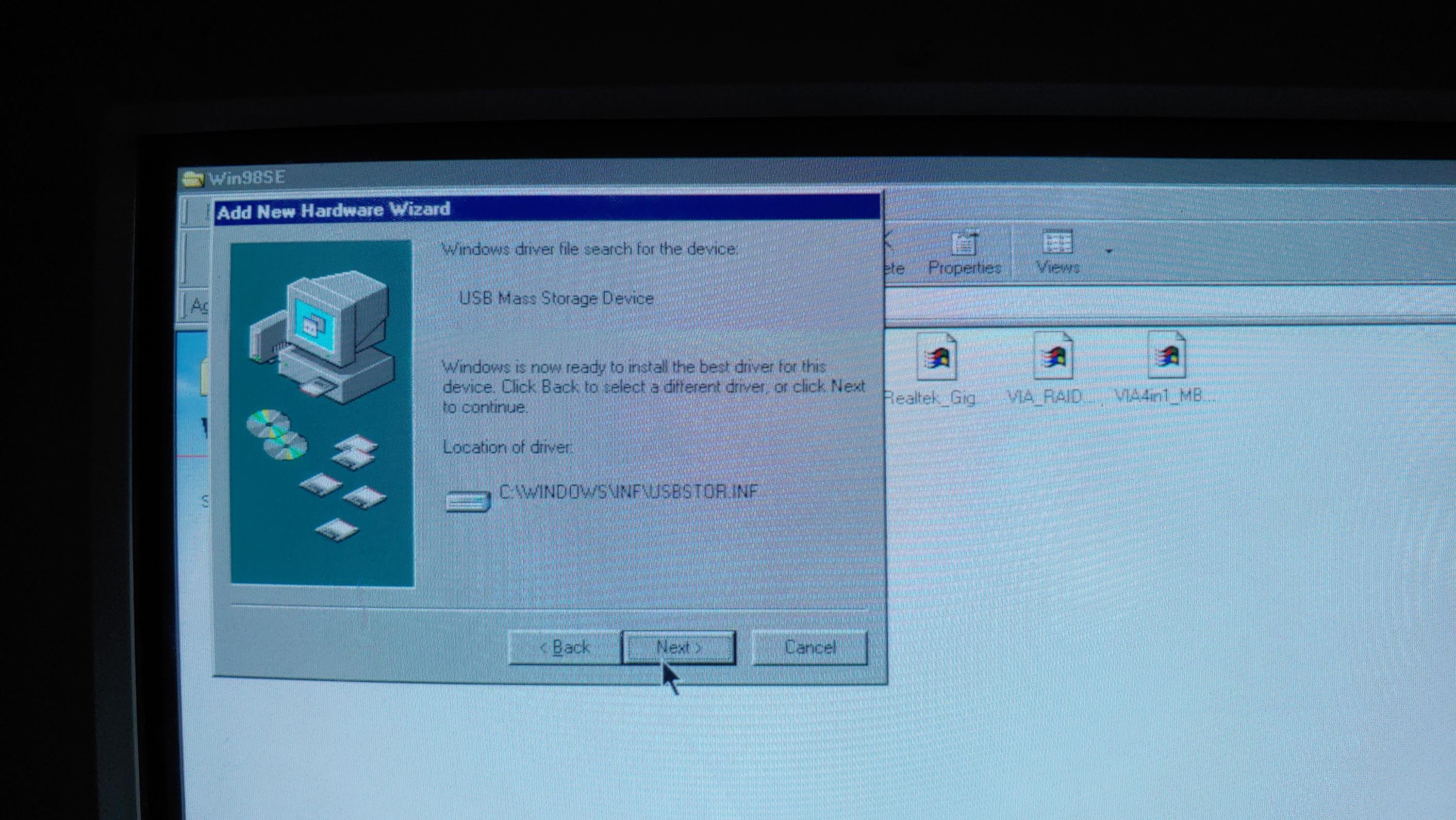

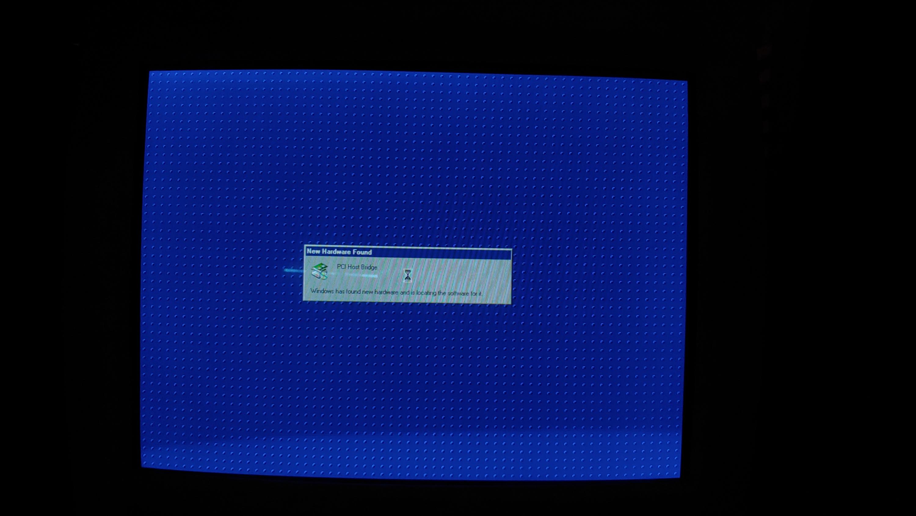

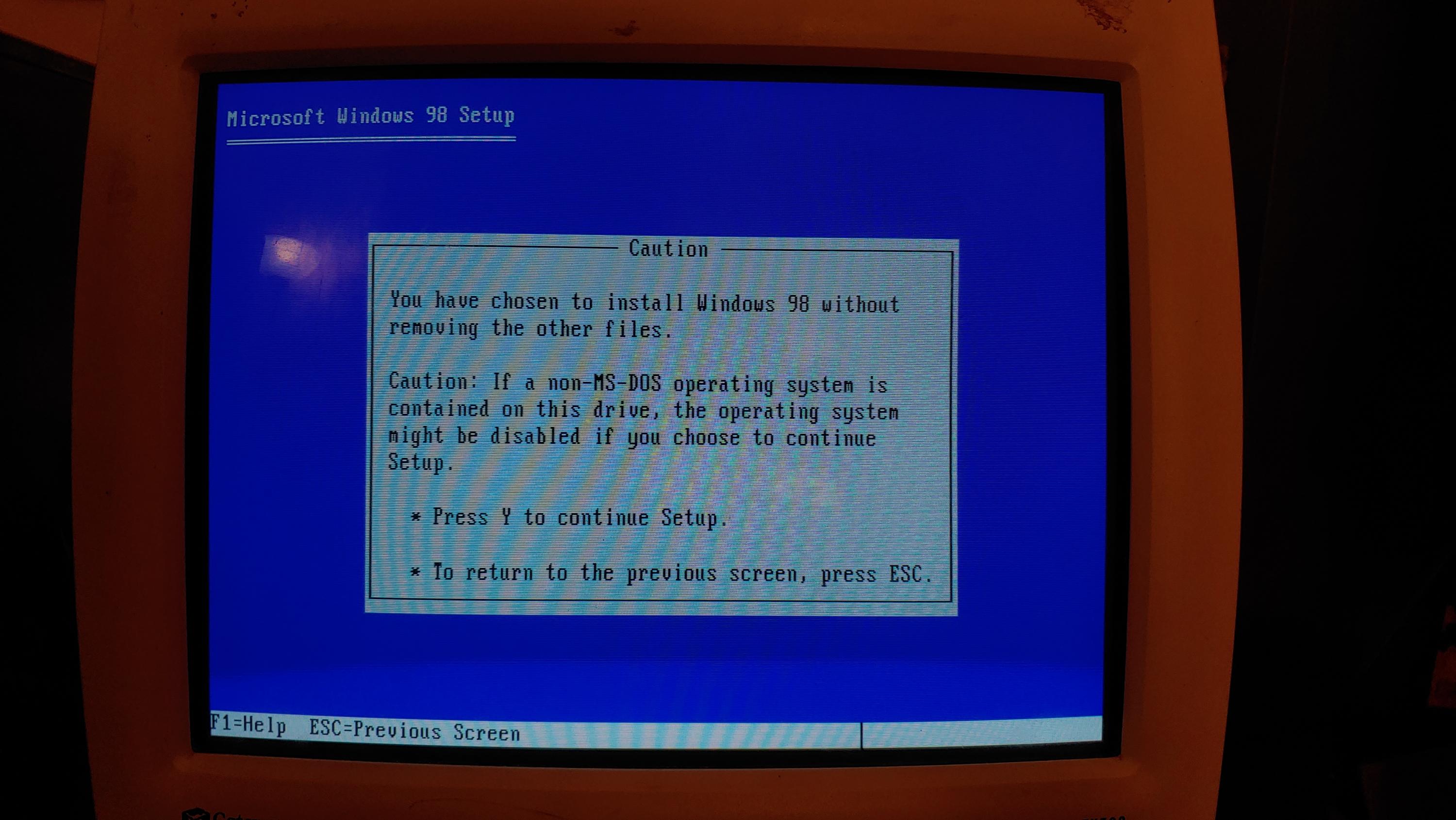

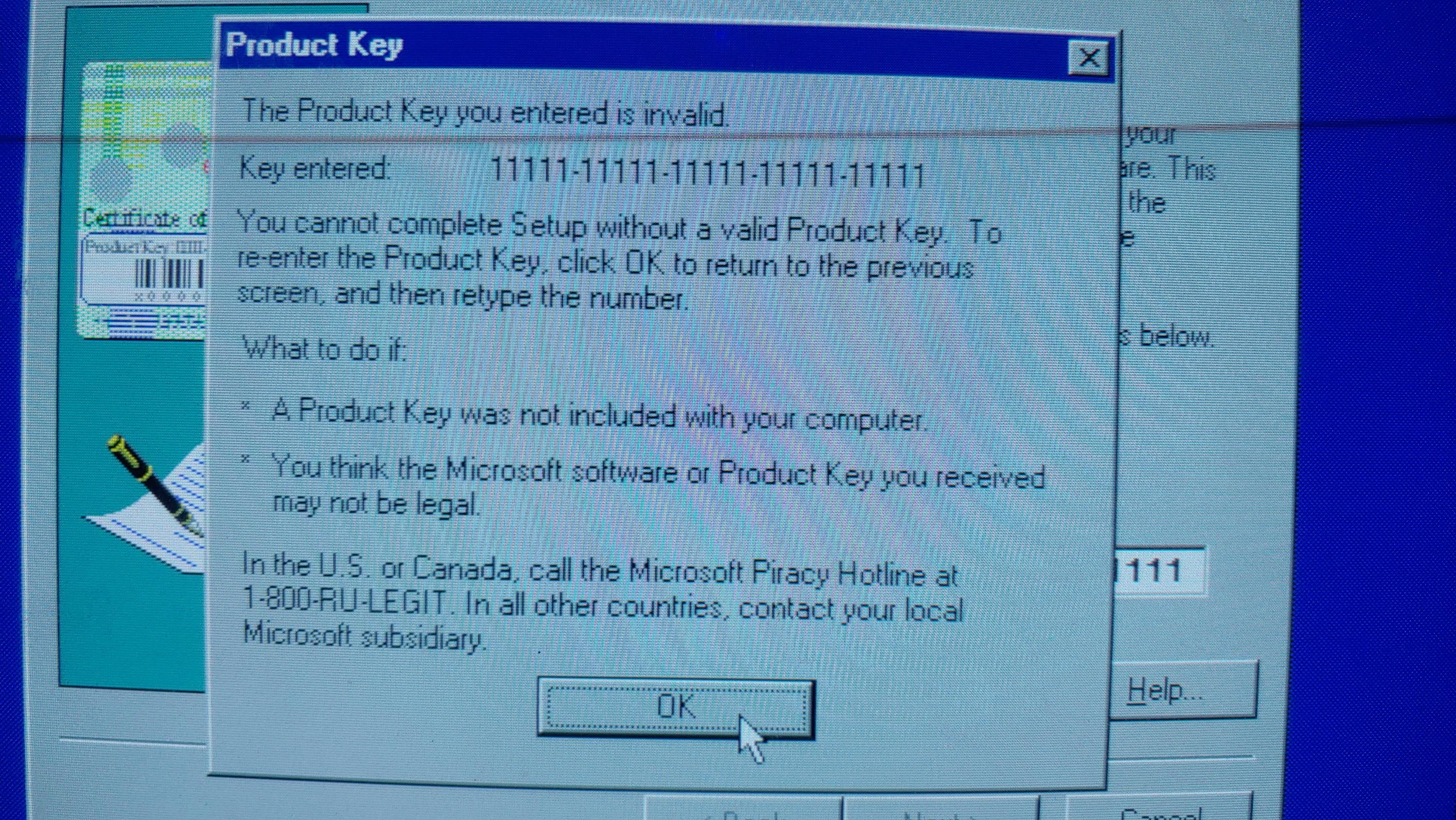

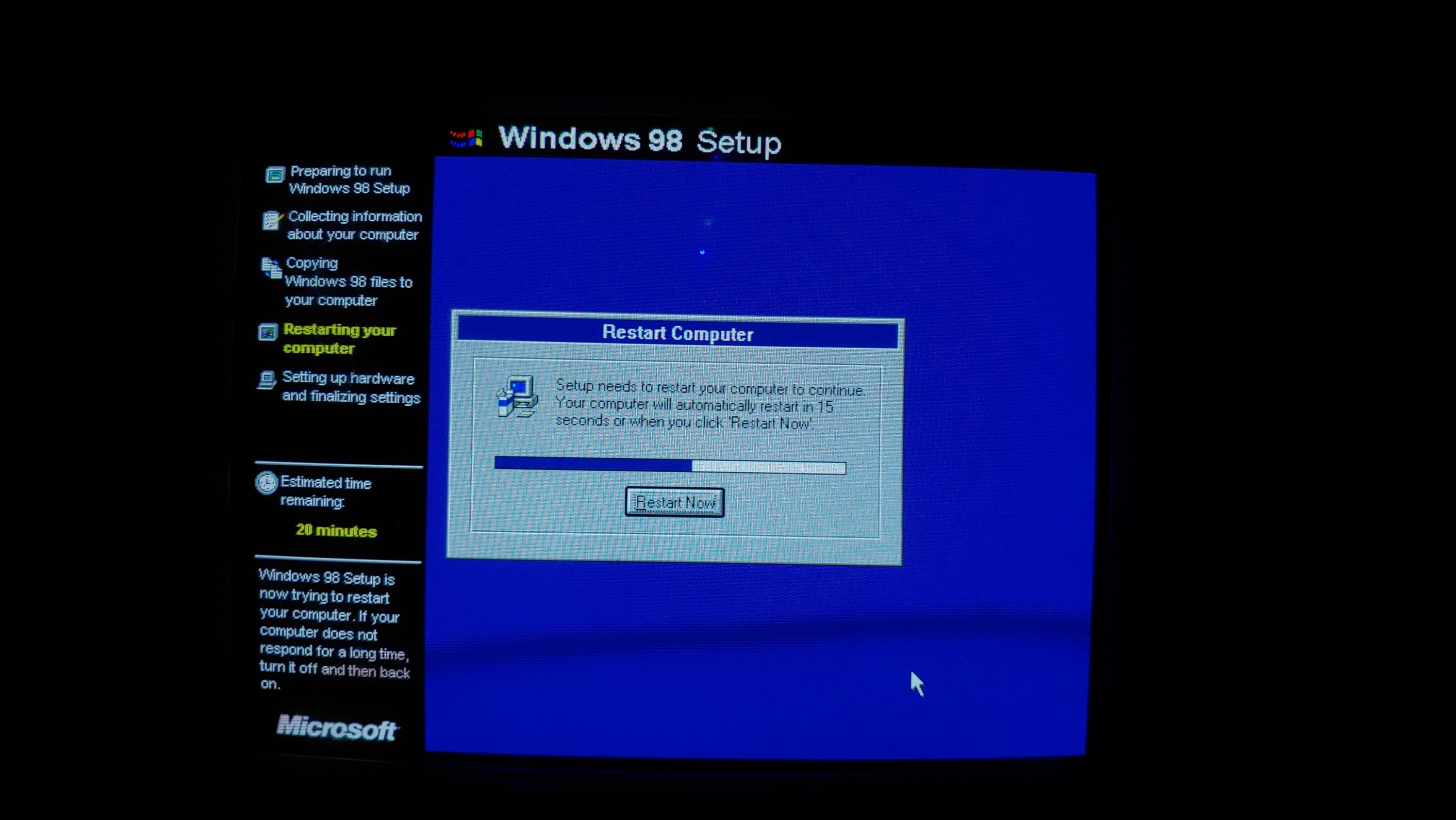

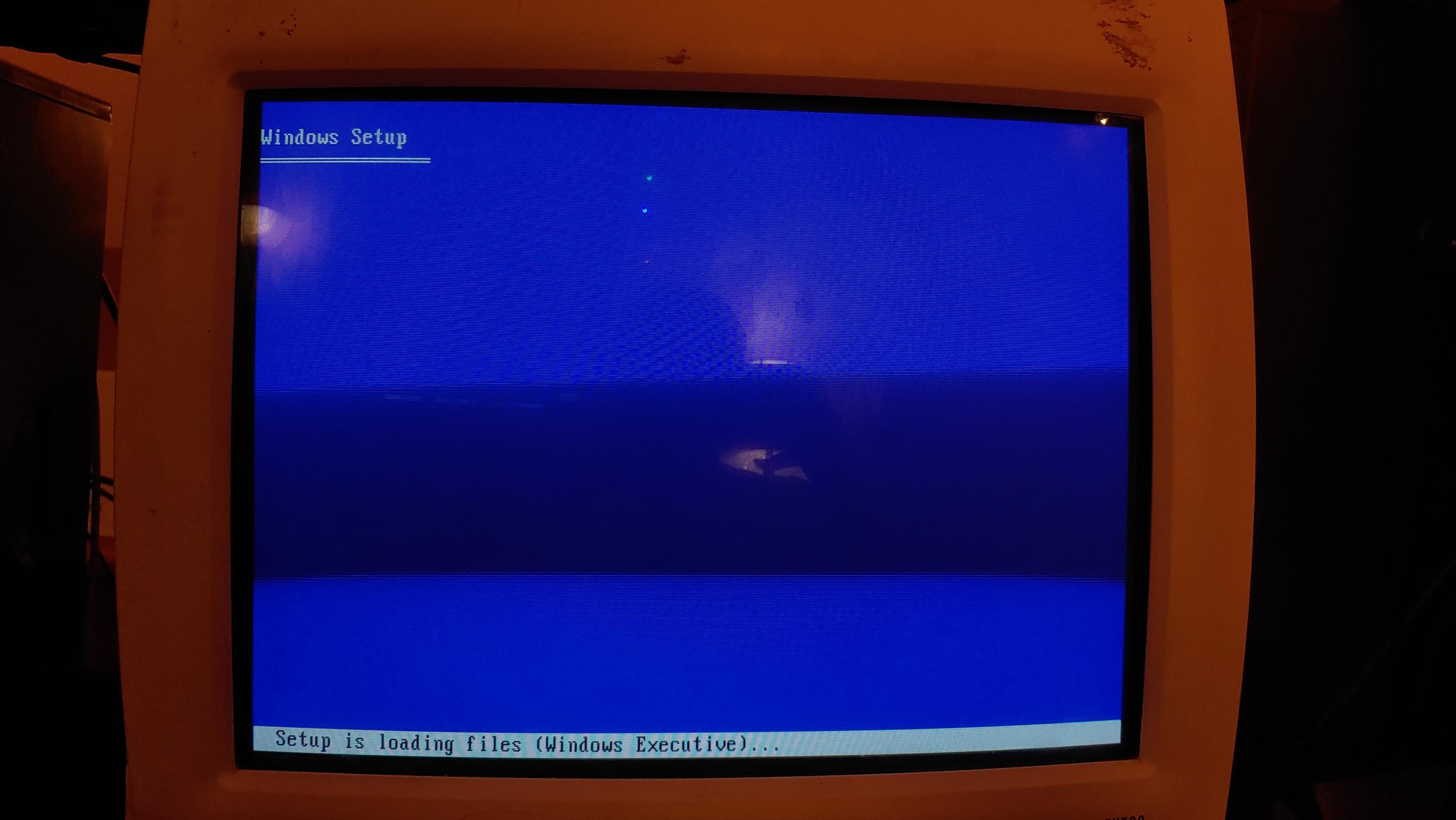

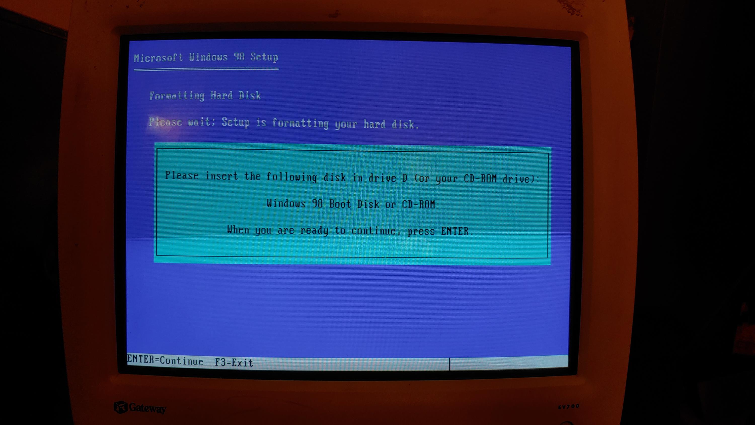

                  Booting up and installing.

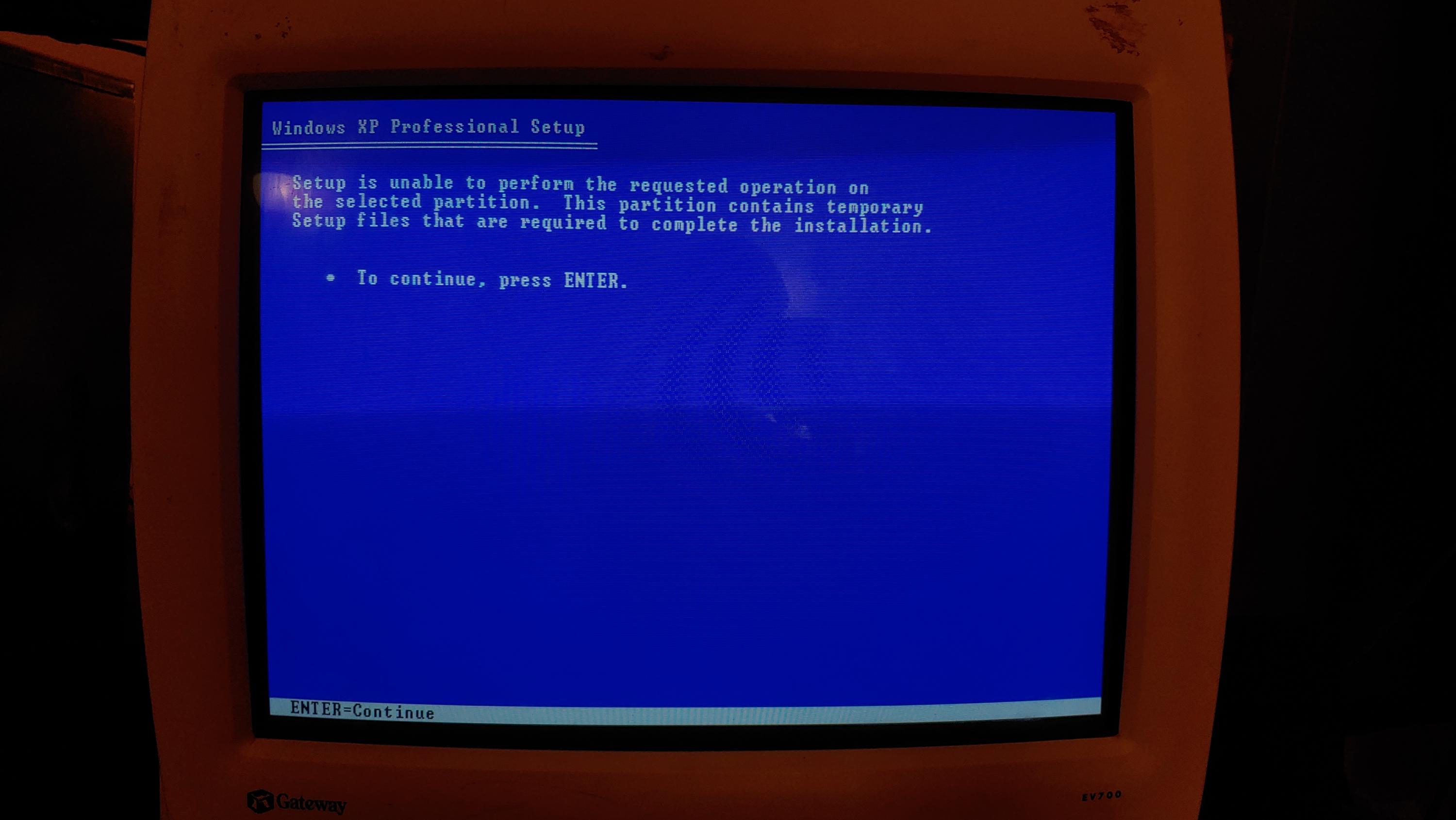

                  The first signs of a false start...

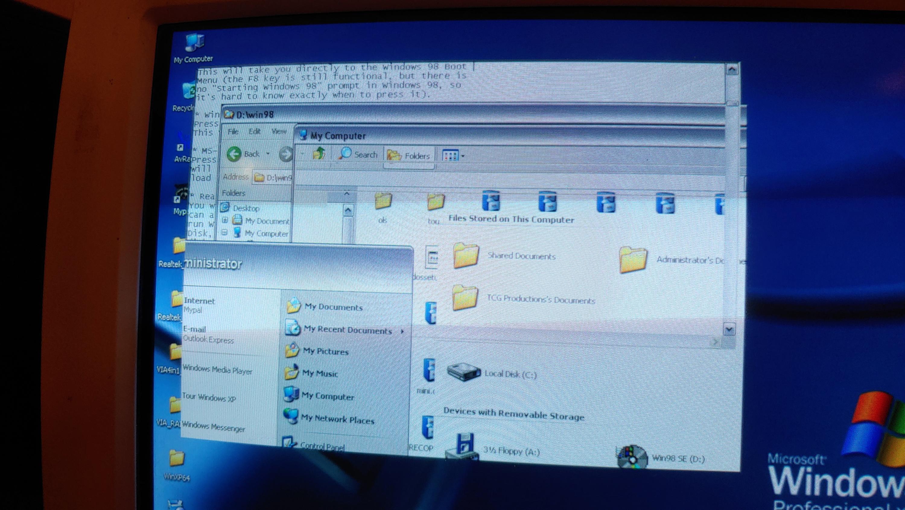

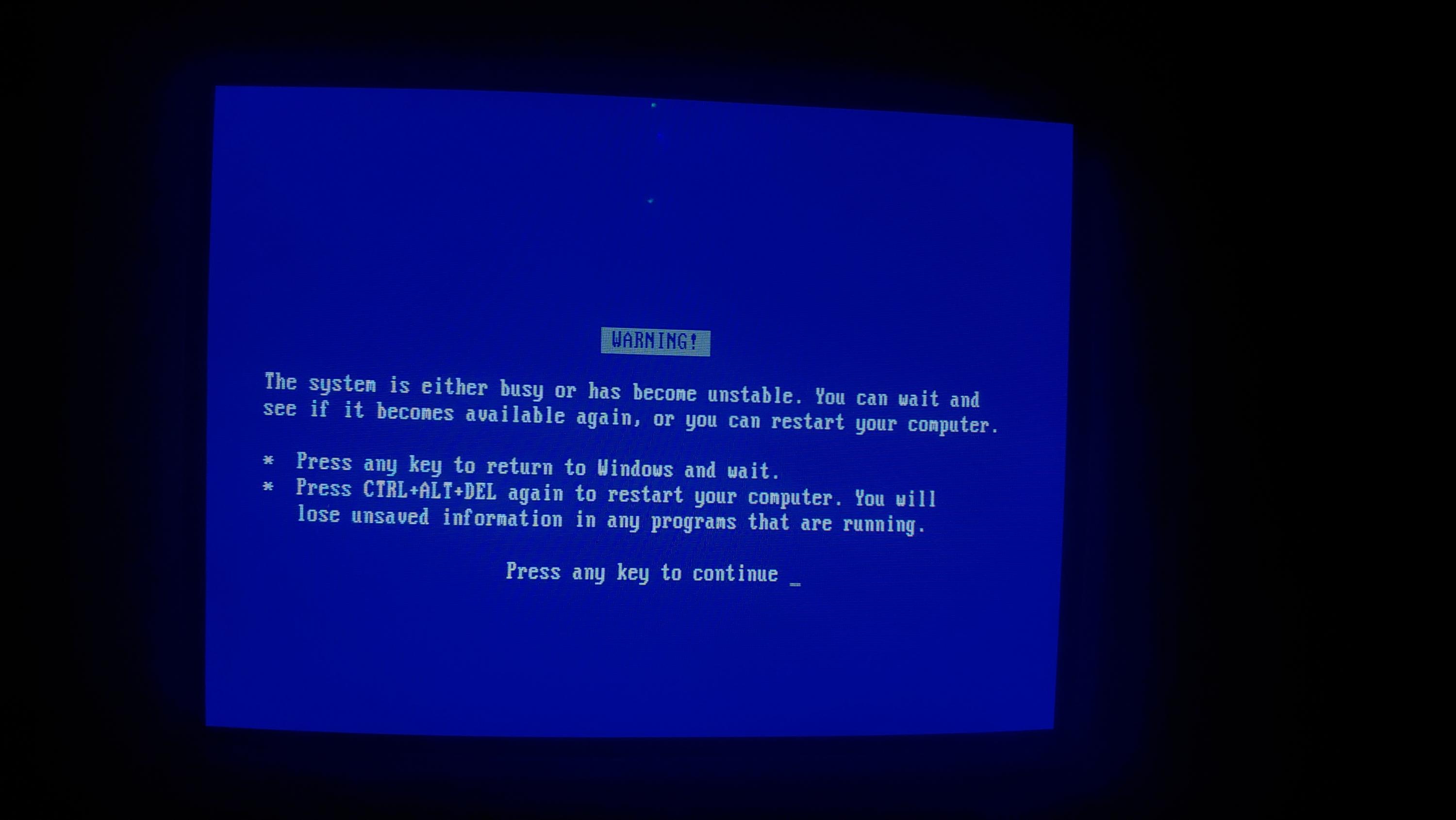

                  Reading the setup.txt file, and WinXP kinda went loopy...
                  Uhoh...
                  Unplugging the WinXP drive straightens things right out.

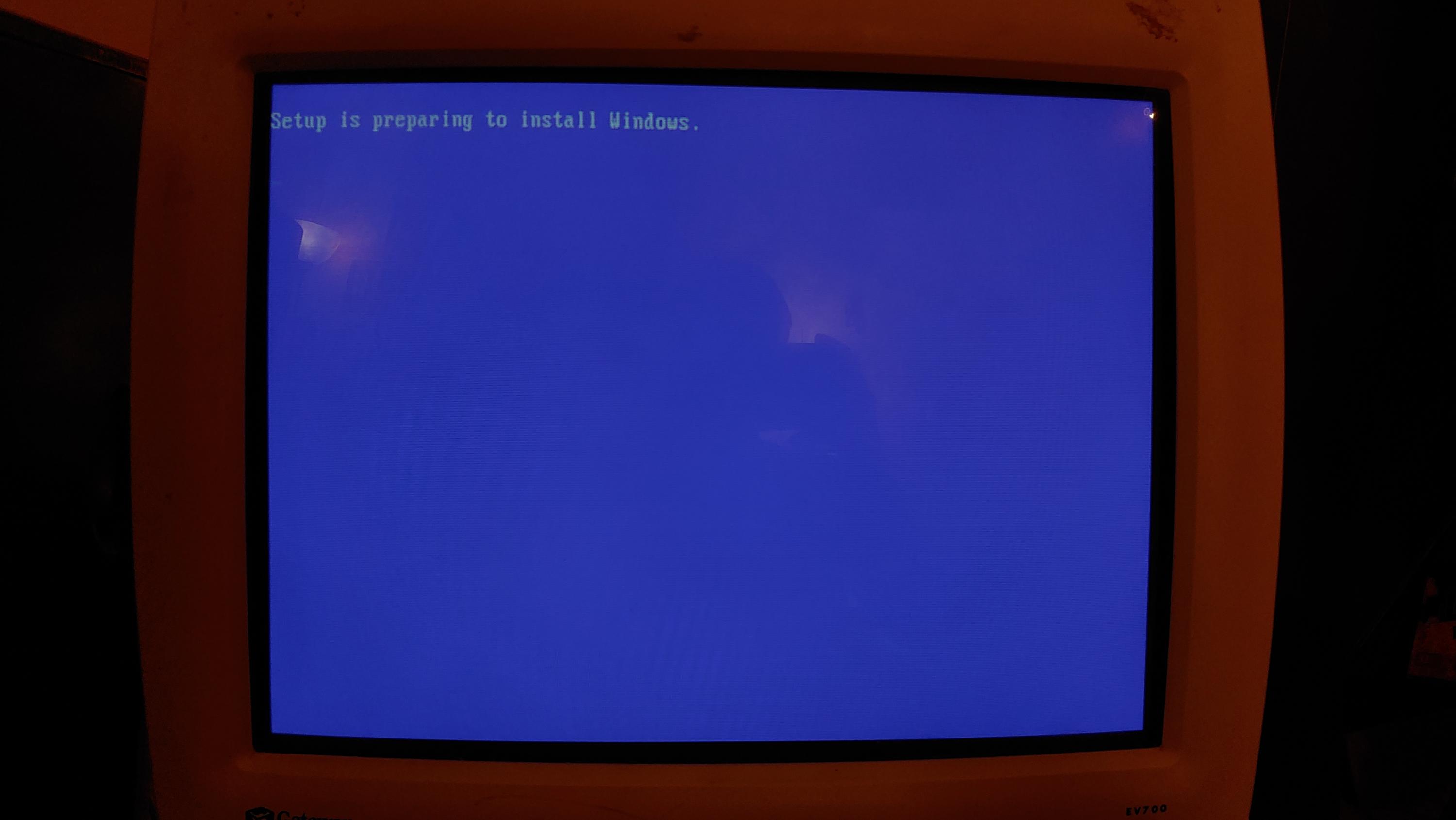

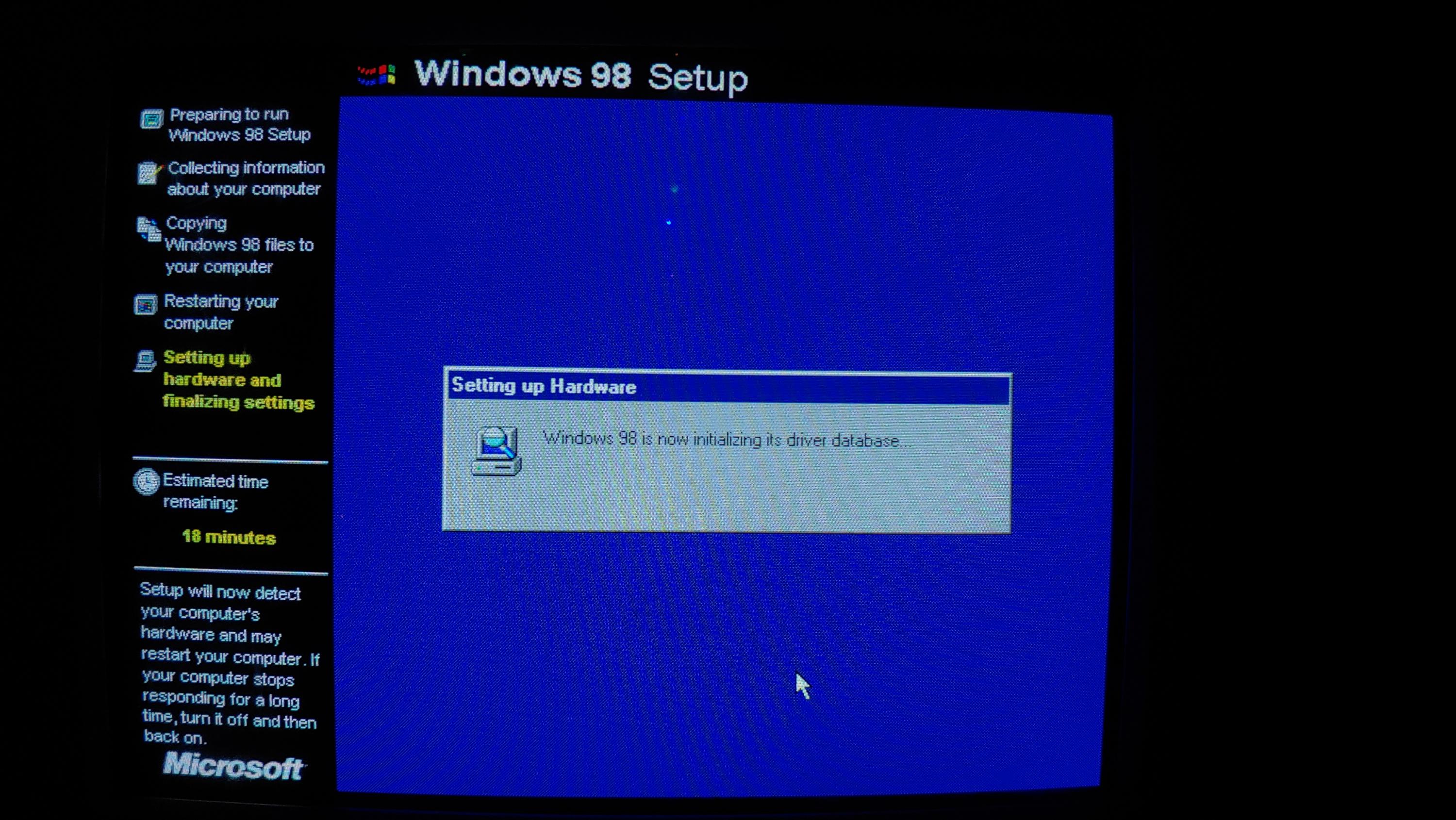

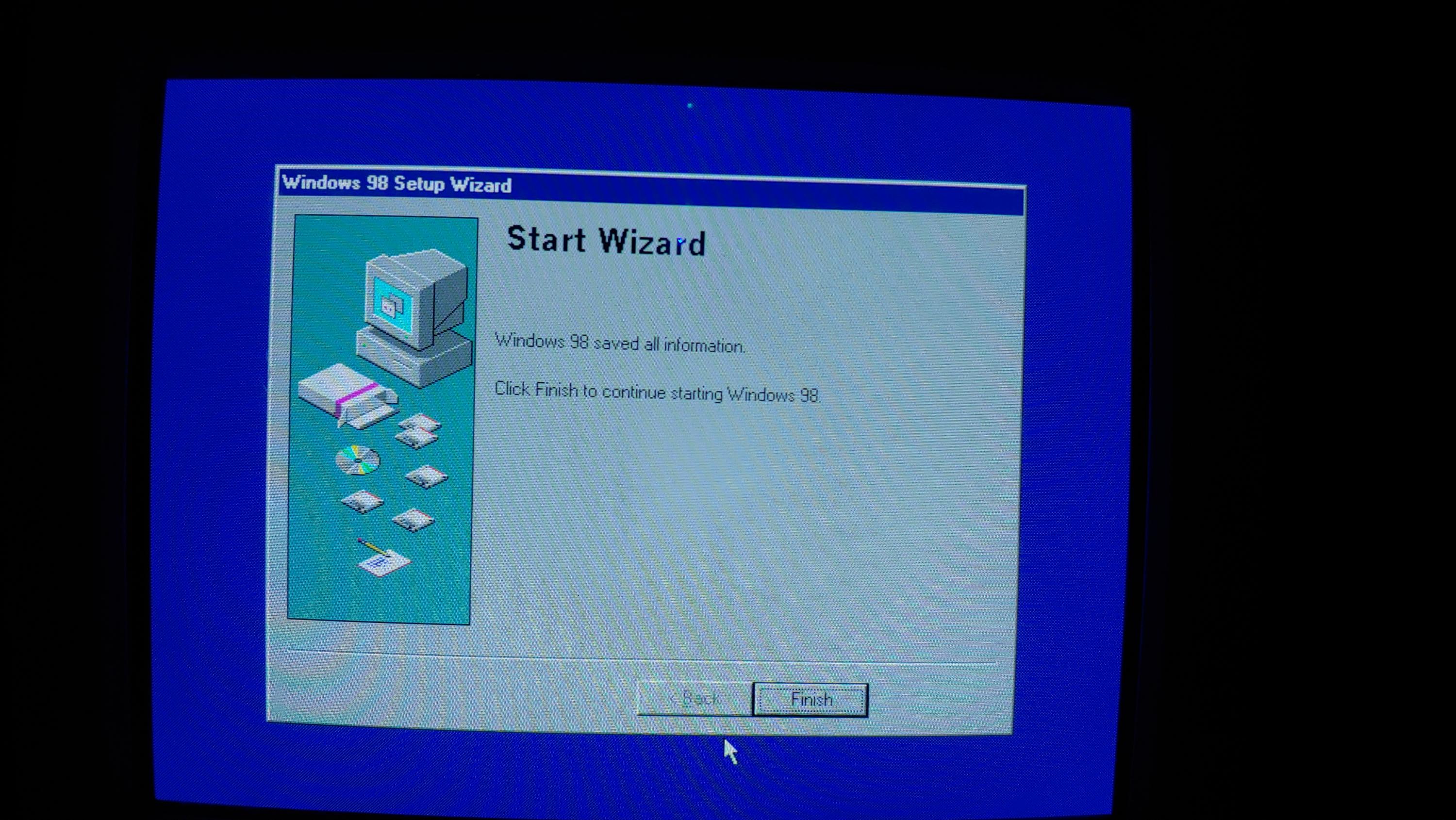

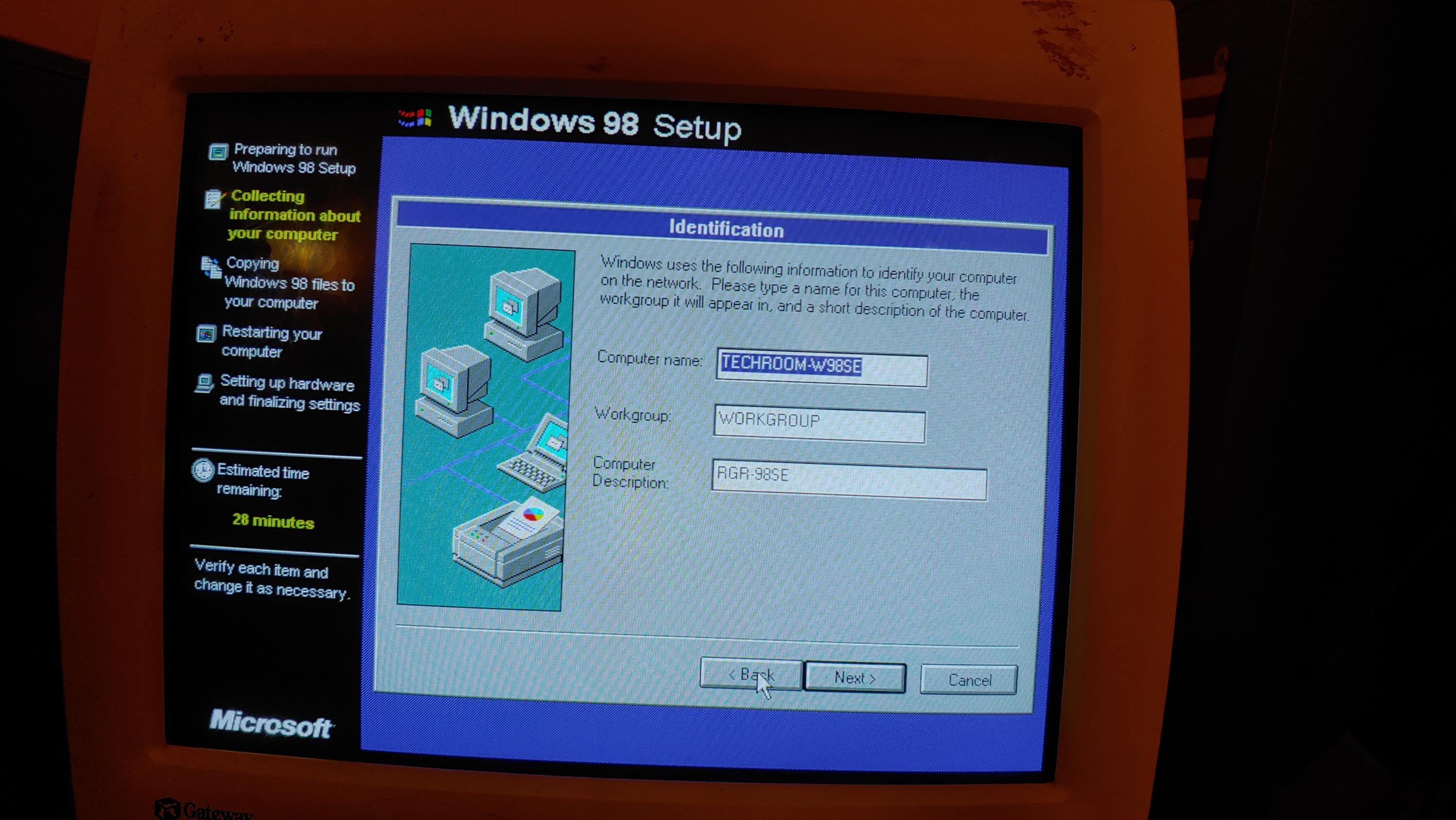

                  Installing for real.
                  Really, ScanDisk? IT'S A BLANK DRIVE!

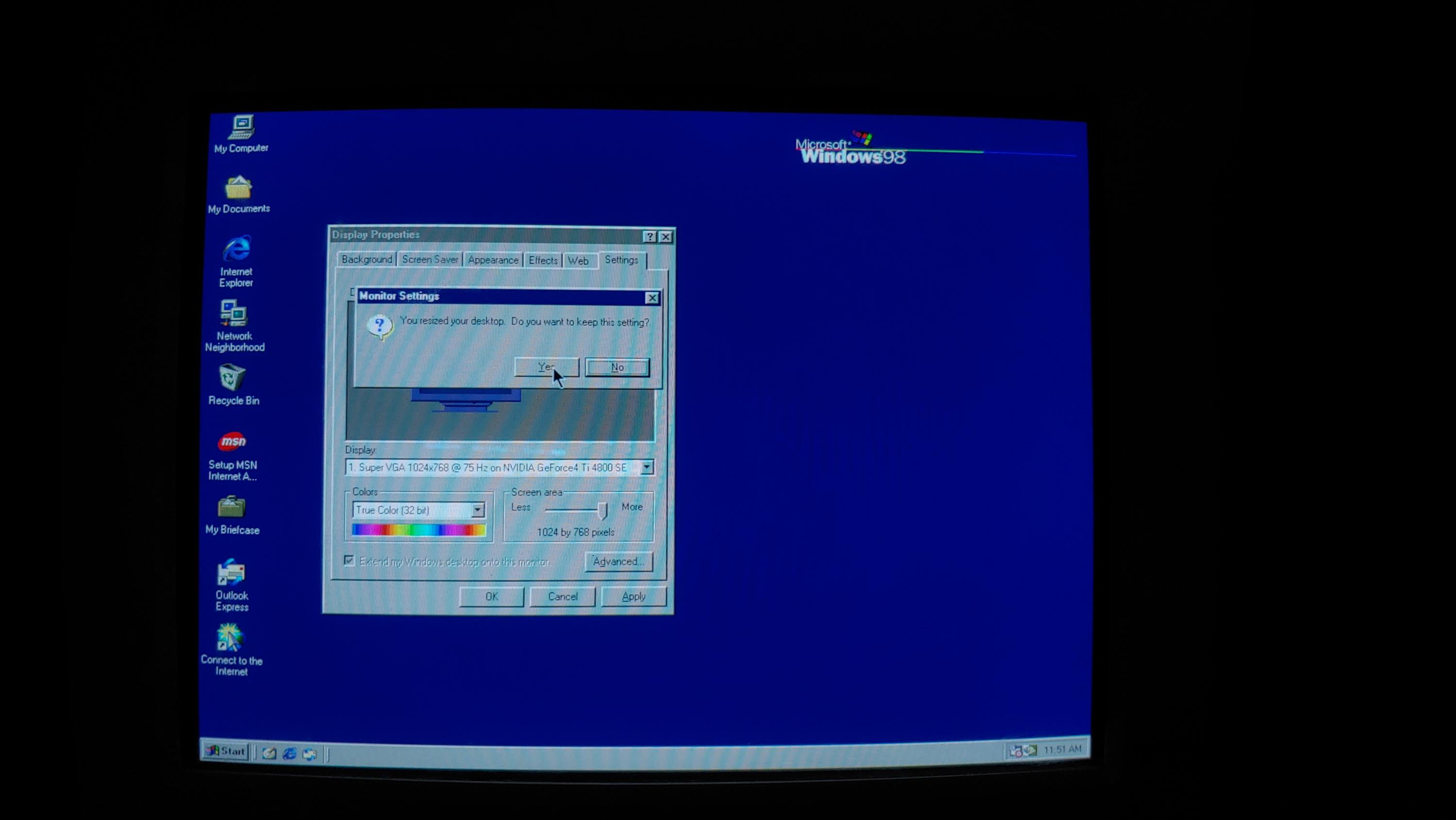

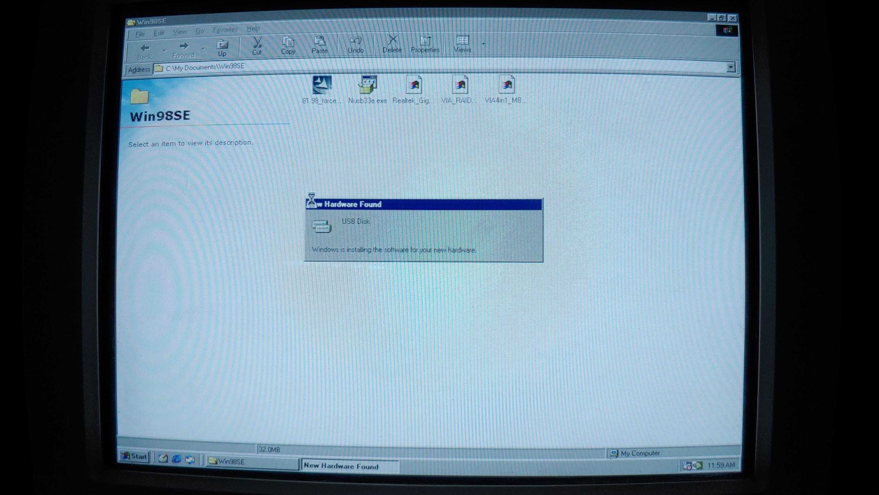

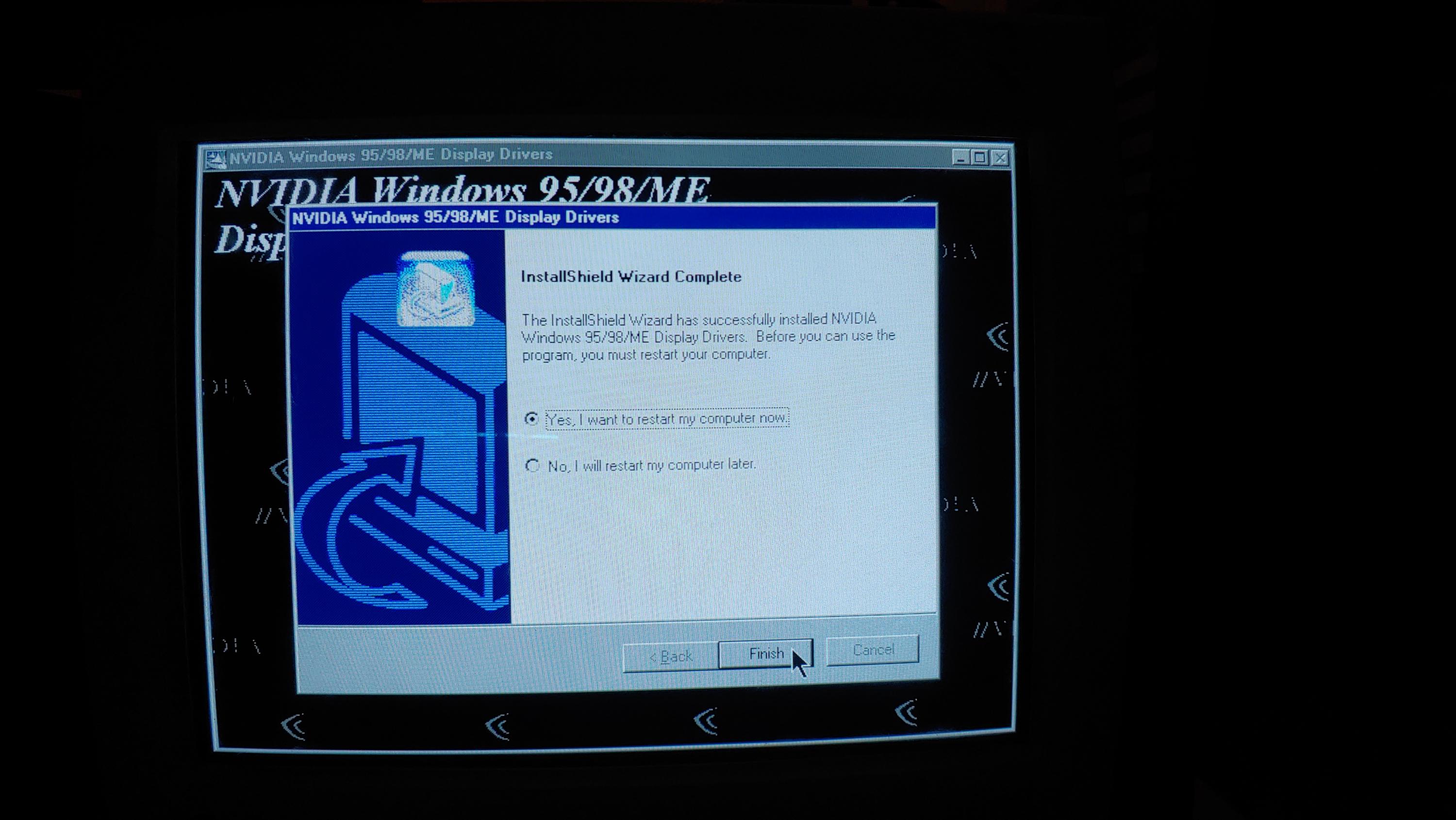

                  Graphical setup phase begins here...
                  And here's the attachment limit once again.
                    You've earned my respect with how you use your CRTs.
                    Lower resolution at higher refresh rate was always my priority.
                    In high school computer graphic design class though, there was this kid next to me who'd always choose the highest res of the monitor... which back then on the 17" CRTs we had was 1280x1024 - a 5:4 resolution on a 4:3 monitor! Ugh! And worst of all, those Viewsonic 17" CRTs couldn't do anything higher than 60 Hz on that resolution. It was a strobing nightmare. It bugged me so much that I'd usually pull my desktop forward on the desk so that it would block his screen from my peripheral vision.
                    Any self-respecting retro PC build should always use a PS/2 KB & MS.

                    Nvidia driver woes:
                    That's one reason I avoid XP x64 - drivers for it usually do exist if you look hard enough... but it's just more work.

                    LOL! Now that's a funny case design FAIL. I mean, what's the point of having an HDD cage fan if it can't be installed when there are HDDs there.
                    Funny thing is, I've seen something similar on modern cases with slots for 120 mm fans on top... but no space left between the motherboard and top of the case. So either you can mount the motherboard and not have fans installed... or install the fans and have no motherboard.
                      I'm guessing they weren't smart enough to use their CAD software to verify that their case can be fully loaded without physical conflicts.
                      And I've done something with the fans that will more than make up for the loss of that one fan from the hard drive cage. It'll be in another one of my Internet Connection Stress-Test Megaposts™, coming soon.

                        Another day, another megapost! Up to January 9th in the picture backlog now.
                        Getting the W98SE installation finished up and settled in here.
                        Continuing with setup...
                        Reboot!
                        First boot.

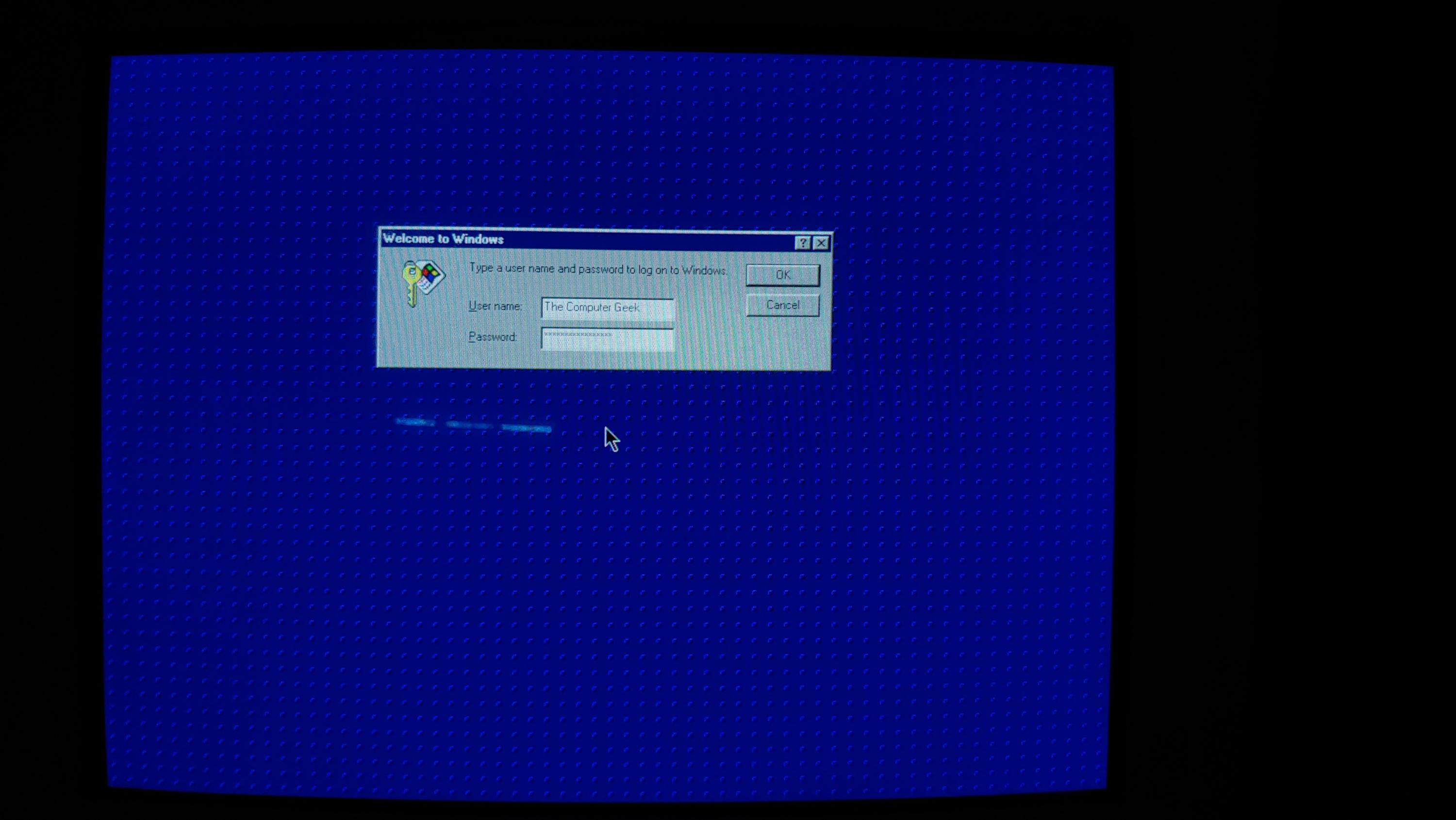

                        Caught a dialog box mid-draw:
                        Setting up...
                        RU LEGIT?
                        And setup complete!
                        Got to see this screen a few times. It's not Windows 9x if it doesn't manage to throw itself into a creative loop at least once a day.

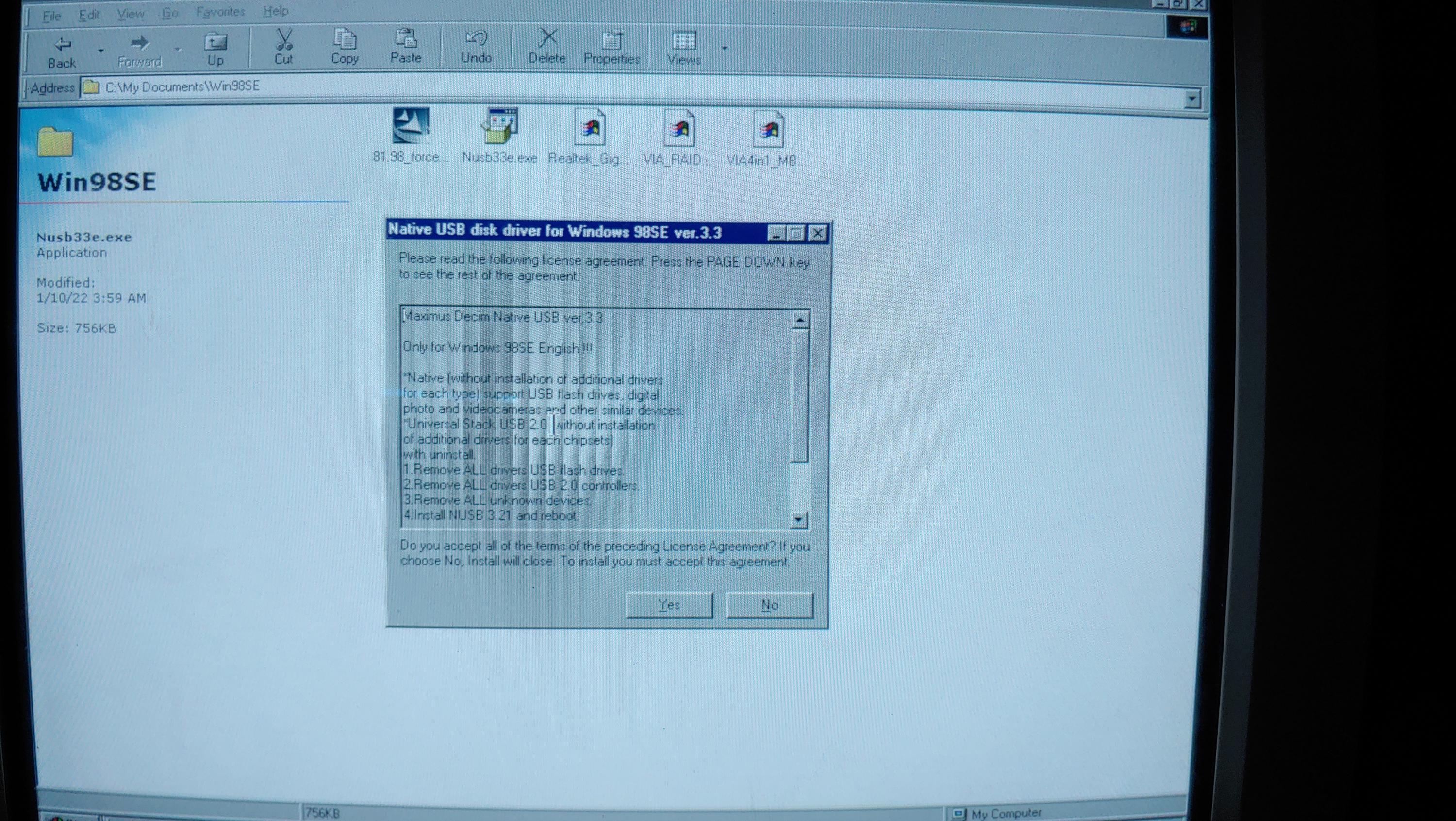

                        Excuse the blurriness. After trying to get the Universal USB Mass Storage driver for Windows 98 copied from a floppy diskette (and failing, several times), I resorted to booting into Windows XP and copying the drivers onto the Maxtor drive that Windows 98 was installed on, including the USB mass storage drivers.

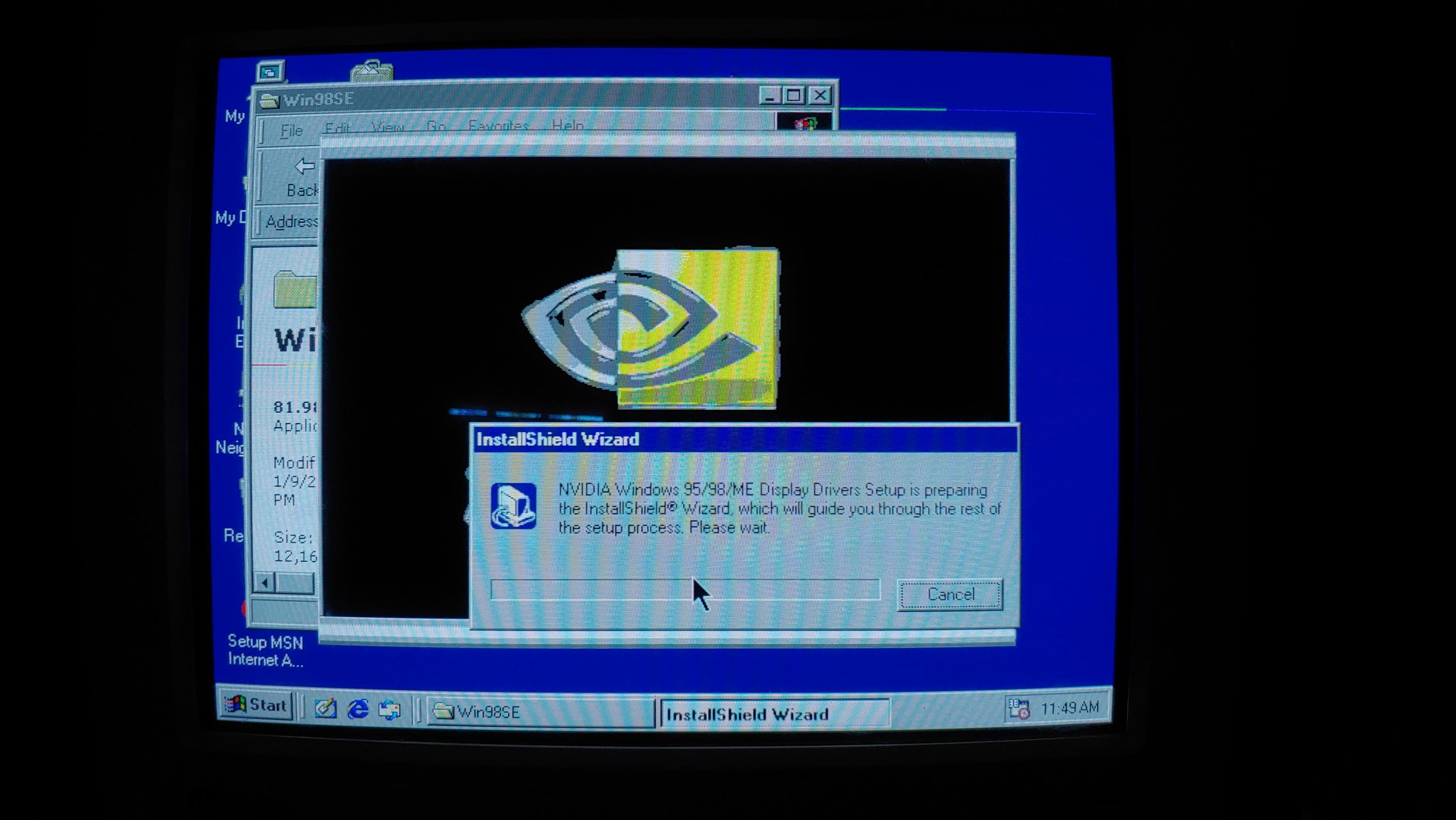

                        Installing the graphics drivers because Windows 98 looks plain awful in 640x480x16 with all of its high-color and full-color graphics being dithered into oblivion.
                        And drivers installed.
                        Windows reconfiguring itself after installing graphics drivers.
                        And that looks a million times better!
                        Seeing if I can make six-foot-flames erupt from the monitor and graphics adapter...
                        ...and no flames, thankfully. 1024x768@85Hz.

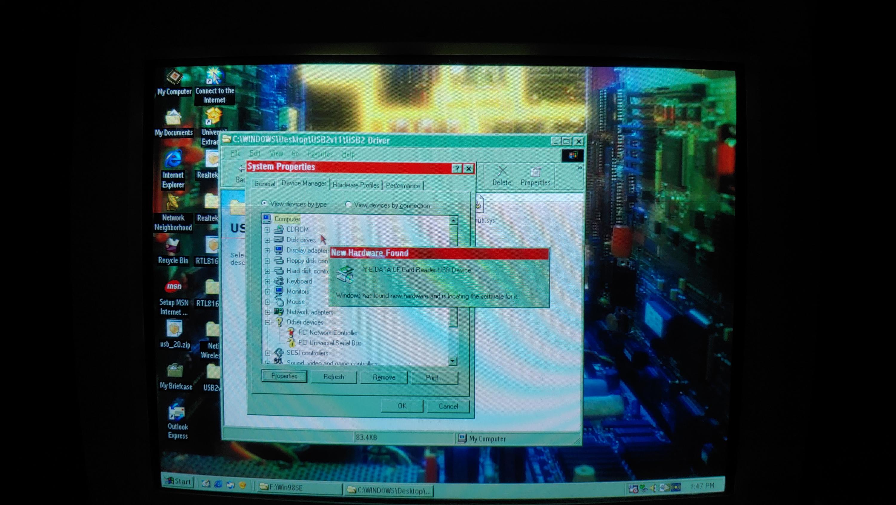

                        Installing the USB mass storage drivers.
                        That looks so much better with the GPU drivers installed.
                        Windows catching up after plugging in a USB flash drive...
                        That's a good sign!

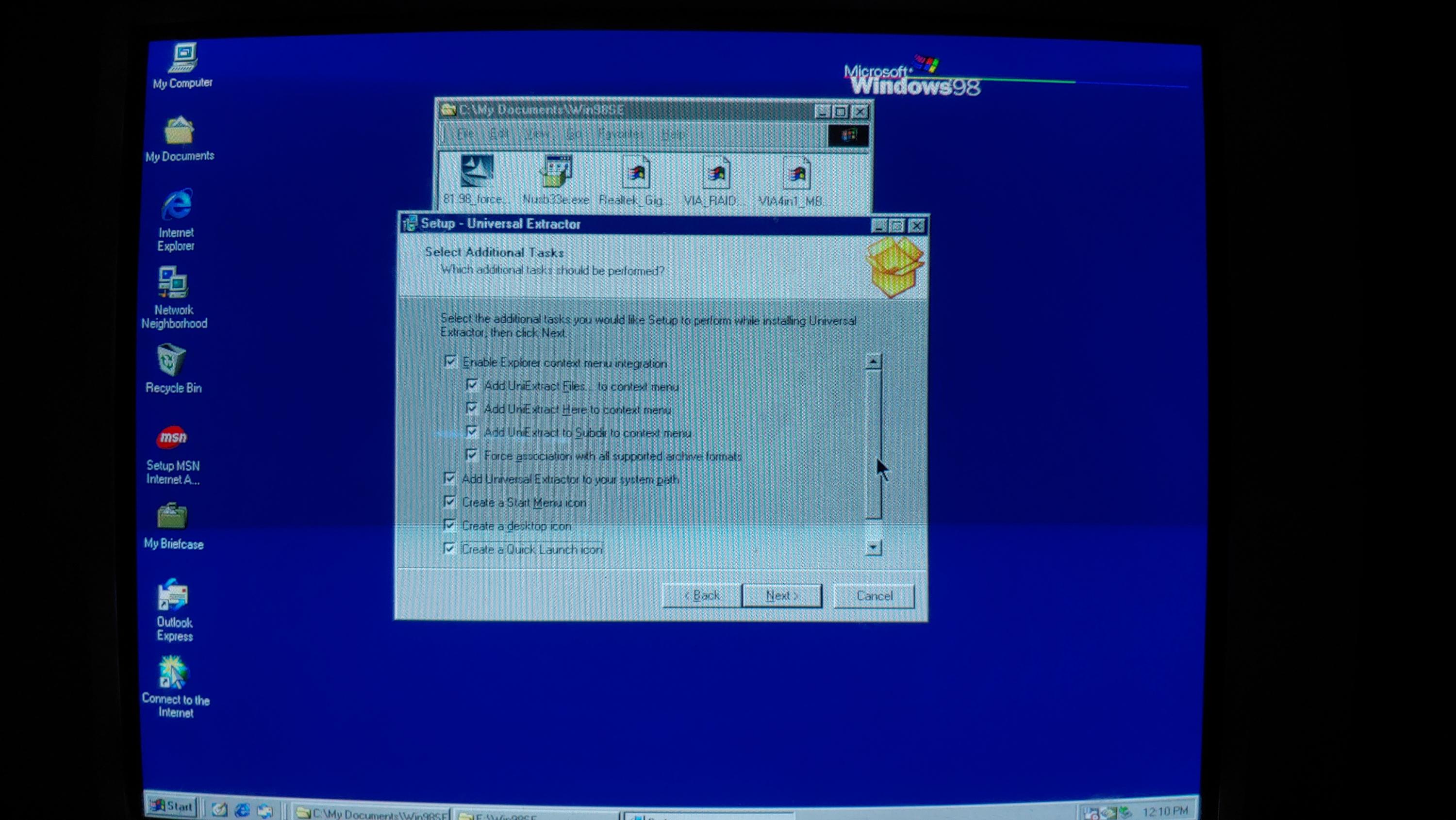

                        Installing UniExtract so I can extract driver packages.
                        More USB stuff.

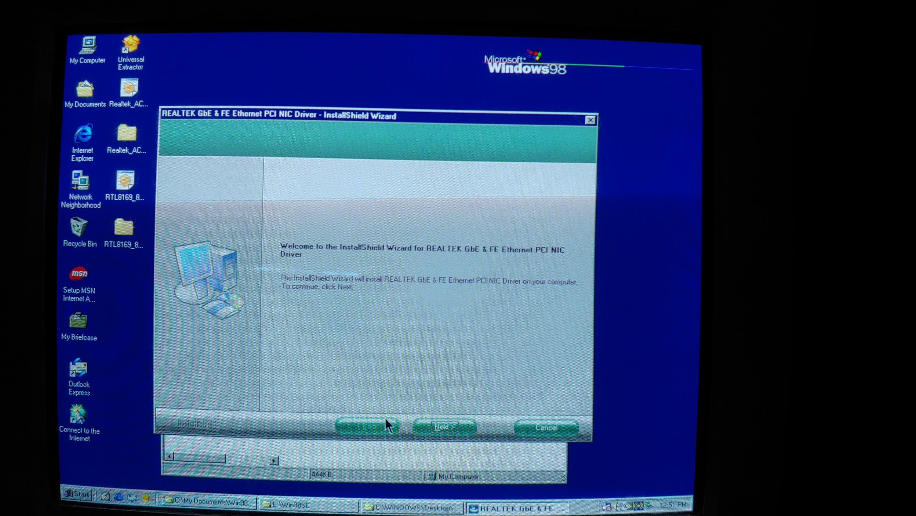

                        Installing LAN drivers.
                        And here we see the attachment limit? Or is it Windows 98 crashing again? Idunno.

                          More progress, and finally getting Windows 2000 installed for real! (Which steamrolled my Windows XP x64 testbed install into the ground)
                          Set a theme for Win98:
                          Installed drivers for the USB card I have installed in one of the PCI slots:
                          Lookin good.
                          Pulled apart once again. Installing a SATA card based around a Silicon Image SIL3114 controller and modifying the system configuration a bit.
                          Here's the SATA card (which also supports everything including RAID 5 with a hot spare or a RAID 10 array):
                          And here's the drivers disc, which is clearly a burned CD-R.
                          Installed.
                          Added a fan to the side of the hard drive cage in preparation for a push-pull forced air setup.
                          Switched the front case fan to a 120mm LED fan pushing air across the hard drive cage.
                          Installed the orange fan from the front onto the other side of the hard drive cage, creating a push/pull setup that will wrap the installed hard drives with a constant supply of fresh air.
                          Test run.
                          Back together and powered on. Disk seen on the new SATA card.
                          Windows XP predictably crashes.
                          Copying drivers to Win98SE.
                          Installing Windows 2000.
                          And now for a few closing case shots.
                          And with that, I'll be back soon with more pictures of my progress!

                            More progress on getting Windows 2000 installed for real.
                            Setup complete.
                            Windows 98 on the boot menu as 'Microsoft Windows'.
                            Test boot to make sure that Win98 still starts...
                            Booted into Windows 2000. Before installing graphics drivers:
                            After installing graphics drivers:
                            And yet another piece of software that left a puddle of 2004 all over my floor.
                            Installing software for the LAN controller.
                            And done.
                            Installing chipset drivers.
                            Go away, nobody cares about you.
                            Installing the Unofficial SP5.1 updates.
                            And done.
                            Moved the whole setup to a new home, monitor and all.
                            Internet Explorer doing what it does best- downloading another browser.
                            FF10 up and running.
                            Installing some prerequisites for Extended Kernel.
                            And the attachment limit is dead ahead.
