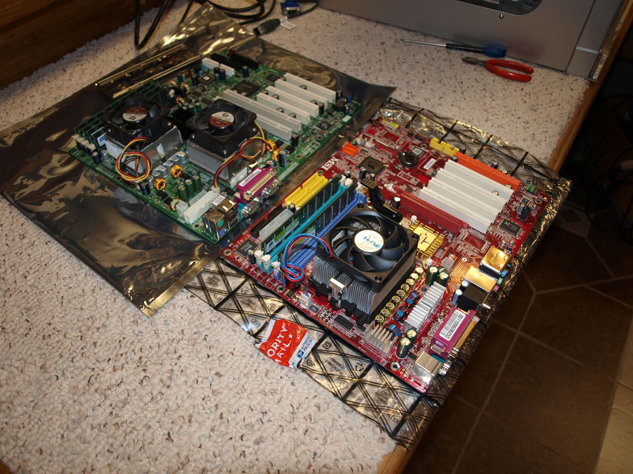

                Scheduling hole opened up earlier than expected, so it's officially go time on getting it out the door.
                Shutting the system down.
                Shut down.
                Power switched off at UPS (Eaton Powerware 9130). Load segment 1 carries the home network stack, so it has to remain on.
                On the table and ready for service. Doesn't this look familiar?
                A little more room under the desk now...
                Into the BIOS we go to remove passwords and reset to defaults.
                Passwords cleared.
                CMOS reset.
                No boot because the HDD is disconnected.
                Unplugged from PSU and expansion cards stripped away.

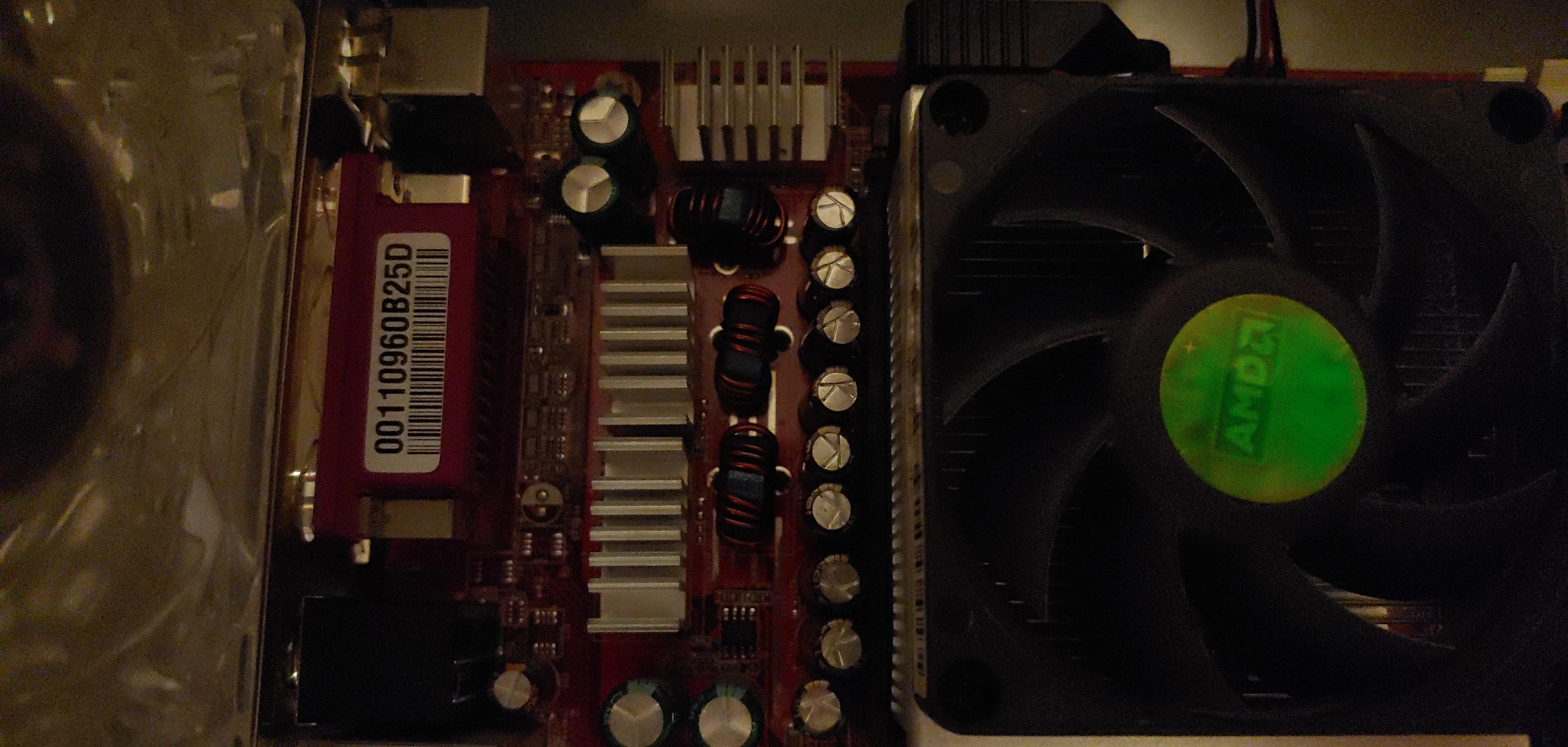

                Plenty of expired capacitors to be seen here.
                Not expired yet, but soon to disappear.
                Motherboard stripped from the case.
                MSI's debug+USB breakout dongle.

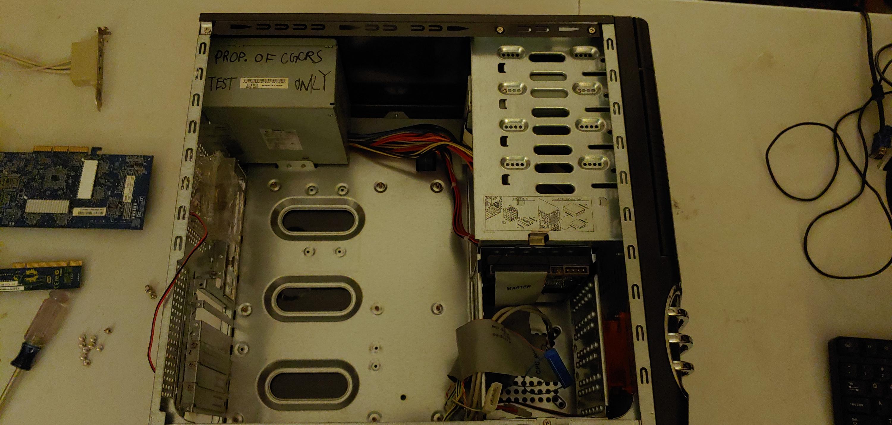

                Expansion cards reinstalled into case, sans motherboard.
                Motherboard, removed from case.
                CPU heatsink removed.
                AS5 thermal paste wiped clean, ready for when the motherboard returns.
                Stripped motherboard, ready for shipping.
                Next post here will likely be when the motherboard returns to be reinstalled and put back in service. TTFN!

                            Oh, I know how that feels right now all too well (and it's not well when there isn't much space. ) Practically, I'm the same way - I have towers stacked next to my desk and under it. Some are prior "main" PCs, some are past "gaming" PCs, and others were just a "bridge" / file storage / temporary PC for some task at some point in time. 5 out of 8 are disconnected from KB/MS, monitor, and internet, of which 4 are disconnected from power (so I can minimize the "zombie" standby power consumption of my gadgetry.) Of the 2 under my desk, 1 is disconnected and just serving as a *food rest*, of all things ... though I do hook it up and play around with it occasionally. The other one kind of switches spots with a few other towers in my closet, based on what season it is and what I want to do. In the winter when it's cold, I bring out the hot, inefficient towers out, and in the summer, the opposite.
                            In any case, I do miss having ALL of my foot space under my desk that I used to have many many years ago before I got into PC repair. On the other hand, I do also like using some of the PCs as a foot rest... so IDK what's better.
                            https://www.badcaps.net/forum/attach...1&d=1617103618
                            Looks like you got lucky and the bad caps are only for the PCI slots power... so rarely anything will suffer from those going bad. On the other hand, if you had any instability issues with that board, there's a good chance those caps weren't the cause. But it's good to get them out of there, anyways... or at least might as well when TC recaps the board for you. Now, replacing the ones by the memory slots and NB - those definitely matter, so your recapped board should be in much better shape.
                            Cool. Never seen one like that for MSI boards. Reminds me of the 4 LEDs by the front USB ports on Dell PCs - I think those also show debug info at POST (not that I ever had to use them, though.)
                            https://www.badcaps.net/forum/attach...1&d=1617104079
                            I don't suggest storing expansions cards like that for any extended period of time (more than a month, at least), as they can warp without support from the motherboard slots - especially longer ones, like that video card.
                            https://www.badcaps.net/forum/attach...1&d=1617104411
                            Pro (up/recycler) tip: thermal compound can usually be re-used if it's not dry and you don't contaminate it with finger oil or other foreign matter too much.
                            Even more so, AS5 thermal paste does not go bad - at least, not unless abused with really hight temperatures (over 80C) for an extended time (at least a year.)
                            So don't waste your money and time on new TC if the old one is still good... which the one above seems perfectly normal. Just scoop it up with a clean tool (especially from the sides where the excess is) and re-apply it in the middle so that it can re-spread again. The only time I don't re-use TC from the sides is when it's heavily contaminated with dust. But yours looks pretty much spotless.
                            On a big surface area like this and a CPU with a heat spreader, re-using even cheaper compounds won't make a difference in the thermal performance. I've done many tests on this, and the difference appears to be less than my testing error margin (typically 1 degrees Celsius, depending on how the room temperature changes, if at all.)
                            Cool.
                            BTW, when you do that, perhaps try re-sizing and also cropping your next image session down a bit. There's no need to upload a 3000x3000 pixel image if you're only trying to show one smaller part in detail in that image, so crop an image to show only the area that is needed. Also, use medium JPG compression (medium quality.) A lot of phones save blurry images in the lowest compression, which isn't necessary. And downscale the resolution to just what's needed to show enough detail. That way, we save a bit of bandwidth to the forums. And moreover, if anyone is indeed re-purposing / re-using an old PC like this from the early 2000's and trying to view this thread with it for whatever reason, things will load a lot quicker. I had not problems loading this thread in a near instant on my i5 machine. But on my P4, the loading time was somewhat noticeable. And on my PIII laptop that I generally use for datasheet viewing only (and rarely jumping to look up something on BCN), it takes about at least 10 seconds to load this thread. So a little down-scaling and cropping goes a long way.
                              Agreed. They're all the same age and have seen power for the same time (16+ years POH), Since some of them are visibly bad, I imagine that ALL of them are not long for the world. And yes, it was starting to suffer from stability problems, so even though they weren't visibly bad, they were probably in a heavily deteriorated state, electrically speaking, so if some are getting changed, might as well shotgun 'em all.
                              Note taken. It may not be easily visible, but I have the 20-pin motherboard power cable looped under the GPU as to give it some support at the far end. Hopefully when TC finishes with the board, USPS/UPS/FedEx doesn't drag their feet about getting it back to me. They certainly didn't when I sent it out, though, so I don't expect problems getting it back if the courier of choice happens to be USPS.

                                        Originally posted by Topcat
                                        The VCORE caps (formerly Rubycon 1500uF @ 6.3v MBZ) got replaced with a pretty line of Fujitsu Polymers.
                                        https://www.badcaps.net/forum/attach...1&d=1617921363
                                        I'm guessing those are the 820 uF, 2.5V Fujitsu's?
                                        Don't discard those MBZ's, though! Probably still good for less critical projects. Even MCZ are usually OK after all these years... though IMO not as reliable or trustworthy as MBZ.
                                        Of course I did replace the poofy ones....
                                        Was it ever a question that you wouldn't?
                                        The other.....just a teaser, this one will make an appearance in another thread...
                                        I don't think that's the dual s462 Tyan mobo from eBay I PM'ed you about... or is it? (Doesn't look like it, but I forgot to check back how far the seller dropped the price over time.)
                                          It all depends on what kinds of loads were on them (high ripple) and how hot they had been running at. Under normal loads and kept relatively cool, yea....MBZ and MCZ were pretty robust....but excess of one or the other or both, their lifespans were relatively short.
                                          Yes, these are 820uF @ 2.5v. These have stood the test of time for polymodding for the last ~15 years, I've never had an issue when these were correctly applied in place of lytics. ...but FWIW, you can get away with a lot of 'slop' when playing 'musical values' in the polymodding process. Barring the unexpected, TechGeek having a good PSU on the system feeding it good/solid/clean power, and nothing crazy happening to the system; this board should last a very long time.
                                          No, it wasn't That one was an eATX, and I didn't have any cases available for it....but FWIW, I found this one via ebay's 'recommended for you' targeted spamverts....and added it to my 'watchlist'... This one is a S2466-M4; and supports Barton CPU's (I had a pair of rare 2800+'s I forgot I had). In the few weeks I watched it, it dropped from $80 to $30...when it hit $30, I grabbed it.
                                          ...so yea, it's your fault!
