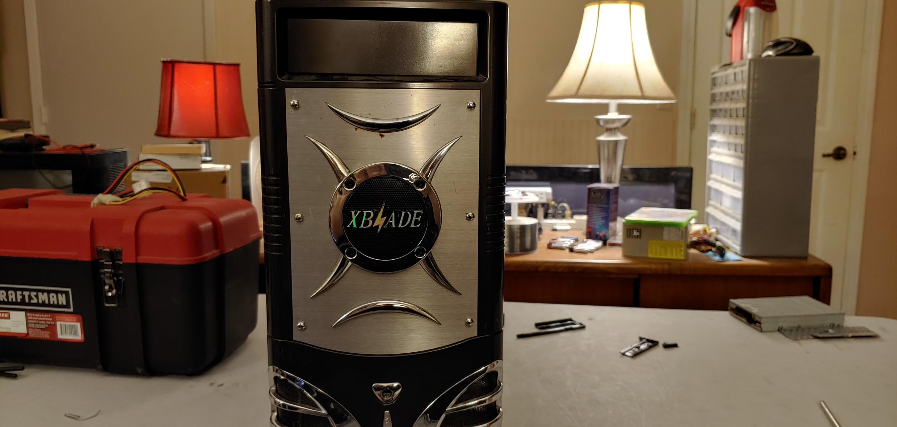

    Now to move the pile of junk, get the system up onto the table, and grab some photos before we start messing with it.

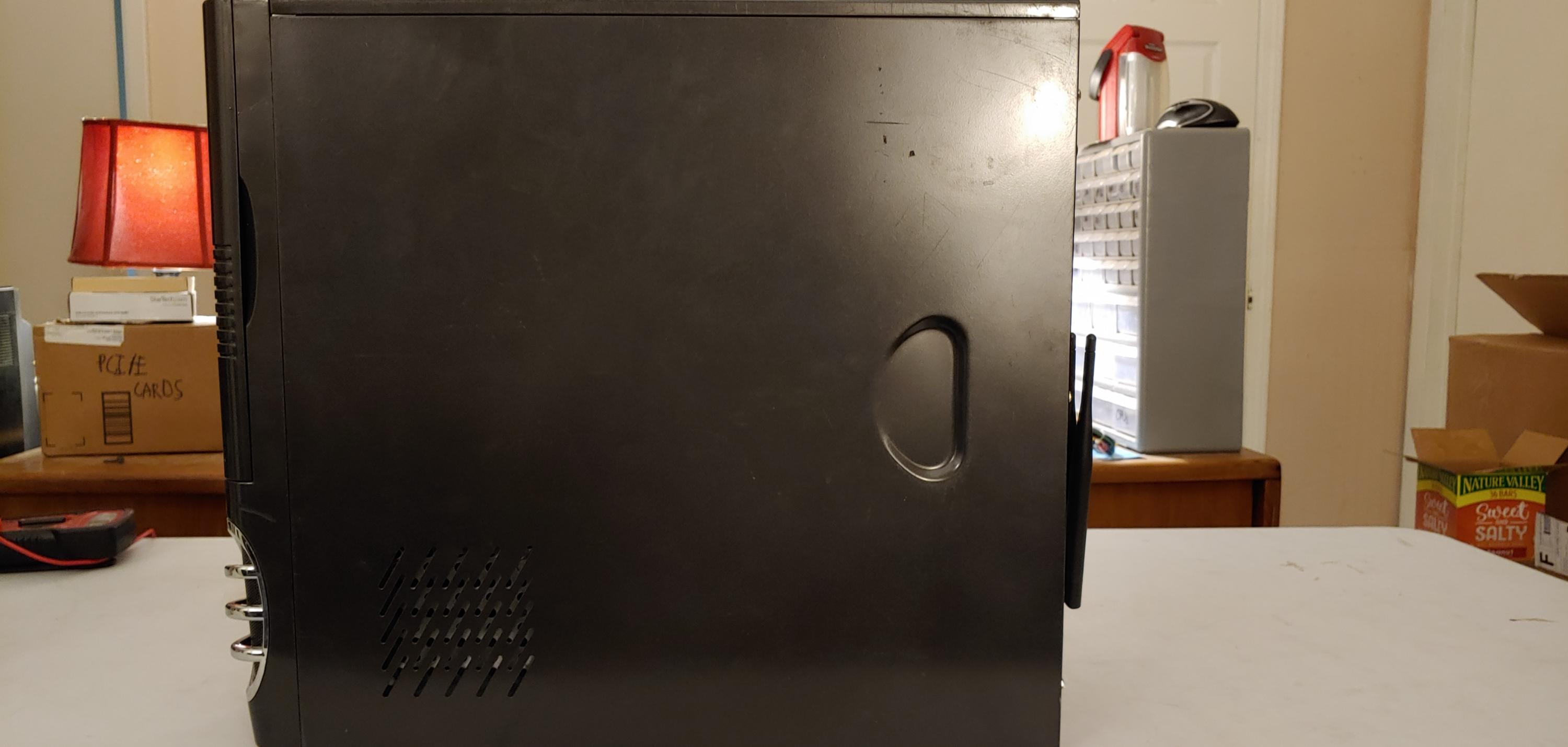

    Awesome side panel:

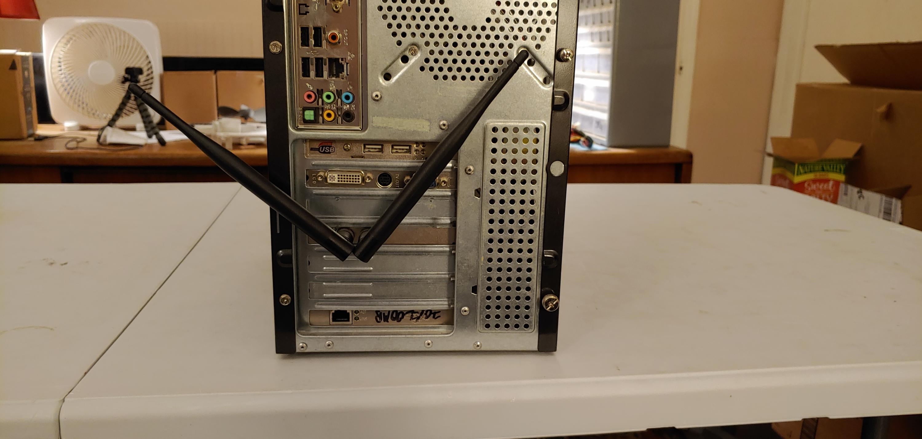

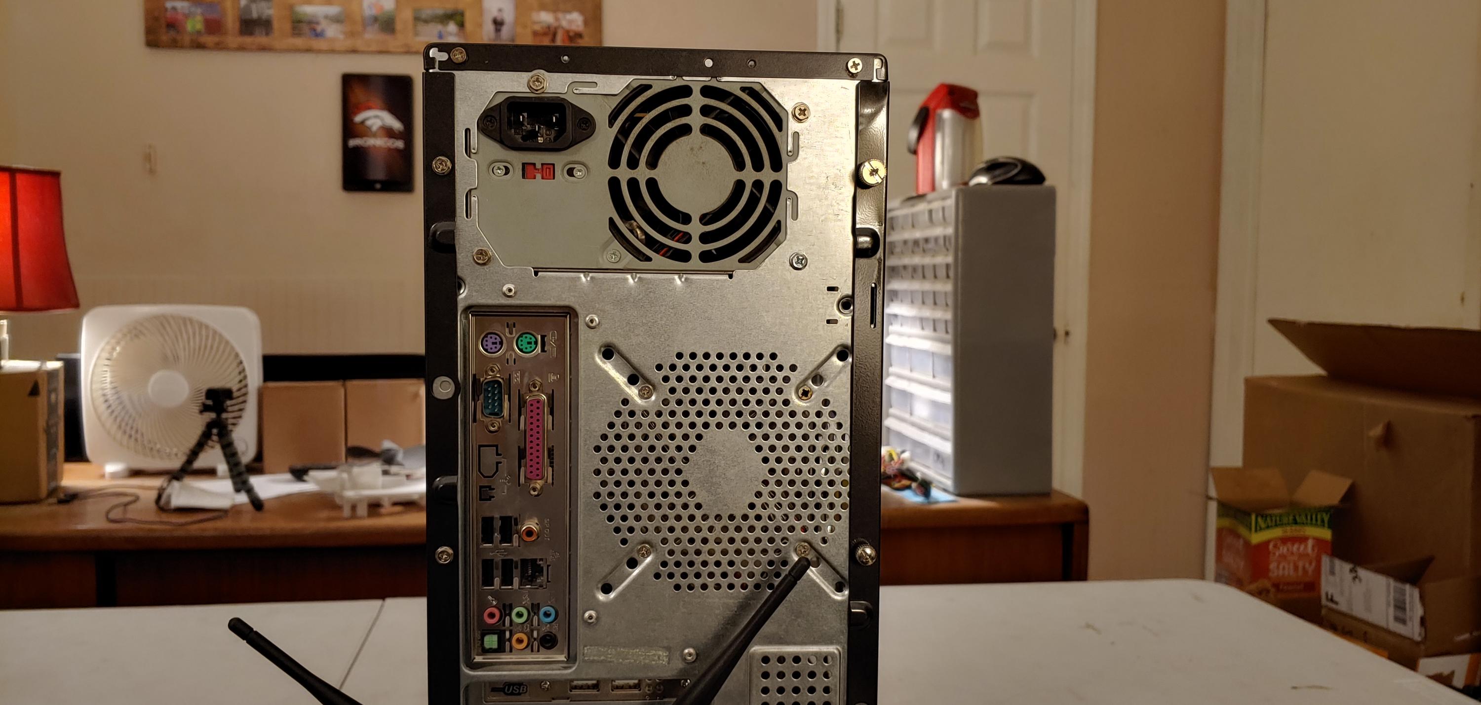

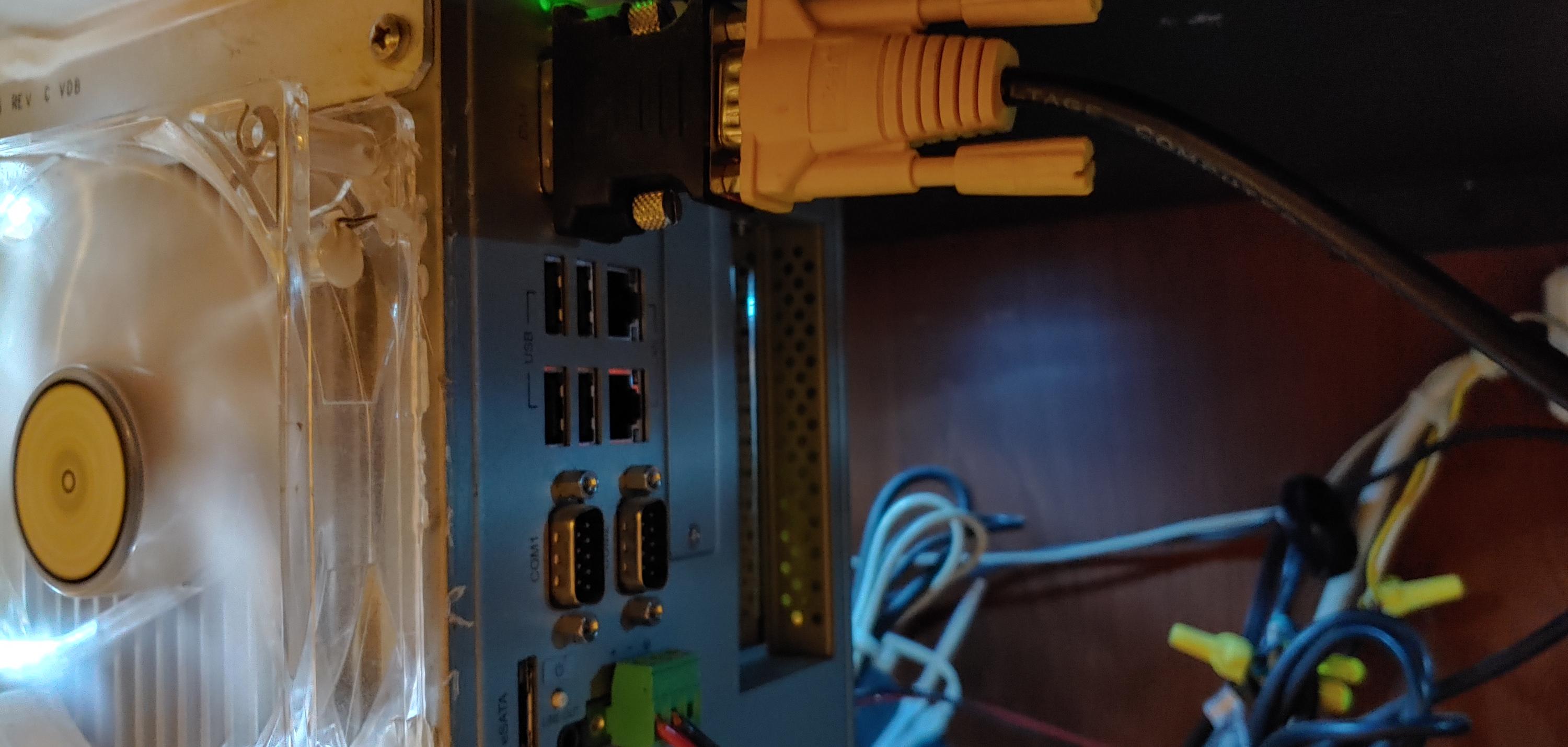

    Butt shot 1 (lots of legacy ports on this old motherboard):
    OOPS, clicked post too early. Carry on...
    Butt shot 2:
    Other side panel:
    Front panel door closed, feat. optical drive with disintegrating cover:

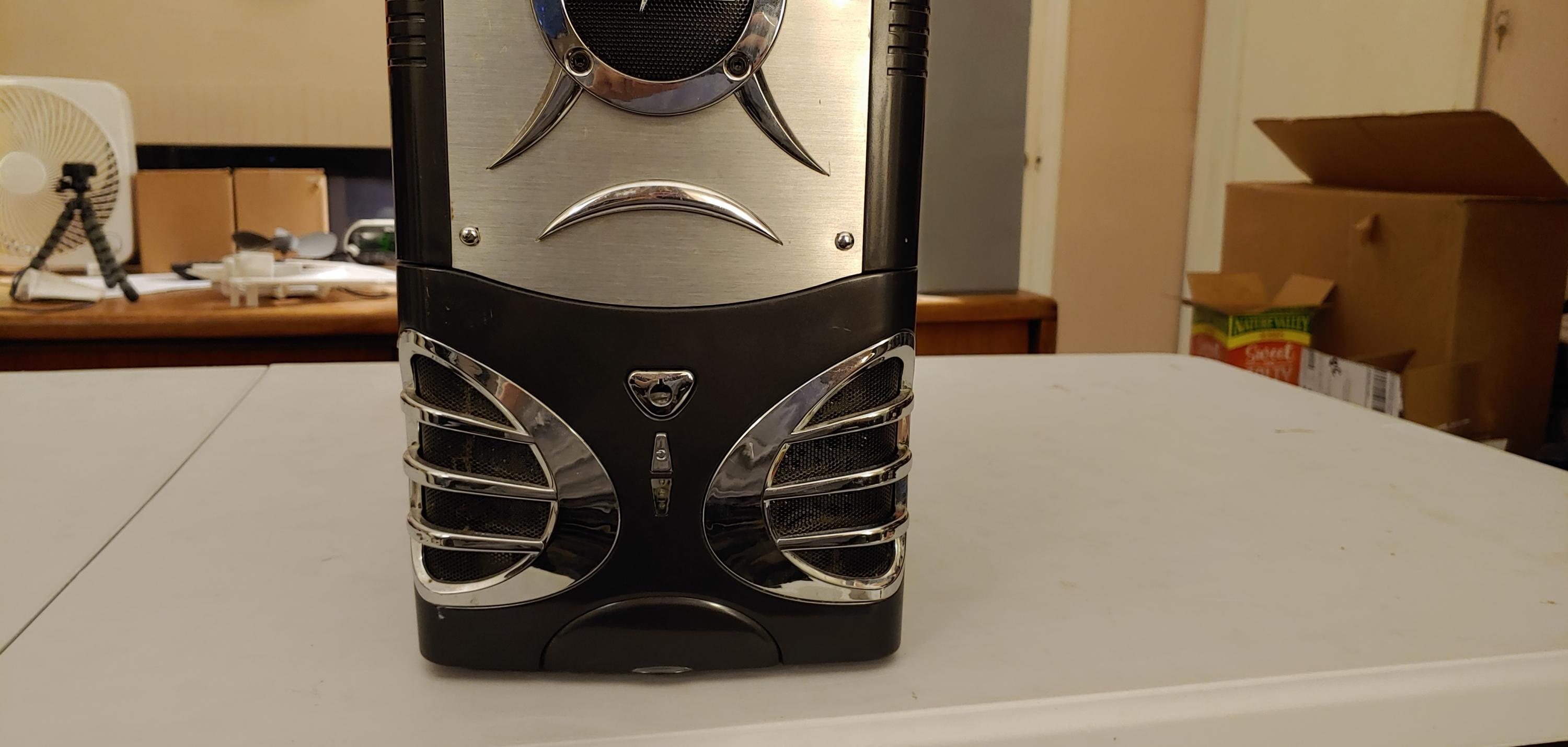

    Bottom of front panel:

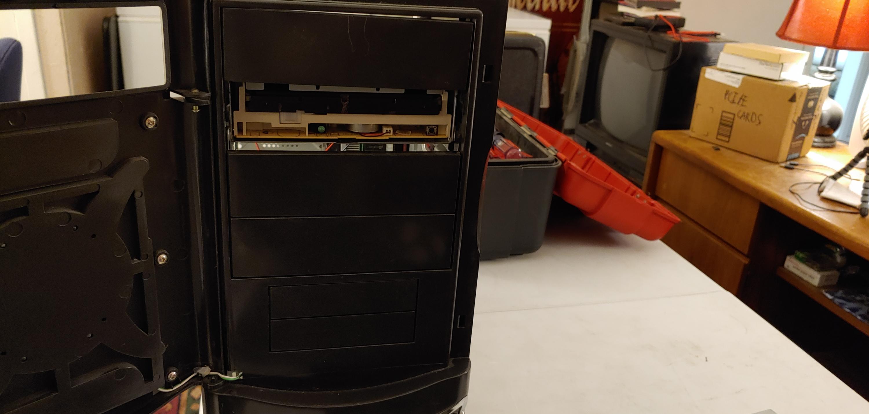

    Front panel door opened:
    (Yes, that floppy drive is loosely sitting in the case.)

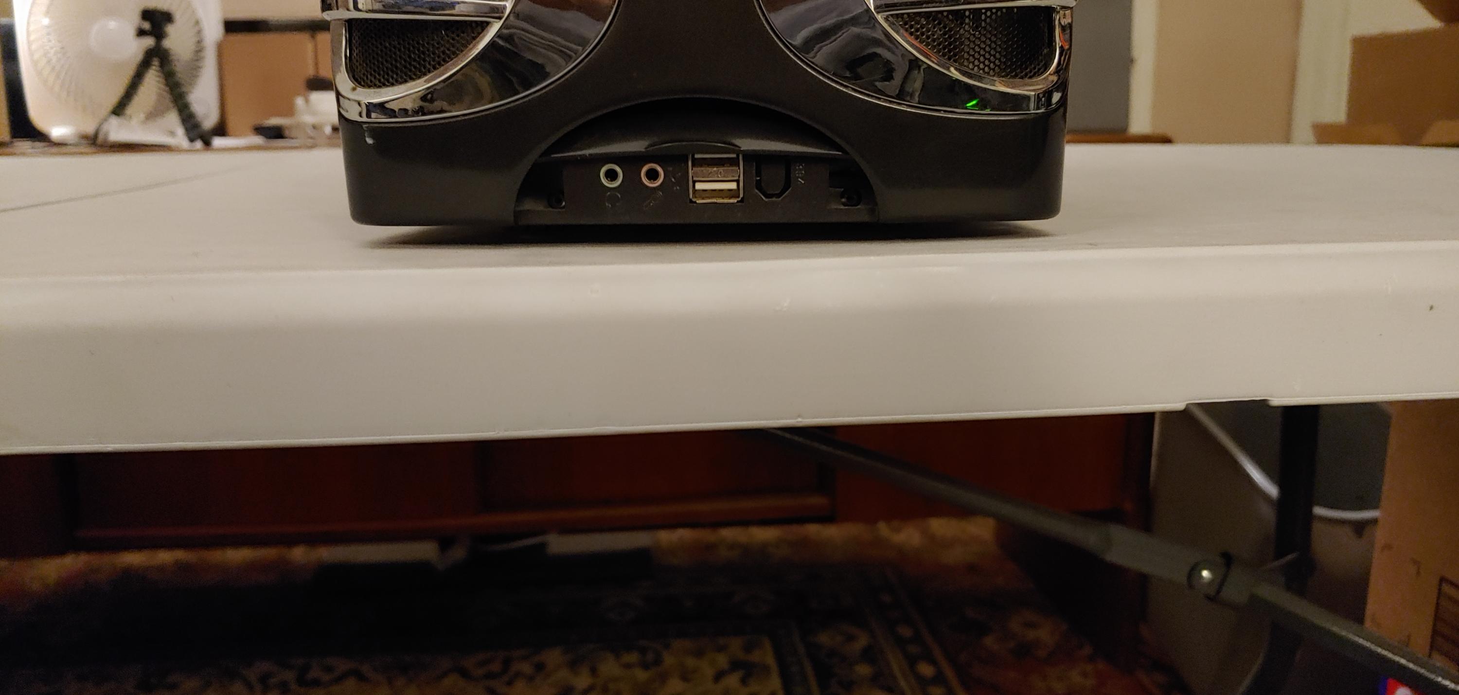

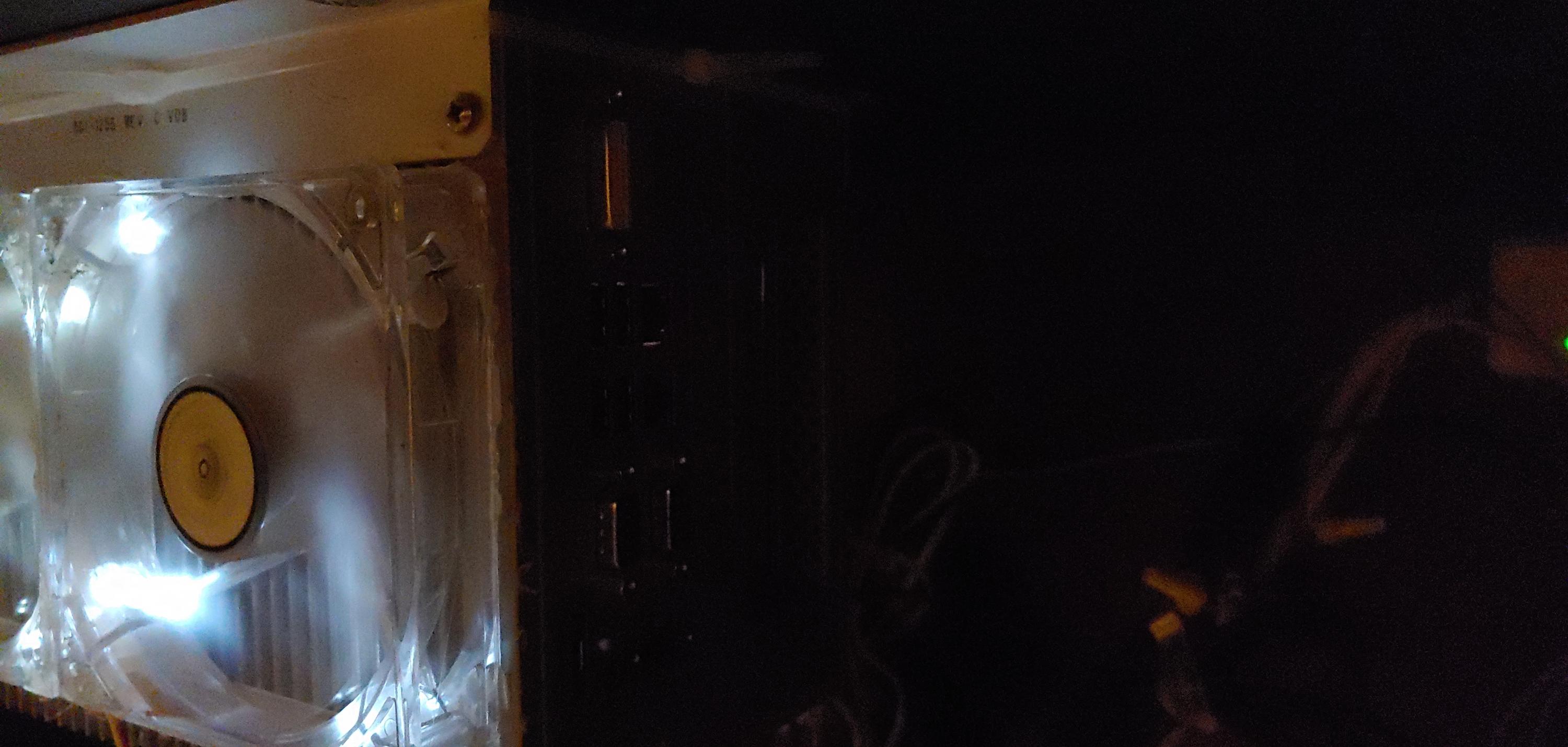

    And for the USB ports:
    The headphone jacks are nonfunctional. IIRC, the motherboard's audio controller is also dead.

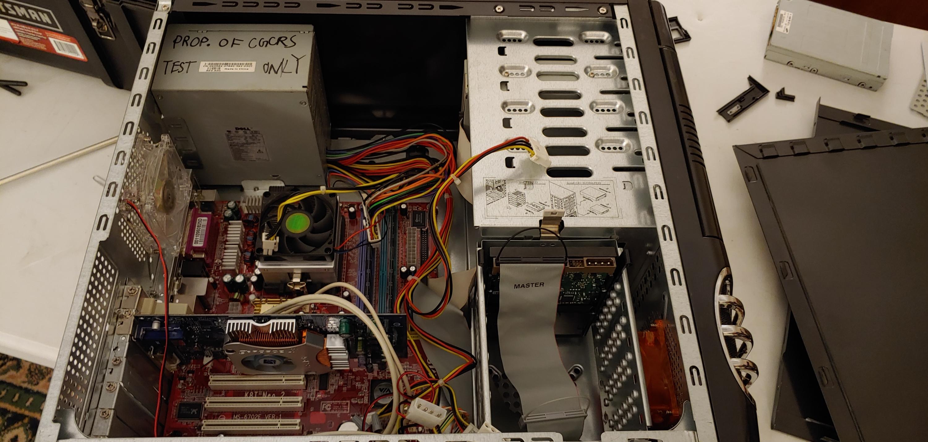

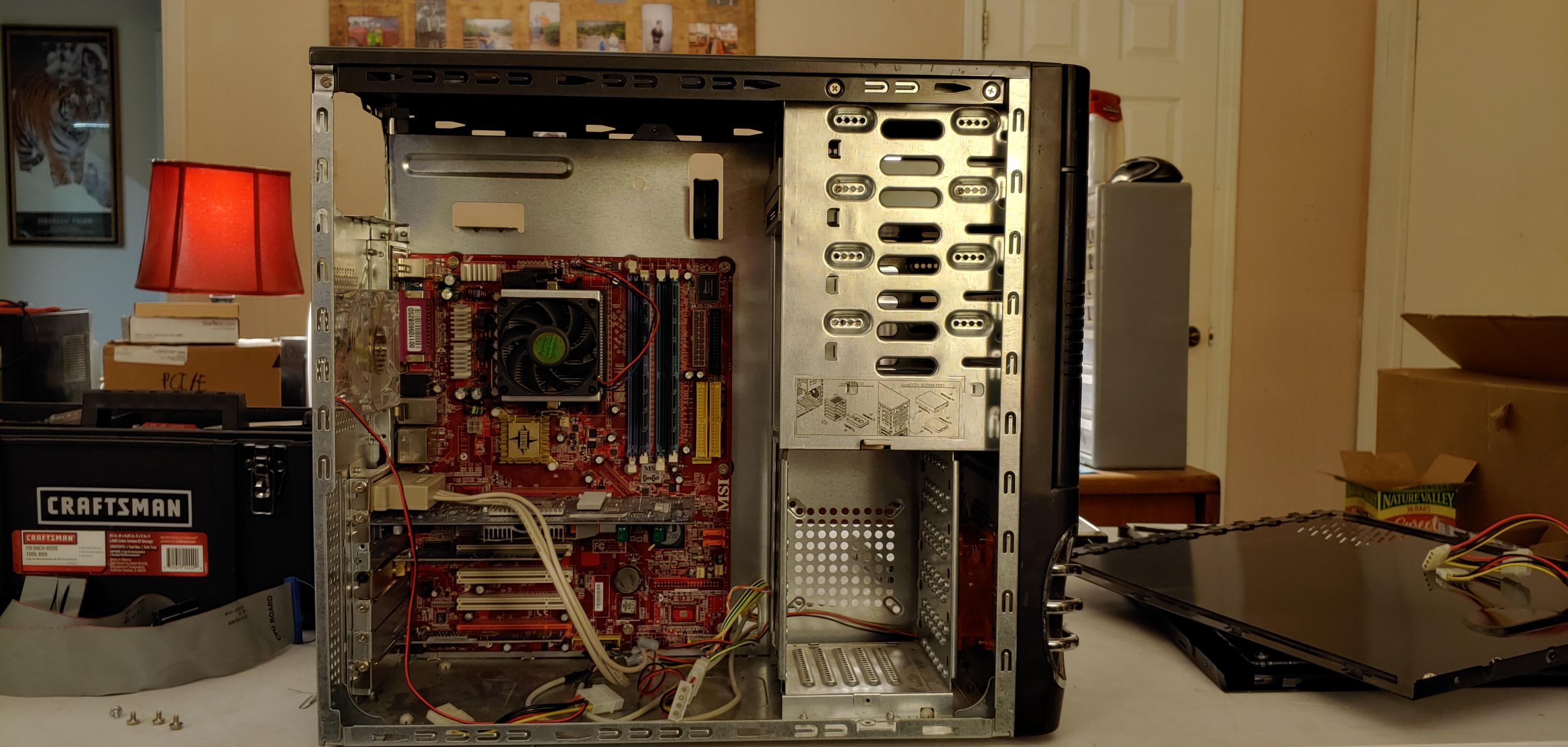

    Now for some inside shots before partially stripping it to make working on it easier.

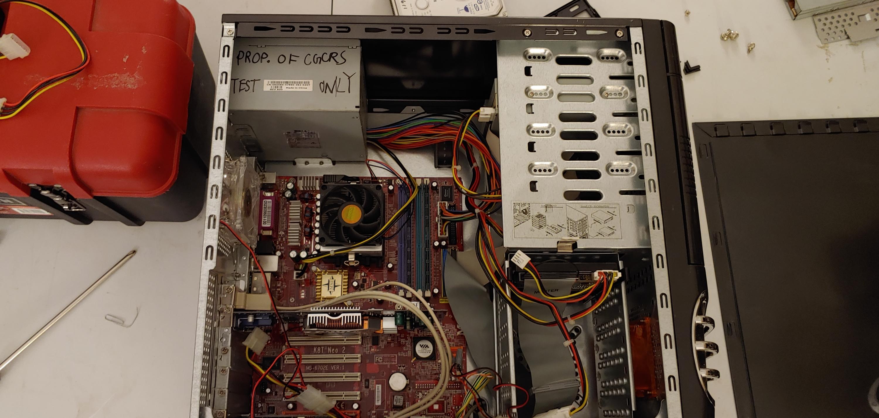

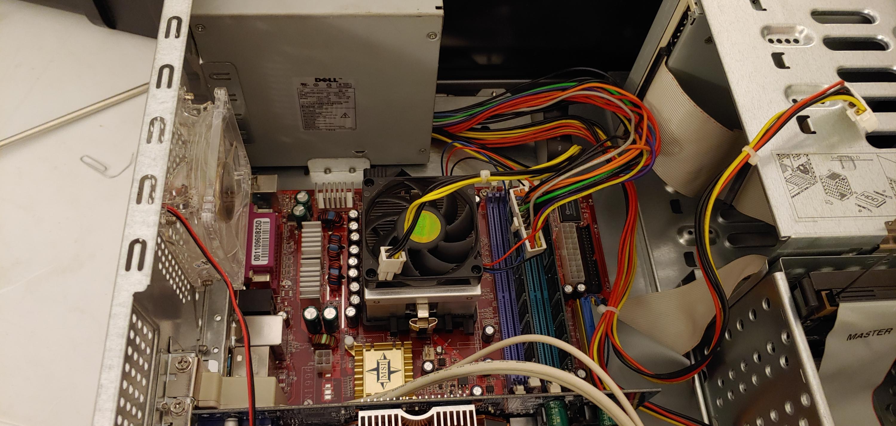

    Top-down case view:

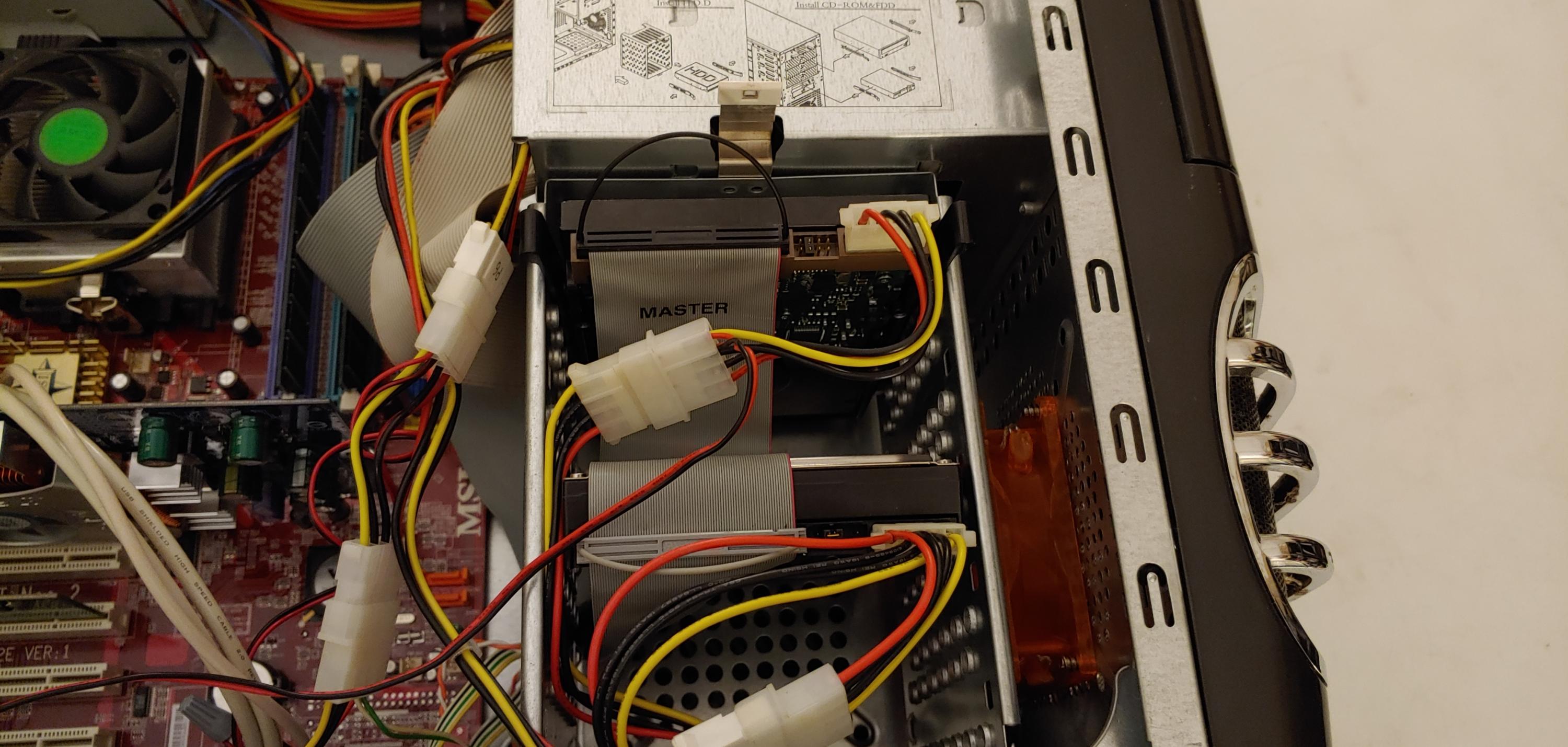

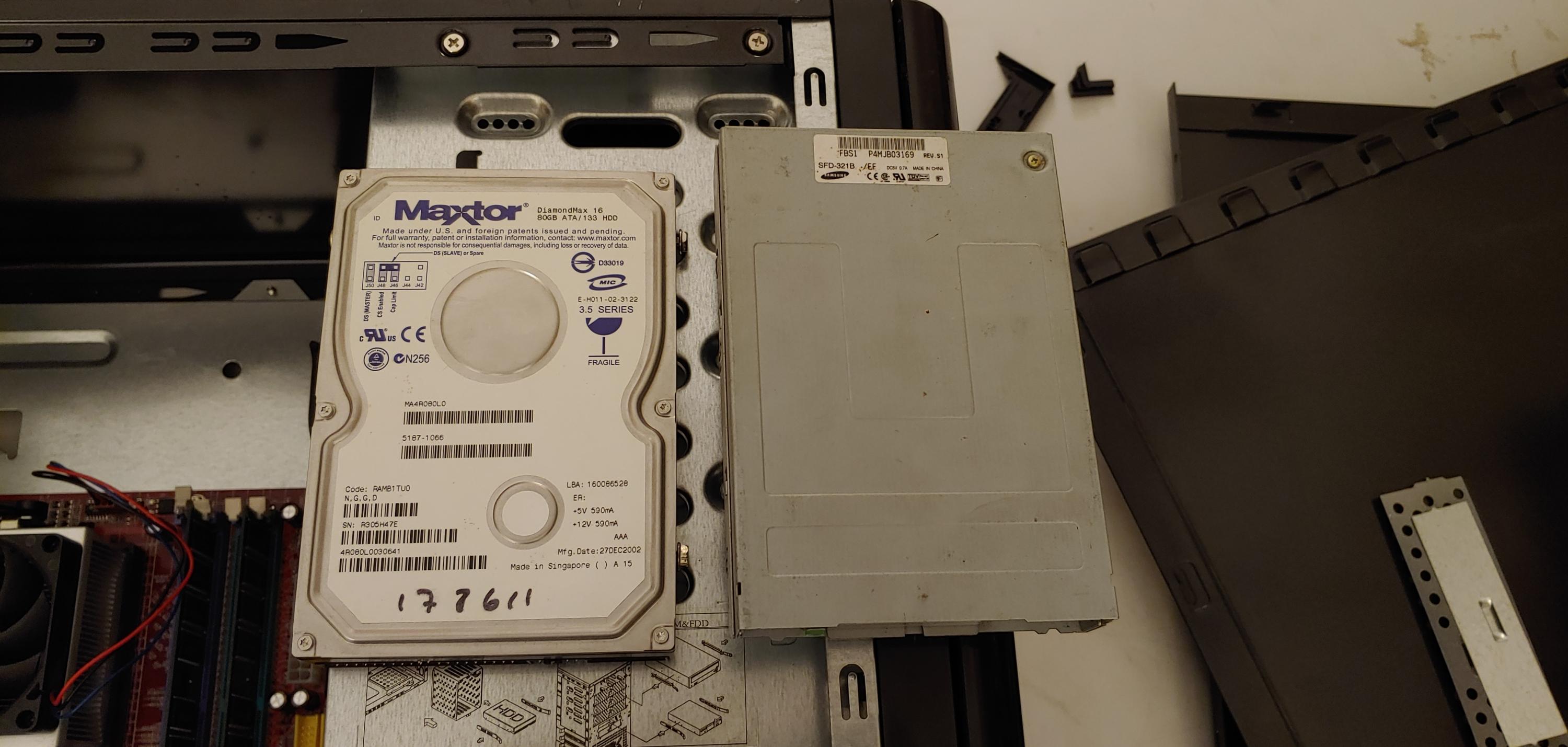

    Both HDDs installed and cabled up:
    Also, I manually jumpered both drives for master/slave when I added the Maxtor drive.

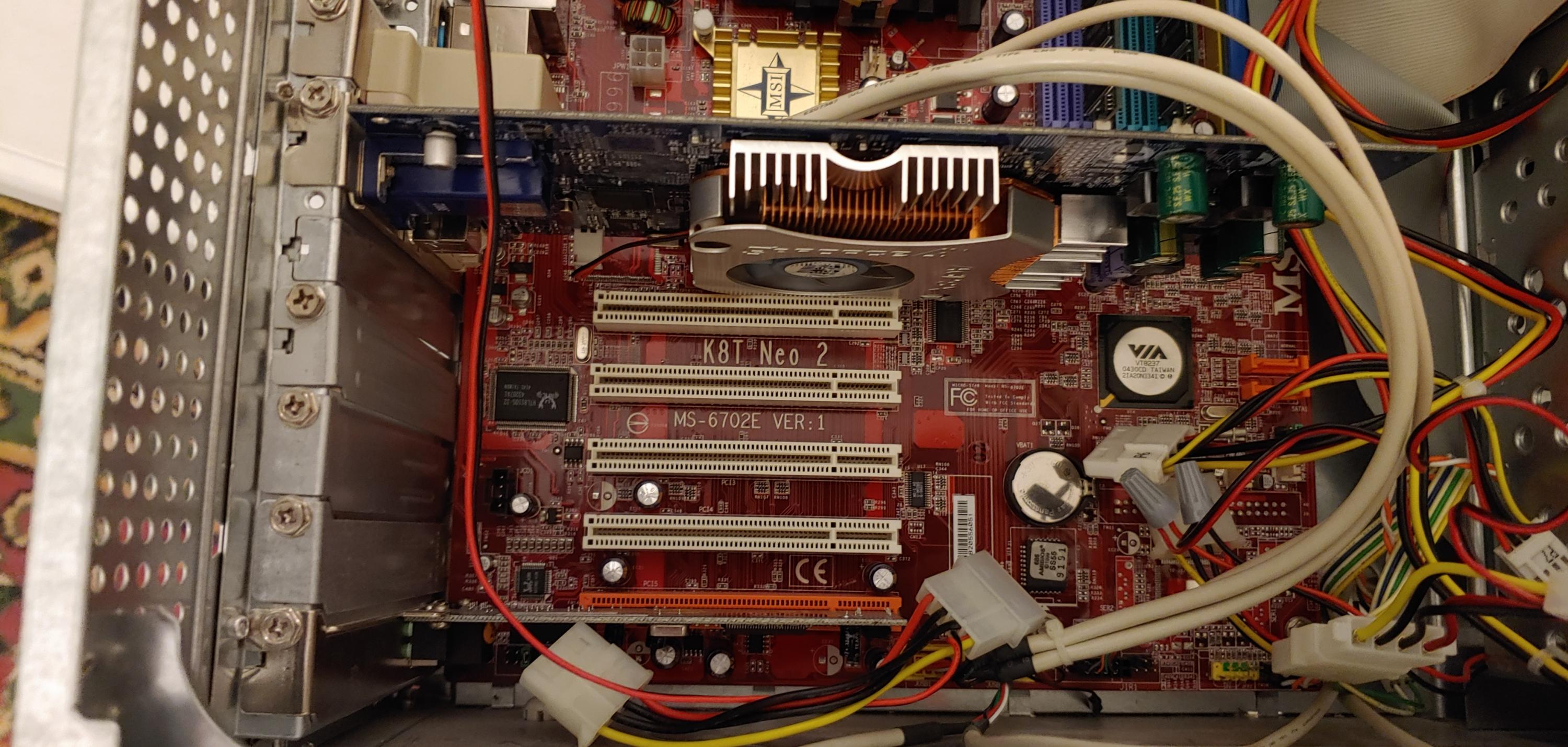

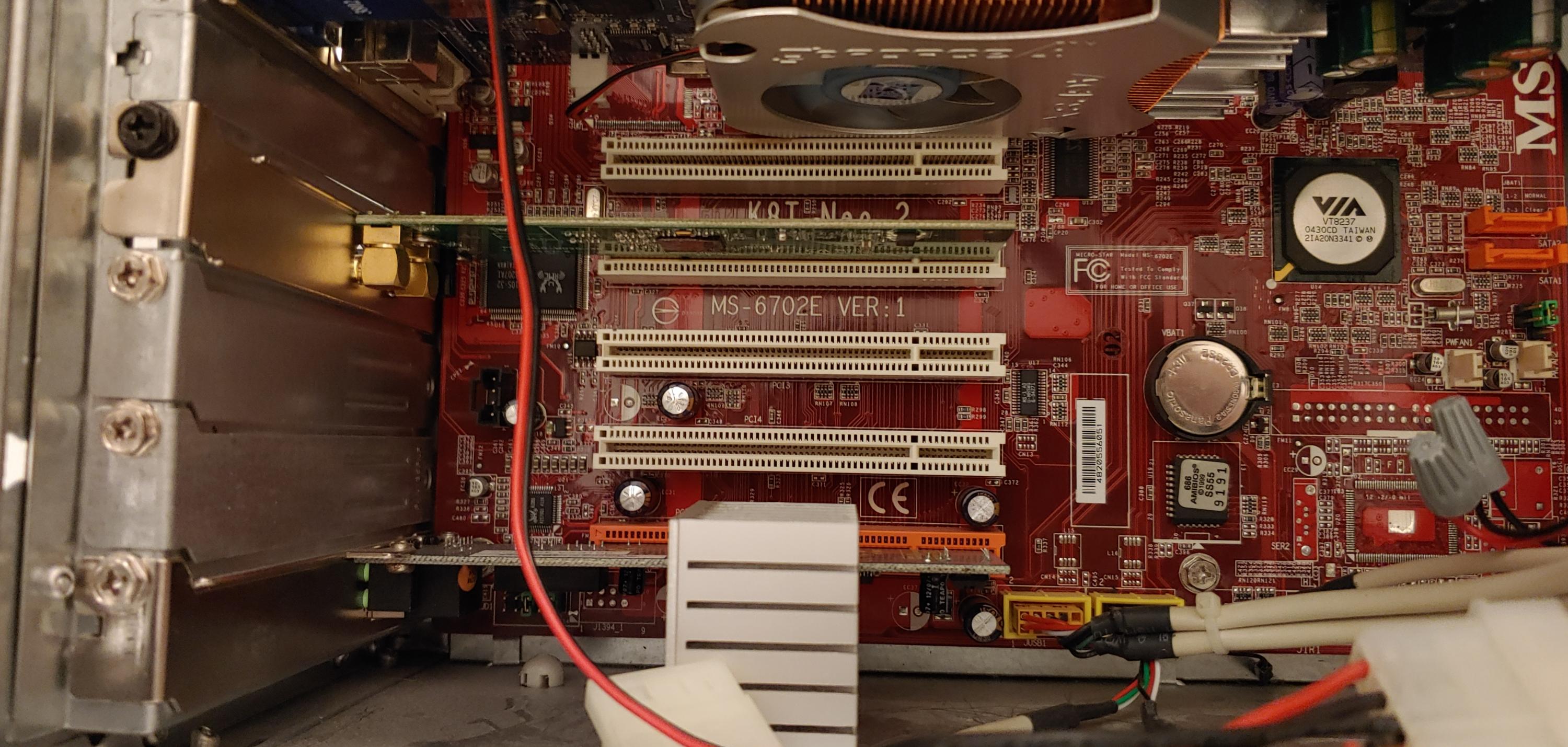

    Installed expansion cards:
    See that heatsink? I had that attached to the wireless card's chipset because it would overheat and do all kinds of bizarre crap without it.

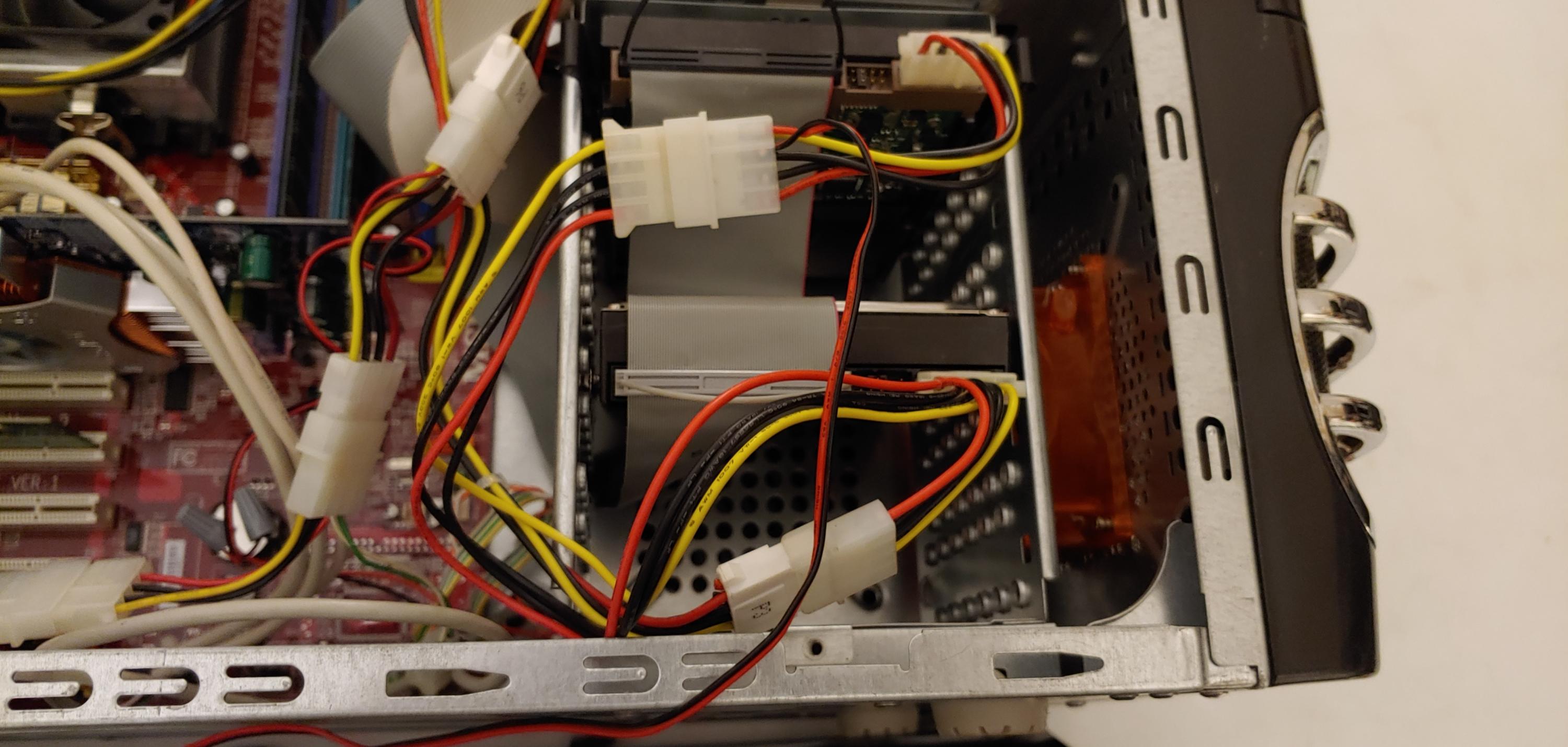

    Molex Madness. Lots of splitters and adapters here:

    More inline pictures incoming. I took these as I partially stripped and reconfigured the hardware.

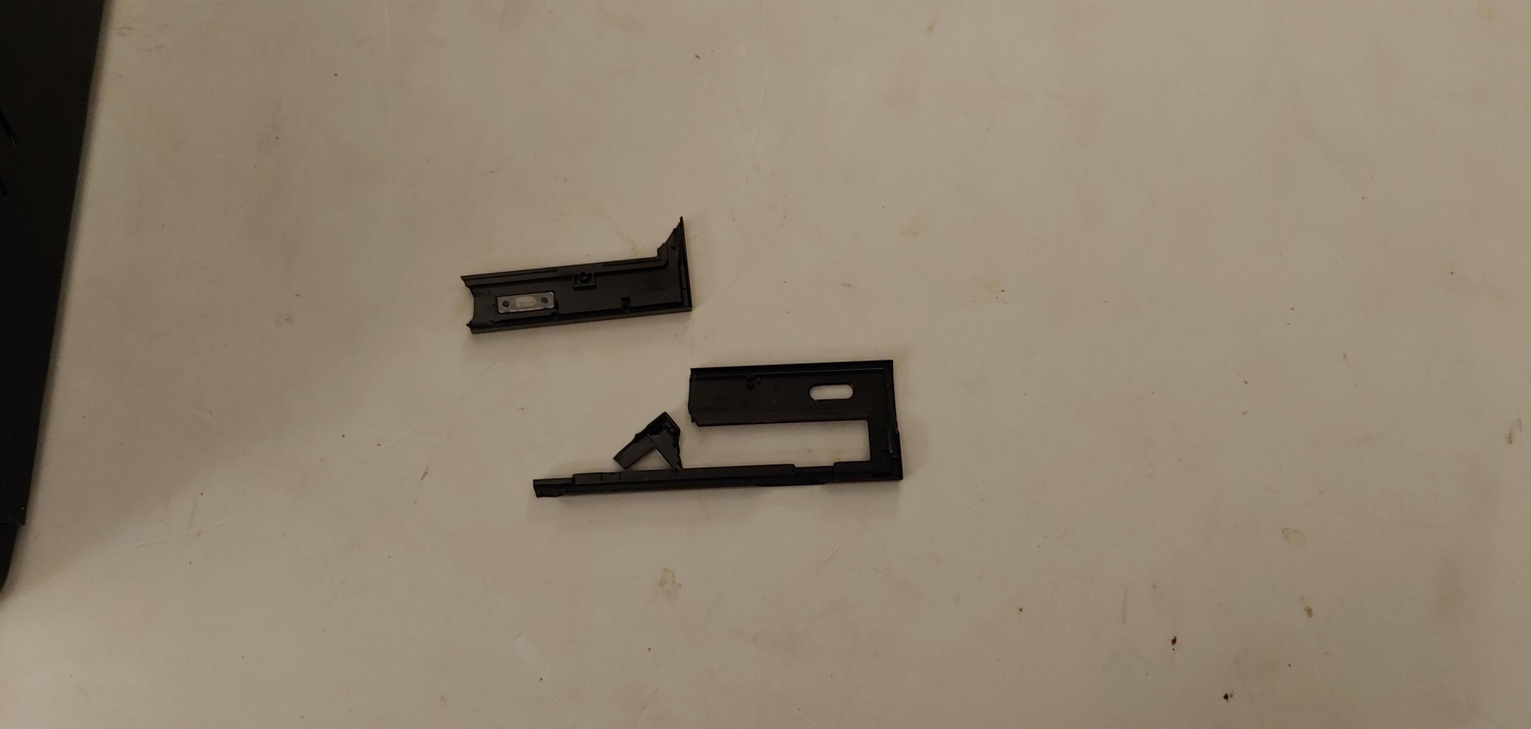

    In the process of partially stripping the computer, the faceplate on the optical drive completely disintegrated to smithereens. As a result, I moved it down a bay so it's protected from junk getting inside. Also, I removed the FDD as it won't be needed anymore.
    Ouch. The IDE connector on the optical drive really didn't want to let go of the cable.

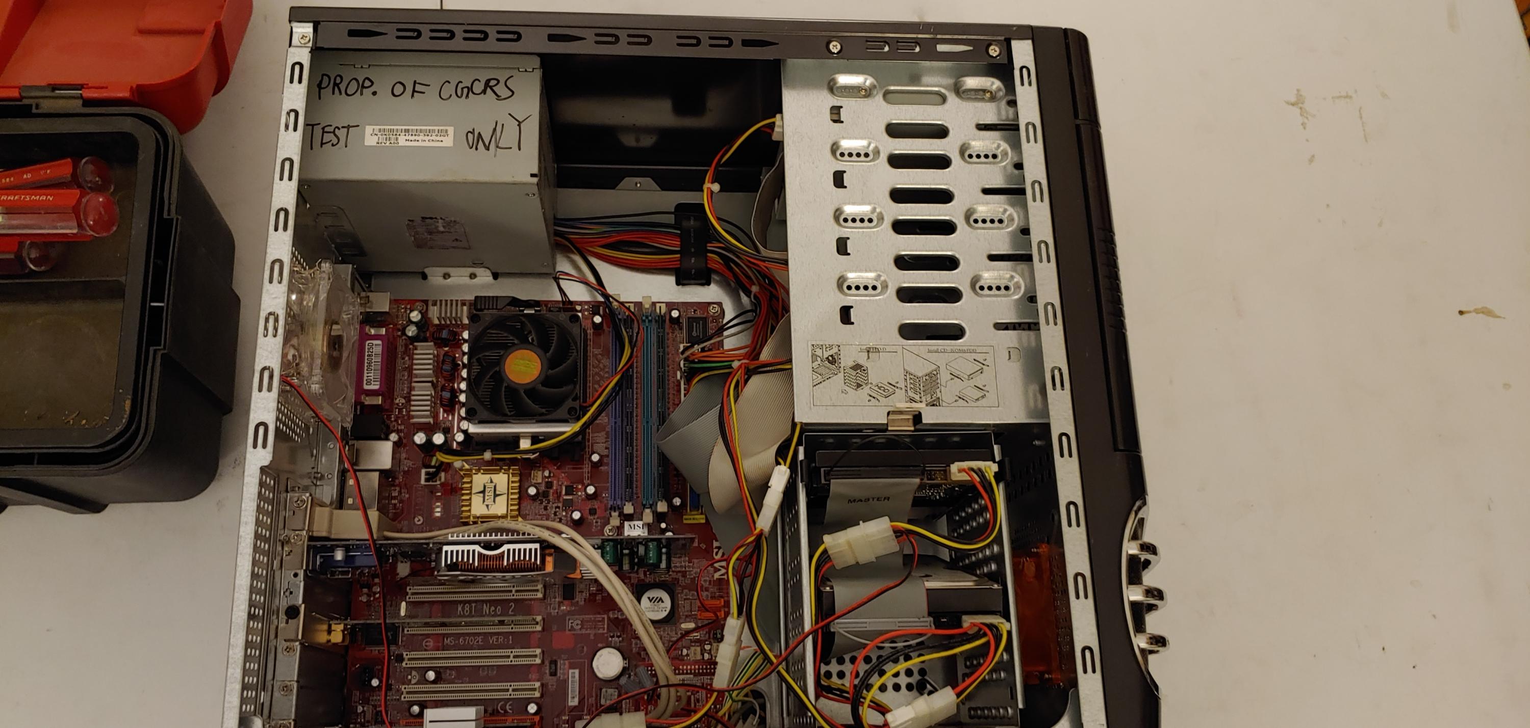

    Partially stripped.
    These won't be returning to the system.
    PSU reinstalled.

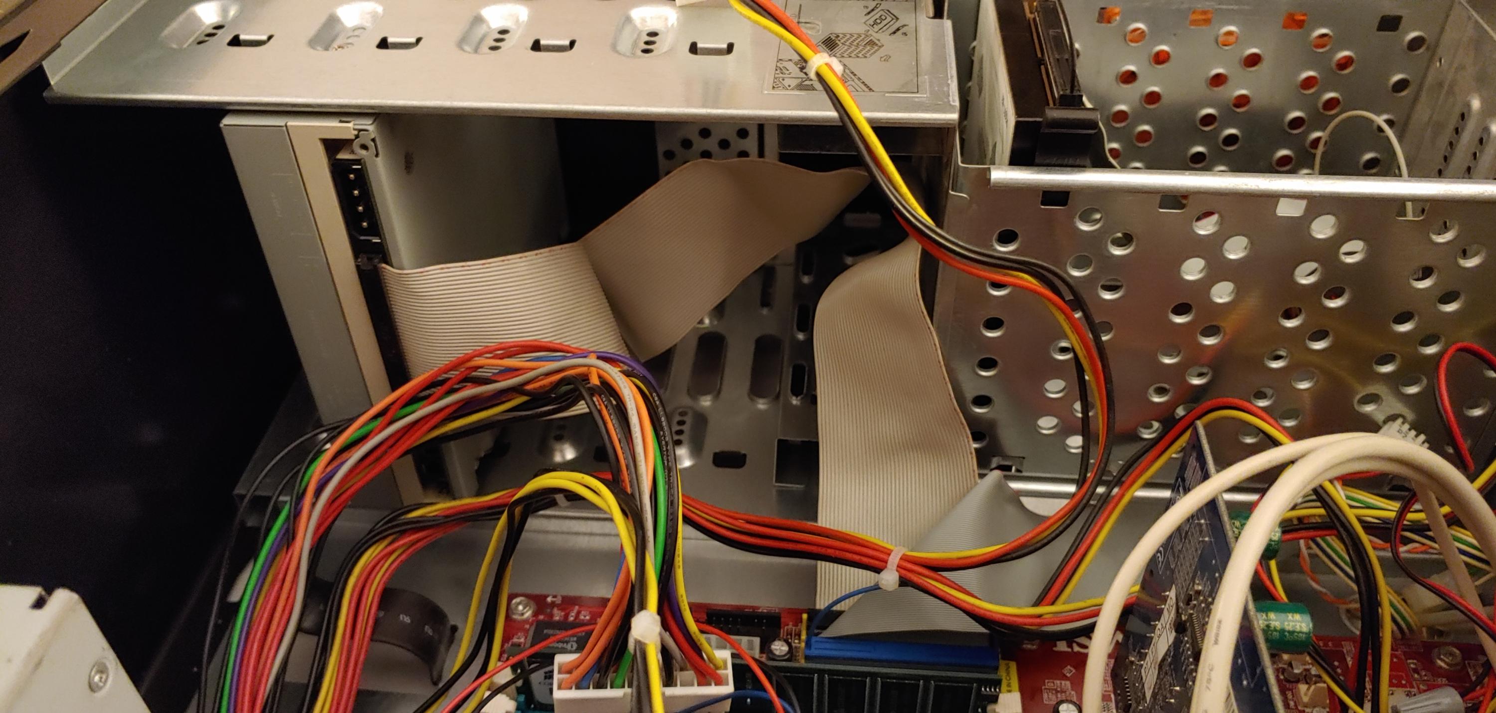

    The lonely 40GB Seagate reinstalled and cabled up.
    ODD installed and cabled up. As previously mentioned, it's been moved down a bay to protect it since it no longer has a faceplate.

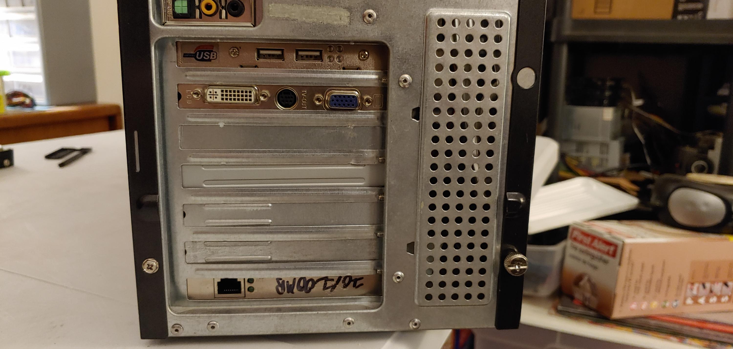

    Wireless card removed and slot blank installed. I prefer to close up any and all open slot blanks on a system when I can. It's aesthetically pleasing and helps keep junk out of it, especially when it's not in use. Open slot blanks are a lot of reasons why roaches and rodents get into systems and tear them up.
    PSU cabling ready to be hooked back up. I didn't hook it back up because there were a couple of pictures to be taken and I was about done messing with it for the night.
    Had to mess up some of my cable management to get the LAN cable to reach the FE controller, which was installed at the very bottom of the case so it could be in the faster PCI slot on the motherboard, as indicated by the orange-colored slot.
    Ethernet cables disconnected from old firewall system. They were reconnected shortly after this, likely for the last time. Yes, it's still on. Yes, those are LED fans hot-glued to the side of it to keep it cool.
    Now to throw it back together, hook it up, and get OPNsense installed and configured on it.

      LOL I'm currently working with one of the exact same case, was wondering...
      This case is obsolete!
      Why?
      The HDD slots cannot take SATA disks
      Why?
      Well, unless you have 90° SATA connectors, both power and data, you can't close the side cover if you have SATA hard drives installed there
      I ended up having a few disk rails printed as I didn't have any and couldn't figure out a way to incorporate deeper SATA connectors and still able to close the case without flexing and damaging the cables.
      BTW, there was a P4 MB in here, alas it wasn't stable. I replaced it with that P3 I was talking about in this case. I have an Athlon XP2100+ somewhere but the P3 could handle 1.5GB RAM, the XP2100+ could only take 1GB
        i thought the wireless card is the middle card? dont see any heatsinks on that. the lower card is the wired ethernet card and thats the one that seems to have the heatsink on it.
        also u have bulging teapos on the pci slot above the orange one. better recap those lest the installed pci cards take a dump from the bad caps!!

          Didn't even check the caps?
            Wireless card is the middle card. The heatsink fell off of it, likely when I was moving the system to the table.
            Didn't even notice the bulging caps. If/when I have the money and time to down the system to send the board off for a recap, I'll go ahead and do that. Which, depending on circumstances, may be soon.
              For crying out loud, this is BCN....we all look out for eachother....if funds are tight, just cover the shipping, I'll take care of it.

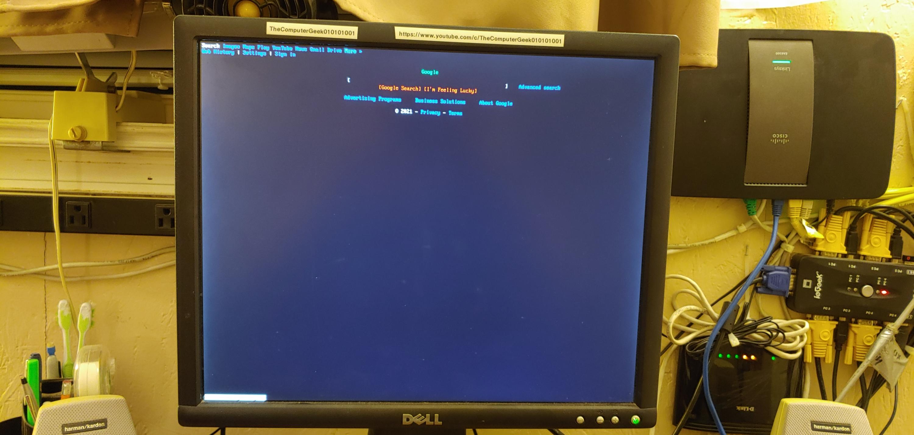

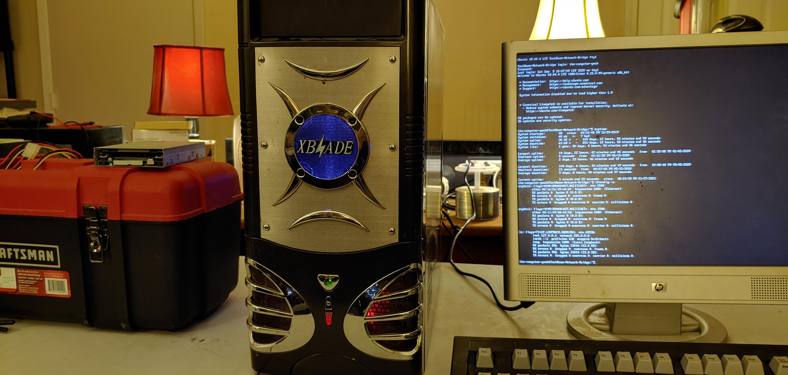

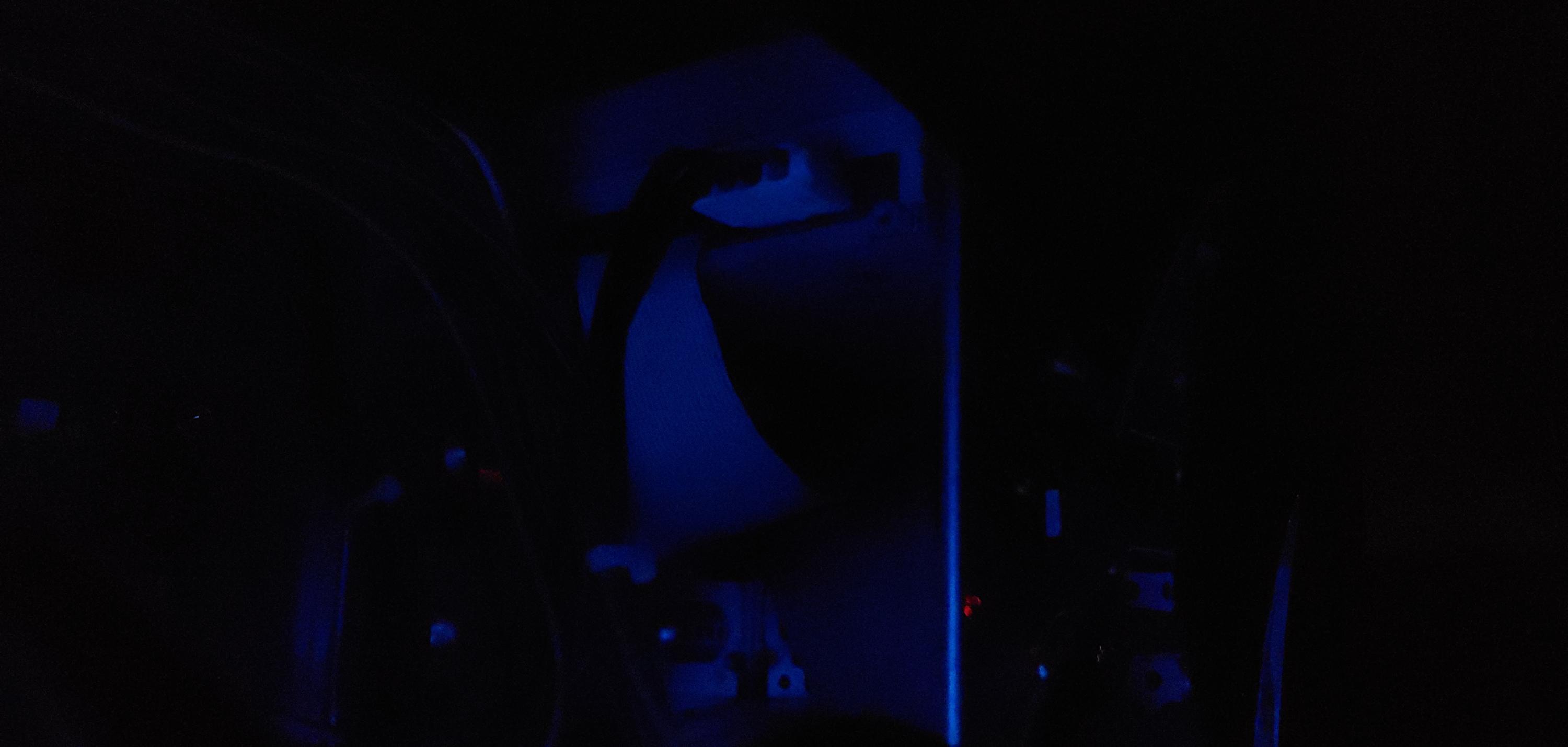

                        More progress. Got it back together and in it's place. Old firewall system is officially out of service for the first time since early 2018.
                        PSU fully cabled up. Since there's no floppy drive, I can plug the HDD directly into one of the PSU's Molex cables.

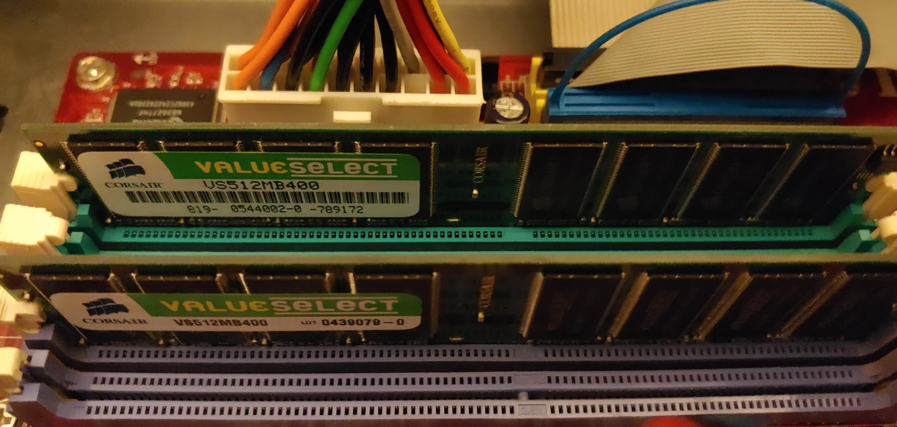

                        1GB of DDR1 RAM installed.
                        All buttoned up.
                        Doesn't that look plain awesome?
                        Another butt shot. No more wireless card.
                        Optical drive no longer exposed.

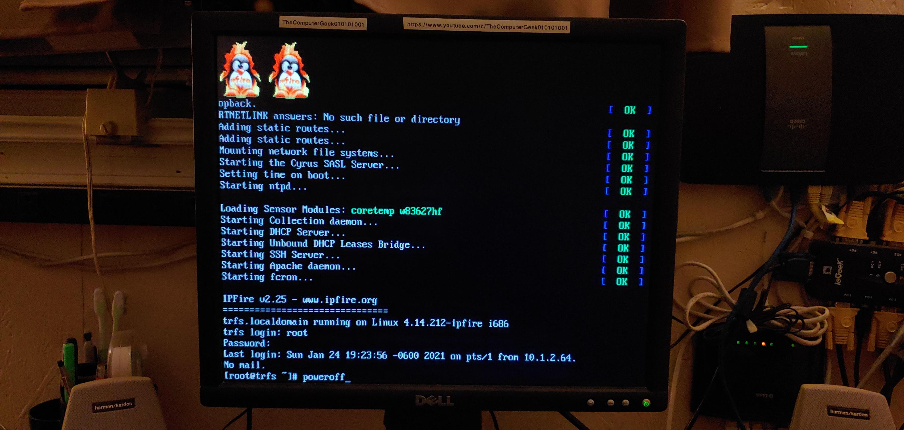

                        Shutting the old firewall system down for the last time.
                        Powered down...
                        ...and power cut.
                        Remains of the ODD's faceplate.

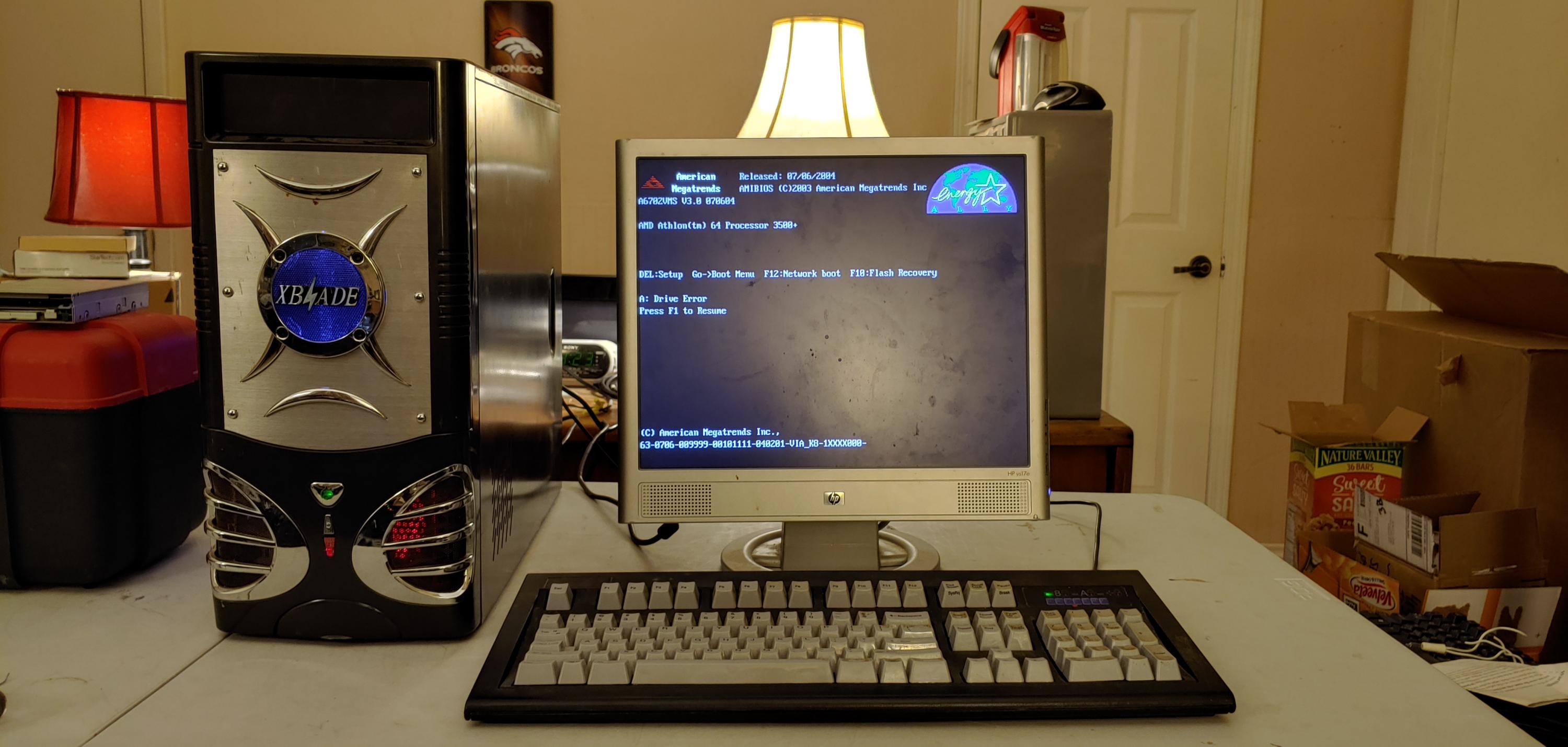

                        Test setup.

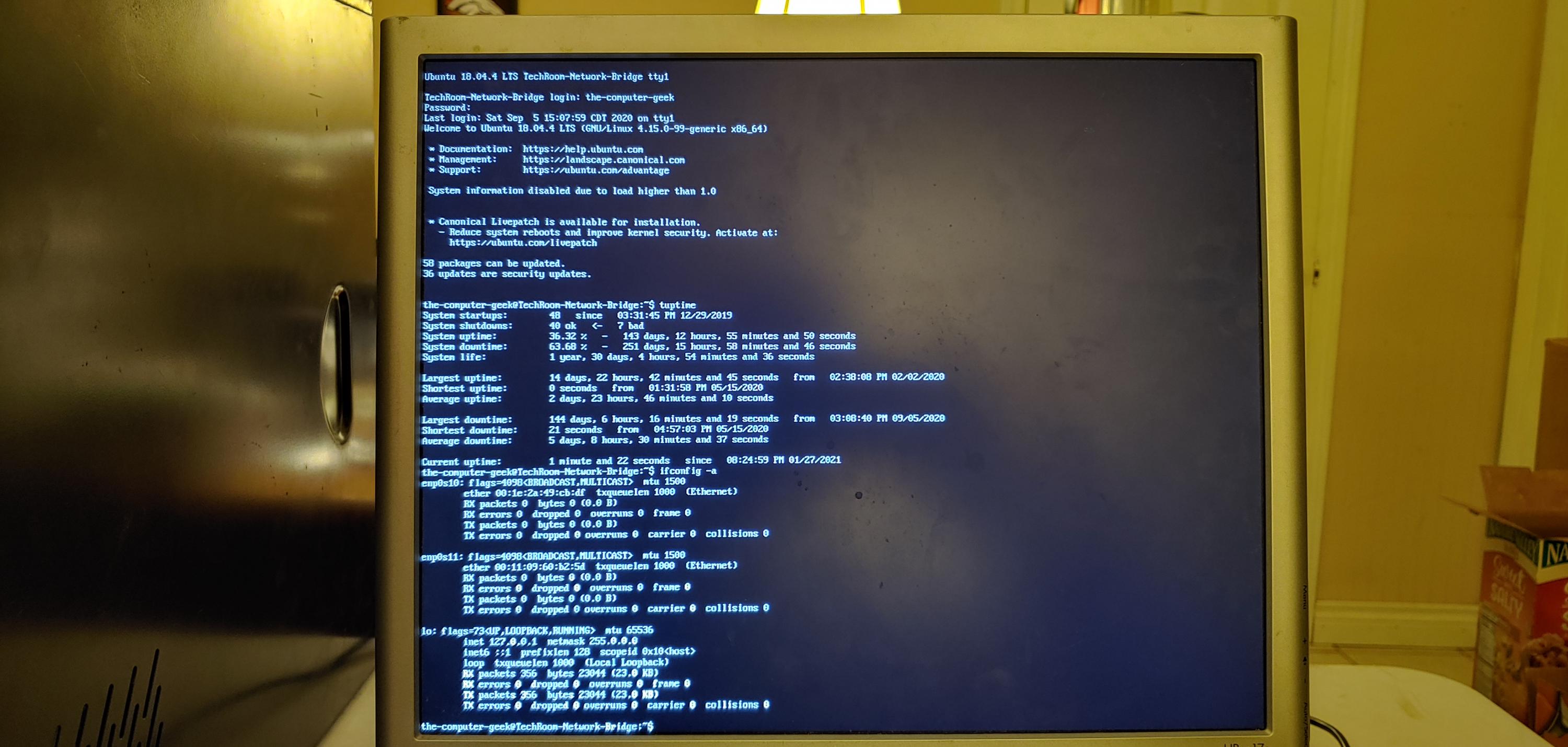

                        It's alive!
                        First boot in 144 or so days.

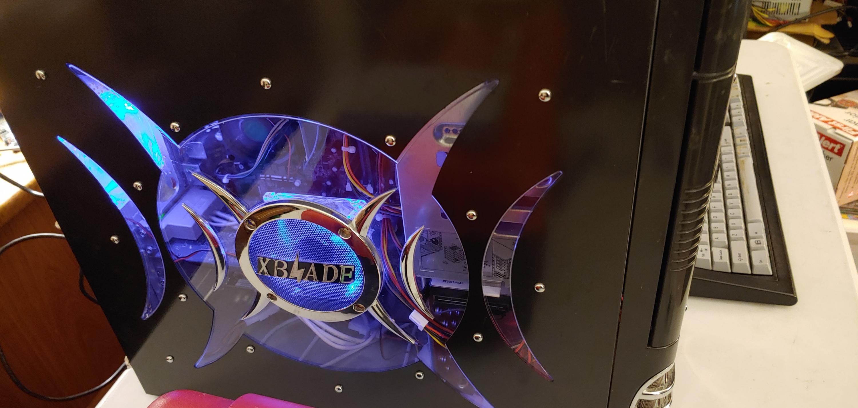

                        More XBLADE awesomeness.

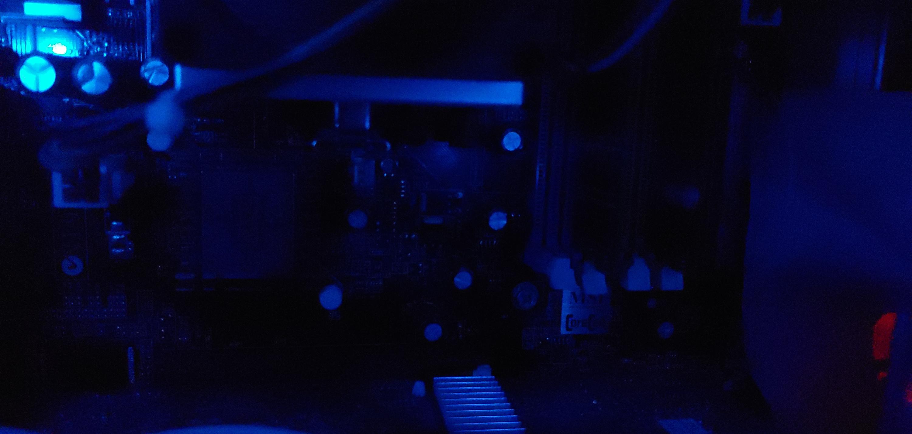

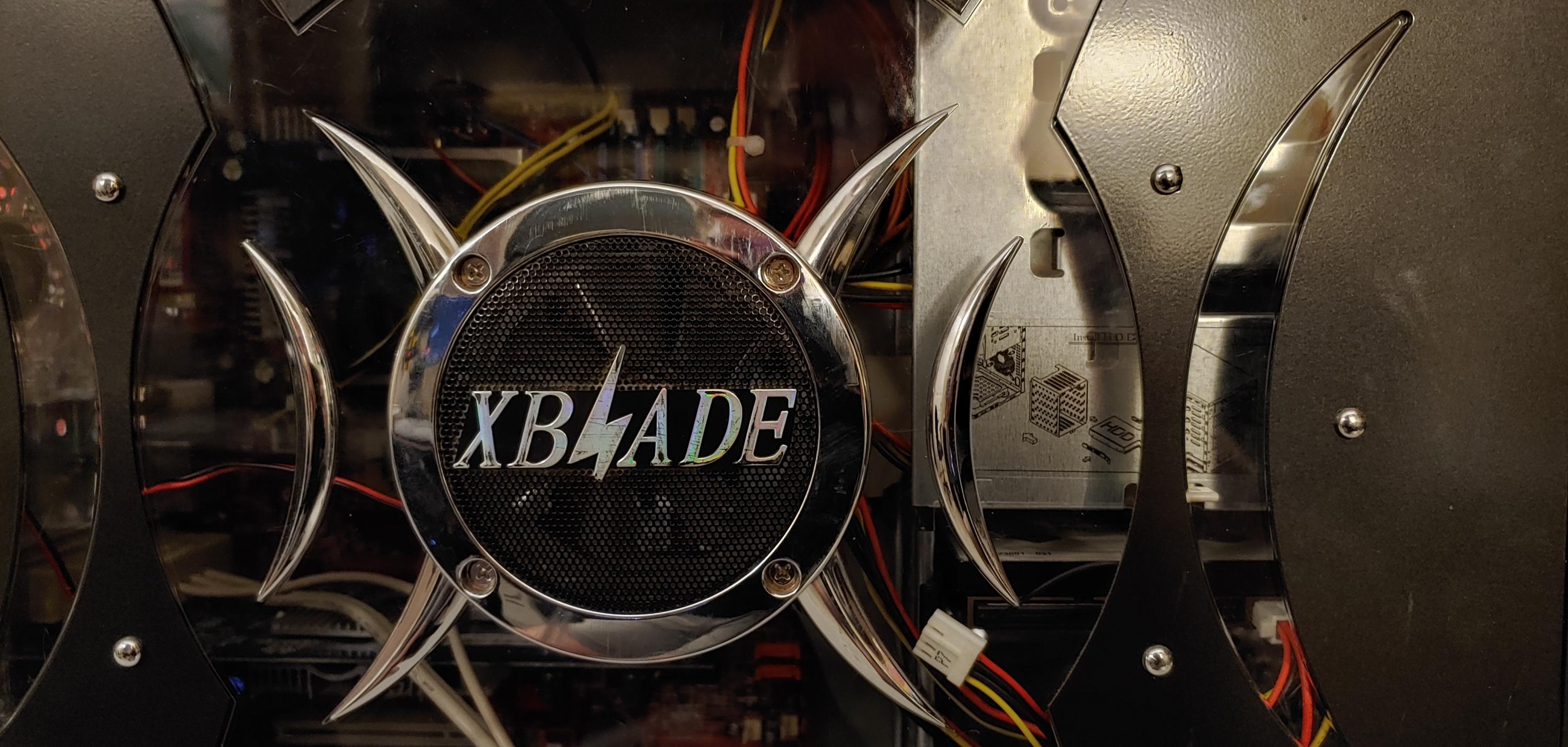

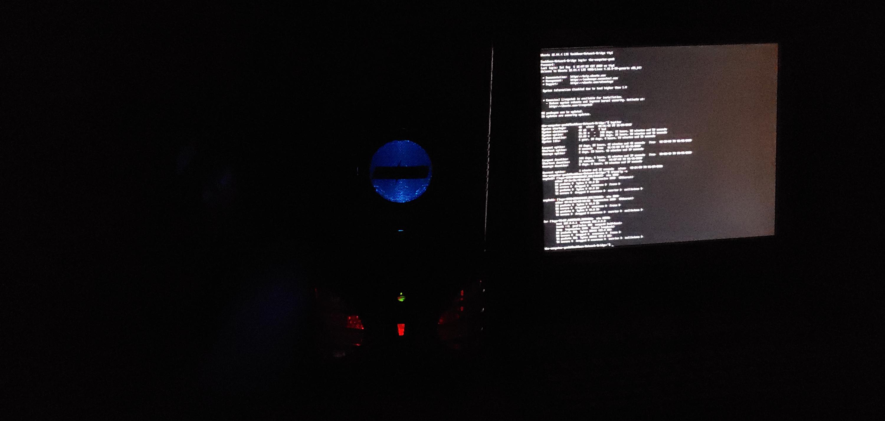

                        Killed the lights for these photos. This is where it really shines.

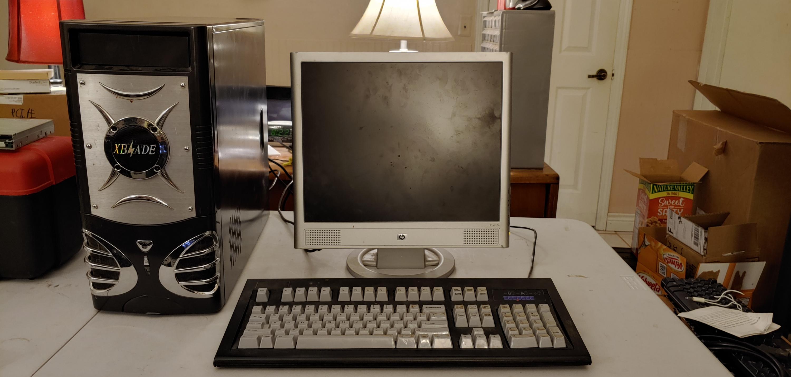

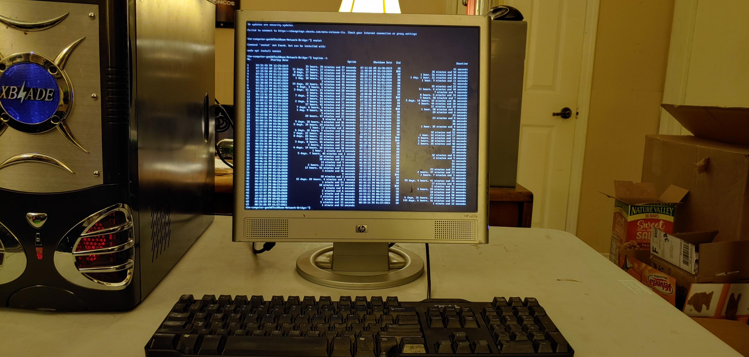

                        Up and running on a USB keyboard.
                        In it's new home.
                        Online (on an Ethernet connection) for the first time in over 8 months.
                        Had some trouble writing an OPNsense image to my USB drive. Either the downloaded file was full of nothing or it refused to boot for whatever reason. Don't expect to see much progress today. Will be pretty busy. Now all I have to do is install and configure OPNsense. There might be an interesting twist in terms of the motherboard, so stay tuned.
