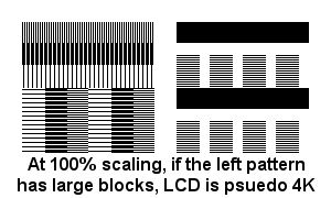

              Here is a test pattern to tell if a 4K panel has actual 4K resolution:
