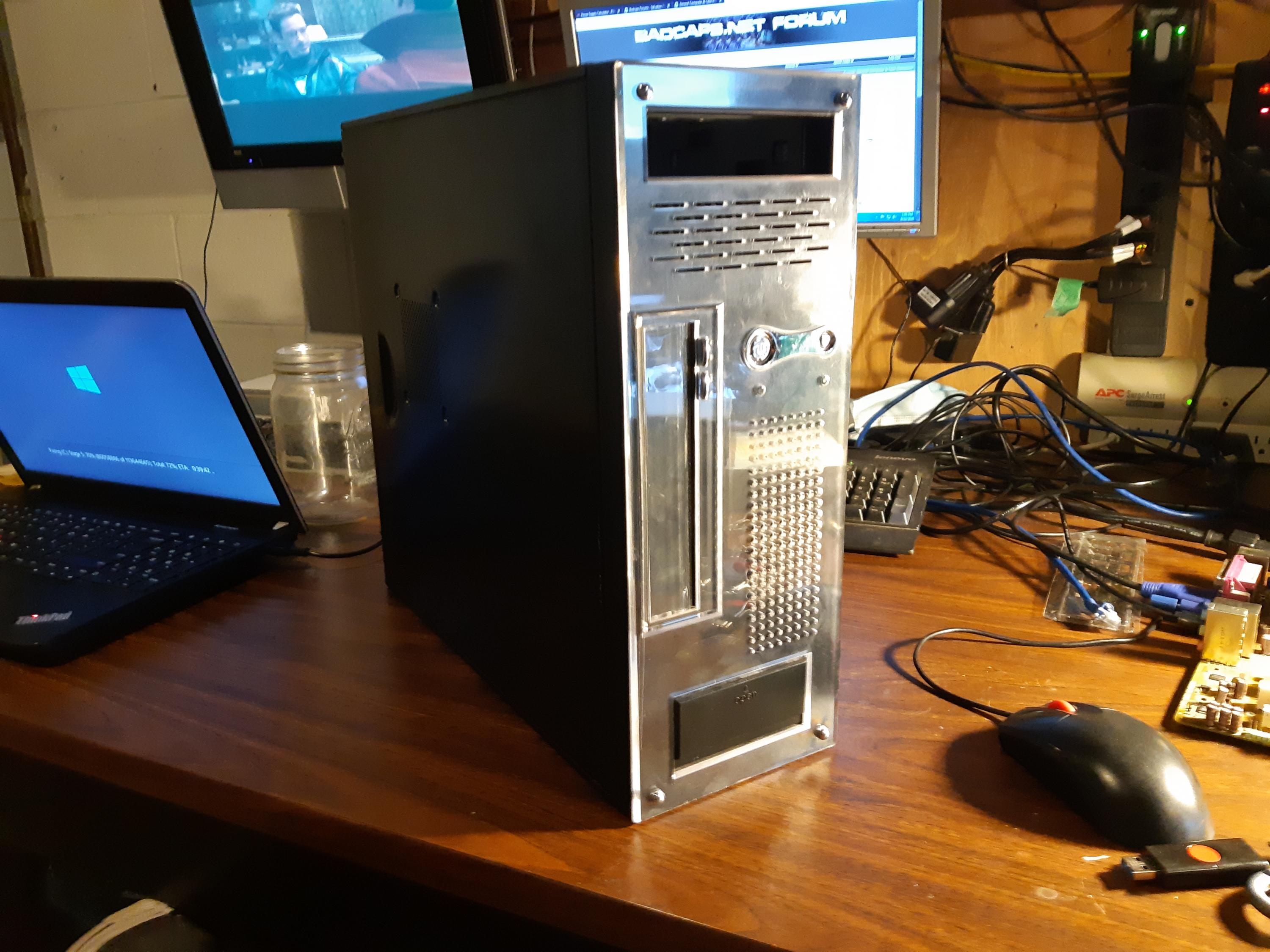

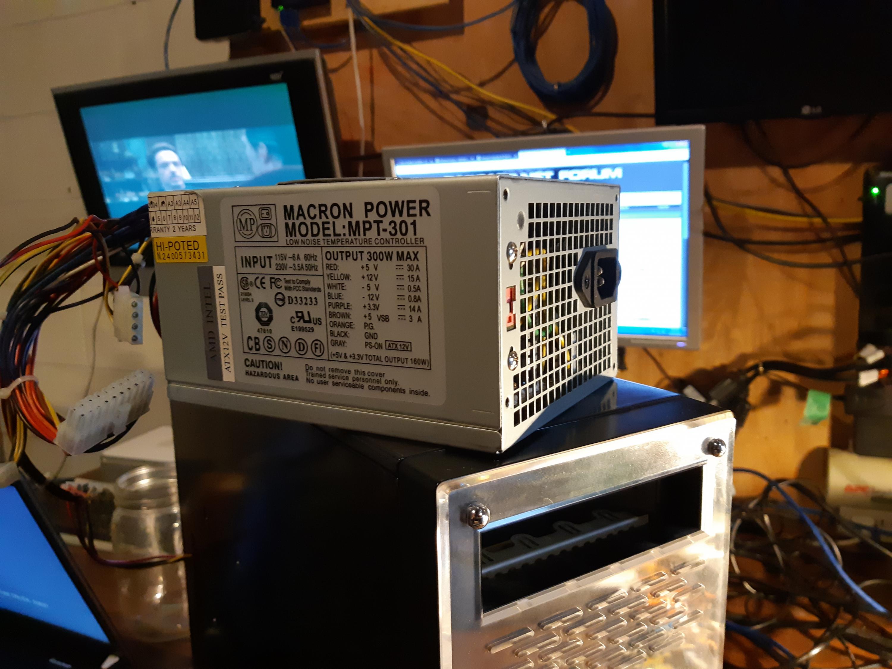

    Hey everyone, I'm trying to find a suitable replacement for this old "slim ATX" power supply. I have an old case in the slim ATX form factor that I want to turn into a home theater PC with "new" (not that new) parts, however the power supply is quite under powered, only about 300w. The make and model is a Macron Power MPT-301
    the dimensions for the PSU are as follows:
    155mm x 120mm x 85mm
    Does anyone know of any compatible power supplies that would fit?
    I've attached some photos so y'all can see

        AM2+ Phenom X4 9950. I was going to use 4x4 ddr2 sticks, but for some reason they stopped working after a bios update

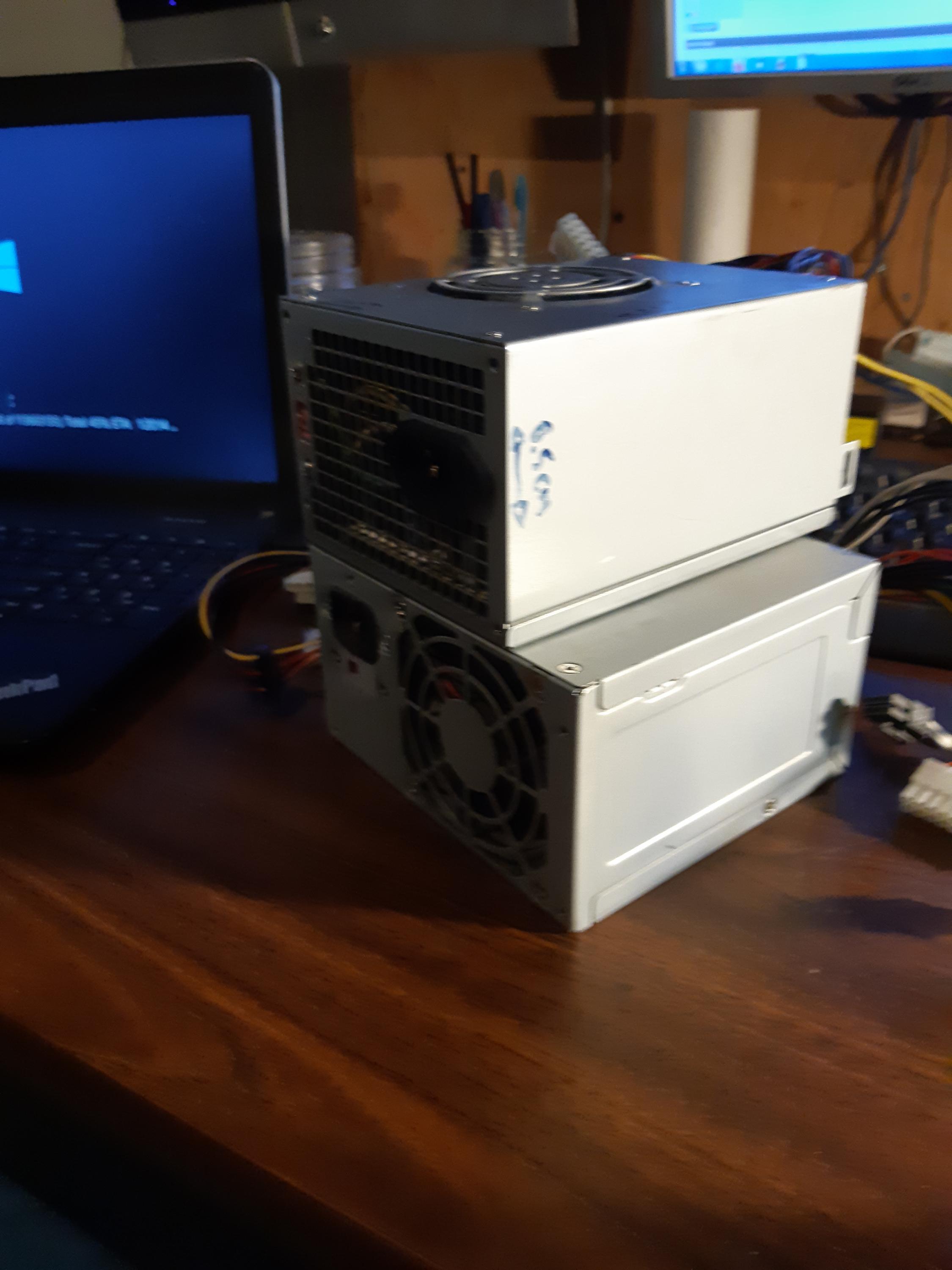

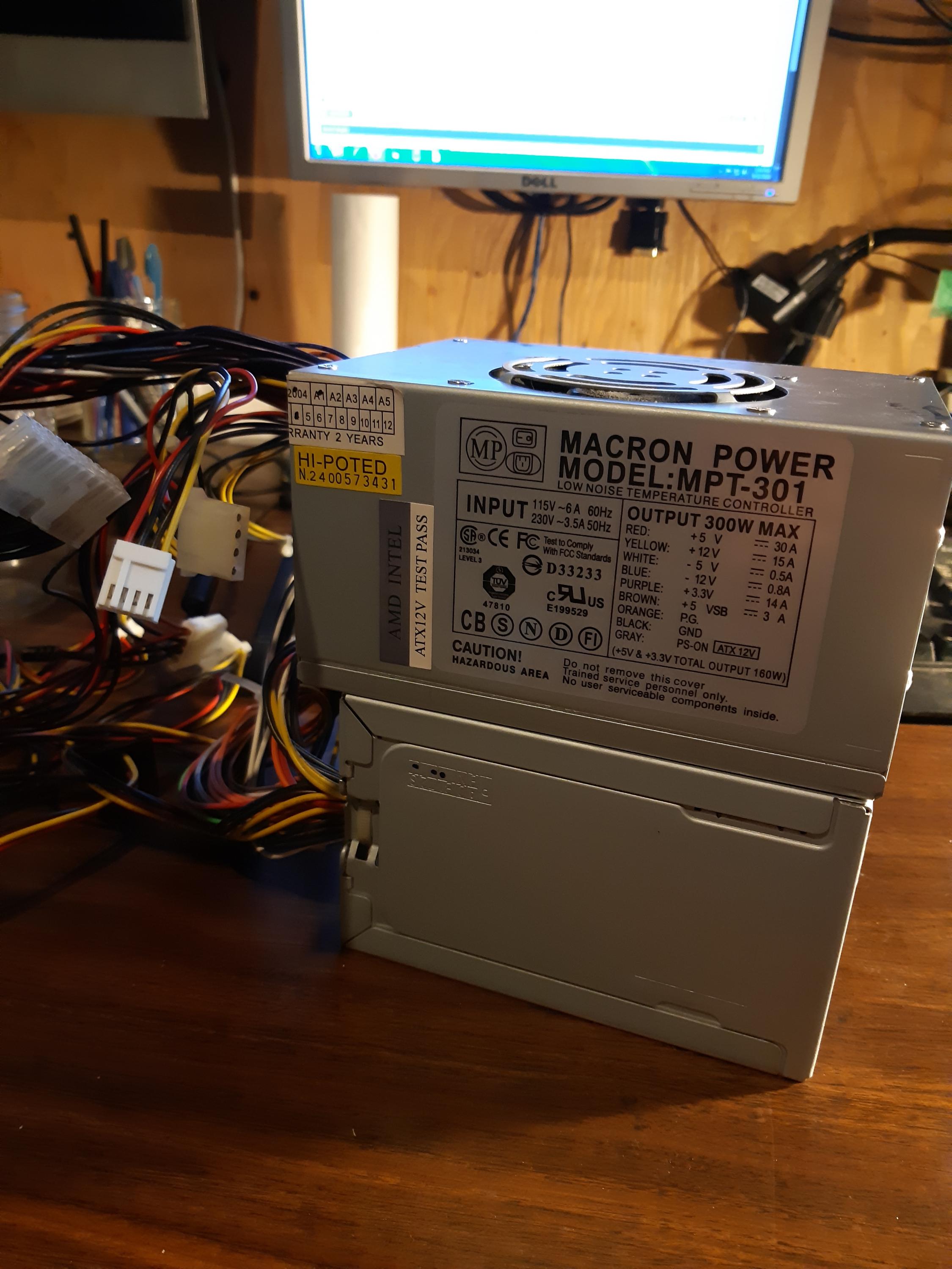

        Looks like regular ATX to me. Just that they made a slim opening in the back.
        it's not, it's skinnier and longer, and an ATX PSU does not fit into the case, see attached pics

          It looks similar to TFX, but seems taller (almost looks like they took a standard-ATX PCB and turned it sideways and slapped the fan on top). It might be some now dead proprietary form-factor that won't have a "drop-in" replacement. TFX could probably be made to work, but may not be a perfect fit.

            I found this
            https://www.atxpowersupplies.com/250...LTATX350SD.php
            you could try to find a higher version of that slim PSU, I don't know the form factor offhand but i've seen them before
            they say it has "-5v" like the original but pin 20 is -5v on standard ATX

              Yeah it's an oddball form factor from days long past. I saw an image in google with a graph showing psu dimensions, and I thought it was "slim atx", though I cant find that anywhere now.
              Looks like I'm gonna have to fab an adapter plate for a more modern cpu, as I'd like something in the 500+ watt range

                Cobble the "mounting surface(s)" off of the old power supply and use that as a bracket (mount new PSU to it!).

                          Not to sound like a grouch, but a 1st gen Phenom X4 in a small case like that is not a good idea at all. It's going to run very very hot and likely neither the motherboard nor the video card will survive for long in that PC.
                          As to the topic in hand...
                          Macron actually made some pretty decent PSUs that could meet the specs on their label. With 15 Amps on the 12V rail, this PSU should be enough even for the Phenom X4, provided you use integrated or some low-power GPU only (under 30 Watts TDP)... which makes sense anyways, since you're going for an HTPC and not a gaming PC.
                          The only downfall of those Macron PSUs are the caps. At this age, yours is probably overdue for a recap (if you plan to reuse it, that is.)

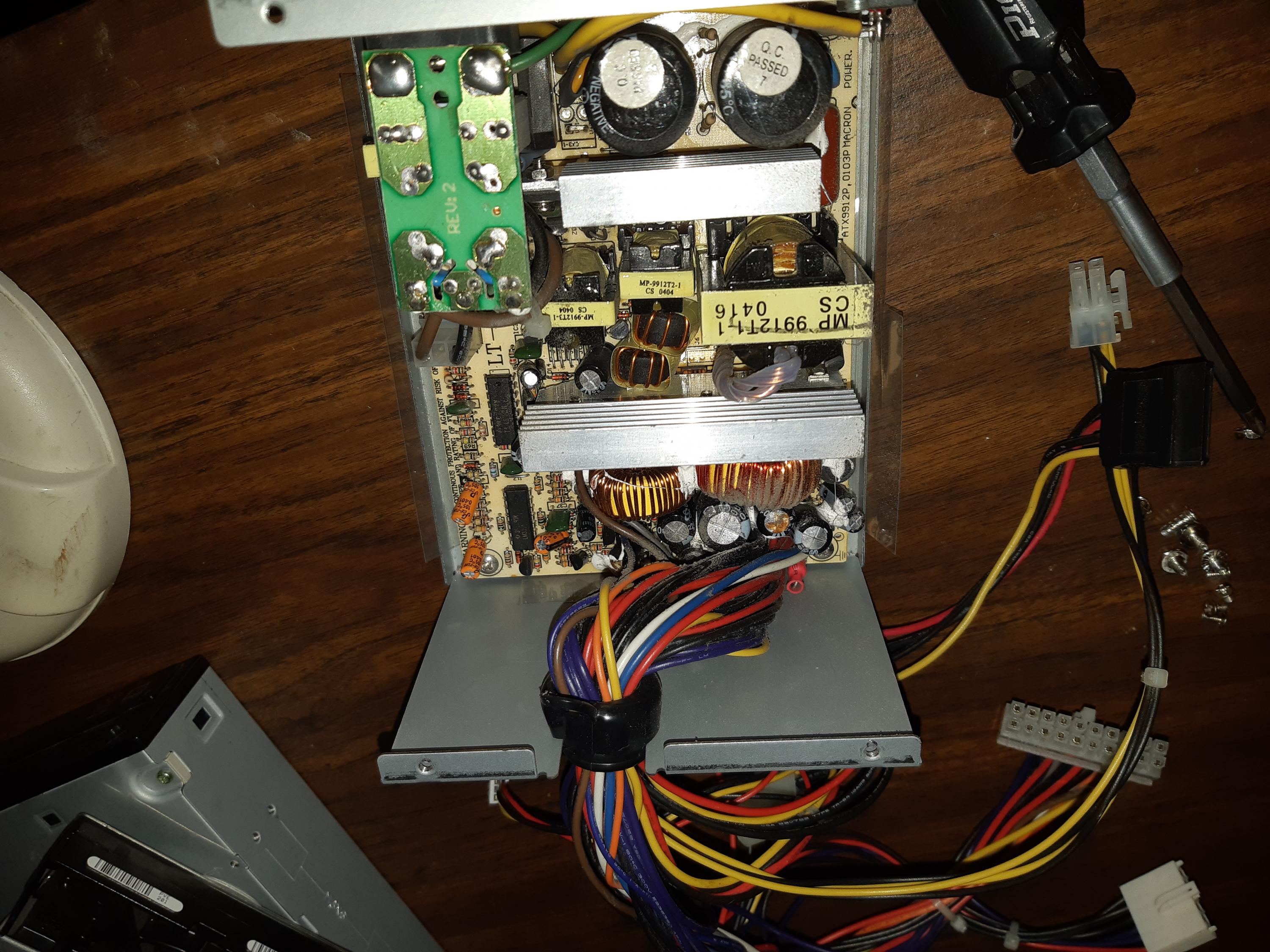

                            I opened the Macron PSU because it was making noise, and found some leaky/swollen caps. If I dont get it recapped, I'll probably cut the rear facing panel and drill some holes so I can mount a modern PSU.

                            I did open up the macron and found a leaky cap and a bunch of bulging caps. I may take it to get recapped as I am spooked by PSUs and big caps.

                              Here's a pic of the blown cap. There's also two with slight bulge at the top
                                        Yeah, you really ought to replace all of the caps in this PSU if you want to get it working. The only exception are the two big 200V caps on the primary, as those rarely have problems in old PSUs like these (and that's fortunate, because these big caps are usually expensive, whereas the rest of the smaller caps in the PSU are pretty cheap.)
                                        But like I said, these PSUs are actually pretty easy to recap. The PCB is single layer and doesn't require a powerful iron to work on it. I recapped mine with only a 30 Watt basic soldering iron back in those day, as I didn't have my (more) fancy soldering equipment then. Also, this PSU is not crammed, so you won't have too much problems removing most of the caps. The best part is that the input wires are not soldered, so you really only remove the 4 screws that hold down the PCB, then unplug the input wires and off goes the PCB on your bench.
                                        In terms of caps, these PSUs are not too picky either. Anything from entry-level low ESR to the more "advanced" low-ESR caps will do. In short, just about anything on this list should be OK:
                                        https://www.badcaps.net/forum/showpo...22&postcount=9
                                        Fear not, this PSU. It uses a 2-transistor 5VSB design that drains the main caps to safe levels within just 10's of seconds after unplugging the PSU. And even if the PSU had a faulty 5VSB, there are balancing resistors installed across the two big caps, which will eventually bleed the caps down to nothing within less than a minute or two from unplugging the PSU.
                                        So there really isn't anything dangerous within this PSU. As long as you have it unplugged from the wall while working on it (obviously!!! but I do have to give the disclaimer here, because I've seen people try to do something like that before.)
