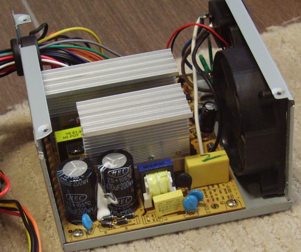

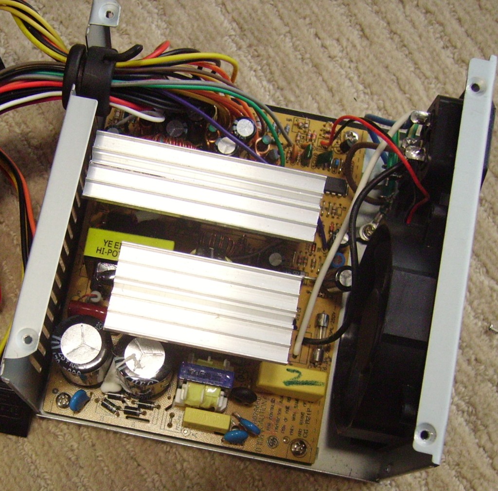

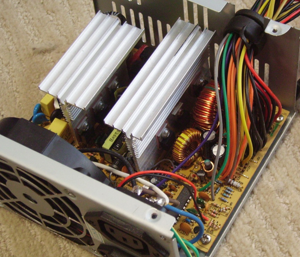

                          Got some pics now. Here they are.

                            #33
                            Re: SuitCase PC. :/
                            NOOOO!!!
                            i see 4 diodes in place of a bridge rectifier. not even close to ok.
                            not enough caps on the secondary.
                            the wire is too thin.
                            sorry, but your PSU is a POS.

                              #34
                              Re: SuitCase PC. :/
                              Ugh, looks too much like a leadman. You couldn't even put a bridge rectifier in there with how those diodes are arranged.
                              I'd say it's 200W at best. But I would need to see what is on the primary and secondary heatsink.
                              I'm going to assume it is like most cheapies and has two 13007 knock-off's which the good ones from fairchild are really only good for a 300W unit.
                              Secondary chokes have some thin wiring, as well as being small. All the secondary rectifiers are to-220 which leads me to believe they are probalby all 20A rectifiers, but most of the time they cheap out for the 12v rail and use a 12A or a 16A unit there. Thought it looks like there are two rectifiers on the 12v rail. Still, that dosen't mean something else wouldn't go poof in it, especially since the primary transformer is microscopic.

                                #35
                                Re: SuitCase PC. :/
                                Looks worse than Deer/Allied, but not horrible like Leadman/Sun Pro (probably closer to L&C, but with better output filtering).
                                The input rectifying diodes are really are small, but heatsinks seem okay. At least there is no two-diode treatment for a 12v "schottky" rectifier . That's a big no-no for any system.
                                Might be okay for the system you're using (I'm not too keen about that idea, though).
                                And what the Hec are those caps ?

                                  Re: SuitCase PC. :/
                                  So it's a junk PSU, but it's the only PSU I have that fits and doesn't make a high-pitched squeal under load. I'm also not looking to spend more than I really have to on this project, so I'll use it for now. I might put a better one in it later.

                                    #37
                                    Re: SuitCase PC. :/
                                    I don't know, even that leadman looks pretty good compared to it.

                                      #38
                                      Re: SuitCase PC. :/
                                      Yes, but most newer Leadman/Sun Pro units I've seen here seem much worse than this Codegen.
                                      c_hegge: If the voltages are reasonable and stable, PSU runs cool, and if this whole system will be used only once in a while for light duty stuff, then the Codegen will probably be okay (at least until the caps go bad).
