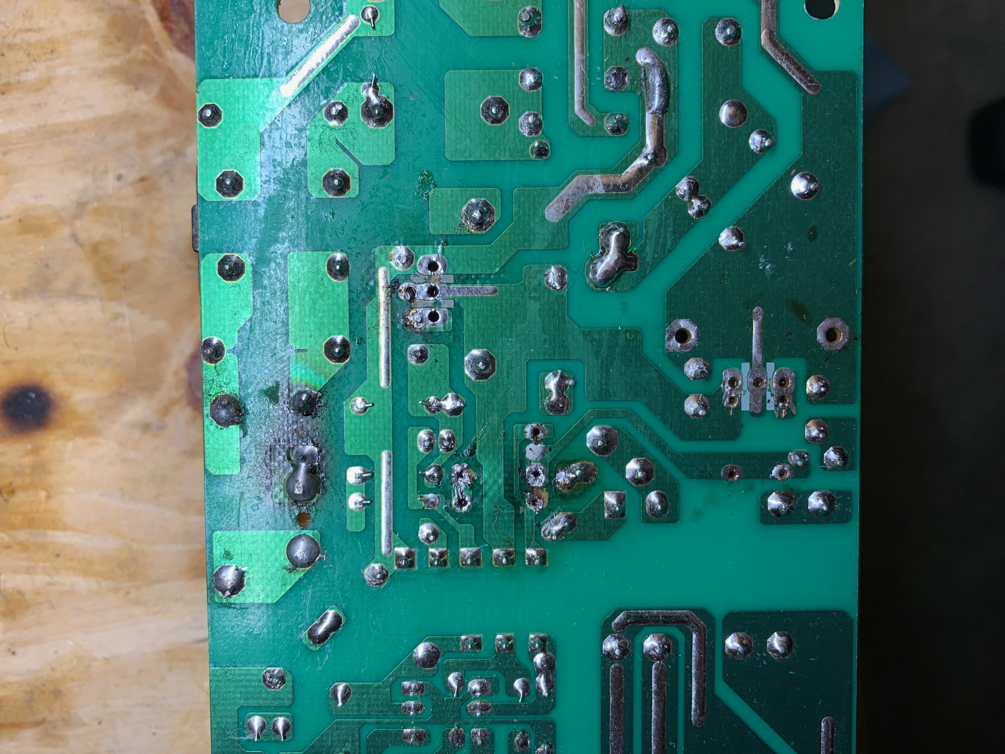

    Hello all
    fun times here tinking with the electronics.
    Minifridge PSU blew up. i replaced a diode bridge rectifier and one mosfet that was shorted. a blown fuse and the varistor.
    ( yes i know i should have replaced both mosfets. Im learning)
    i didnt really find anything else wrong so i plugged in and got some high pitch sounds and after 5 secs fireworks went off.
    Two resistors fried.
    trying to figure out the values of them. No way to tell but hoping someone can give me a general safe bet based on knowledge of switching PSU's.
    ive also found a 4.7cap measuring only 2.3uf, shorted zener diode and out of spec 10ohm(i think) resistor attached to that rail.
    The other diodes in teh area are measuring OK

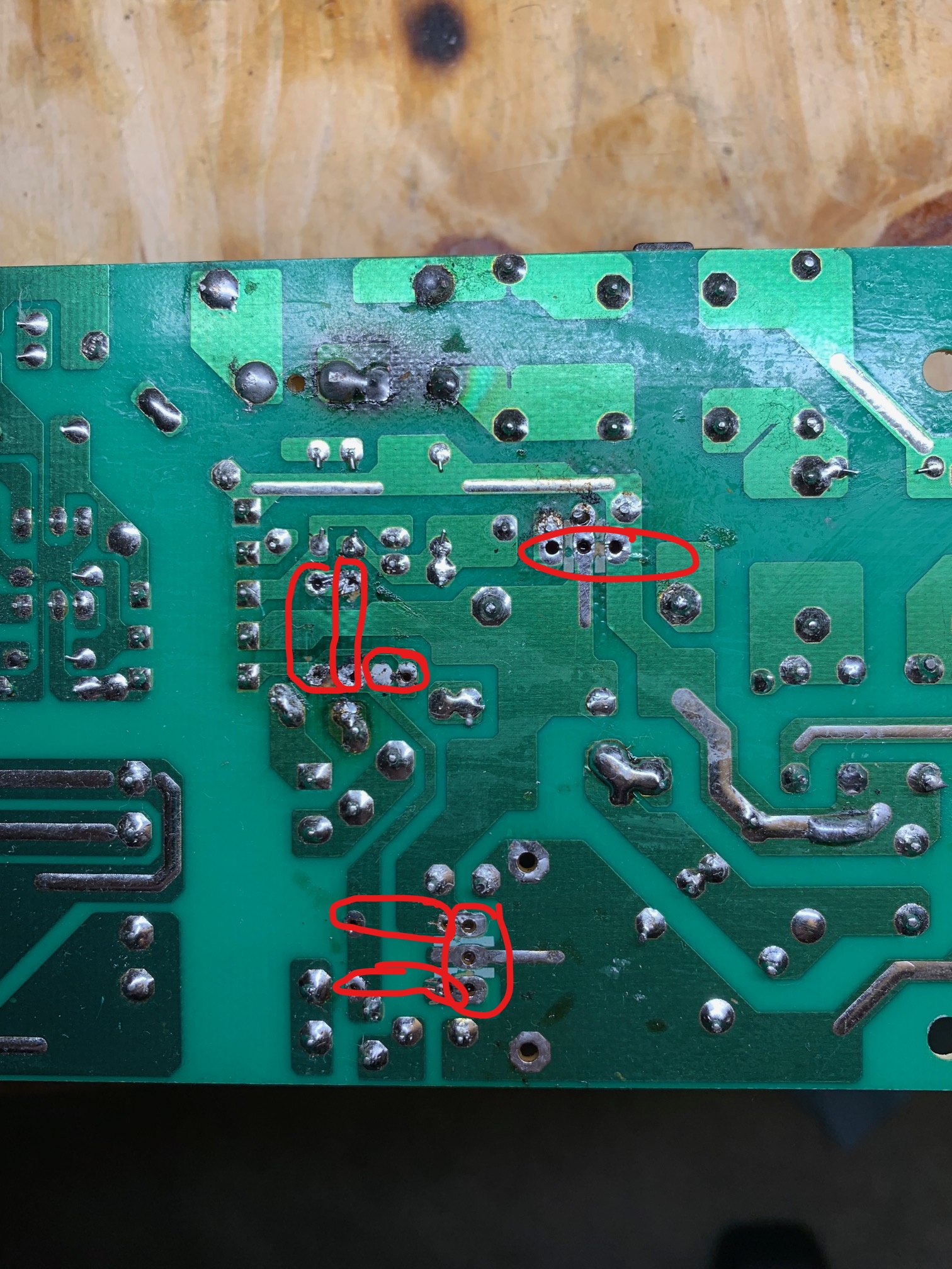

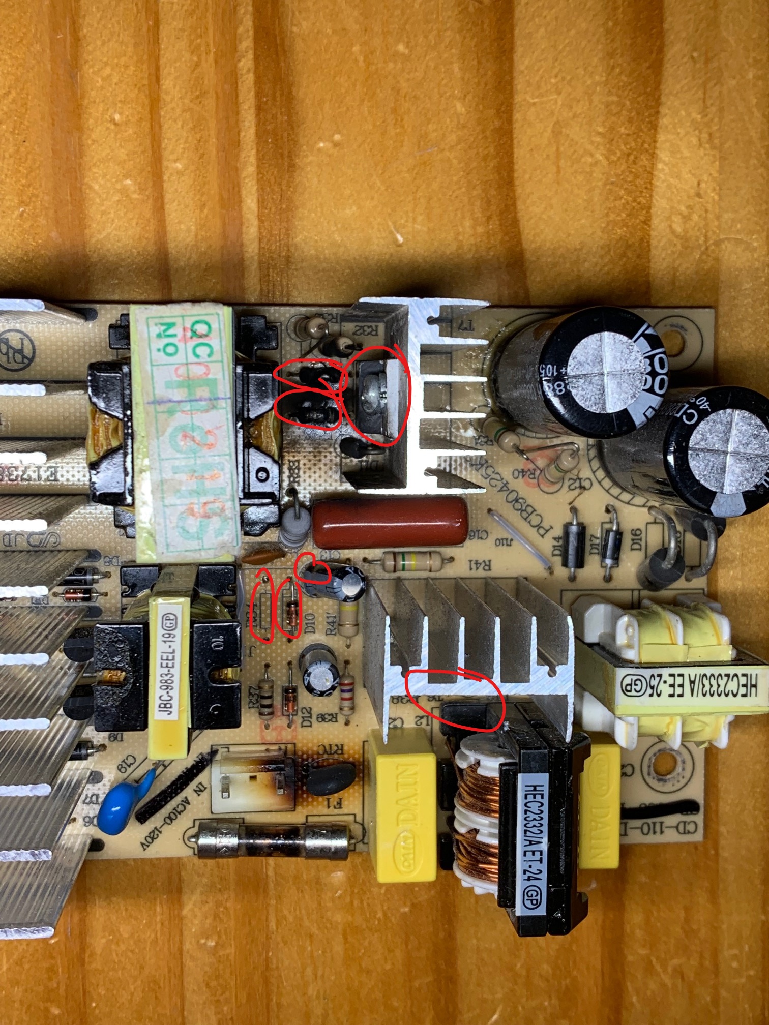

    See picture. ive circles all the components red.
    please let me know what you think happened and what the values could be. and anything else to check.
    Thank you in advance

        They were two 150k resistors. tested good

            well as is, one measured 375ohm and the other 2.4kohm
            i cut the 2.4ohm in half not really sure how to test now lol

              The resistors have location numbers, which are you looking for? ie: R04 = 10Ω, D10 should be the same as D12 (1N4148)
              R36 2.7K, Can you read any of the colors on R35? R35 could be 2Ω

                R35 & R36 are the burnt ones.
                Was unable to read anything, the whole outer was burnt away

                    D12's number is clear in your picture. Check this thread, it may help https://www.badcaps.net/forum/showth...ghlight=cd-110

                                i just wanted to say thank you for all your help.
                                i ended up replacing the two Fets, two burnt up resistors, a diode, capacitor and
                                IT WORKS!
                                I first tested with the light bulb contraption. got nervous because it was making a whine. but bulb didnt light up. so i measured voltage and was getting all of them so i connected it normally and success... been working all week.
