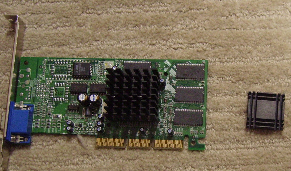

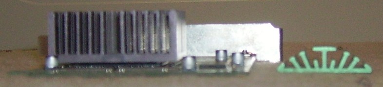

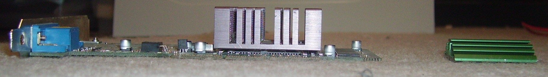

    I recently aquired some arctic silver thermal adhesive and it's great stuff. I found some old 32MB video cards with tiny little heatsinks on them and replaced those heatsinks with bigger, better ones. They no longer get too hot to touch after only running for ~30 mins
    In these pics, the original heatsinks are sitting next to the cards. The first card (the one with the green heatsink next to it) is an nVidia RIVA TNT2 and the second is an ATI Rage128 Pro.

    I have a few old cards with small heatsinks like that as well. They get insanely hot when playing old games. I usually put 40 mm fans on mine and run them at 5v, which is just enough to keep the card cool and the fan quiet. But you solution is definitely better.

        Nice work. Have had to do that as well in the past. Might I suggest putting one of these next to it? Fairly quiet, and keep the vid card happy and cool.

                    With these heatsinks, the cards don't get hot at all. After running for a few hours, they feel slightly warm to touch. However, it might be benificial for a card that runs hotter. I can get small 40mm hamster wheel fans with brackets to mount them. I recon I could probably screw them to the sides of the heatsinks.

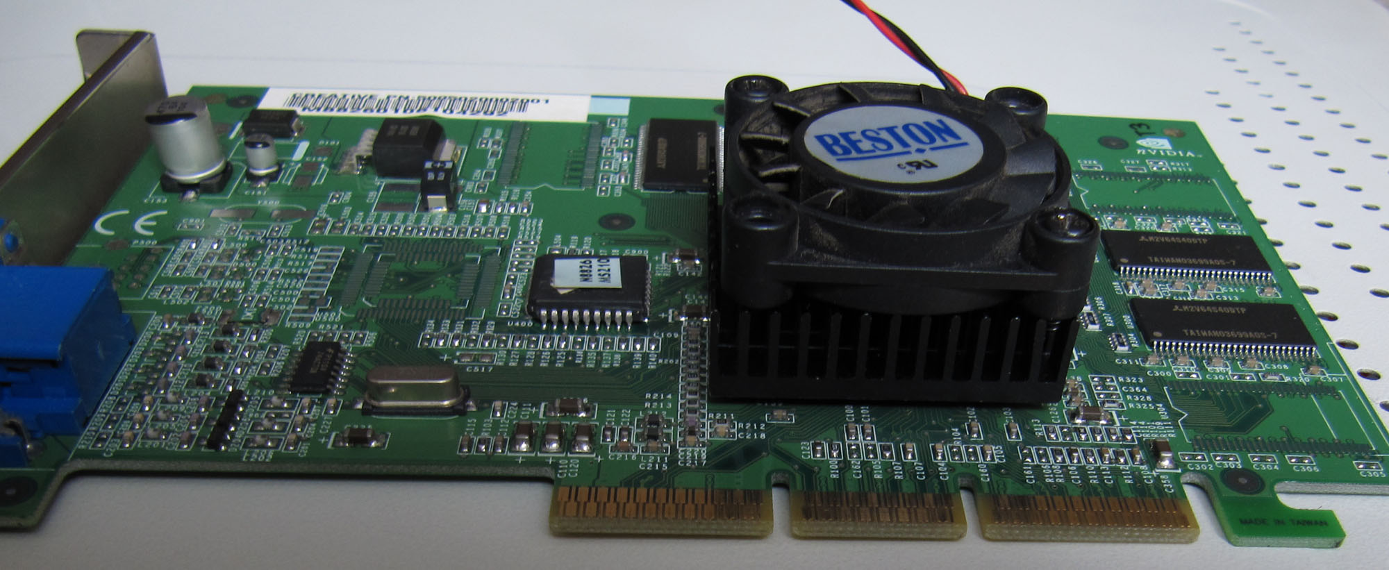

                      I got 2 geforce2 mx 200 cards for free.
                      The first came with its original black heatsink, the other without one:

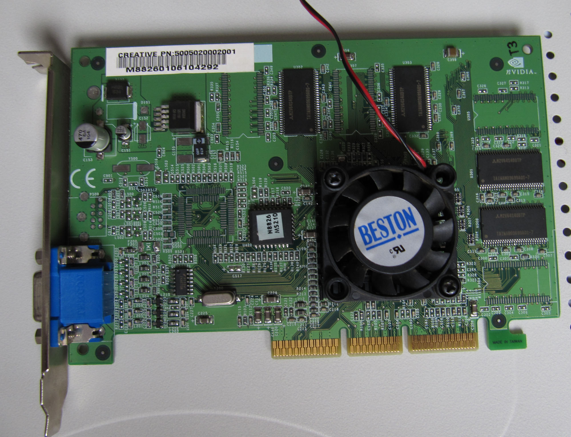

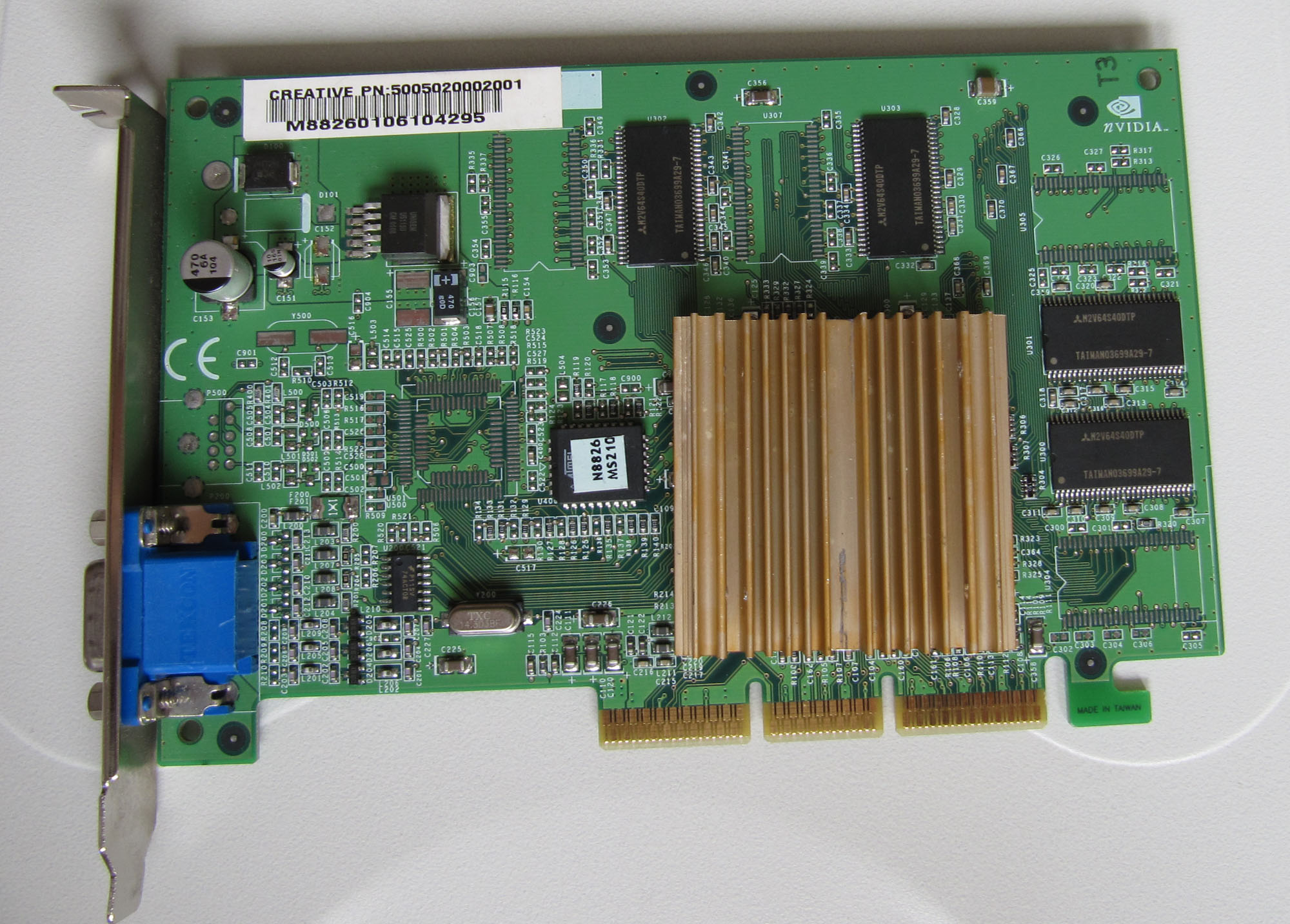

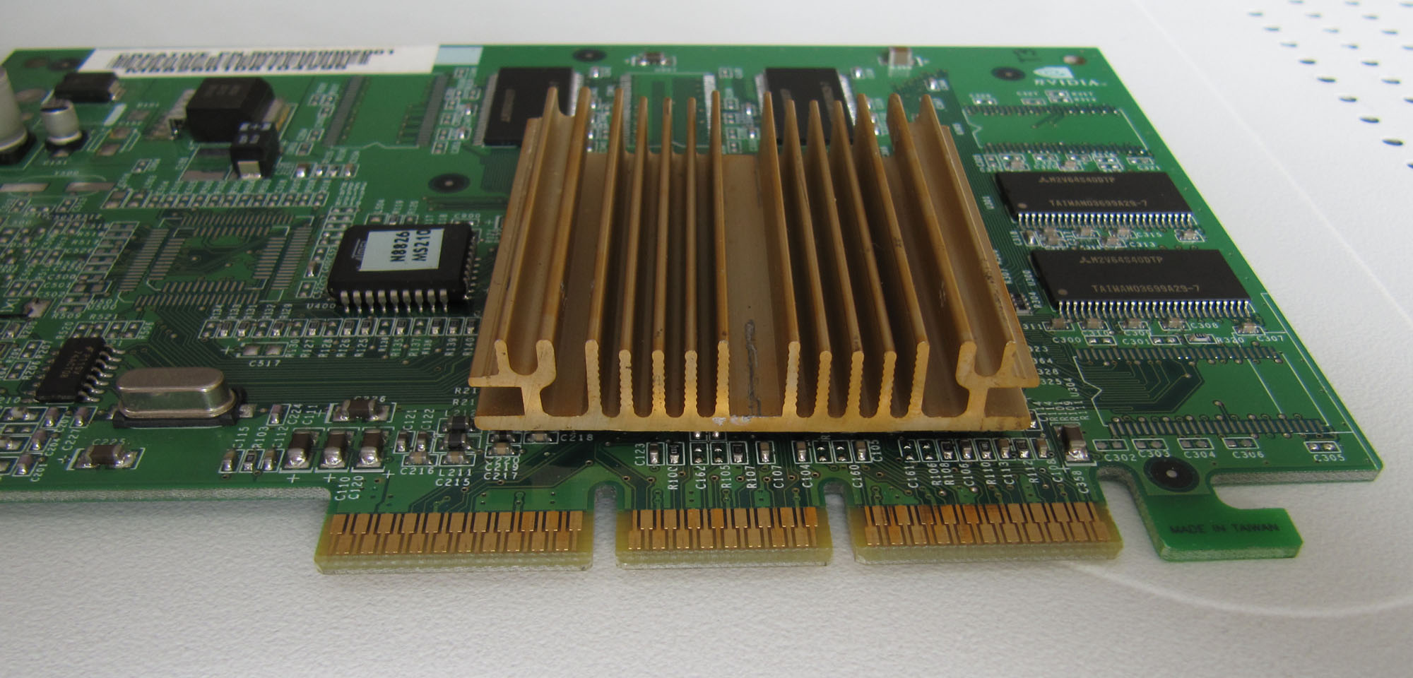

                      https://www.badcaps.net/forum/attach...chmentid=15594
                      Both working...
                      I added a small fan at the first card, making it run completely cool and silent.
                      For the second card I used Arctic Silver Thermal Adhesive to put a spare gold looking heatsink that I had. With that heatsink installed, the card gets warm but not too hot, so at the moment I don't think I need to add a fan.
