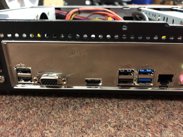

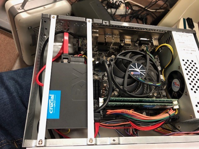

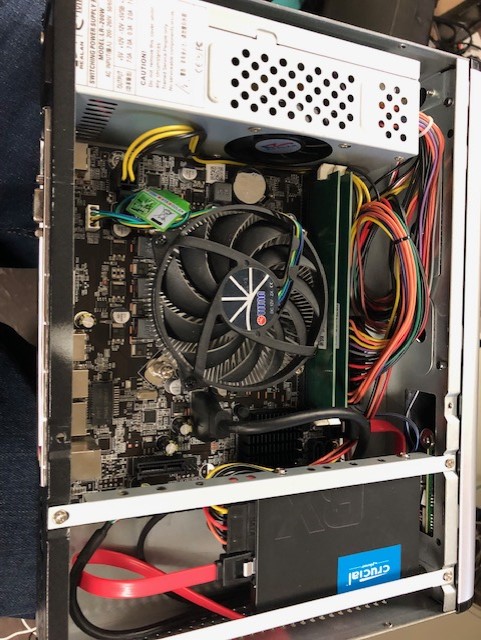

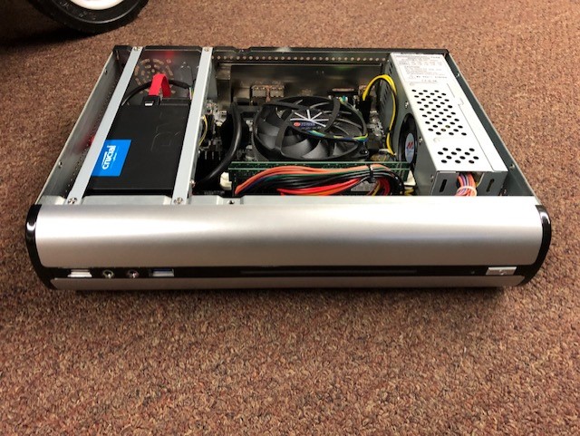

    Okay I built this last year and put alot of thought into it, I wanted to build a system with a really crappy chinese motherboard and see how it would run. for the case I started with the CUK Axiom which is a rebaged realan case and has a 200w psu with cheap caps and really can do about 160w.
    Next the motherboard I chose I found on gearbest, its a generic B75 1155 matx board that has USB3 and 6gb/s Sata. This board does not support TurboBoost so I chose a Core i3 3225 that has the Better HD4000 and no turbo.
    It has a Titan low profile heatsink for the cooling.
    The I/O sheild for the motherboard was also poorly cut so I used a dremel to make sure the USB ports aligned better.

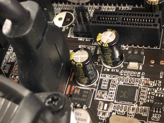

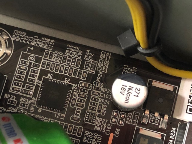

    Now the best part this motherboard has bad caps straight from the factory, NJCON polymers and ChengX eletrolytics never before have I seen such amazing quality.
    I did put in 8GB of crucial DDR3 1600 and a 240GB crucial BX500 so it boots Windows 10 extremely fast. I also have had no stability problems with the unit yet.
    So the real question can the Chinese build a cheap motherboard that works and the answer is YES!

        That ATX power cable is ridiculously long. It looks like it could reach all the way to the expansion slot.
        I also see that they spared no expense on the PSU fan guard - no stamped grill.
          errr yea... by chinese standards yea... the quality is indeed amazing.
          really...? have u tried superpi, prime95 and intel linpack? i stress test my systems very rigorously...
          nope the real question is whether the chinese can build a cheap motherboard that lasts and the answer is still debatable! so thanks for posting. i shall take note of this date and start counting the days on how long it lasts...

                  Despite using a no-name Chinese board, I think this is still a pretty cool build.

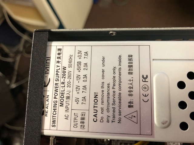

                  Should be plenty for the system.
                  Just make sure it has good caps - especially if it has APFC and has a cheap input cap there, as that is really likely to go out after a few years of use.
                  Lol
                  I wouldn't actually worry about the NJcon polymers, because they are polymers caps after all, and a lot less likely to fail.
                  But ChengX.... yeah, they gotta go - at least the bigger ones or ones that filter any important rails.
                  IDK, maybe the Chinese have improved their quality over the years, but I still don't think they can make reliable caps in the long run. Better stick to the known Japanese brands.
                  Linus tech Tips had a video not too long ago on buying a Chinese X58 board and using it OC an old 1366 CPU. The results were pretty interesting, actually. While the board wasn't a great OC'er, it did support USB 3.0 and m.2 slots - something that IIRC didn't exist on any X58 boards back in the day (well, at least m.2 anyways.)
                  So I wouldn't discredit the Chinese boards in terms of reliability. As long as they followed the Intel design specs, they are probably fine. In terms of reliability, it will be just down to the components they used for the board. Pretty sure MOSFETs and other ICs are fine. Probably only the shoddy electrolytic (and possibly polymer) caps are the ones to beware of.
                  And of course possibly buggy BIOS and lack of long-term support for it.
