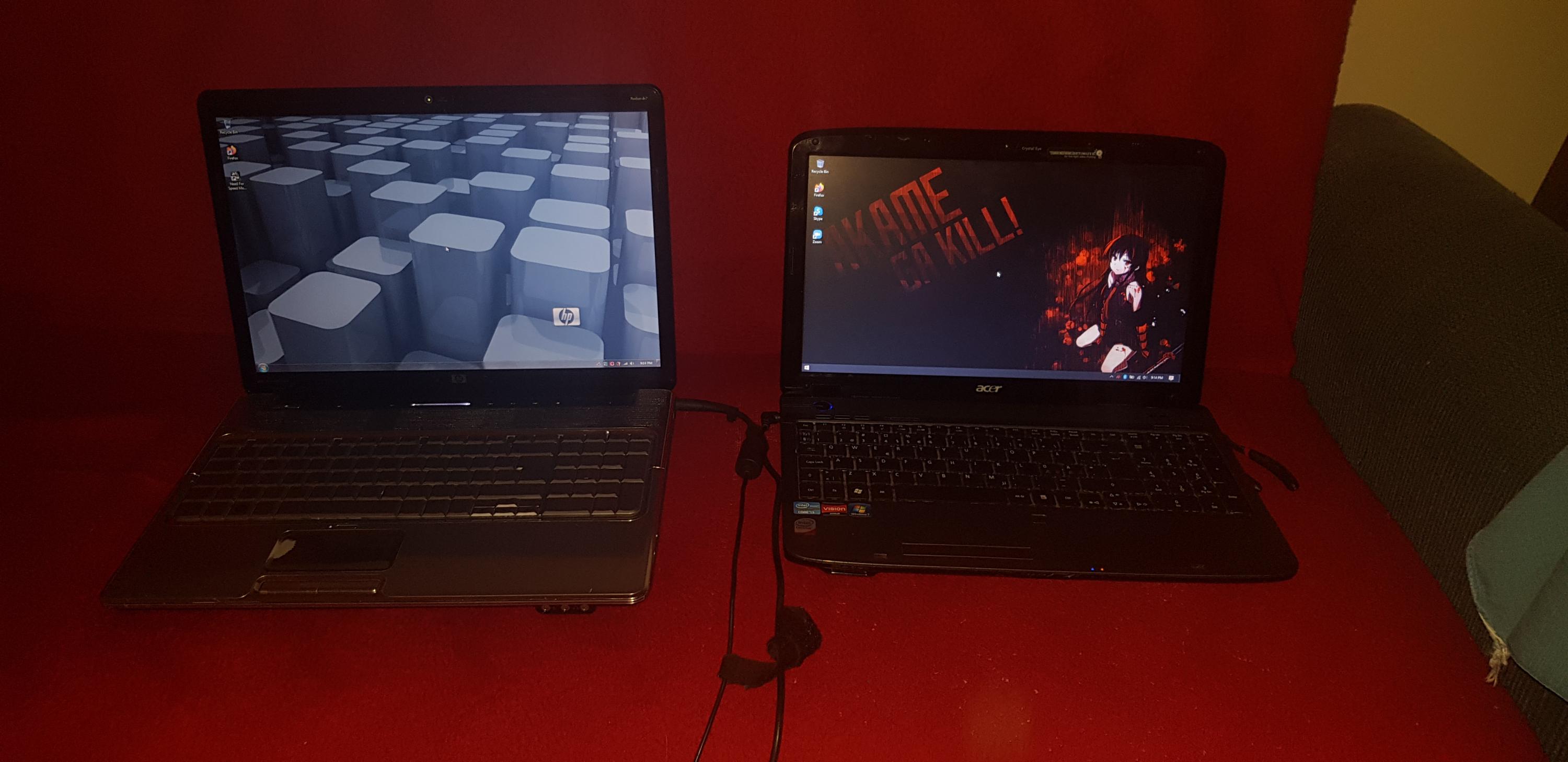

    Speaking of scores, here's a photo of two laptops I have fixed from some of my posts in this exact thread.
    Left: HP Pavilion DV7-1214ea, from post #4737
    Right: Acer Aspire 5740G-333G25Mn, mentioned in post #4152.
    How I fixed them:
    DV7-1214ea: AMD NB needed reflow, this time it actually worked. (I went through 4-5 units that failed to come back to life, this is the first). Have repasted it, swapped in a Turion ZM-82 and added some pennies under the GPU heatsink as the board has slightly warped around the GPU area (since the NB and GPU are pretty close to eachother), and it runs quite cool for a S1G2 machine (much cooler than my now defunct Acer 5536G)
    Acer 5740G: ghetto fixed it by programming an old 775 mobo (Gigabyte 945GZM-S2) BIOS chip with the EC BIOS (using this tool) and then soldering the dead 775 mobo's reprogrammed & repurposed SPI chip onto the Acer mobo.

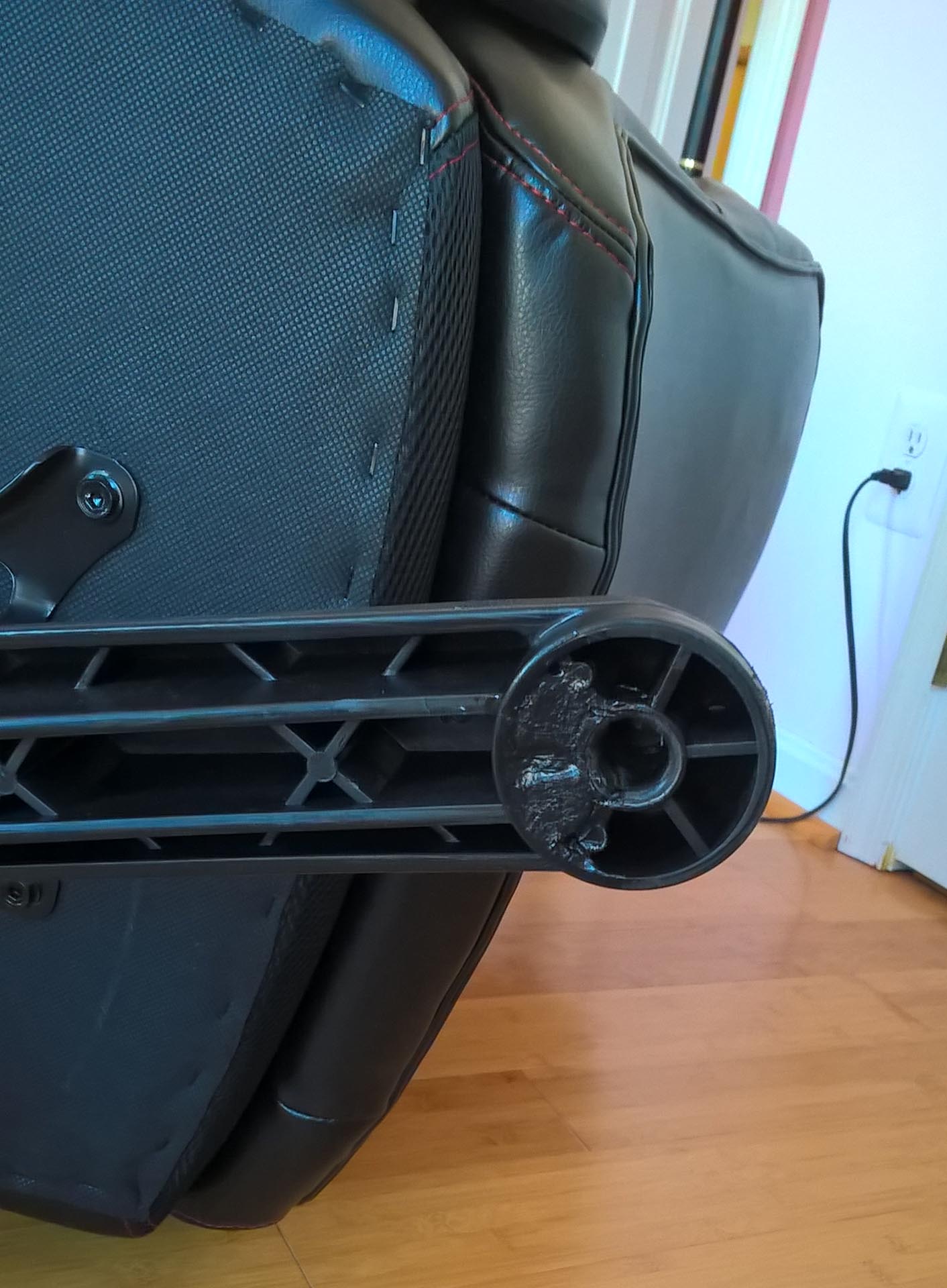

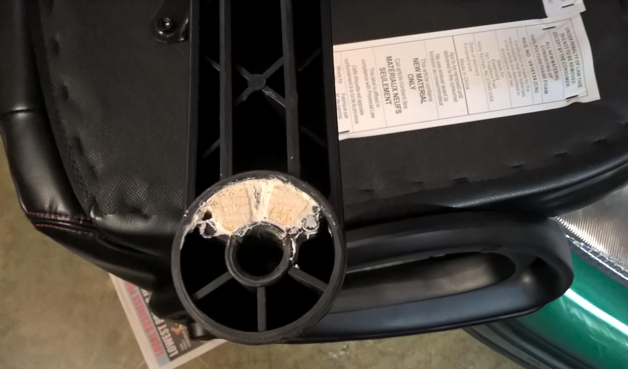

      best cheap/free scores 1.1 - ESS Essentials ESS-6060-RED office chair
      About a month ago, I found a cool-looking office chair thrown out for trash pickup in my neighborhood.
      It’s an ESS Essentials model ESS-6060-RED. It was immaculately clean and even smelled like it came from a clean house (actually, there was a strong air freshener or some kind of leather cleaner smell on the chair, but it wasn’t unpleasant in any way.)
      Only one problem, though: one of the caster wheels was broken off. And it wasn’t the actual caster wheel that was broken, but rather its seat/hole in the plastic base of the chair. Didn’t seem like anything drastic that couldn’t be fixed, though.
      Since the plastic pieces that held the caster were all still attached in base (but just pushed/bent in), I thought it would be best to glue them back in their proper position. I started looking for any marks on the base to see what kind of plastic it was made of. It didn’t say, unfortunately. I was hoping that it would be ABS or other similar plastic that lends itself well to solvent-based glues (like PVC glue, for example.) Since I couldn’t tell what plastic it was, the easiest way to know was to put a big dab of glue on the plastic somewhere, wait a minute or two, and then rub it with a small screw driver. If the glue dissolves the plastic into a gooey substance, it’s suitable. However, I wasn’t lucky with this one. The plastic base didn’t react to PVC glue or Acetone. If I had to guess, it’s probably PBT.
      Thus, I figured the best thing then would be to just glue the broken plastic pieces in there just to hold the shape of the hole for the caster shaft, and then support the back of those plastic pieces with a filler material. I proceeded to gluing the plastic pieces with contact cement. While contact cement is not very strong in applications like this, it does at least stick well to all materials. Once it cured and the plastic pieces were in place, I filled the holes behind them with regular general purpose house silicone and inserted wood pieces as material filler. The result was this:
      https://www.badcaps.net/forum/attach...1&d=1607578612
      It may not be that pretty, but it should hold. And it won’t be visible, since it’s on the bottom side of the base. However, I took it a step further and painted with some black latex paint.
      There, now it’s done!
      After the paint dried, I put the casters back on and tested the chair. Everything worked well. However, I noticed that all of the casters have quite a bit of play room in the holes in the plastic base. Now, I’m no expert when it comes to office chair… but to me, this seemed like the loose caster shafts could do more damage over time if left as-is. So I added a few layers of clear packaging tape on the metal shaft of each caster. This made the casters fit a lot more snugly into the base. Rolling the chair around feels a lot sturdier too.
      So I think that completes this repair. A $150 chair (actually currently more like $125 at Wallmart and Amazon) saved from the trash and fixed with zero parts wasted.
      And here it is:
