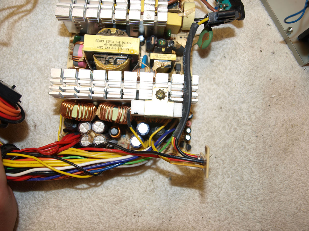

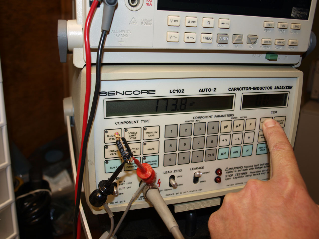

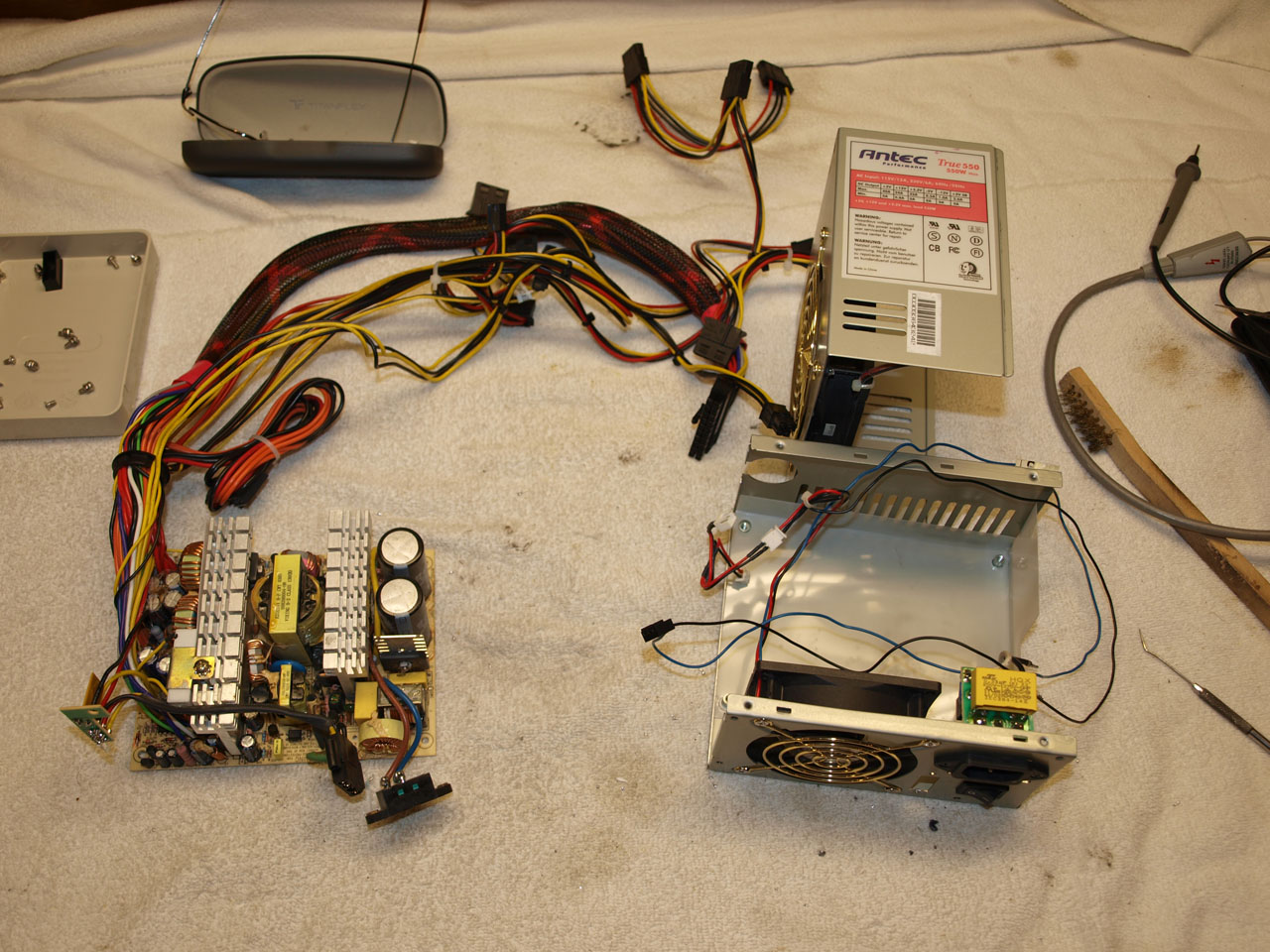

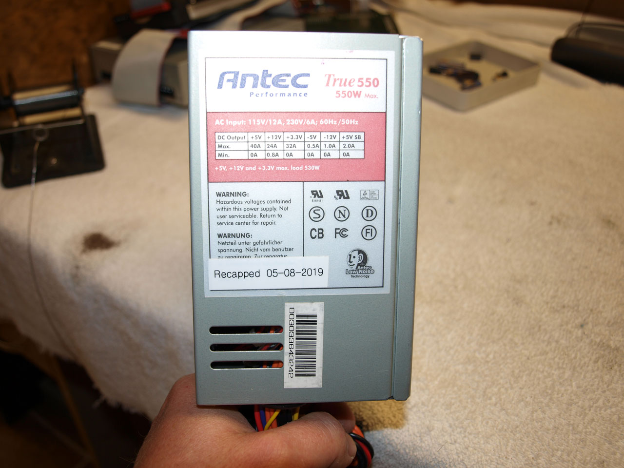

                                  Oh, and don't forget about that Antec PSU
                                  I got around to it today. It was loaded with capxon and fukkyou caps. None bloated, but all way out of tolerance.
                                  Anyway.....here we go!
                                  Apart:
                                  No bloaters....
                                  ...but...yea, 1000uF 10v cap reading 173uF...the other one was reading 51uF. The others were on par with being out of their tolerances.
                                  Back together & tagged.
                                  ...and alive & well. It worked before, but I'm sure it wasn't happy....but now I bet it is!
                                  Just a refresher, this was something Ratdude picked up at the goodwill store.

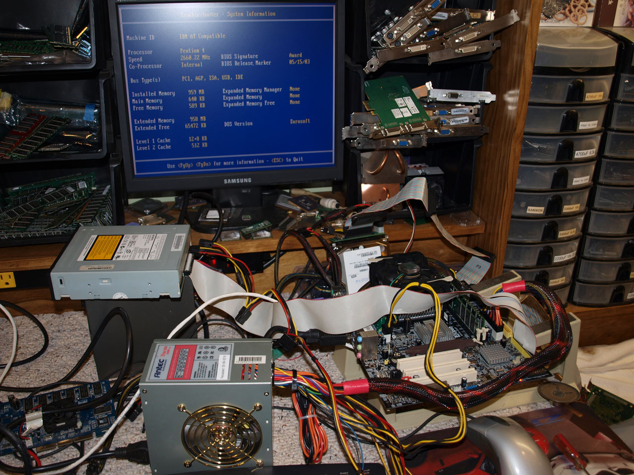

                                          Nice. Not bad for $5?
                                          Now you need to build a rig for it... I owe you a part or two for that
                                          I have a build in mind for it....which starts with a new old stock VP6...
                                          Originally posted by Topcat
                                          ...I also scored an Epox EP-D3VA motherboard, which is basically Epox's version of the VP6 but with an ISA slot...this was a cheap one, it has bad caps.
                                          This one showed up... I recapped it in lytics, as unusual as it is, I didn't deem it worthy of polymodding. Pre-testing this one, if it would POST, it only would show 1 CPU.
                                          ...but it's cured now!
                                          I also attached a heatsink to the northbridge....it didn't have one.
